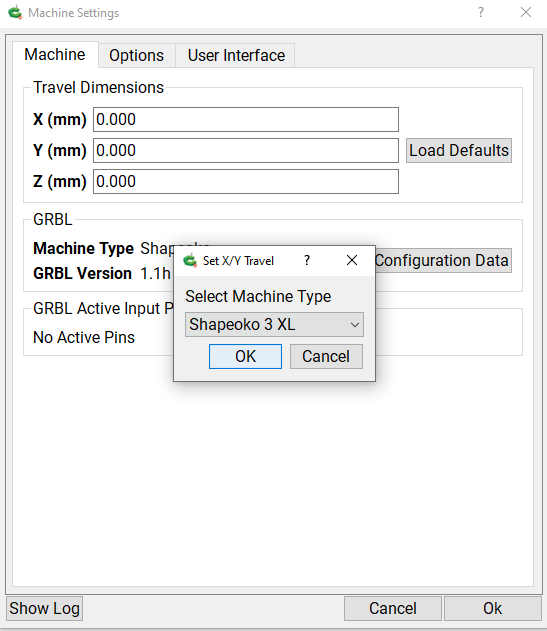

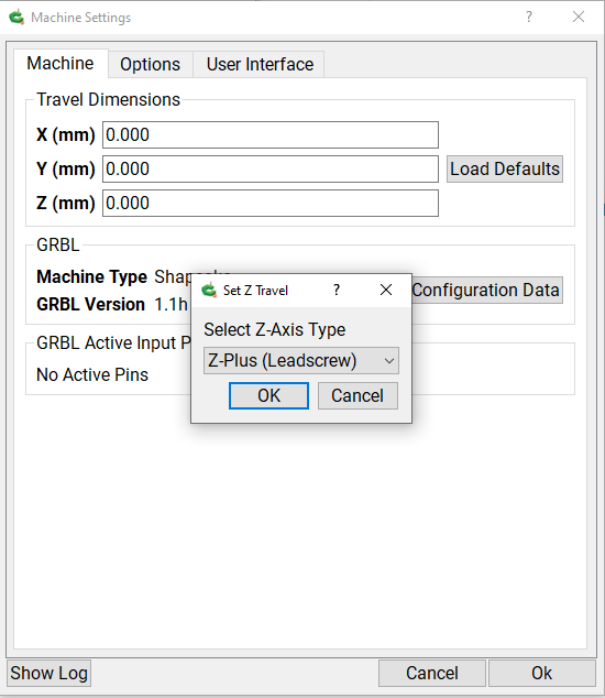

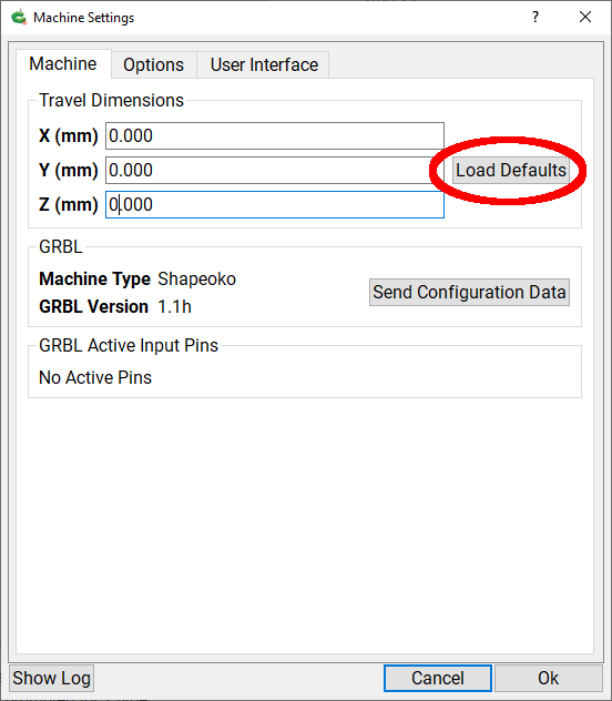

Hi @hroscoe,
Just double checking:
  • so you went in the Settings page, clicked “Load Defaults”:
  • selected “Shapeoko 3 XL”
  • selected your Z axis (I’ll assume it’s Z-plus here)
  • you should the see this:
Carbide Motion uses its own internal limits, so its important that you go through this procedure.
Do you see something different in the “Y” line in “Travel Dimensions” ?

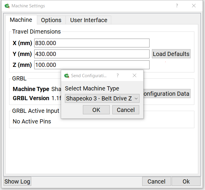

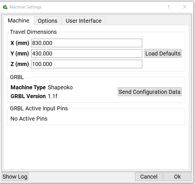

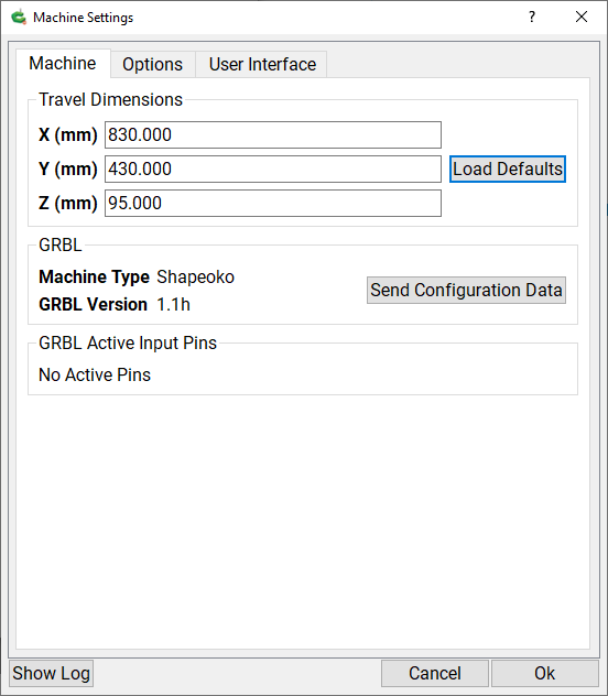

Here is what I did:
Here is what appeared in the log:
