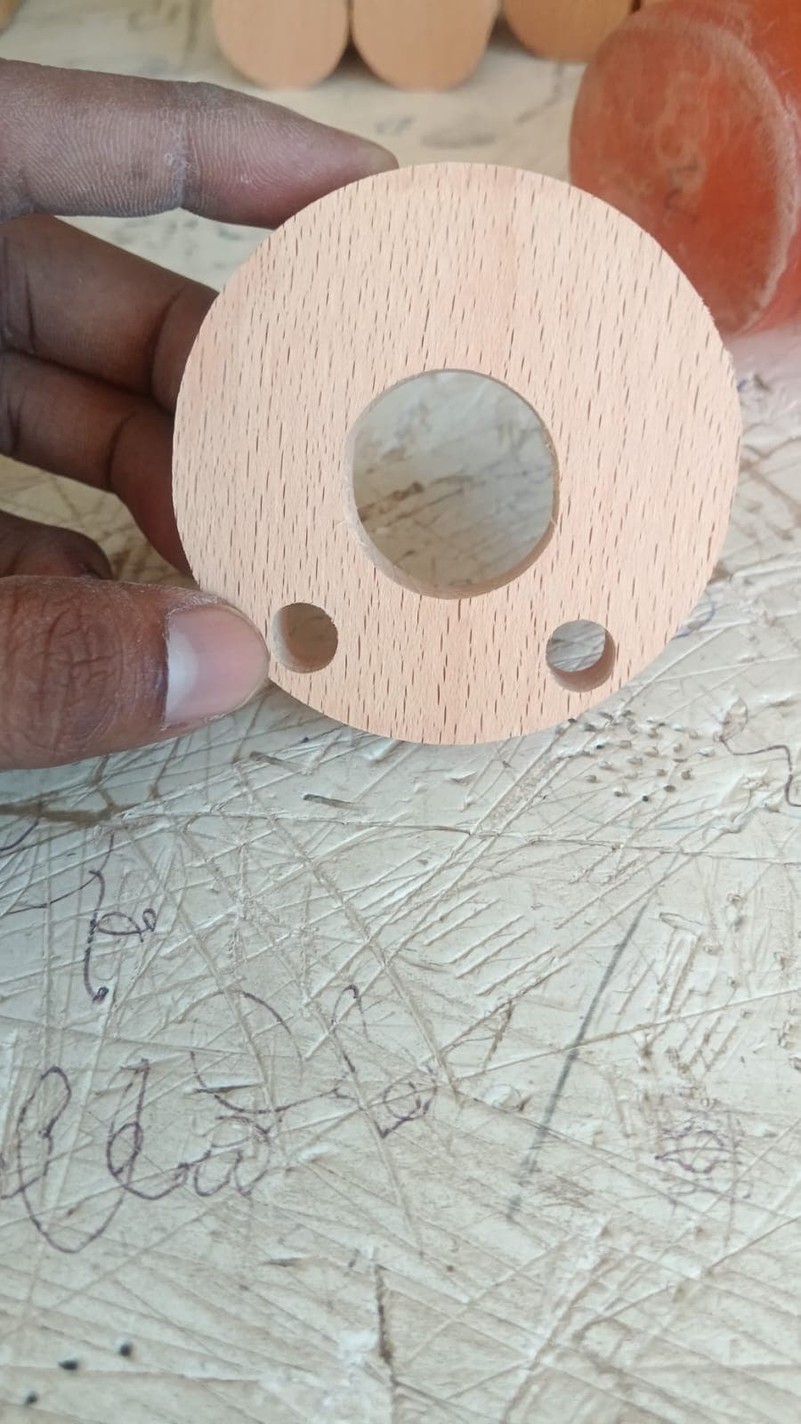

CNC or Vector Issue?
What could be wrong?
On X-axis ( left-right extreme) i see straight cut, instead of circle/arc.
On Y-axis ( top-right extreme), complete arc/circle, no issues at all.
The same vector file worked well sometimes back, so nothing seems to be wrong with the vector file.
How to troubleshoot this on the CNC mechanicals? or something else that i could not imagine.
The best check for the machine is to power up, install a probing pin, jog to the center of motion for all axes, then grab the tip of the probing pin and try to shift it in all possible directions — it should be steady, any aspect of movement should be investigated.
https://carbide3d.com/hub/docs/maintenance/
If the machine checks out mechanically, then the question is if the geometry is drawn accurately — if it is, then the toolpaths may be looked into
and feeds and speeds checked out:

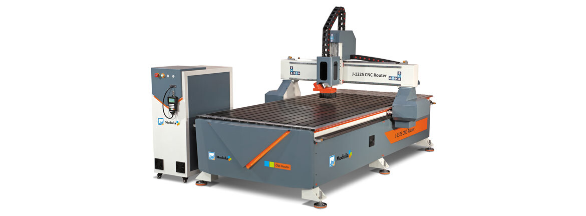

What CNC are you using?
Please send a wide shot of it from the front and send it over.
@sandeepdhariwal, how are you fixturing your workpiece? Is there a possibility it may have shifted during the cut?
with RichAuto A11, Samsung Motors, Panasonic Drives, HSD 4kw spindle, working area 8x4 feet
Hi Randy, No thats not possible, workpieces are fixed like anything, it wont move a mm.
