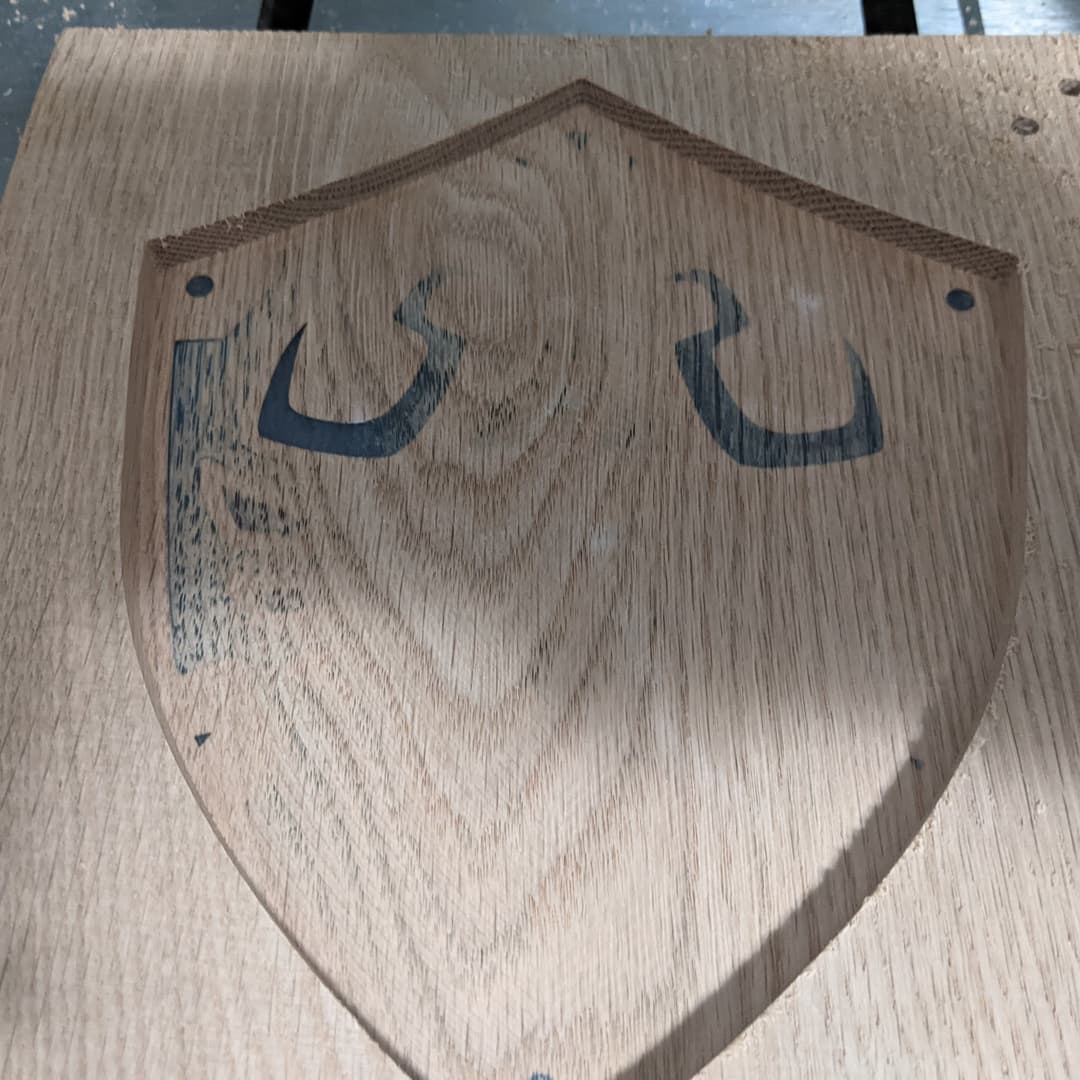

I had some workspace limitations, since I couldn’t use the makerspace shapeoko and had to use the nomad at home.
I’ve been kicking around the idea of doing something like this for a while, so this was a bit of a proof of concept. Some lessons learned up front. Doing multiple colors is harder than expected, at least without some sort of way to precisely pour. Also some colors are going to be harder outright. Alcohol ink might be easier instead of micah powder. Trying to get the mix just right to have it sort of see through. Removing wood from the backside made it bow a bit, so leaving more parts in the middle might be something to try next time.
I quite like how the wood from the vcarve is left to give a distinct line for the stained glass look.
Process was pretty straight forward, it just took forever. I used some oak I had laying around, so put that on the machine and faced it. Then used advanced vcarve with a 3mm max depth and 1/8endmill and 60degree vbit.
Picked sections that were far apart to try and limit this to two pours for the resin. I left the part on the machine throughout this process
You can see some of the color bleed here.
Faced the excess resin then did the next section
I then needed to go back and redo color because I was worried I went too heavy with the Micah powder and had some color bleed. Was pretty cool to see the machine only remove the resin.
Once I was happy with the colors I flipped the part by using locating pins in the waste board and holes I had placed in the stock.
Then I cut the part out and put a thin coat of resin on the back and front to remove the tool marks.
