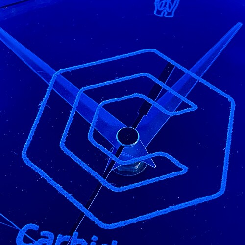

Hey guys! So I’d like to submit this entry, but, forewarning: I destroyed the project in the very last step… :confused:
My idea was to use the Carbide 3D vectors to make a clock design with a slightly different skull on every hour… I happened to have an old clock laying around with a neon blue backlight and a 245mm diameter piece of circular glass.
I used the Skulls category in the design elements page & picked my favorite ones. I recently purchased the Mc Etcher 120/90 degree dragbit pack, and was excited to find a fun use for them. I started by taking the clock apart, and masking the neon light with tape. I’m a spray painter by trade, so this was pretty easy.
I used rustoleum flat black to repaint the clock face. I used Carbide create to position 12 skulls at 30 degree increments. (360/12…) I’ll include plenty of pictures :wink:
I had a hard time using the default svg’s from the design elements page… I had to use the node editing function to make sure everything was closed & contained…
IMG_8808
Then I painted the clock hands silver for more contrast, and made sure my tool paths were alright.
I finished my design in carbide create, and used my pen-holder to do a test run on some posterboard to make sure the vectors looked alright. The pen holder design is actually what’s available on CutRocket: Simple Pen Holder by thefrenchwickler
I used my test run to position the glass face of the clock and started etching with the 120 degree drag bit:
I made sure to flip my image horizontally by 90 degrees so the etching would be on the backside. It looks better that way, trust me. :ok_hand:
After the etching was complete, I reassembled my clock.
However, I cracked the glass when re-tightening the screws.
Ughhh so annoying!
The project would have been “perfect” if it weren’t for the glass cracking. :frowning:
Oh well. Lesson learned? I still think this was an improvement to the original design! Now I just need to find another piece of glass with a 250mm diameter… :sweat_smile:
then it’ll be good to go! :metal:
