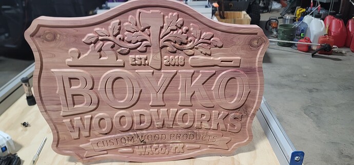

So, I’ve wanted a machine for some time, and finally bought one in November. I had never touched a cnc before. With the tutorials and this forum, I did my first sign this weekend. I am absolutly sold on the Carbide/Shapeoko!

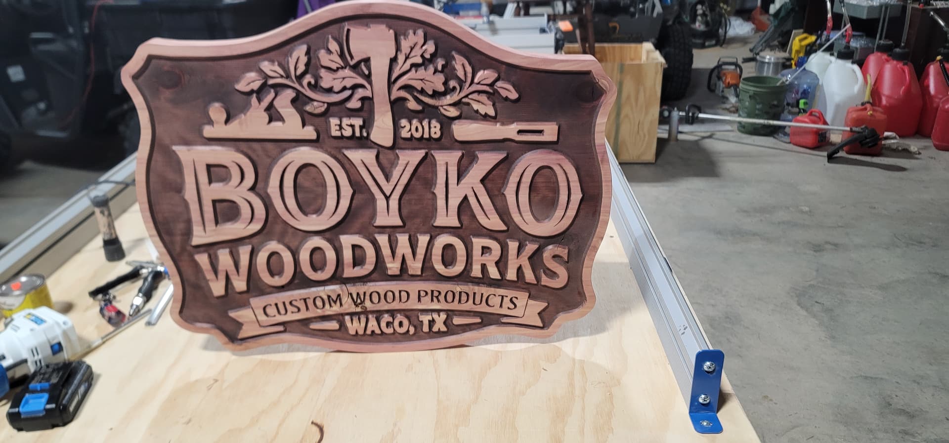

That is a GREAT job! Carve looks excellent and I like the contrasting color

To get that clean and consistent contrast, did you stain the entire thing to finish it and just surface it as a final step?
I used a brush and tried to stay in the valleys, then wiped up almost immediately. Then just hit the top with a DA sander.
Nice!!! Excellent contrast & detail. I love the position of the knots ![]()
It was some old cedar I had laying around. Cut a couple pieces, planed and glued up. The knots were just random. ![]()

Great design! I really like the organic elements. Great work.

Can you tell me what steps/process you used to darken the background and leave the raised design untouched?

@Frank246 I used a brush and stained in the recessed areas. Then used a DA sander and hit the raised areas to remove any stain that got on it.
