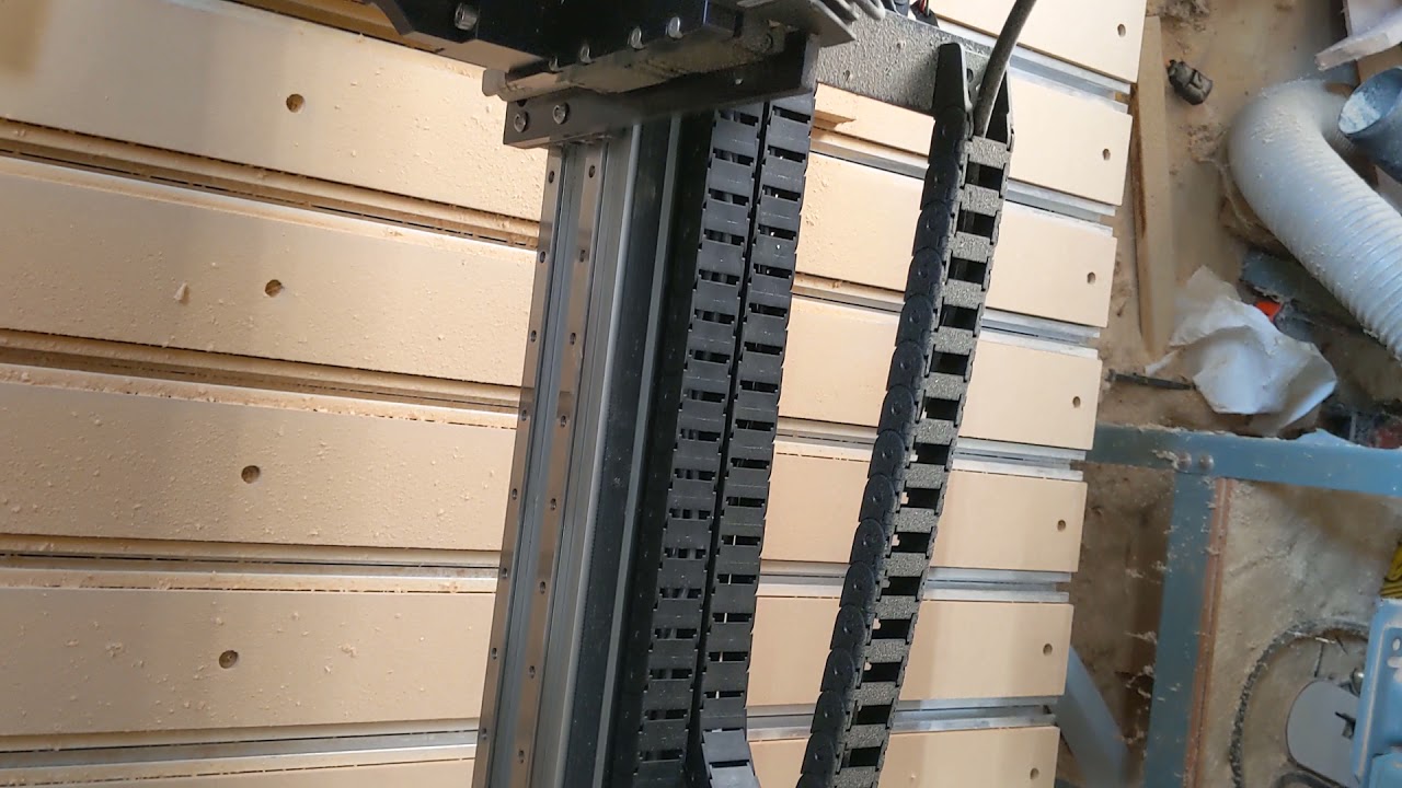

I went into the house for a minute to grab something to eat on a 20 min toolpath.
When I came out the tool was going in weird directions. Now the Y axis is stuttering when I initialize the machine and it stutters a bit when manually moving it quickly by hand with the machine off.
It seems to permanently stutter (in place) when it gets to the back of the Y axis.
The machine is a shapeoko pro xxl.
Video of issue:
I really hope I haven’t damaged something permanent. Any ideas what I can do to resolve this?
I haven’t had it long but it worked perfectly before this. I’m not sure if my laptop went to sleep while I was away from it. I’ll have to make sure it is set to not sleep.
Any help is greatly appreciated.

Ok, if the Z still registers correctly, but the Z movement during initialization does not stop and grinds at the top of the axis (is this what’s happening ? hard to tell from the video), it may be that the axis meets the mechanical limit a little bit before it would trigger the switch. You may be able to reposition the switch slightly lower, such that it triggers in time.
I think it’s actually the X axis… The z initilizes correctly but the X doesn’t move at all. I’m going to have a look at it further.

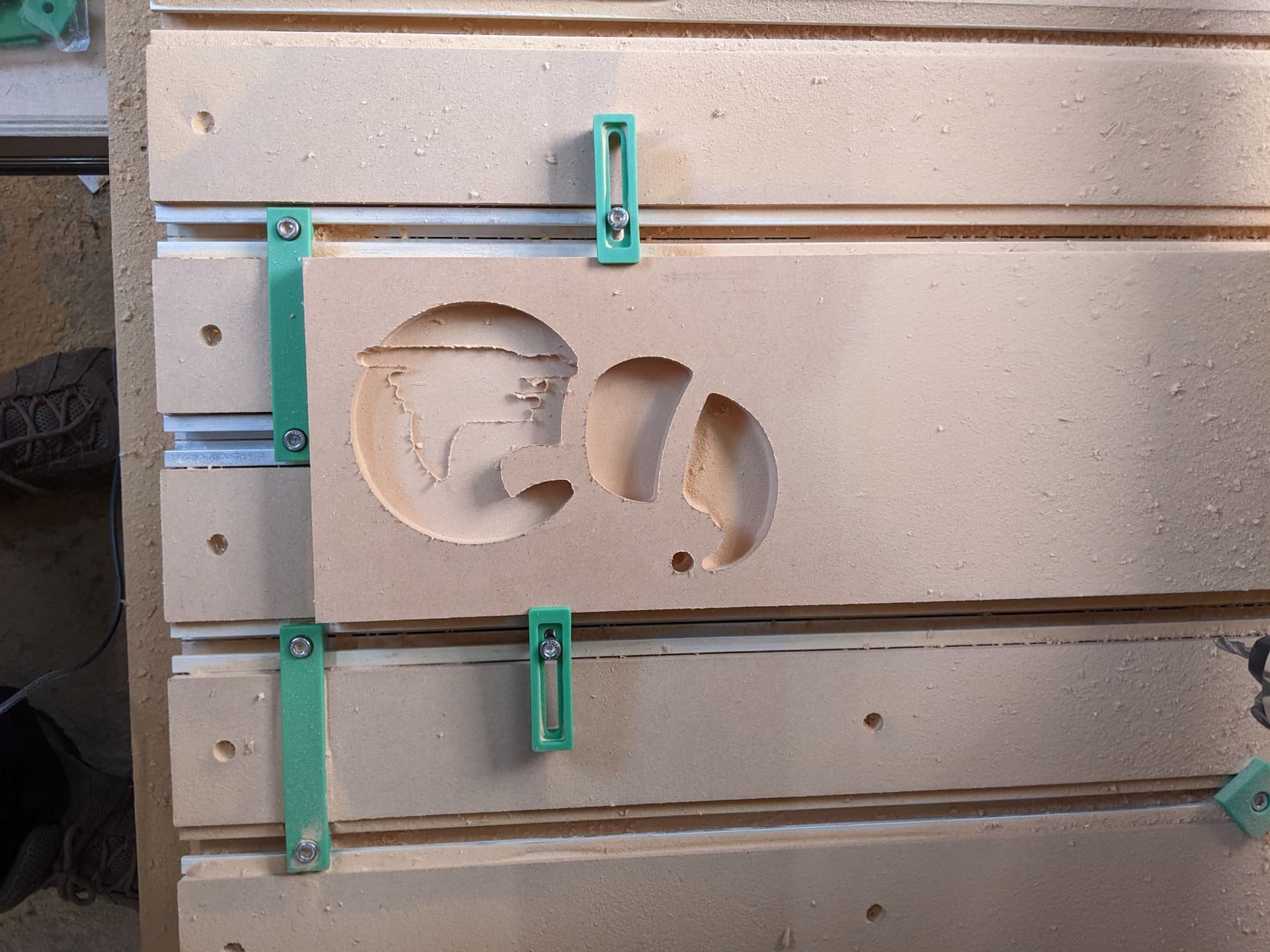

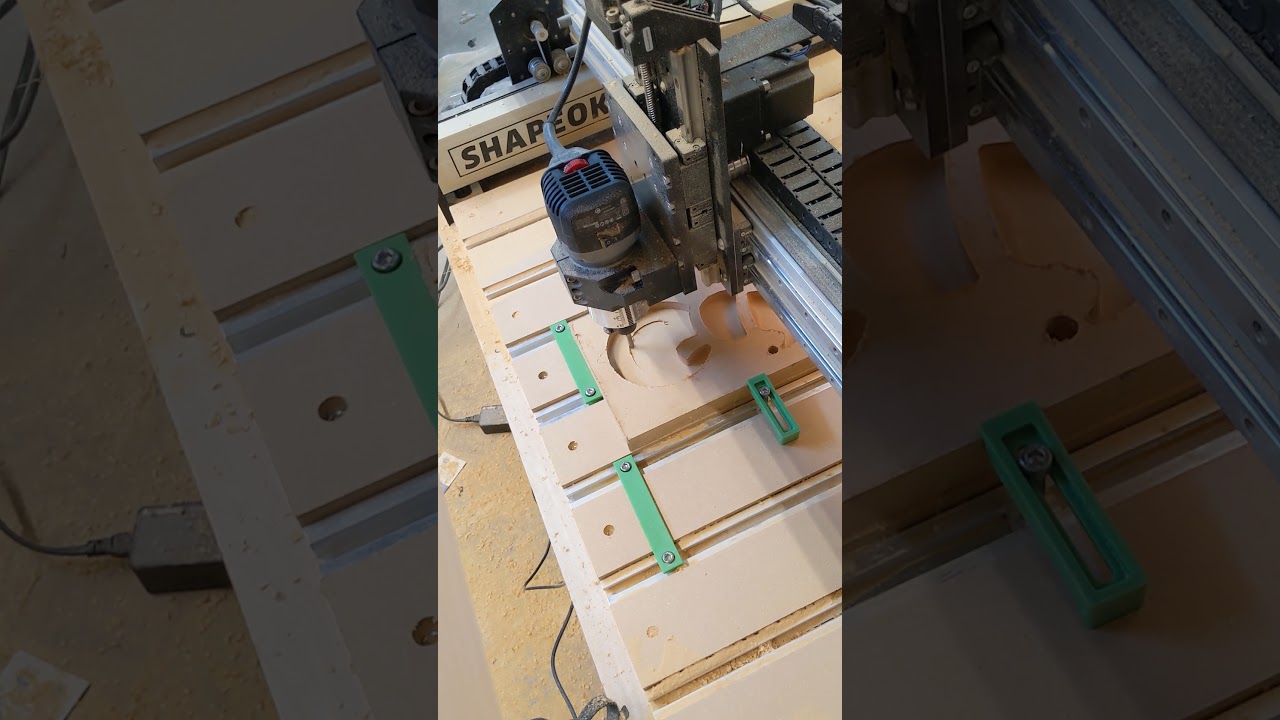

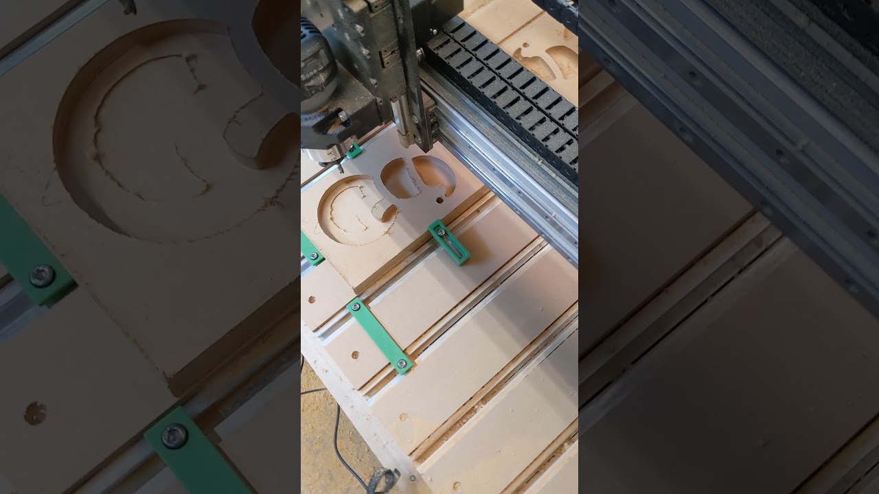

This has happened three times at the same section. I was able to get video of it.
I started the cut on a fresh piece, the first two pockets worked fine (same toolpath as the third).
It only seems to fail when it gets 10-12mm deep in the material at that point.
I edited the toolpath to just be the bottom cavity and started it fresh. It was running fine but I didn’t want to wait for it. So I edited the toolpath to start just above the existing depth. It cut fine for a pass or two but lost x-axis again.
The third time I got these videos:
X-axis stalls
re-zeroing afterwards.
Let’s see what support has to say, but I would probably remove the x belt, remove the X stepper motor, and inspect the pulley set screws there (is one of them still aligned with the shaft’s flat, and are both tight?)
