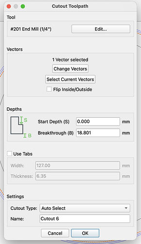

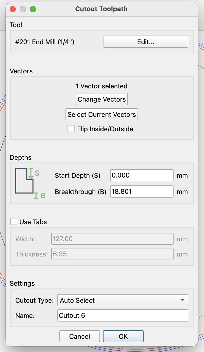

I’m trying to do a cutout. Previously when I had done cutouts, I had a field that said “use stock bottom.” I’ve either changed a setting somewhere or I’m forgetting or not seeing or understanding something, but I don’t have that anymore. (Though weirdly it is on contour… maybe I was using contour previously for cutouts? Is that the way?)
Also, on cutout, there is “breakthrough,” which I had thought meant stock bottom. So I put the thickness in there… but the simulation shows that the cutout is going to down twice as far as that. I’m so confused. :confused:
Before the Cutout toolpath existed folks would use a Contour toolpath to cut out a part.
Breakthrough at 0 exactly equals Stock Thickness. Adding Stock Thickness to that as depth results in cutting twice as deep. A negative value for Breakthrough will leave that dimension as an uncut “onion skin”.
Holy cow I never would have intuited that :smiley: Just makes me feel dumb for not reading it somewhere. Thank you! That makes sense

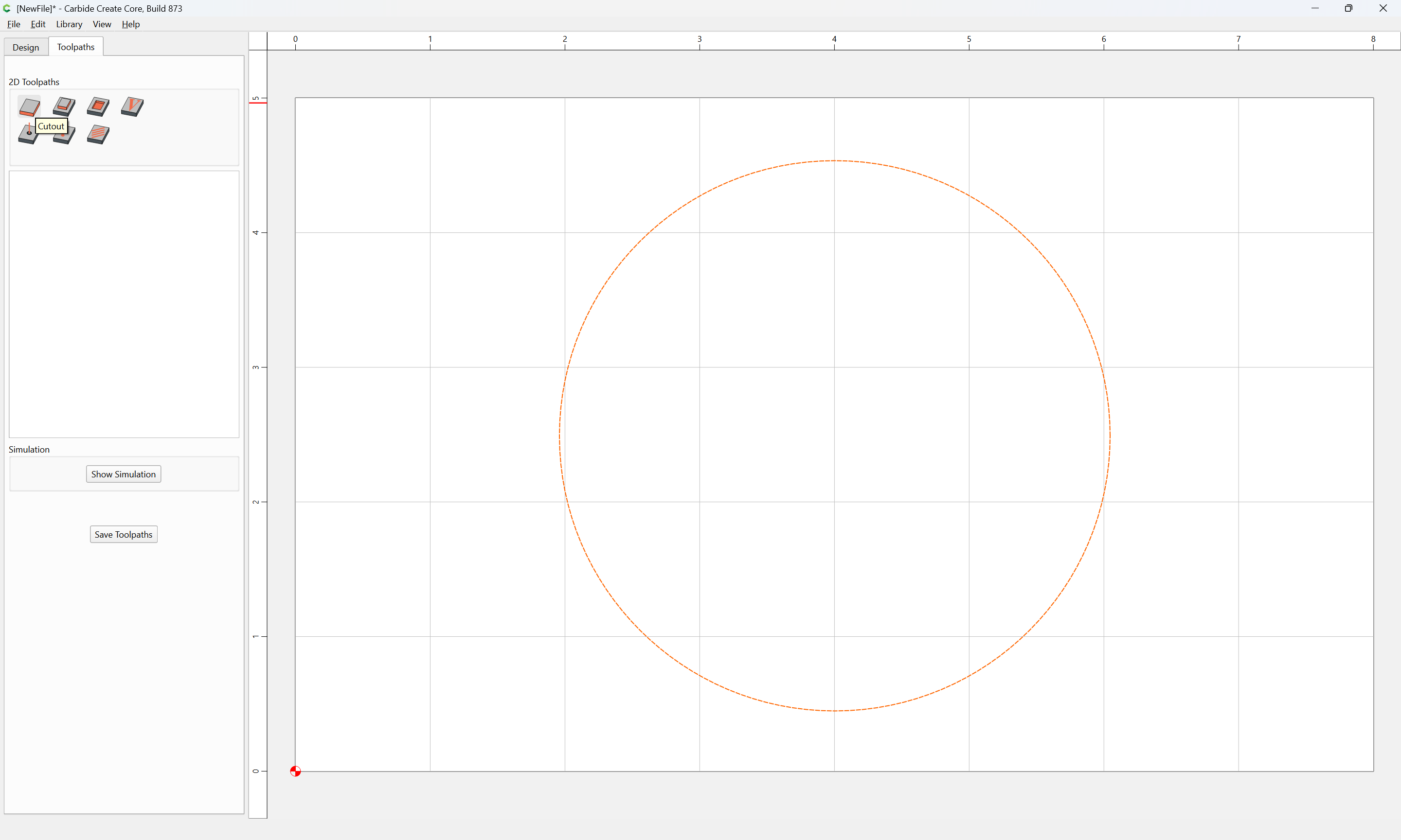

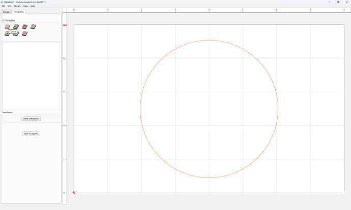

Where is this cutout tool (in Carbide Create. I have not been able to find it.
Any sugggestions?
It is the tool paths. May be pro but not sure. I have pro so what I see is what I get. You have to be above a certain level for the cutout tool path. The current level is CC 870.
The cutout path cuts a wider path than the tool to keep you from clogging up the tool when doing a contour cut. So a cutout path takes longer than a contour cut but is safer for not getting a tool broken off and recutting chips.
Since this came out I used it 3 times. Each time it cut below the stock and into my spoilboard. I have not used it in the 870 so not sure of behavior. That may have been fixed. Suggest you do a test before using it and set up as you like.
It was added in a recent beta and is in the current stable build:

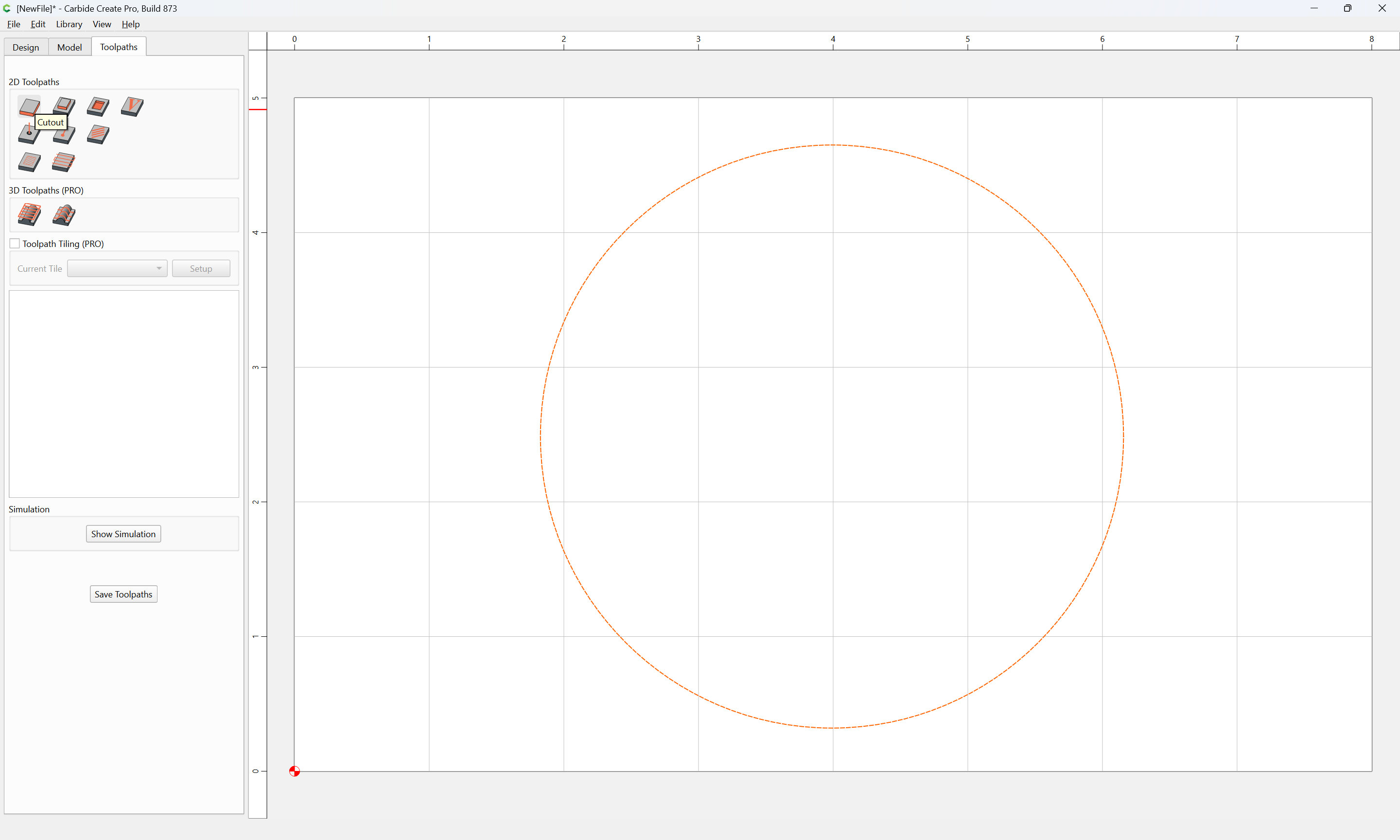

Is it a Pro version?
No.
Just update to the current stable, or better, beta:
