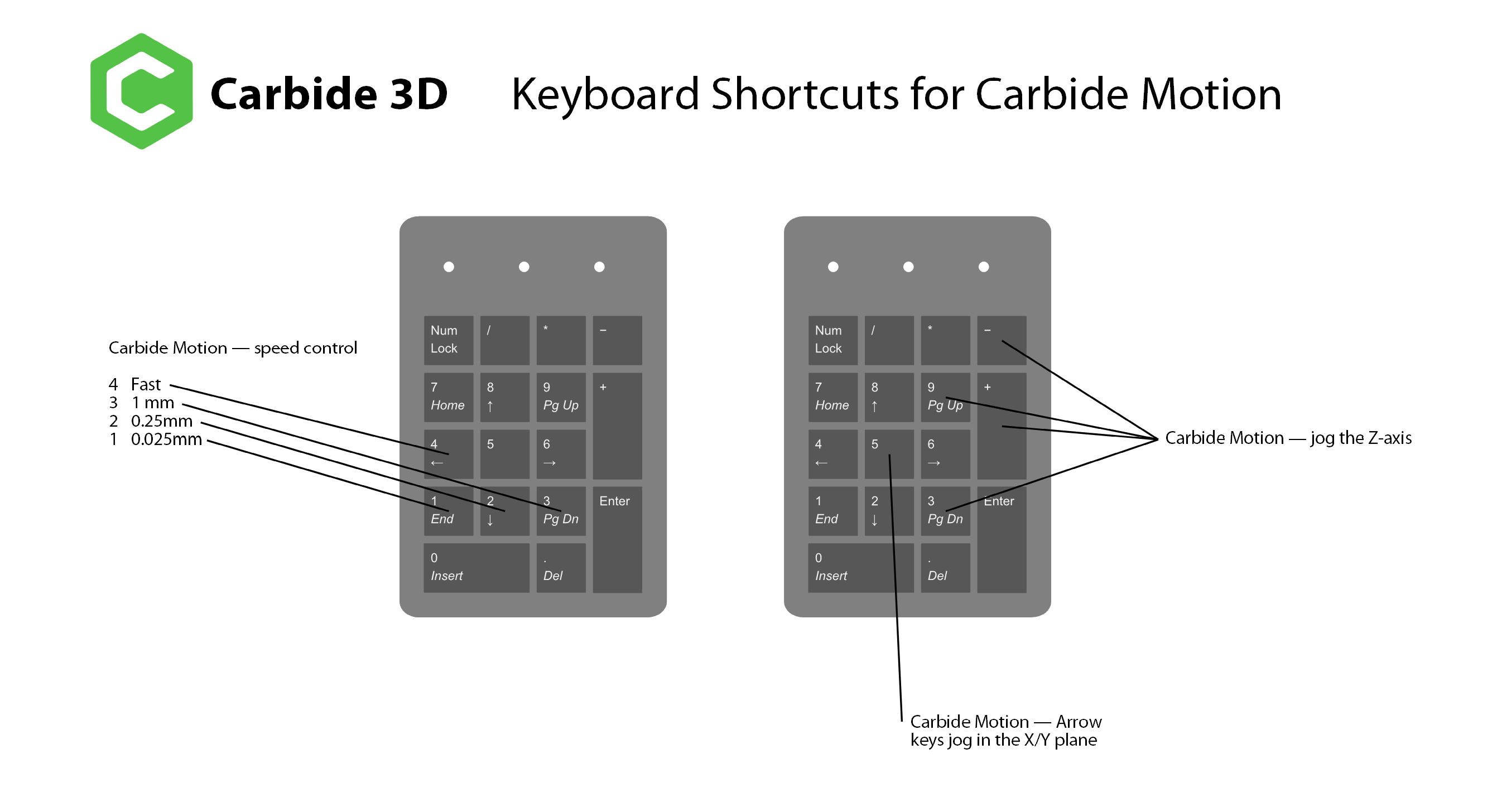

that said, the default shortcuts should allow a numeric keypad to “just work”:
