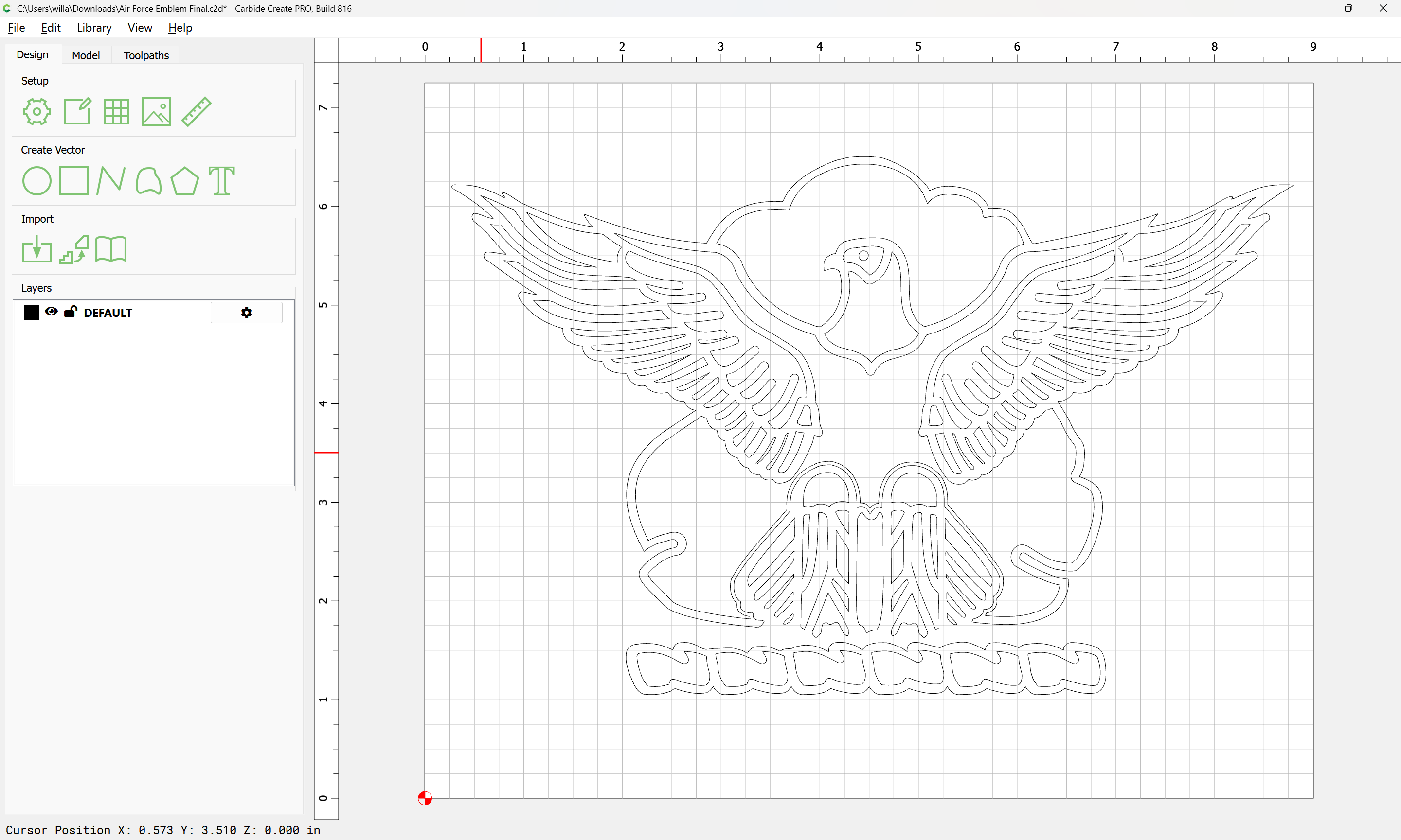

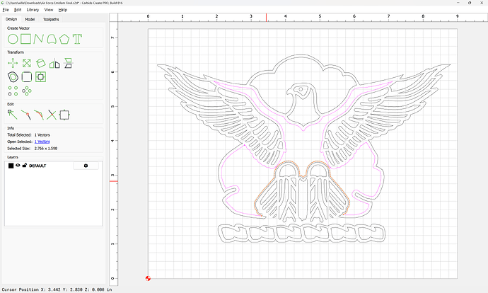

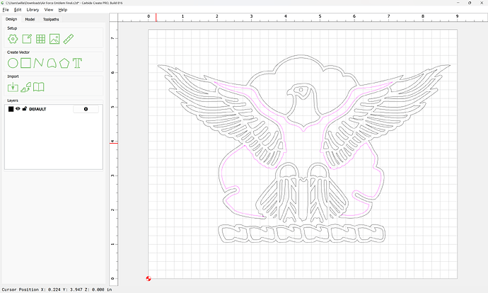

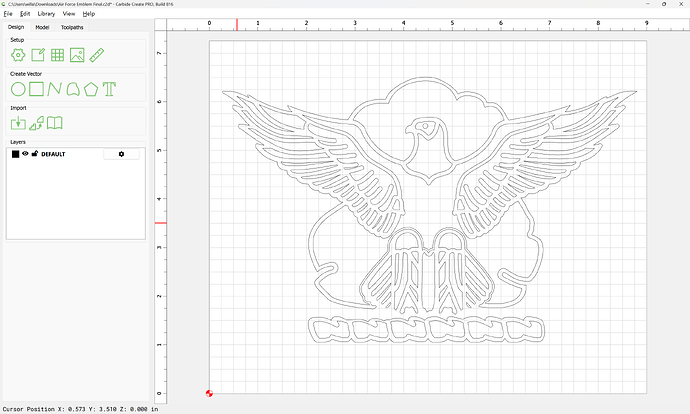

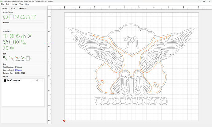

I am having difficulty trying to connect vectors on a eagle file I am working on. Can someone give me some direction on how to get them connected?
Thanks,
Kerry

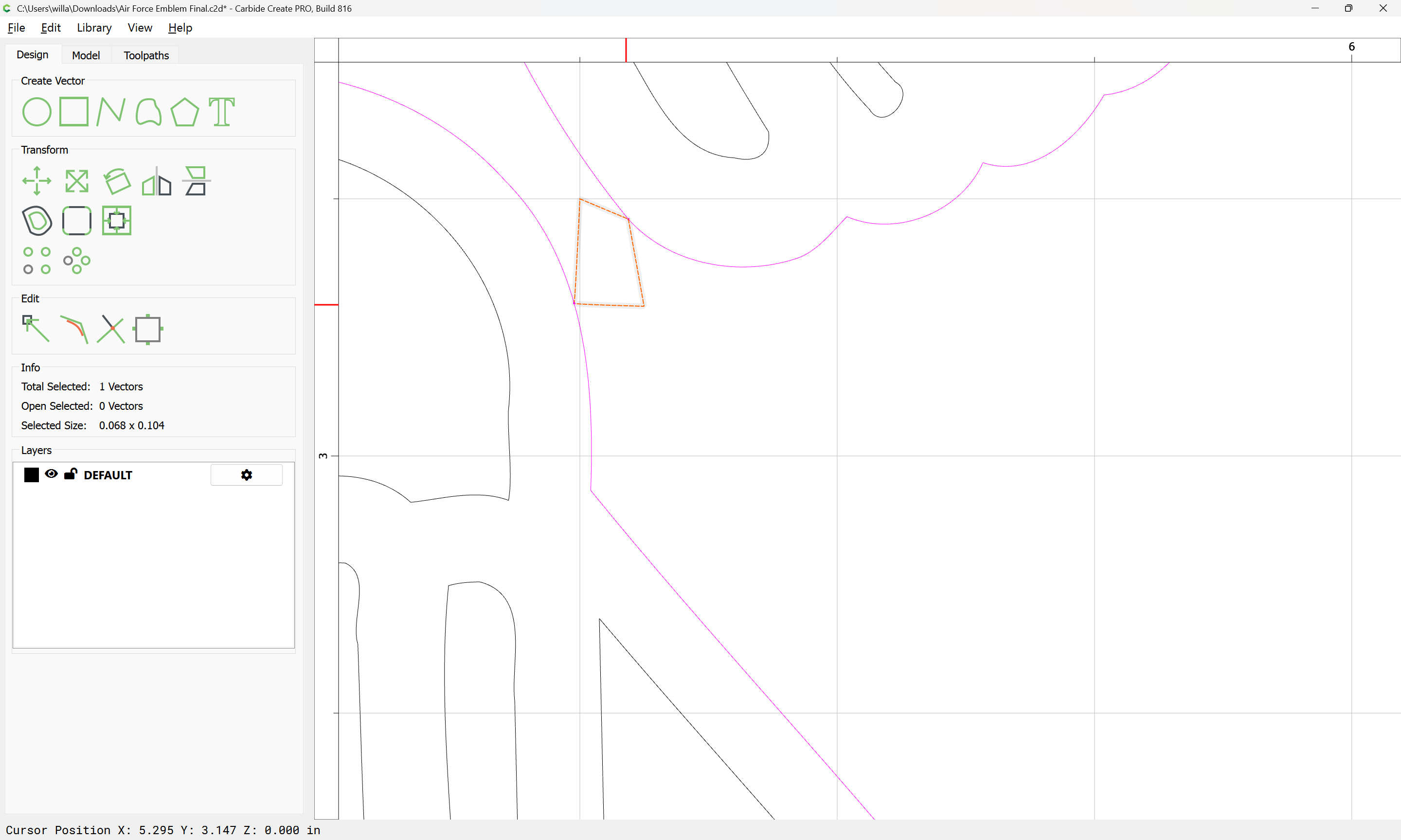

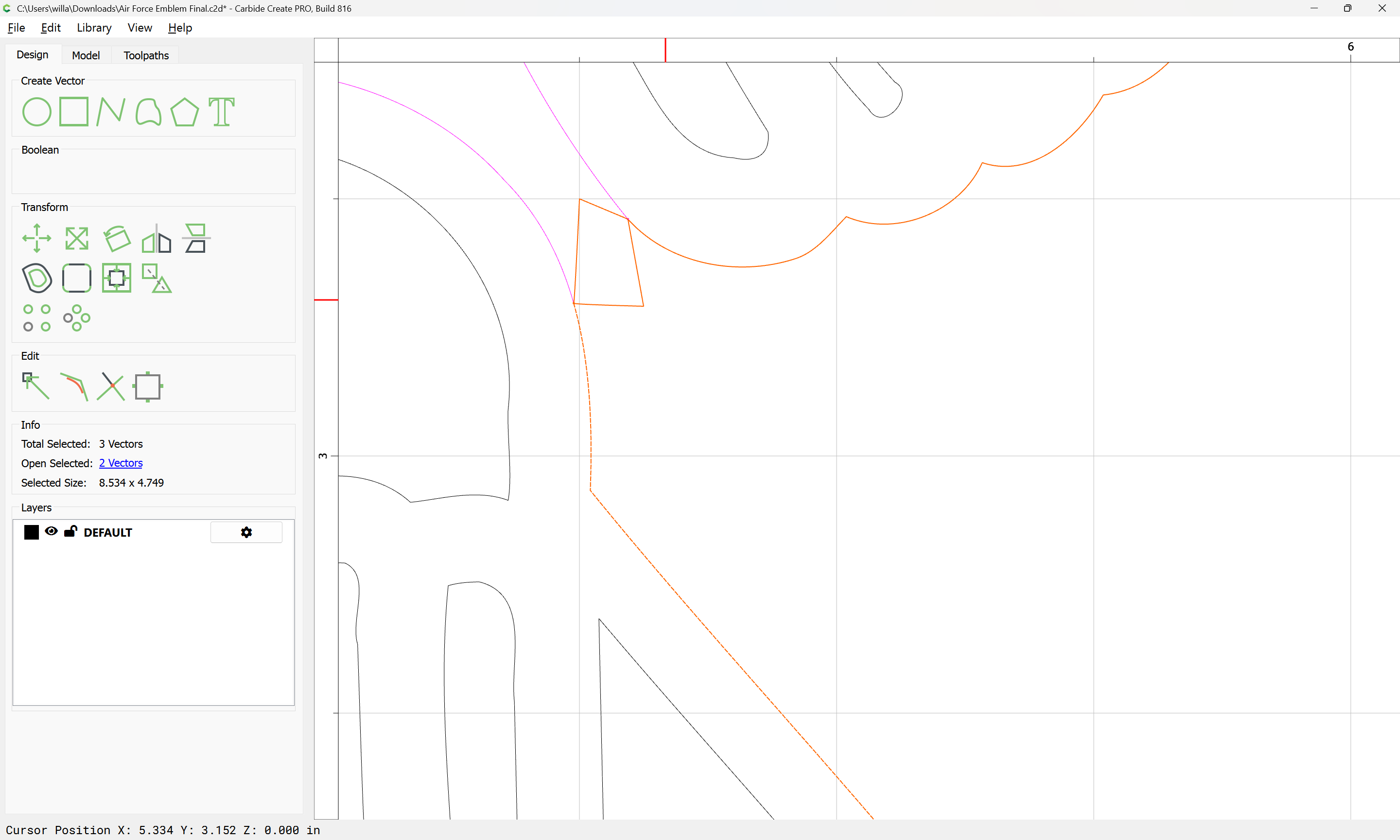

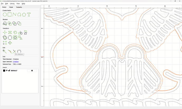

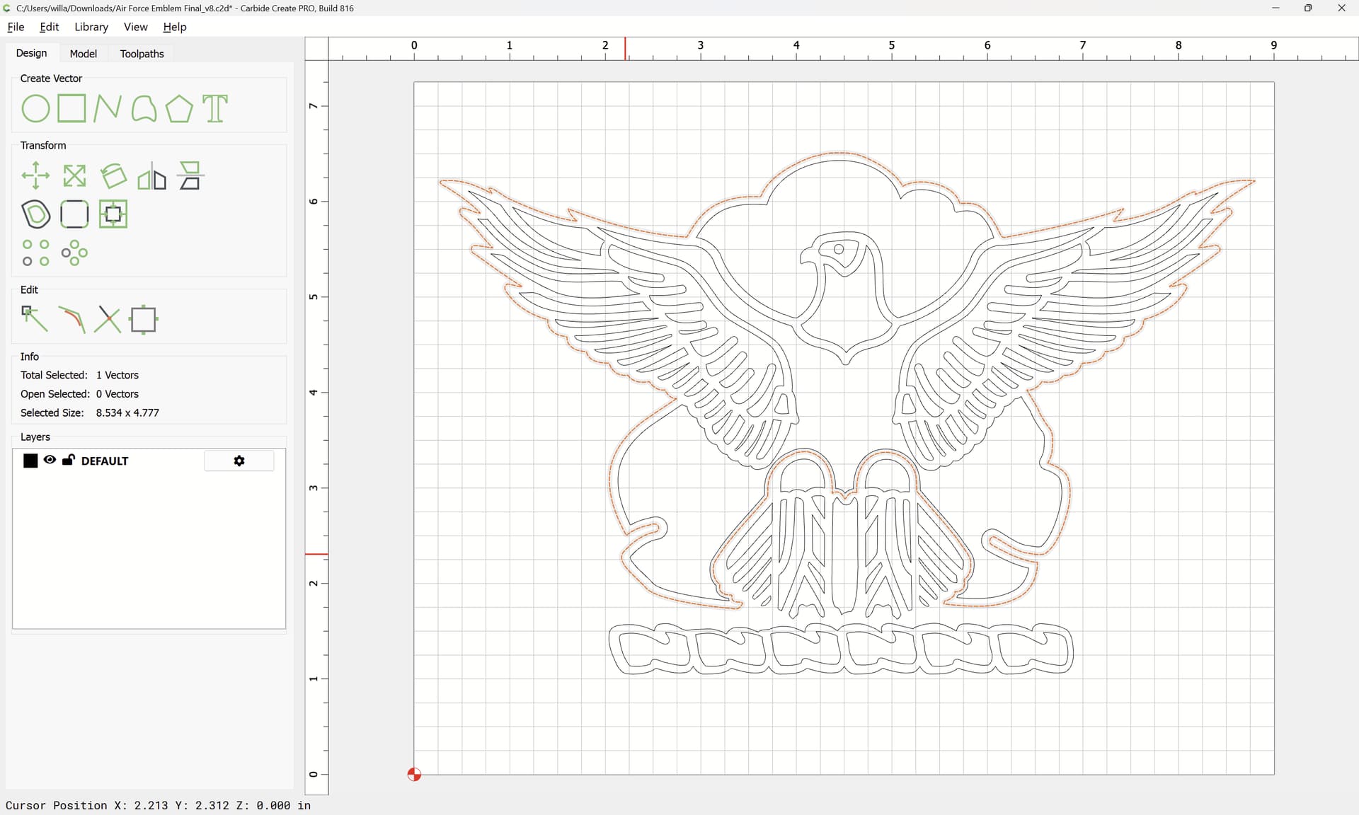

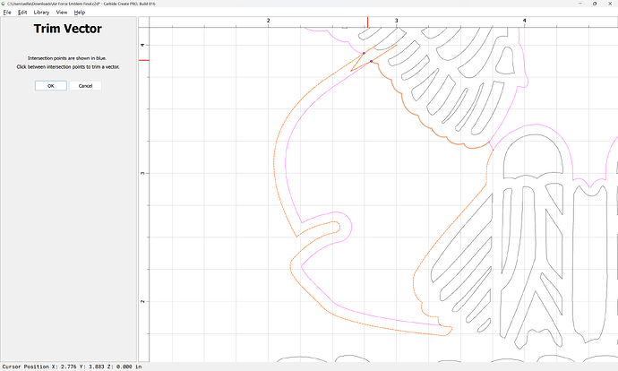

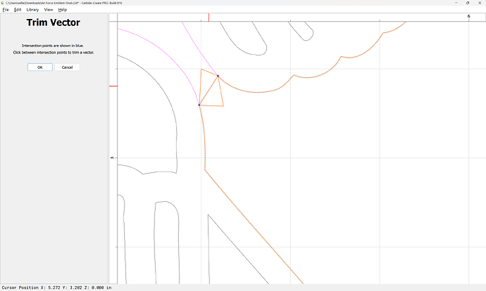

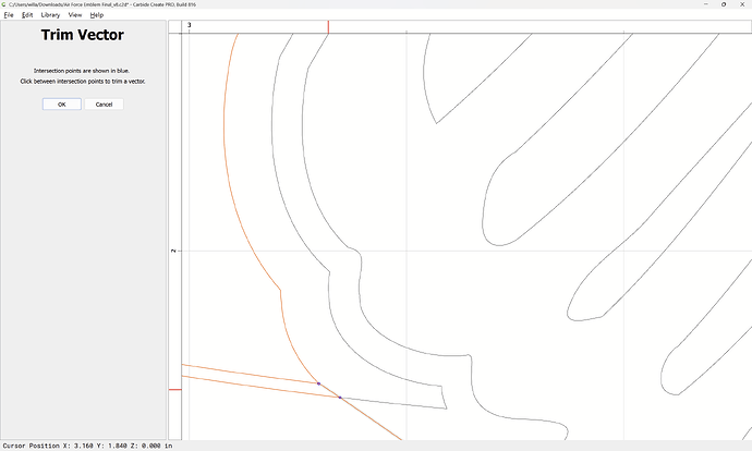

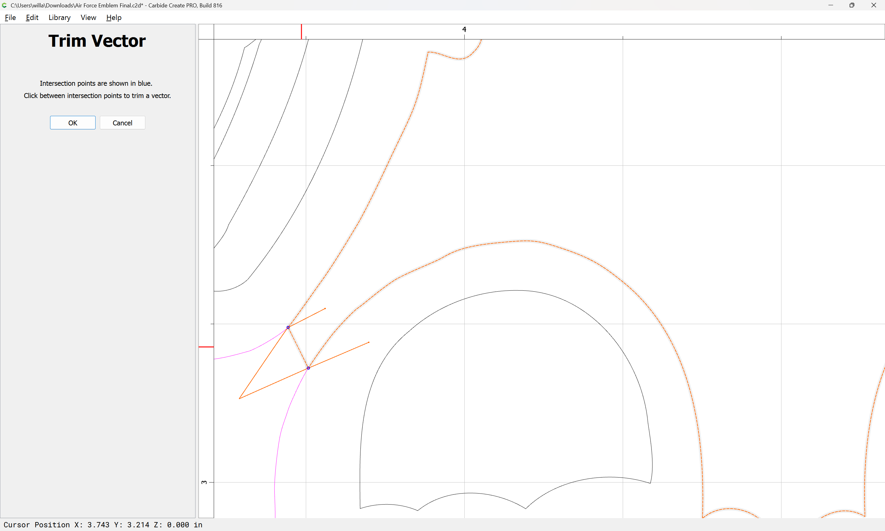

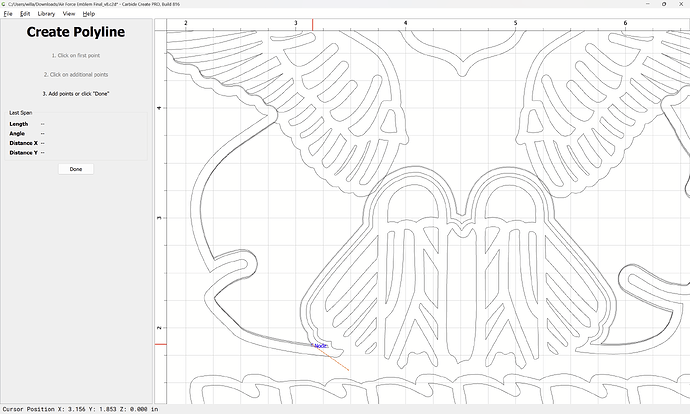

You need a set of vectors which describe a closed region.
Working from the outside in, we get:

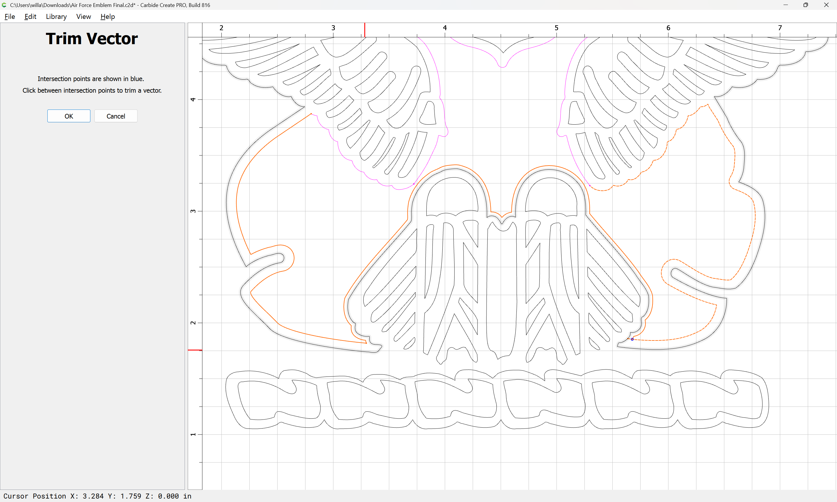

which needs to be opened up so that it can join with the balance of the other geometry:

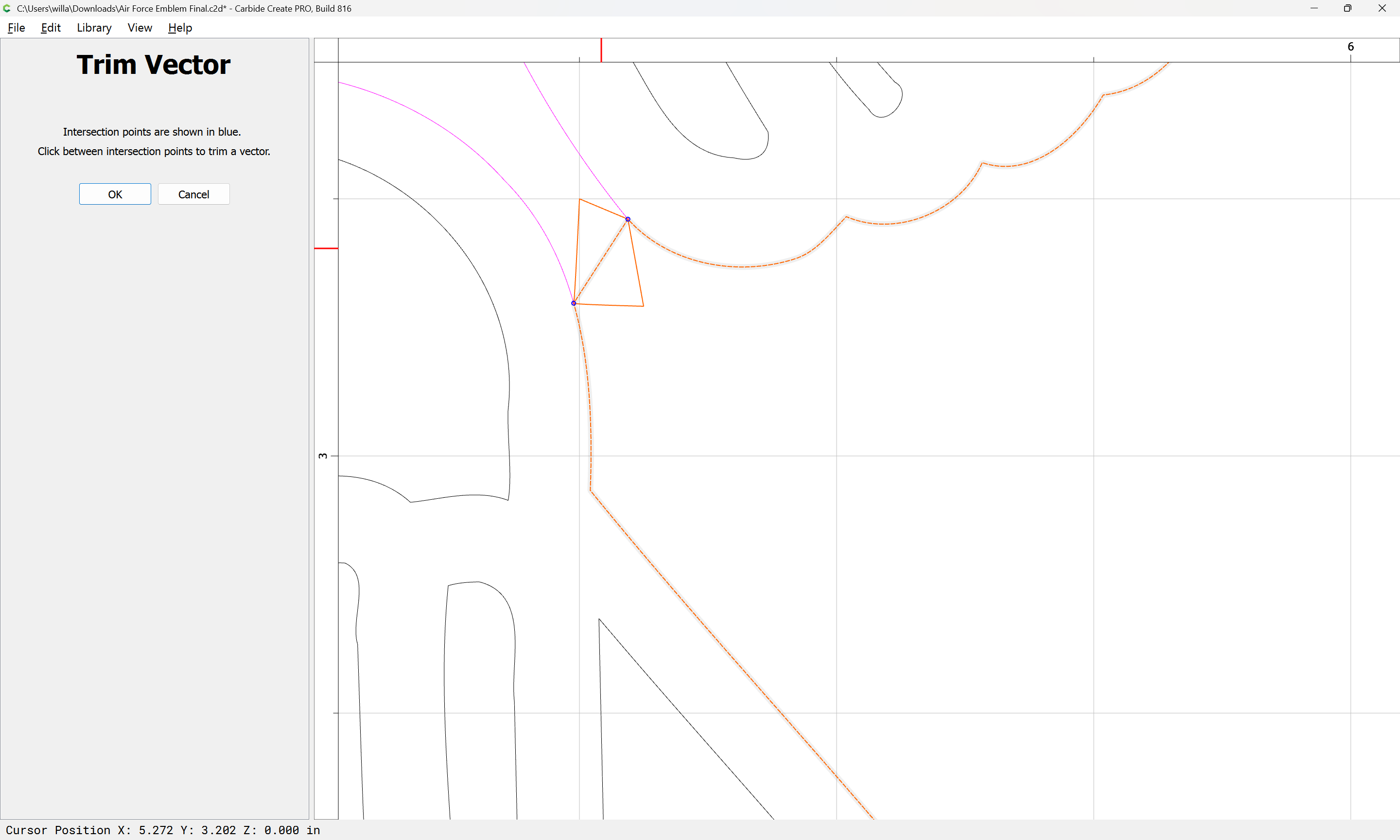

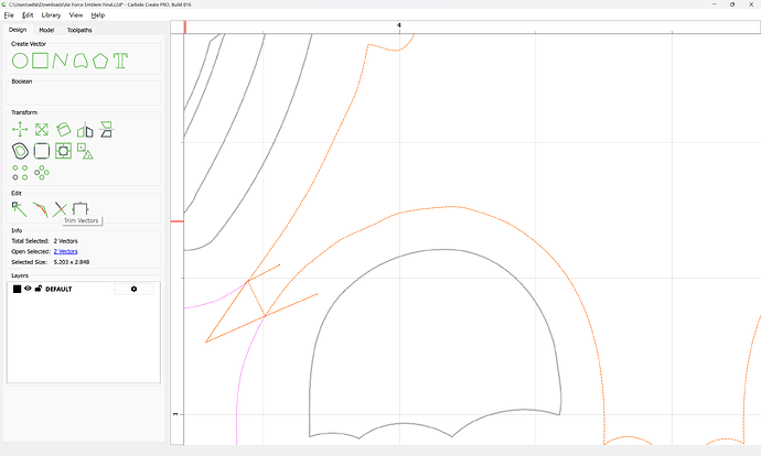

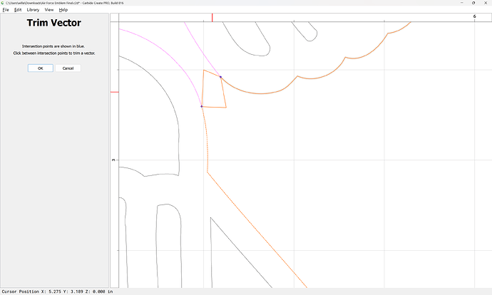

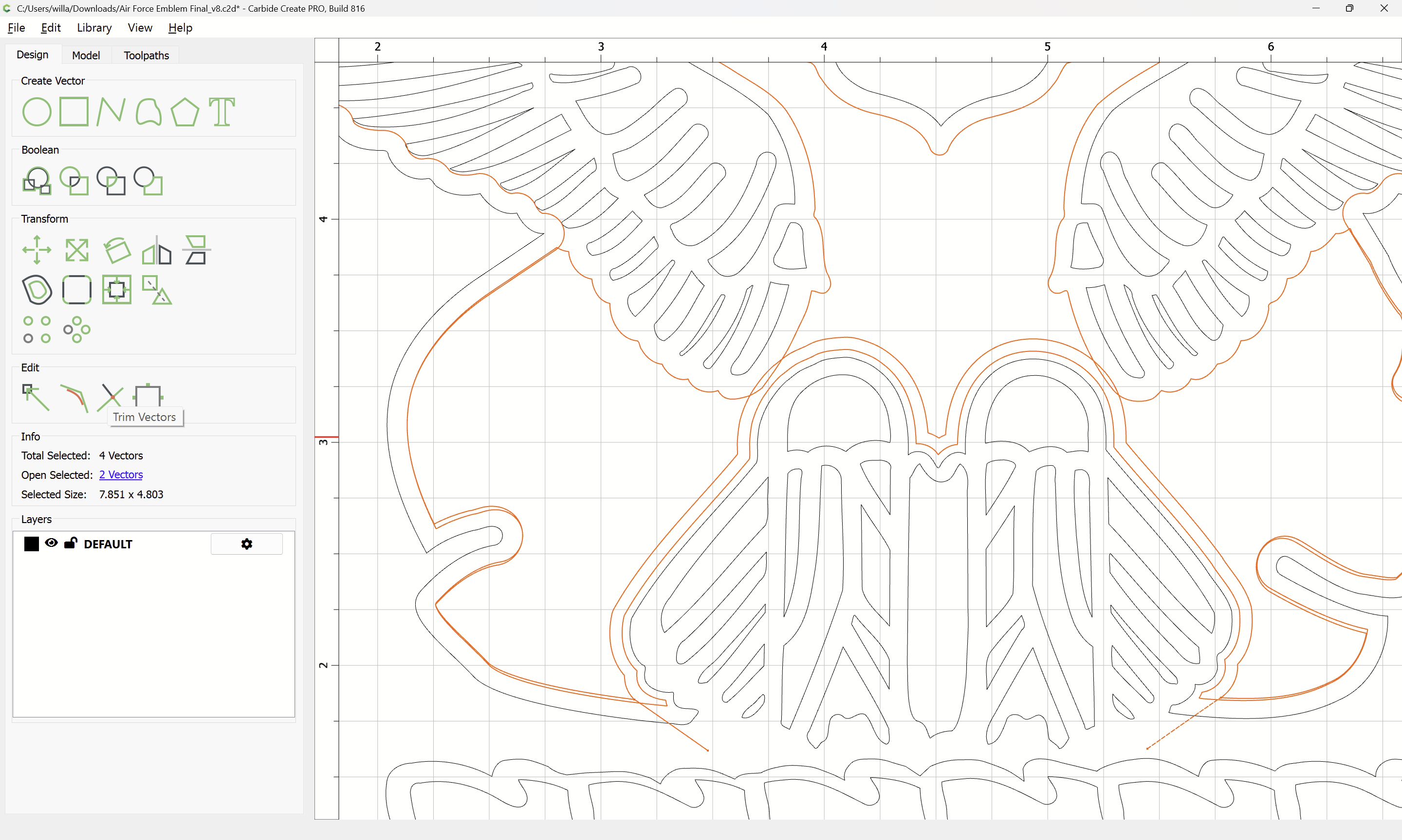

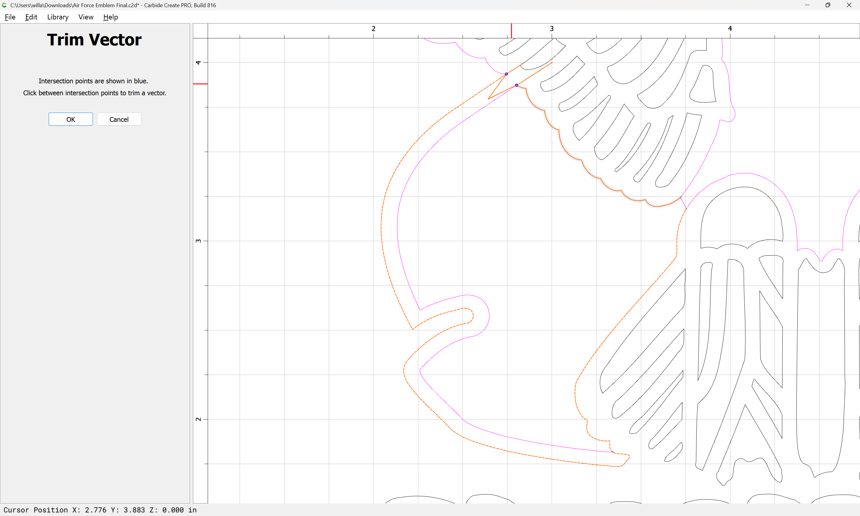

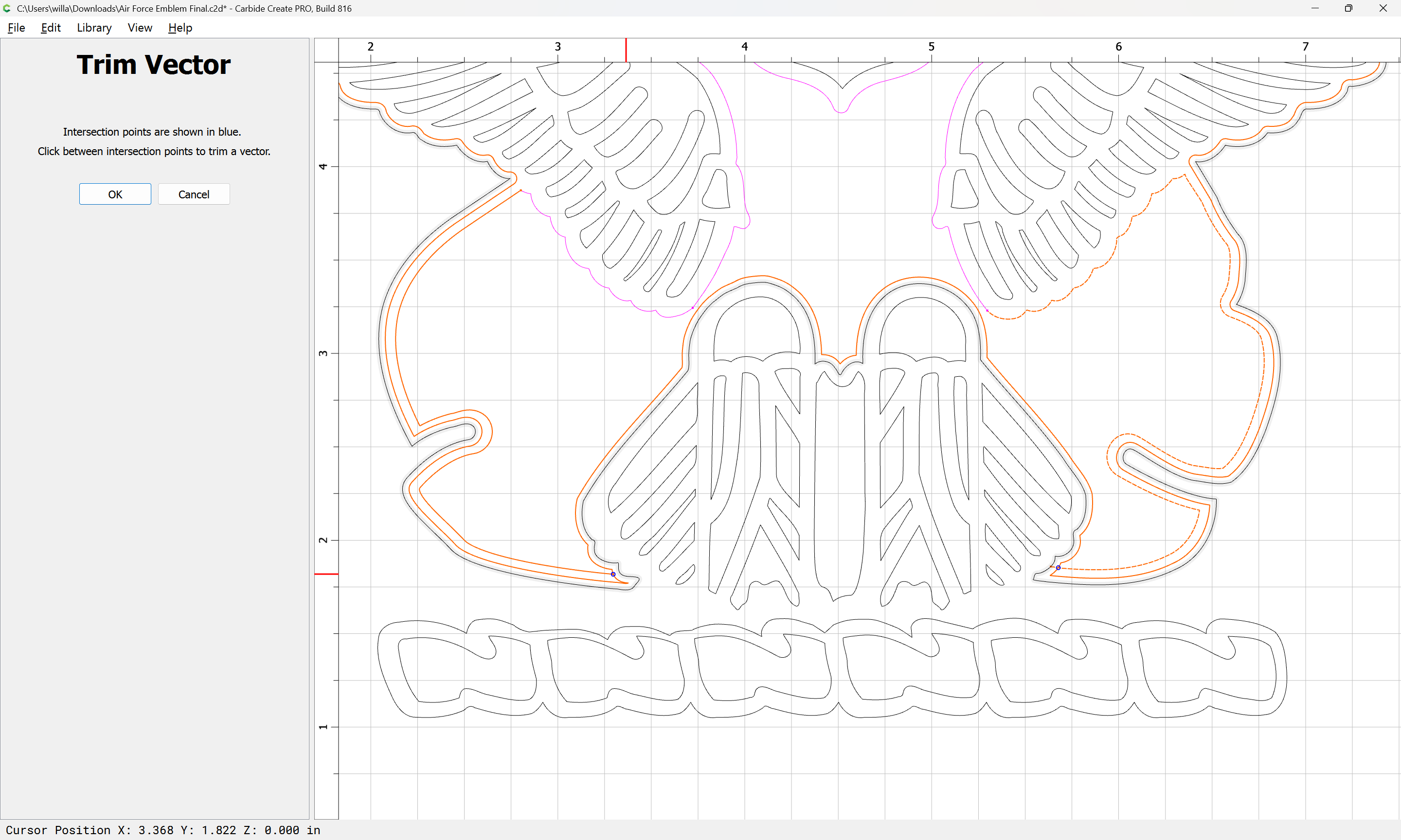

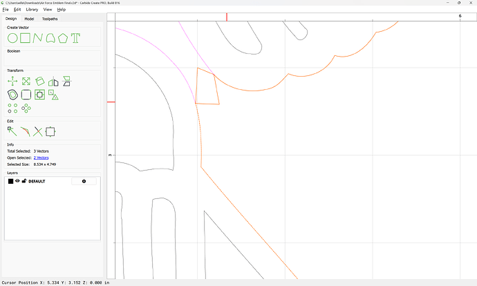

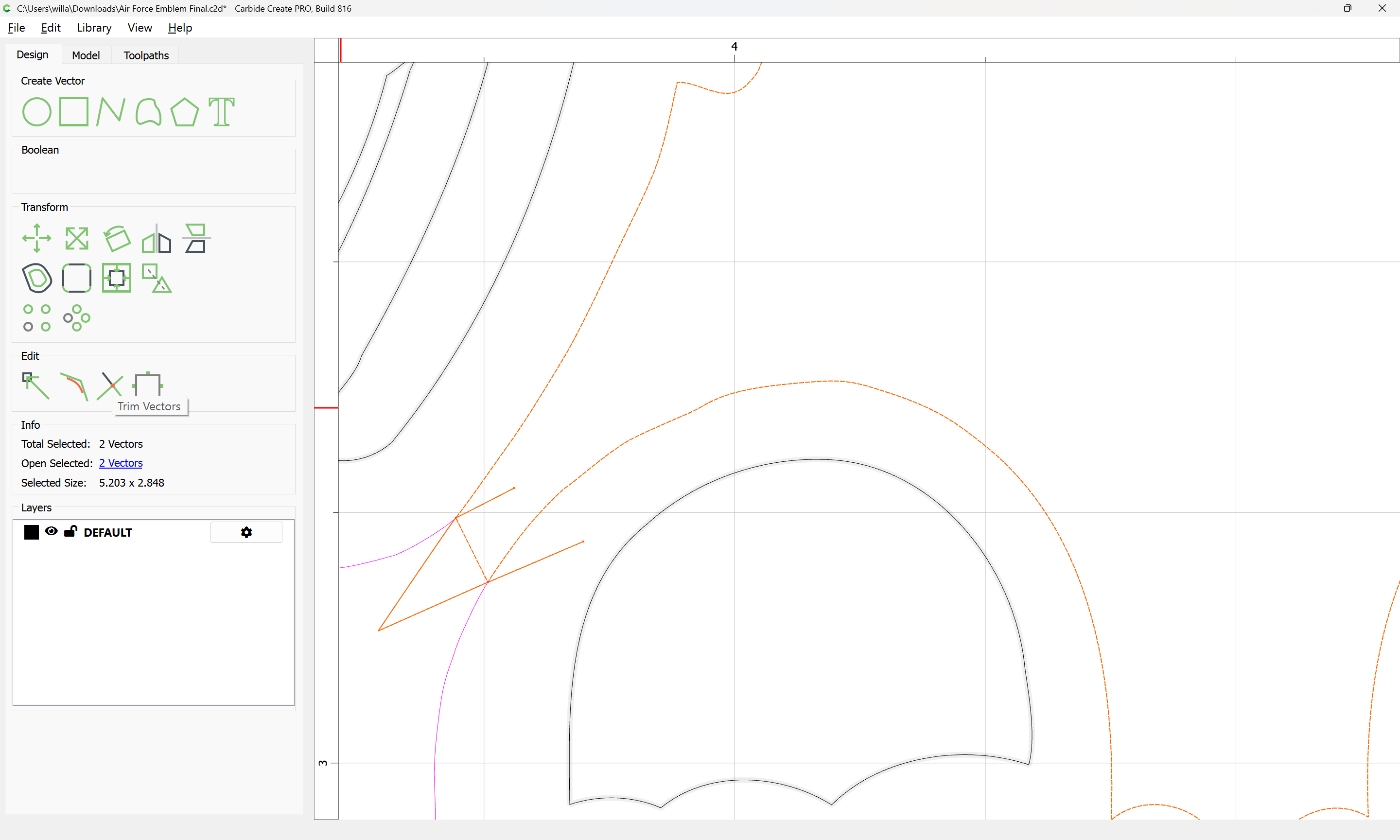

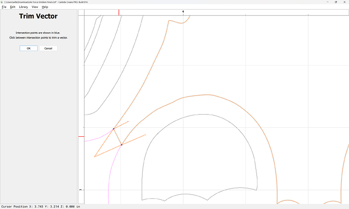

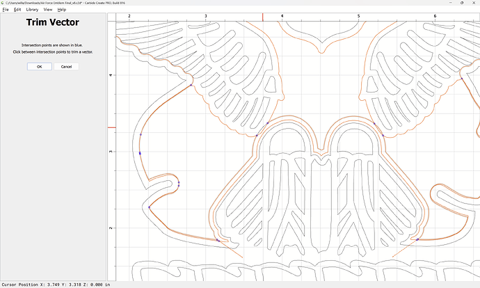

Draw in some geometry and use Trim Vectors:
to remove the section which precludes joining with the balance of the geometry:
then delete the added geometry:

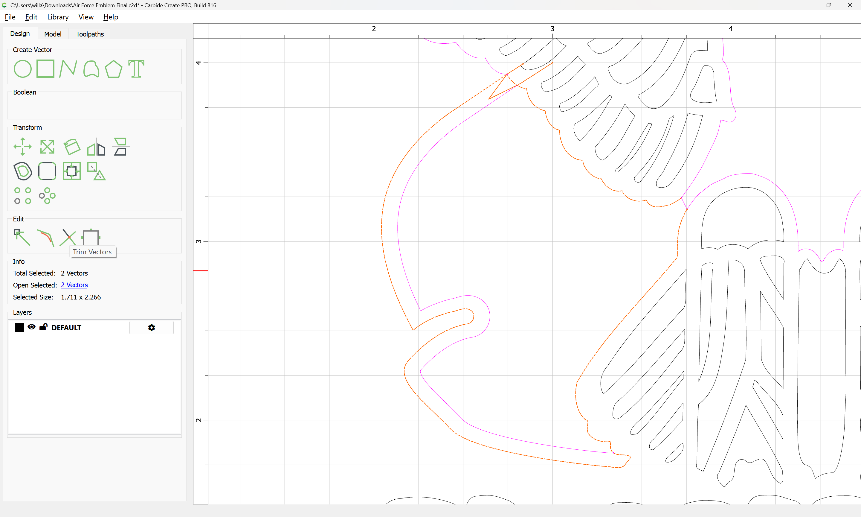

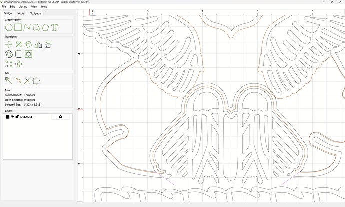

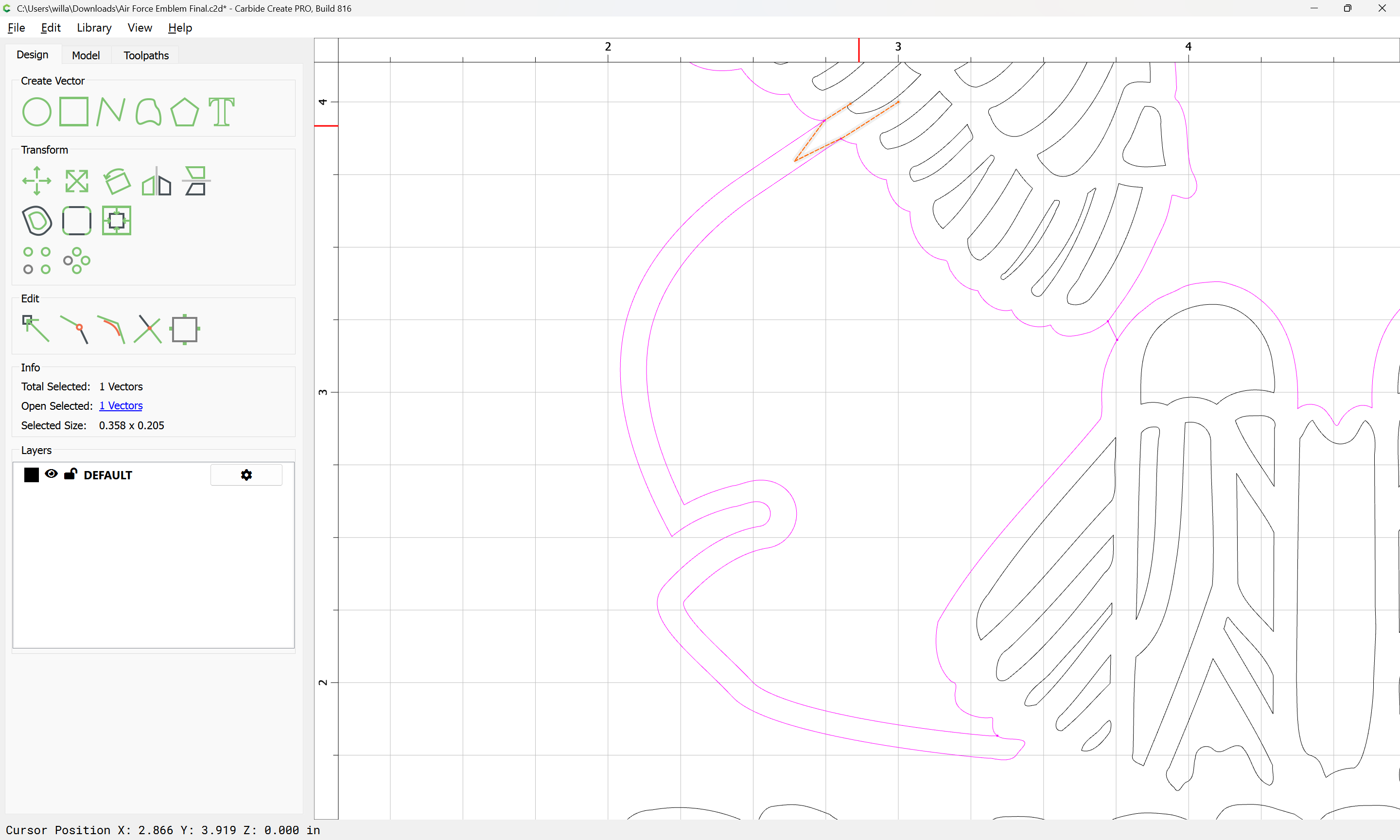

Repeat for the inner shape:
OK
delete

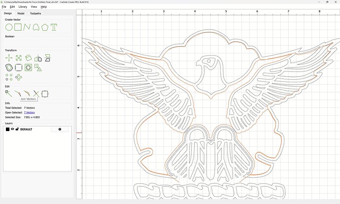

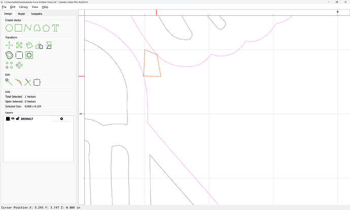

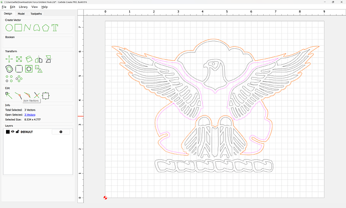

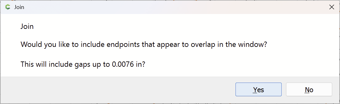

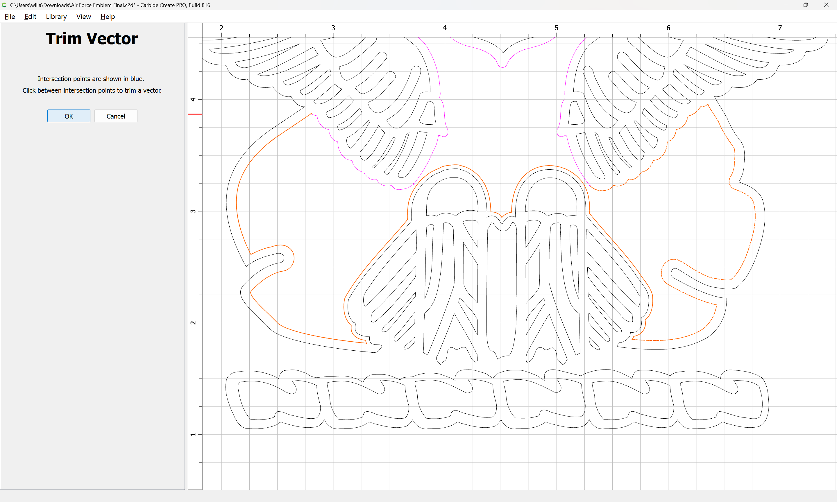

Once you have a continuous set of open vectors they may be selected:
and joined:

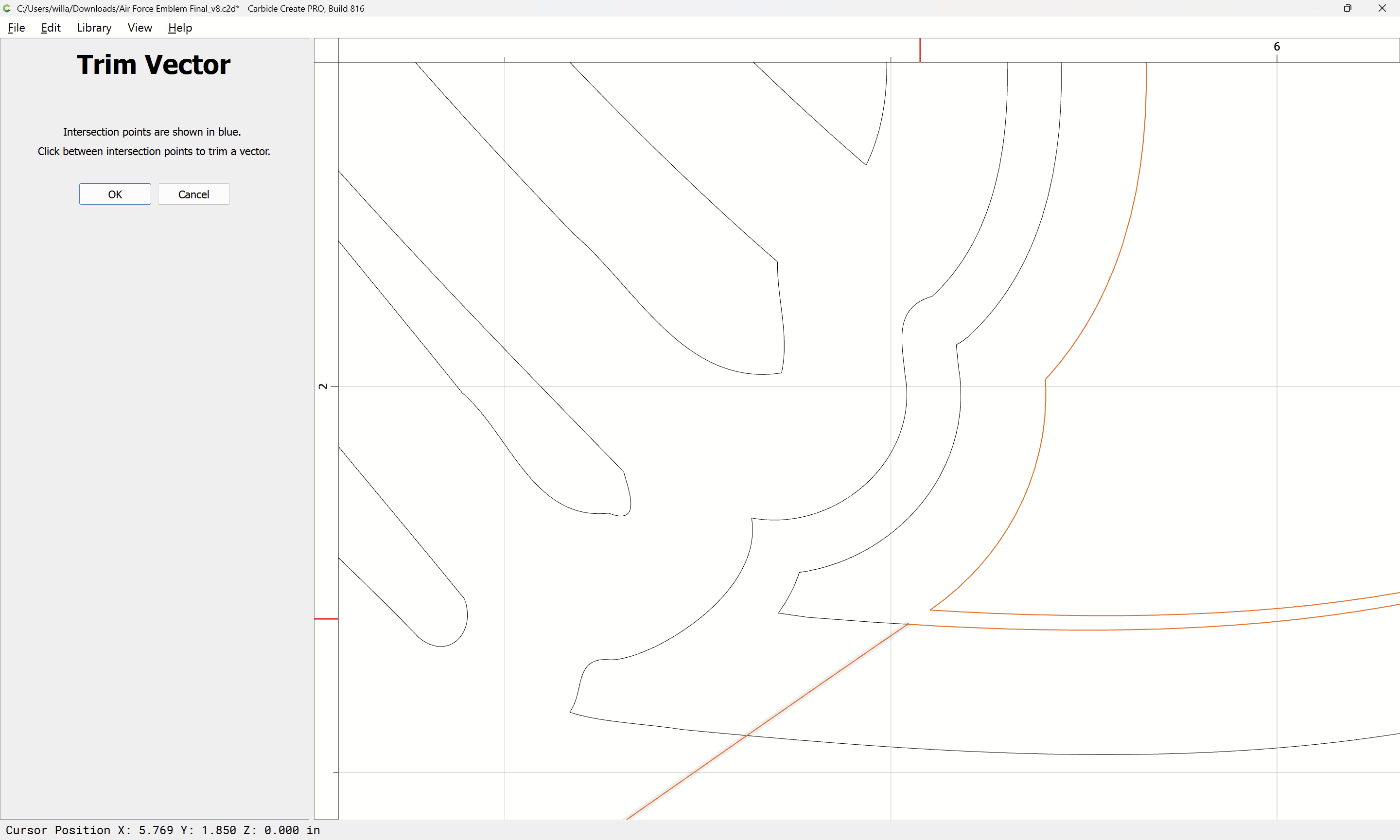

The balance of the geometry:

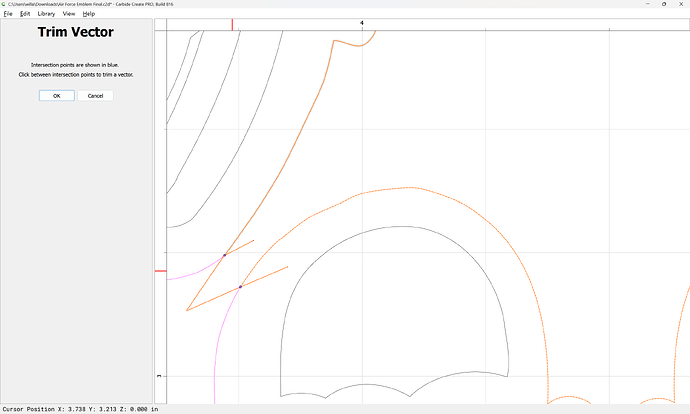

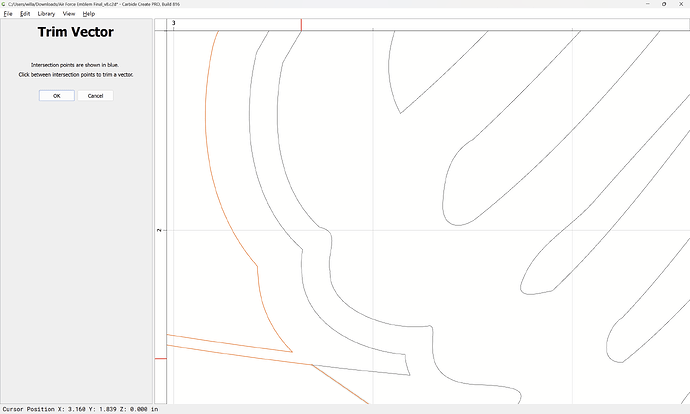

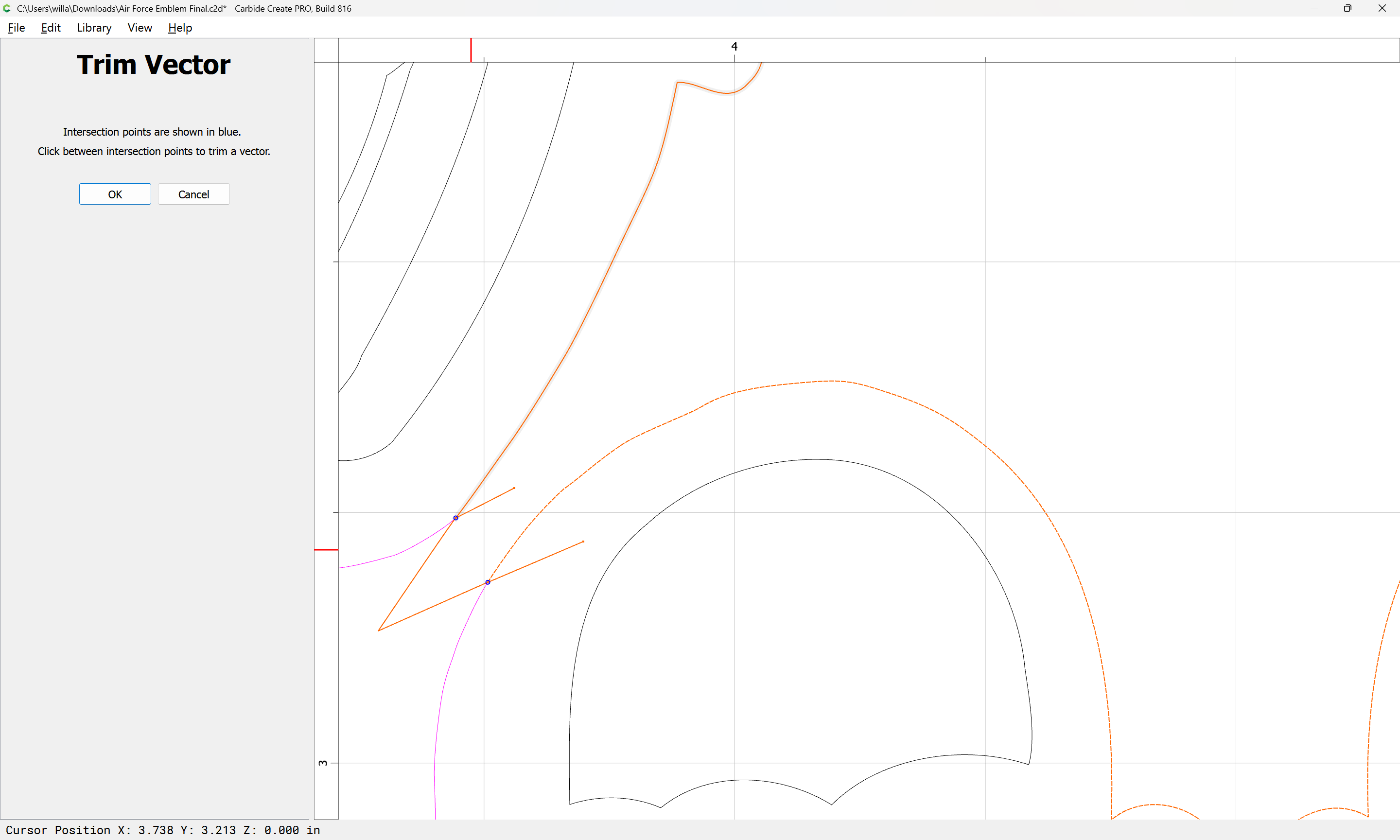

requires some additional offset geometry:

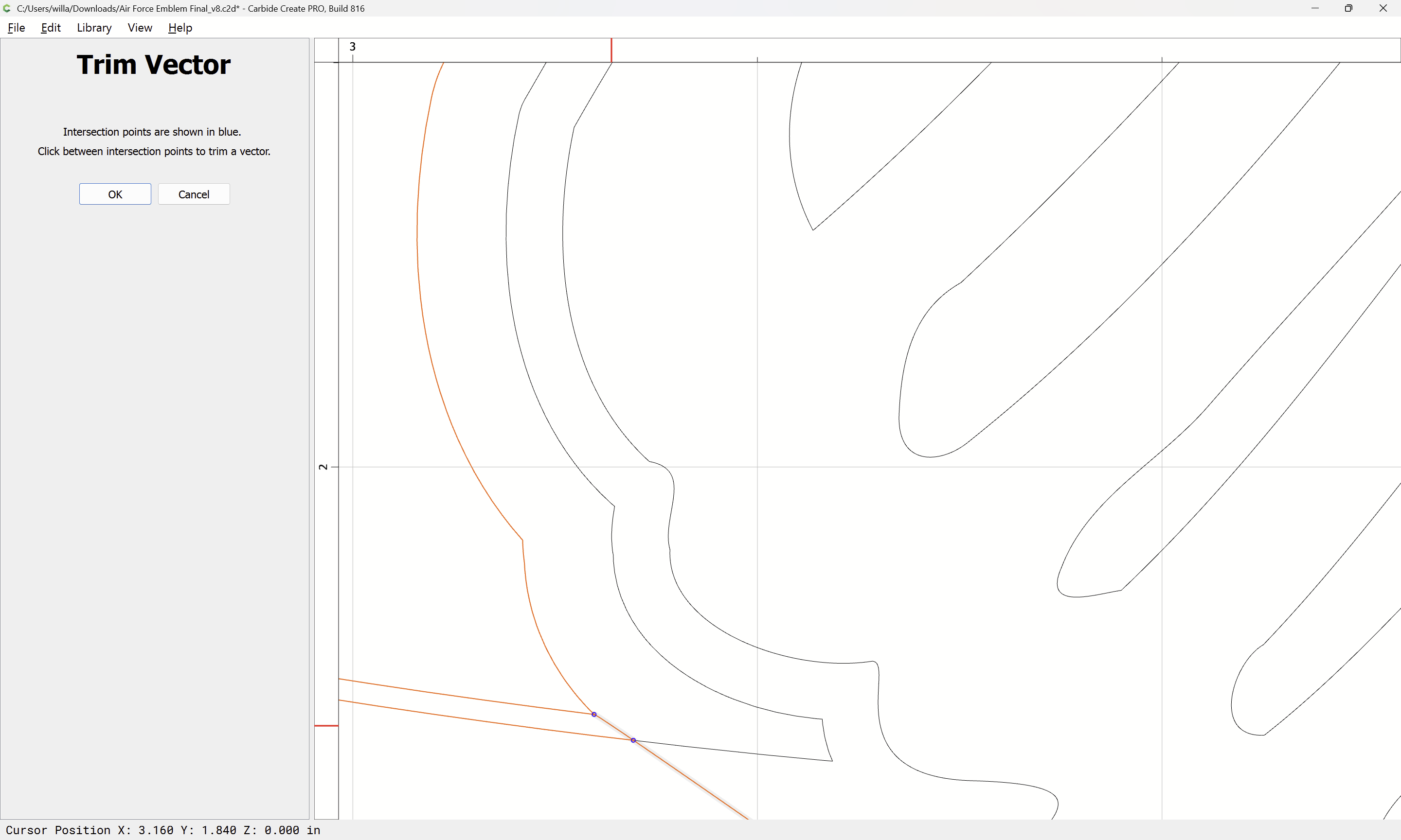

which may then be trimmed down to only what is needed:
until one arrives at:
OK
OK

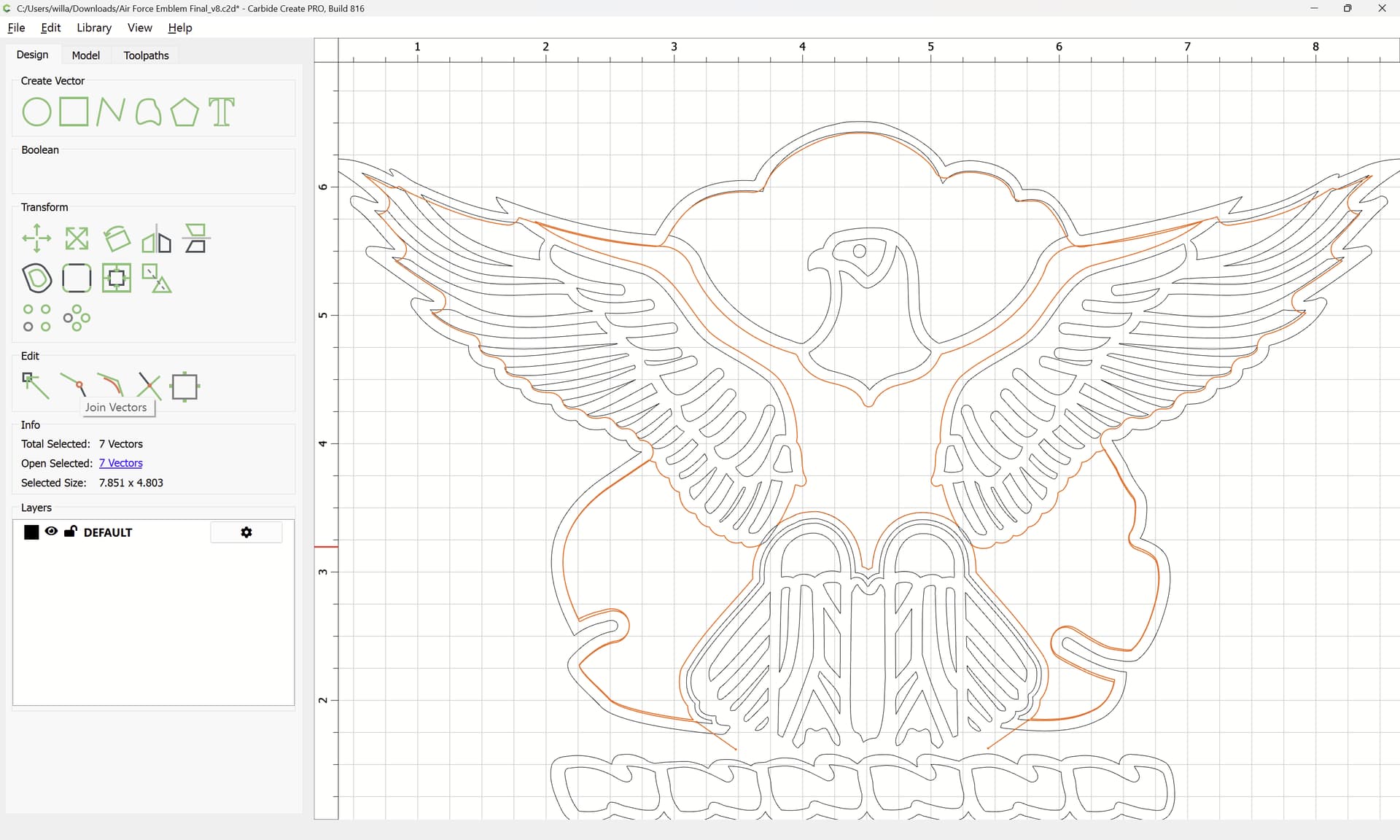

Select the balance of the geometry:
and use Join Vectors to close:
Yes

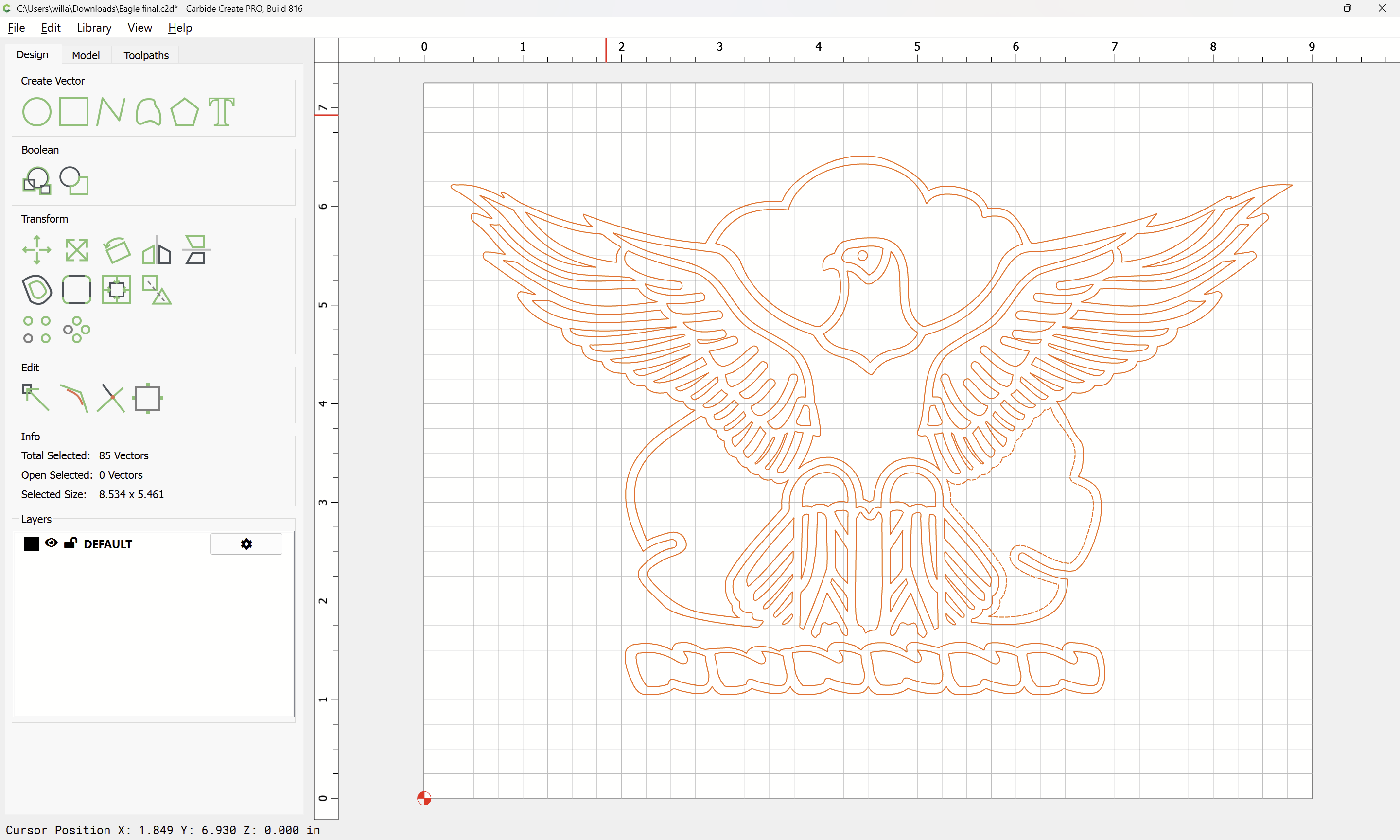

Attached as a v8 file.
Air Force Emblem Final_v8.c2d (3.4 MB)

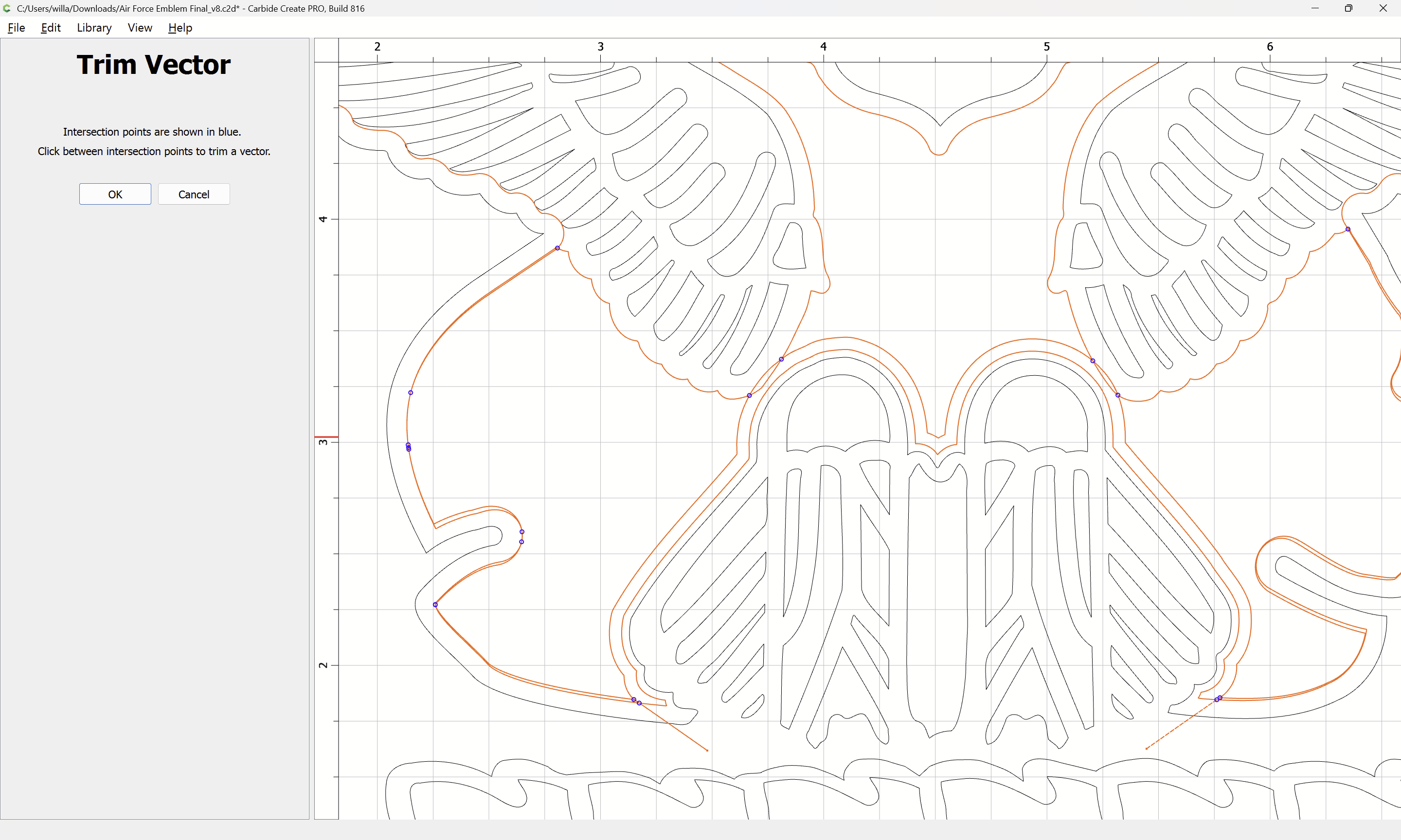

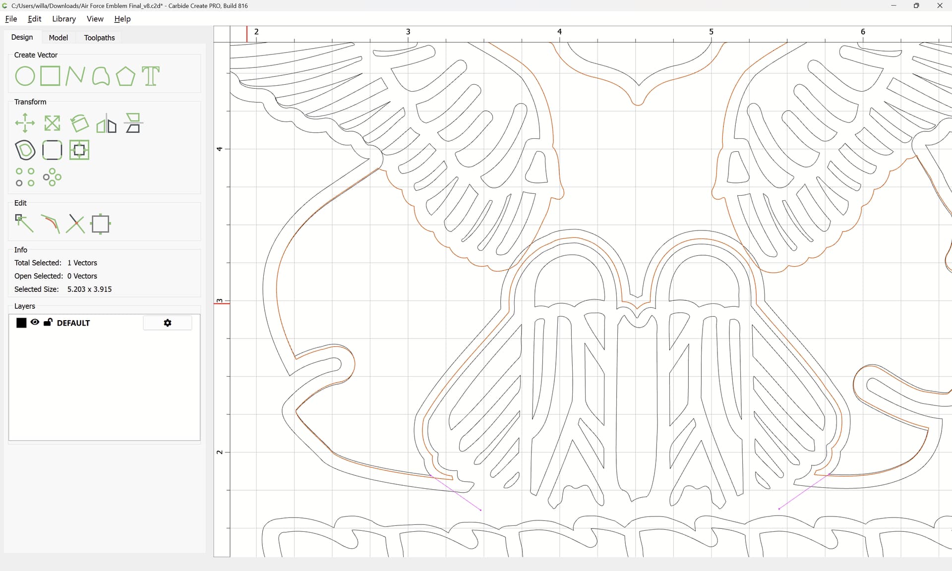

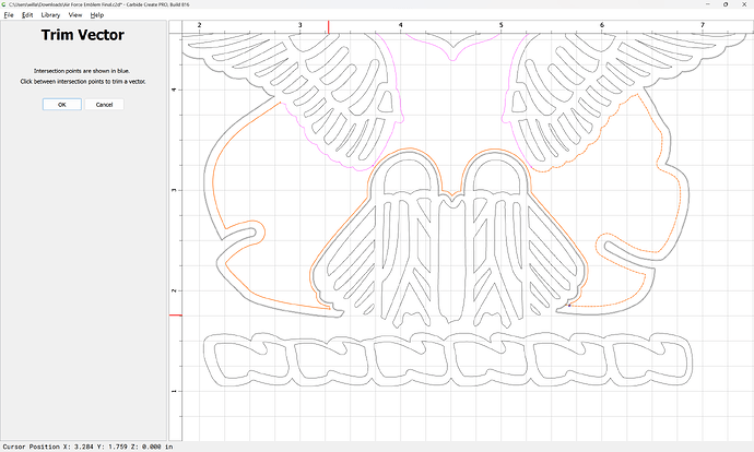

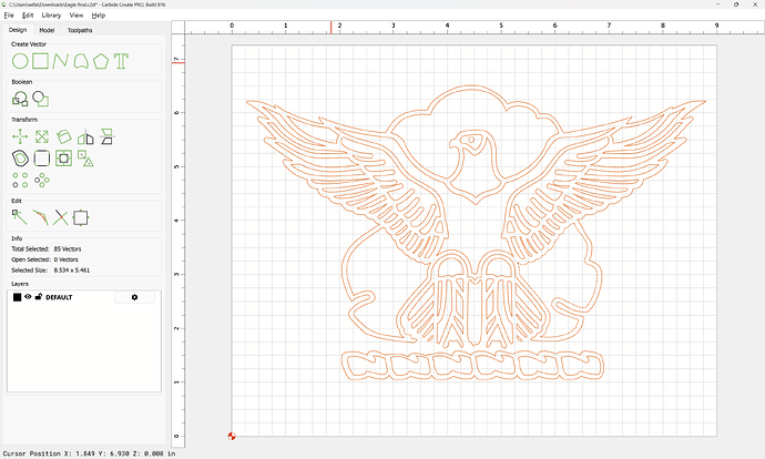

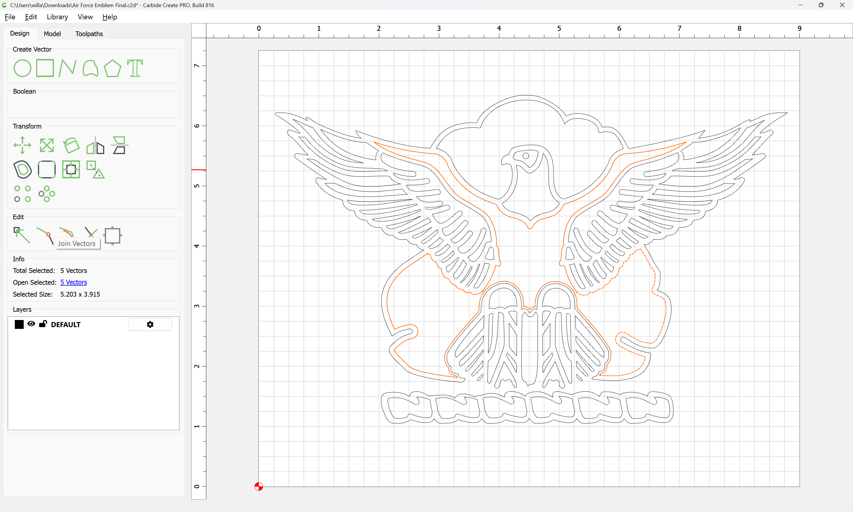

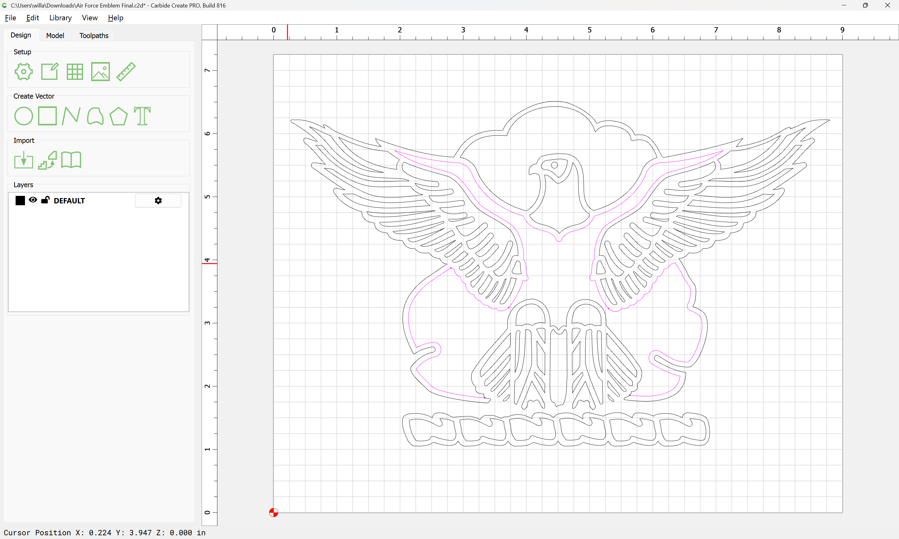

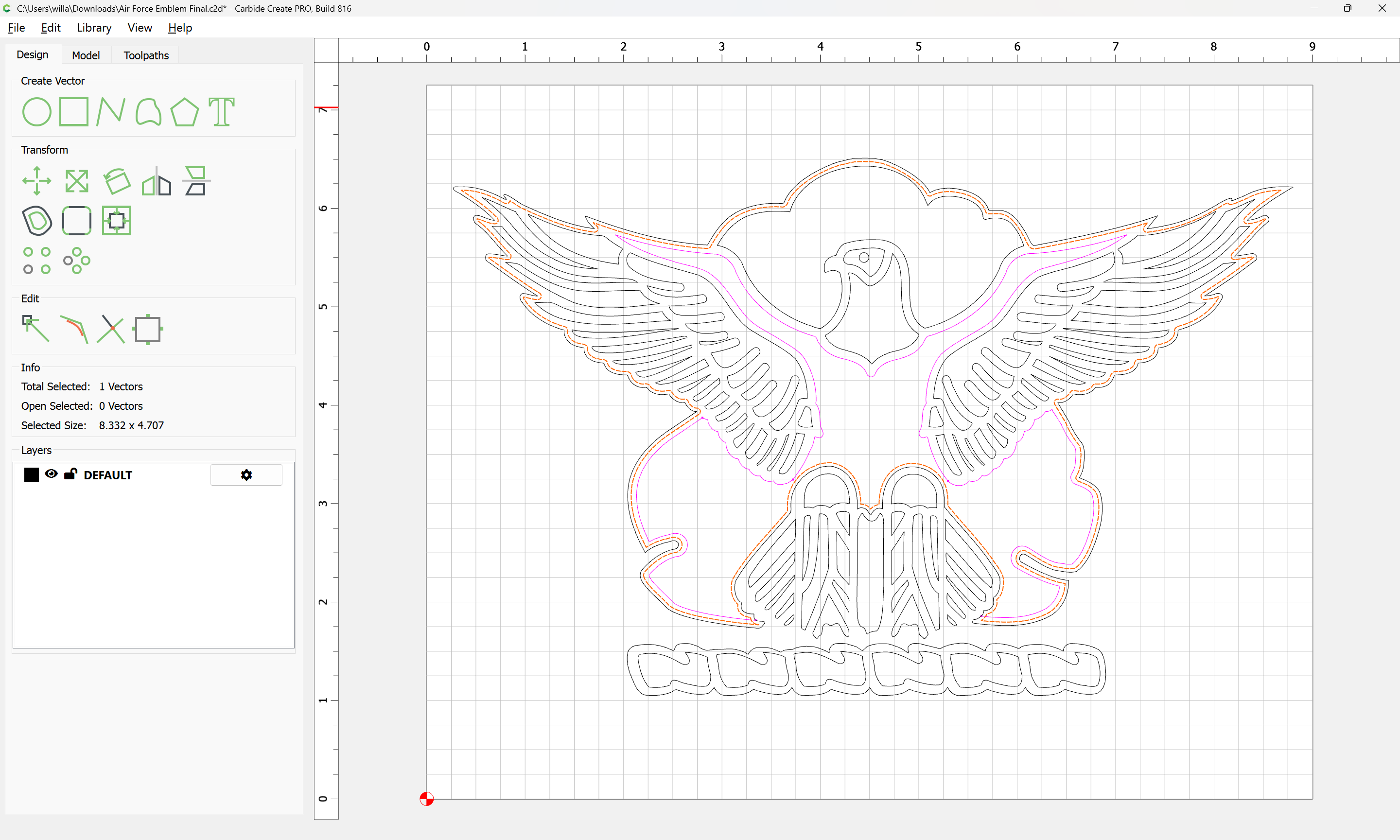

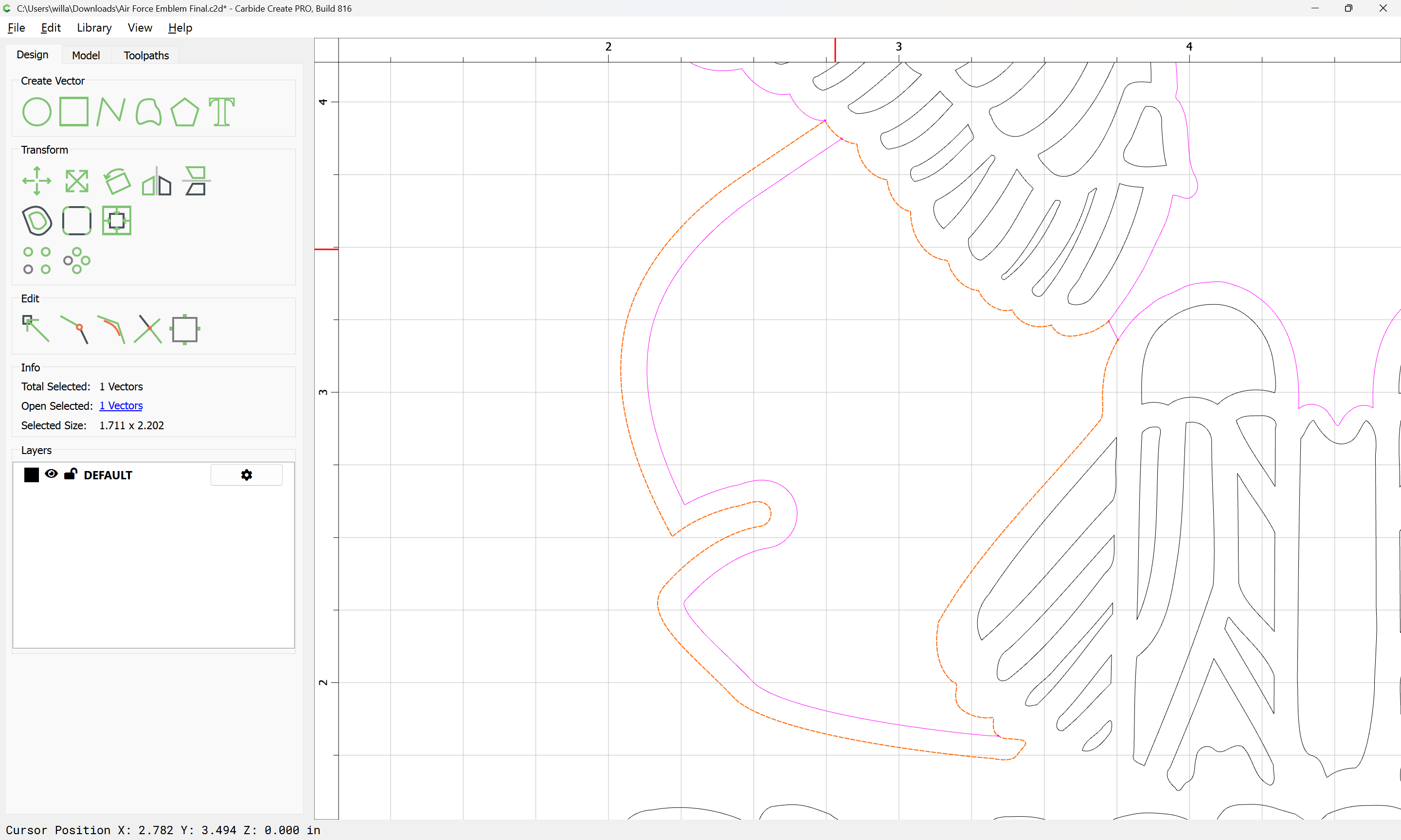

Hi William,

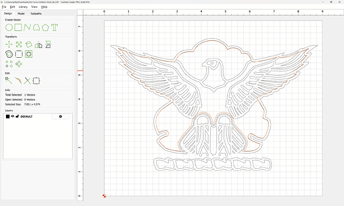

So it looks like I am making progress but still need additional help. I have attached a screenshot of the eagle along with the .c2d file. I am trying to enclose the bottom two areas (W) to be the same as the top area (W) but cannot get the vectors to close. I would also like the outline of the wings to close so I can create a toolpath for them. Can you help with that?
Thanks,
Kerry
Eagle instructions.pdf (174.2 KB)
Eagle final.c2d (300 KB)

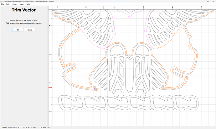

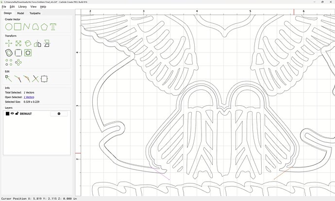

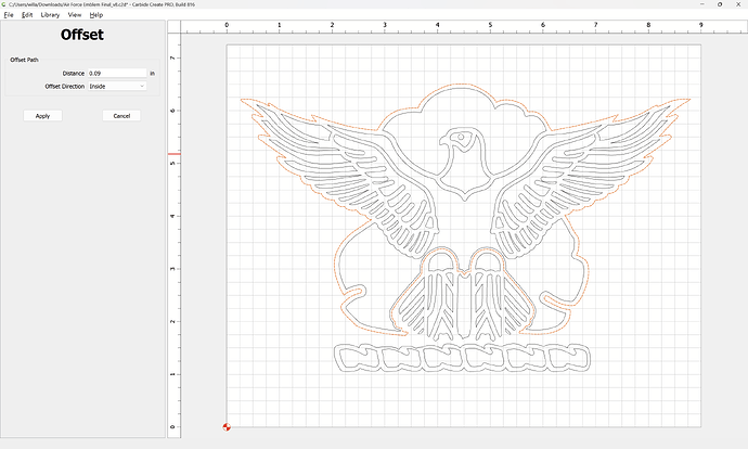

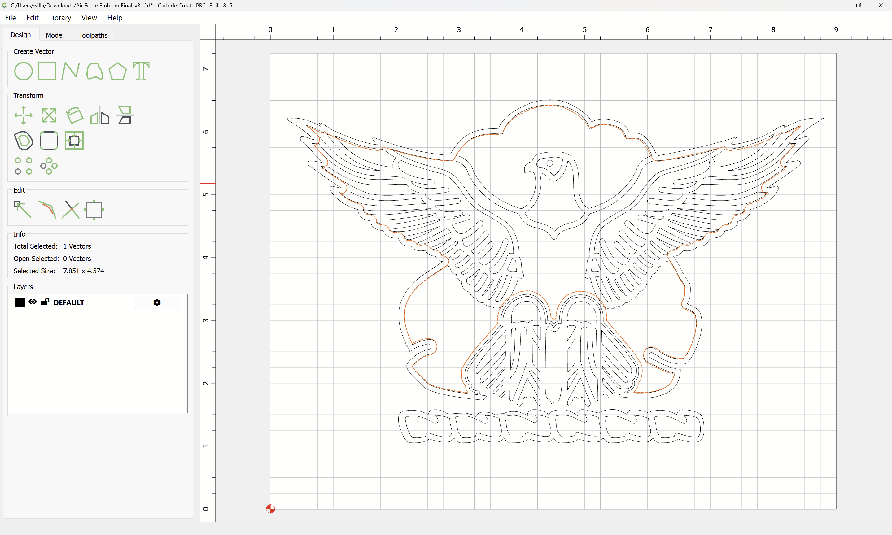

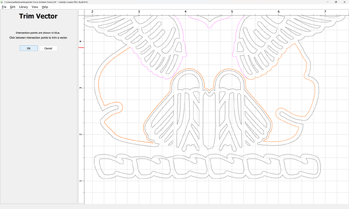

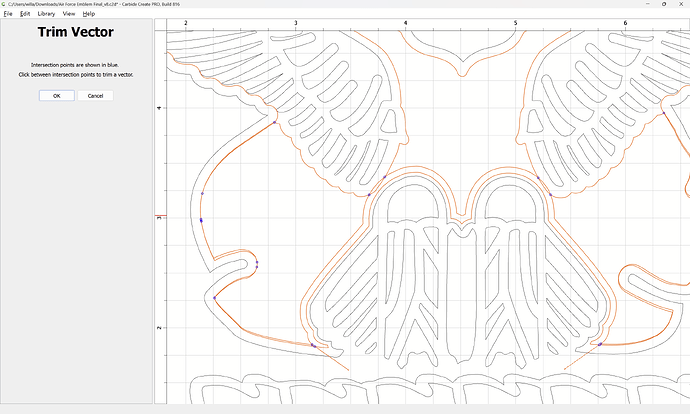

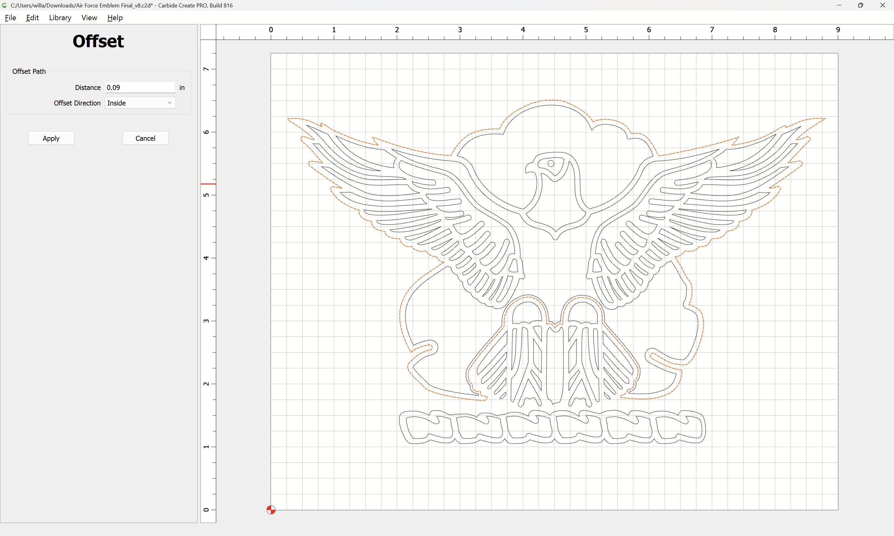

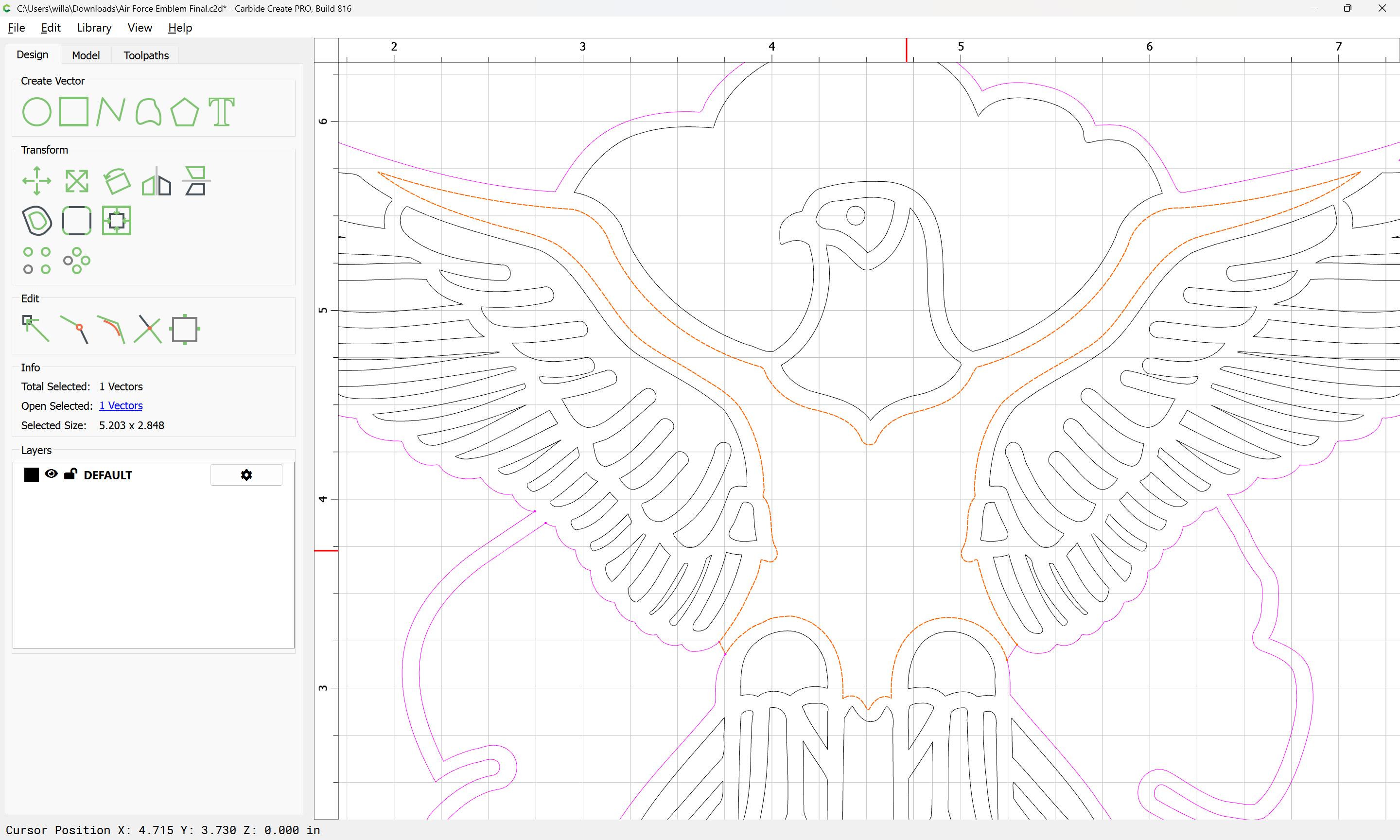

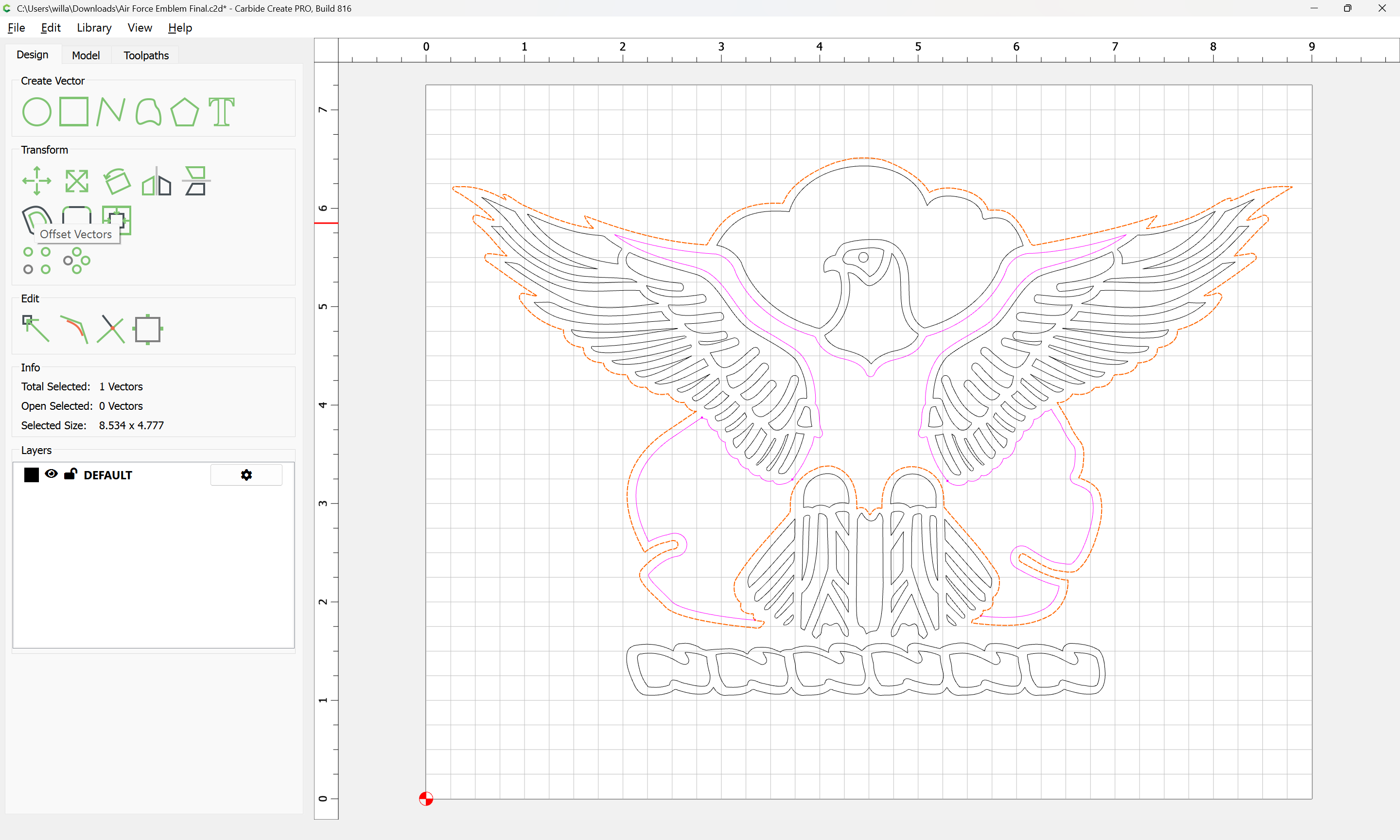

This can pretty much be done w/ the previous file which was made:

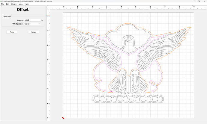

just offset to the inside by a suitable distance:
Apply

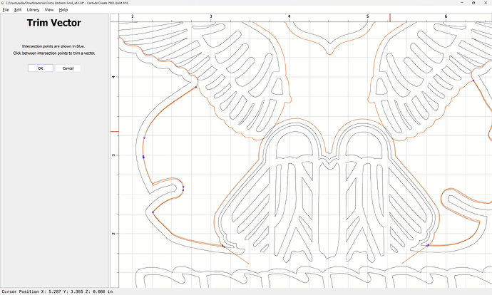

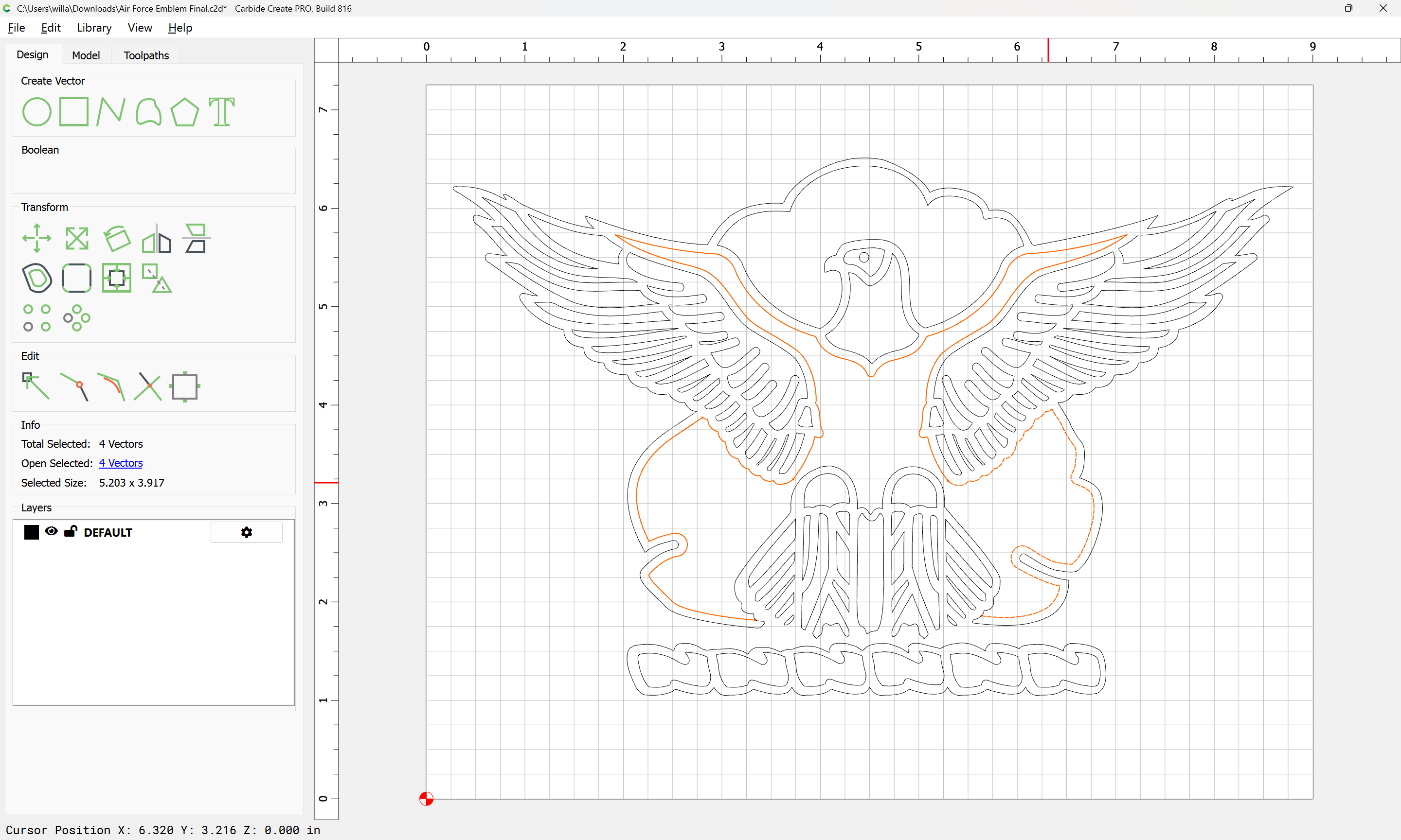

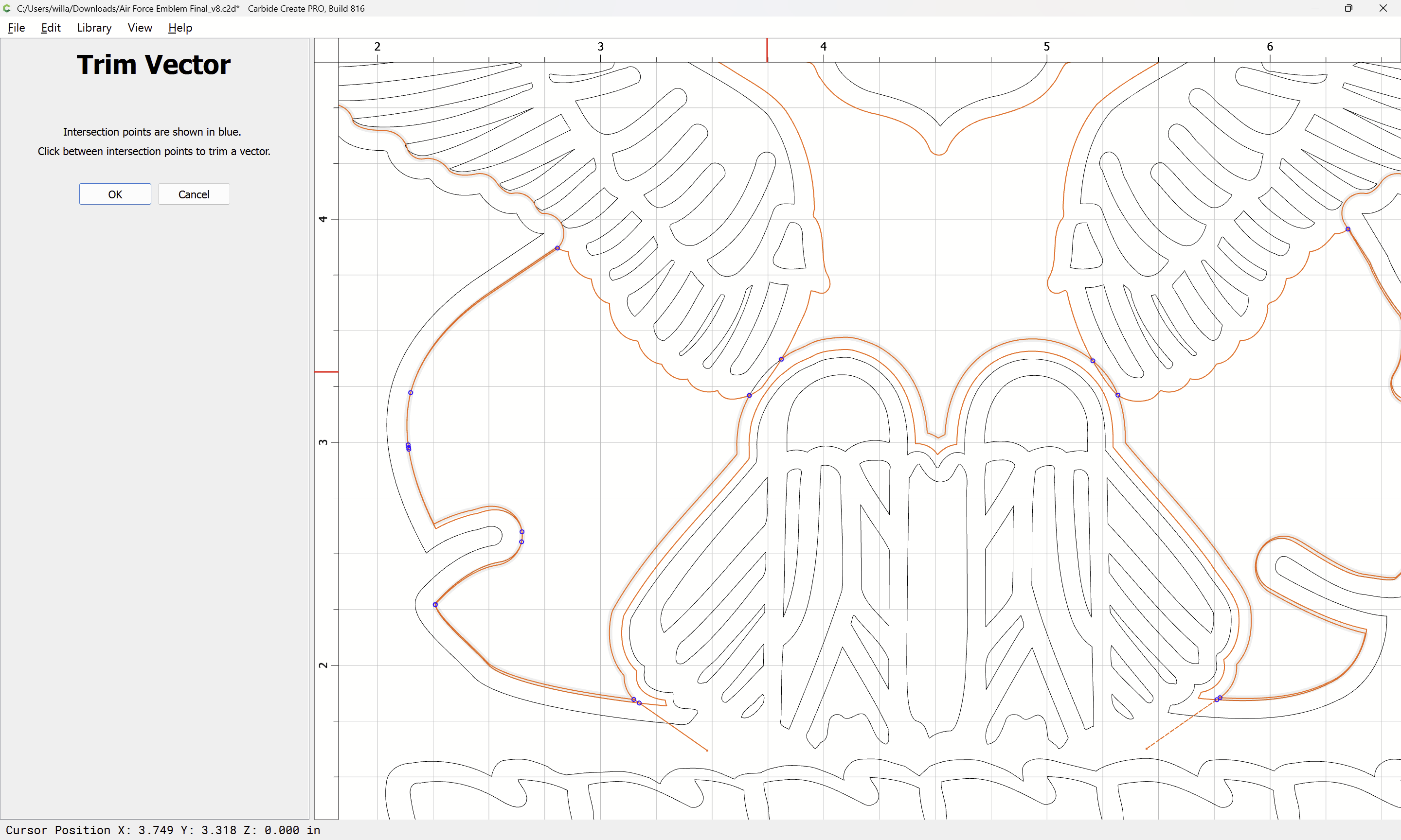

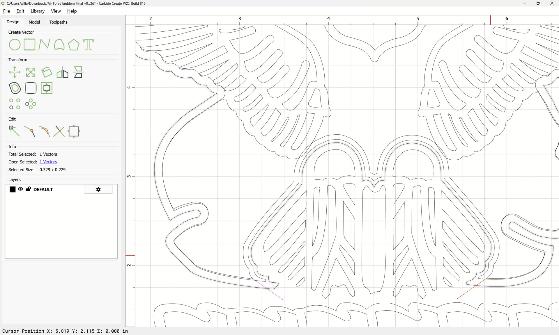

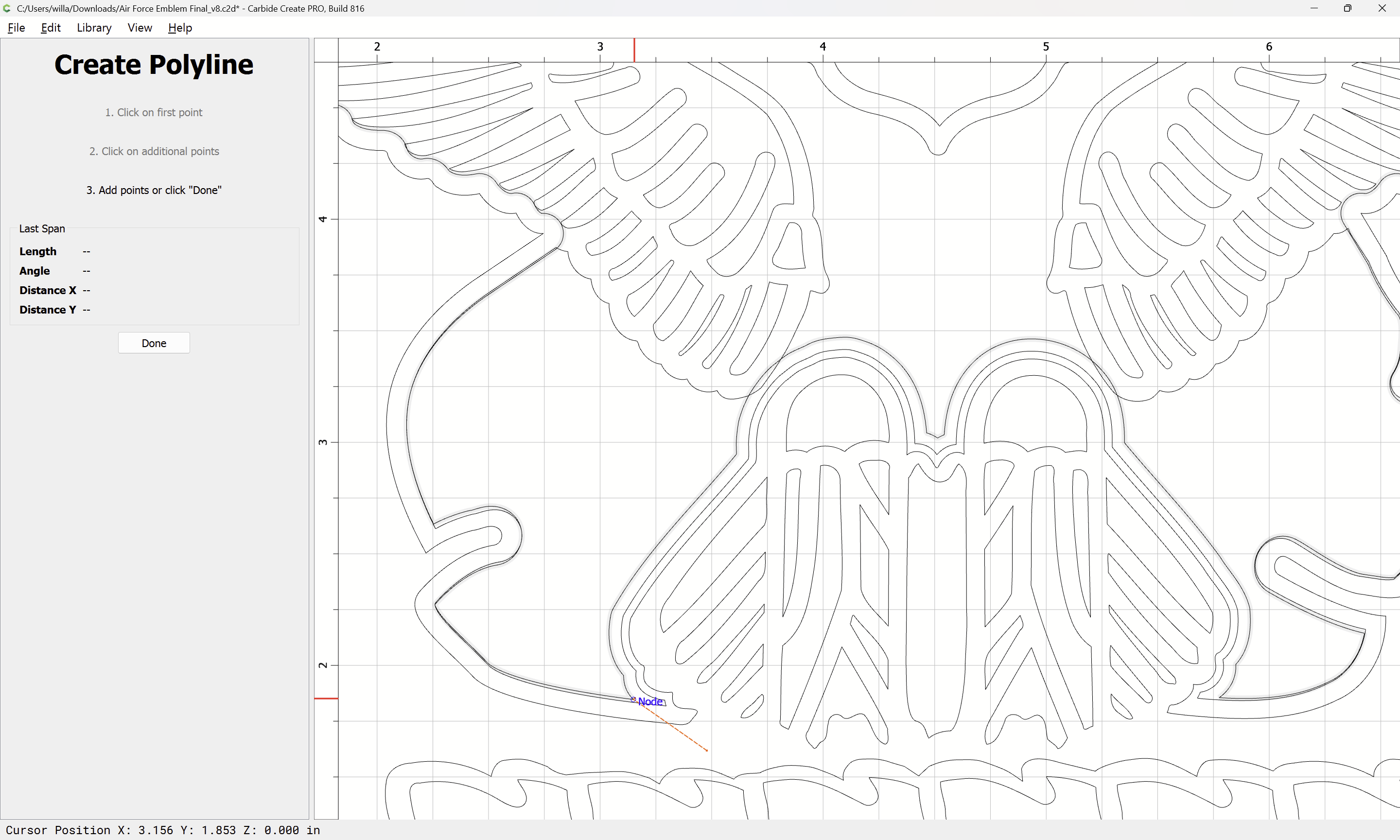

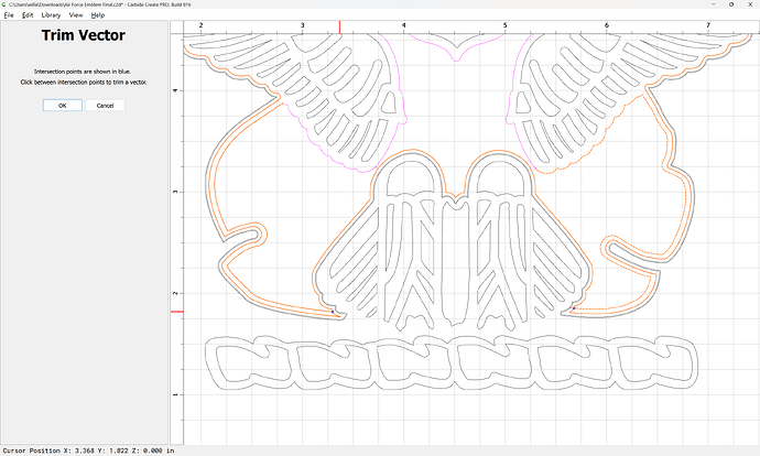

Then draw in crossing geometry where necessary:
Duplicate the relevant geometries:
Then select what one wishes to work with:

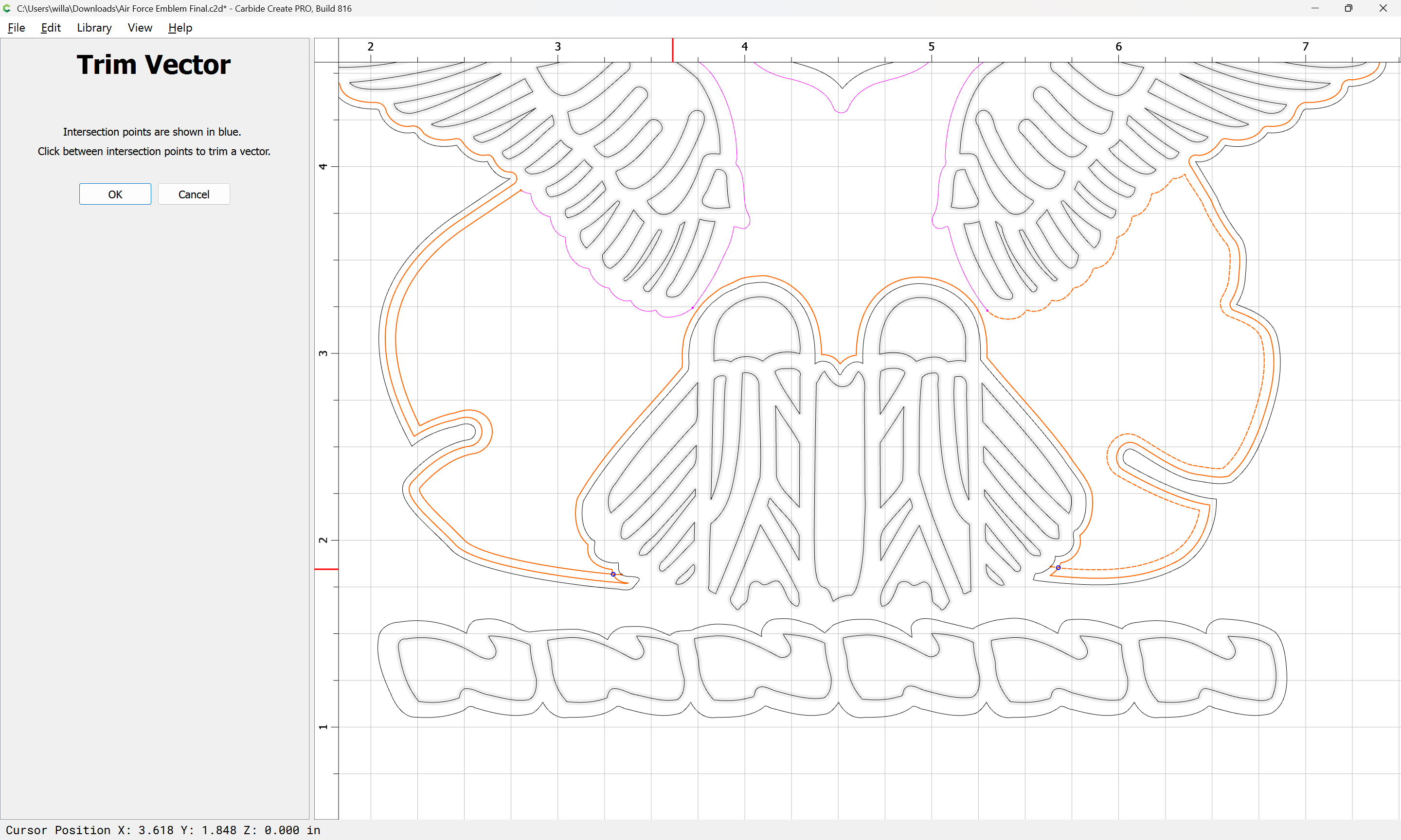

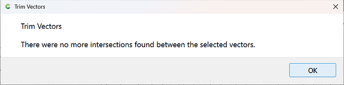

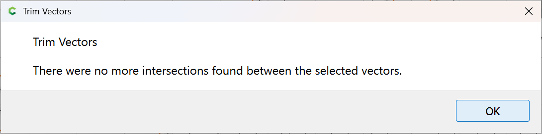

and use Trim Vectors to reduce down to what is wanted:

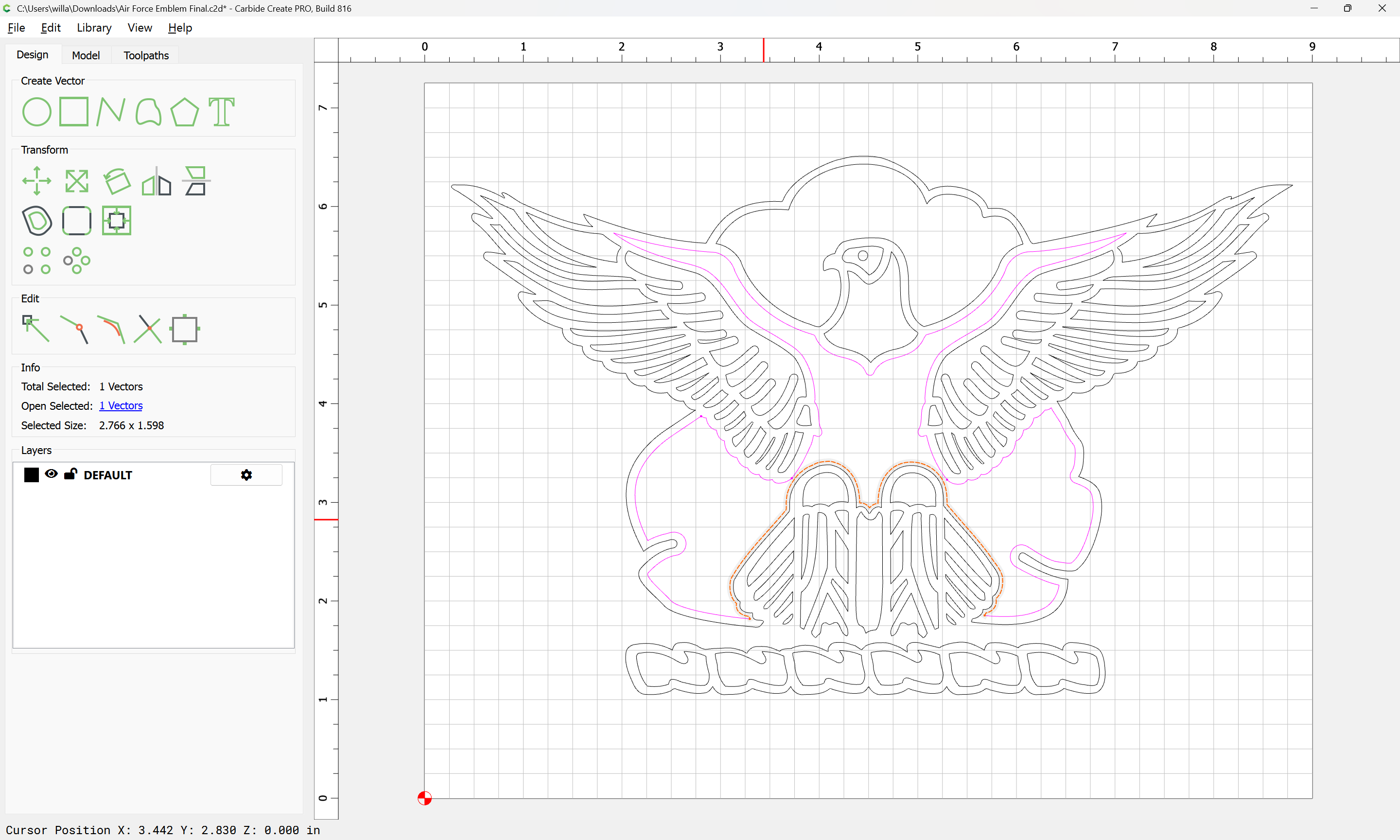

OK

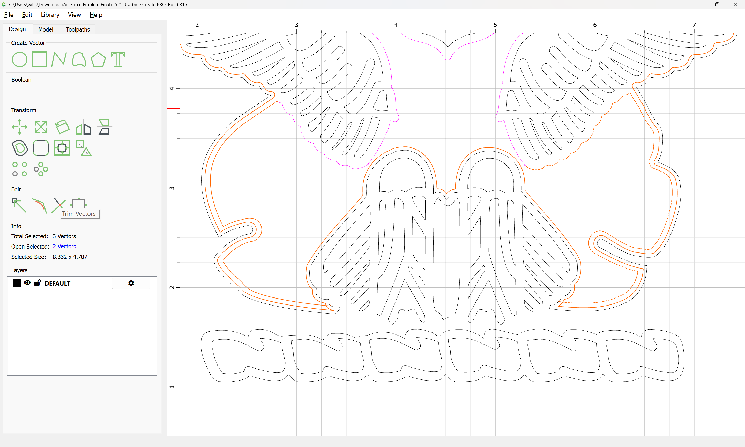

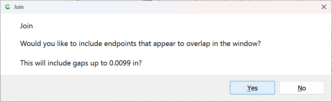

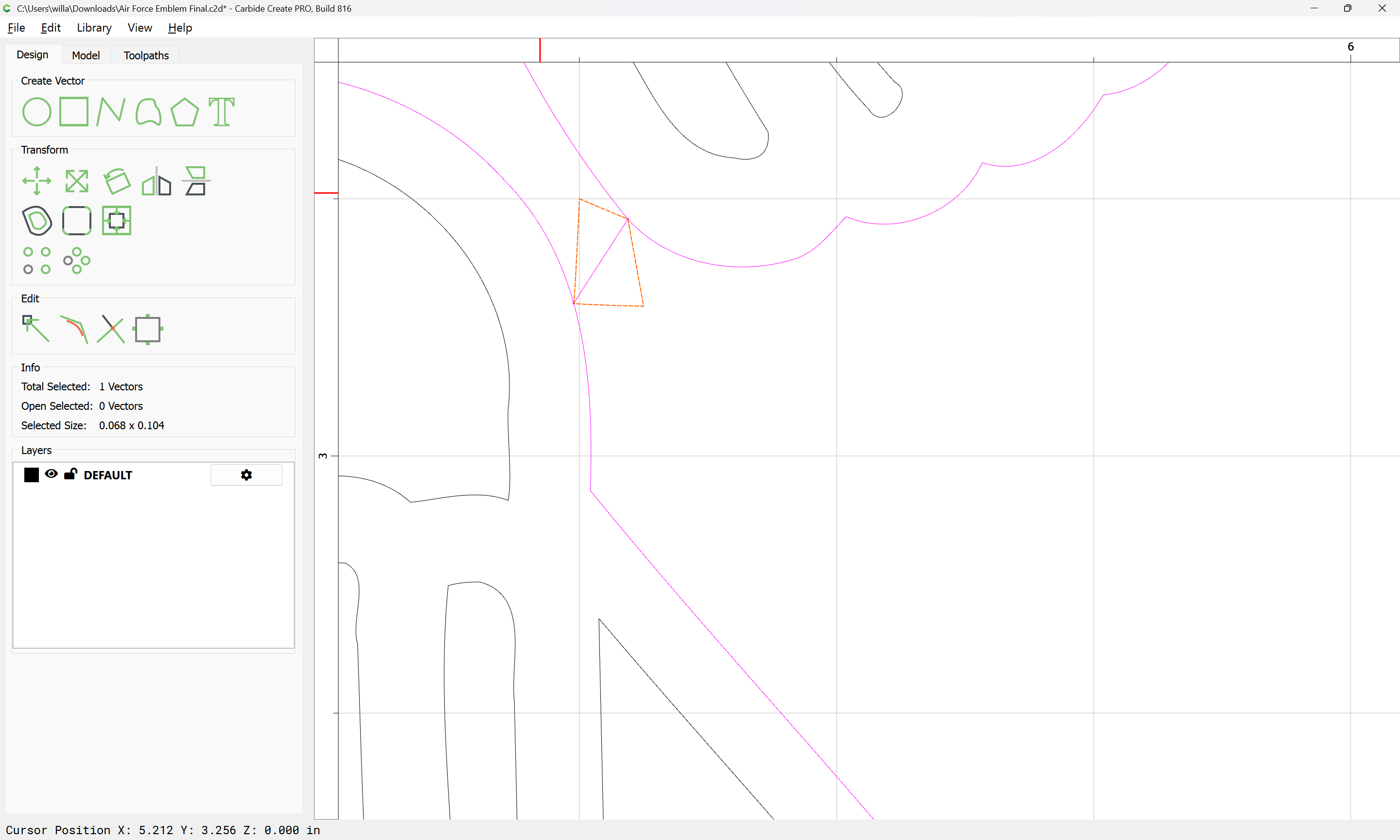

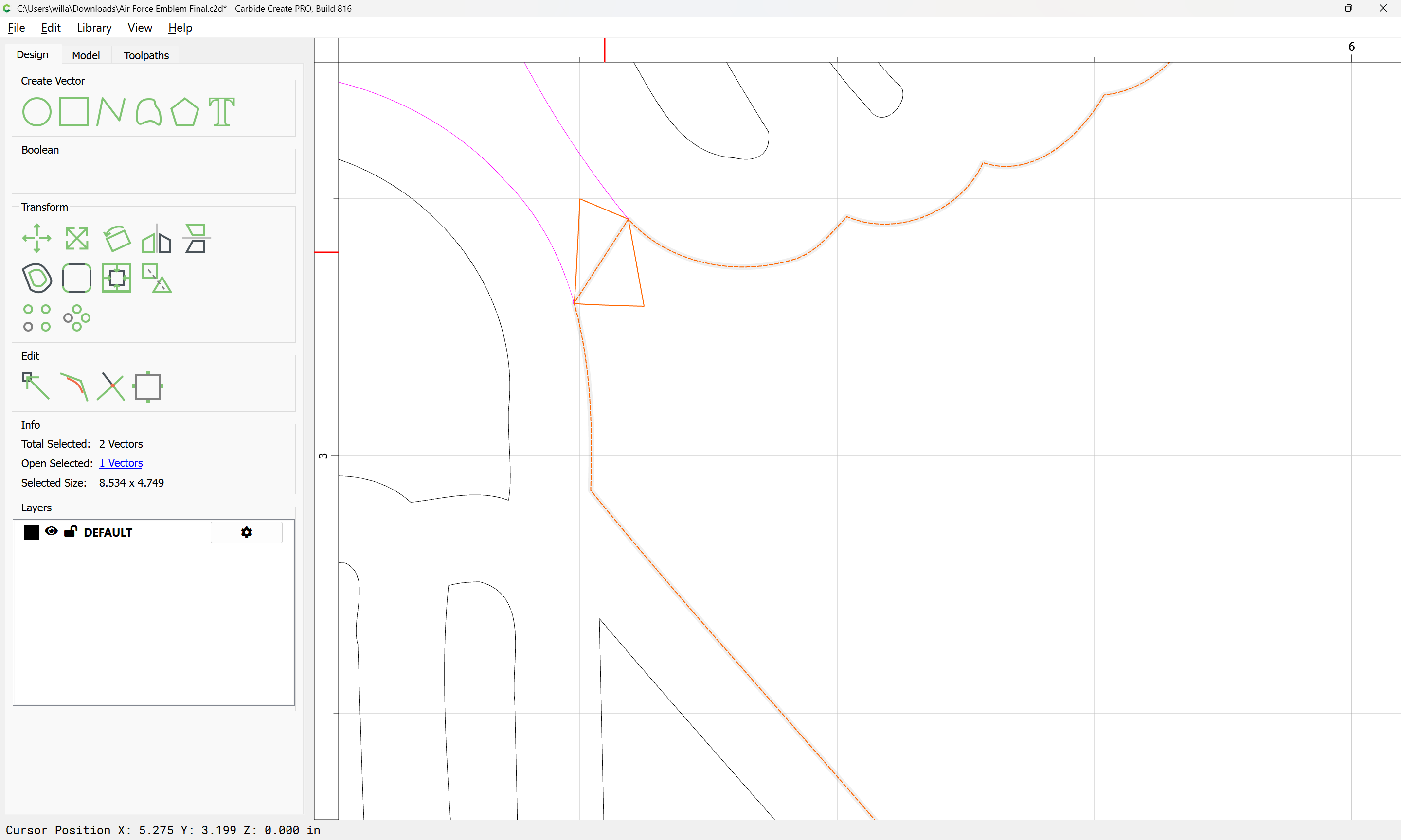

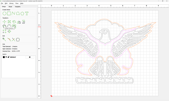

Use Join Vectors to close the new region:
Yes
Eventually, repeating the process as necessary for each separate region which one wishes until one arrives at something like to:
attached as a v8 file (again)
Eagle final_v8.c2d (256 KB)
