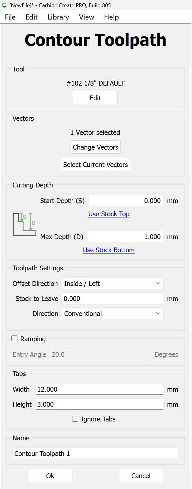

There is control over this if you have a Pro license:
Setting “Stock to Leave” and offsetting to one side or other will allow one to increase from the radius.

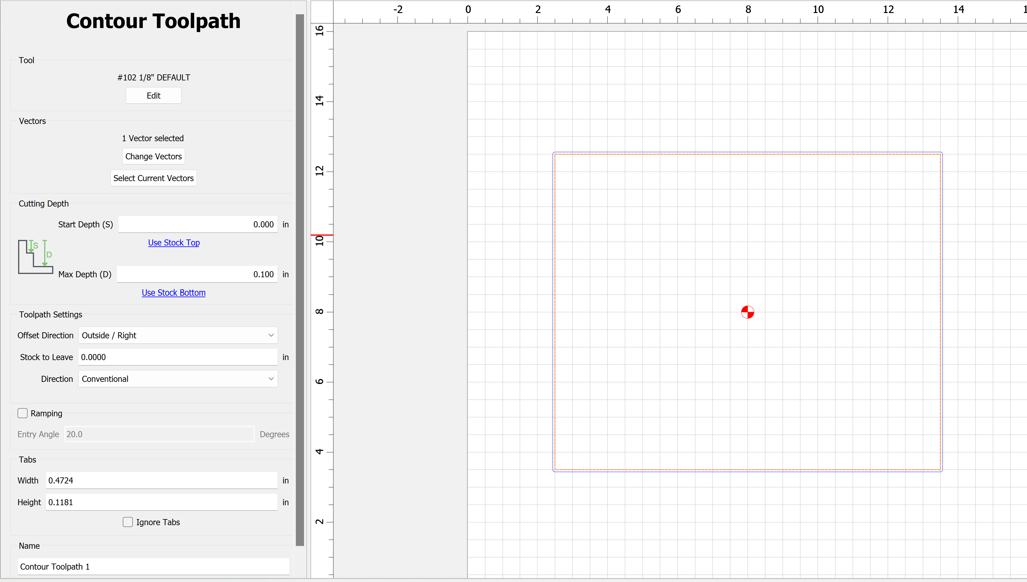

With the free license and you pick outside contour with a 1/4" bit then you will cut down the outside of the line. If you pick inside then the bit will run on the inside of a line. If you pick no offset with a 1/4" bit then the bit will travel down the center line and carve 1/8" on each side of the line.

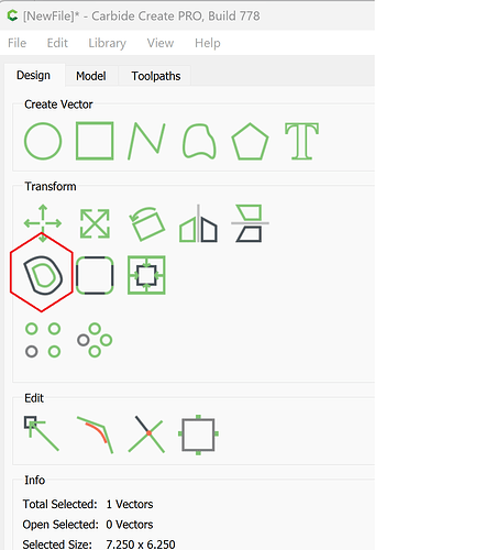

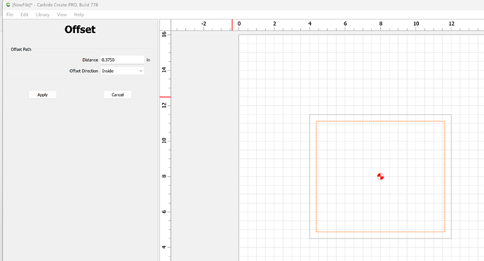

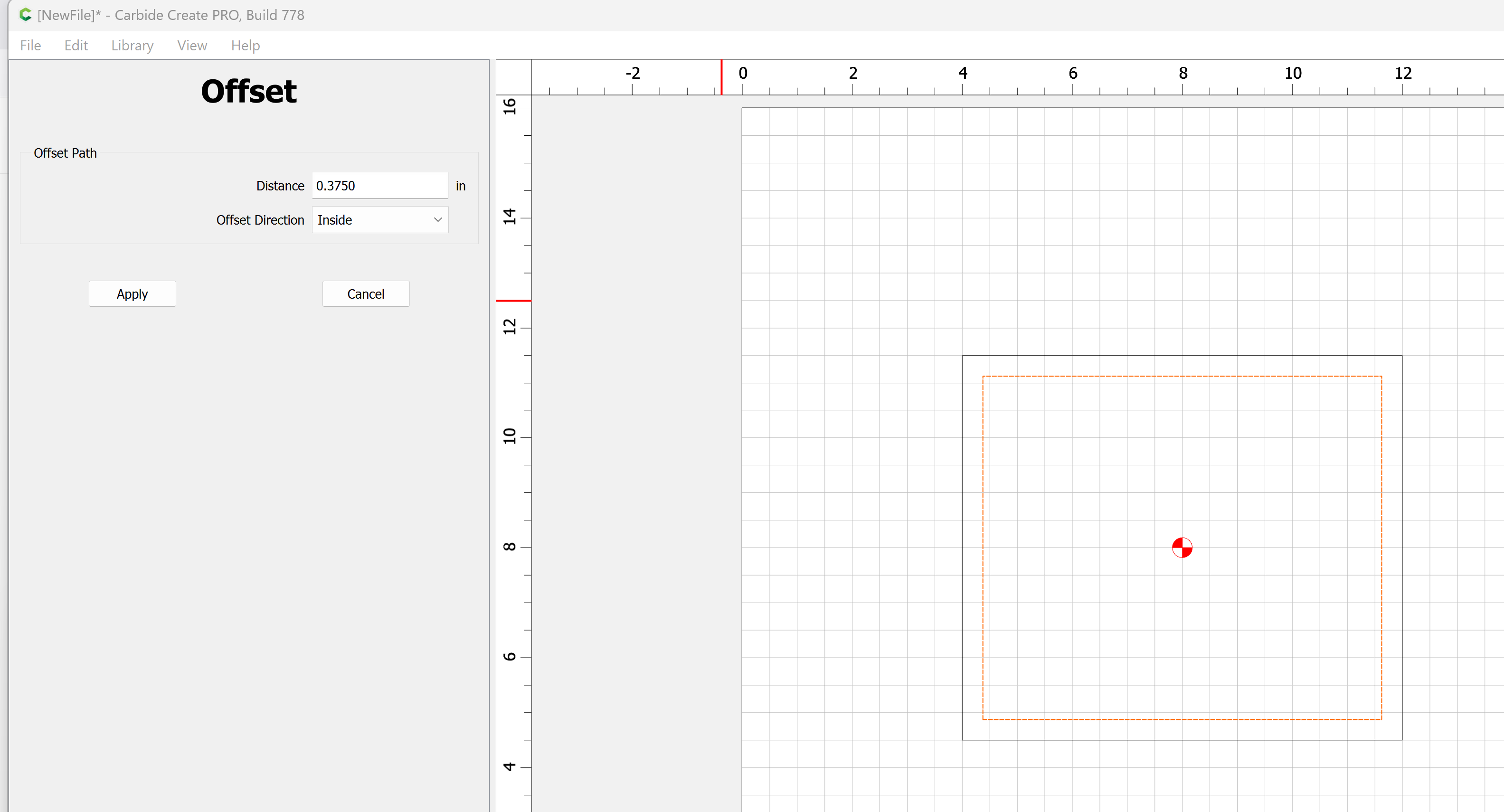

@WillAdams often recommends to not do slotting. That means doing a contour on the outside of the line you would use the “offset” tool and increase by more than 1/4" and the two lines are selected and a pocket tool path is used to the depth you want. The problem with slotting is there is big deflection and chip ejection. So if cutting out a project instead of a contour on the outside use the offset tool and offset like 3/8" and make a pocket. The bit will make a pass around at the cutting depth 1/4" wide with a 1/4" tool then it will make another pass touching the 3/8" offset and make a 3/8" slot around your project. This is not always practical if you need a 1/4" slot but whenever possible use a pocket that is more than the width of the bit.
A contour offset and just a plain offset are different. The offset tool adds to an existing object.
The contour offset is set in the tool path.
