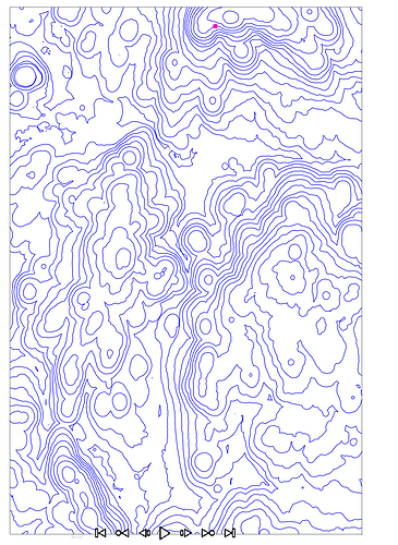

I am playing with the TopoMiller output. I am trying different tool paths and bits along the way.
I had been using the Scallop path operation but I did not like some of the tool marks.
I changed to a Ramp operation, since it gives an elevation cut feel, I still have not cut one yet.
I was looking at the path from straight down and found the path makes a great Topo representation. It looks so good, I want to make an etching from the path, but I need to change all the Z values to zero (accept for the retracts).

This has been pretty fun little AI test so far. Getting the tool paths flattened is straightforward enough and detecting loops is working fairly well.
The issue I’m running into at this point is the pesky transitions from one tool path to another from the original 3d. These lead ins and lead outs are harder to automagically detect than I would have thought.

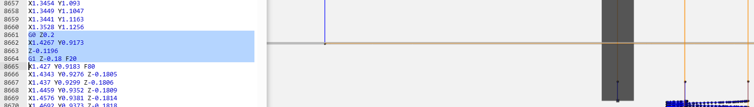

The current “Test3” file looks like this in ncviewer.
I can see a short cut lines connecting the retracts to the cut paths.
If I can remove that line, it will create a cleaner result ( no duplicate points ).

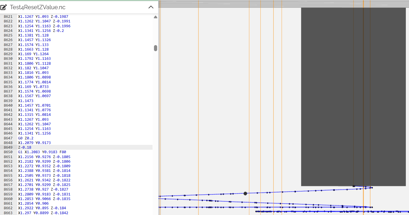

Here’s a better one. I had to zero out the Safe distance in the Links tab.
Test4ResetZValue.nc (1.4 MB)

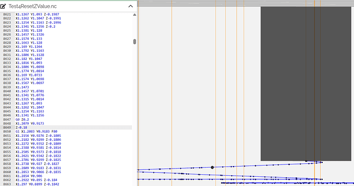

Not 100% sure what I am looking at but the file I posted has minimal movements in Z remaining other than Z0.2. Can you view it in something like NC Corrector and let me know what needs modified?
What software are you using to view this?
Oops, I need to read a message completely.
The file looks pretty darn good in ncviewer.
I need to get a feel for the changes ( text wise ).

I just compared the two files.
The differences are limited to some whitespace added to the end of most records.
The record count is identical.
The “Test4” file would eliminate a duplicate point in the nc file.

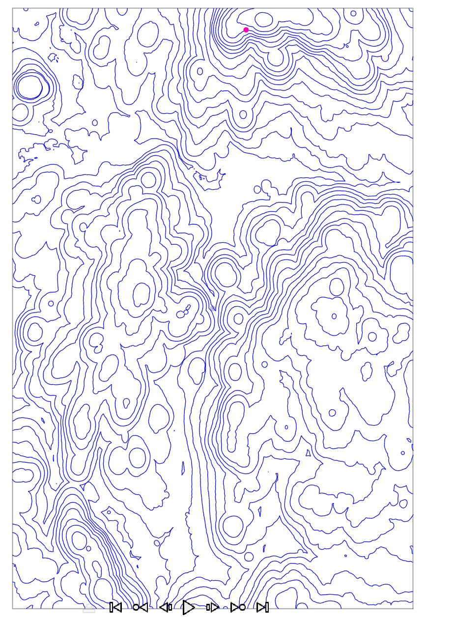

I think this will work converting Ramp like passes into a Topographic like etching paths.
