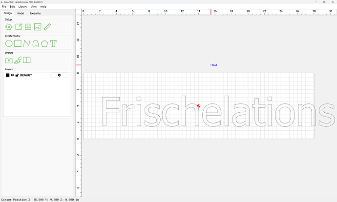

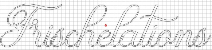

Can someone refresh my memory. How do i convert a text to graphic so i can weld the letters into one piece. I’m using an older version of Carbide create (V743).

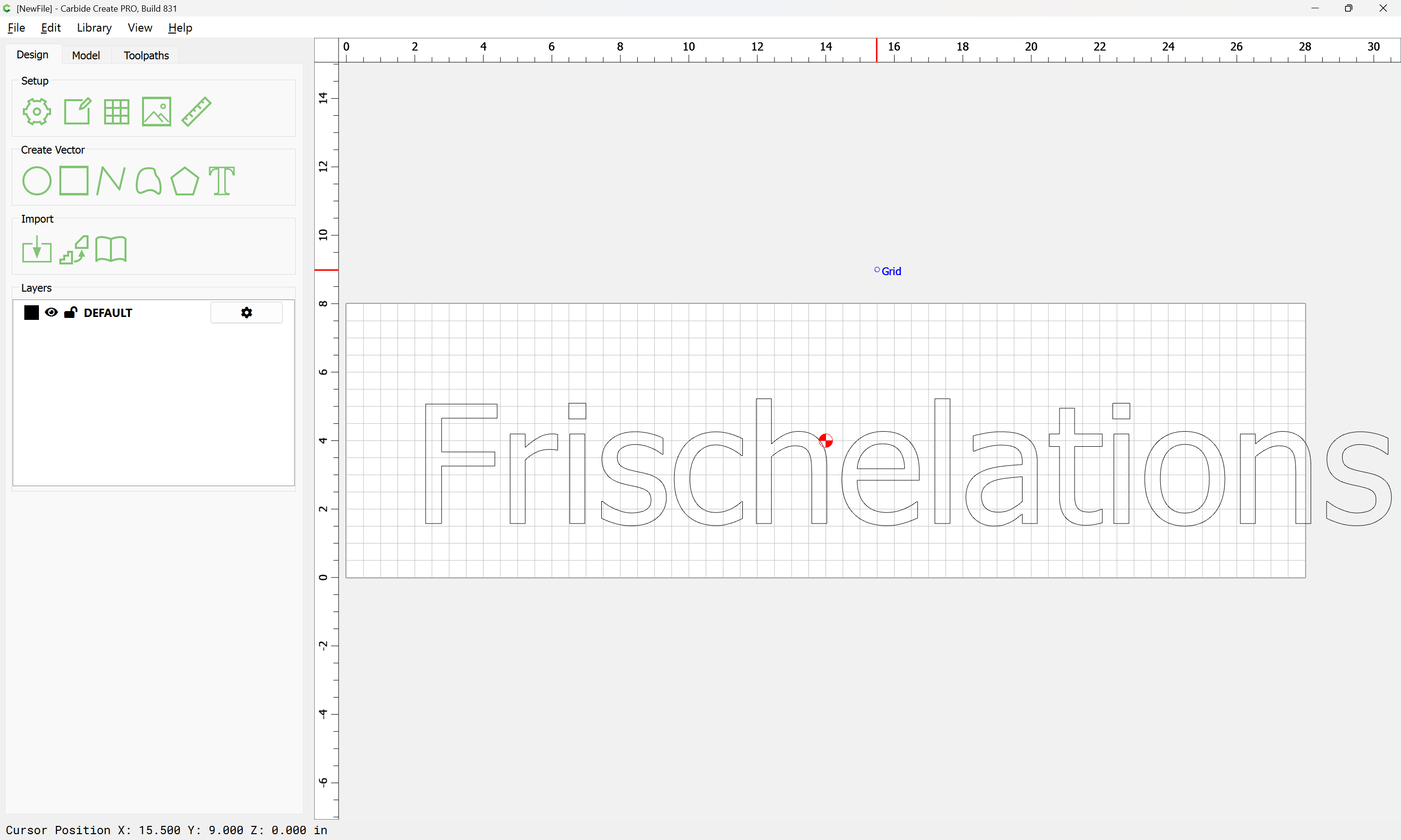

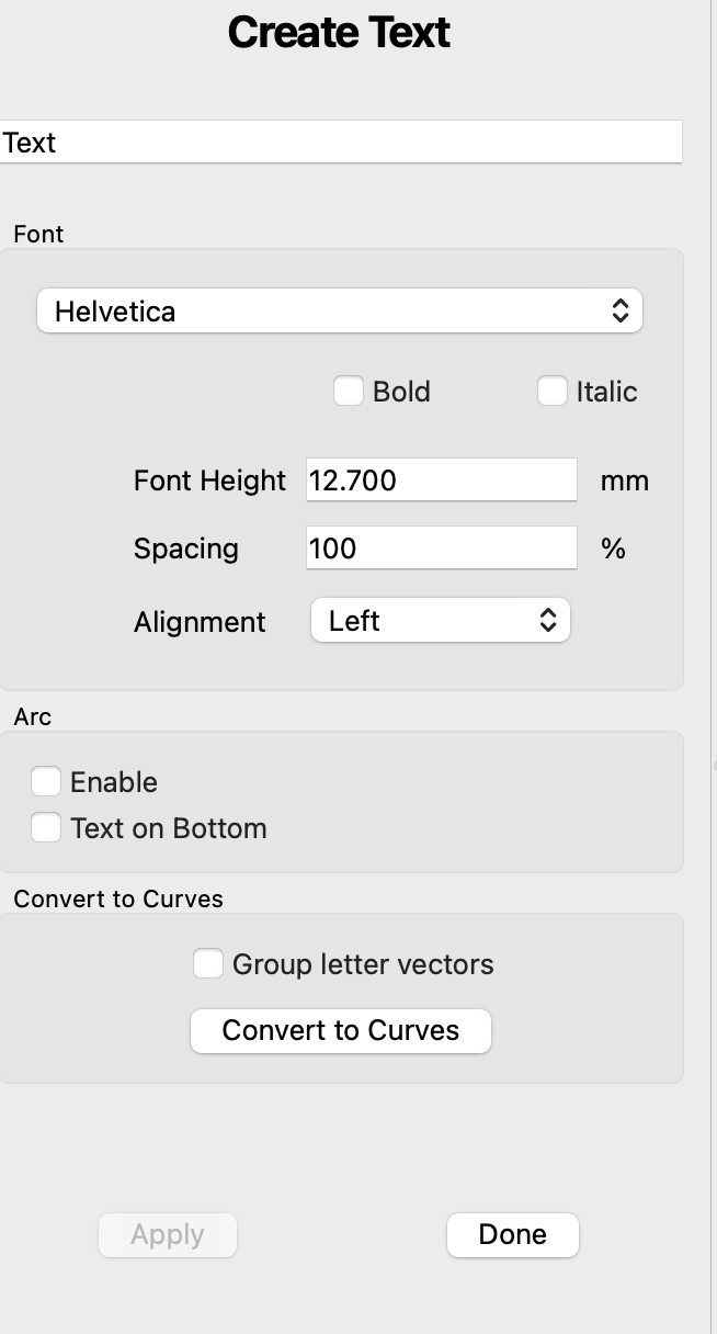

Did you “Convert to Curves”?
Not yet ill try that thanks
See:
https://carbide3d.com/blog/merging-script-fonts-in-carbide-create/
When i click on Boolean i get four options. None of then seem to give me what i want
Here’s the file
Frischelations.c2d (160 KB)

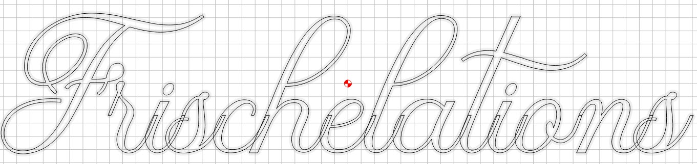

You need to convert the type to paths:
Finally got it.

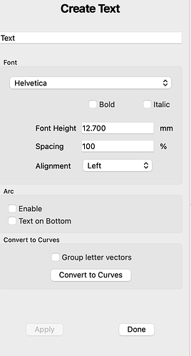

Convert to Curves
Then select “Smart Weld”
Thanks for the help.
Frischelations.c2d (196 KB)

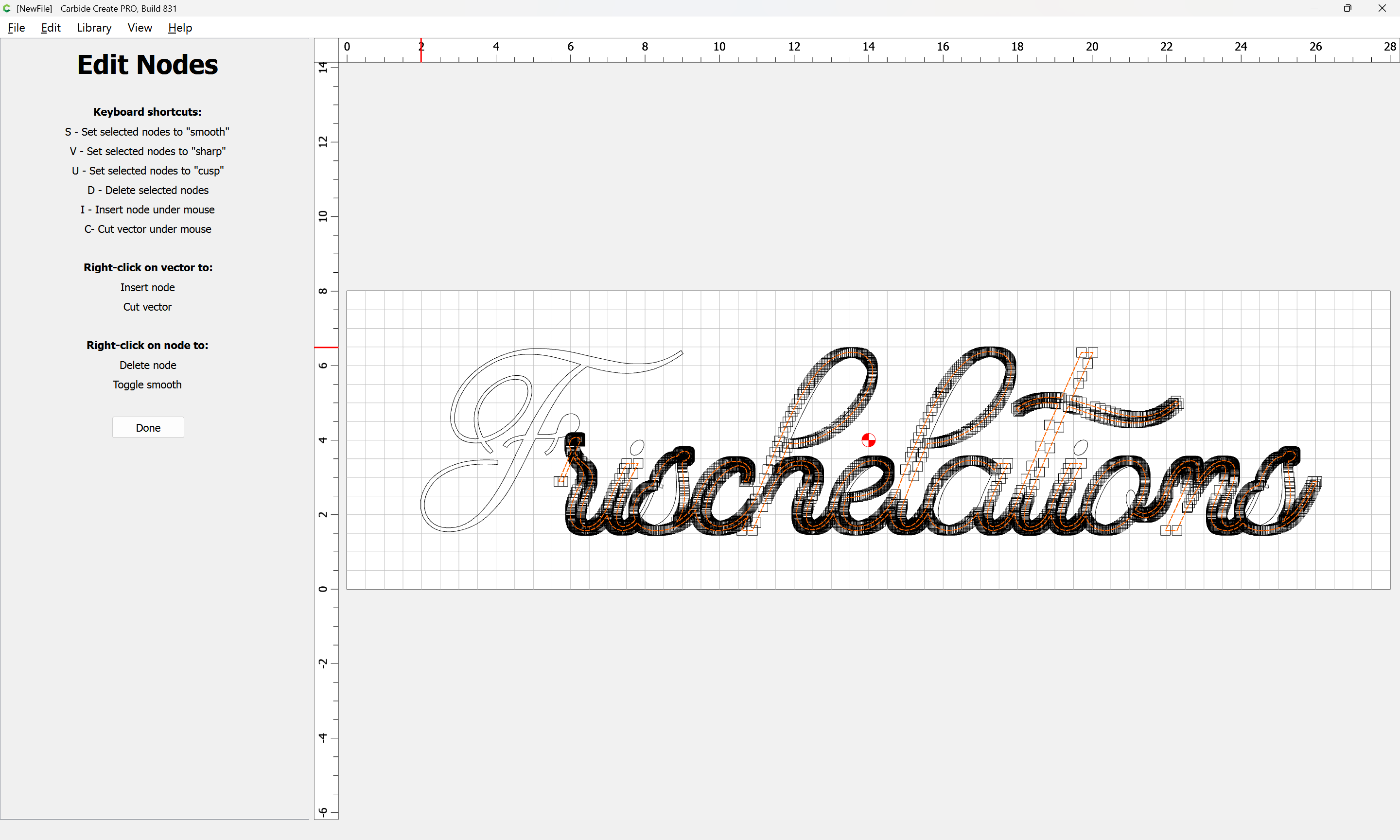

Please note that Boolean operations convert text into polylines:
u
You’ll have a better result if you use Trim Vectors then Join Vectors.
