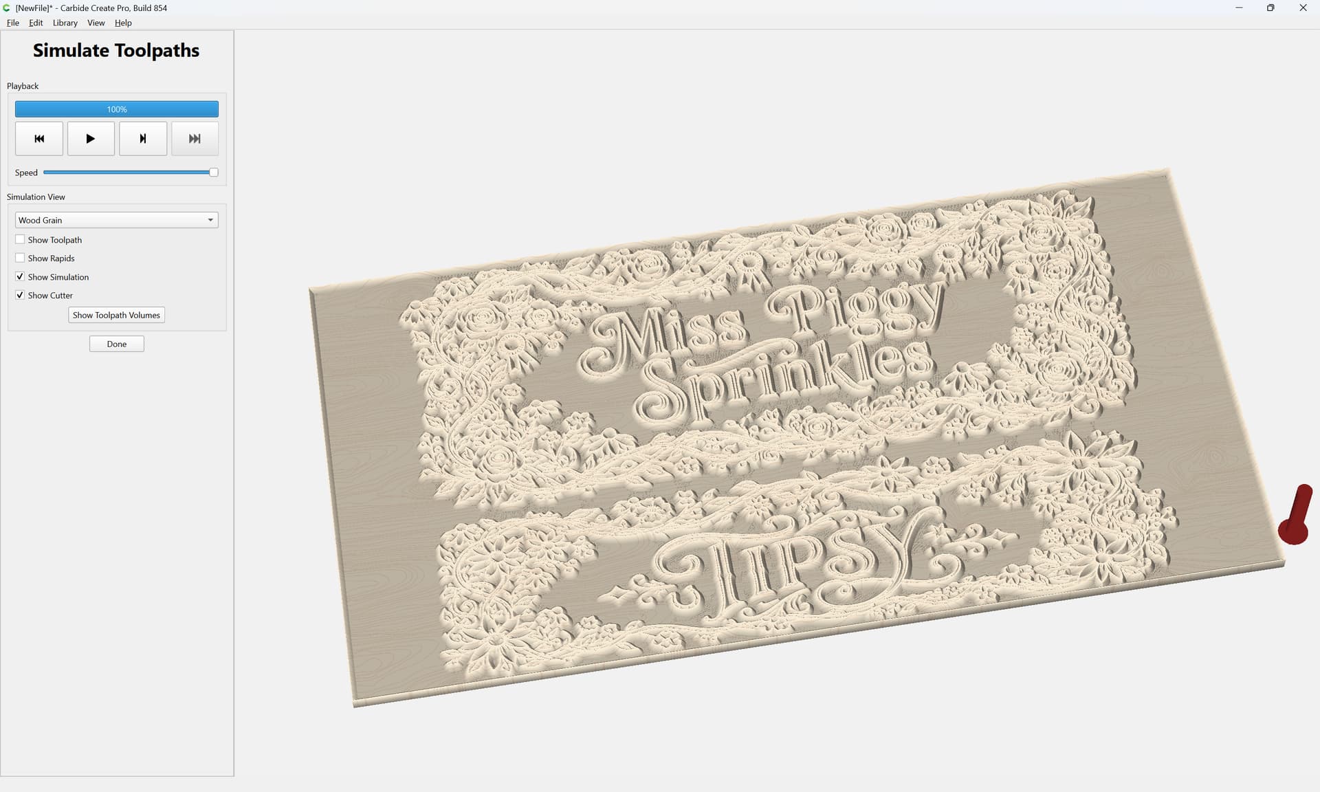

You didn’t say how you are going to machine the file. I looks to me like it is v-carvable. My simulation says it is a 90 minute file on a 35x20 substrate. Probably really means three hours. This would look very pretty as a shallow relief file too!

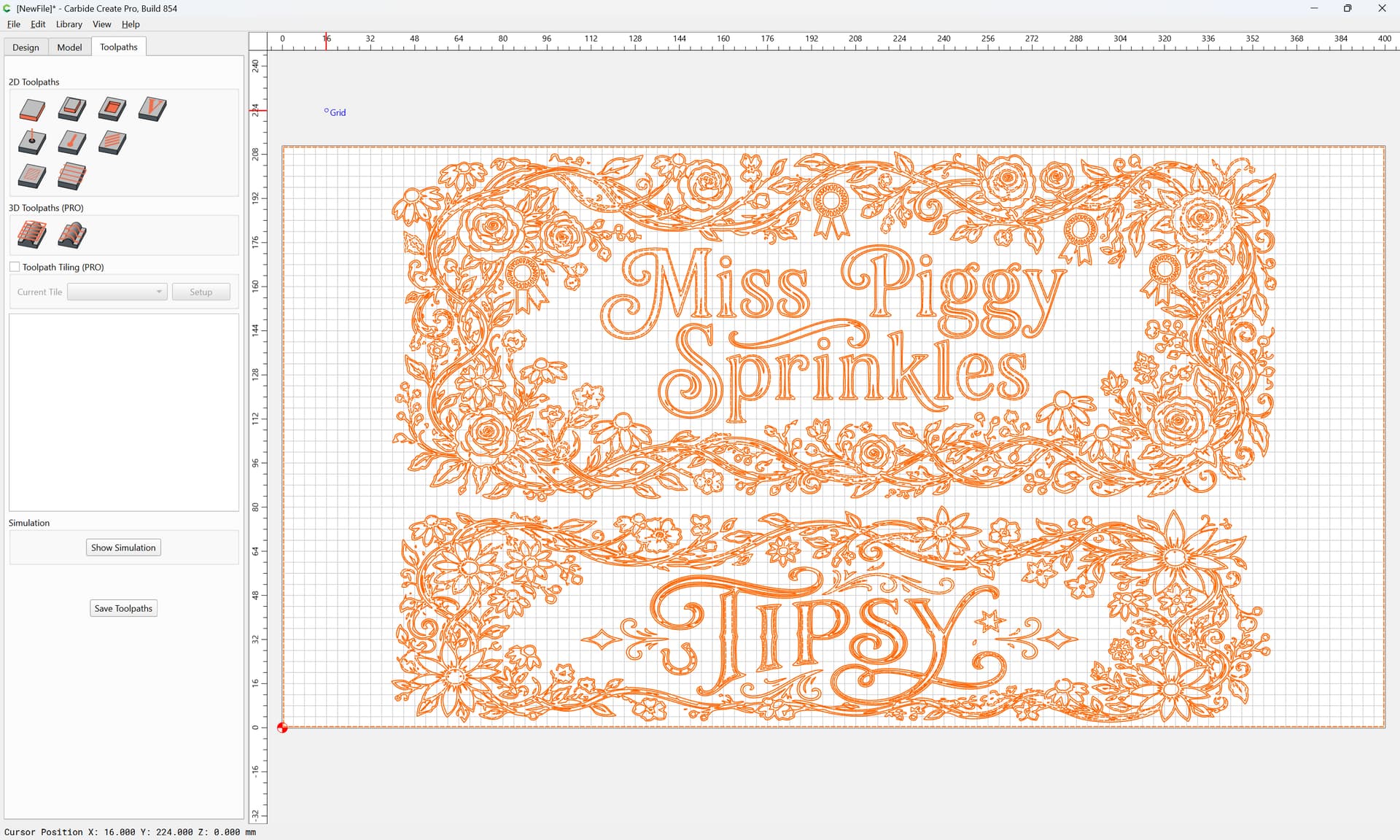

The file opens/imports as expected:

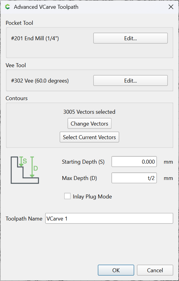

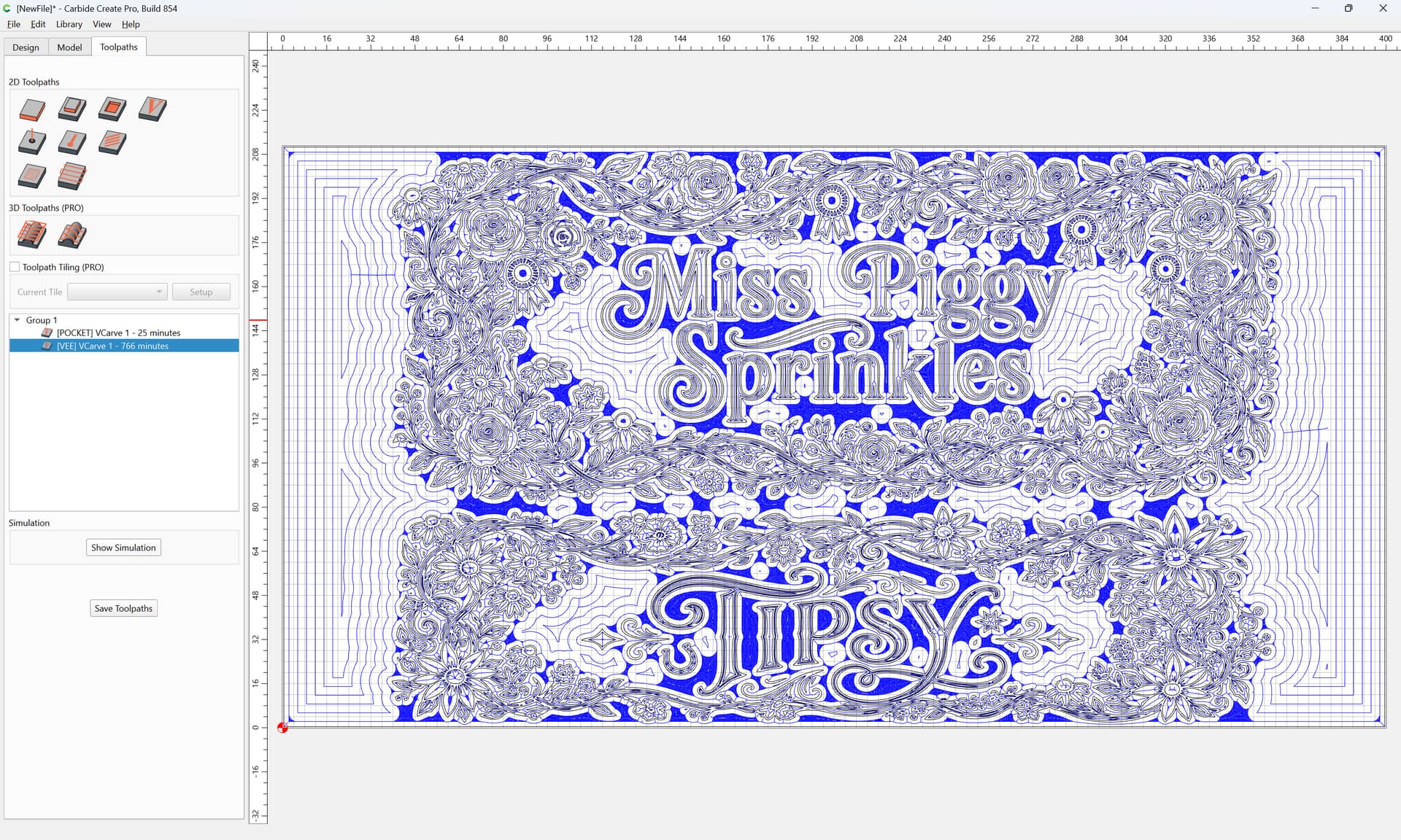

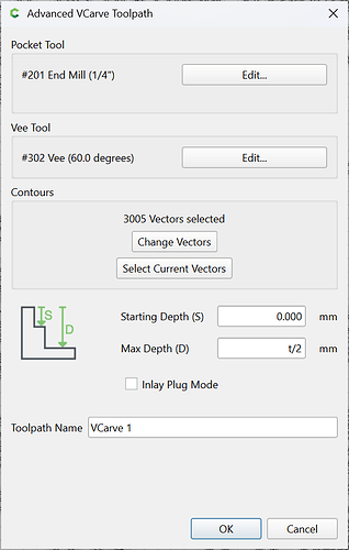

and assigning a V-carving toolpath with pocket clearing:

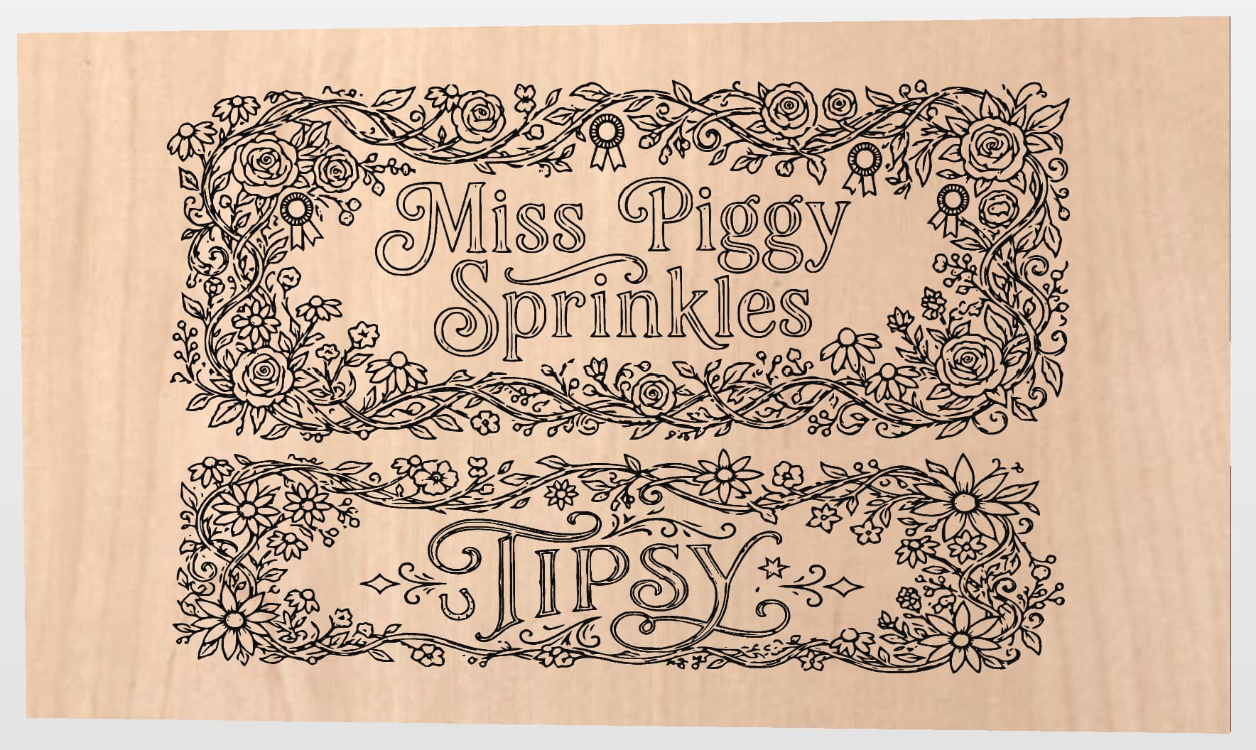

and if V-carved w/ a suitably acute V tool:
Seems to cut well.
