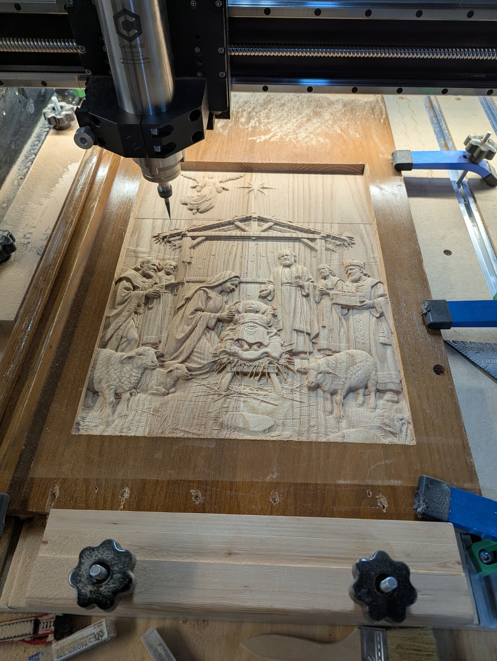

I don’t recall using that specific app, but I haven’t had much luck using file conversion. I do something similar to @cheu. I’ve used both my own photos and AI generated images. Sometimes i have the images converted to gray scale, and sometimes just use the full color image. As @cheu said, I’ve found Sculptok to be the best at building a downloadable stl file. I use the free version, which still allows you to make adjustments. You WILL need to play with it to get the hang of it. The attached image was AI generated and converted through sculptok. I downloaded it, imported into CC and added the tool paths. Have fun with it. Sculptok uses the “token” system, but if you log into it daily you get free tokens to use.

Nice detail in that carve!
Thank you (20 characters)
That looks great,what size bit are you using?my guess that it will take a reasonable time
Thanks. It’s a 1/32 bit. I’ve done multiple carves from photos and usually end with a small bit to bring out the details. Yes, they are long, I overkill the step over so they can be extremely long. This one was 12 hours.
