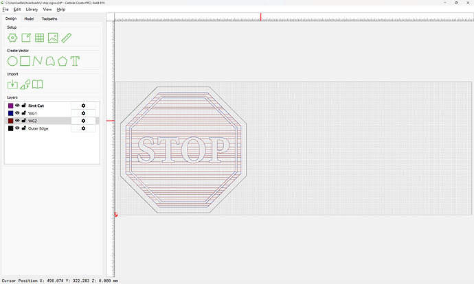

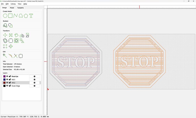

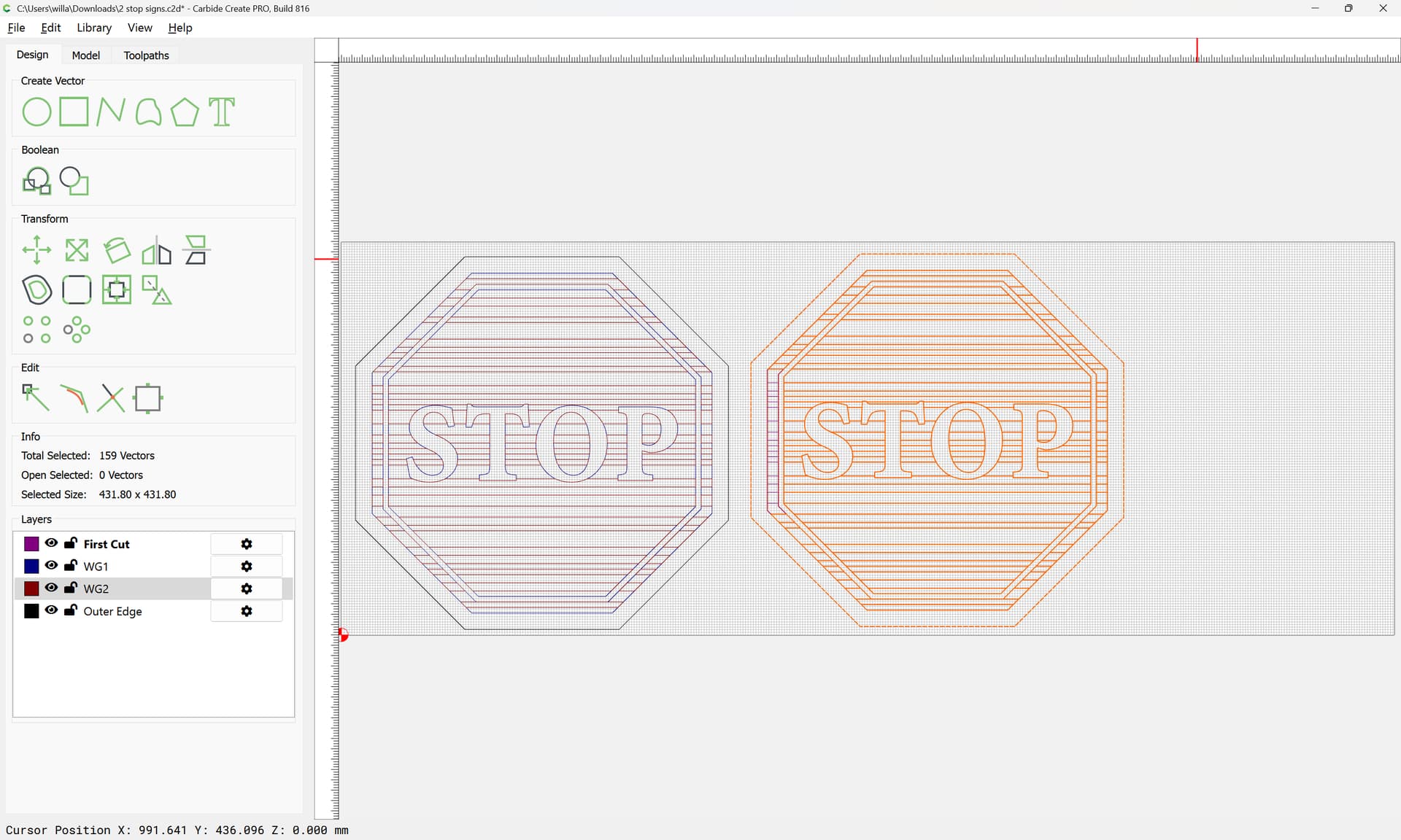

Quick question. I’m trying to copy and paste from one image to multiples on the same project, but it only pastes part of the toolpaths…and different ones each time I try.
Thoughts?
2 stop signs.c2d (780 KB)

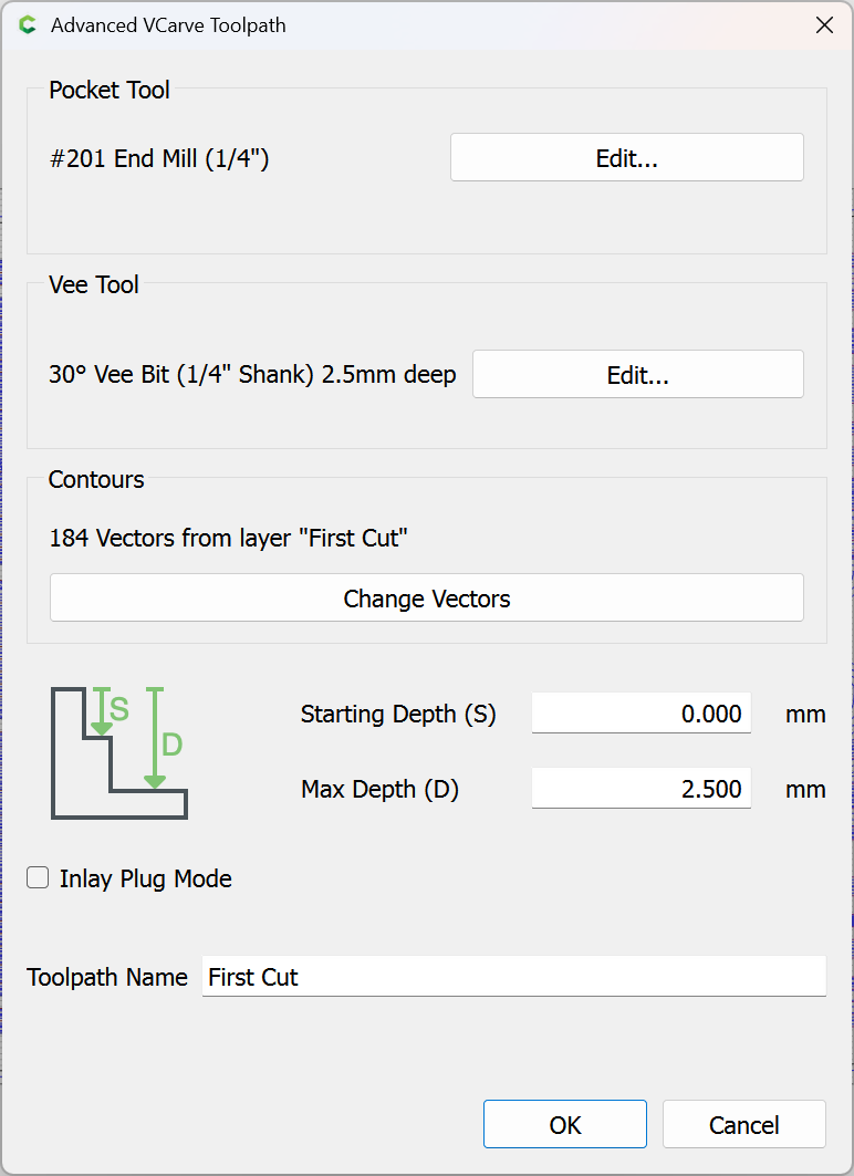

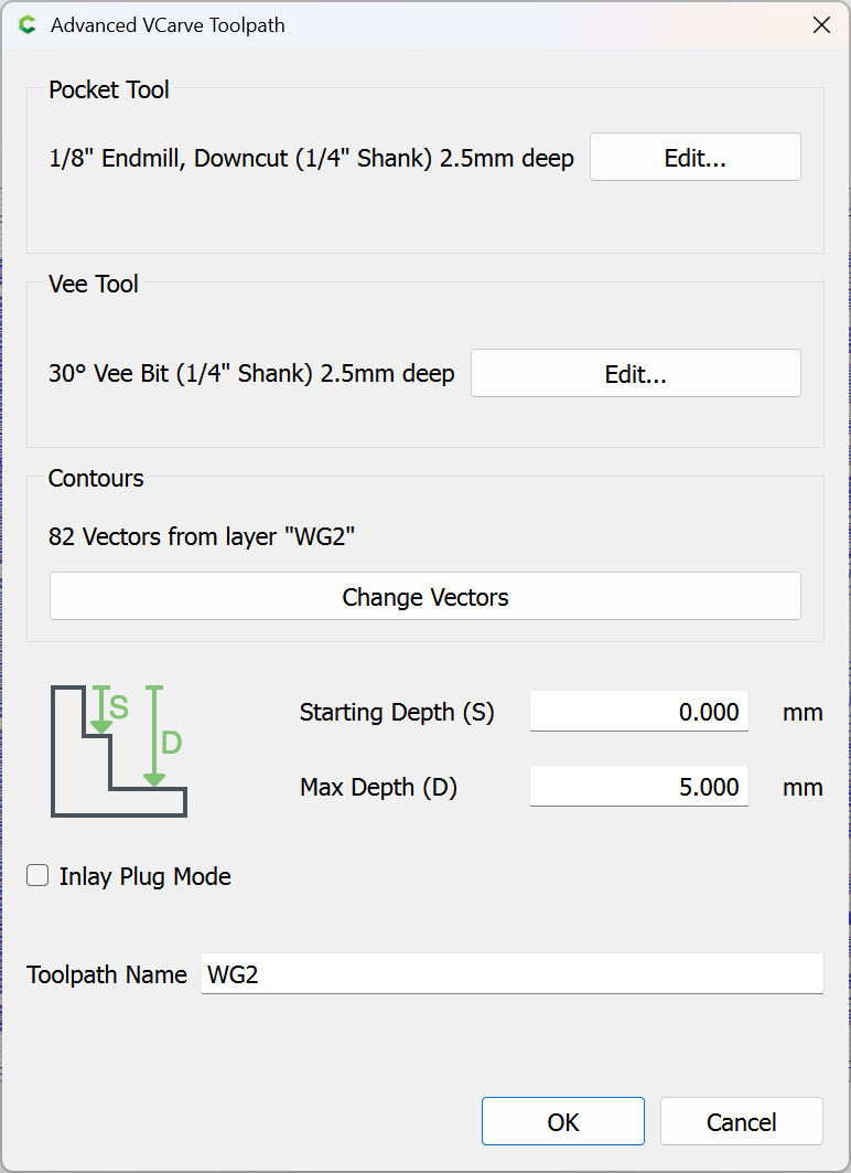

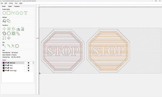

Your files have toolpaths assigned based on layer:
so duplicating to a different layer will interfere with that.
What is the solution?

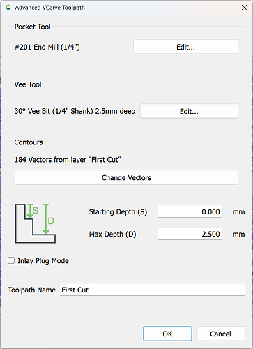

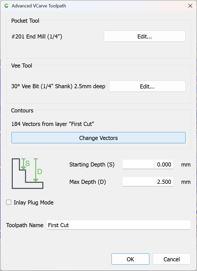

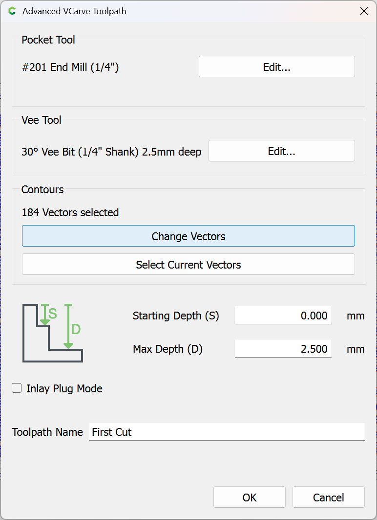

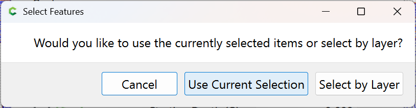

If you want a toolpath which will be able to be duplicated it will need to be associated with a selection:
Change Vectors
Use current selection
Repeat for any other toolpath which is associated with a layer.

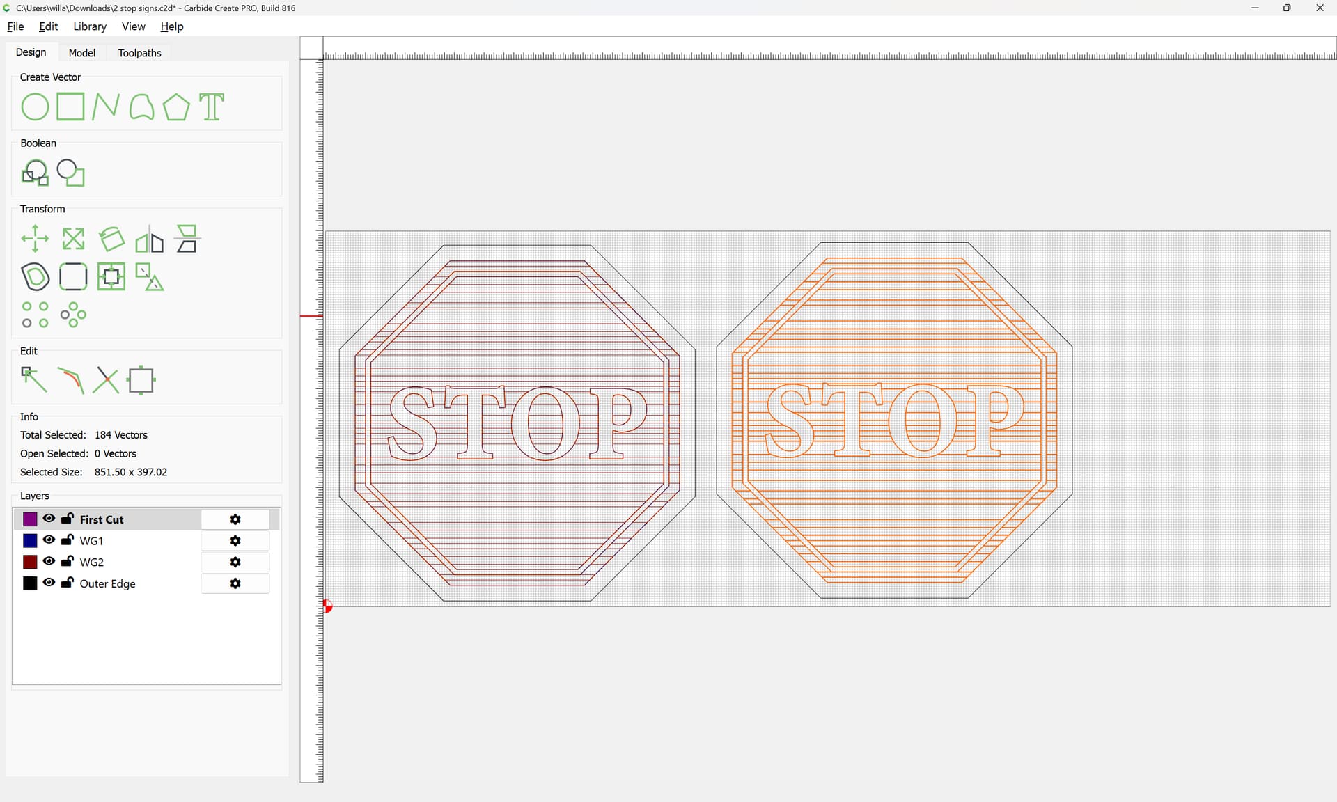

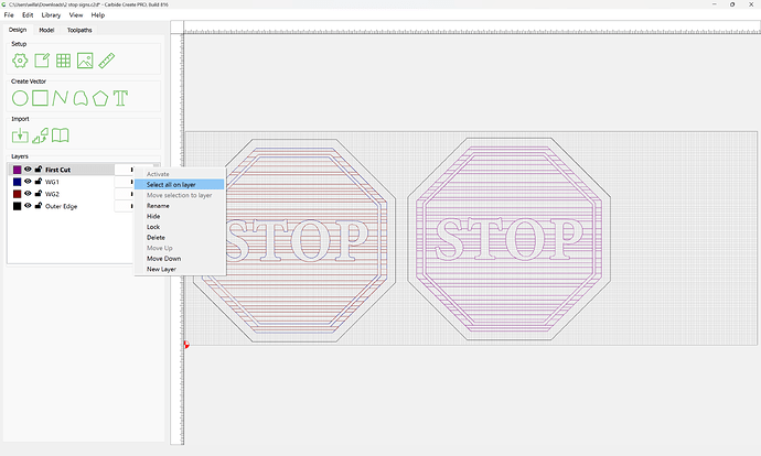

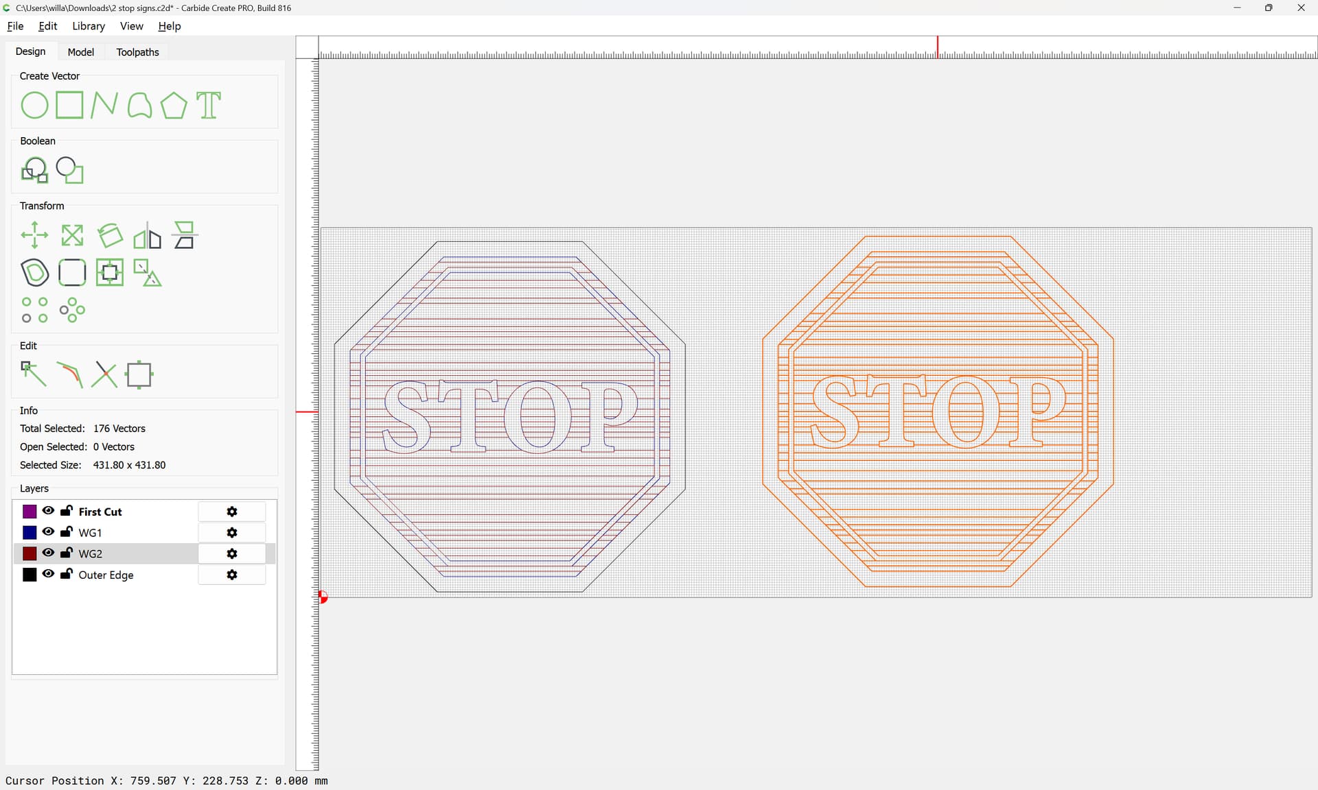

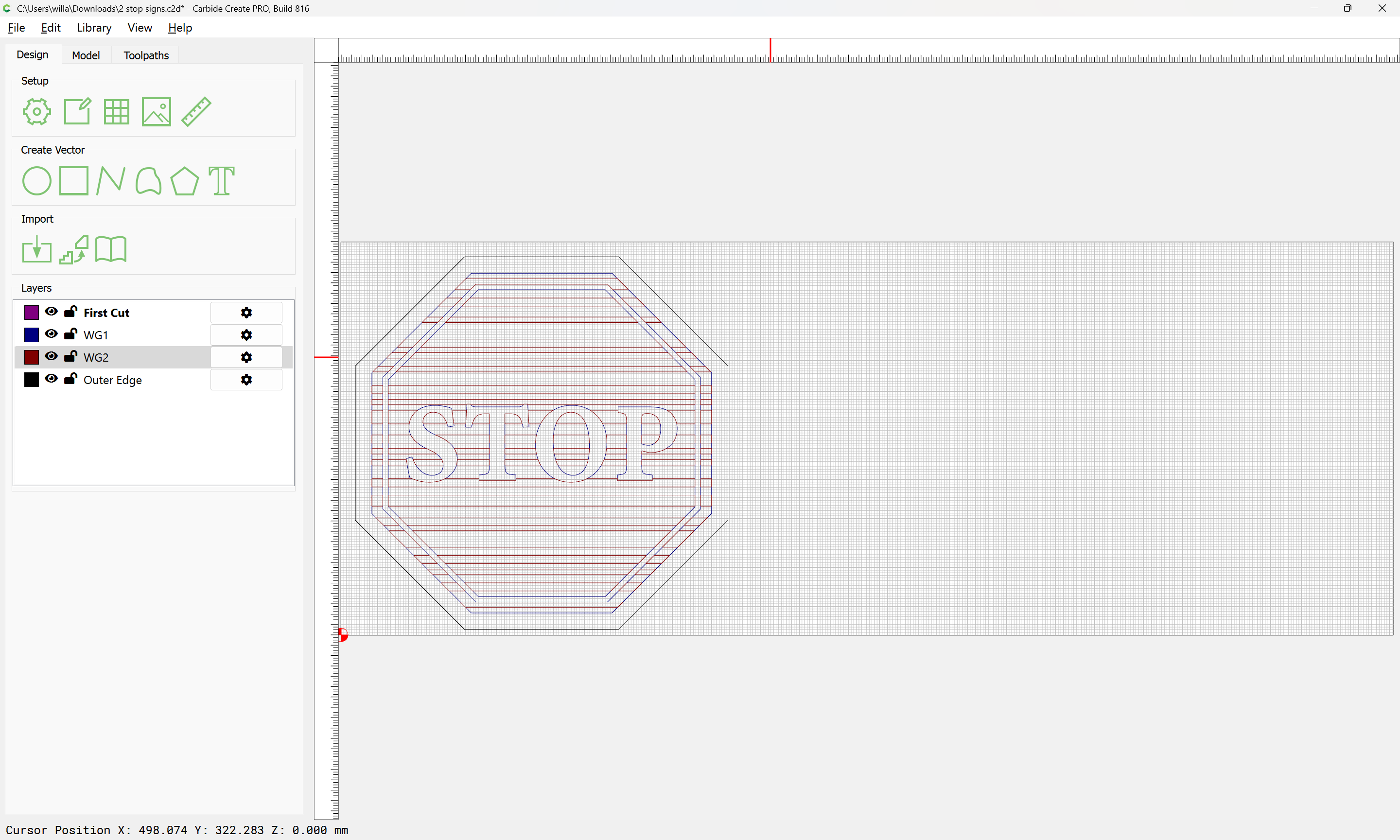

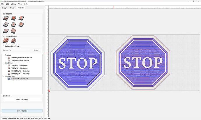

If you then delete the duped geometry:

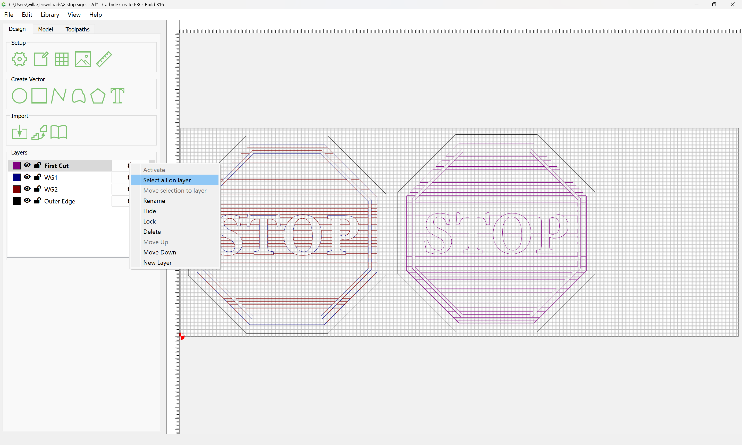

and then copy-paste:
the results will be as expected:
