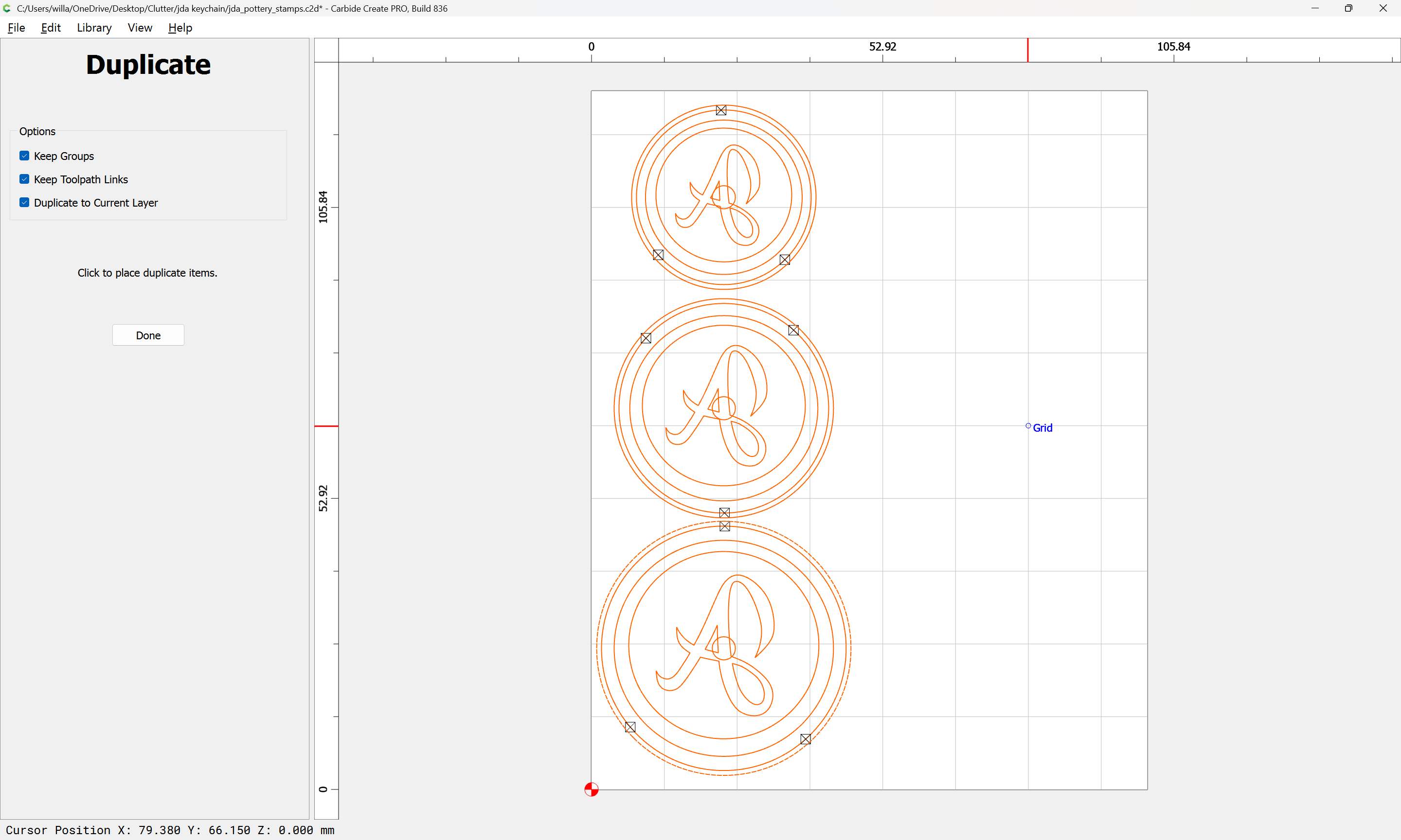

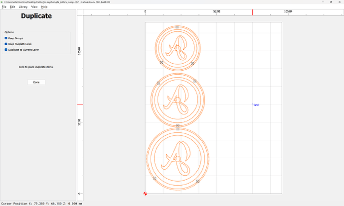

Usually, it’s best to make all the geometry, then assign toolpaths — obviously doing production work as described at:
VIDEO
changes this calculus, but the best thing to do is to use the Duplicate functionality:
which affords controls for this:
If you have difficulties with this, please let us know the specifics.
