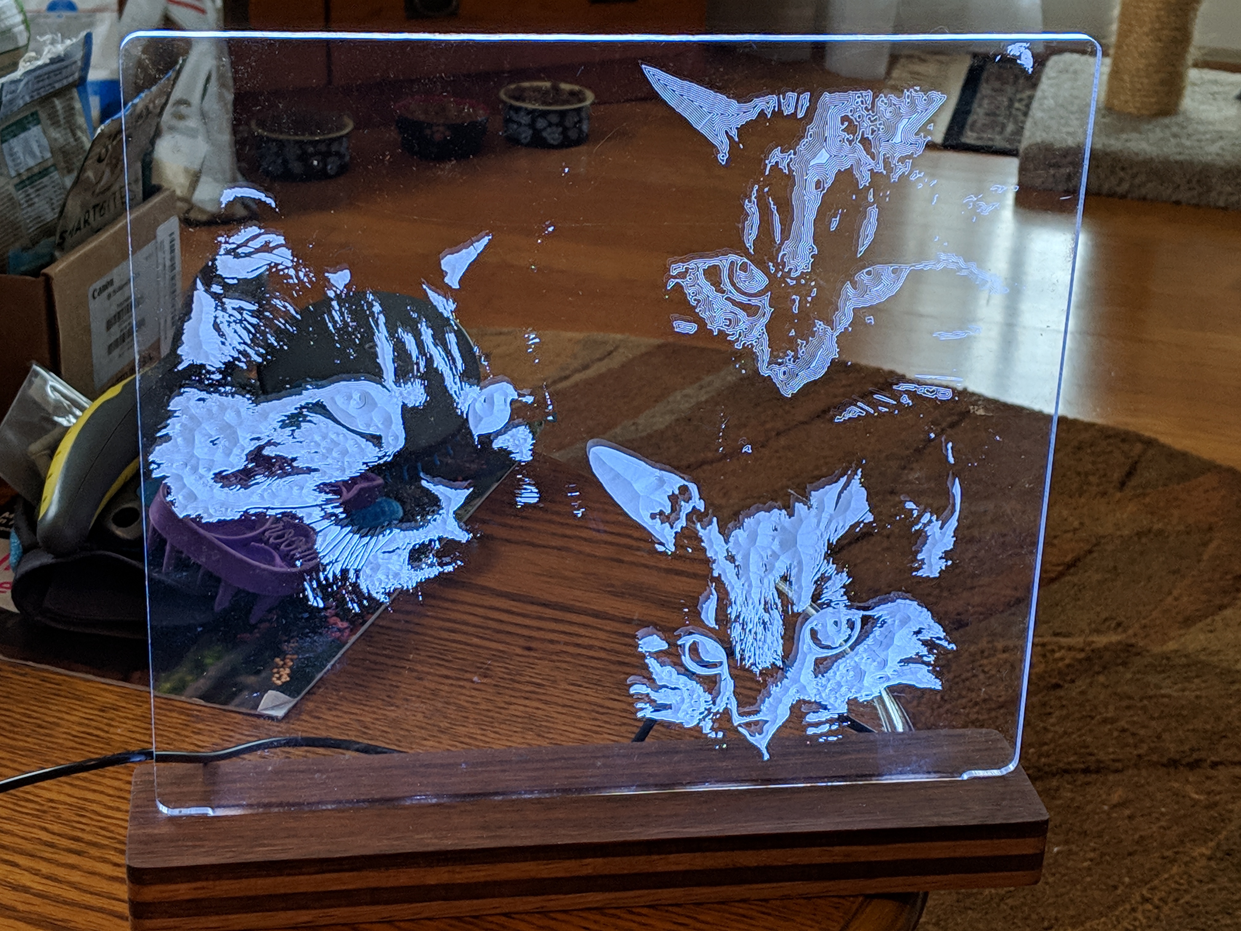

I used https://smile.amazon.com/gp/product/B001J9K5XI to cut out the design I made below.
This was try 3; the first 2 tries ended up in one big melted gue before I even got to the outer cut and I had to throw away some nice endmills that now were encased in a hard bal of plastic

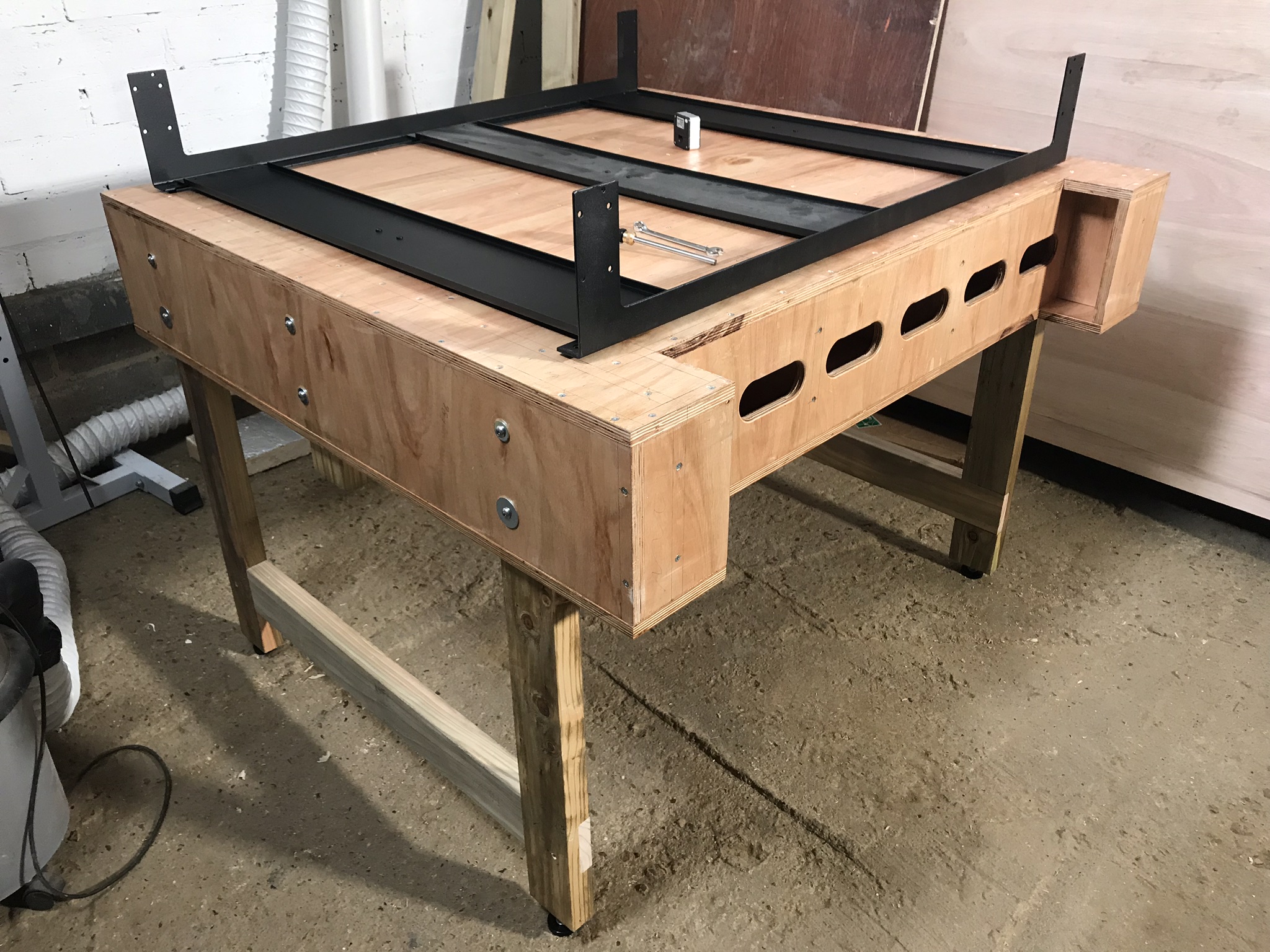

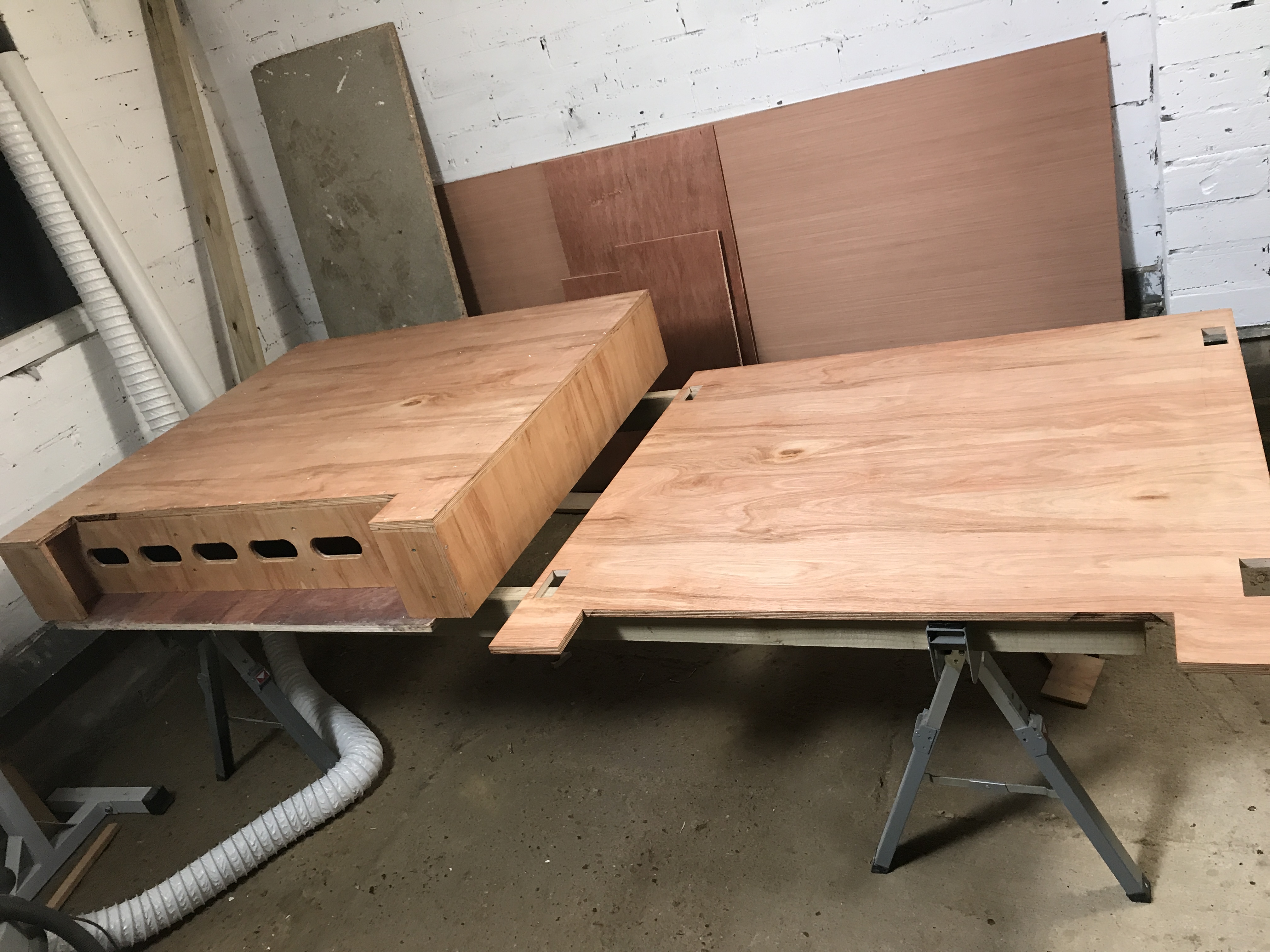

I spent a while making up a torsion box table for mine to live on but anything you have that you can get flat and level works. Mine is a bit ugly but functional (now that there’s more angle bracing on the legs). It doesn’t have a lid over it but I use a dust hood on the spindle. I took the time (as suggested in the manual) to use a polyurethane lacquer on the supplied MDF parts and on the torsion box to keep the damp and mould away, from your description I’d suggest it’s worth considering for you too.
