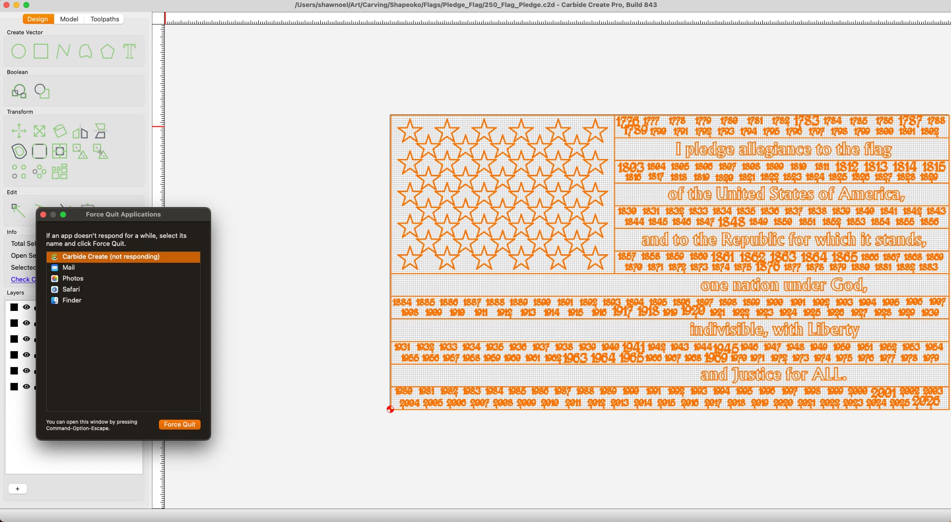

Hello and thanks for reading. So I have this dxf file that I exported from Illustrator CS4and imported into Carbide Create. I import the file and then group all of the elements so I can center the elements on the work area. As soon as I group them I get the Mac color wheel of death. I’ve walked away for 15+ minutes and it was still spinning it’s evil spell. Thank you for any help.

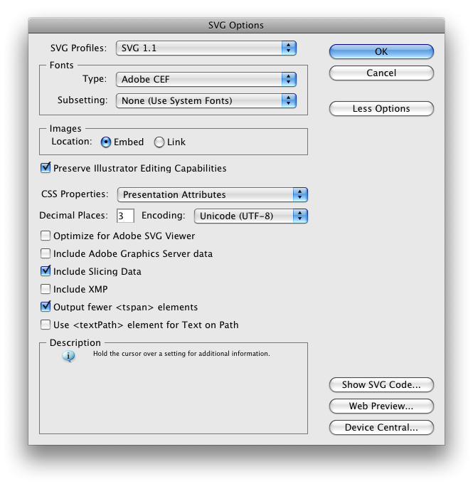

Does the behaviour change if you write out an SVG (remember to uncheck the “Responsive” checkbox)?
Will, I sent the file to support because it was too large to add here(crazy). I’ll export the SVG again to ensure the Responsive checkbox is unchecked.

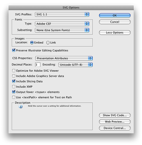

These are the options Illustrator CS4 gives me while saving as an SVG. I didn’t see a “Responsive checkbox” however. Yes, the SVG crashes/becomes unresponsive after grouping the elements.
I believe you need to use “Save for Web”
https://www.adobe.com/learn/illustrator/web/export-svg?ntd=1

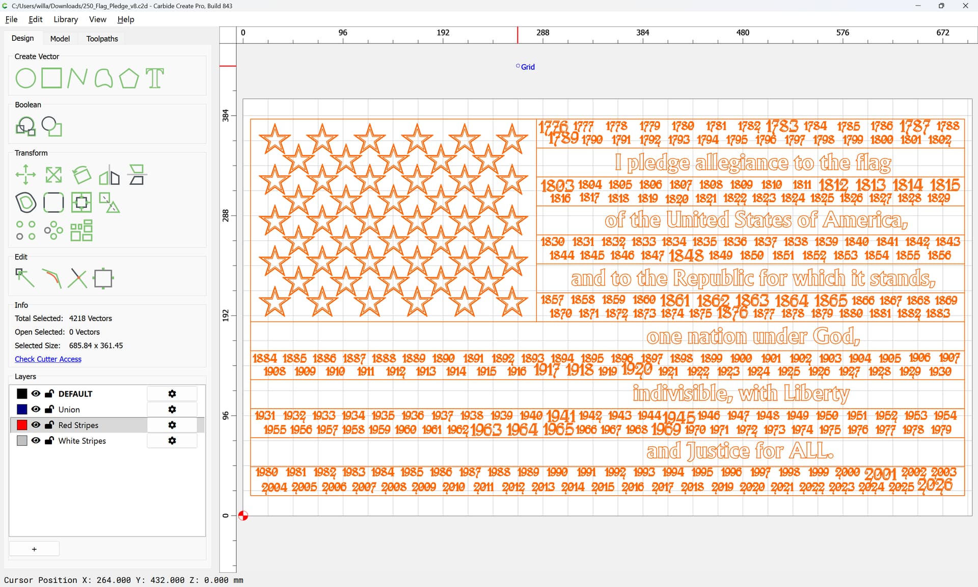

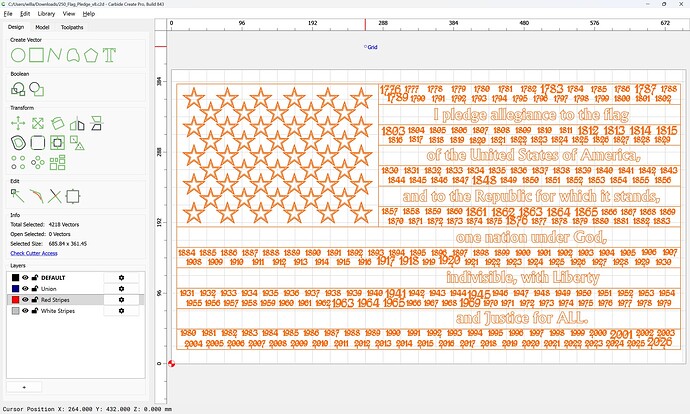

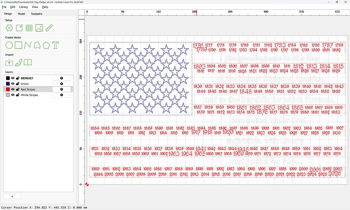

As noted on support, I was able to simplify this down to 4,218 elements:

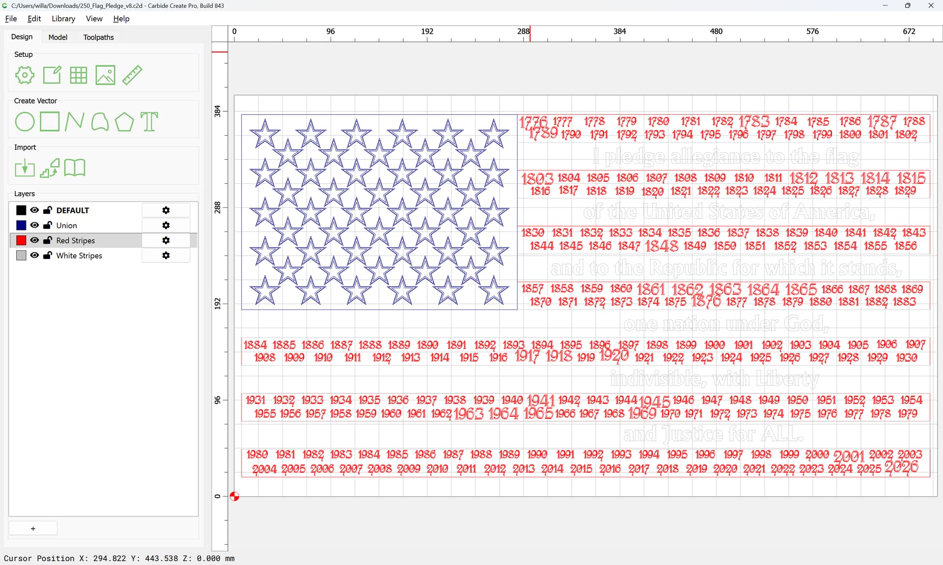

which I was able to organize on appropriate layers:

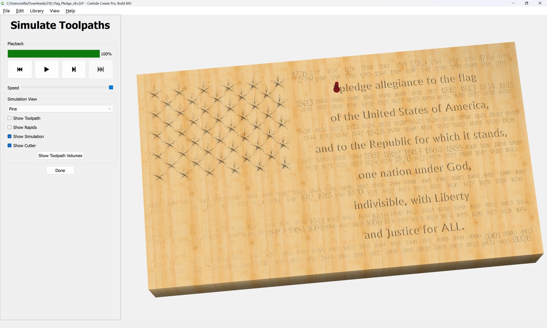

and then set up suitable toolpaths:

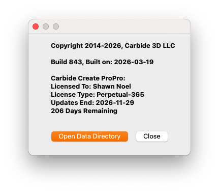

Update- we added a fix for this in the next release.
