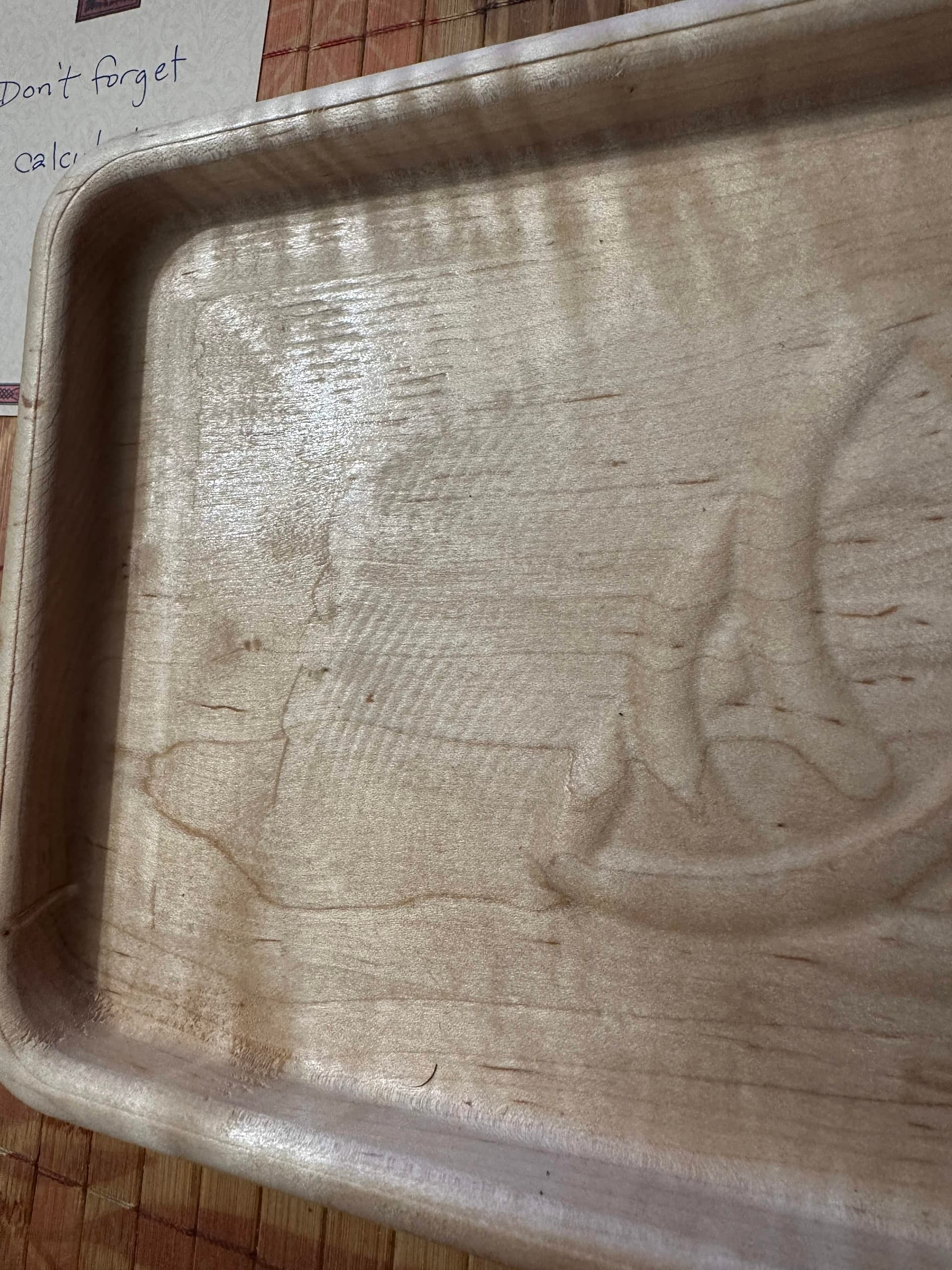

@GJM Looking at it quickly on a project I have open, it looks like “parallel” keeps the bit going in the same direction instead of circling out from things. So if you look at this you can see how there are toolmarks radiating out from the 3d section in the middle as well as ones going lengthwise. Both of those are from the same pocketing operation and setting it to “parallel” would eliminate the ones that are following the curves of the center design.
So the benefit wouldn’t be time but cleaning up tool marks from the milling process.

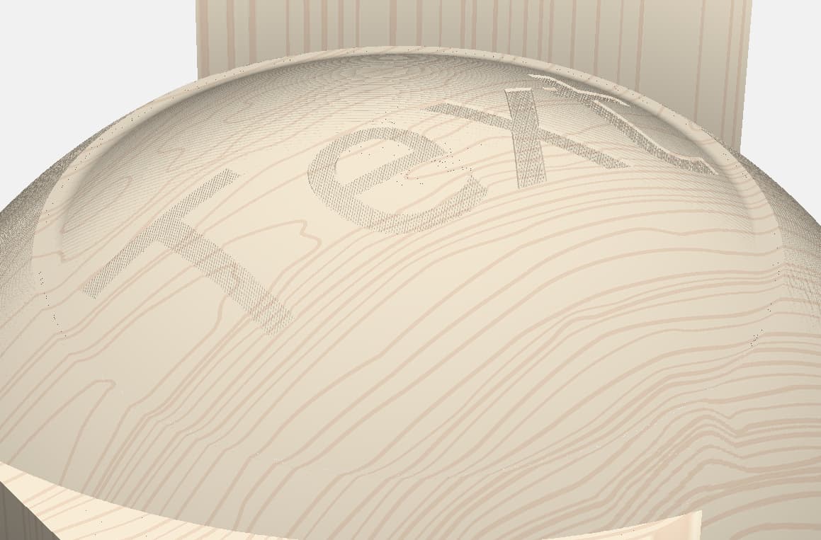

Tried projected engrave in 858. It was stuck on 20.1% for about 5 minutes.
Turns out it was done, it just didn’t update the % until I hovered my cursor on it. (chronic issue with other paths as well.)
OK, can you explain the Start Depth / Max Depth logic?
I set them to 0.000", 0.010" and expected it to cut evenly 0.010" into the 3D surface.
It cut on a plane above the model.
Finally settled on Start Depth 0.100" and Max Depth 0.010", and it cuts part of the engrave…
What do I use if I just want the entire text engraved at 0.010" into the 3D surface?
OK, looks like Start Depth 0.500" and Max Depth 0.010" does what I want.

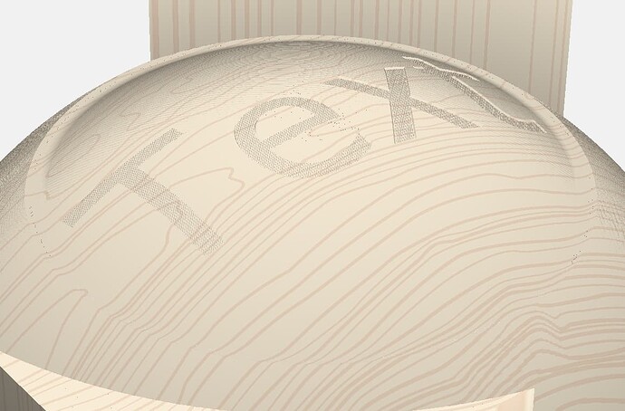

Here’s a more thorough description of the intent: (And this presumes there are no bugs in the current implementation, so this is the intent only)
  • To be pedantic, the two parameters are Start Depth and Cut Depth, not Max Depth.
  • In all cases, the maximum cutting depth is the Start Depth plus the Cut Depth. That’s the same in the 2D and 3D cases.
  • When projection is enabled, if the model is higher than the toolpath, then the model can “push” the toolpath up. If this happens, the toolpath can cut up to “Cut Depth” into the model.
  • If the model is beneath the toolpath, nothing will happen.
  • If you just wanted to project into the whole model, the best thing would probably be to make the Start Depth equal to “T”, or the stock thickness directly.
  • While not perfect, this does keep the semantics of 2D and 3D similar- both create a toolpath at the same depth; one just allows the model to push it back up.
Personally, I don’t care about the flexibility argument. If this were for me as a user, I’d always just internally set the Start Depth to the stock thickness when projection is enabled. But it’s not for me, and this is closer to the way other systems have implemented projection, so we’re starting here. (Good or bad, I don’t know)

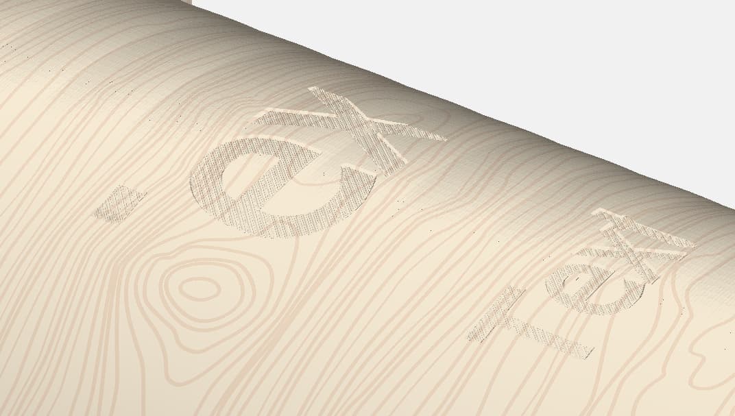

But it doesn’t. In the 2D case, if I had previously cut a 1/4" pocket I would set start depth to 0.25" and my cut depth to the desired depth for my engrave. Say 0.010" (Max Depth: 0.260")
In the 3D case, If I cut a 1/4" deep engrave, and then want to engrave into that resulting surface, I have to set the Start depth greater than the lowest point I will encounter (say 0.500"), then set the Cut depth to my previous depth + the new engrave depth (0.260"), Max Depth: 0.760".
Again, I get how to set it now to get what I want. But it’s a paradigm shift. i.e. when using Project to 3D Surface, it means something different.
