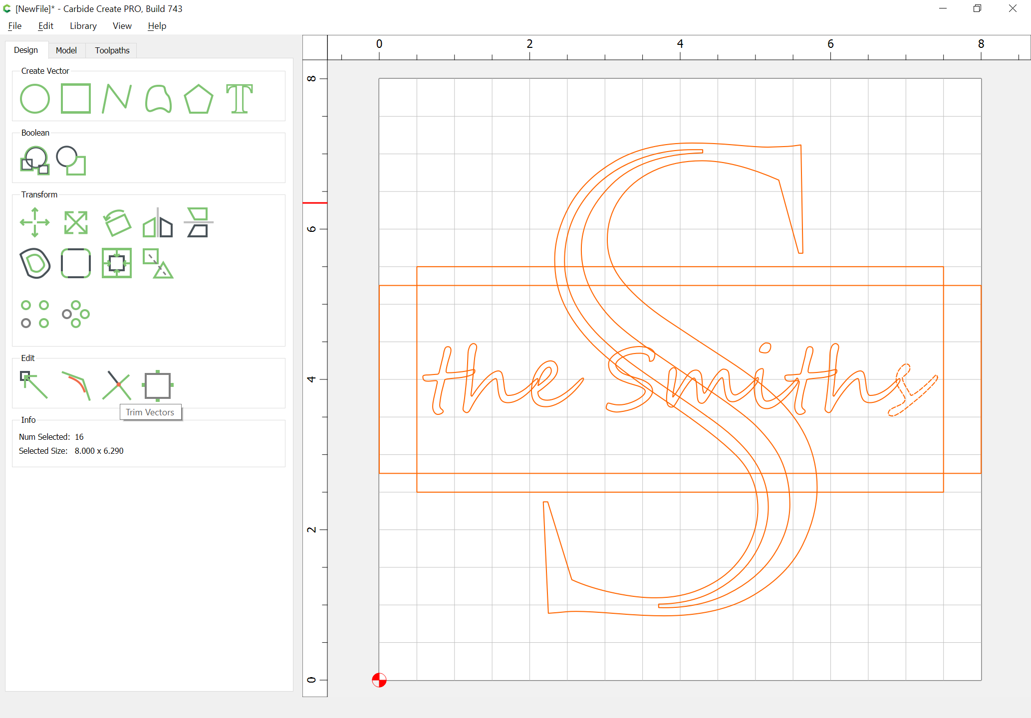

You need 3 elements, one of which comprises two pieces of geometry:
The letter:
A pair of rectangles which will define the bars across the letters:
and the text for the surname:
It will be necessary to convert the letter to curves:
Because the letter has a highlight in it, this must be done in two operations if using Boolean union, so first duplicate the taller rectangle:
and then select the hollow, then shift-click on the rectangle to add it as the key object (indicated by a dashed highlight):
and Boolean Subtract:
Then select the remaining taller rectangle and Boolean Union it w/ the letter outline:
Then shift-click on the remaining rectangle to add it as the key object and Boolean Subtract it:
If you are using a Script font, you will wish to convert it to curves and combine it so that it will be cut as desired, see:
An alternative approach is to use the Trim Vectors command — draw up the same geometry, and again, convert all the text to outlines:
Select everything and use the Trim Vectors command:
and then click on and remove all line segments which are not needed:
Then clean up by removing superfluous geometry:
Select everything and use the “Join Vectors” command to close the geometry:
Assign a suitable toolpath:
and adjust until one gets a preview which matches what you wish to cut:
If you wish to cut as an inlay:

But comparing your original example with the other, you will likely have to split the S into two halves using the same techniques vs purely removing the covered portion of the letter. Aesthetically that looks a lot better vs subtracting most of the vectors away.
