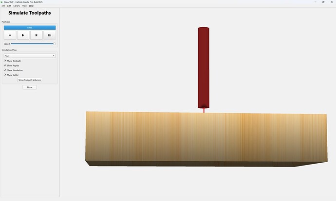

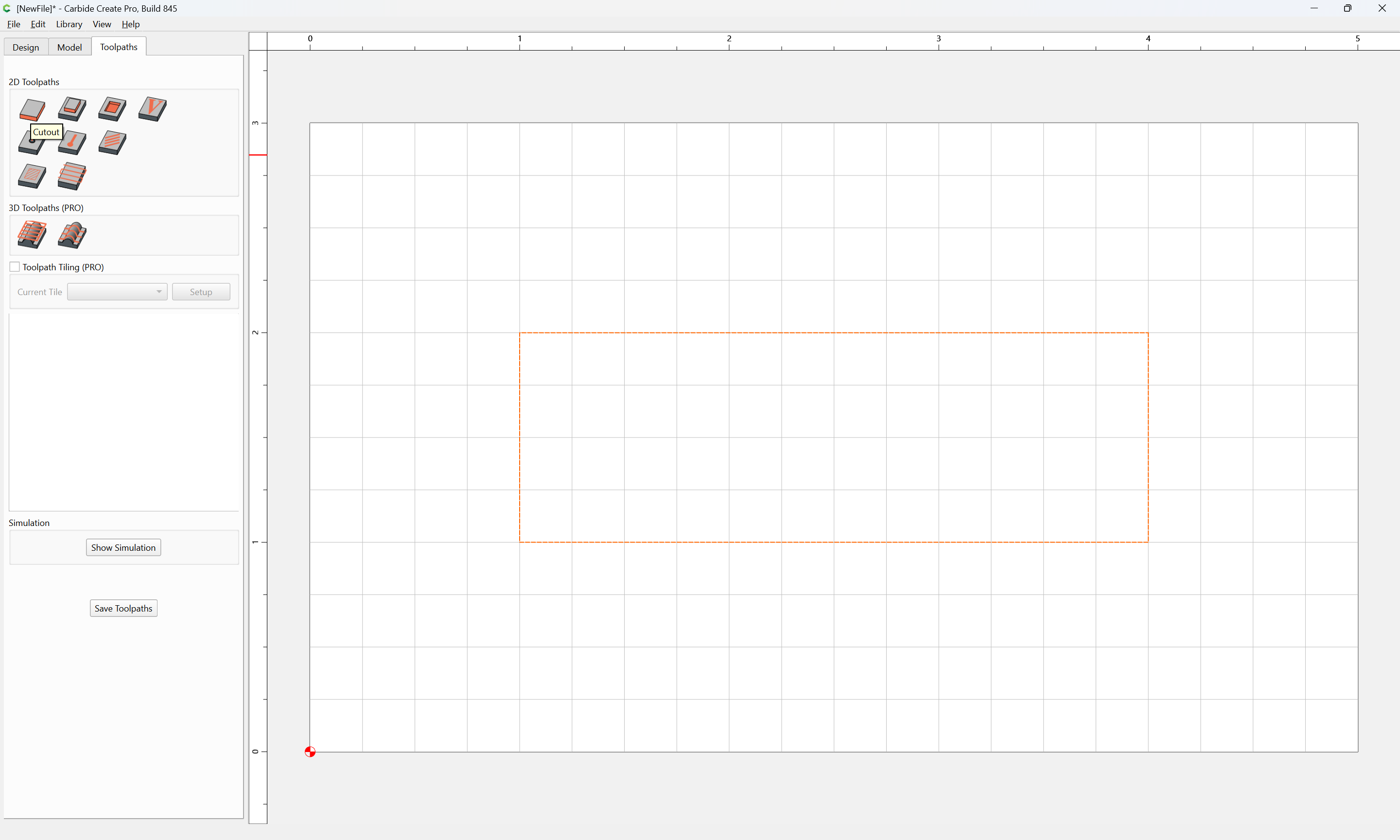

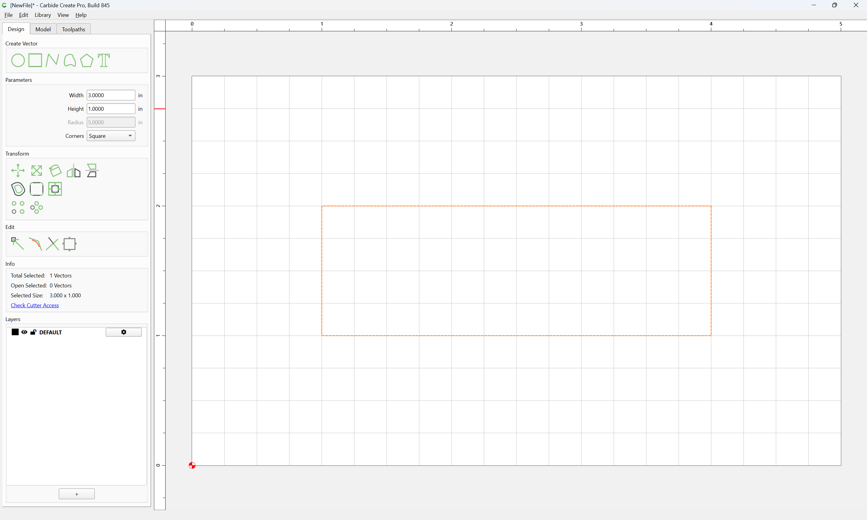

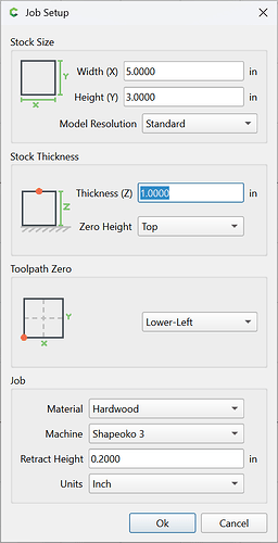

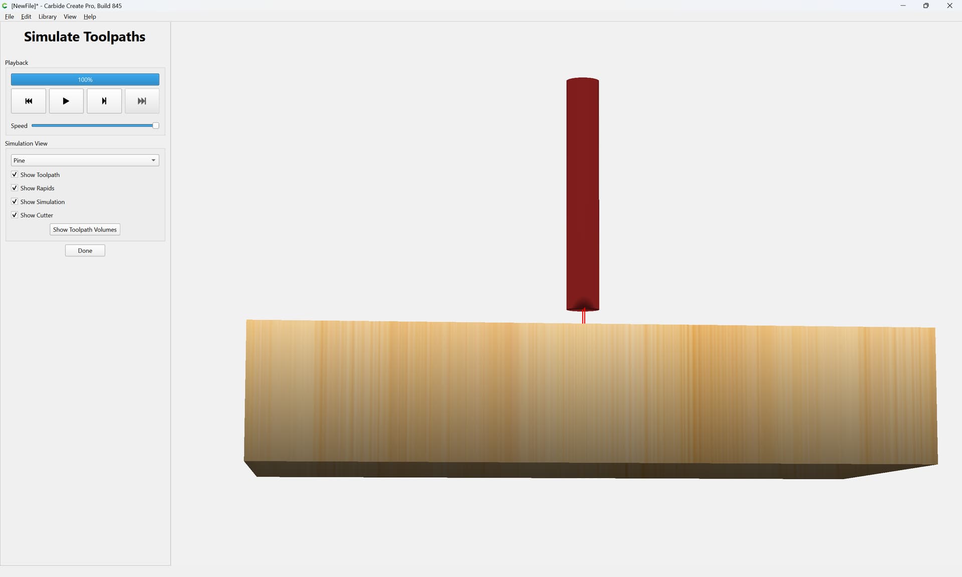

Let’s try a simple test file, and maybe I can bash this into my thick head…

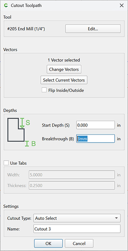

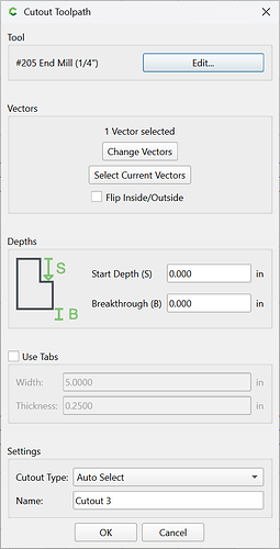

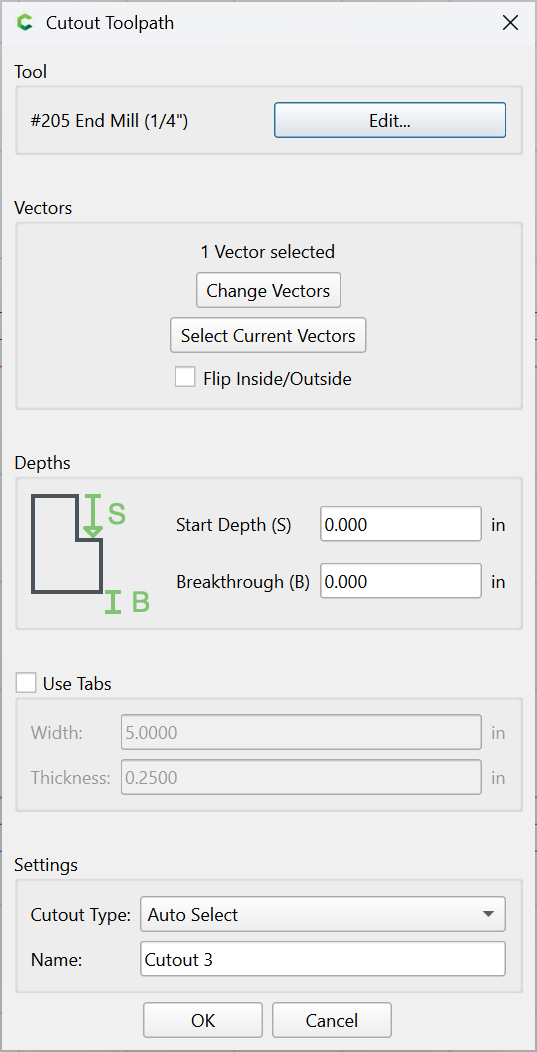

with the defaults for a Cutout toolpath:

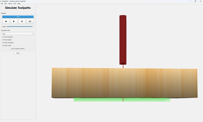

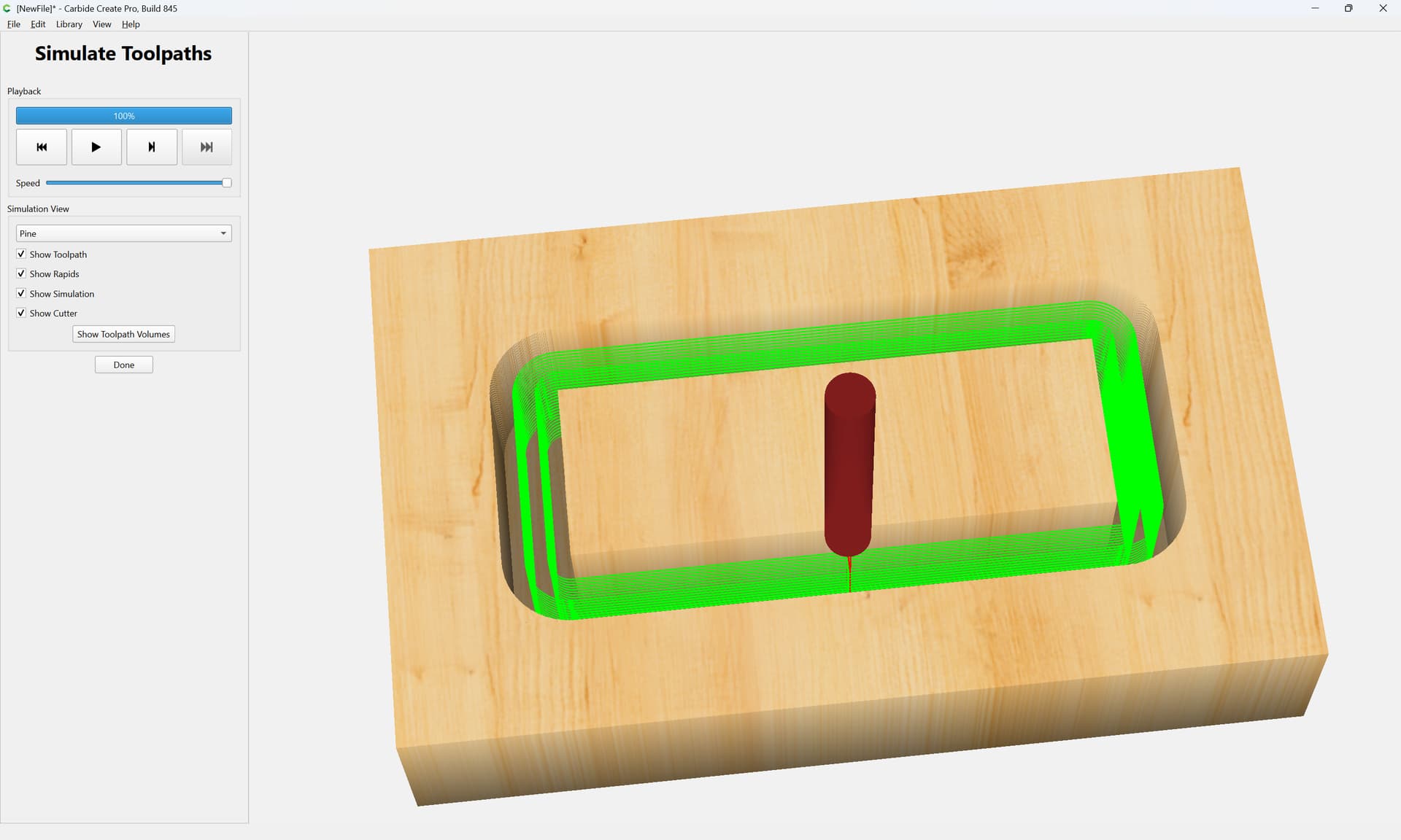

As expected, it simply cuts through:
flush with the bottom of the stock:

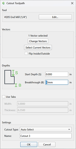

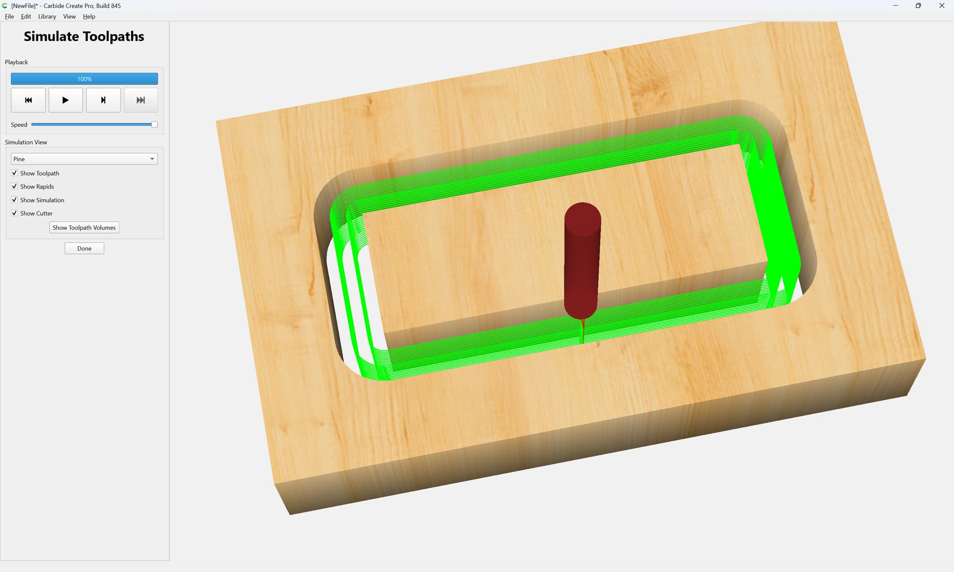

If we then change the dimension, say by Tab Height (default == 3mm):

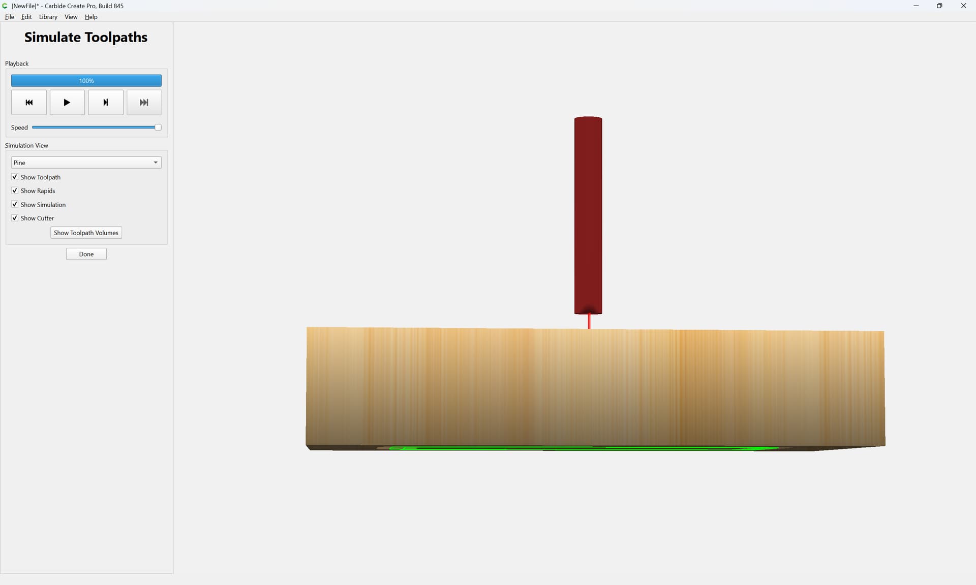

it cuts through by that additional dimension (for a positive value):

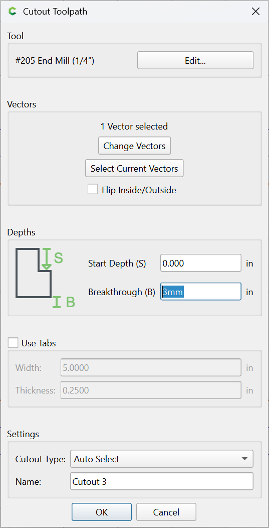

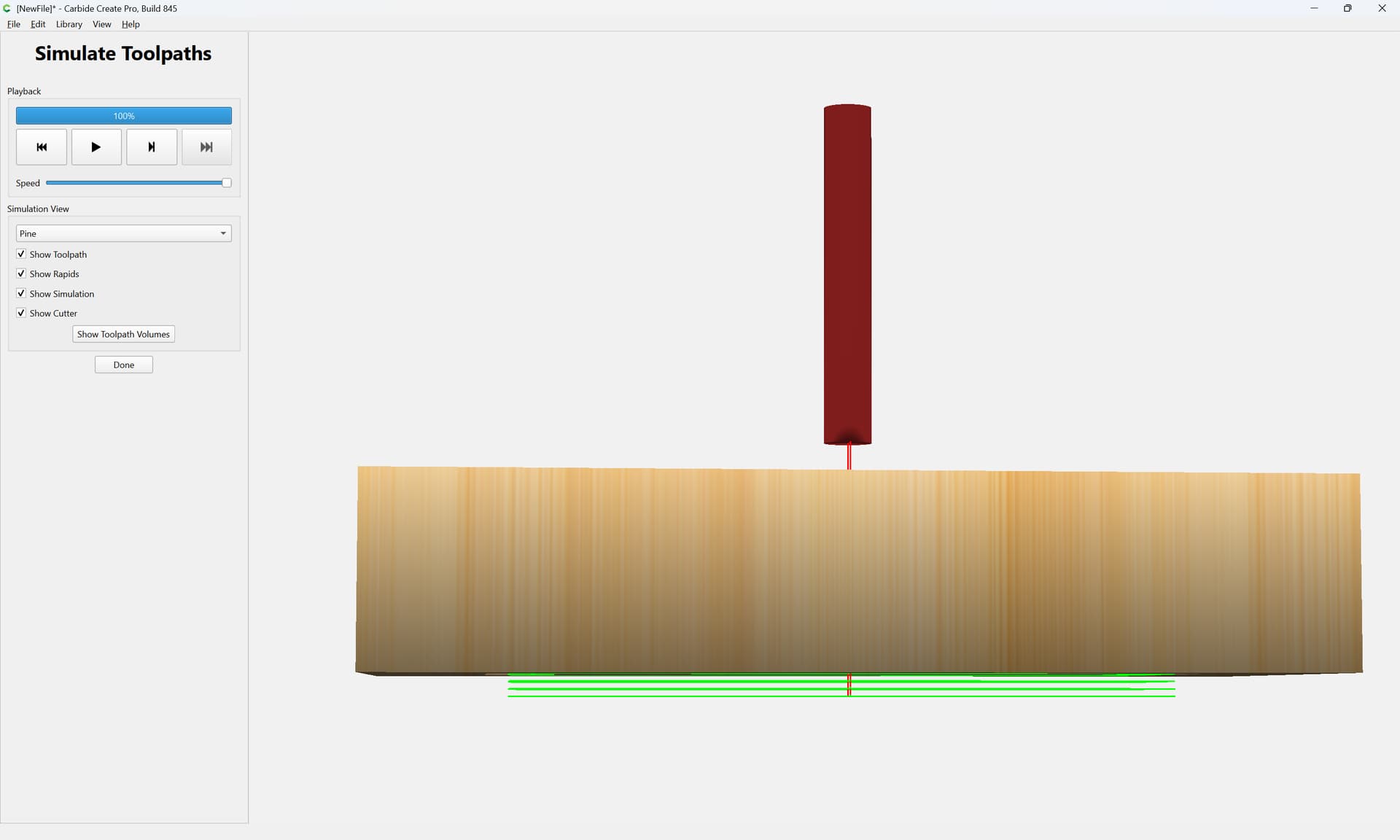

If we change it to a negative value:
then the cut falls short by that distance:
