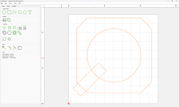

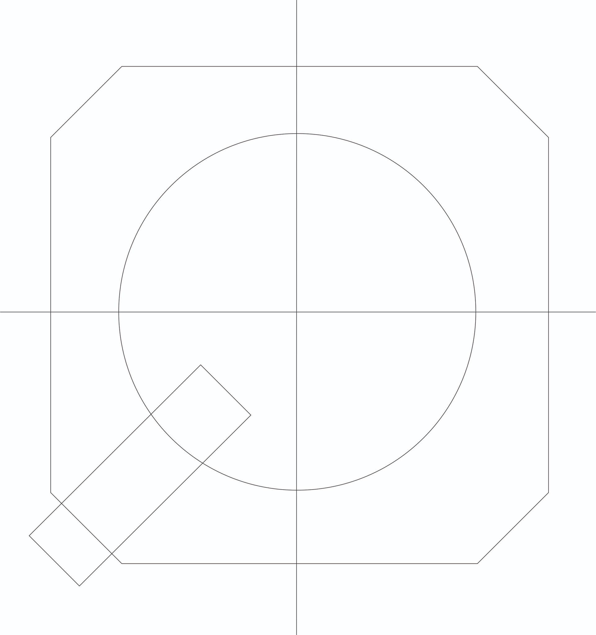

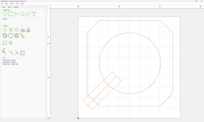

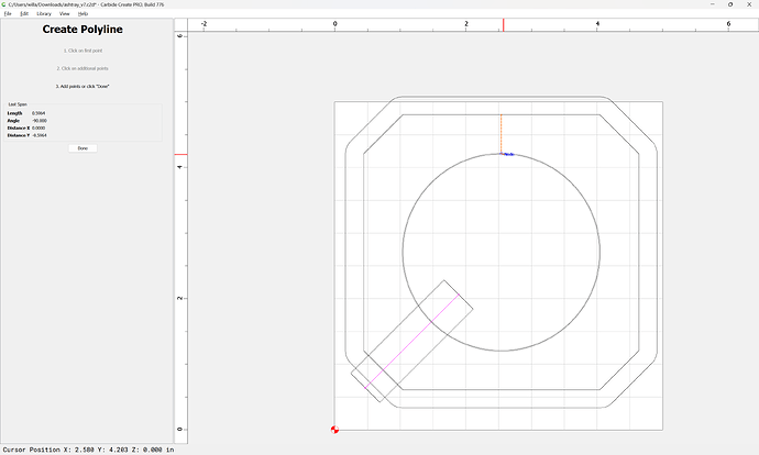

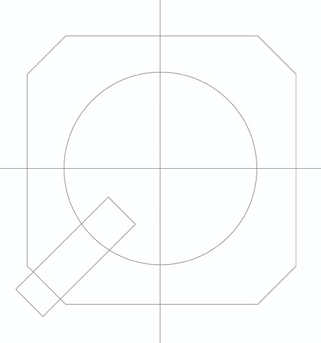

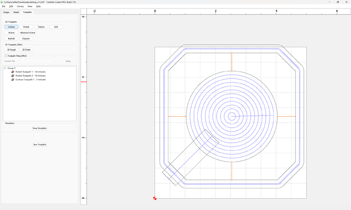

How do I create a path for a round nose bit. I tried just drawing lines, (the 2 X and Y lines) but in CC tool paths it says EMPTY TOOL PATH. Whan amI doing wrong?

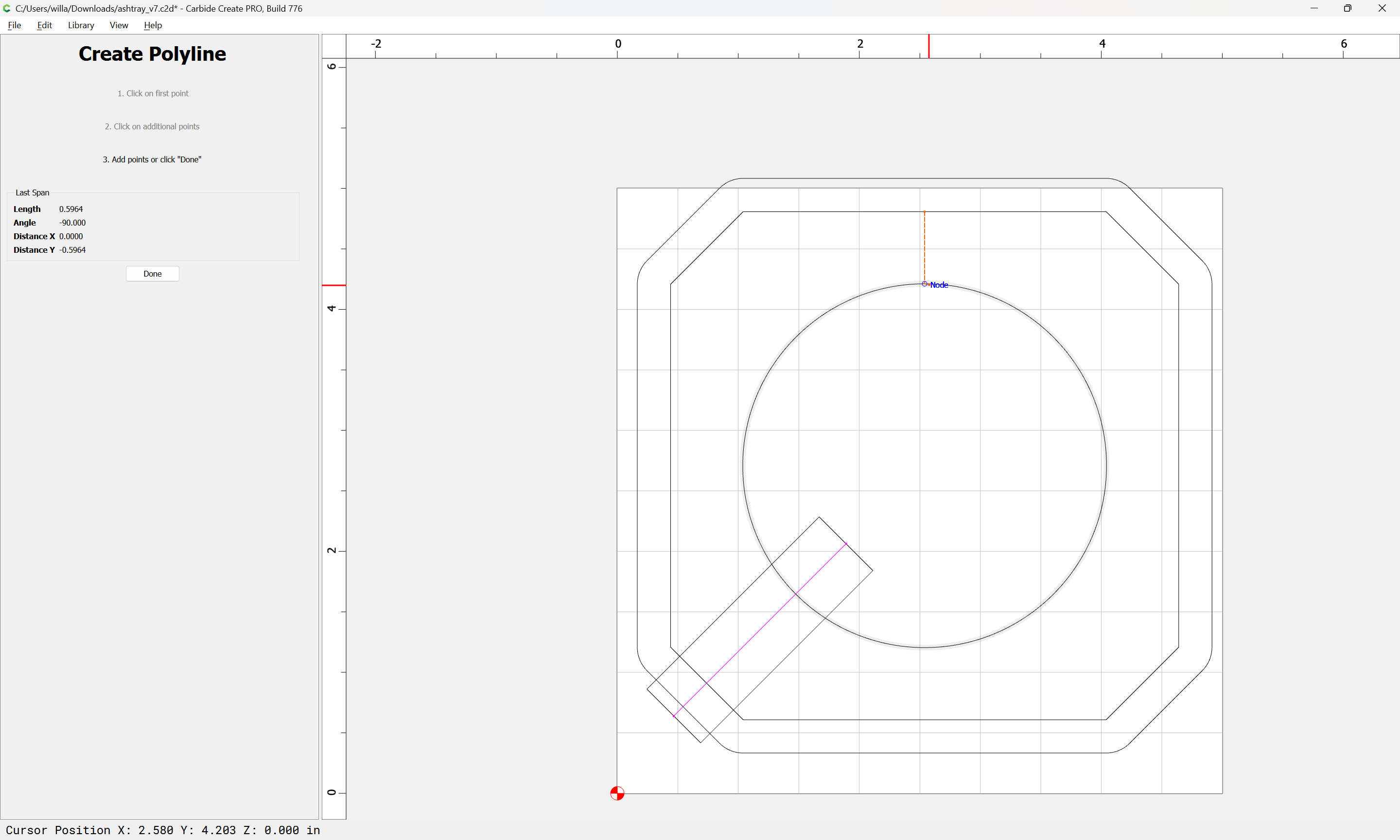

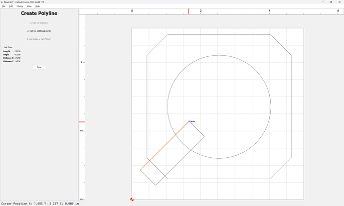

One way to do this is a single line to which a No Offset Contour toolpath is assigned:
Draw a line along one side of the rectangle:
Done

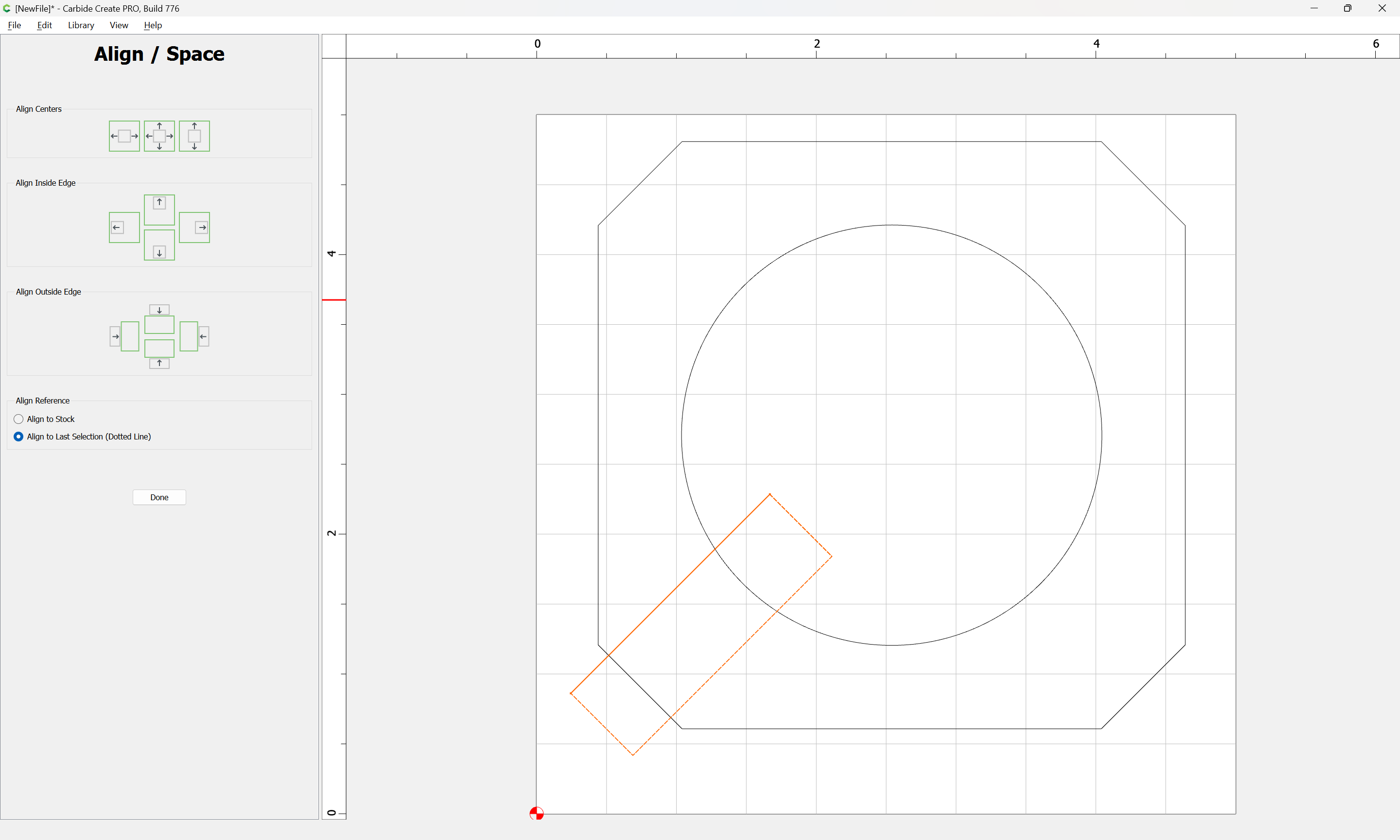

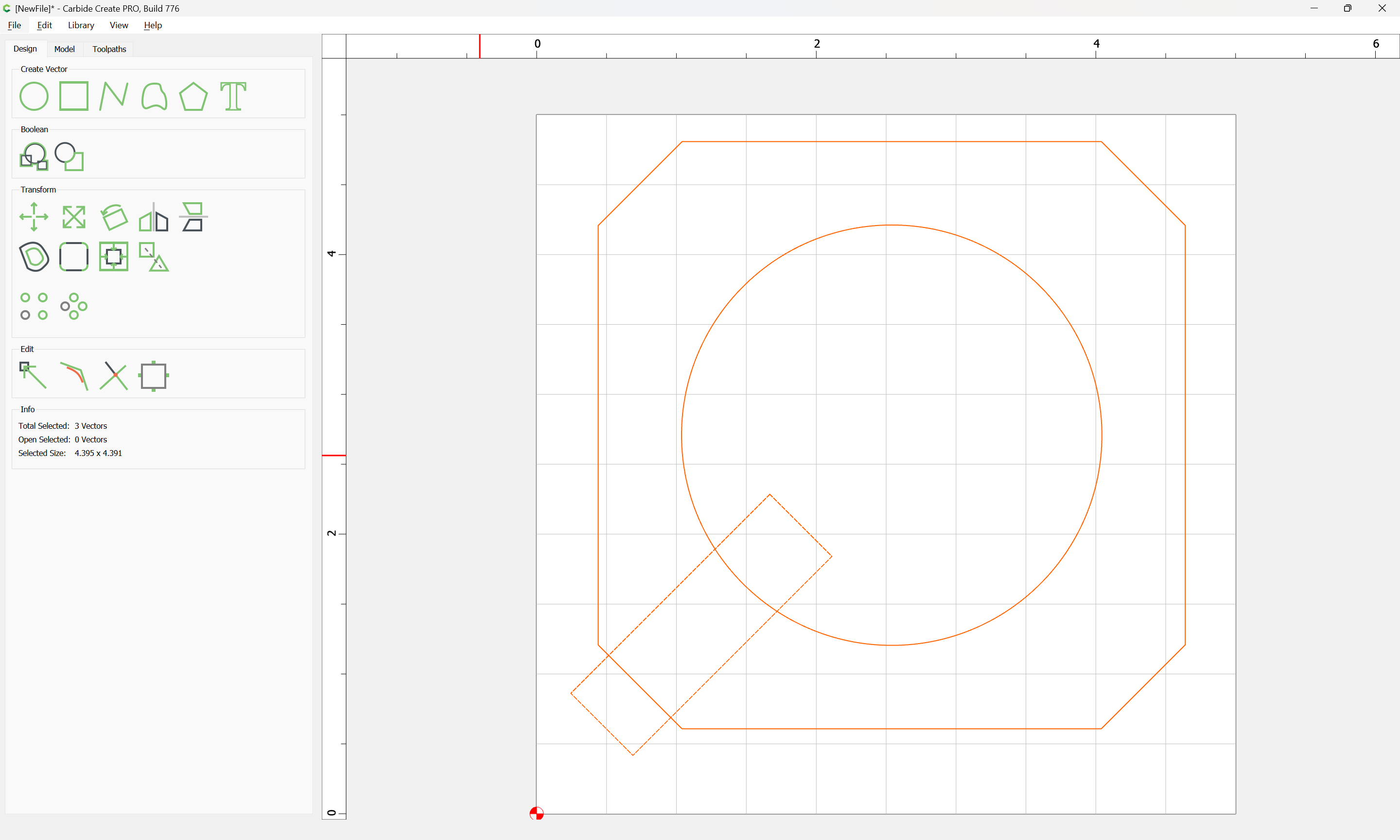

shift-click on the rectangle to add it to the selection as the key object:
Align Vectors

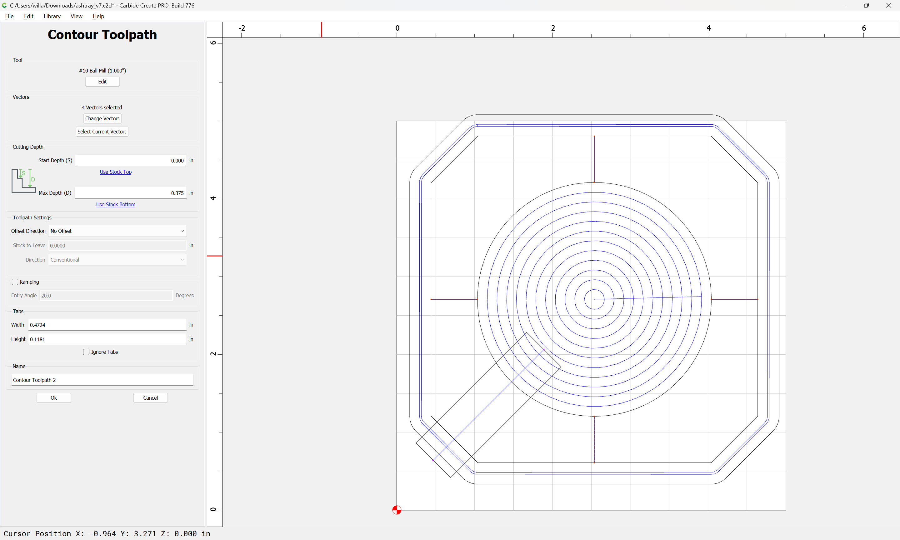

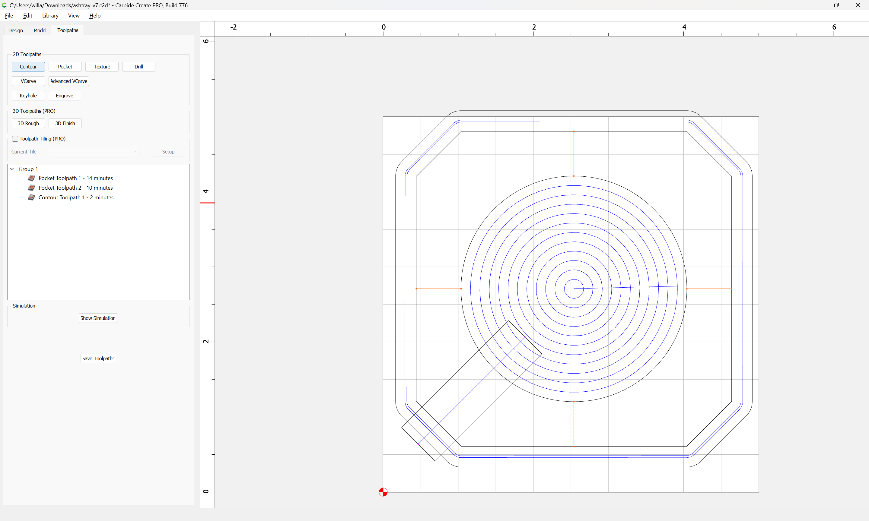

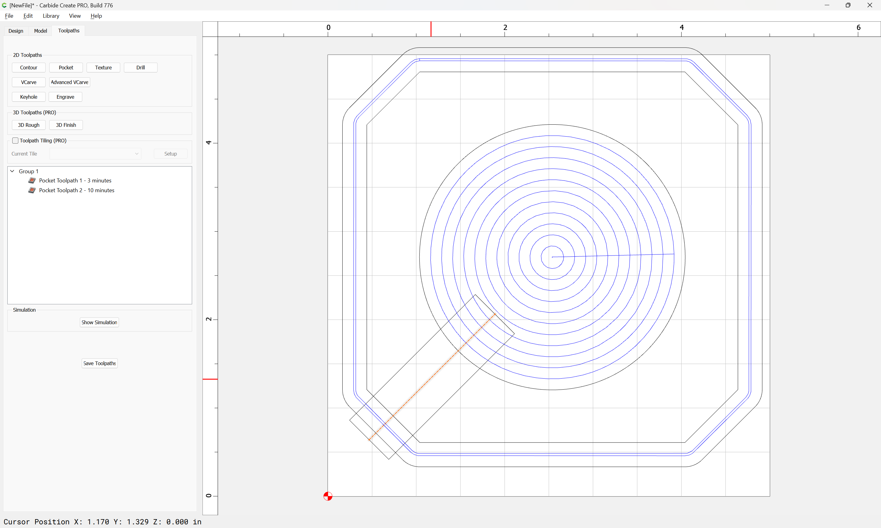

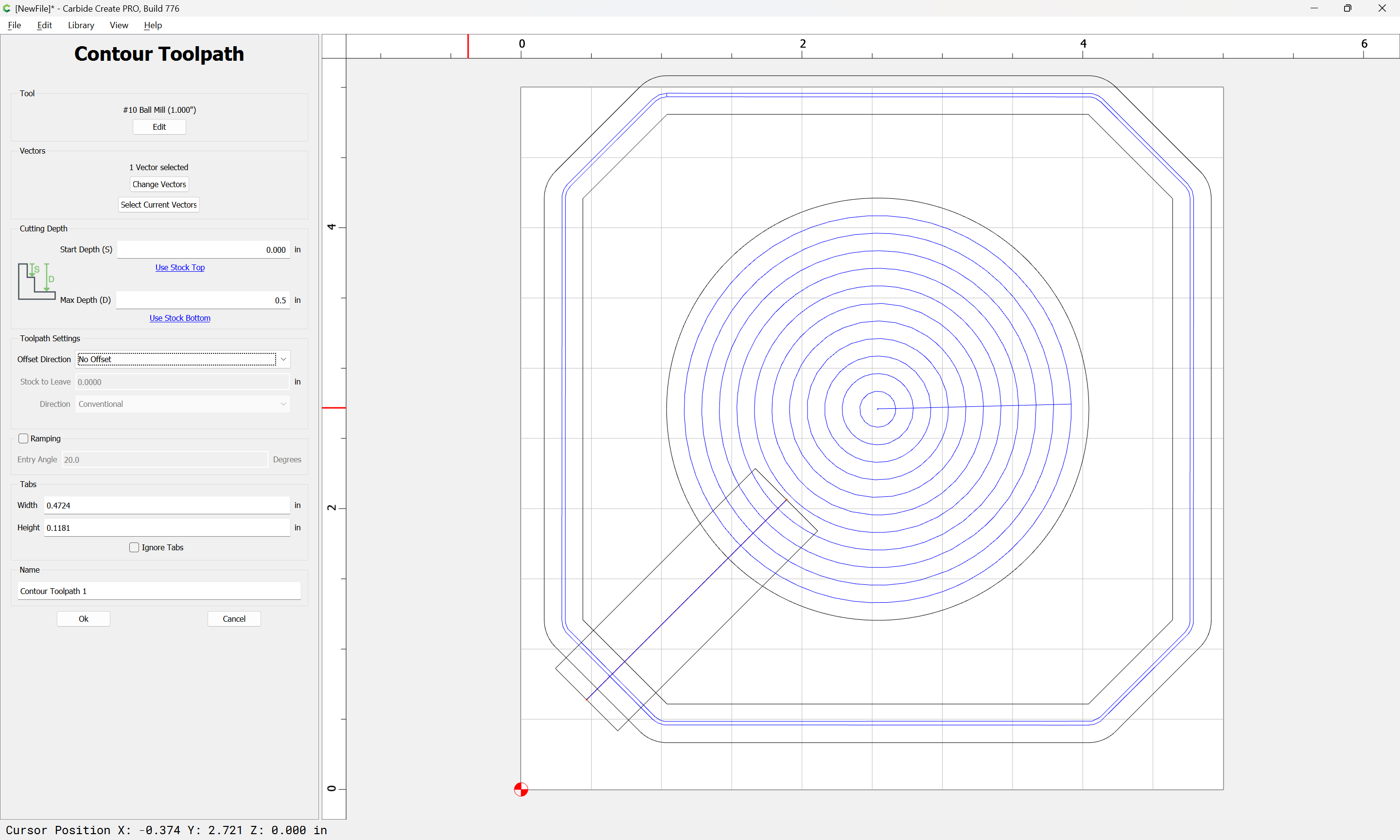

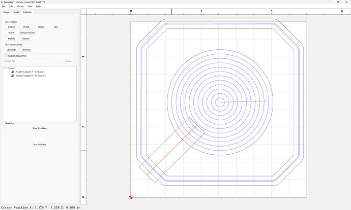

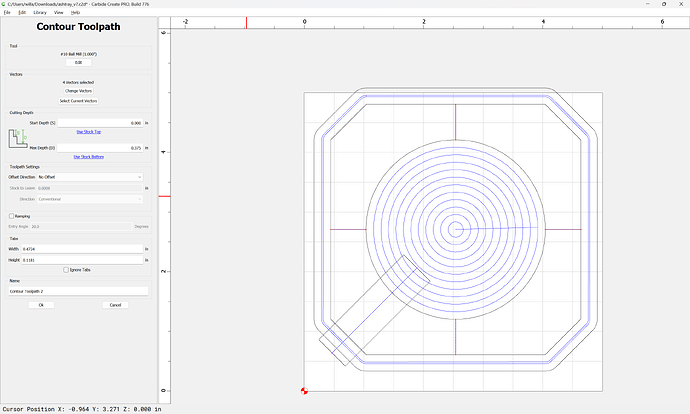

Then assign suitable toolpaths:
Attached as a v7 file.
ashtray_v7.c2d (360 KB)

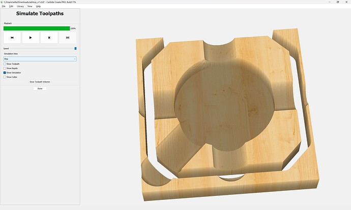

Note for using the bowl bit that you’ll want to see @KevBarn14 's video:

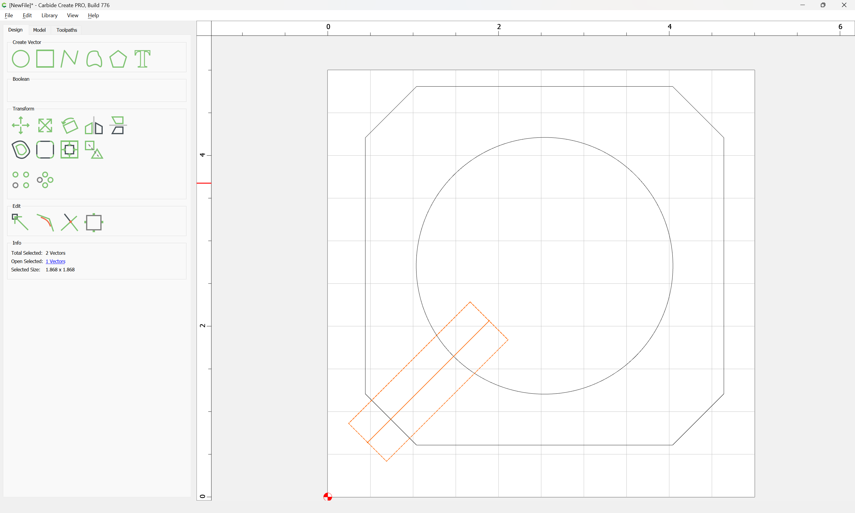

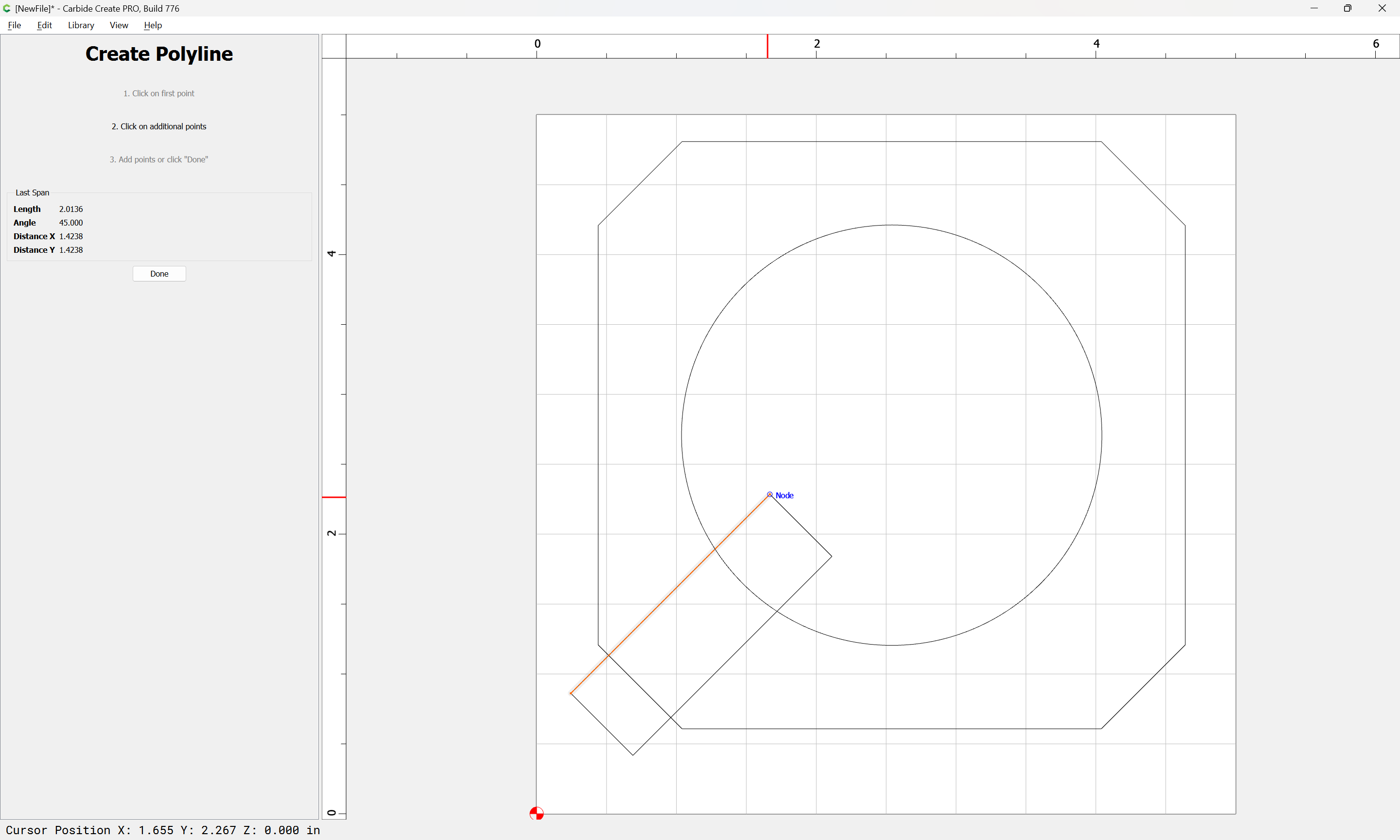

For perpendicular lines, just draw them:

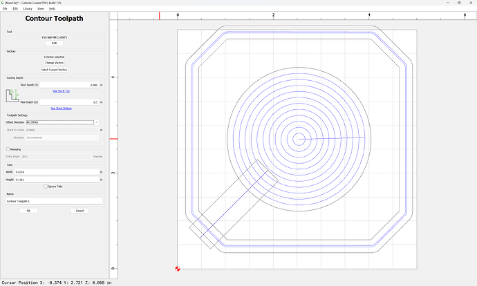

and also assign a No Offset Contour:
updated file:
ashtray_v7.c2d (364 KB)

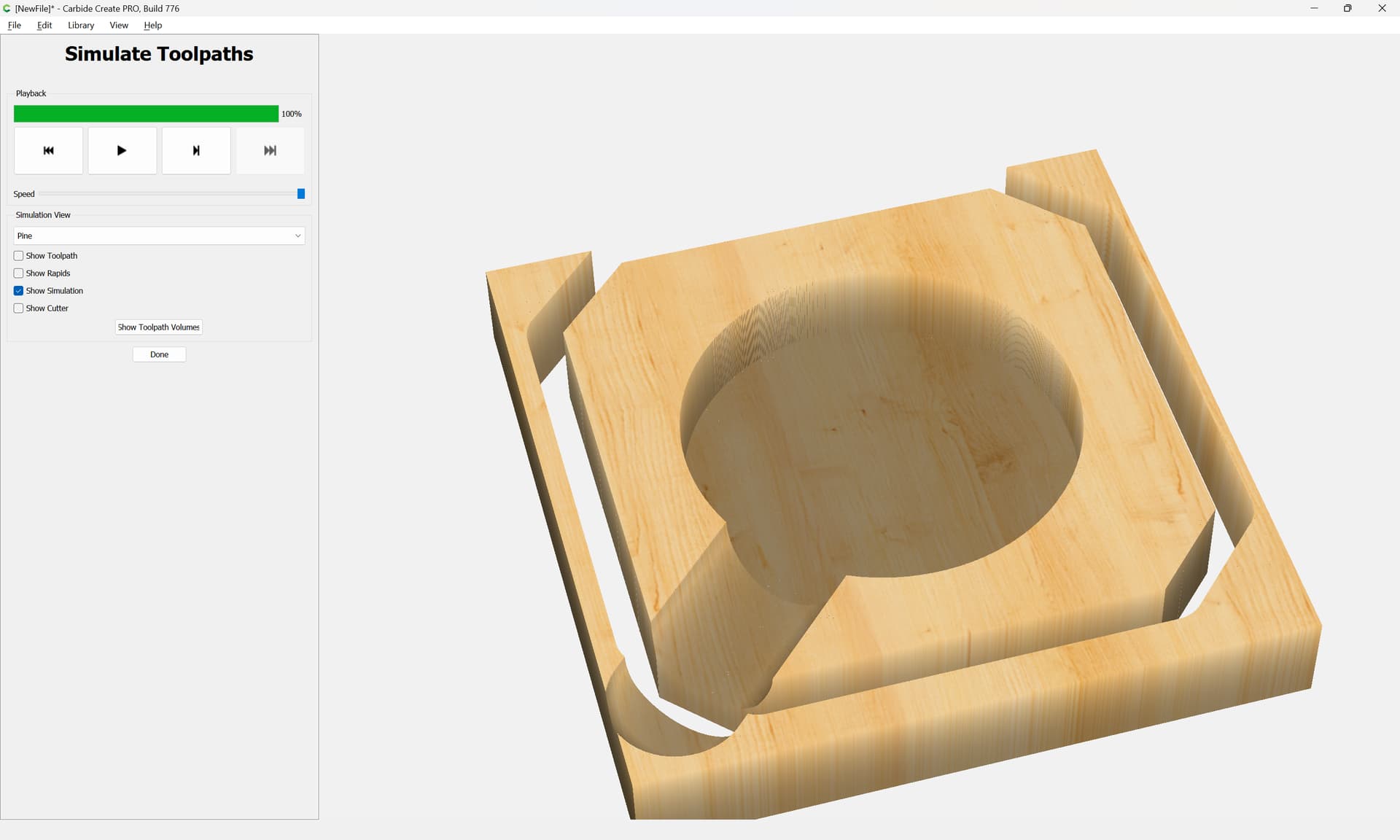

That worked out. Thanks a bunch.
@avtorres1 drop a picture here of your final product. That would put a nice bow on the discussion.
