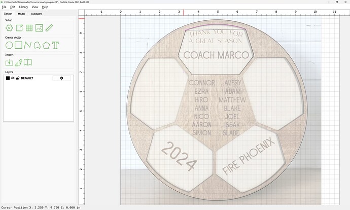

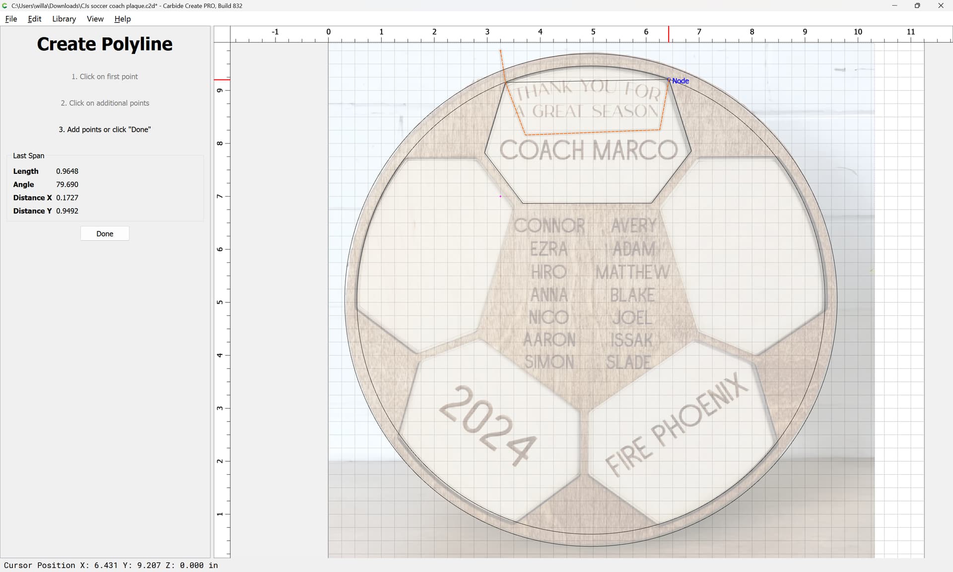

Im trying to copy a design I found online of a soccer ball plaque for my son’s coach. I am trying to figure out how to trace the pattern shapes. Is there an easier way to where I can convert the jpeg to another type of file to make tracing easier? I have attached the file with the top cut out traced except the curves. Thanks for any input

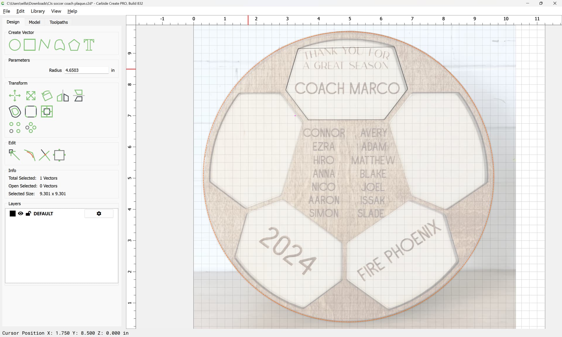

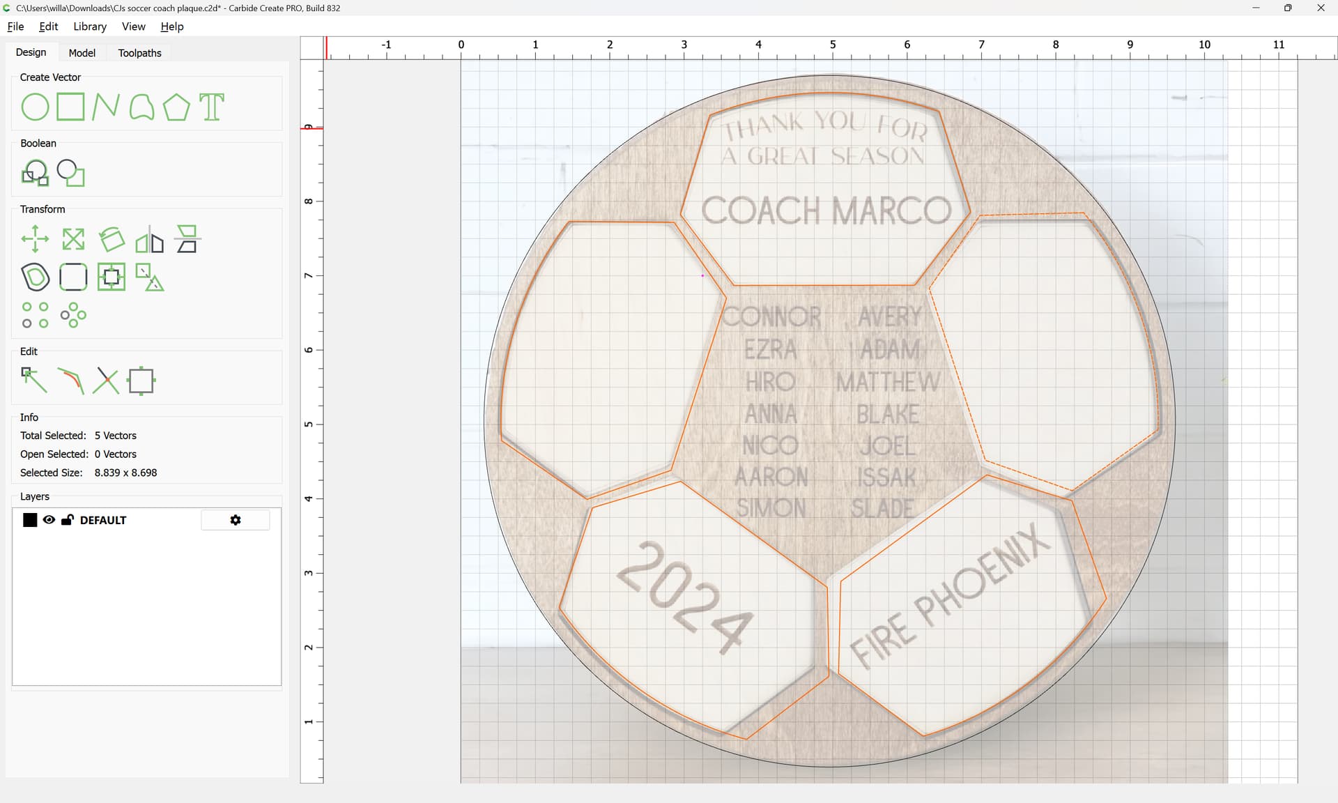

Given the file:

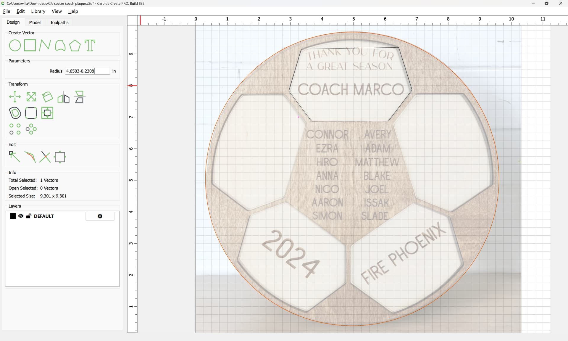

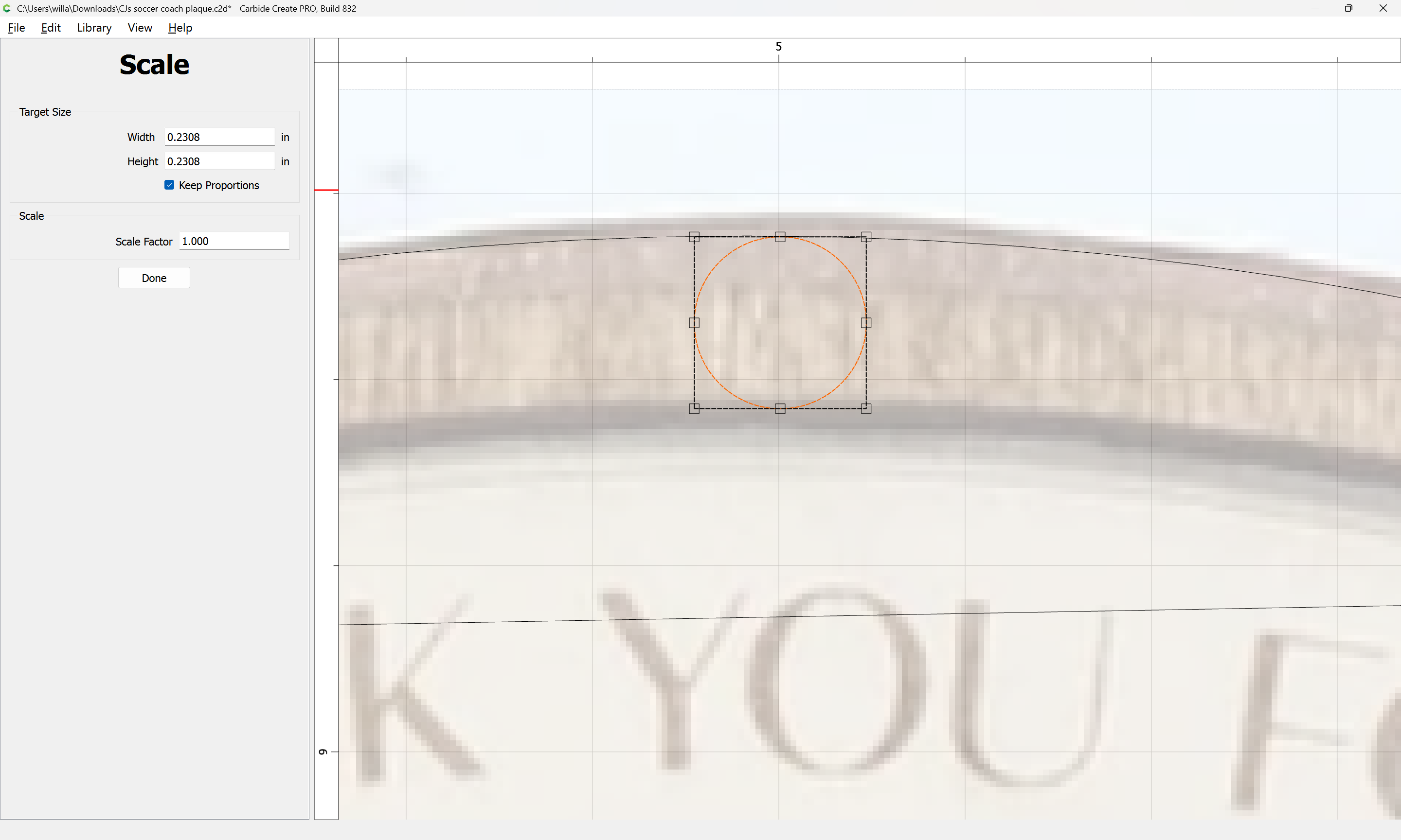

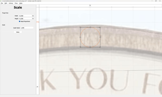

Measure the desired inset:
Select the outer circle:

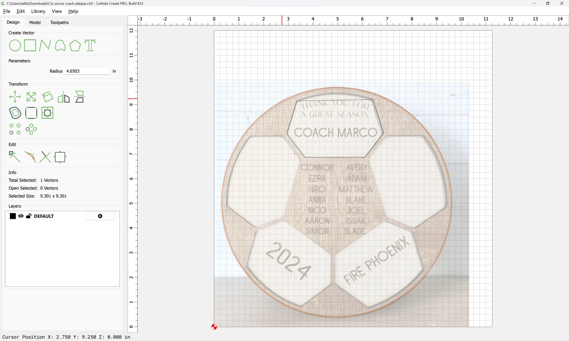

copy-paste it to make a duplicate in the same position:
Then reduce that copy by that dimension:

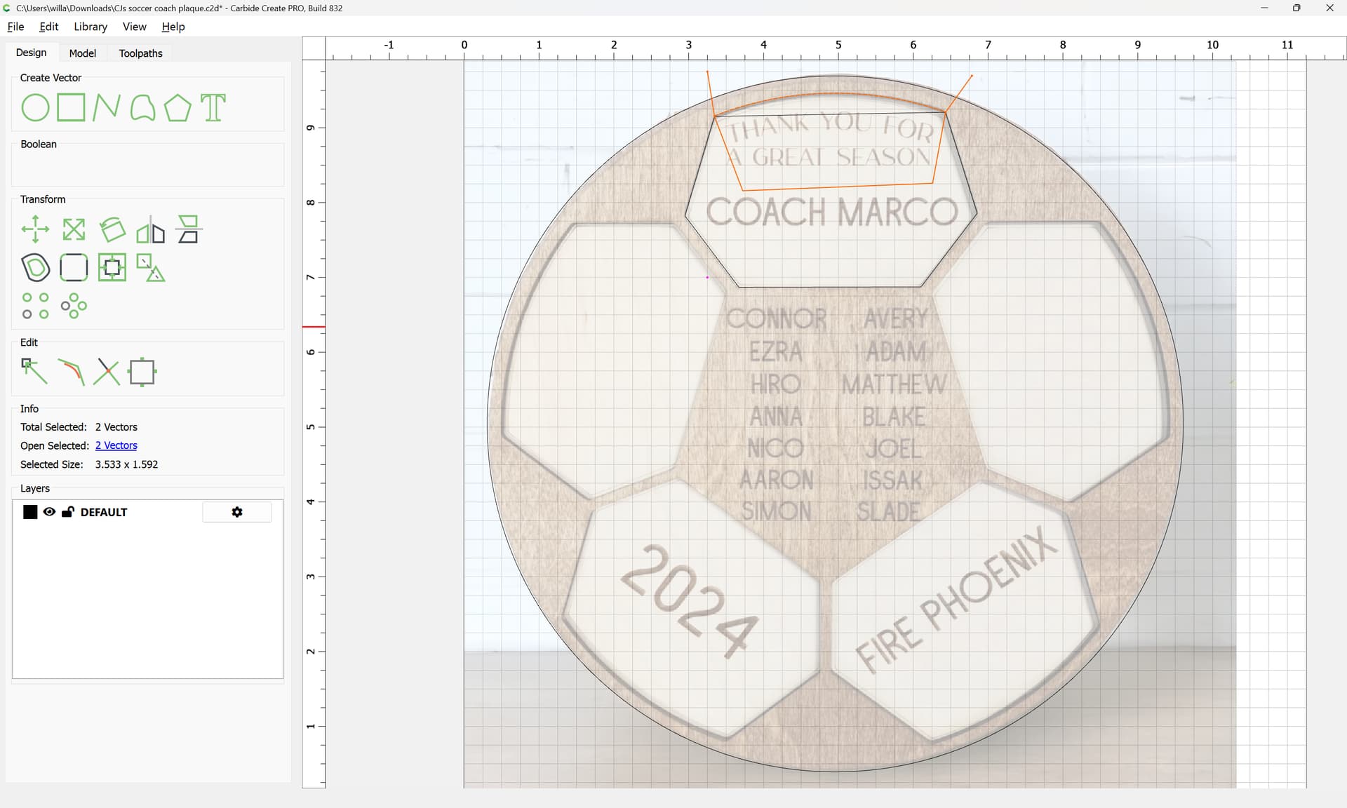

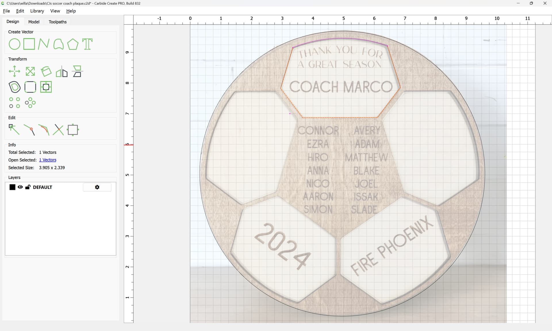

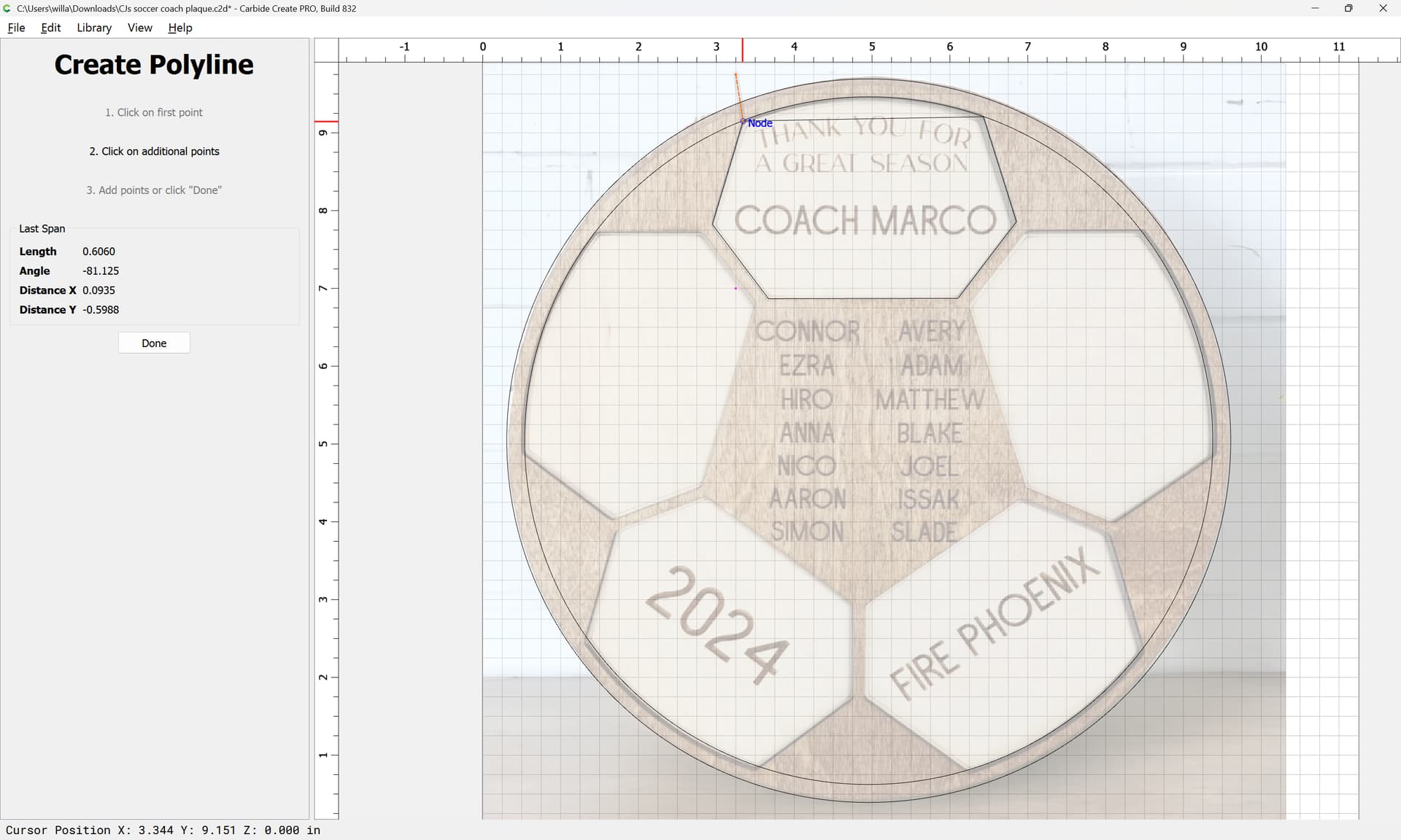

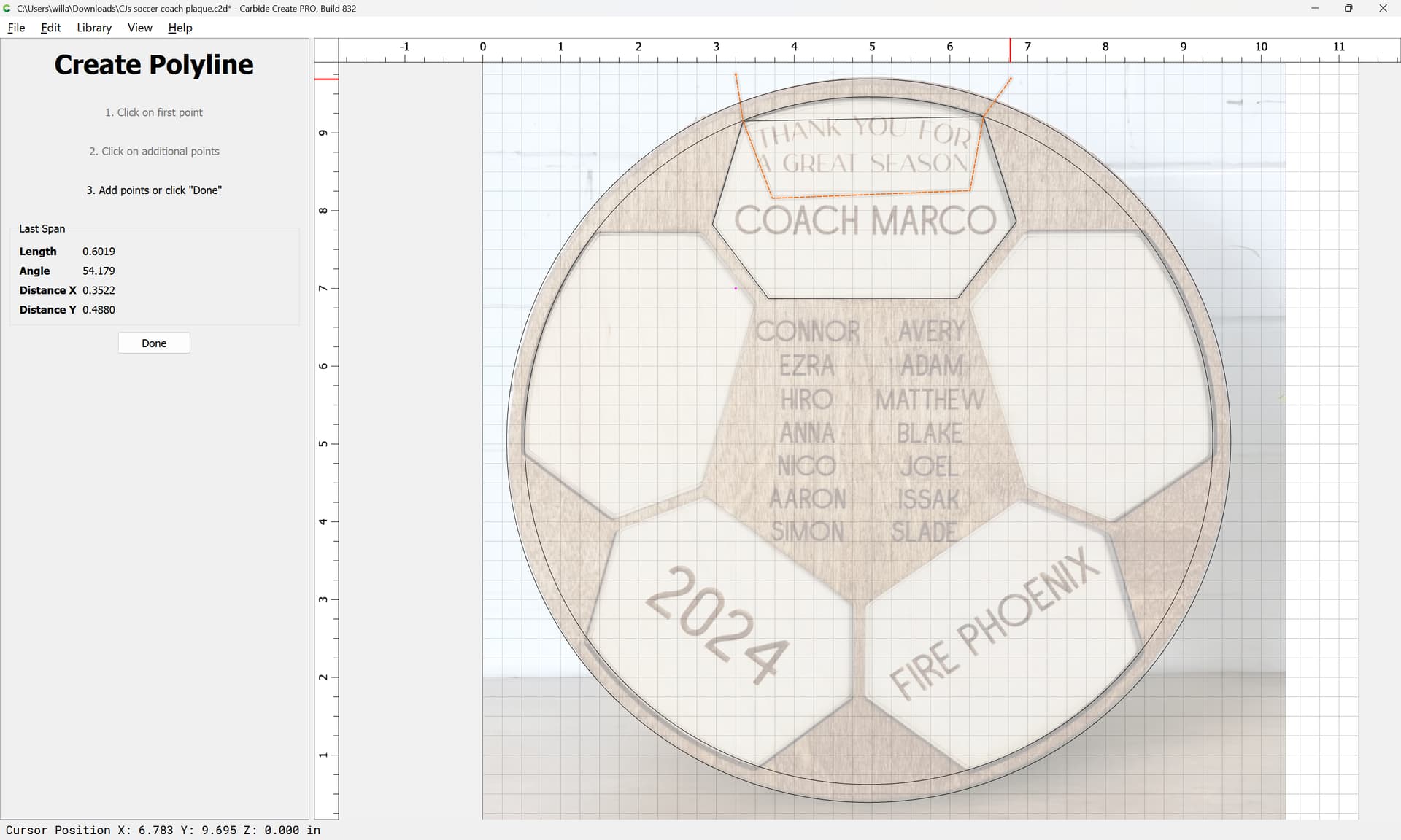

Draw geometry to define where you want the cuts made:
Done

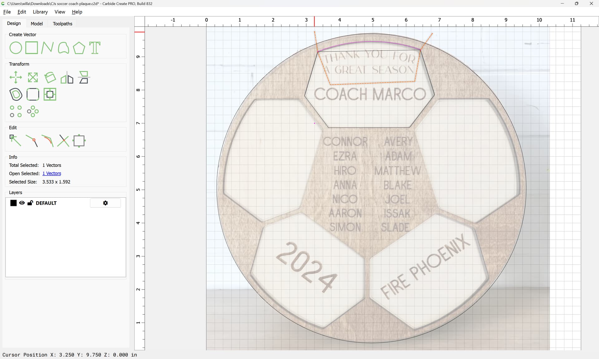

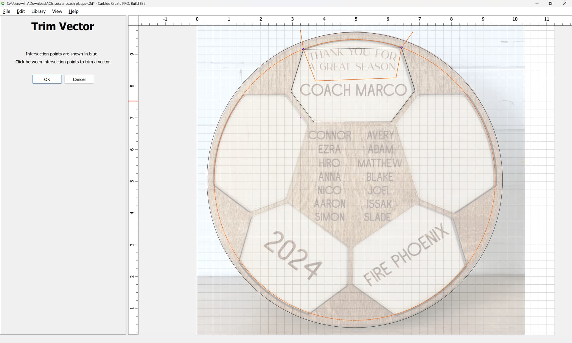

Shift-click on the circle to add it to the selection:

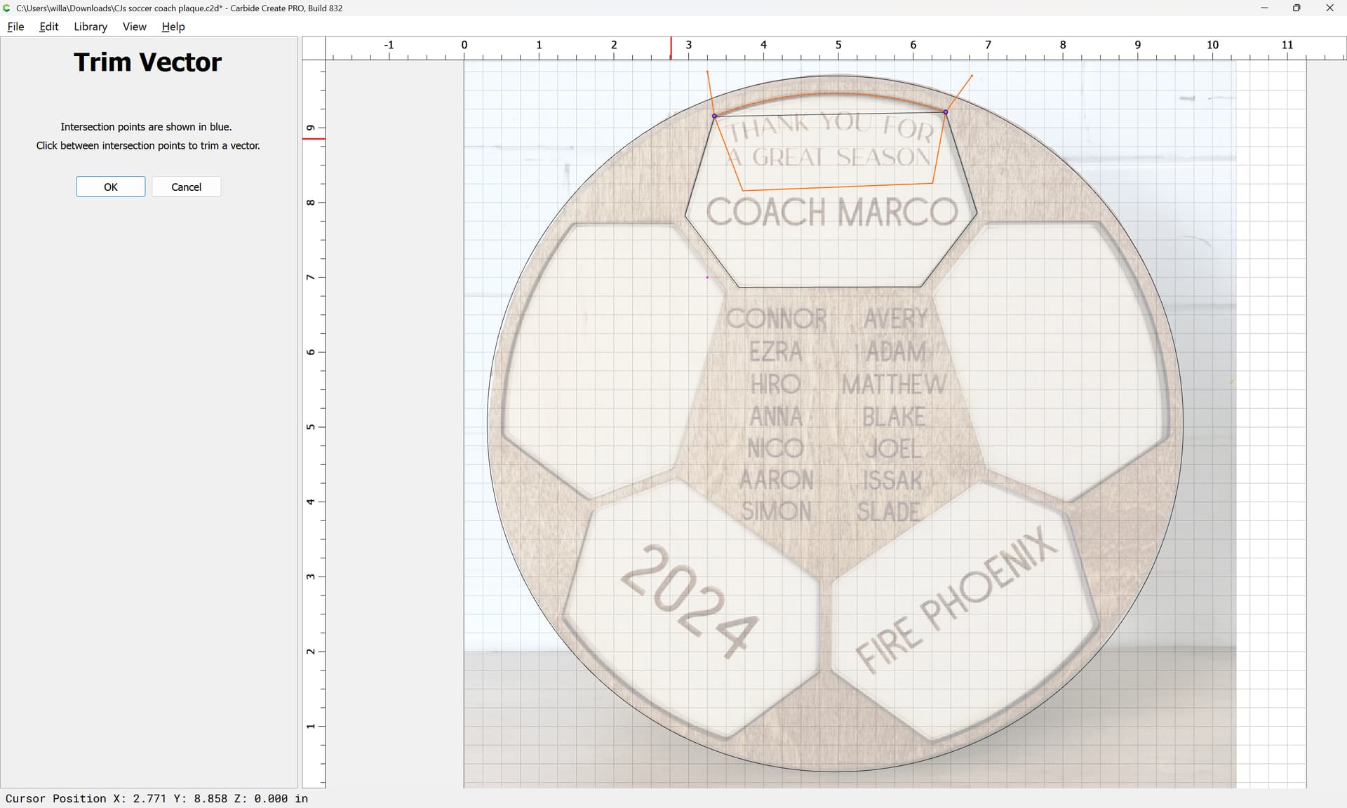

and use Trim Vectors:
to remove what is not wanted:
Ok

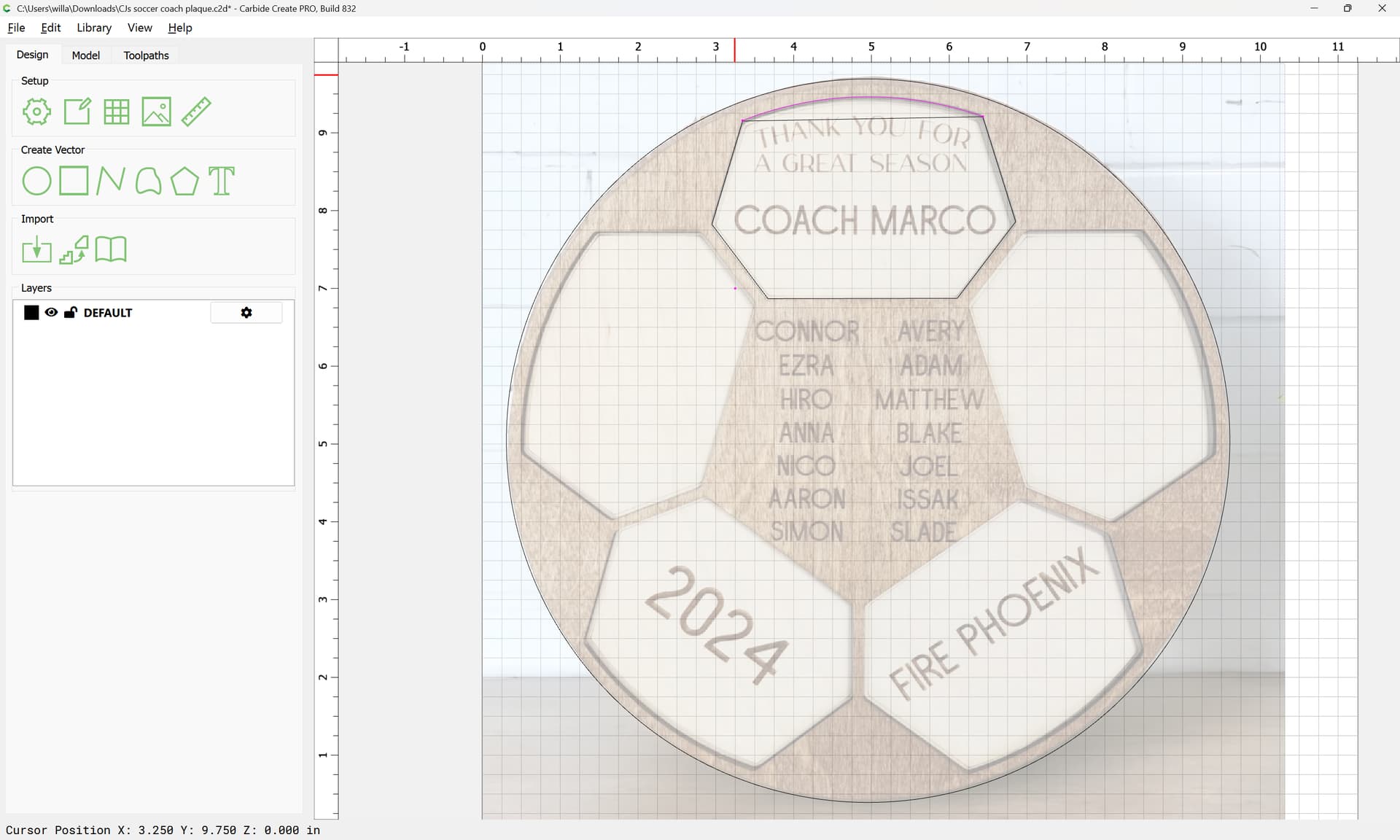

shift-click on what is wanted to remove it from the selection:
and delete the marking geometry:

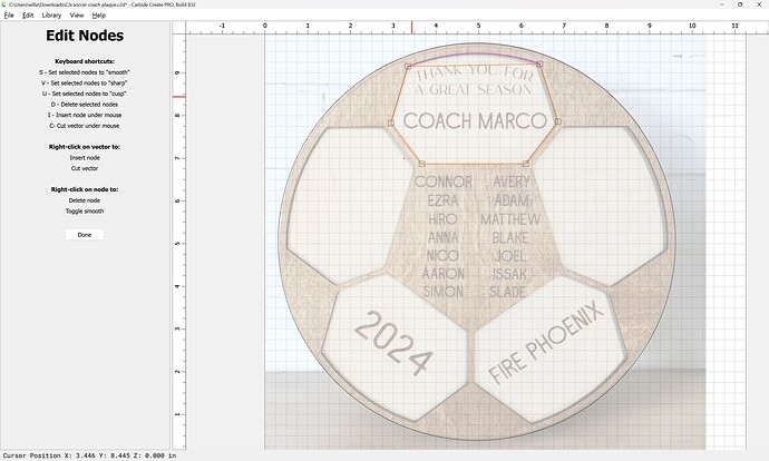

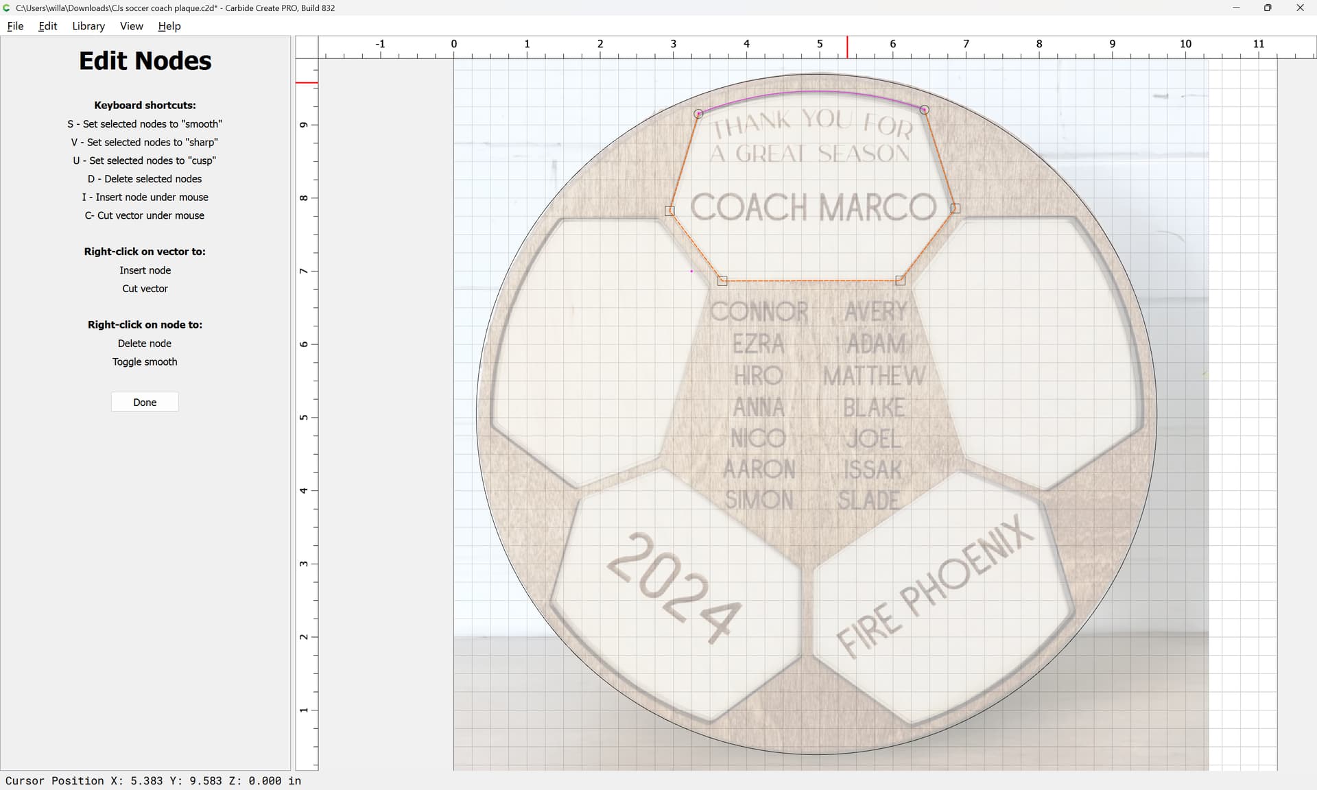

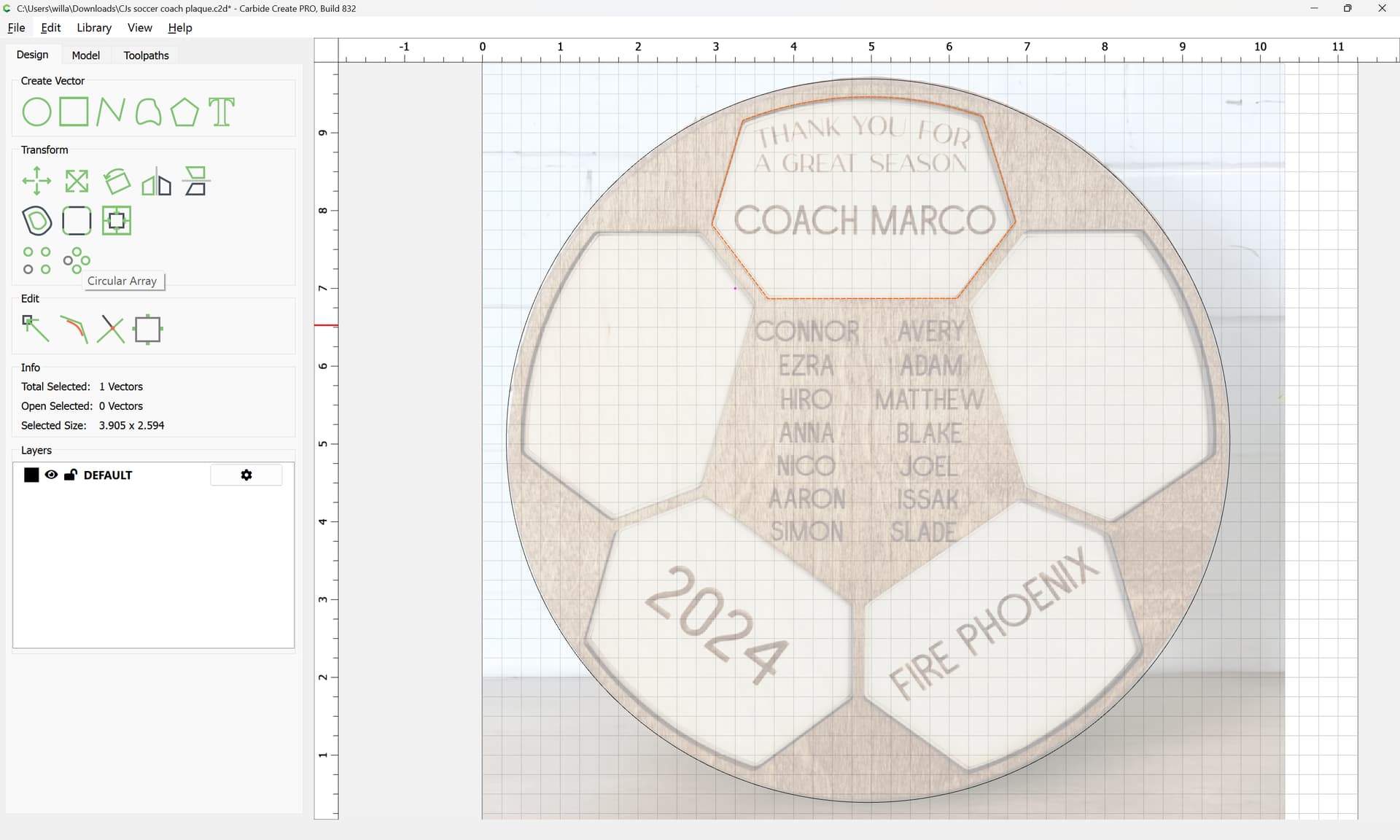

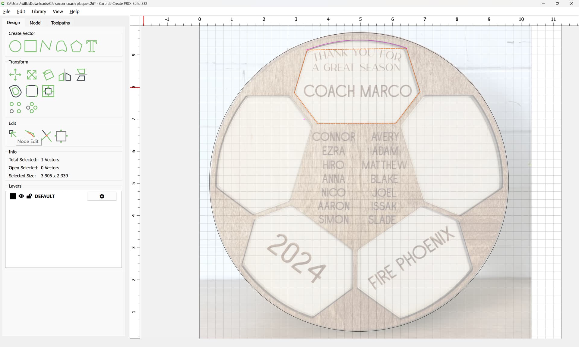

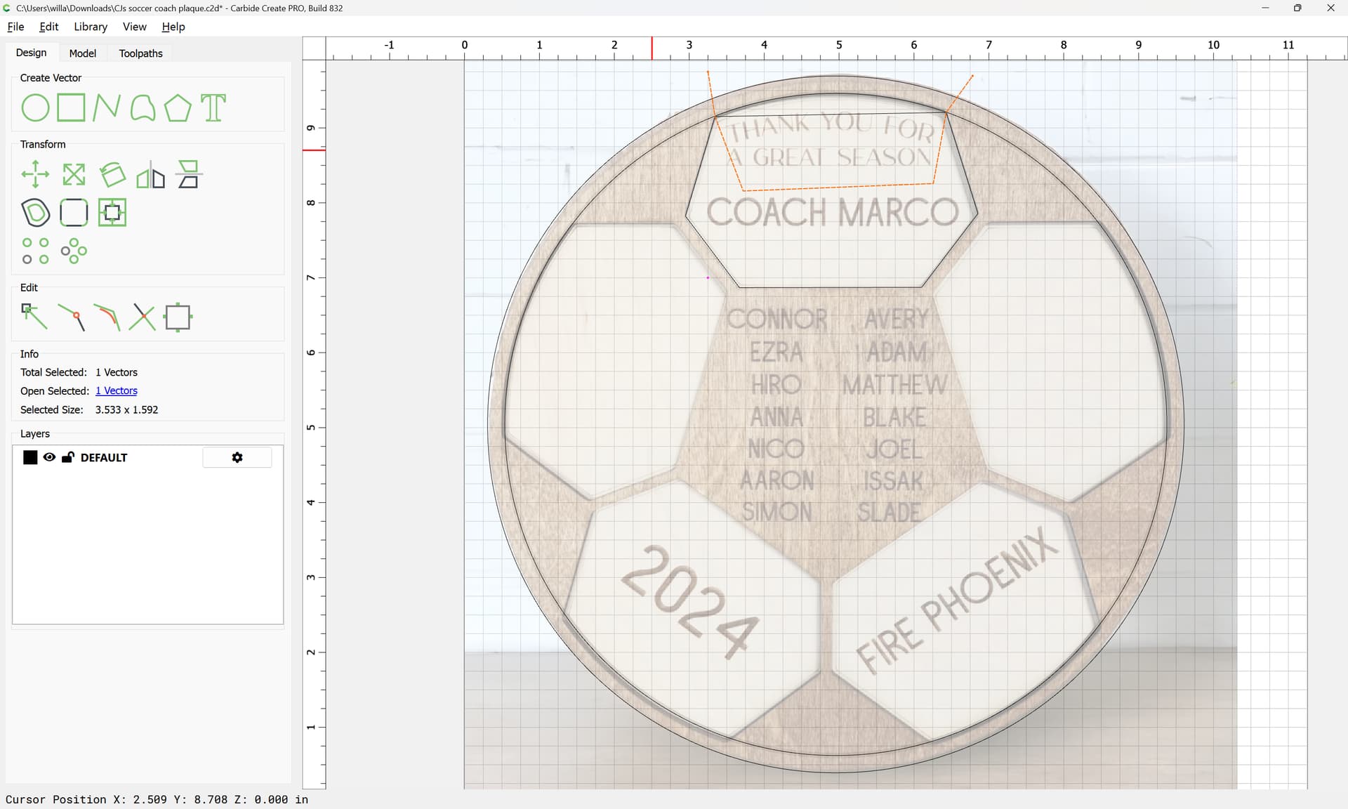

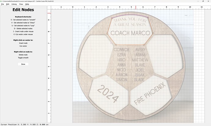

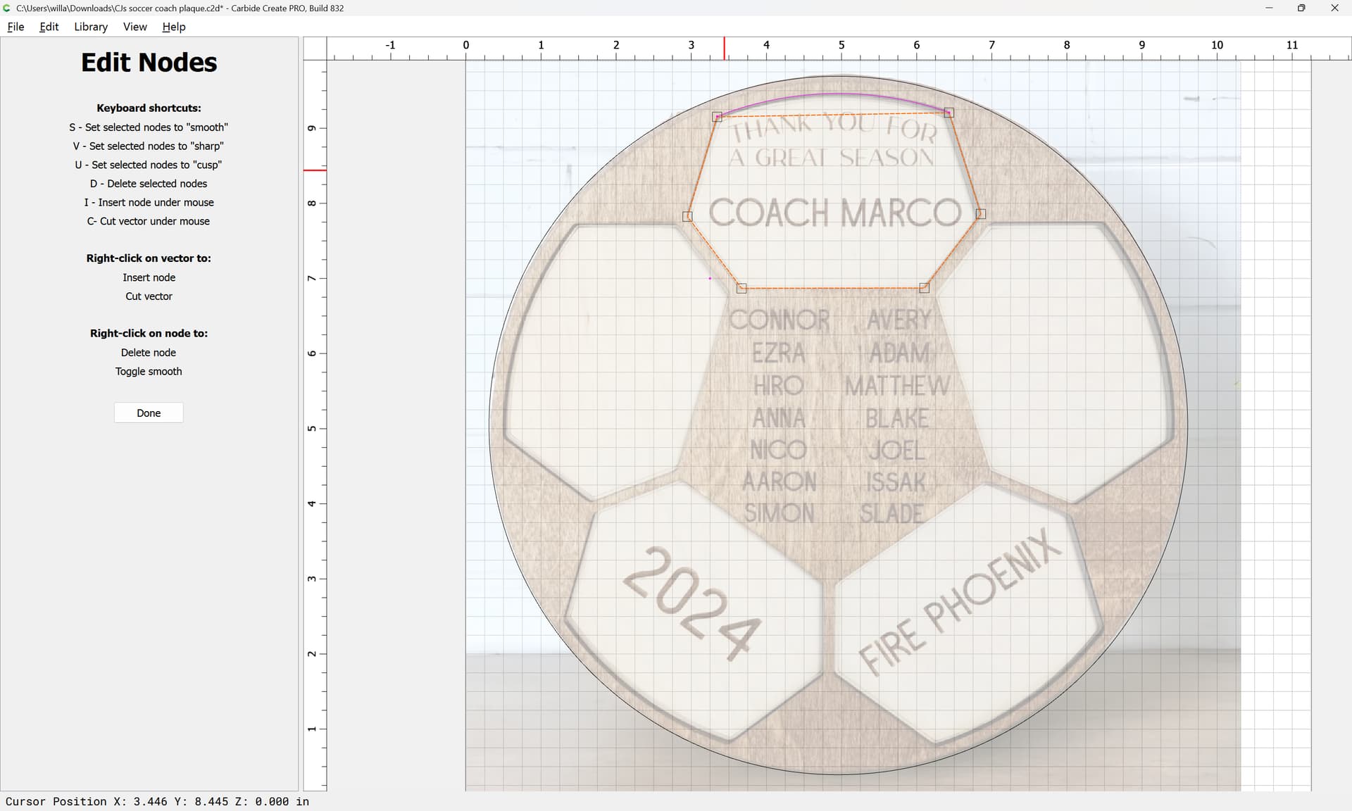

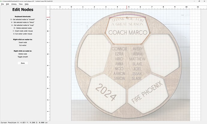

Select the geometry which one wishes to add to:

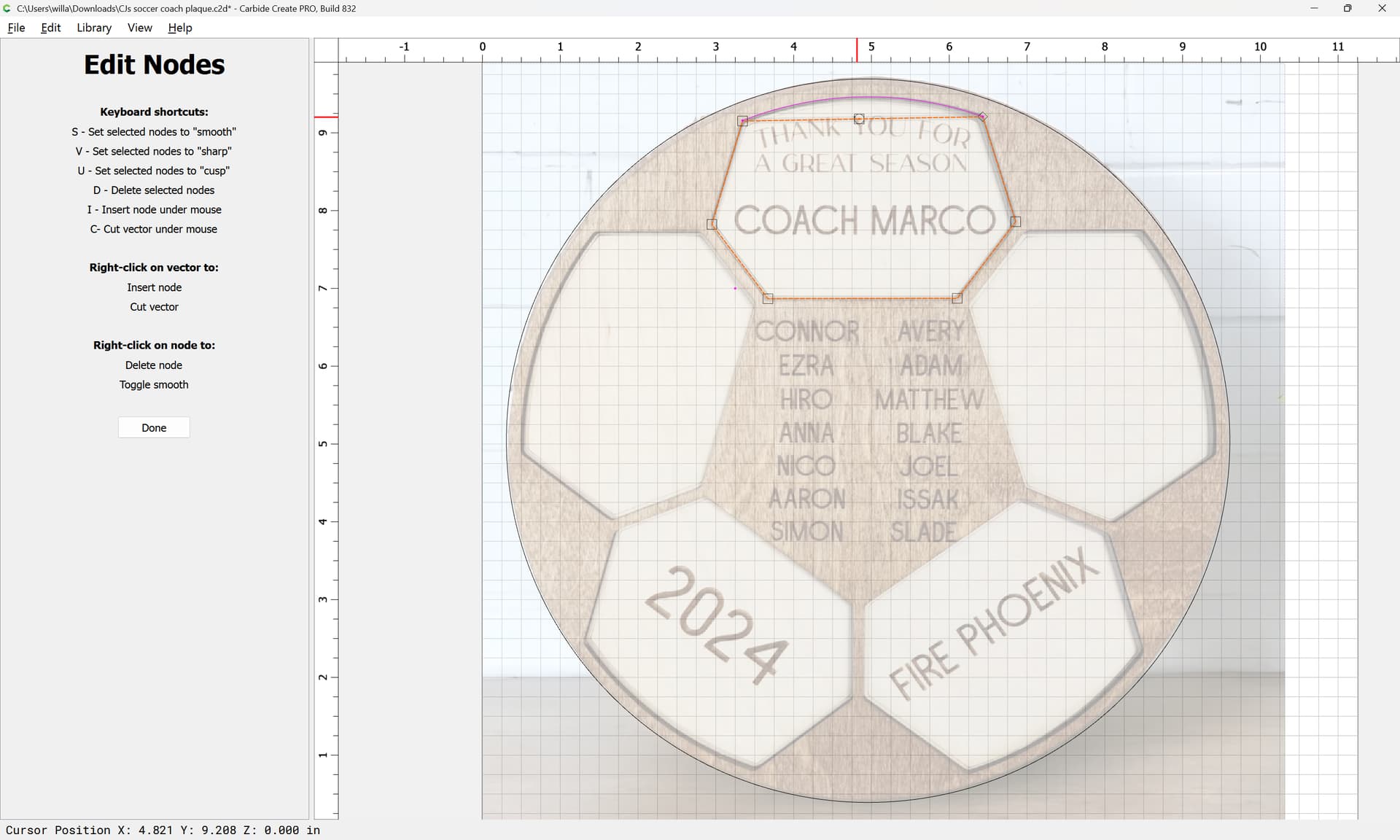

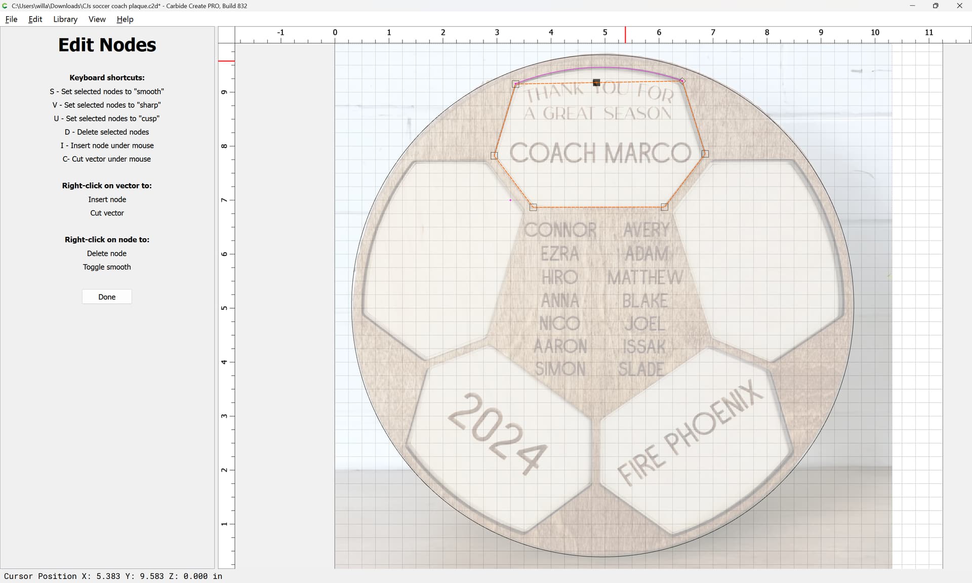

and use Node Editing:

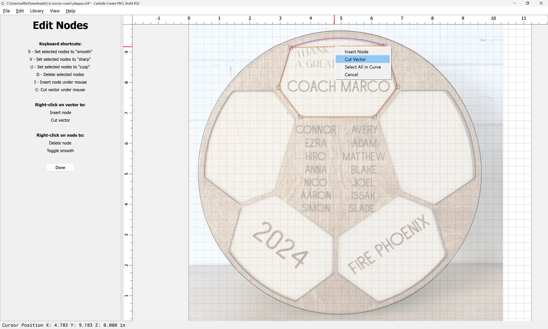

to right-click:
and Cut Vector:

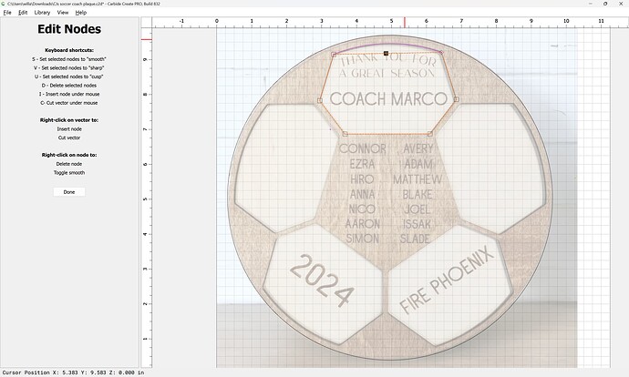

Select the begin/end nodes:
and press d to delete:
Done

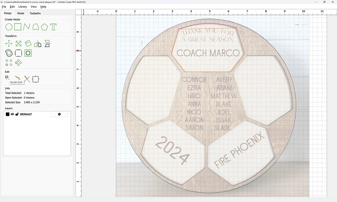

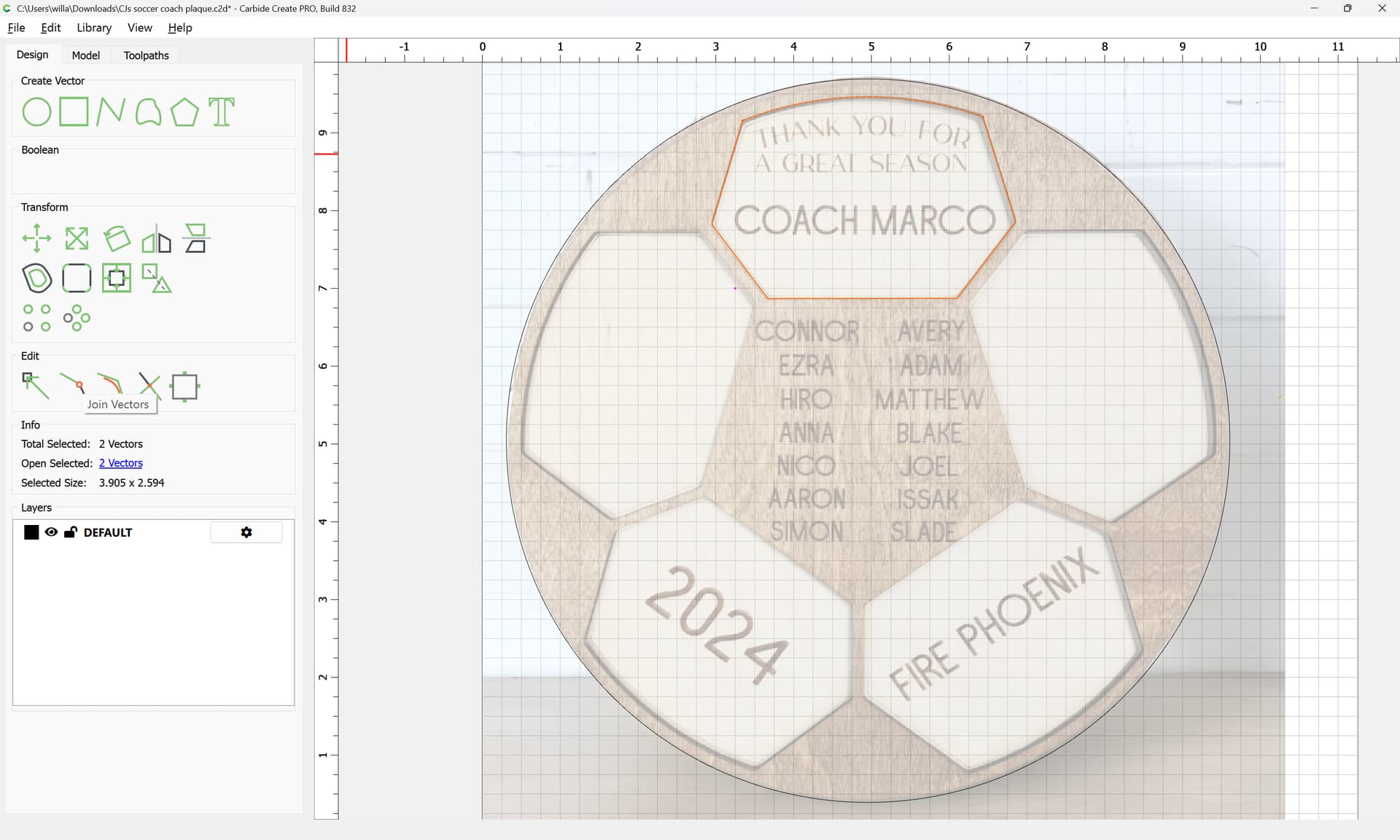

shift-click on the arc to add it to the selection:

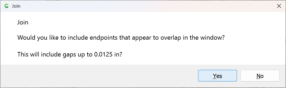

and Joint Vectors to close:
Yes

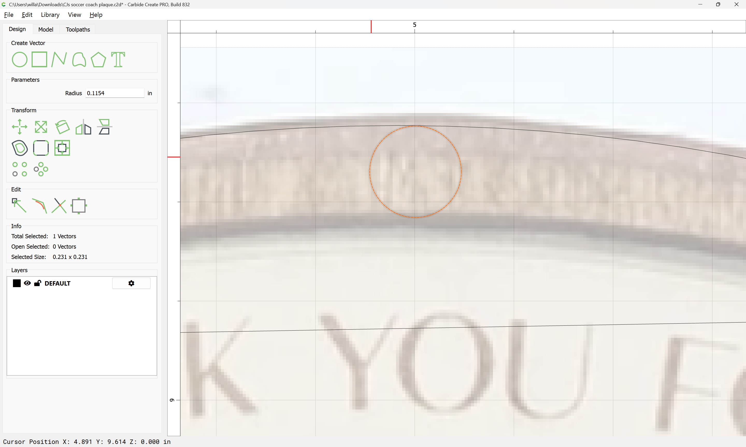

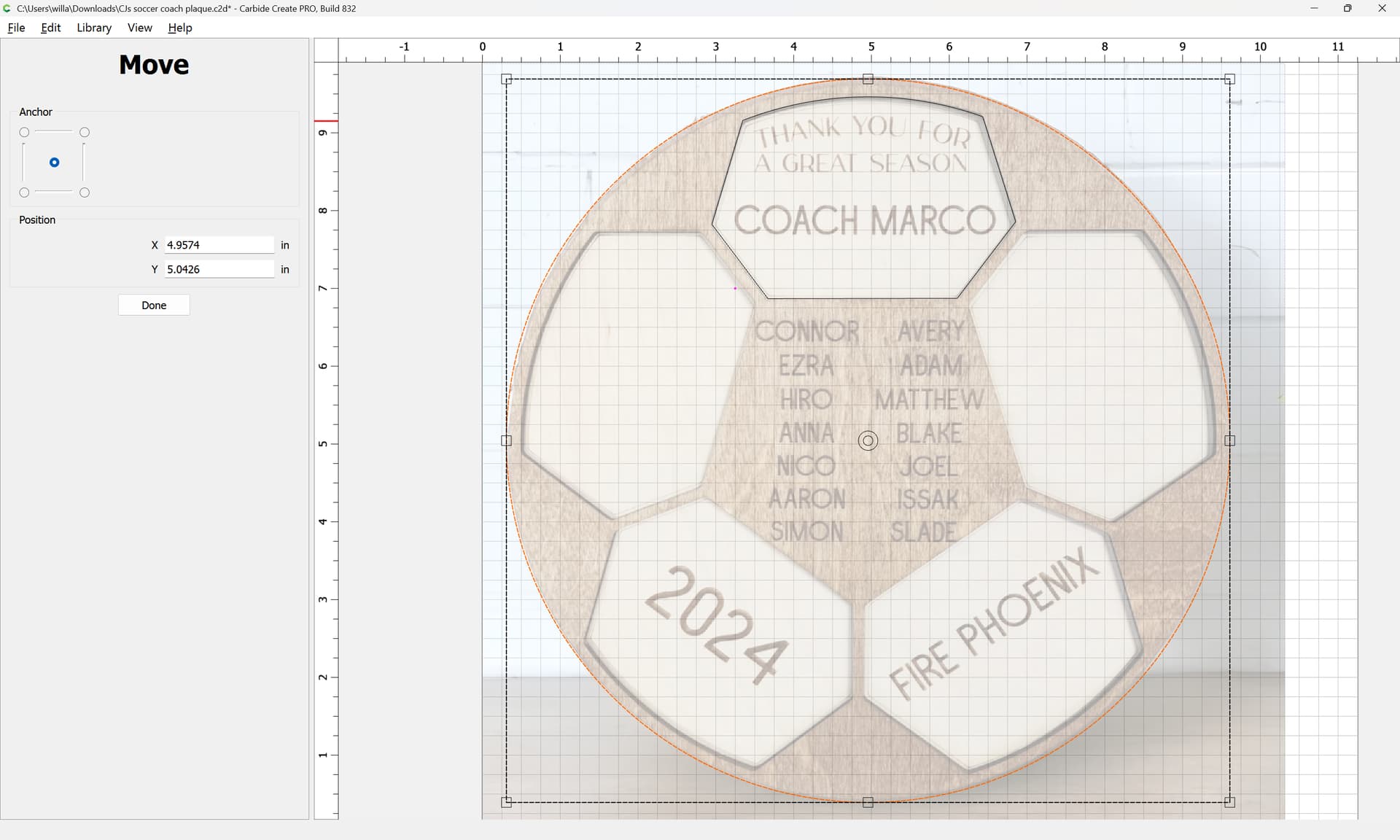

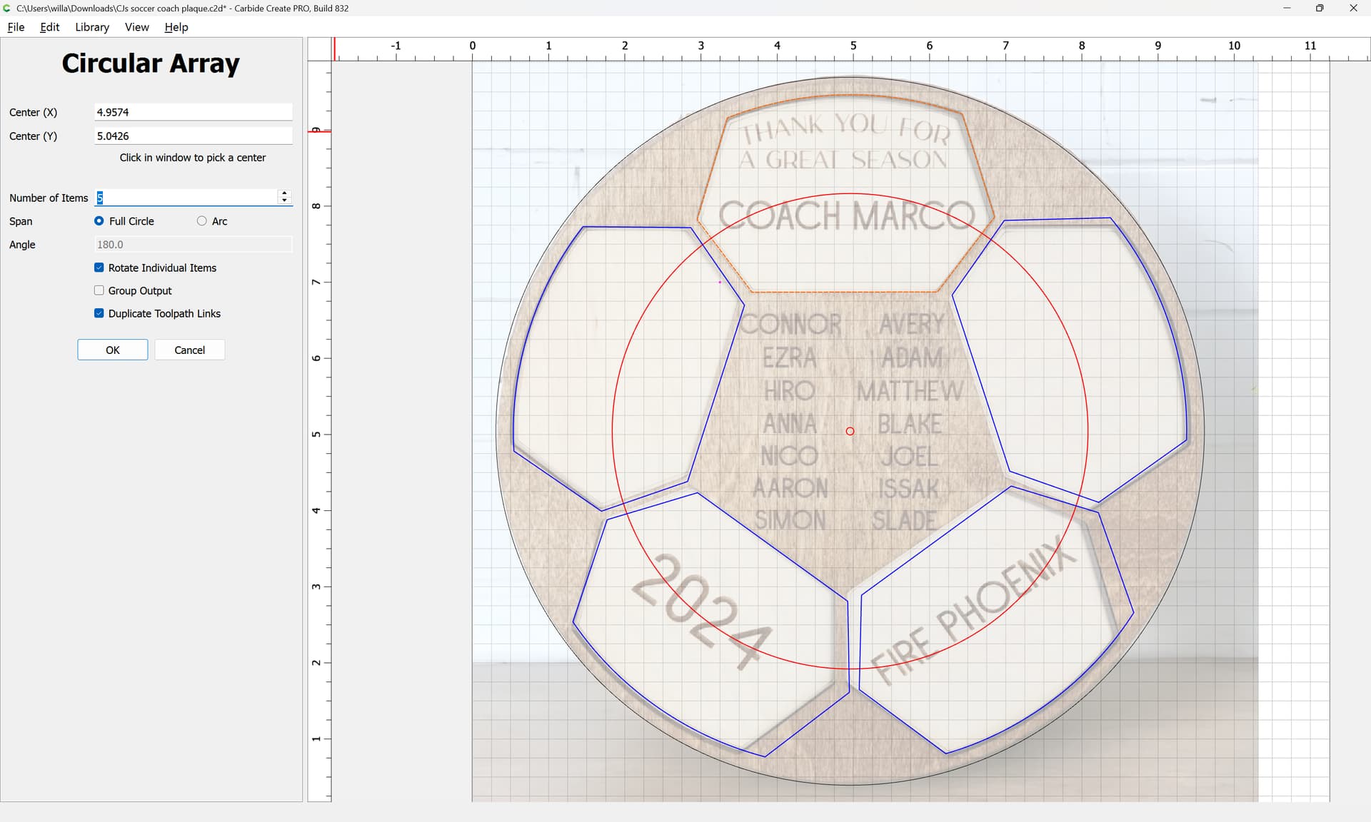

Then use Circular Array to duplicate, but first check the center of the circle:
and transfer those coordinates into the tool:
OK
