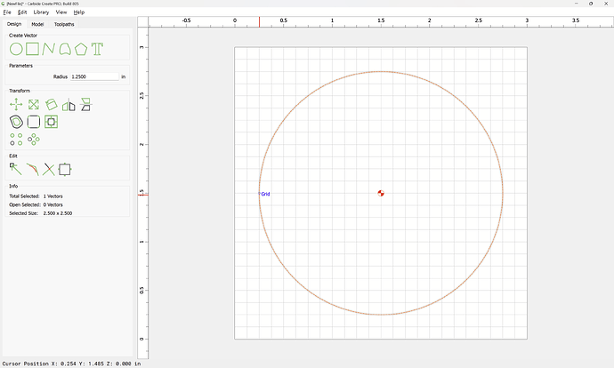

Given the need to make a curve inside a part, one draws up the geometries in question:
where the rectangle should have a curved bottom — in order to do that we must:
  • model the entire stock:
  • draw a piece of geometry large enough to create the rounded area:
  • Restore the balance of the part:
OK
OK
Join Vectors
Yes
Model this to create the flat area of the part:
Then restore the circle and remove the surrounding material:
Apply
