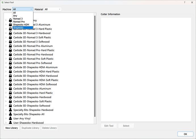

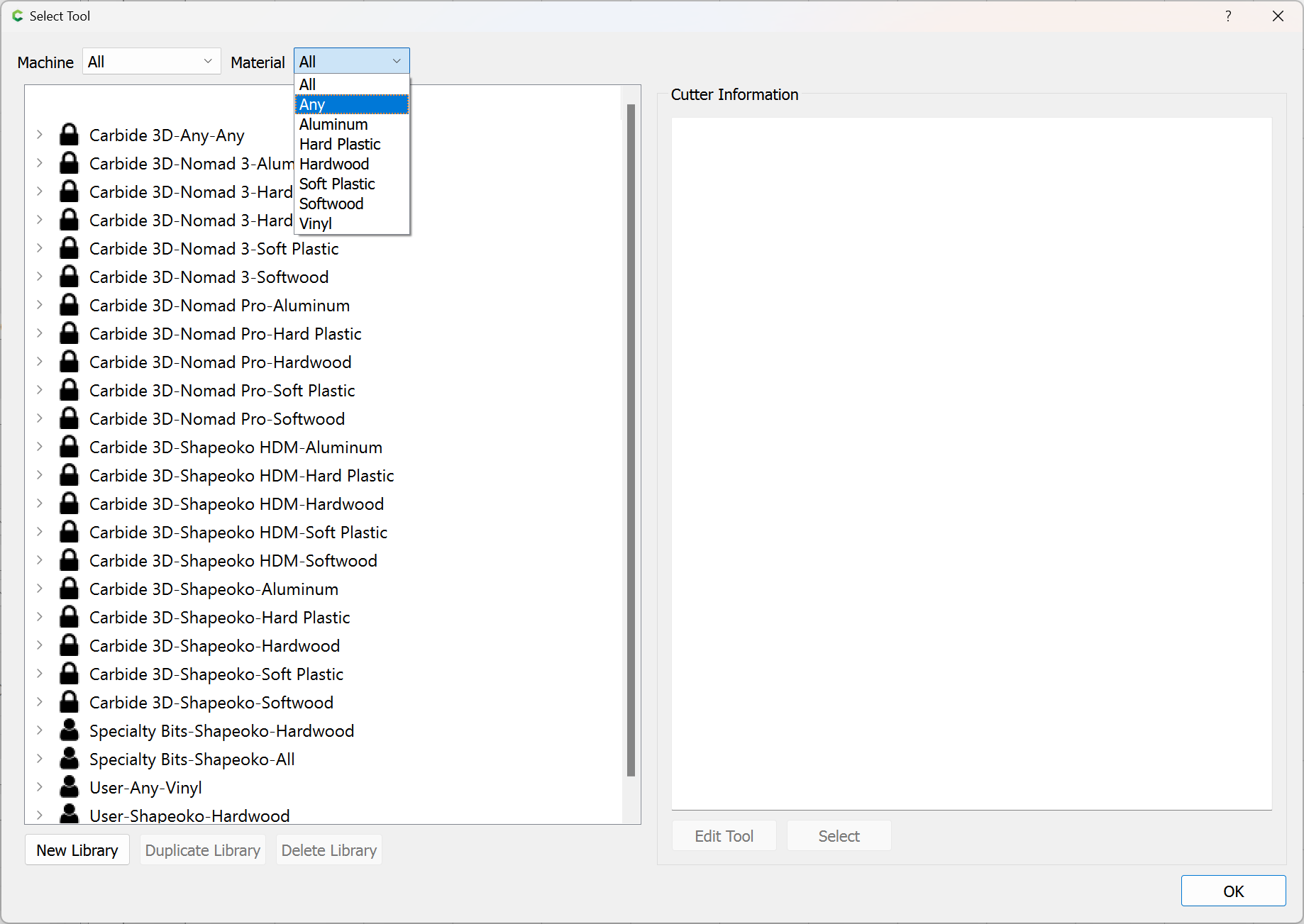

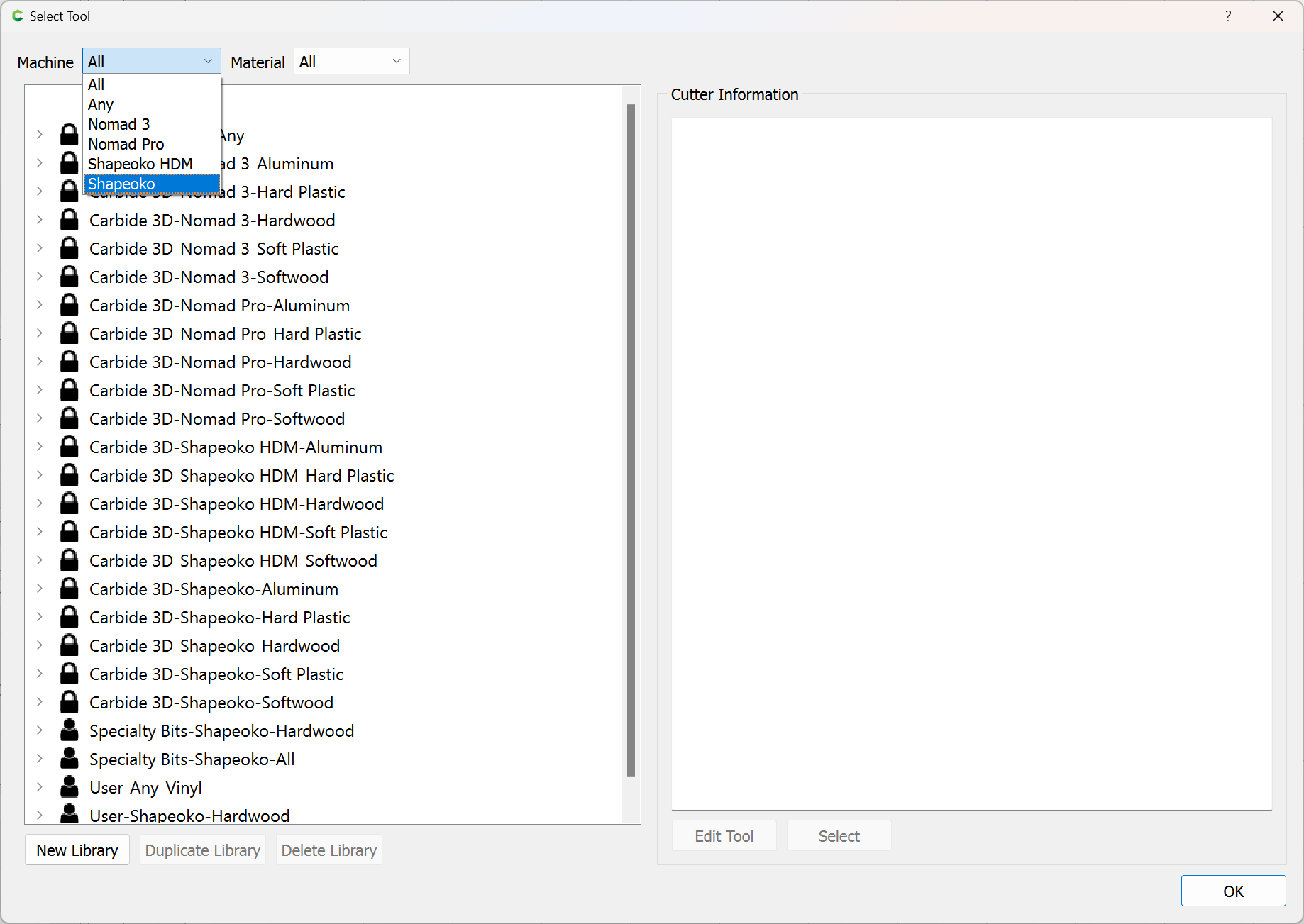

What do you have selected for Machine:
and Material:
Note that All != Any
