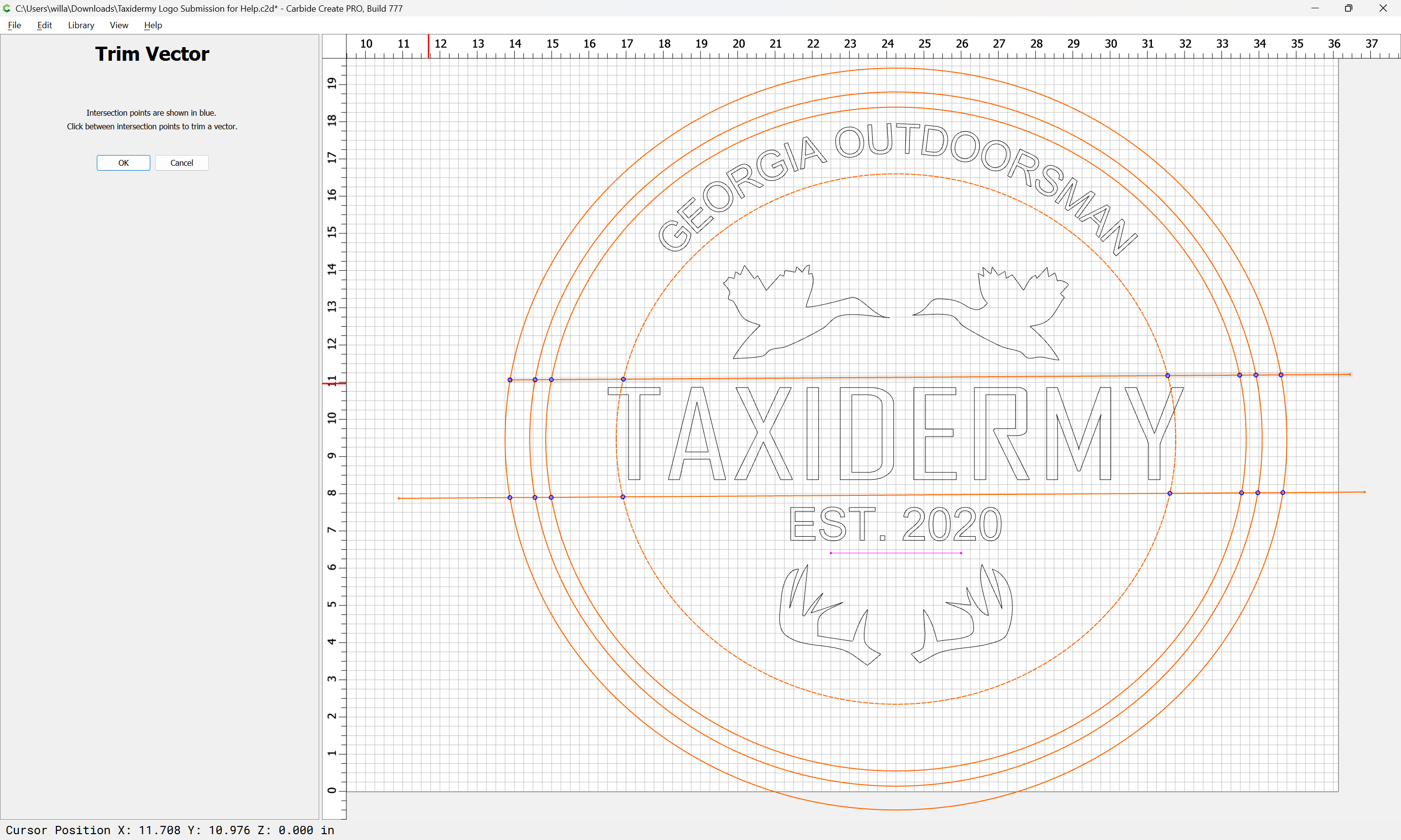

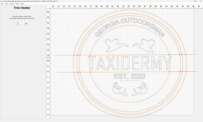

Attempting to take out the segments of the circles in between the two lines that run through the logo. I have spent two days on it now with no success. Anyone have any suggestions on how to accomplish this. I have attached the .svg file so that you can see what I am referring to. Any guidance would be much appreciated.

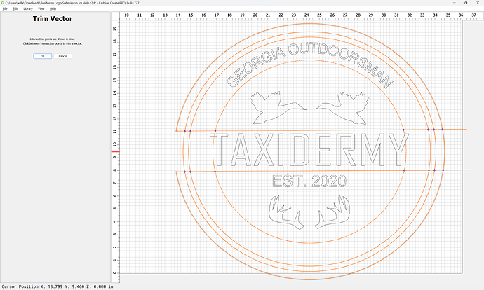

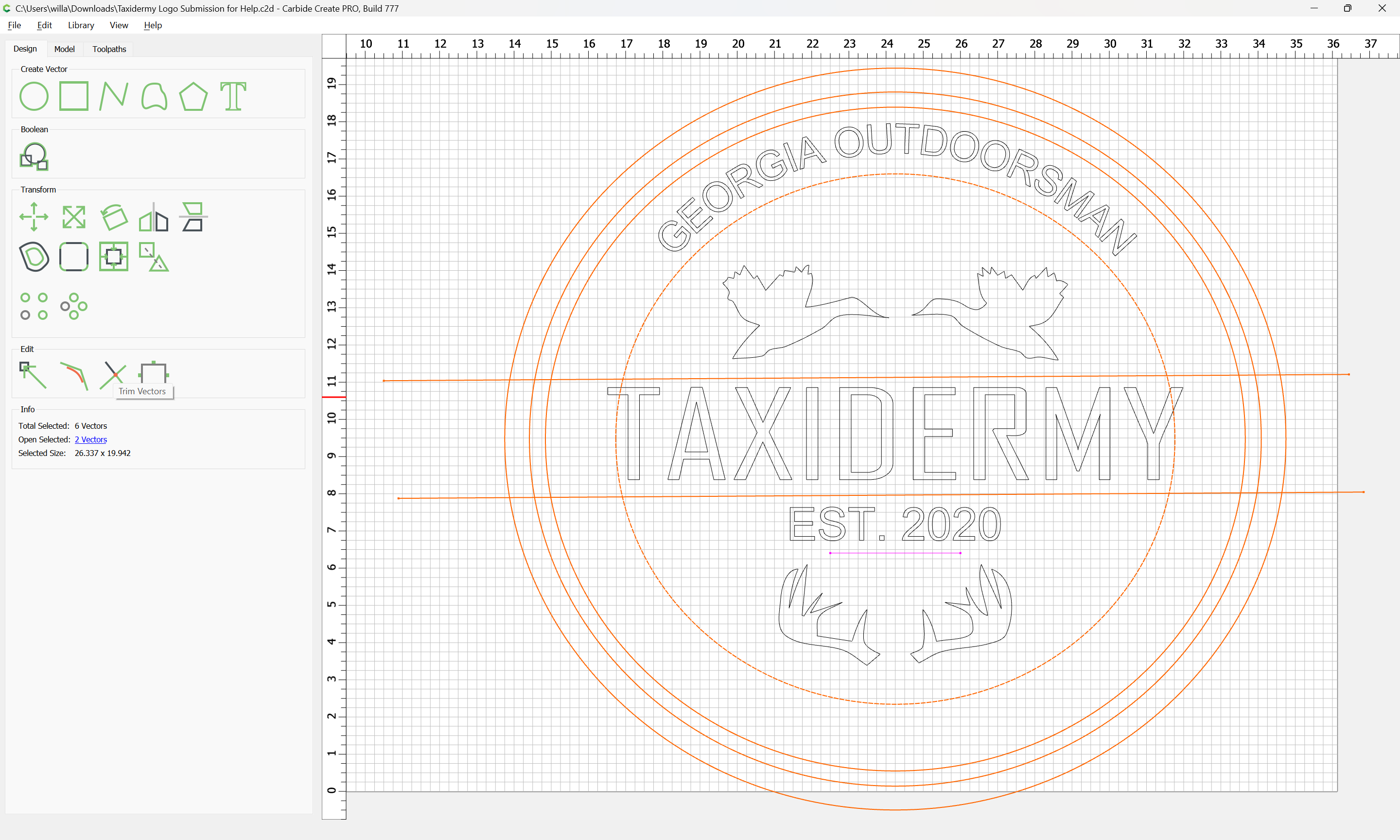

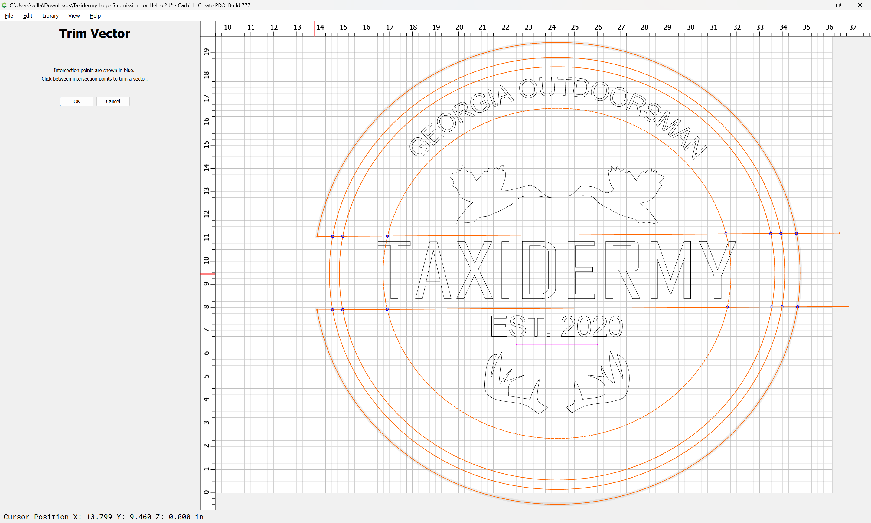

This is what the “Trim Vectors” command is quite useful for.
Select the elements involved:
Go into Trim Vectors mode:

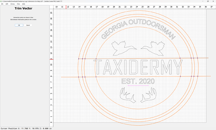

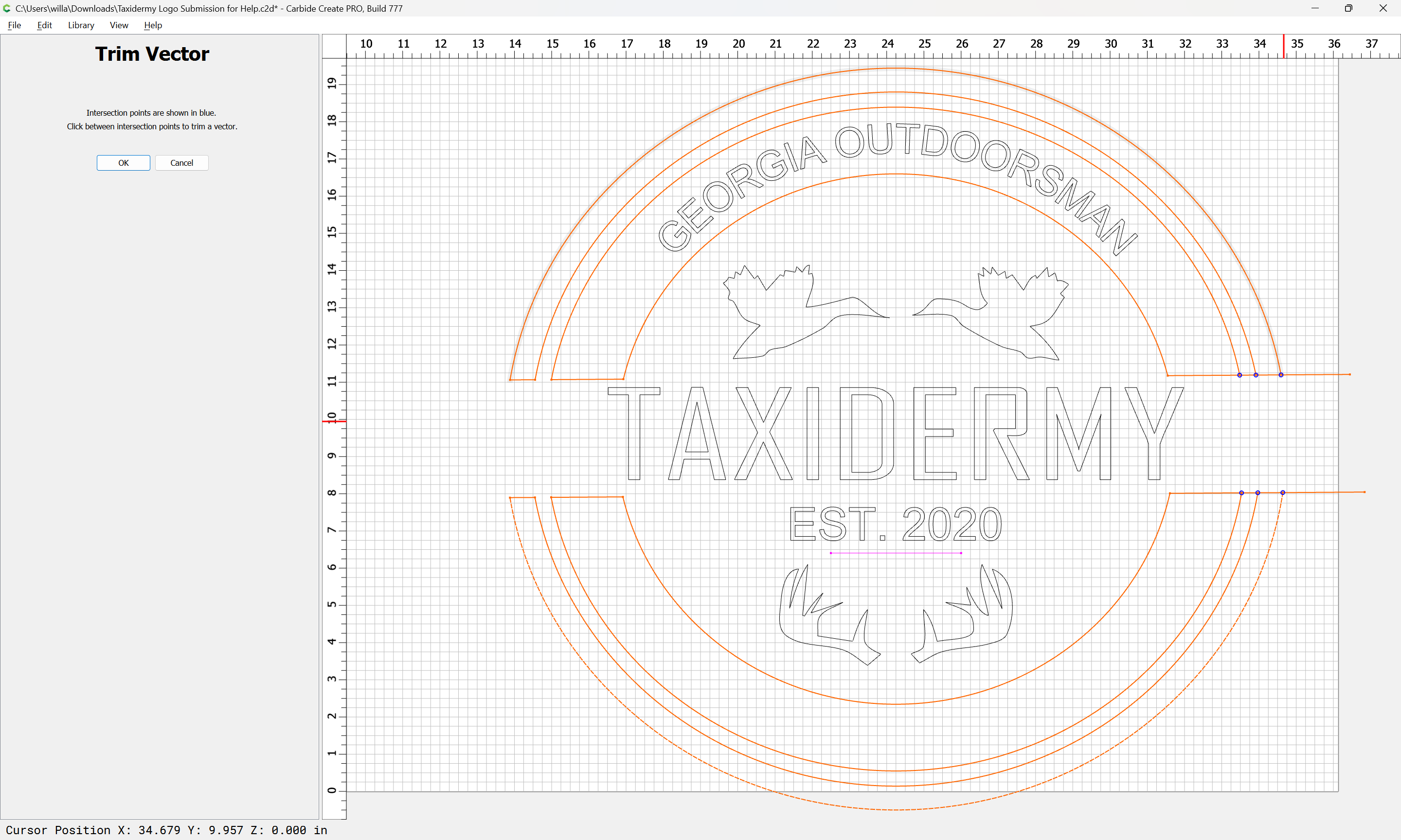

click to remove the lines which are not wanted:
until one arrives at:

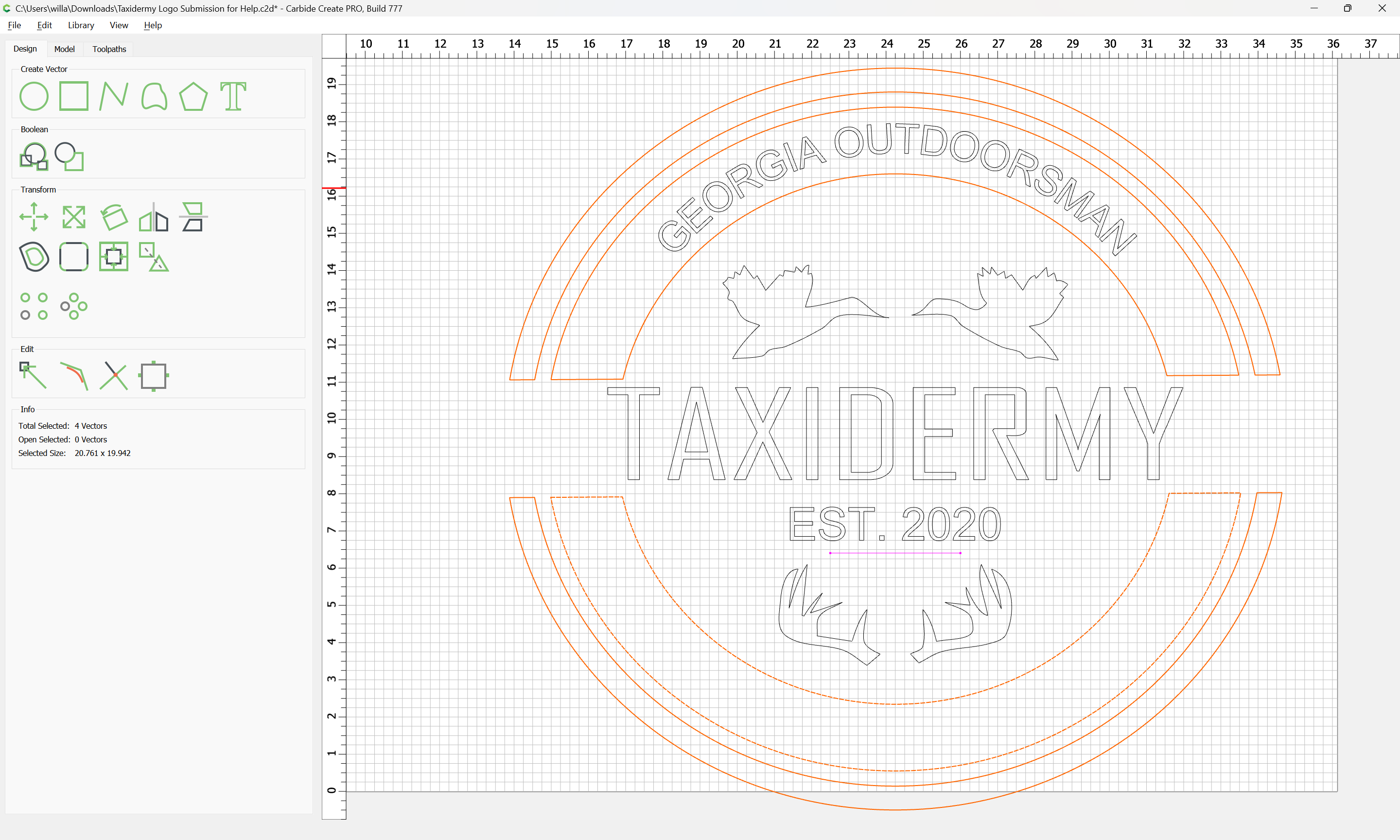

OK
OK

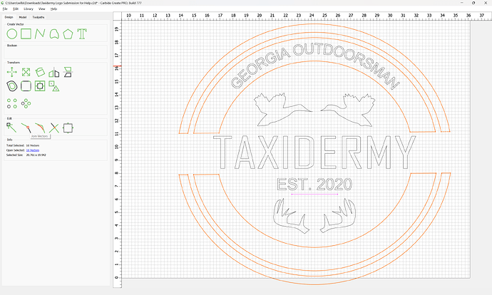

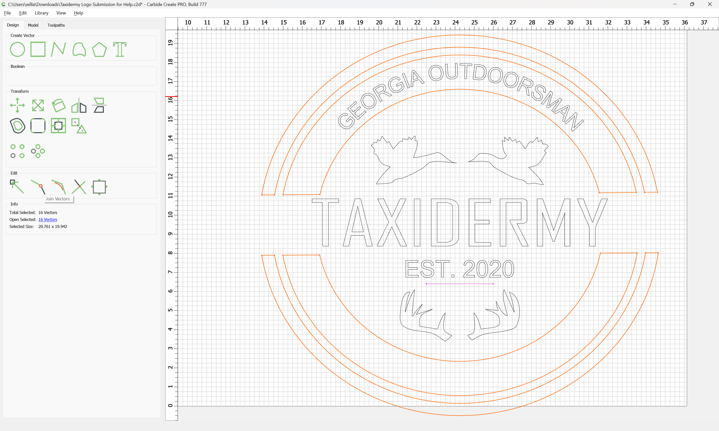

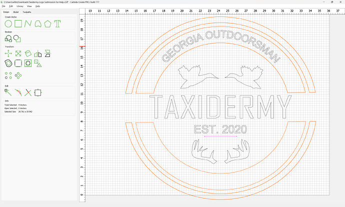

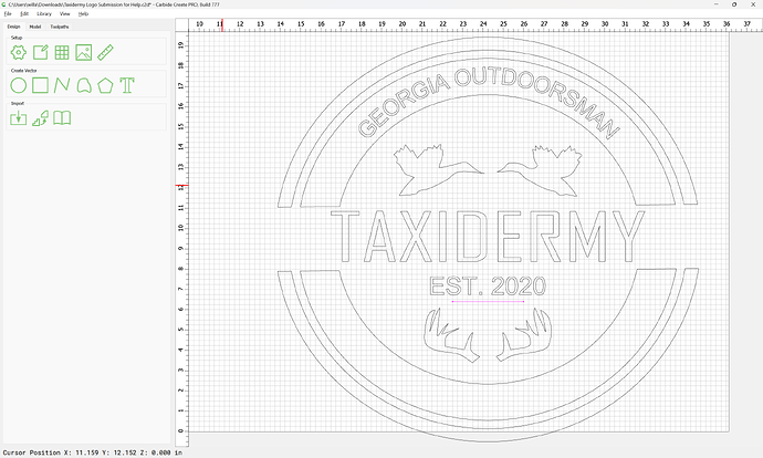

Then use Join Vectors to close things:
Yes
