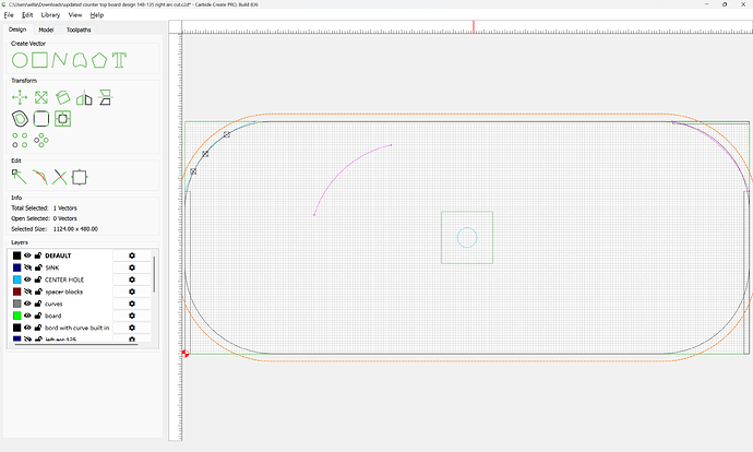

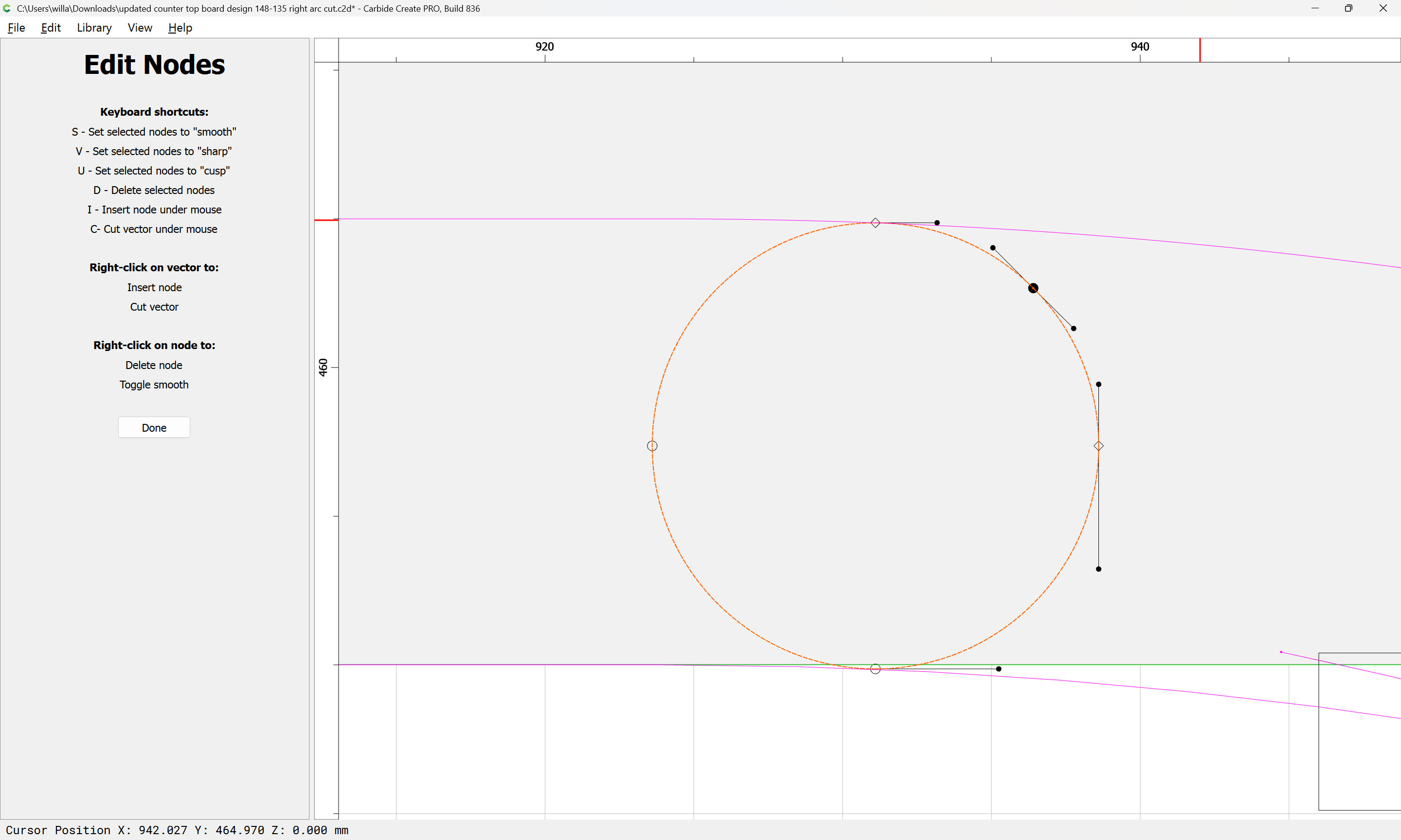

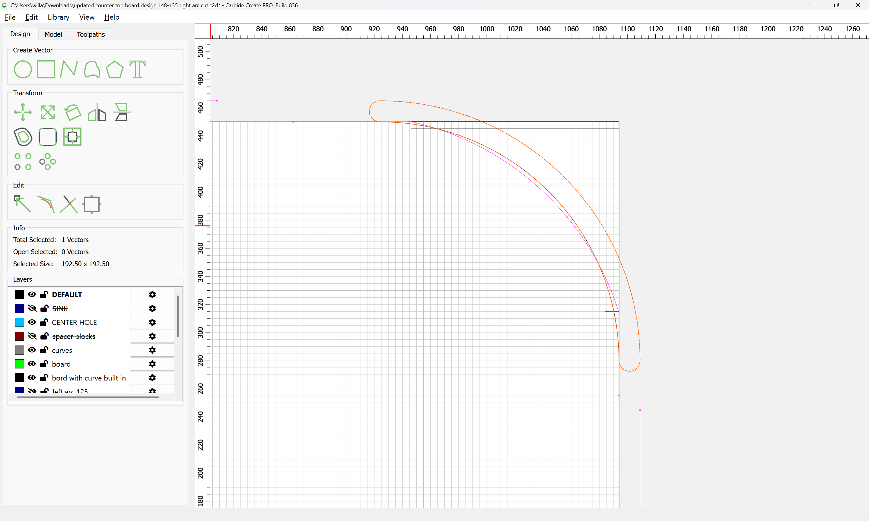

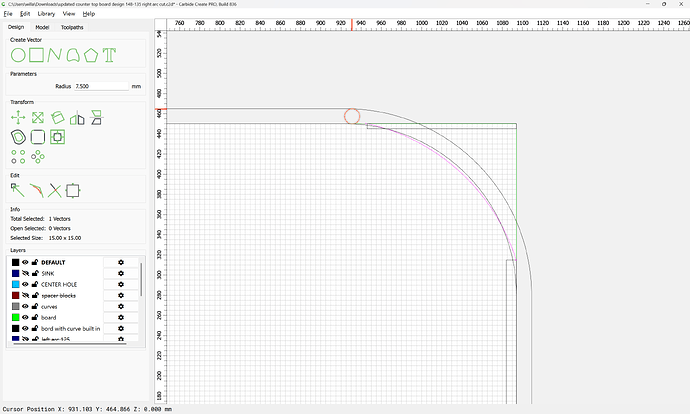

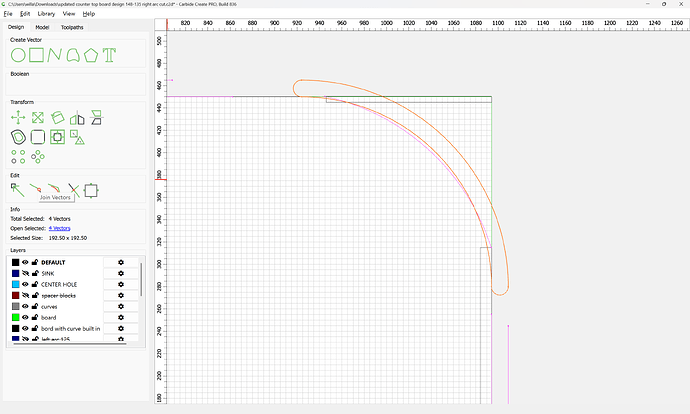

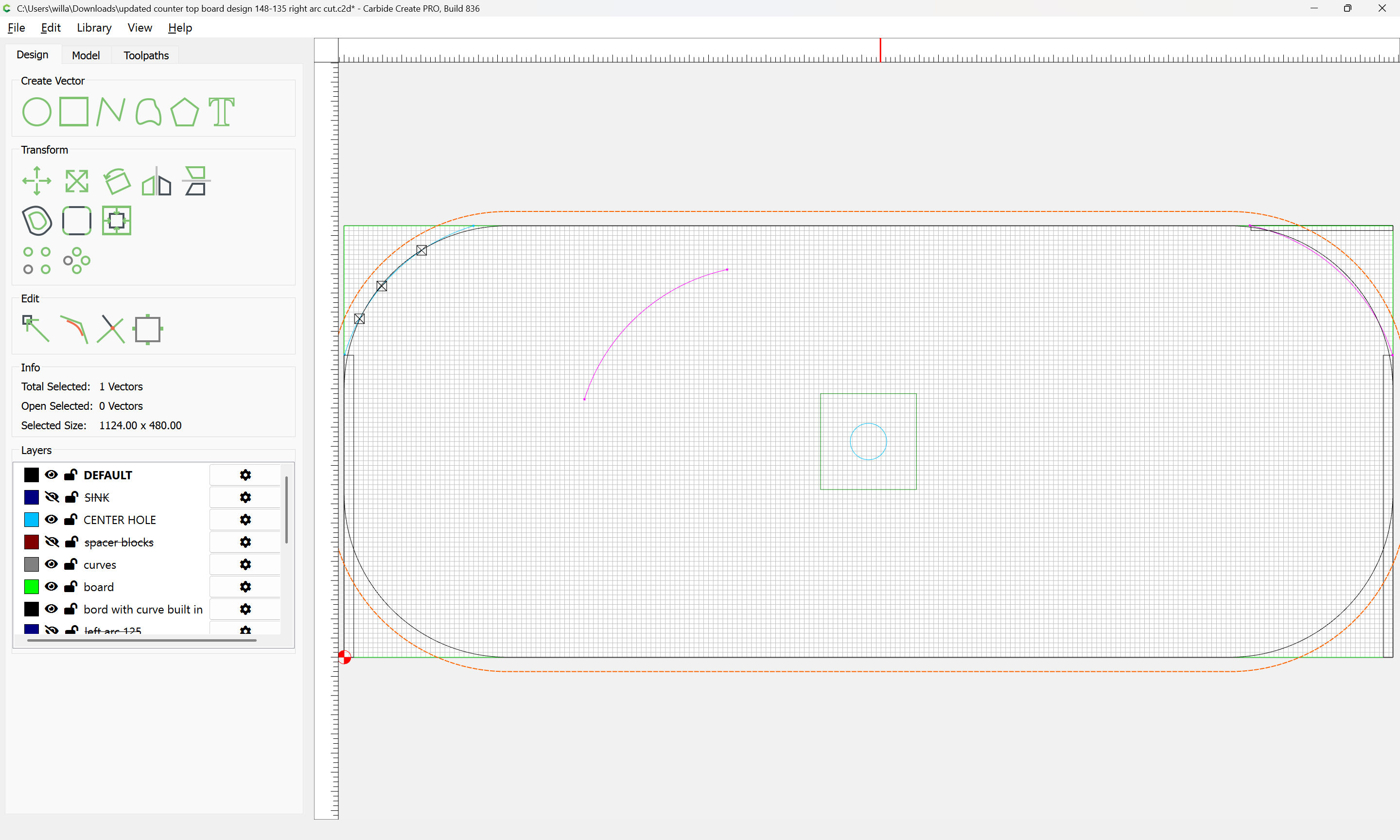

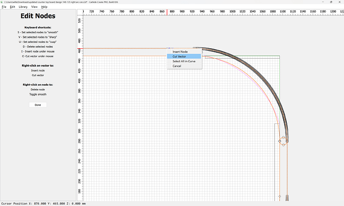

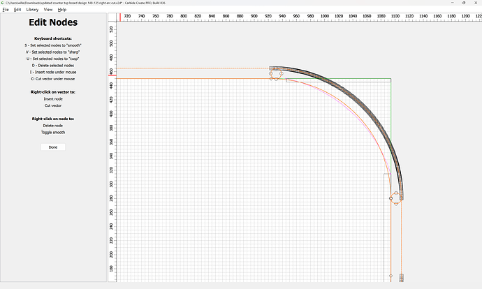

Folks,

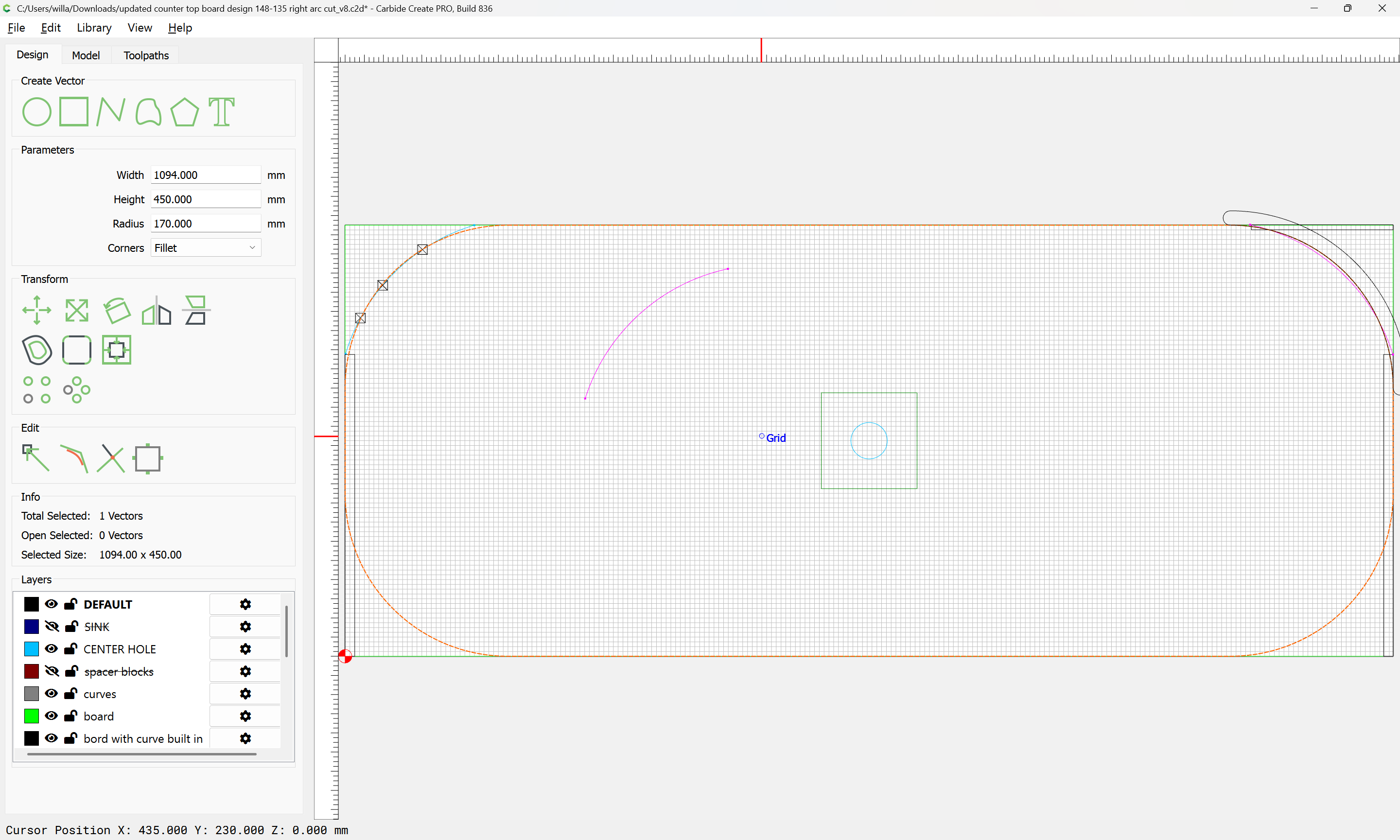

I am trying to cut a curve on each end of a 2" thick wall nut board I am designing for a counter top. The arcs are in top 2 corners. I designed this as an arc so that I dont have to cut the entire board, just cut off the arcs so that I have curved corners.

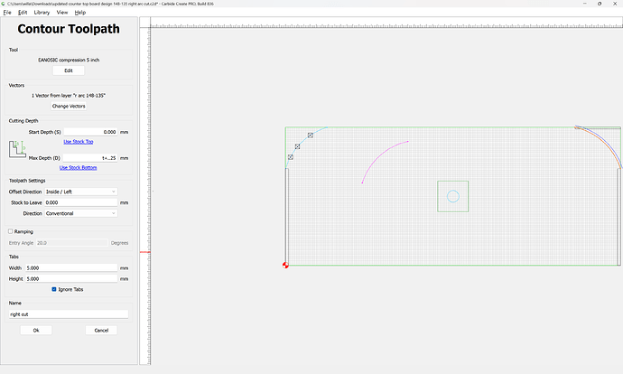

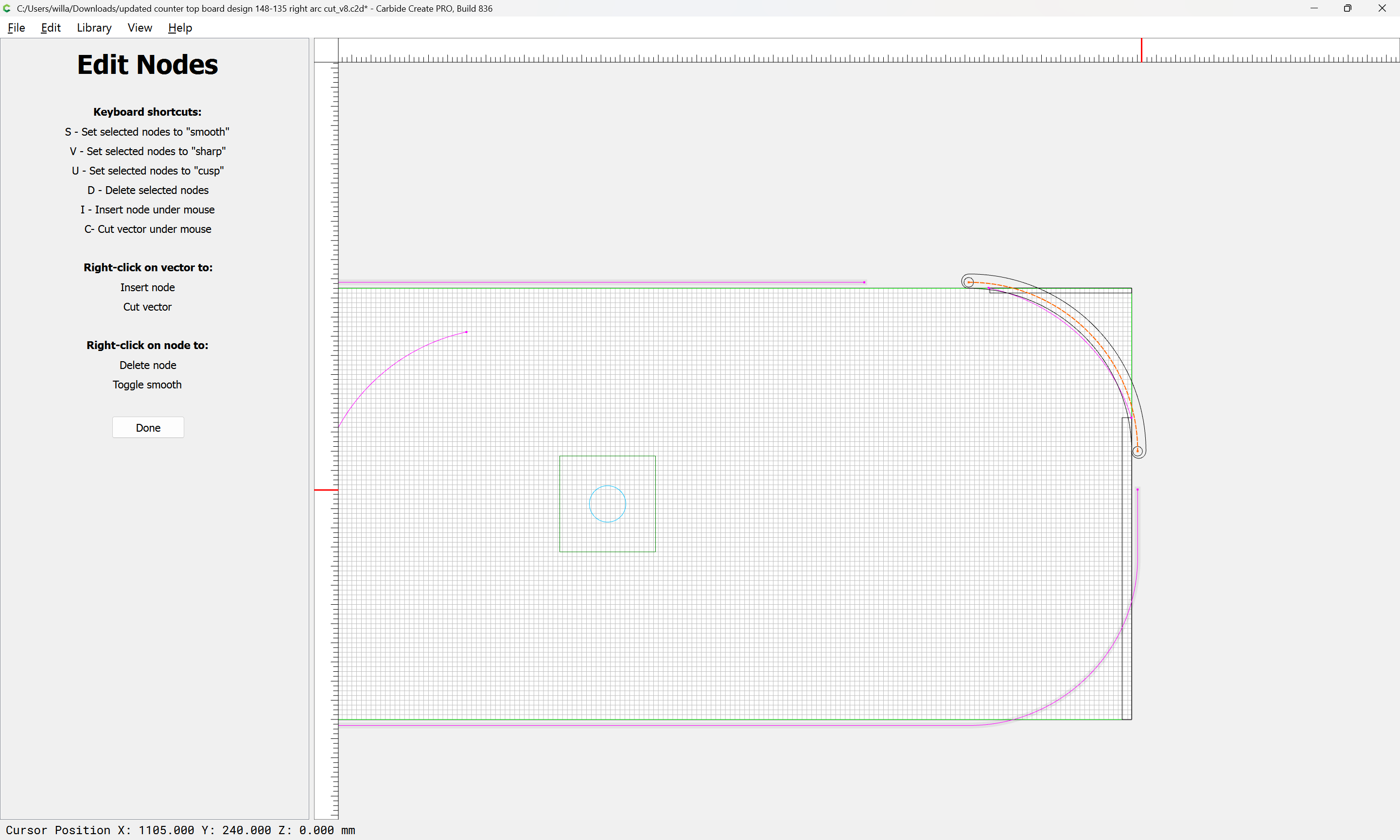

I am using a 1/2" shank Spiral compression cutter. It cuts the curves well, but leaves a lip at the end of the arc. I like to smooth out the ends. I tried rotating the curve to make it shallower at the end, but it still leaves the lip - which appears to be 1/2 diameter of the endmill. I used contour path with outside on the left corner and inside on the right corner. Is there a way to simplify this and any tricks? Attached is the CC file and a couple of pictures of the actual cuts. The lip seems prominent at the end of the cut and thus the right corner shows up more on the top.
attachments.zip (364.1 KB)
Thanks for your help in advance.
updated counter top board design 148-135 right arc cut.c2d (76 KB)

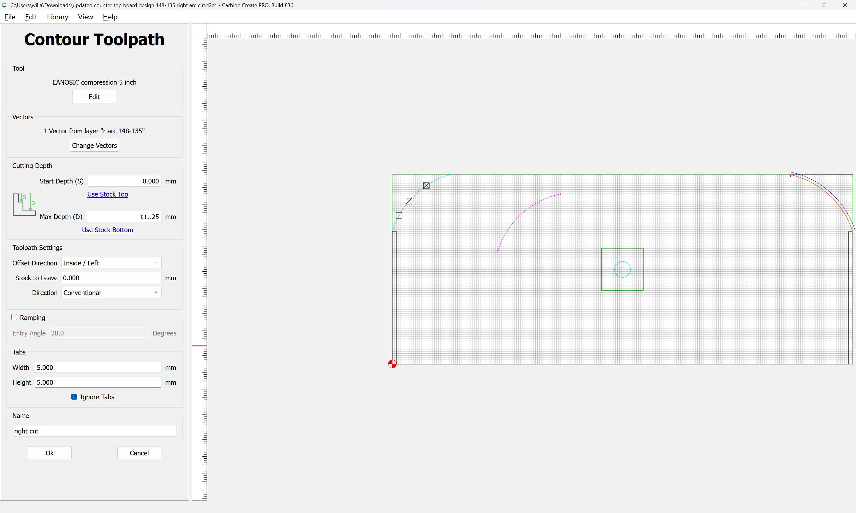

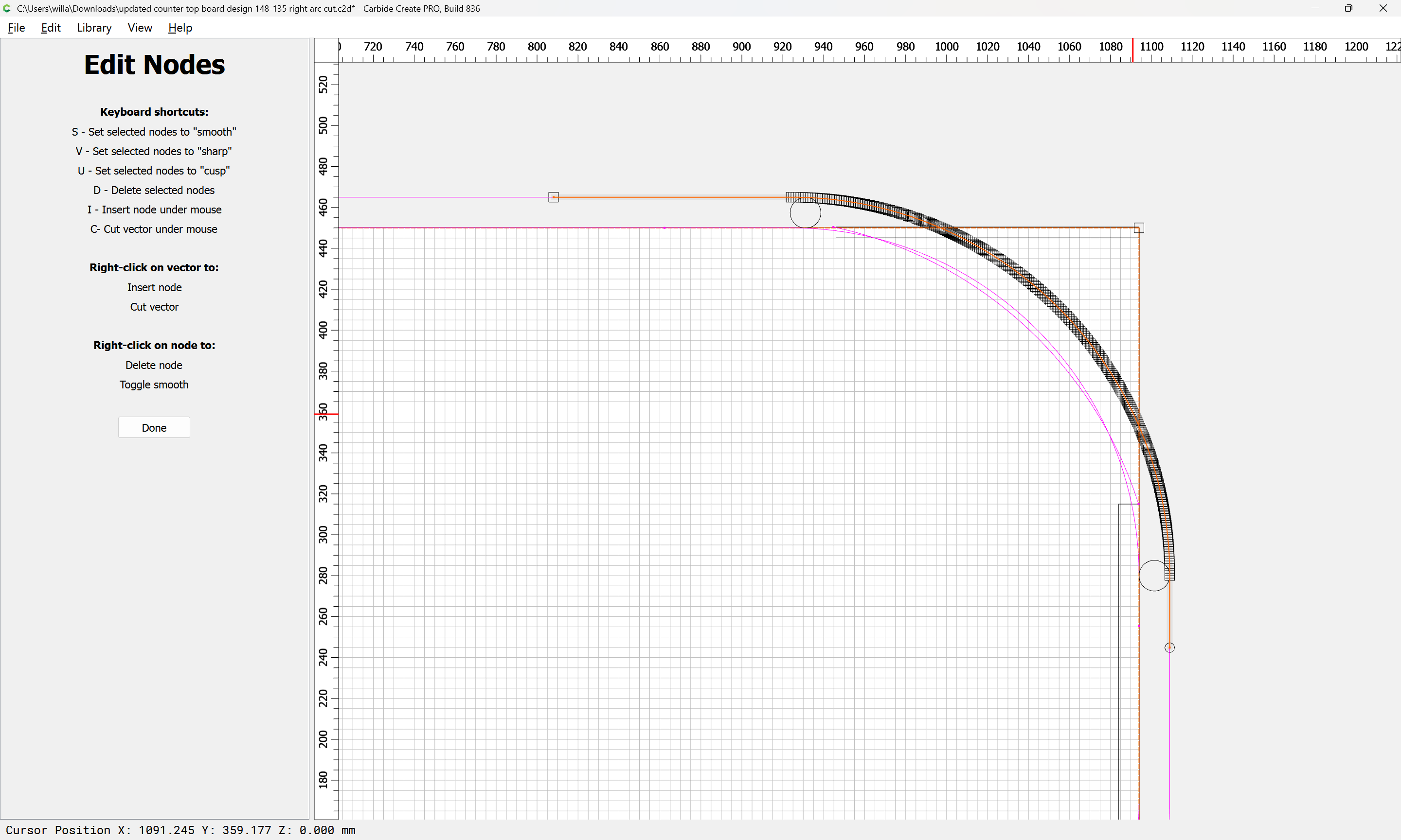

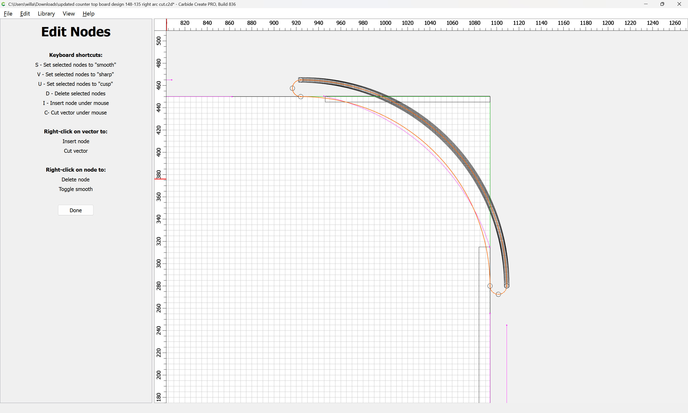

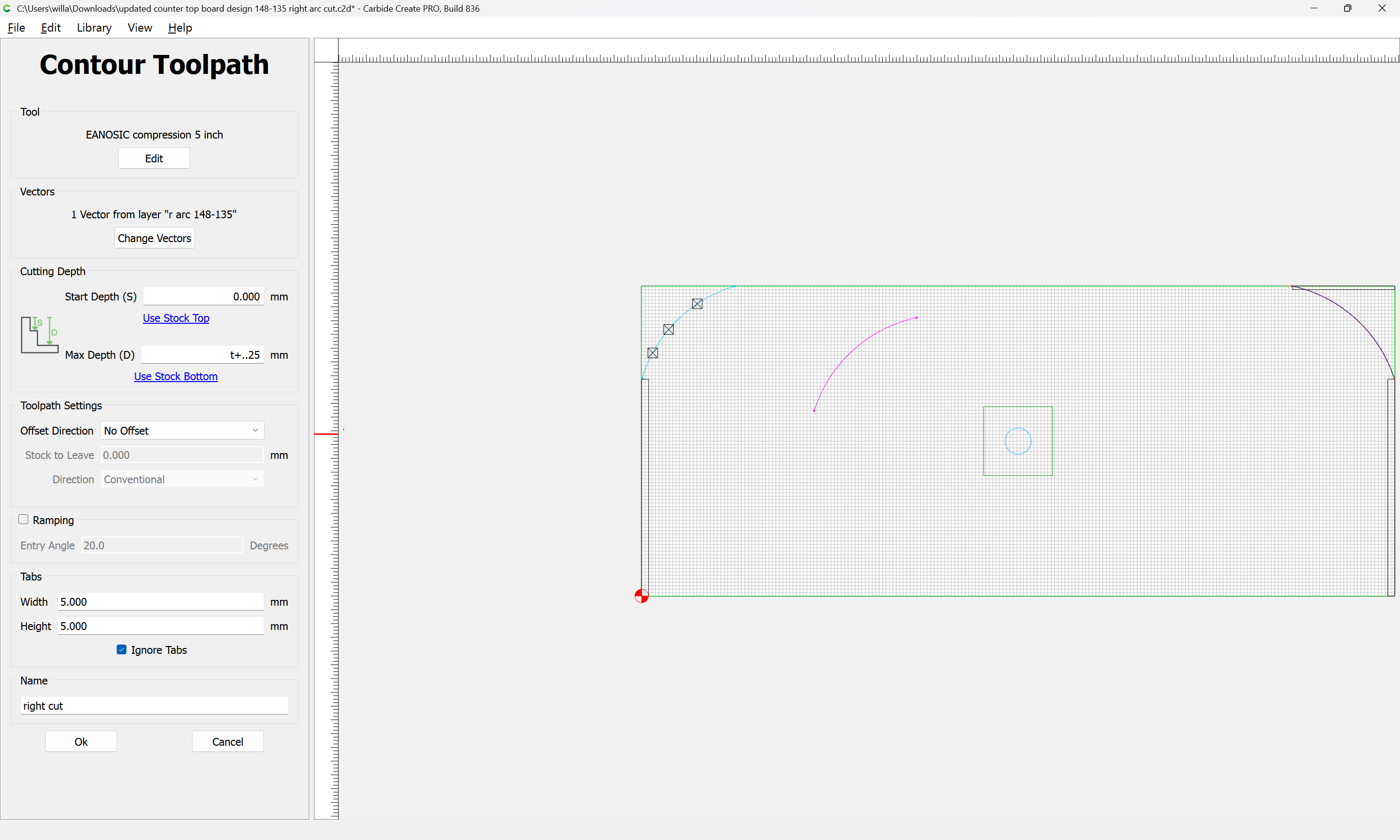

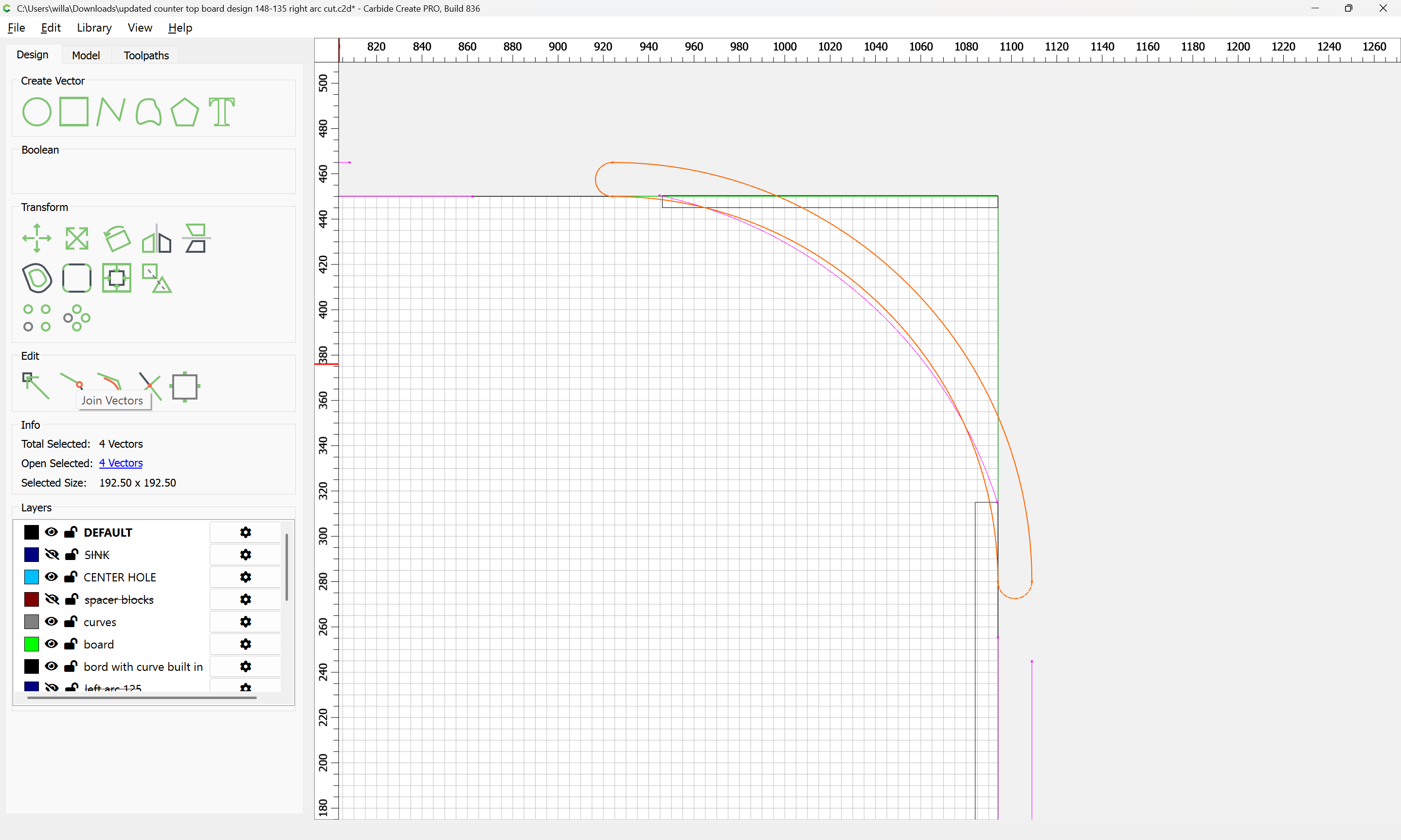

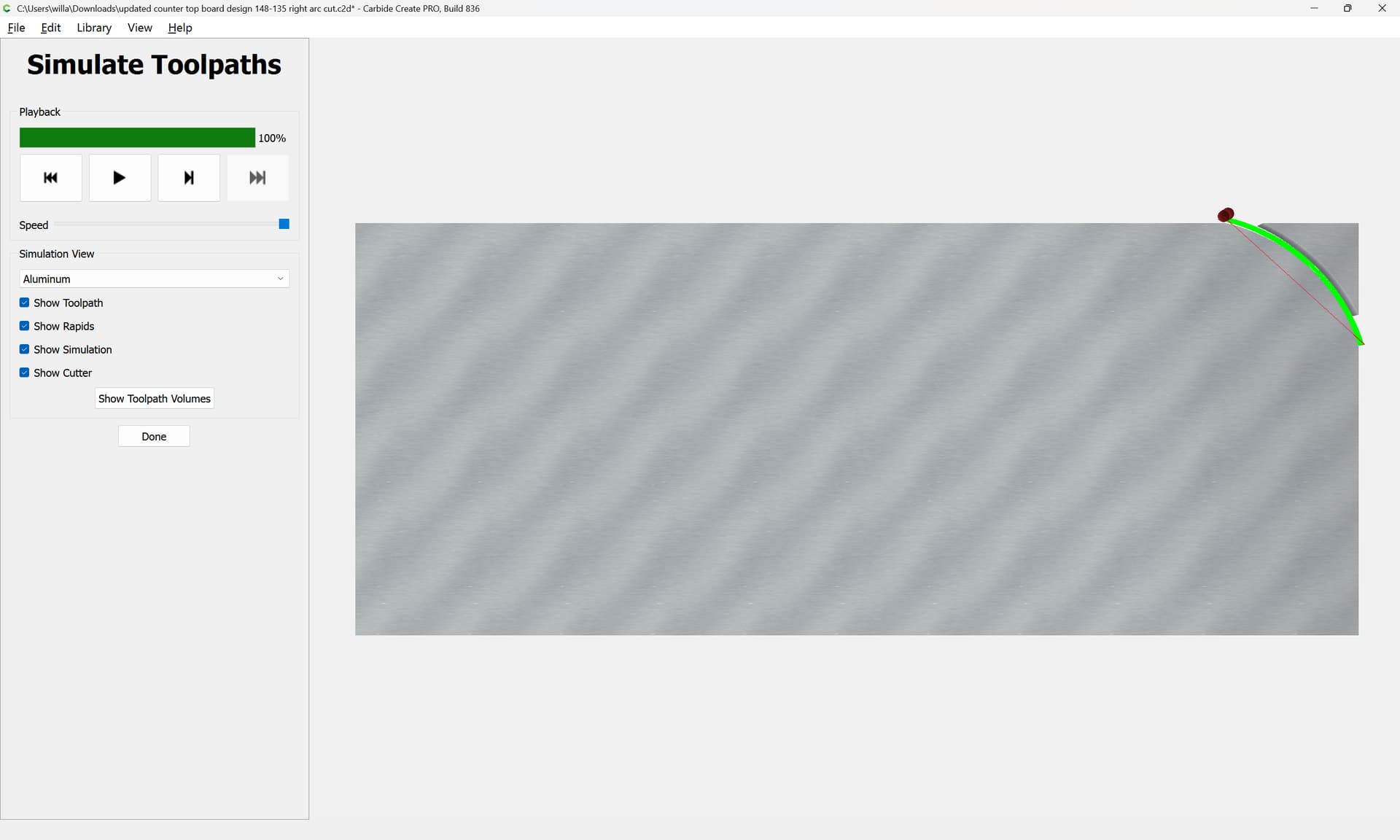

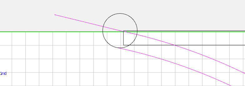

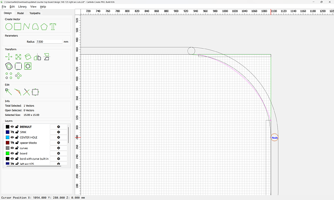

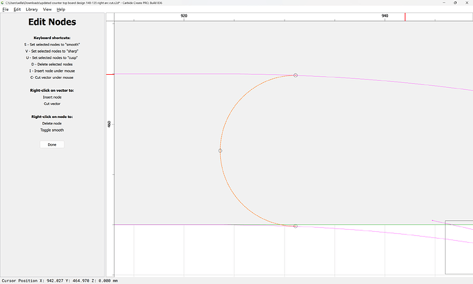

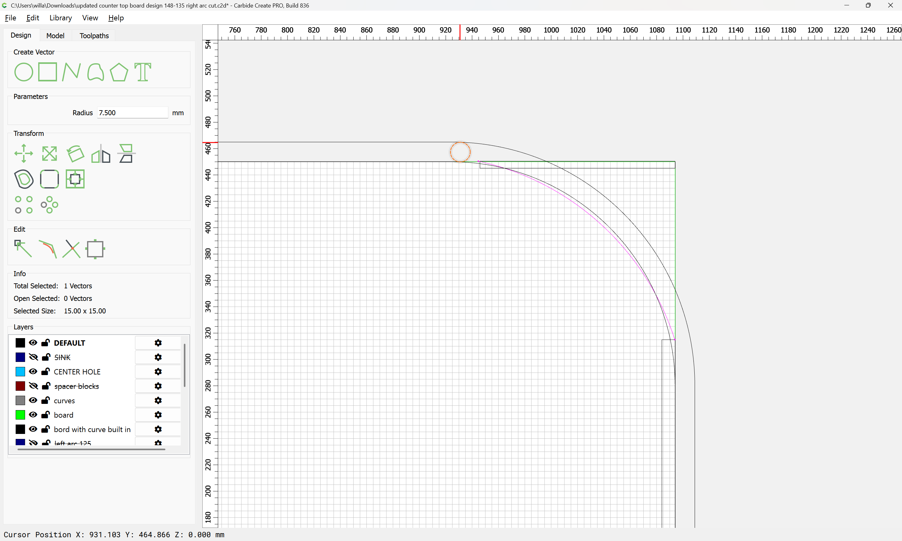

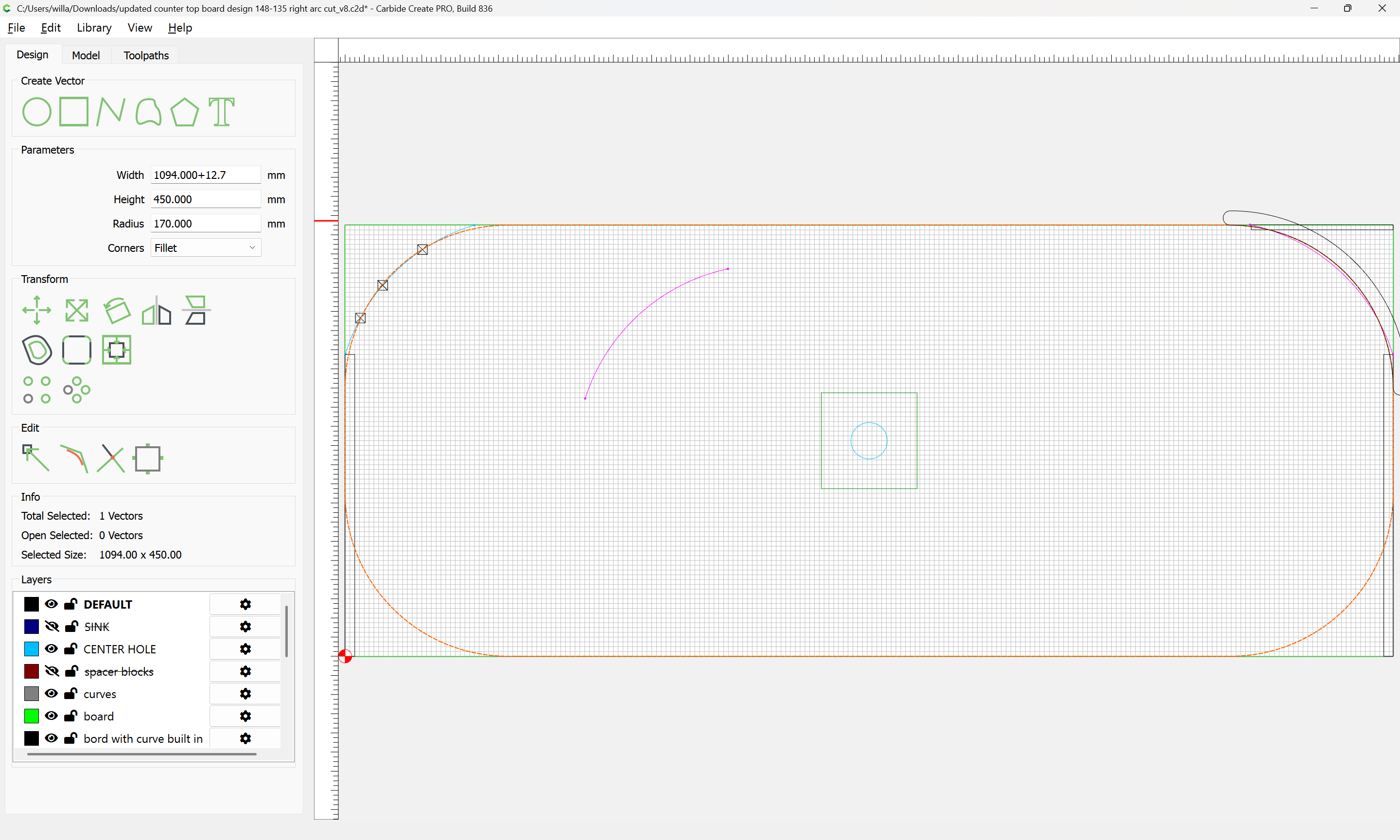

With the ON (No Offset) condition your cutter is stopping at the end of the curve.
Extend the curves so they cut past the offset intersection

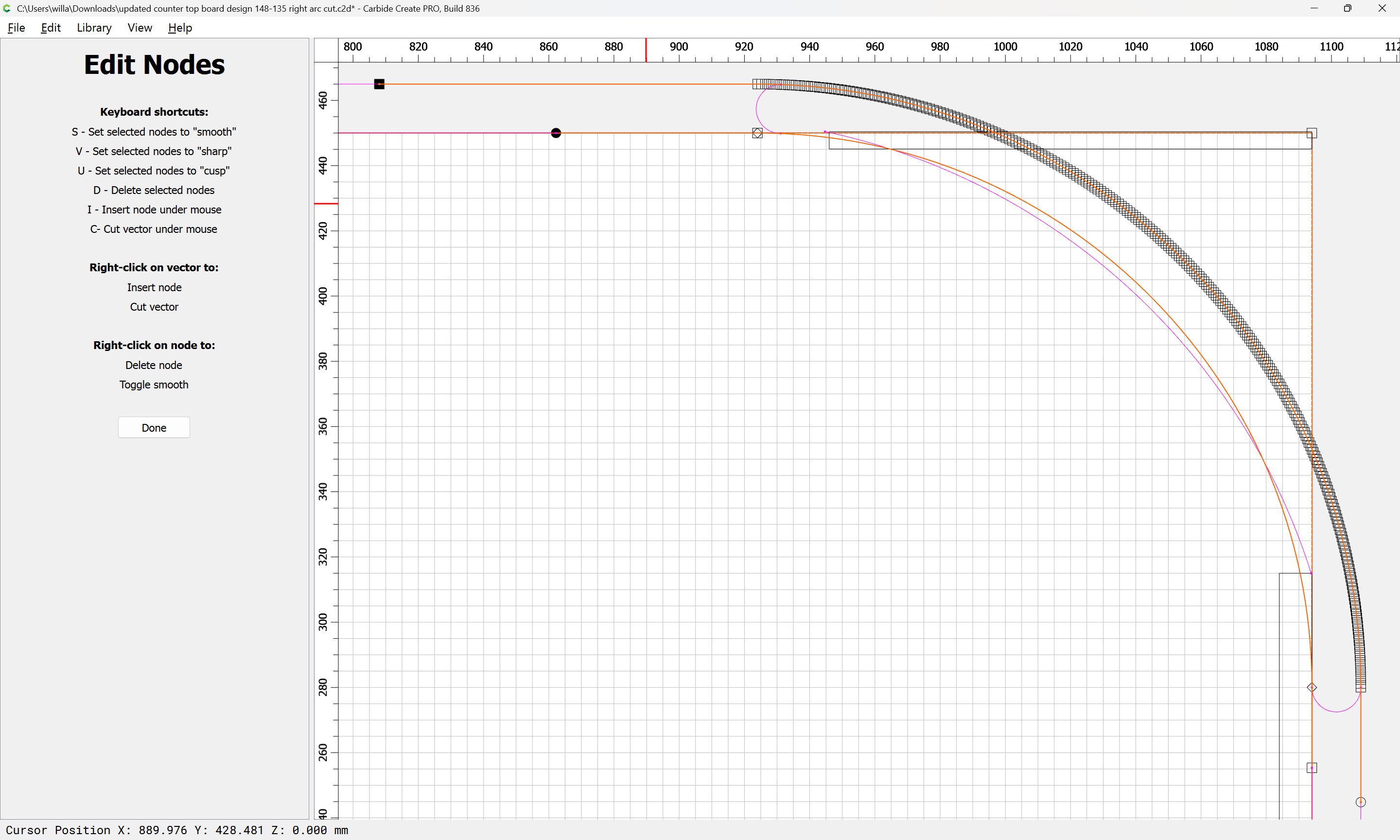

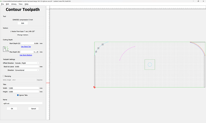

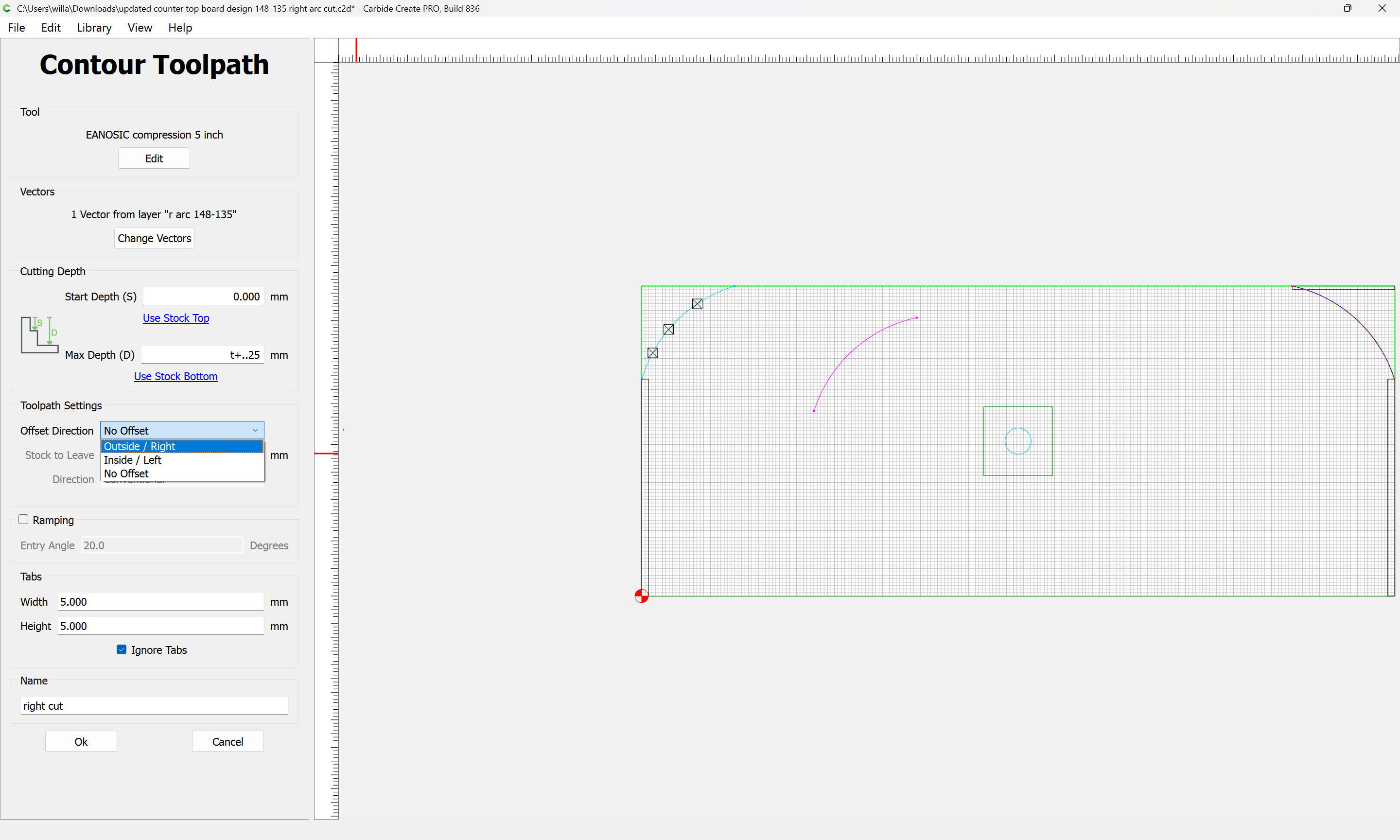

If you are using a No Offset Contour:

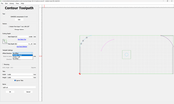

then you will need to setup/position the geometry so that it describes the tool movement, not the edge which you wish to cut — inside/outside work for open geometry:
but since they are based on the direction of the cut rather than an actual inner/outer based on closed geometry, one has to try one:
and if it’s not on the correct side, toggle it:
which then previews as:

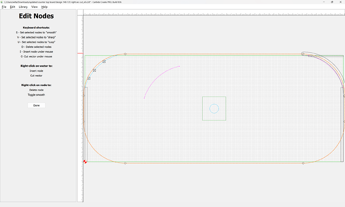

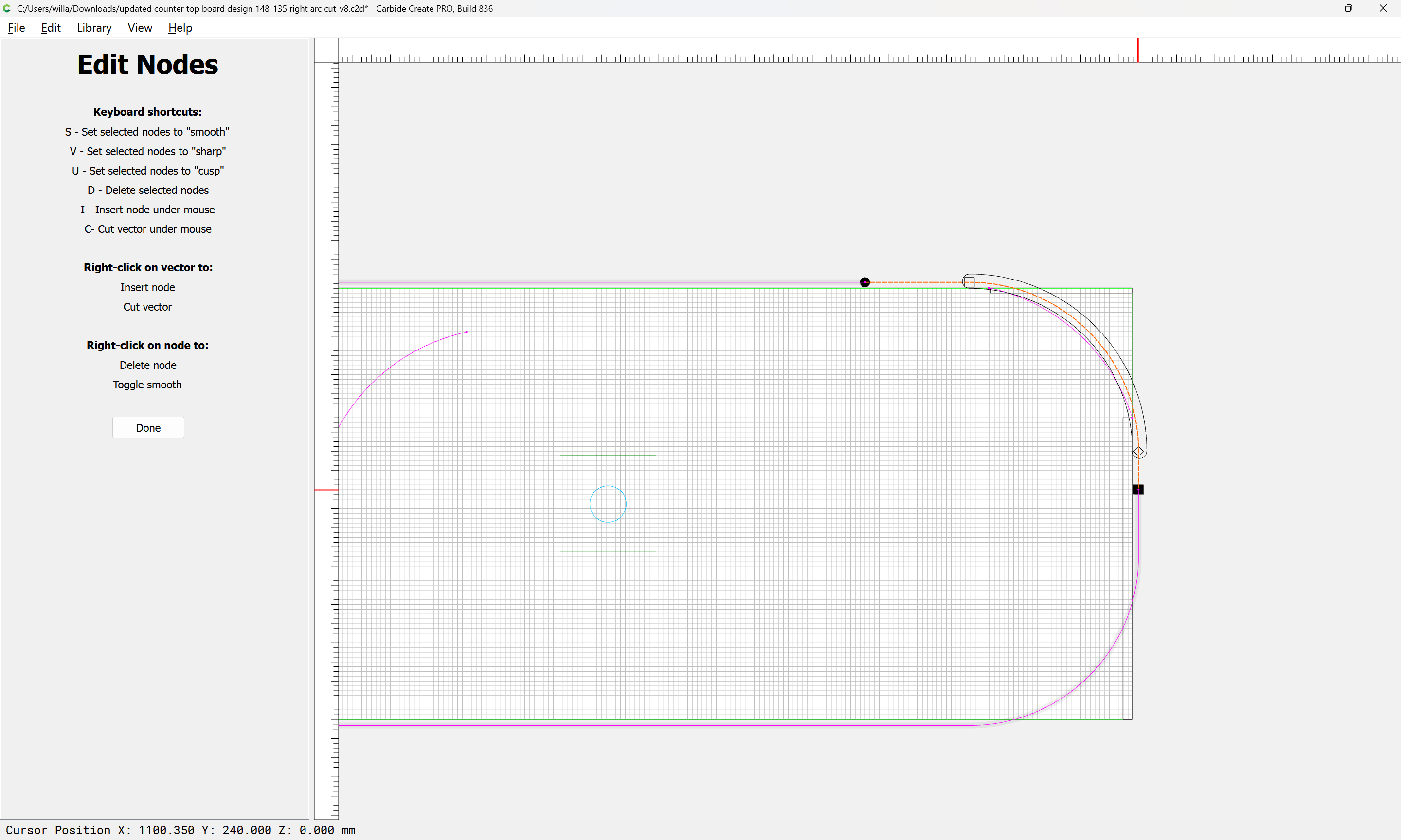

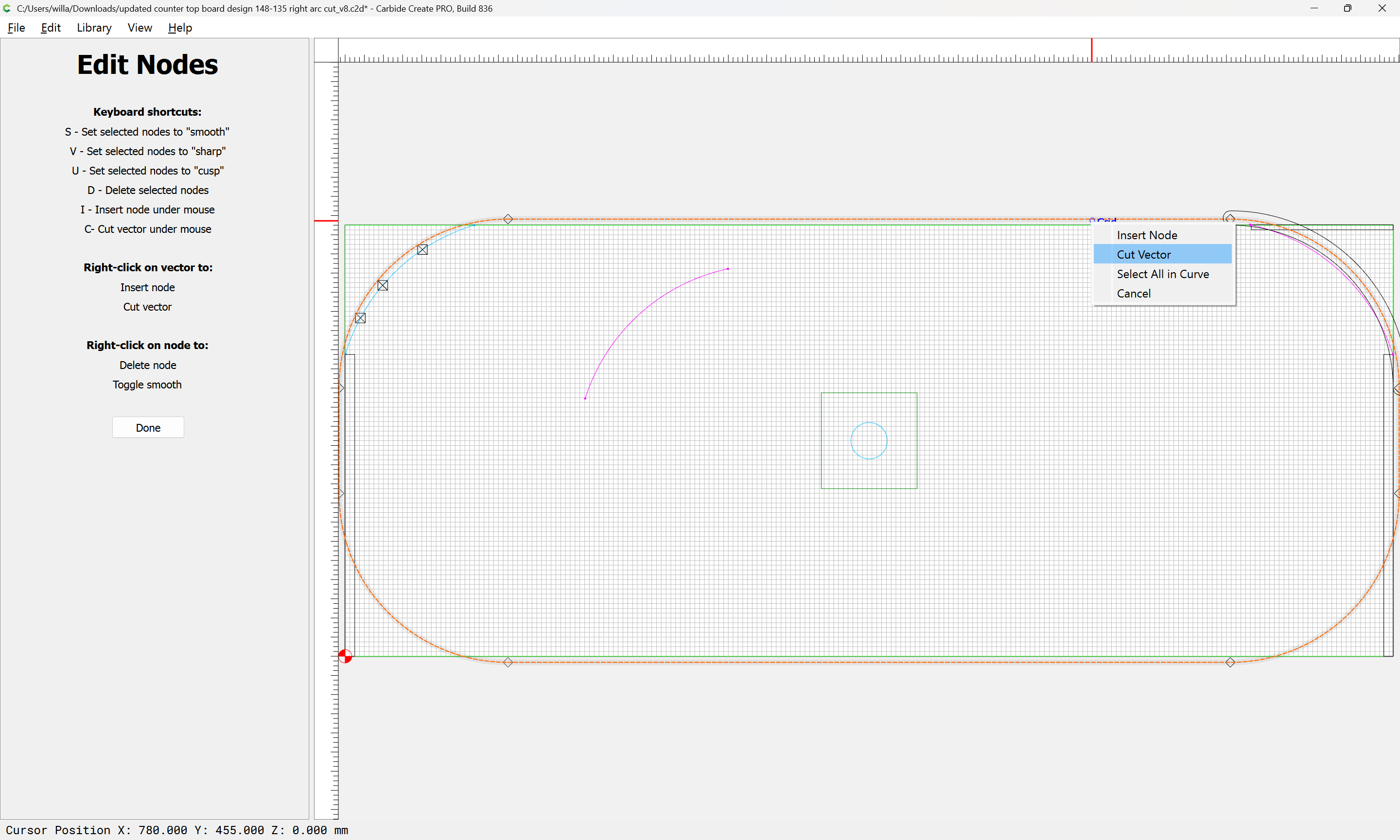

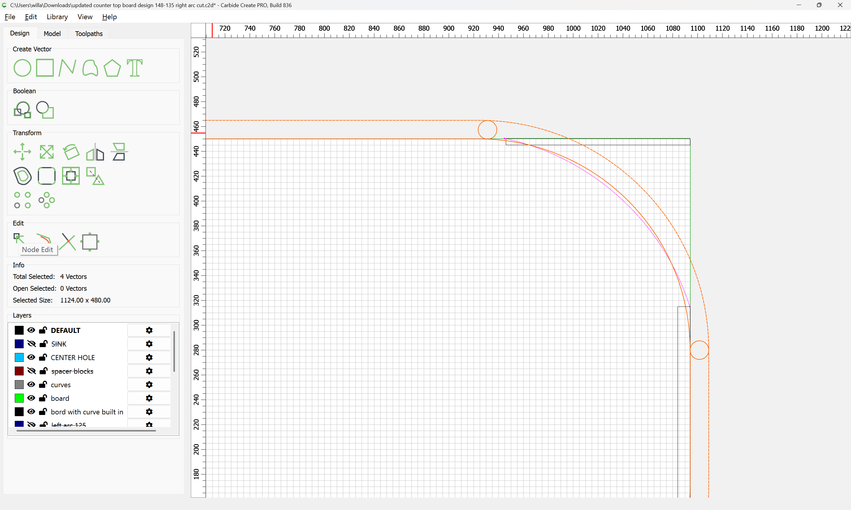

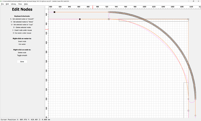

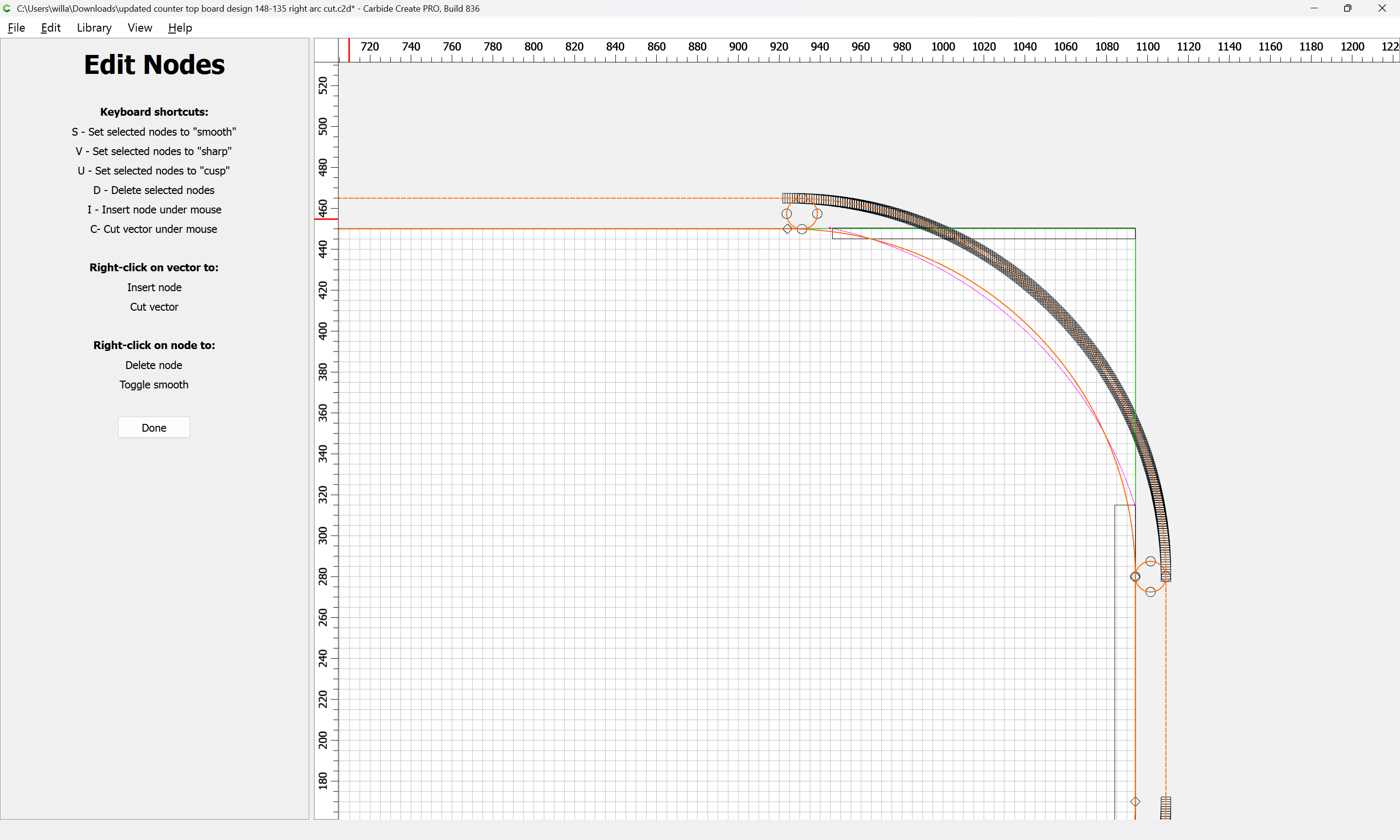

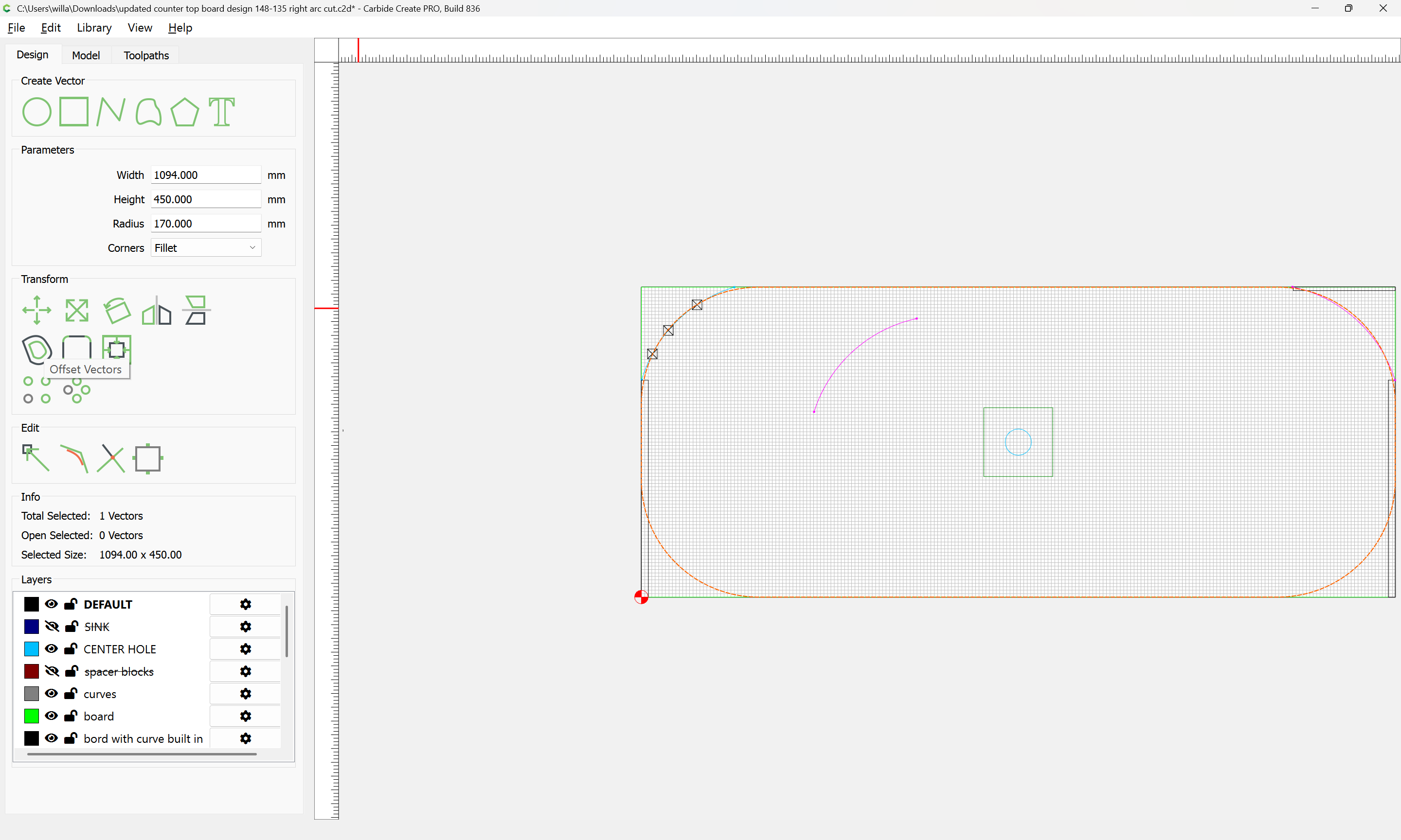

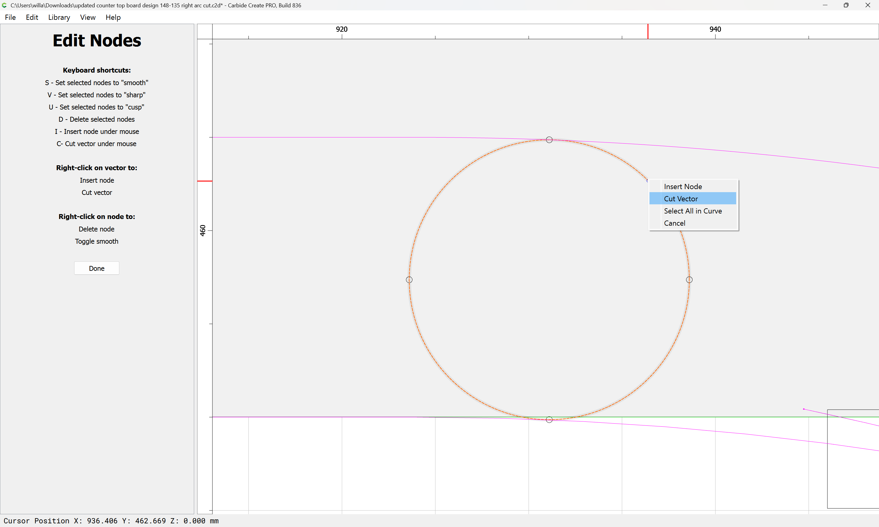

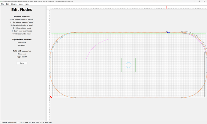

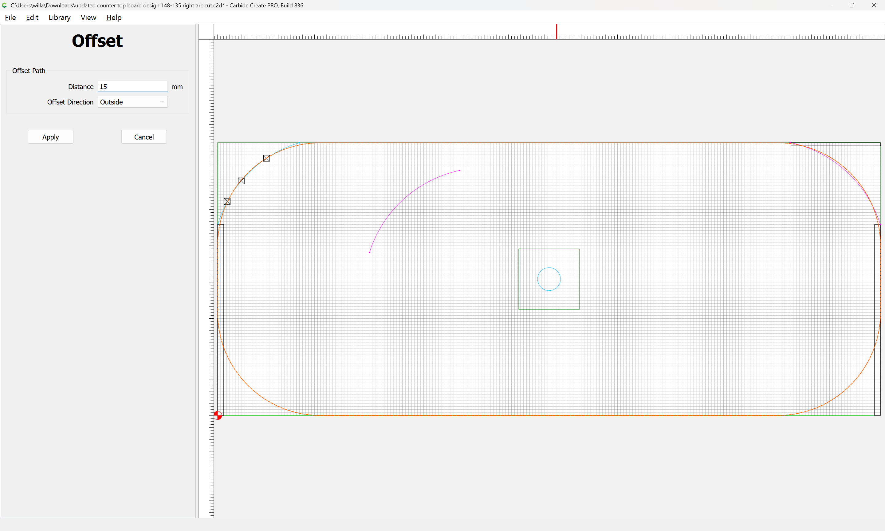

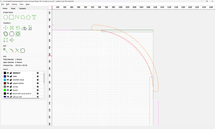

That said, it is almost always better to draw closed regions which define what one wishes to cut:
Duplicate the original:
Select everything:
and use Node Edit:
to edit down to only what is wanted:
if need be, re-selecting:
and selecting:
and deleting:
Until one arrives at:

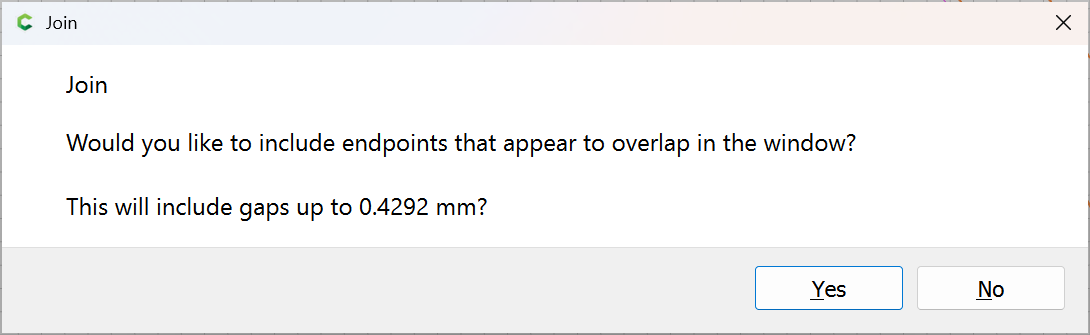

Use Join Vectors:
Yes
o

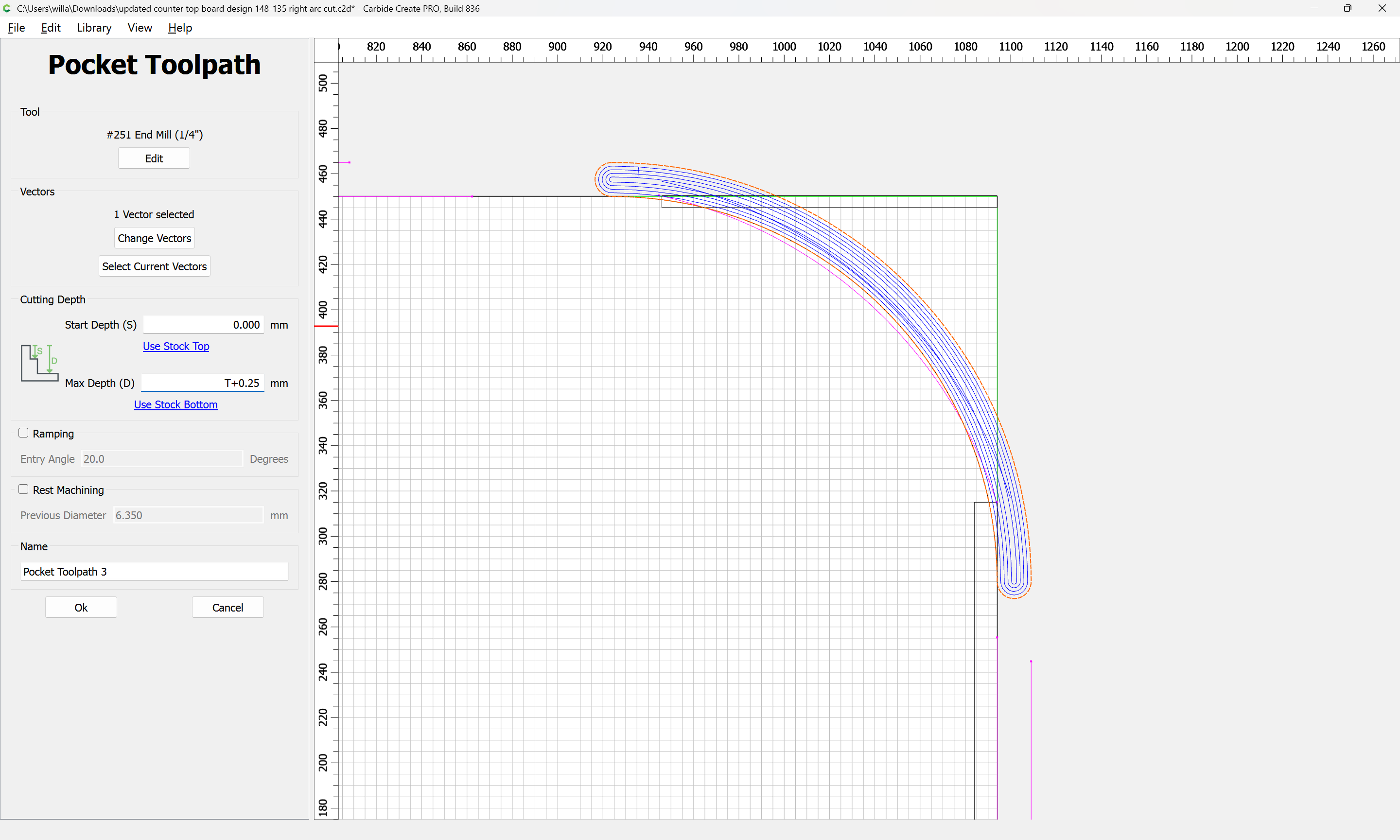

and use the pocket for the cut:

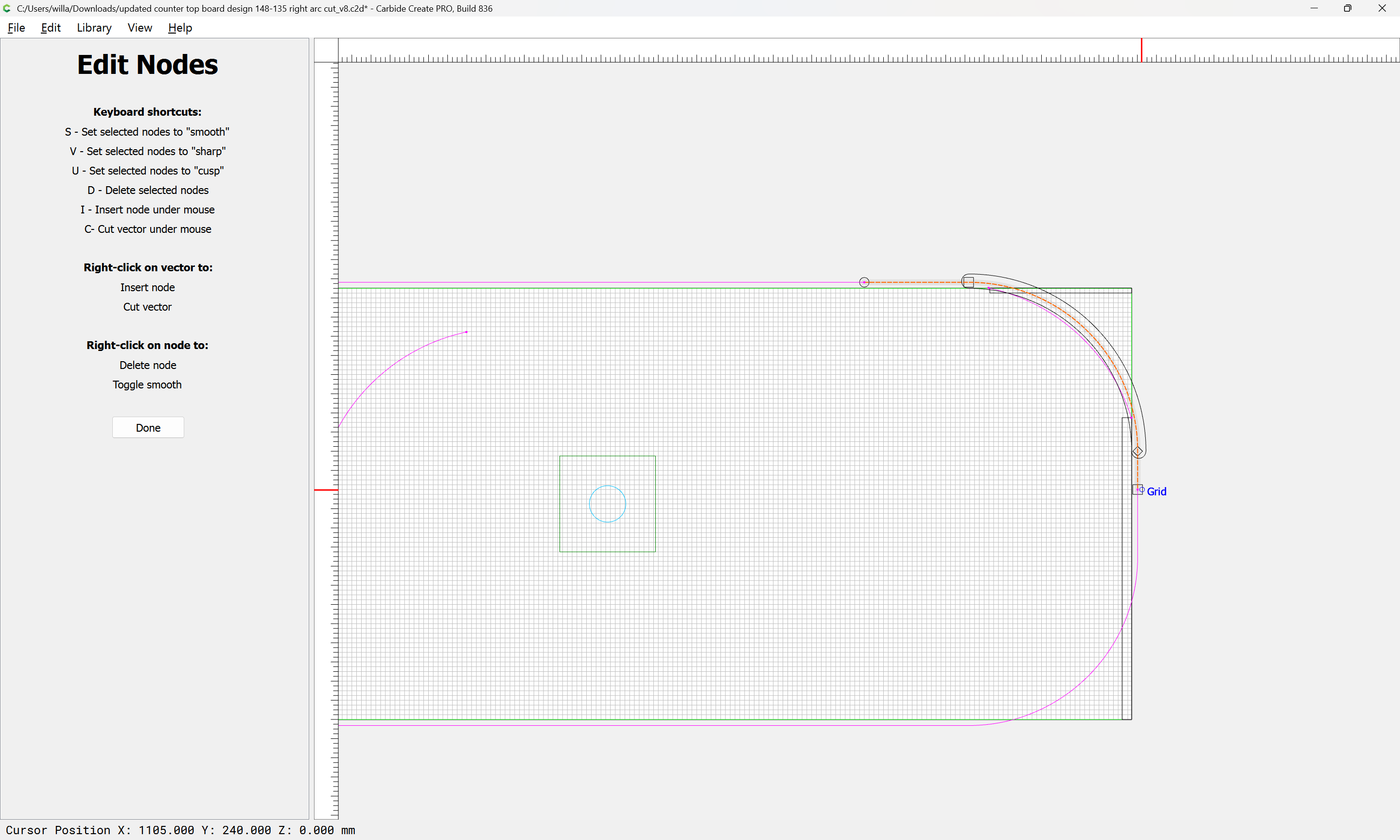

Attached as a v8 file:
updated counter top board design 148-135 right arc cut_v8.c2d (148 KB)

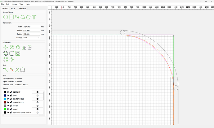

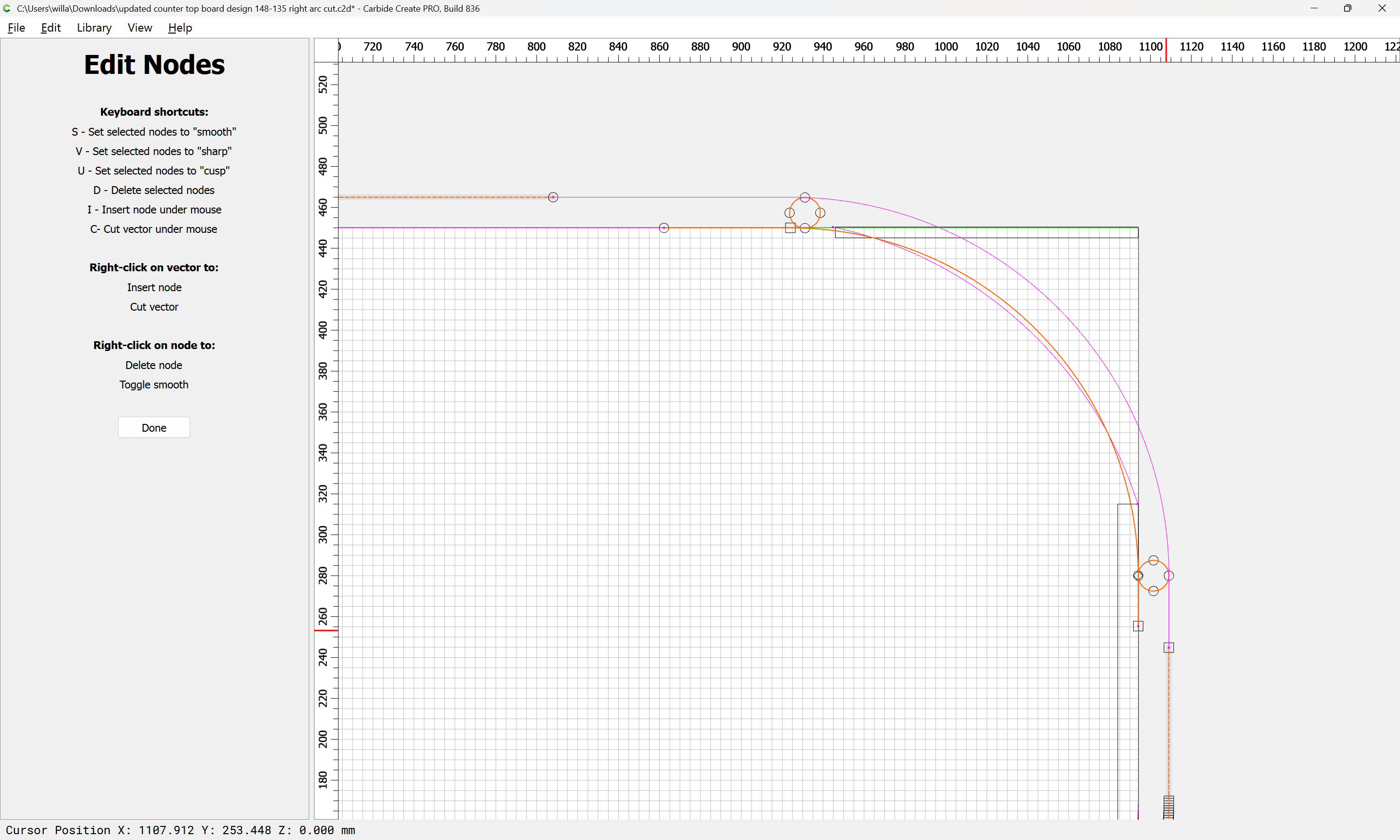

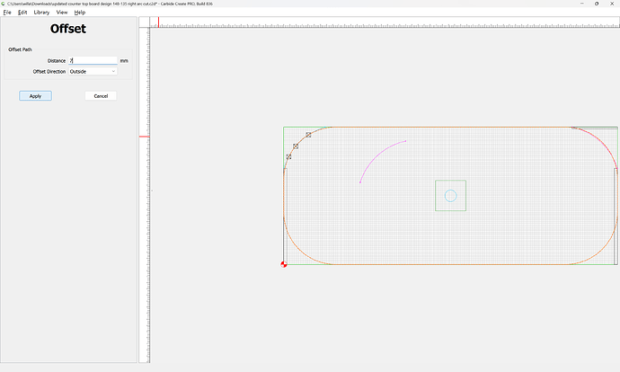

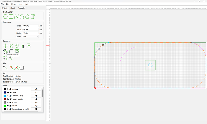

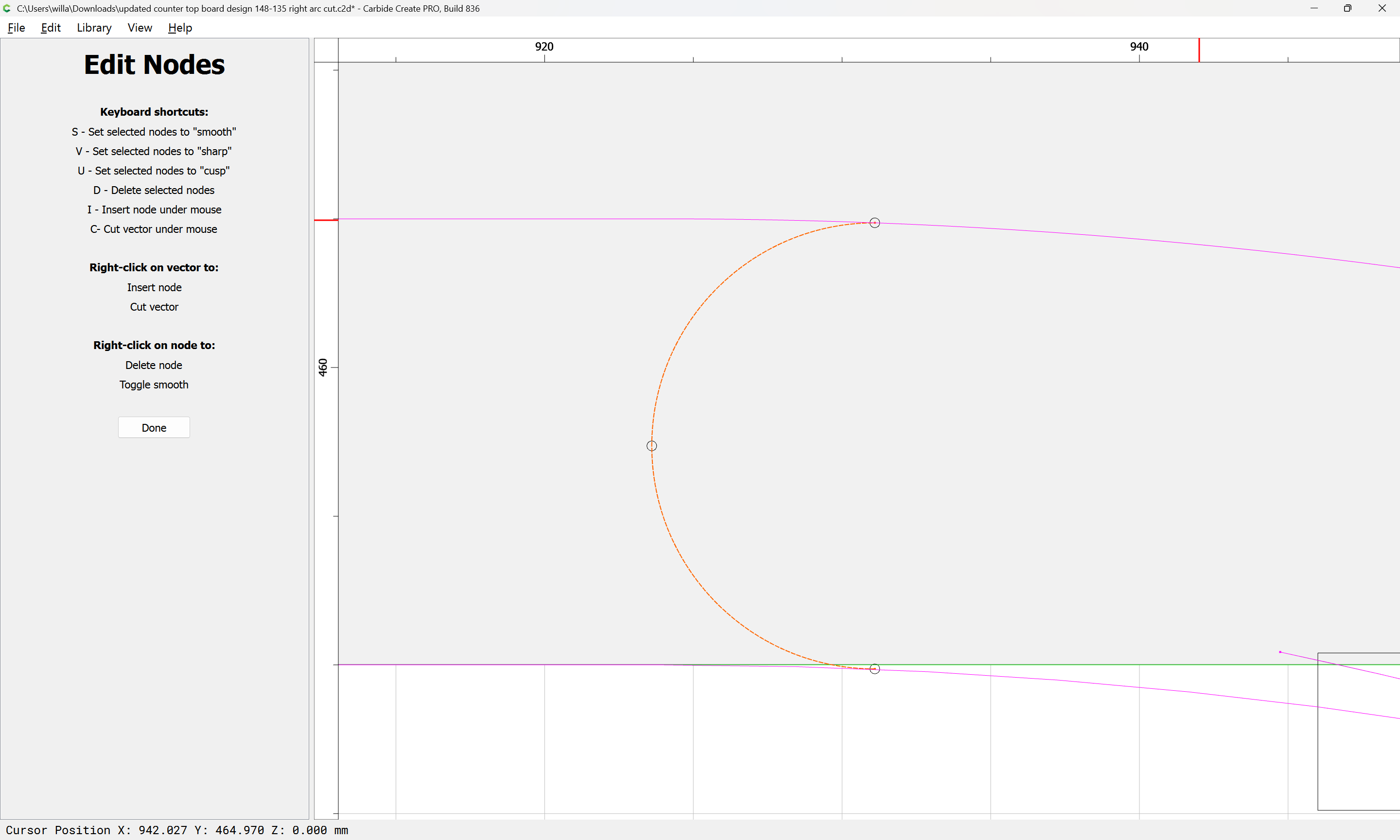

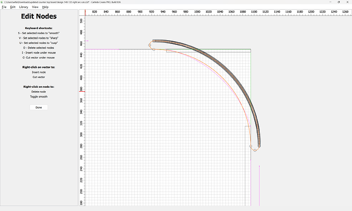

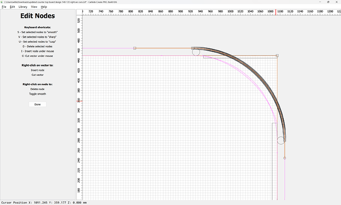

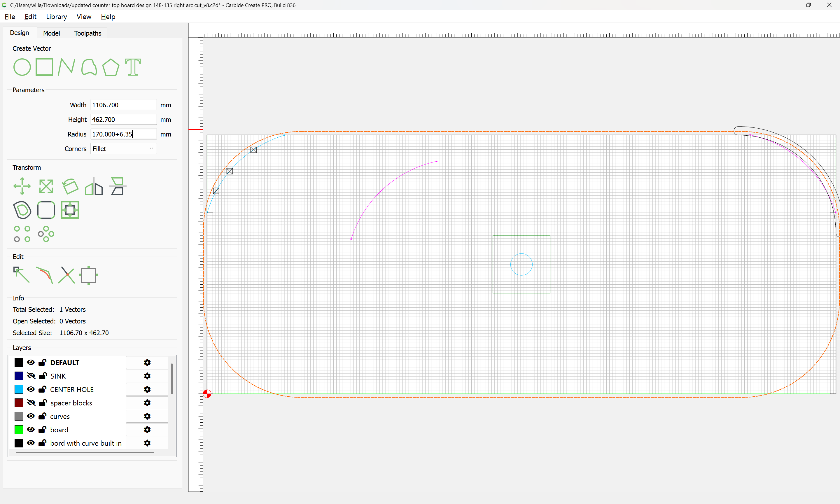

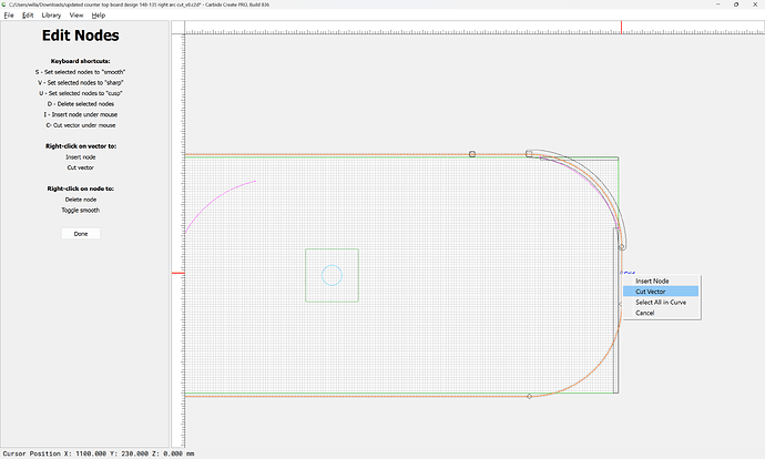

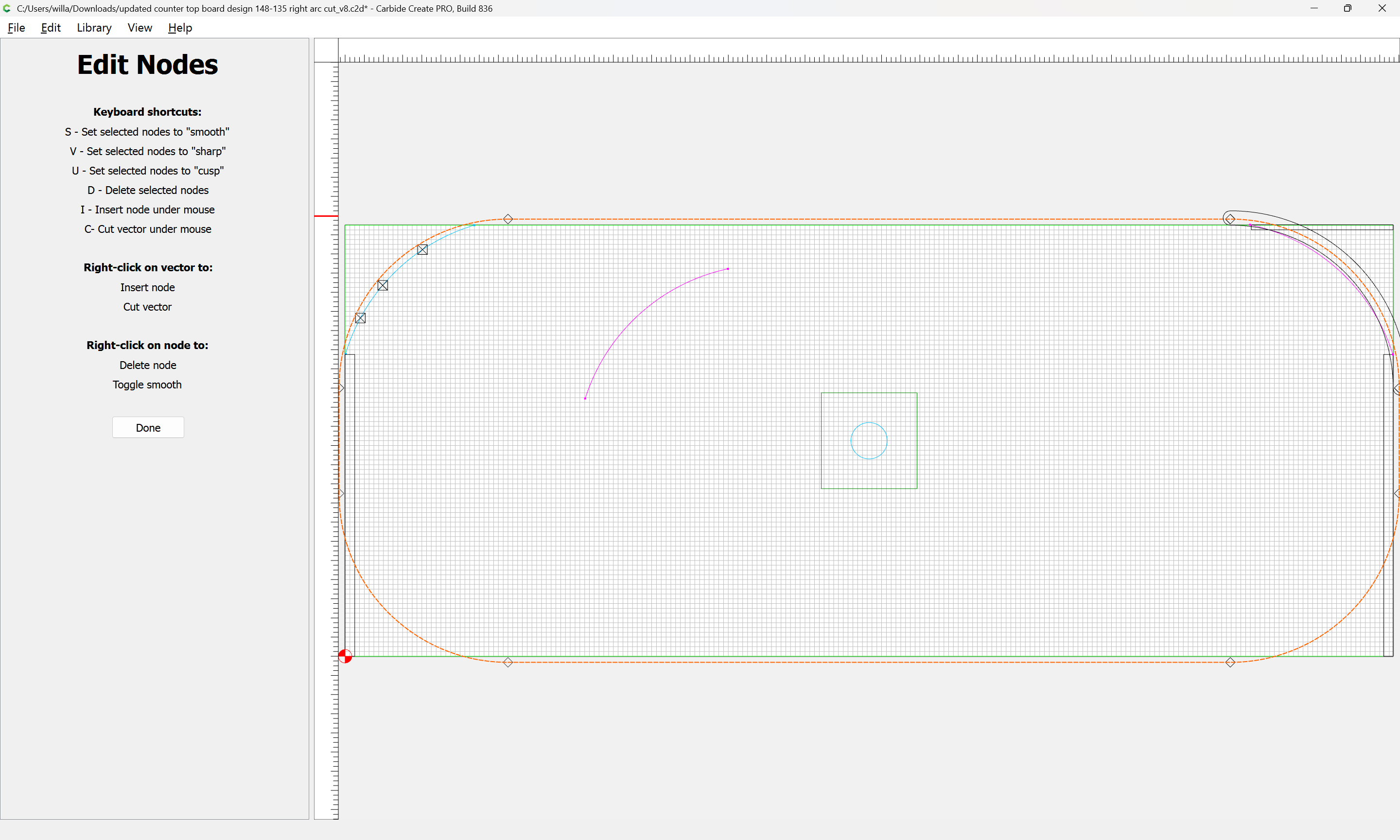

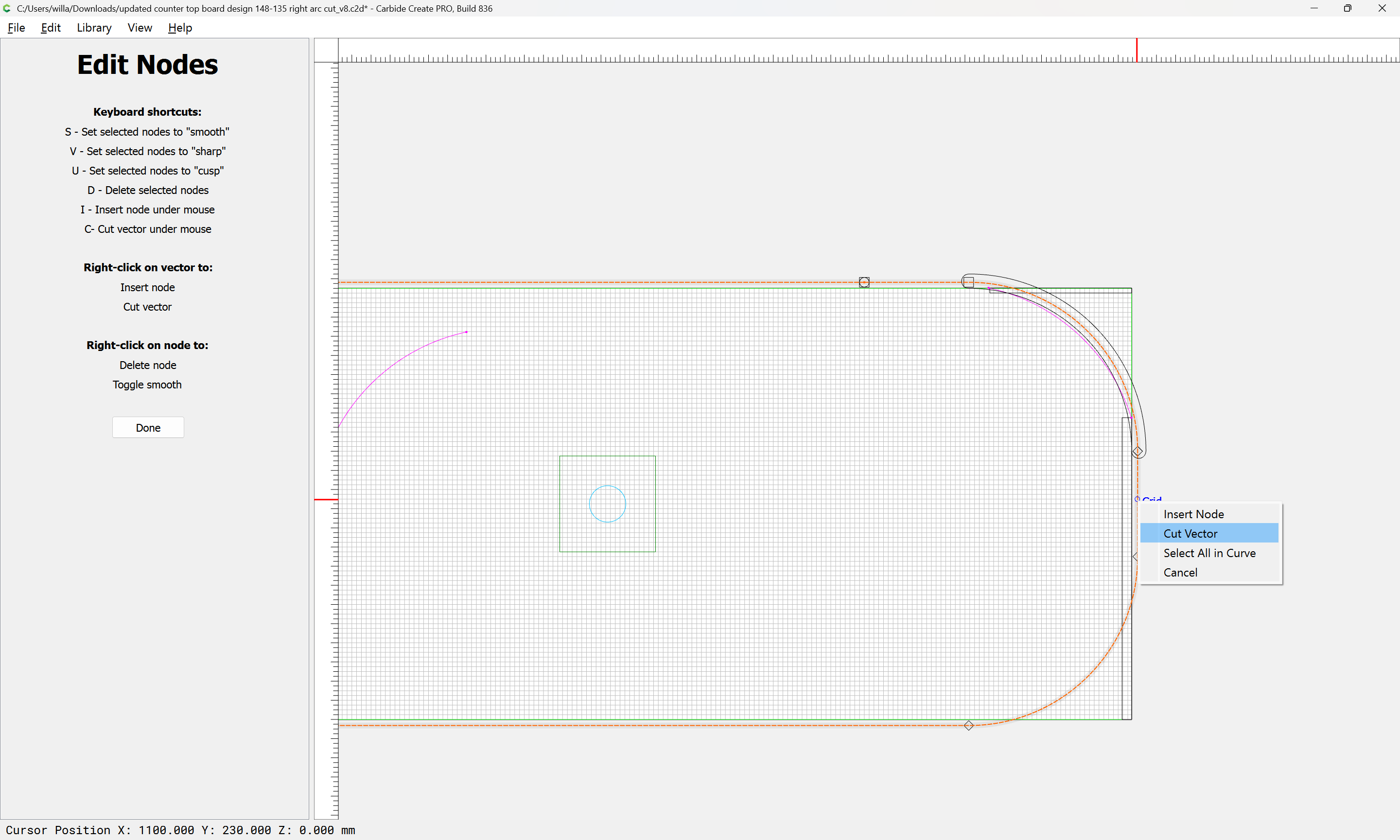

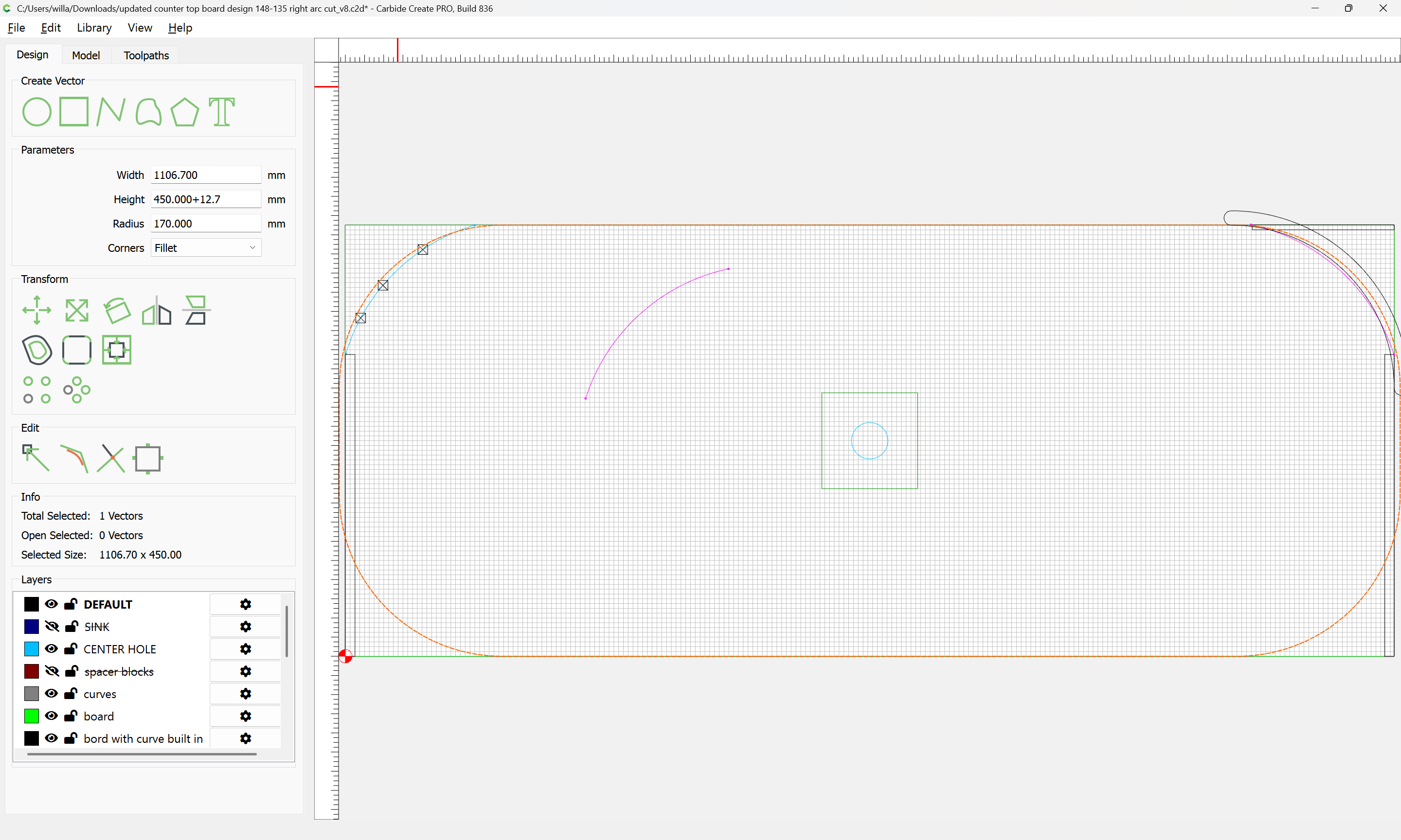

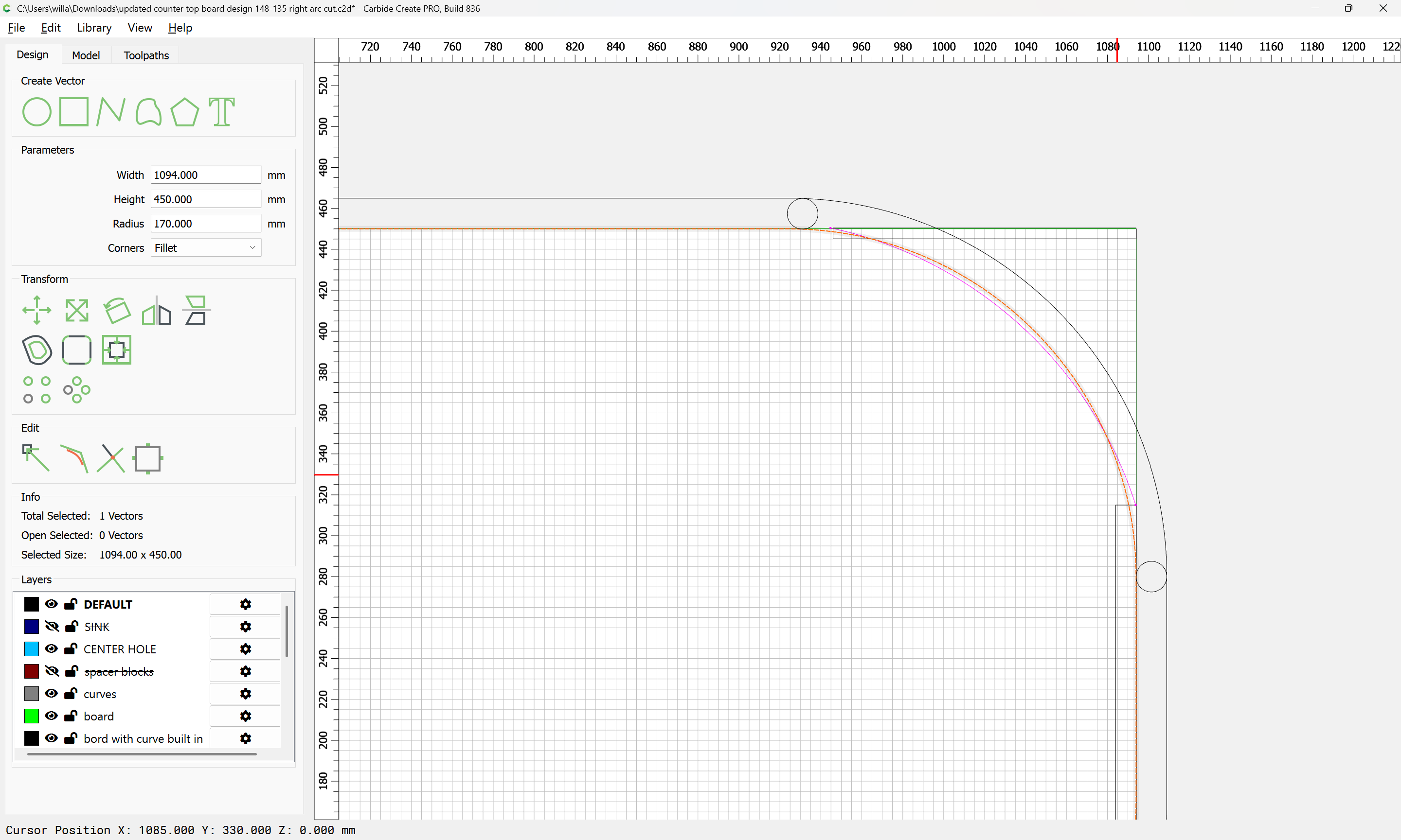

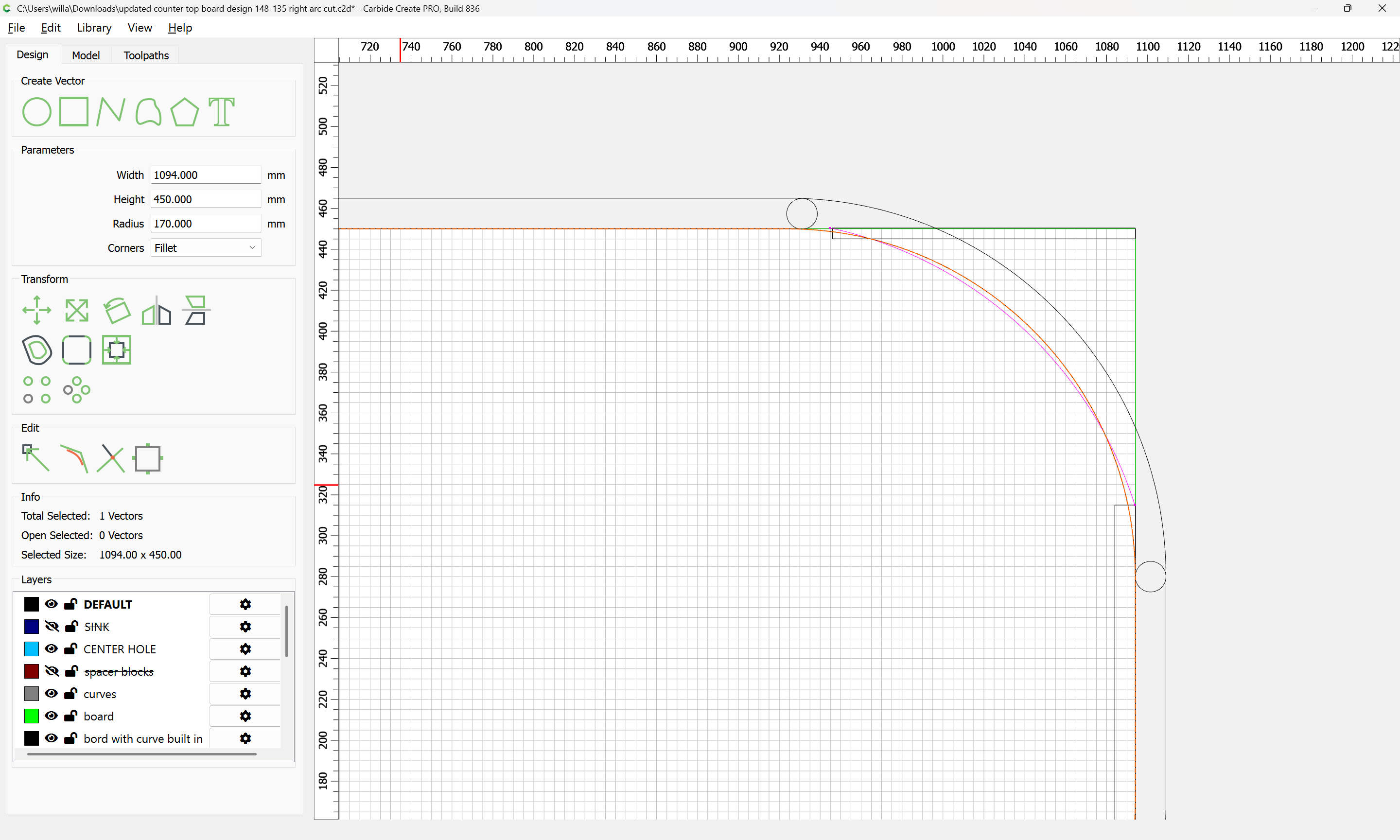

That said, if you’re willing top accept a No Offset Contour cut, then the necessary geometry is pretty easily made — add the diameter of the tool to the Width and Height or a rounded rectangle:
and if need be, adjust the radius:

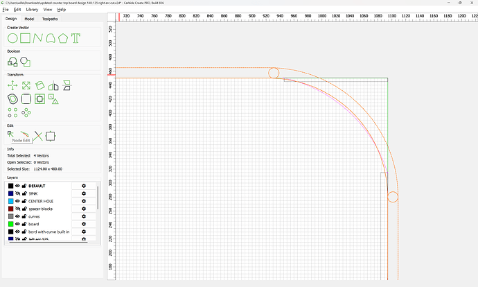

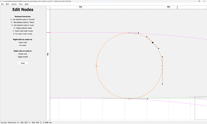

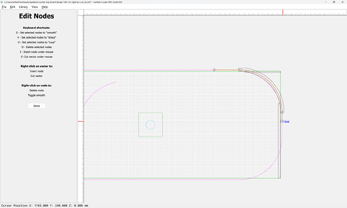

Then go into Node Edit mode:
Cut to either side of the arc which you wish to keep:
Select the two added nodes:
and delete them:

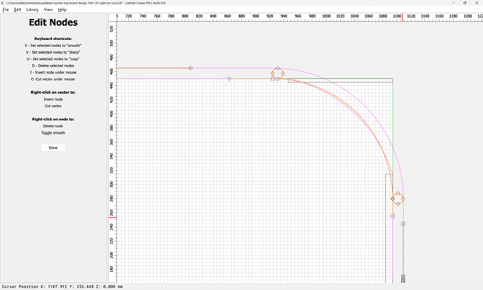

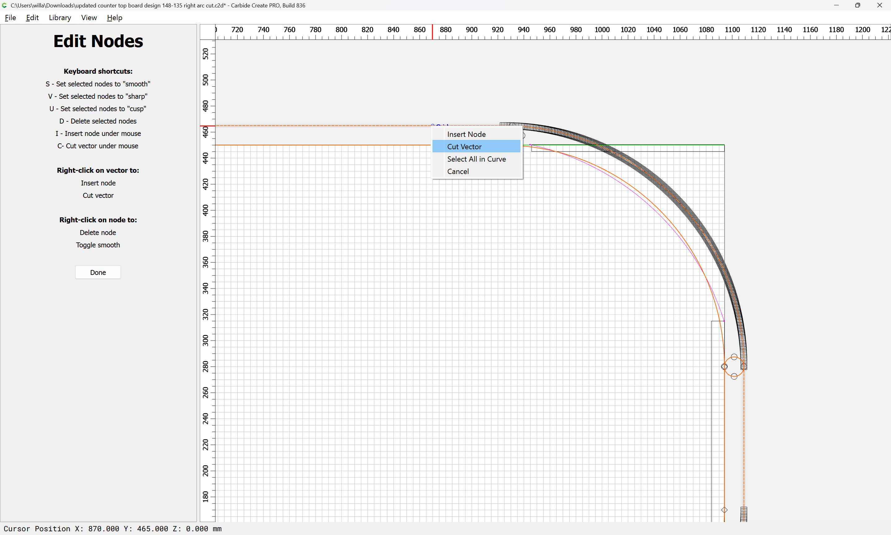

Will,
Thank you so much for such a comprehensive response. All brilliant ideas. I am learning these in CC. I have been meaning to get to use Fusion 360 which I believe has lot more features especially when it comes to 3D tool paths. Learning curve is steep I understand. All in good time. CC is for now my go to.
Following your earlier response, I made the 2 corner curves using 2 concentric circles and a small circle between them as in your response and edited out 2 pockets to cut. Then I used the node editeor to make it better fit the cut I wanted as I was fixing the cut I already made to rid of the lips. I get it that the pockets are better way to go about this but it does take longer in thicker boards.
