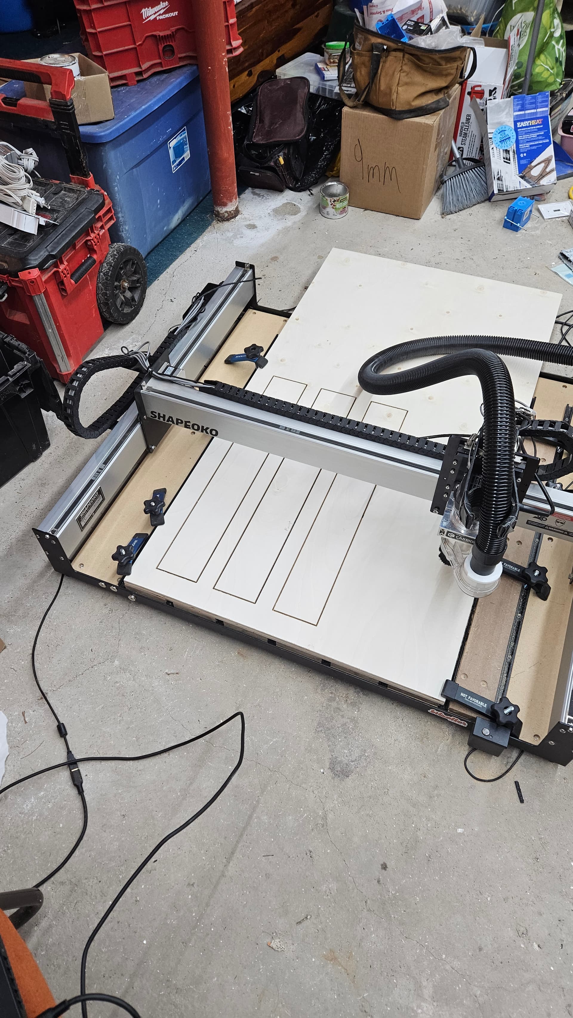

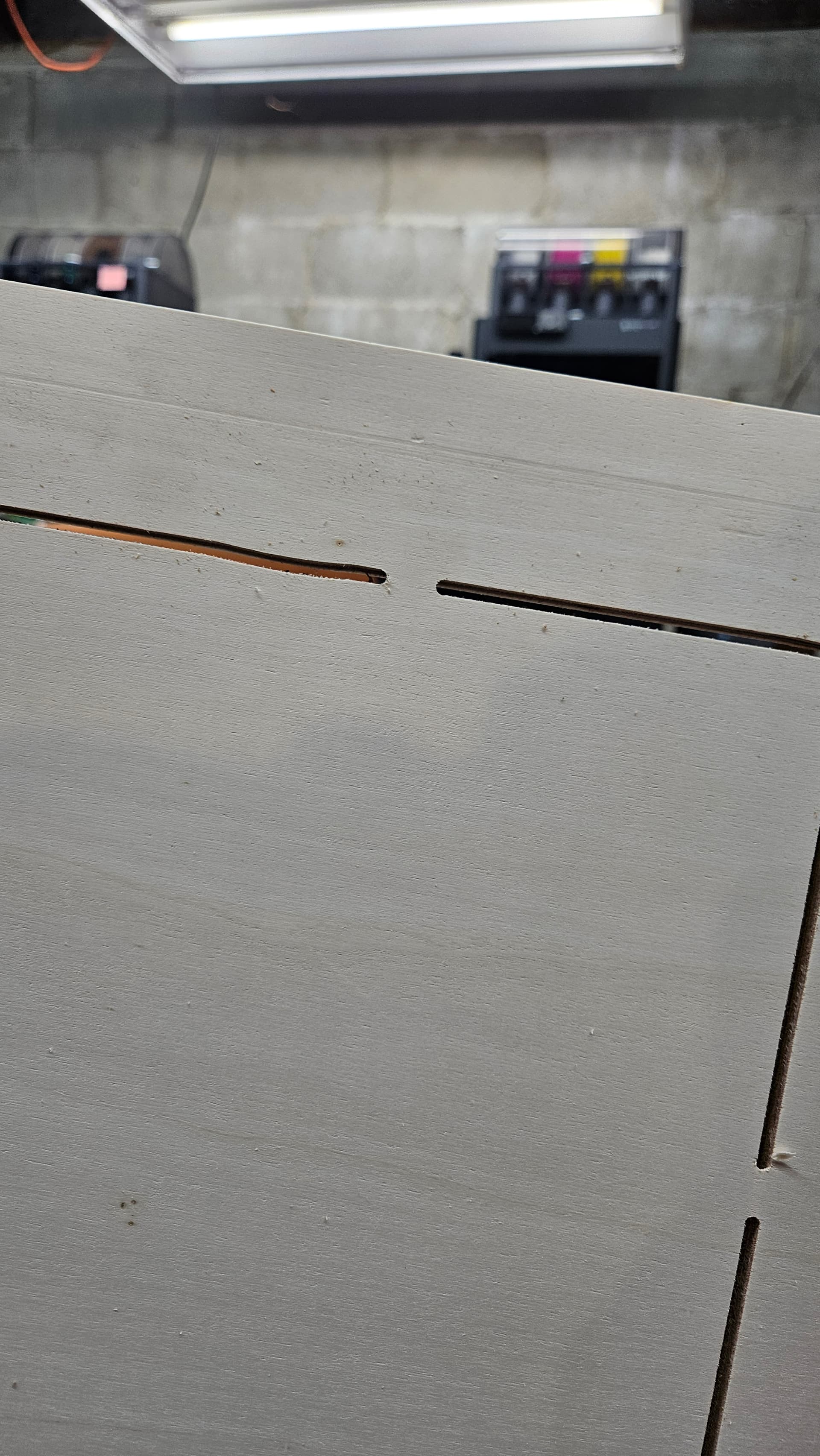

I am building Parson’s Cabinet per the plans he posted here a few years ago. I noticed on one of the passes the router was traveling straight up the y axis and it swerved out and back in on the x axis. It only did it once so i dont think it is anything to do with a bad belt tooth or anything.
Has anyone experienced this? As the cabinet is being built, it is sitting on a concrete floor and i understand this is not ideal.
Edit: i forgot to mention that i was playing with the speed override and took it to 140%

It might be a tooling engagement issue — where possible avoid slotting and add geometry and cut as a pocket

Im new to this and am really sure of what to look for. I do plan on tuning up the machine once the enclosure is built. Its not easy to do much at ground level.
I think i understand what you are saying. Are you thinking the bit being engaged on both sides caused it to grab and yank the whole thing sideways? I am familiar with that effect from trying to use a palm router.
@Jho yes that is what @WillAdams is saying. In the CNC world we call it slotting where the bit is engaged on both sides to avoid this you could offset the boundary by the bit width and carve/pocket it down to close to the bottom of your work piece and then run your contour path. Sort of like with a palm router working the bit in to your line your routing. Hope this helps and makes sense. -Tony

You have to be careful with laminates. The sandwiched layers can contain knots etc and this could affect the router travel, more with a belt machine than a ball screw machine. The fact you were ramping up the feed while slotting is most likely the cause.
