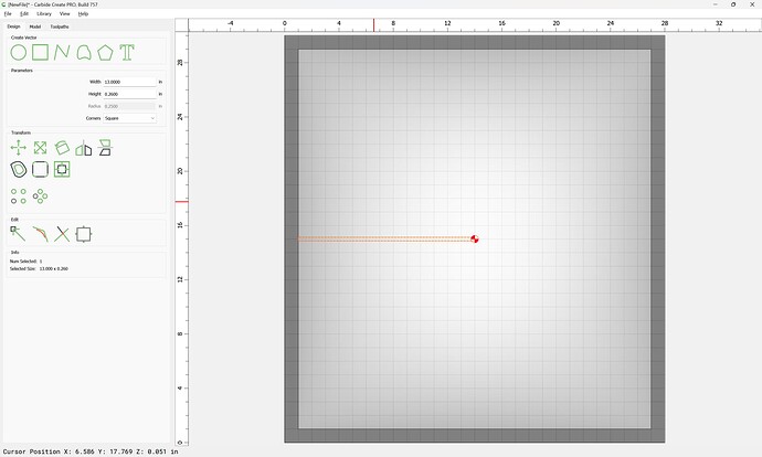

Trying to cut a .26 in pocket 13 inches long with a bottom depth starting at .125in and ending at .26in .
this is used to hold small .25 inch x .25 inch stock 13 inches long. A plane will be used to taper .25in stock .

First, model the stock:

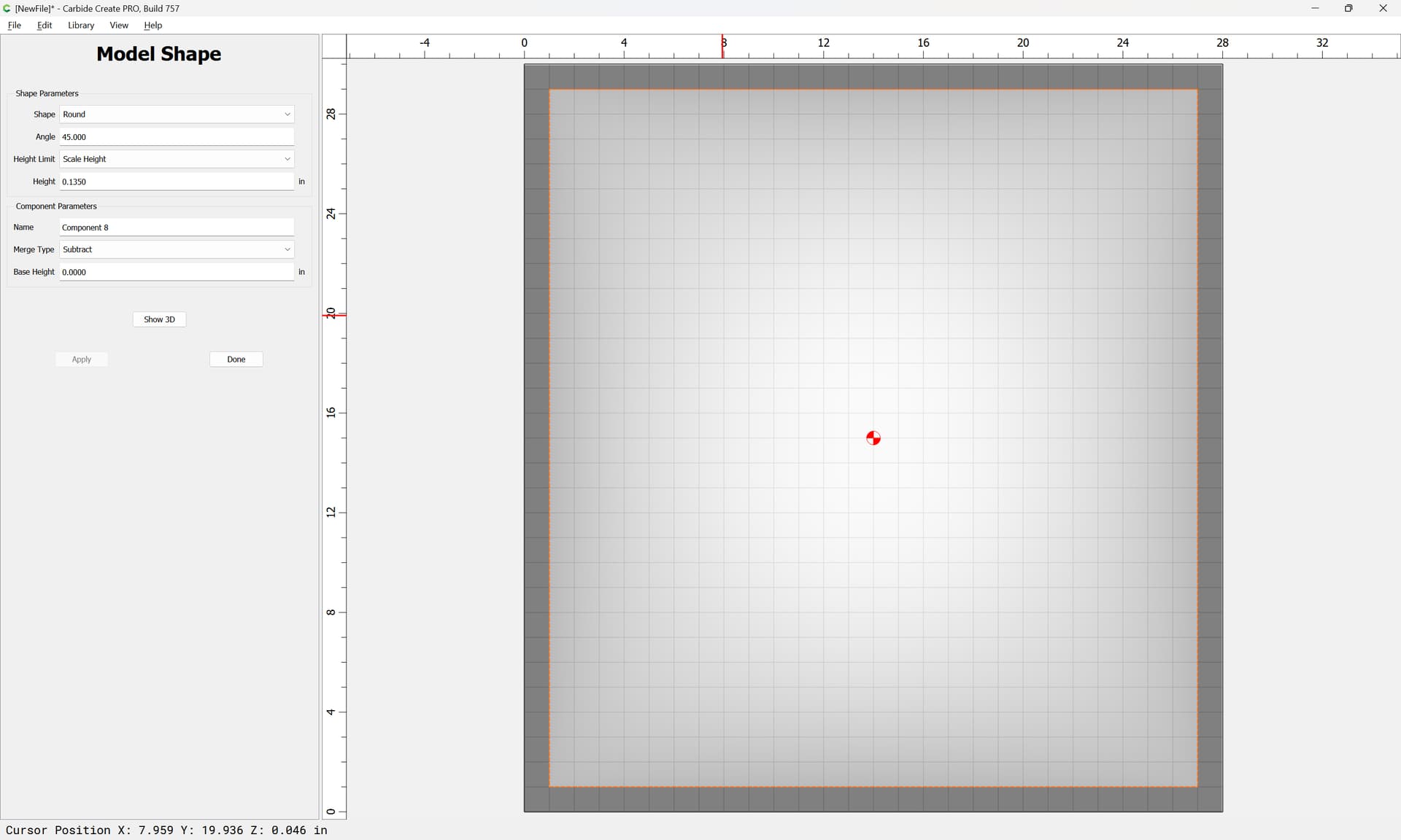

Then subtract the 0.125:

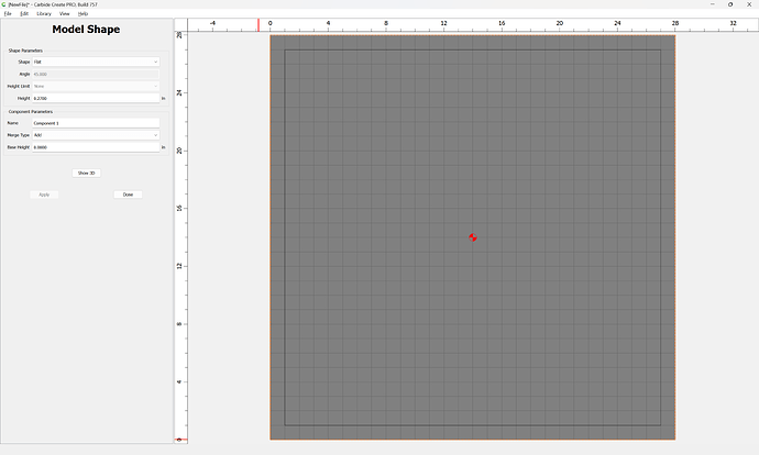

Then subtract down to the balance to get the 0.26" total depth at an angle:

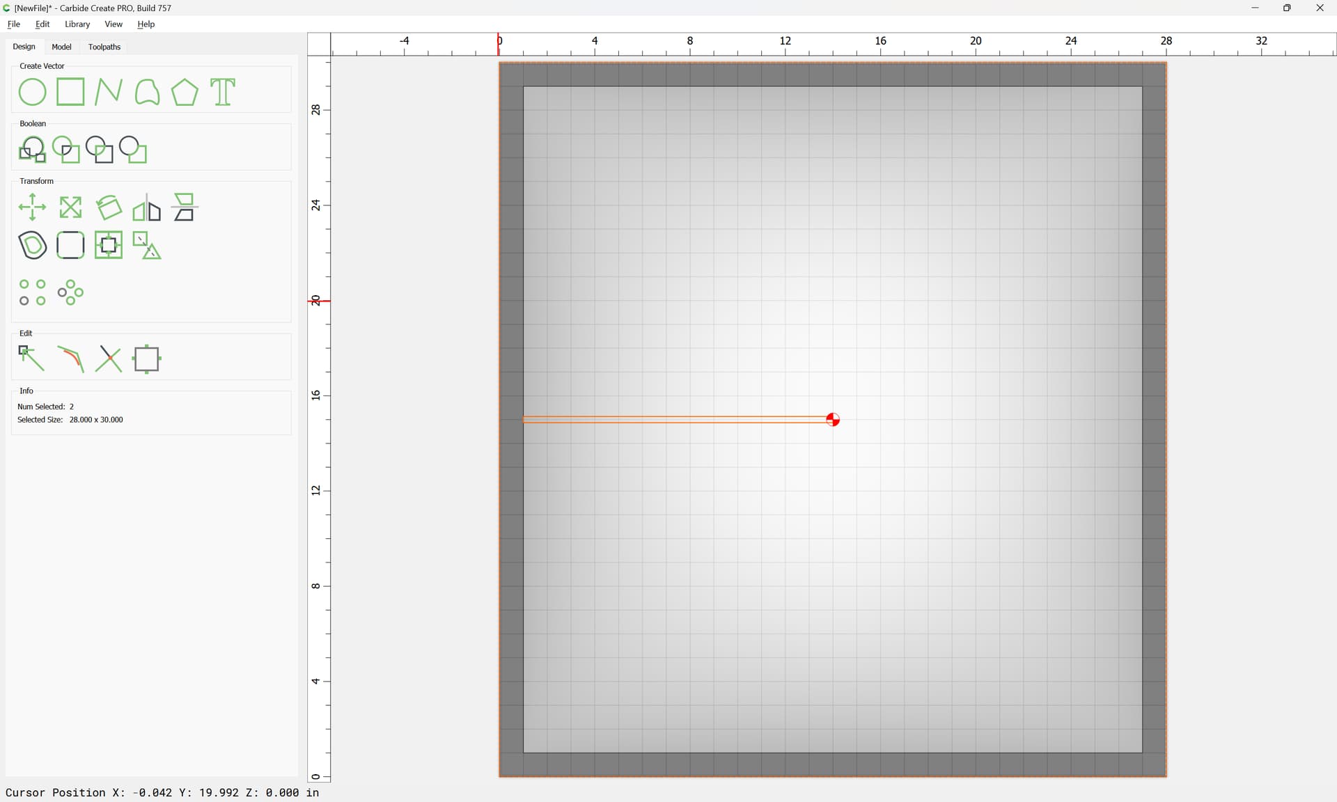

Then model things to the base height:

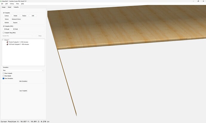

Then the pocket can be cut using a 3D toolpath — doing this partially so that the profile of the cut can be seen:
