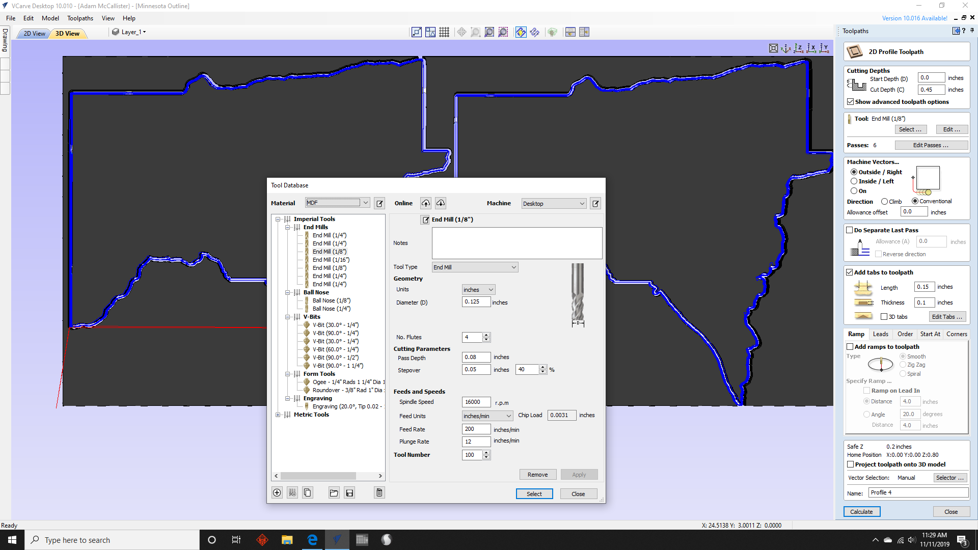

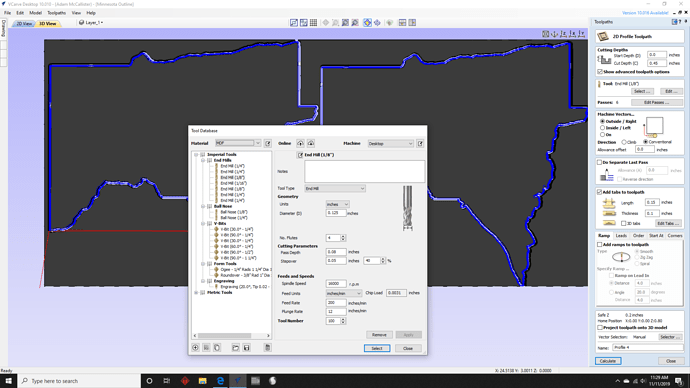

I just bought Vcarve desktop and am trying to run a simple cutout.inhad the feed set at 60 inches/min and when I tried to run the cut it was barely moving even after going to 200% in carbide motion. So I tried to adjust the feed to 200 inches/min in Vcarve and running it again same issue. Vcarve says the estimated time is 7ish minutes and it’s probably taking that long just to run the first pass.
So no idea what I’m doing wrong.
Can you show a screen shot of that tool path settings? And the bit settings for the bit you’re using too.
I just noticed on Carbide Motion it is showing MM at the bottom on the run page, even though I selected the Shapeoko Inch post processor in Vcarve and I double checked again to make sure that is what I selected. Also while it is cutting it goes really slow on the jagged sections but flies through the straight parts.

The tool path generally looked OK and the only thing that stood out was you’re using 4 flutes for an 1/8" end mill and I’ve not seen one of those. It’s unusual but not causing your problem. Have you tried using the MM post processor instead? I’ve had large issues with their Imperial post processor and use the MM post processor exclusively now. You can still do your designs in inches and the post processor will convert it when you save it. Try that and see if it helps.

Edit: I see that your plunge rate is 12in, if you have a lot of up and down, this will slow down the F&S every time the bit goes up and down, the Shapeoko slows down to 12in then accelerates but if it goes up or down withing seconds, it will not go to 200in.
