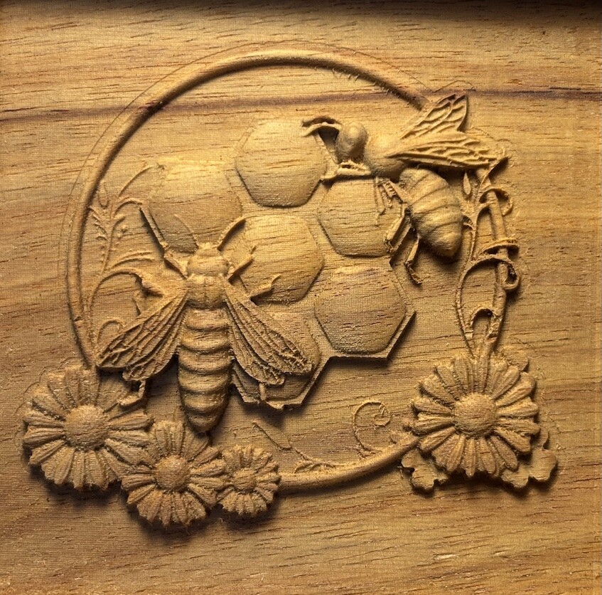

Good choice for cutting board due to the oily nature. But if they’re nice pieces I’d use them for some more noble cause if you have any artistic goals in mind. Teak, at least legacy species used in the USA, can take a reasonable amount of detail although slightly stringy. This piece is about 2 inches wide:
