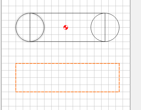

can’t delete 1/2 of the circles on the ends of my insert.
insert is 14.5" x 3.975". both ends are round. when I add the ends, I get full circles. I need to delete 1/2 of each circle on the interior.
I’m lost!

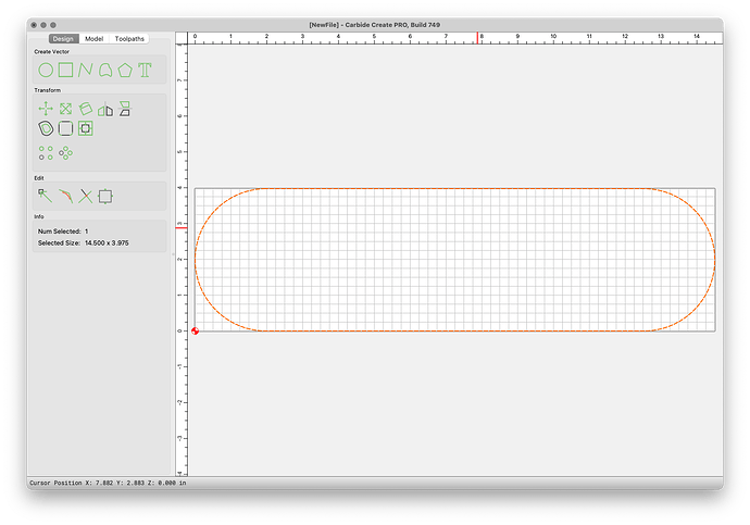

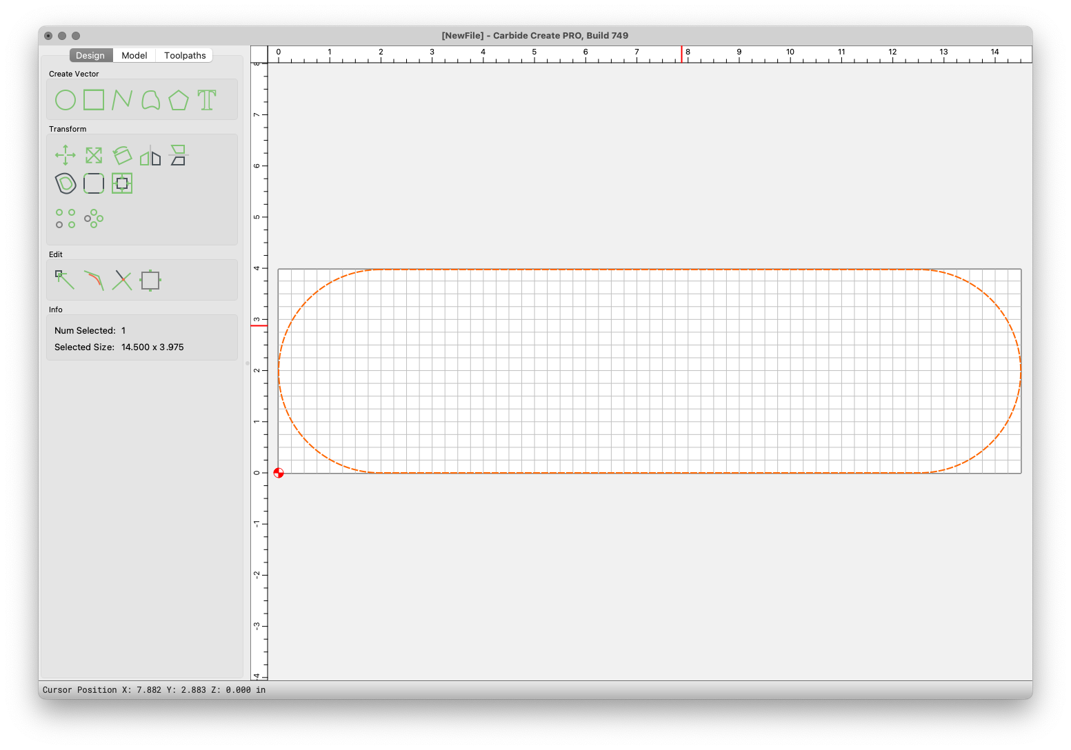

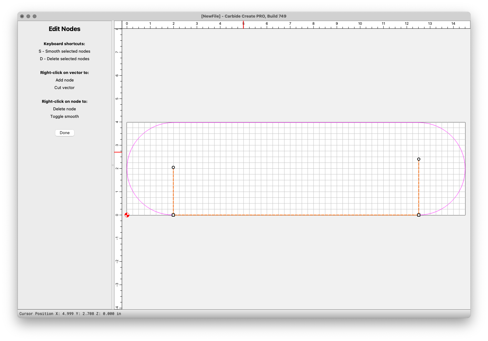

There are a couple of ways to do this.

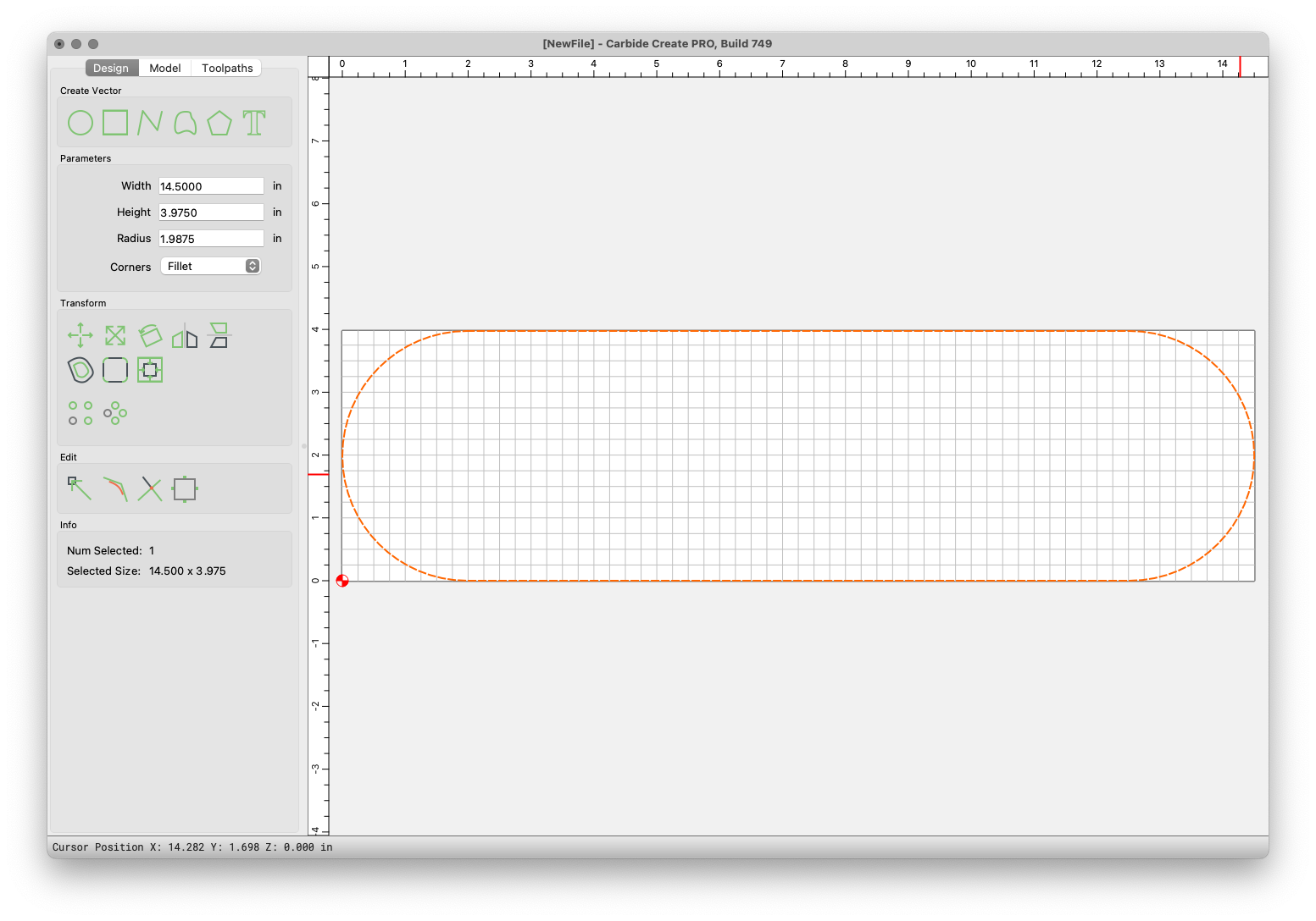

The easiest is to draw a narrow rectangle and round the corners/ends:

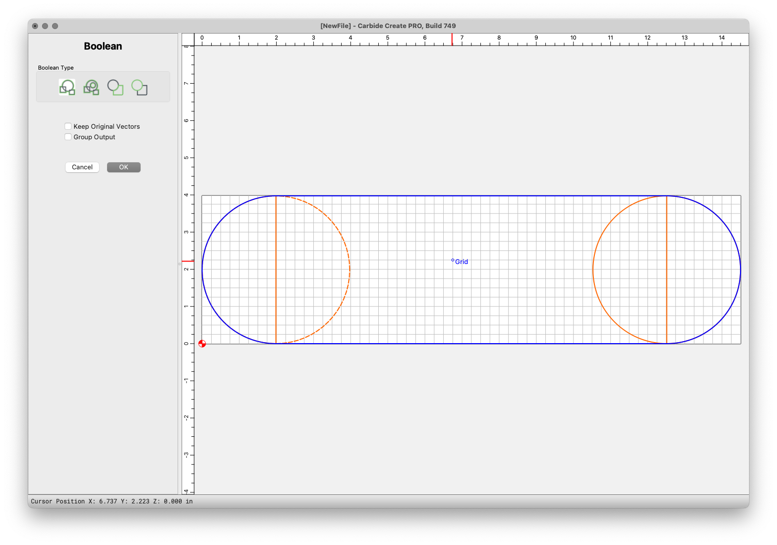

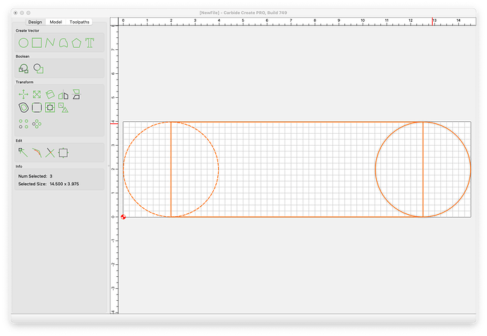

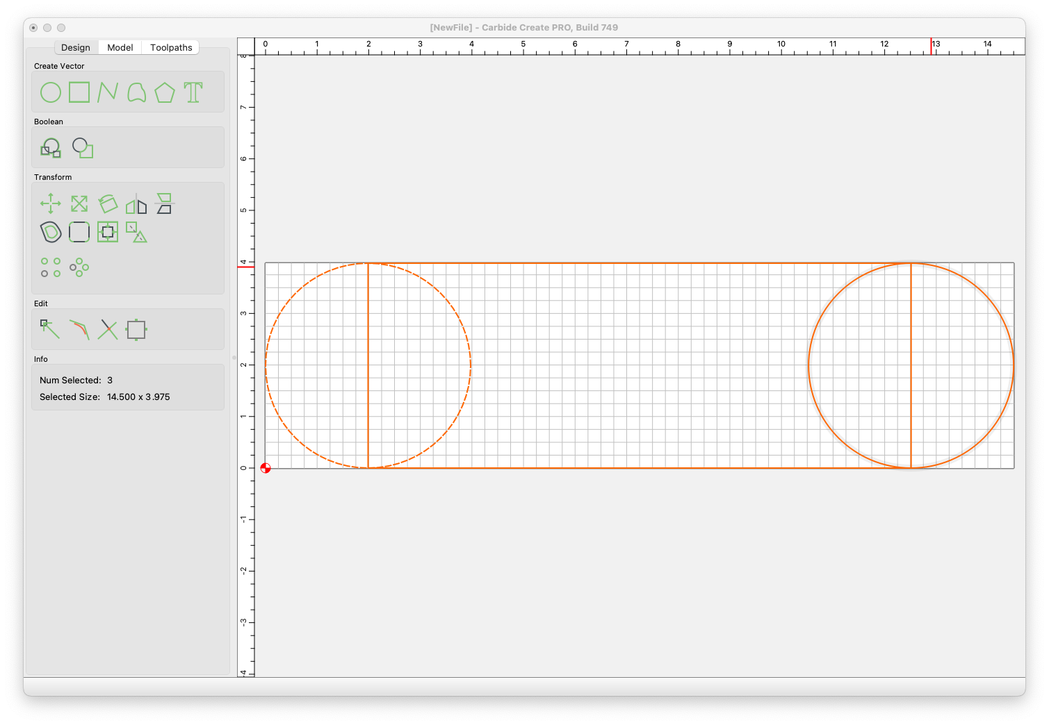

Or, you can draw a rectangle and two circles:
and either Boolean Union:

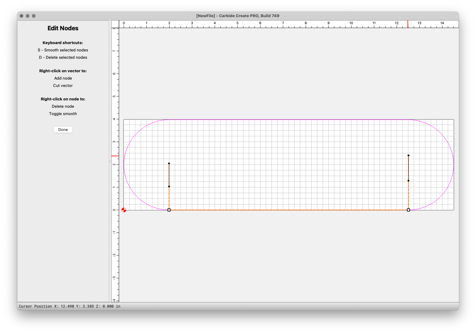

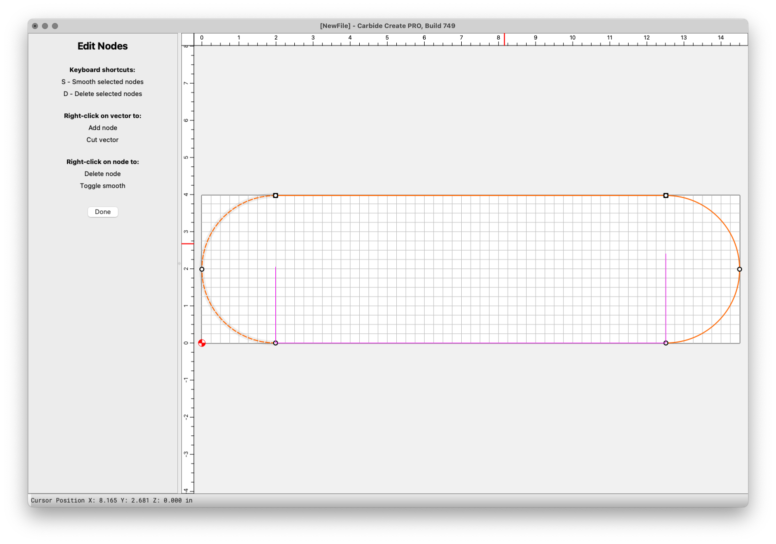

or Node Edit or Trim Vectors to arrive at the desired shape:
Screenshot 2023-03-03 at 3.55.14 PM
Screenshot 2023-03-03 at 3.55.44 PM
Done
Snap your circles to the placement you need at each end. Select the rectangle and one circle. Do a Boolean on that image. Do the same for the other end.
Although it is not aligned properly in my image here, is this what you are trying to get?

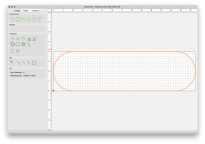

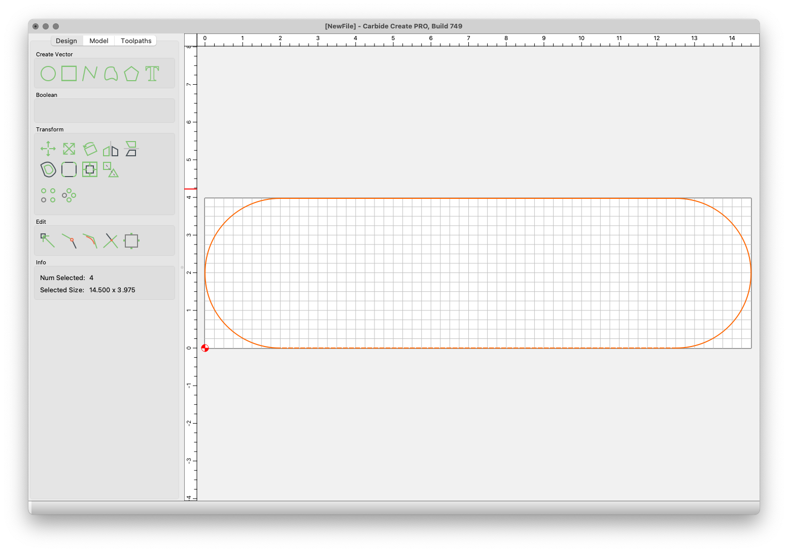

The way I would do it would to add a rectangle 14.5 X 3.975". Then make your grid .5". Then add your circle with the radius or 3.975/2 and then copy and paste your circles. Select your circles and move them to each circle is hitting the center of your rectangle on each side. You can now delete your 14.5 x 3.975" rectangle. Then make another rectangle that is [3.975"/2]+ [3.975"/2]-14.5=10.525 by 3.975. Place the center of each end of the rectangle in the center of the circles. Now do a boolean like @WillAdams showed and you will have your insert shaped.
insert_1
You could delete the first rectangle but I just moved it out of the way.
insert_2
insert_3
insert_4
There are a lot of ways to make an object in CC but it usually requires you to make some objects to help keep the project constrained like the first rectangle.
@WillAdams @gdon_2003 - Won’t the “Fillet” tool also achieve this corner rounding? Obviously, I don’t use Carbide Create often enough!

Yes, that was why I showed it as the first option in my post:
