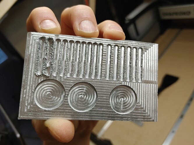

Destroyed my first end mill

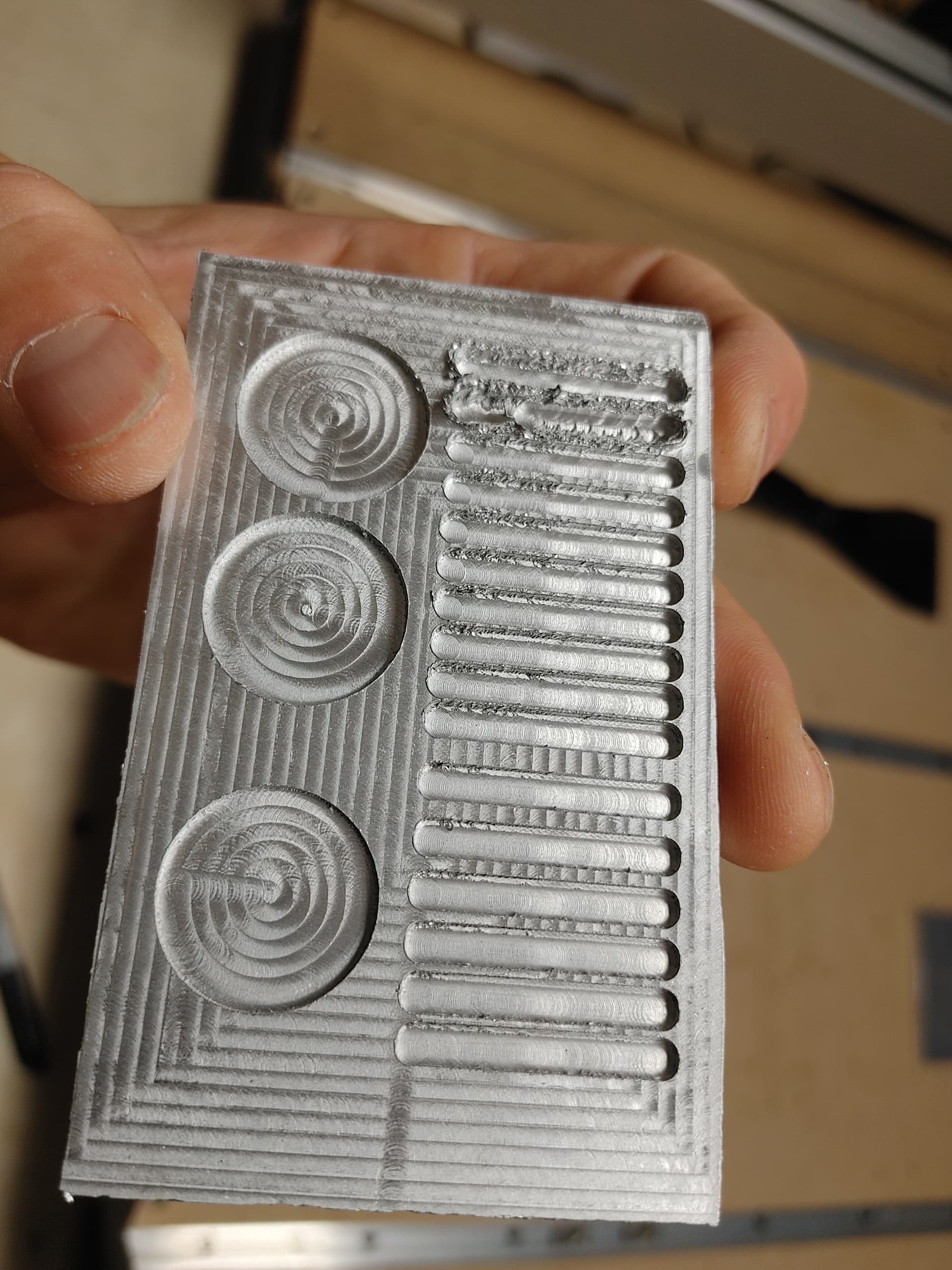

Well, I’m just gonna assume it’s destroyed - through excess heat and chip welding.
It was my first time testing a down cut end mill. I did a light surface pass and it did really well. Then I tried some 3mm pockets and it was a major fail.
Tool is a 2 flute 1/8" down cut end mill.
My settings were for a 2 flute 1/8" regular end mill. I tried to throttle back the speed while it was cutting but it was too late. Off to the tool graveyard.
Downcut pockets are the 2 on the far left. Rest are upcut.
Down cut bits are great for shearing the top surface edge of fibrous materials, to leave a clean edge, not so much for solid materials, as it forces the chips down into the material your cutting.
My trick: I only use ZrN coated cutters in Aluminum…they don’t allow the metal to stick to the cutter.
You may be able to salvage the tool by cleaning it in lye (easily sourced as drain clog opener at your grocery store — just check the label).
FWIW, I work in a machine shop were we machine aluminum and stainless steel to tolerances of ±.0002. We NEVER use downcut tools for anything, ever. Also, keep in mind that metals are usually climb cut (not conventional) with some rare exceptions having to do with side surface finish quality. If you want to keep experimenting, try climb milling. For quality finish we also use 3-5 flute finishing tools. Roughing and finishing tools are usually made for those specific functions.

One of the reasons we wouldn’t use down cut tools in metal even for finishing is simply because all edges get a chamfer or edge break, so imperfections left by a slightly worn up cut tool are not an issue. Not doing that leaves sharp edges in metal which will cut skin. Second, of course is lack of chip evacuation, which is what you experienced. Feeds and speed are also important for a good finish and tool life.
