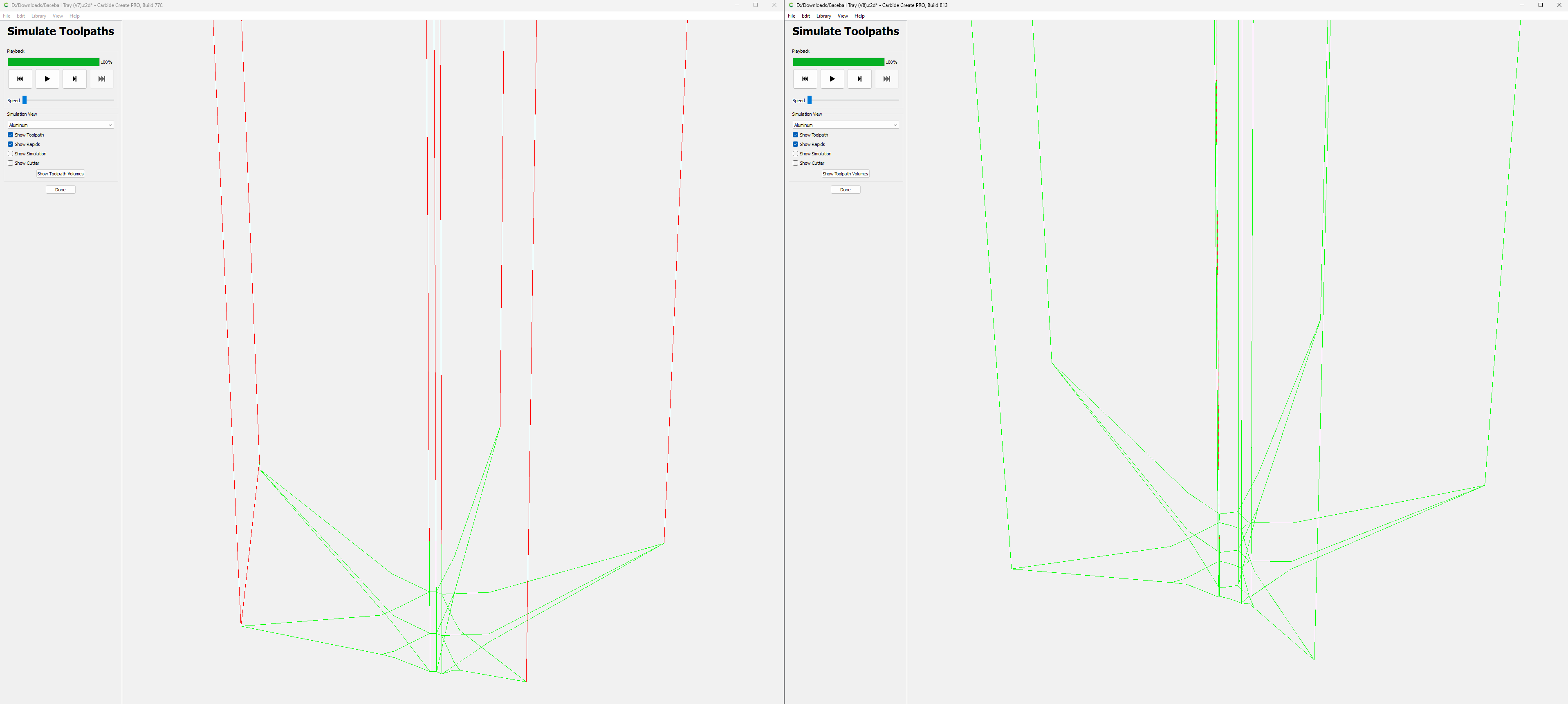

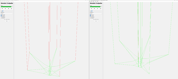

If anyone is curious, here is what I noticed.
I changed the project to JUST vcarve a single star, then compared (side by side) the toolpaths…
If you slow the simulation down to its slowest setting you can watch the both side by side. I don’t know if the red (rapid) lines between the two are (just) a visual different or an actual G-code difference.
I exported the G-code and attached to this message if someone wants to evaluate (I’m not a G-code reader).
7.nc (1.9 KB)
8.nc (2.3 KB)
Either way the V8 isn’t AT ALL up to par on the VCarve portion of things like V7 is. I too did a single star yesterday after this & it ran the same way… to many extra inefficient non-necessary moves that take up way to much time. Unfortunately until it gets resolved I’ll have to use V7.
