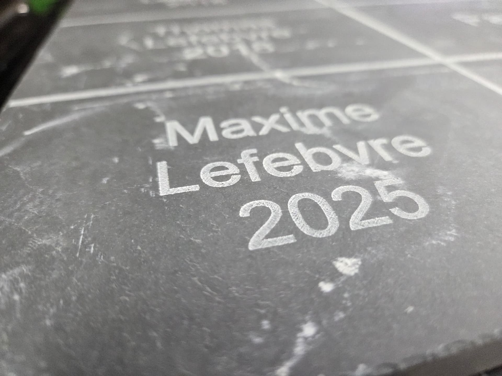

I am contemplating trying to engrave floor tile with a diamond drag bit. I have tried it on ceramic tile and have not been happy with the results.
Does anyone have experience if it will work, or have I just found another way to wear out an expensive bit?
If it can be done, any experience/recommendations as to types of tiles work best?

There has been some discussion here before:
https://community.carbide3d.com/search?q=etcher%20tile
the big things are:
- that surface variation are sufficiently shallow that the spring mechanism can overcome them
- how long the diamond will last

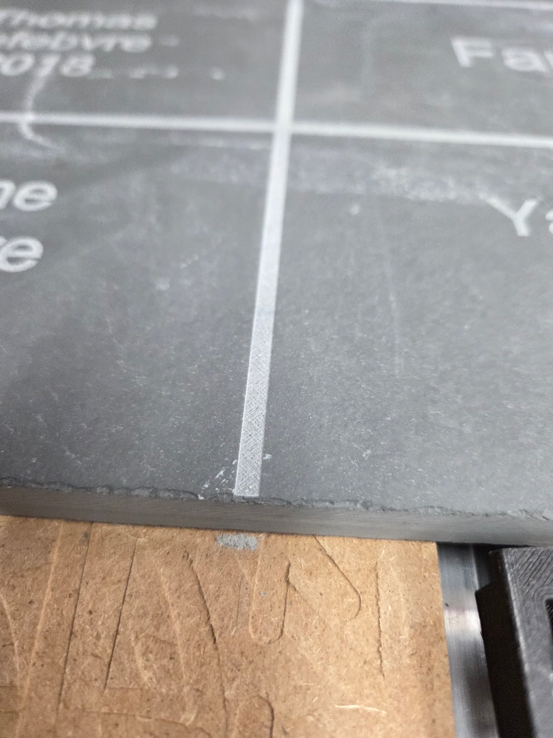

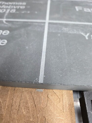

Here is the result i am having. Very happy about it.

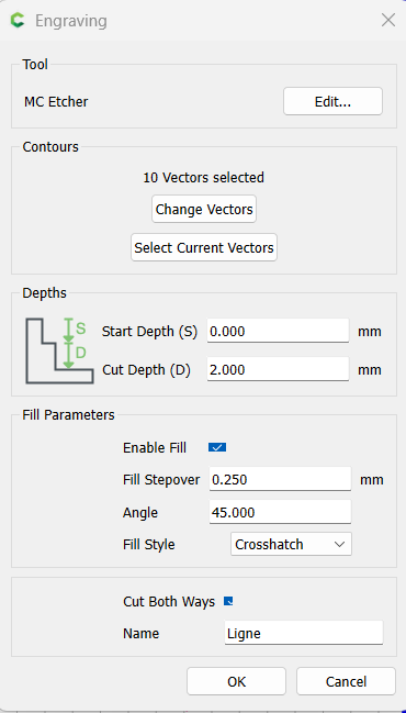

Yes, Here are my settings.
