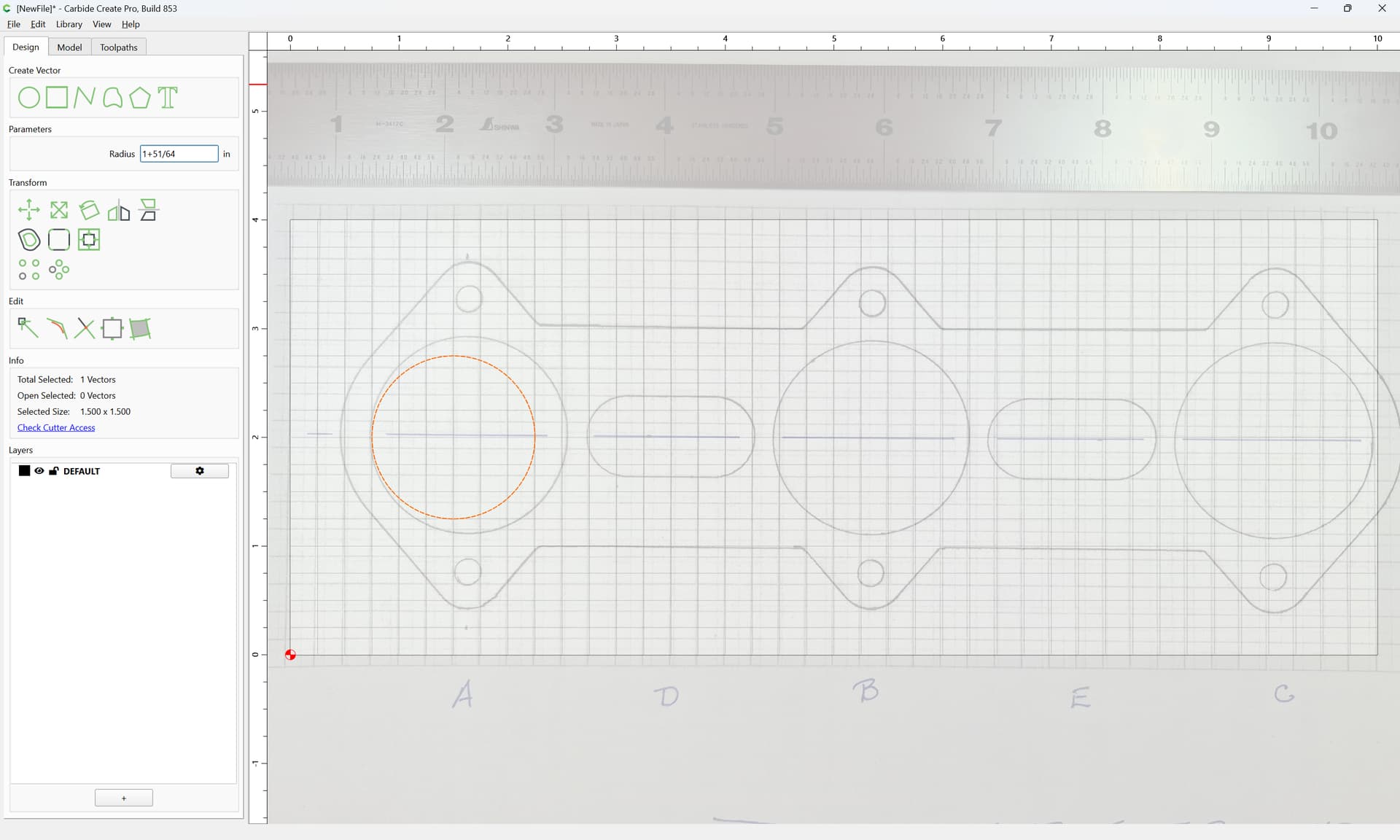

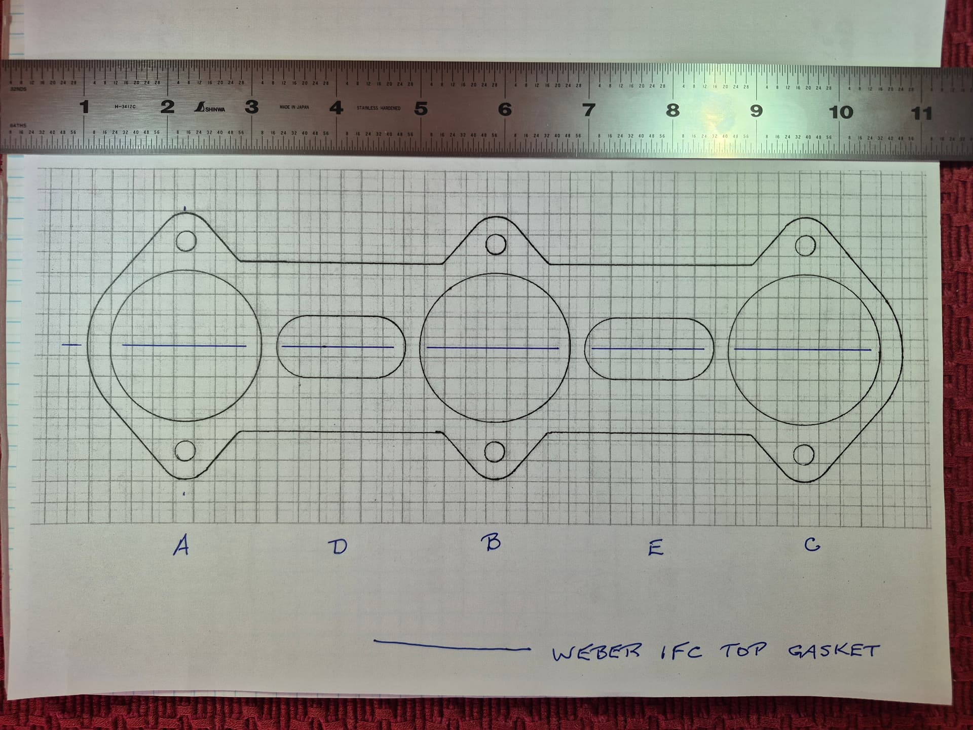

Drawing a Weber gasket
as requested on support…

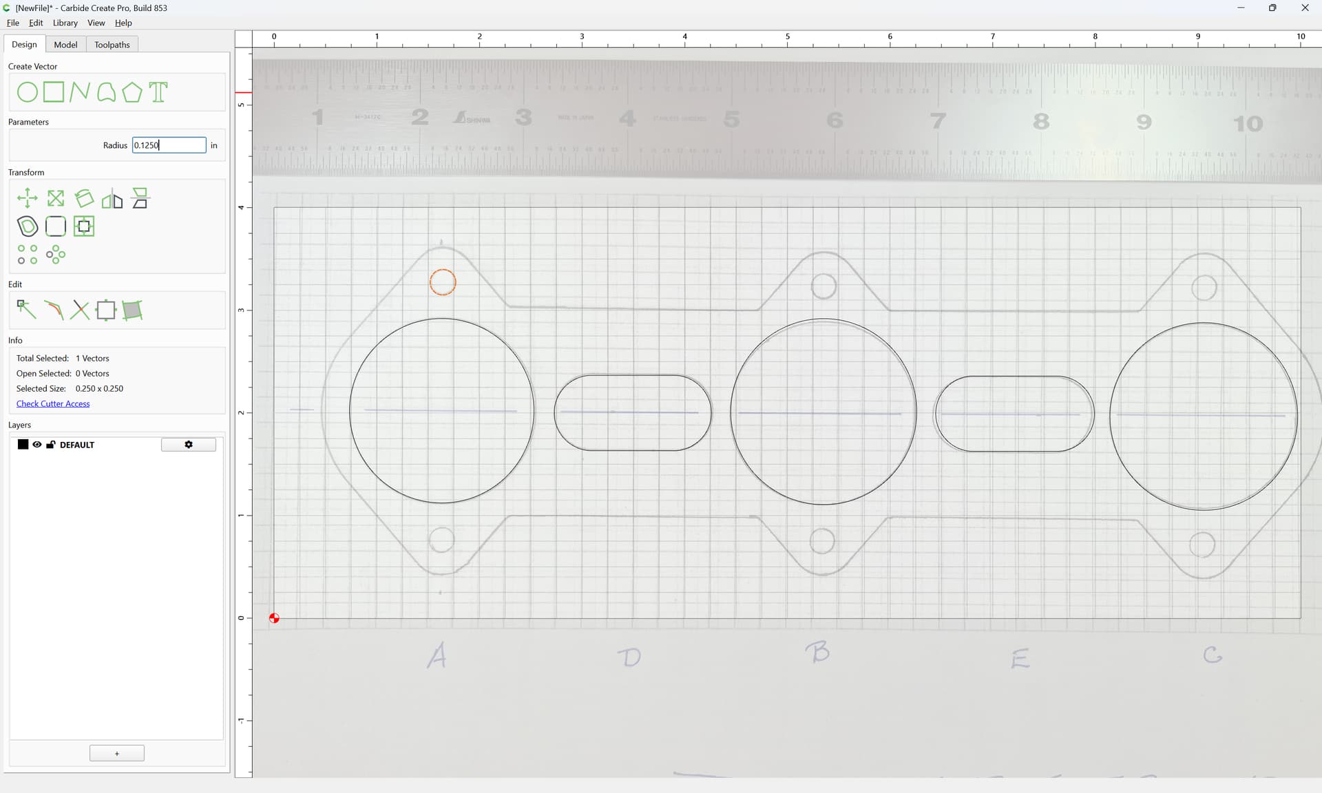

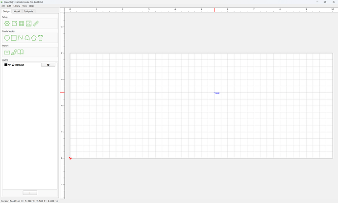

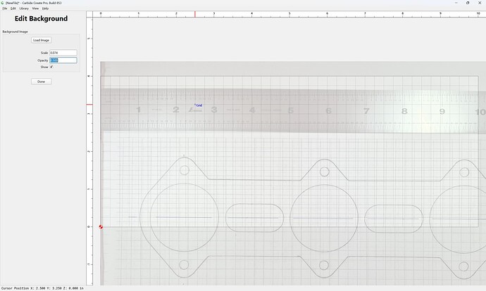

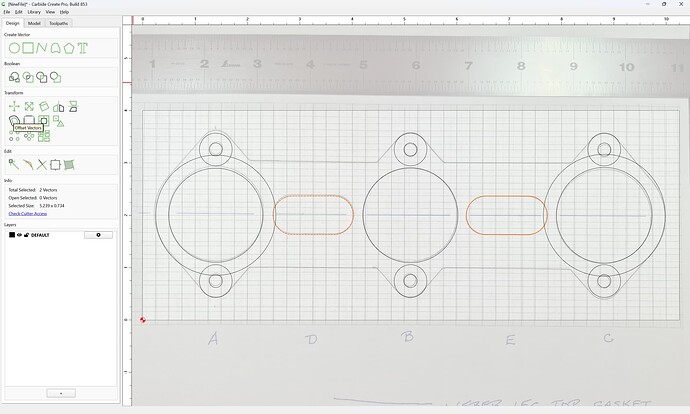

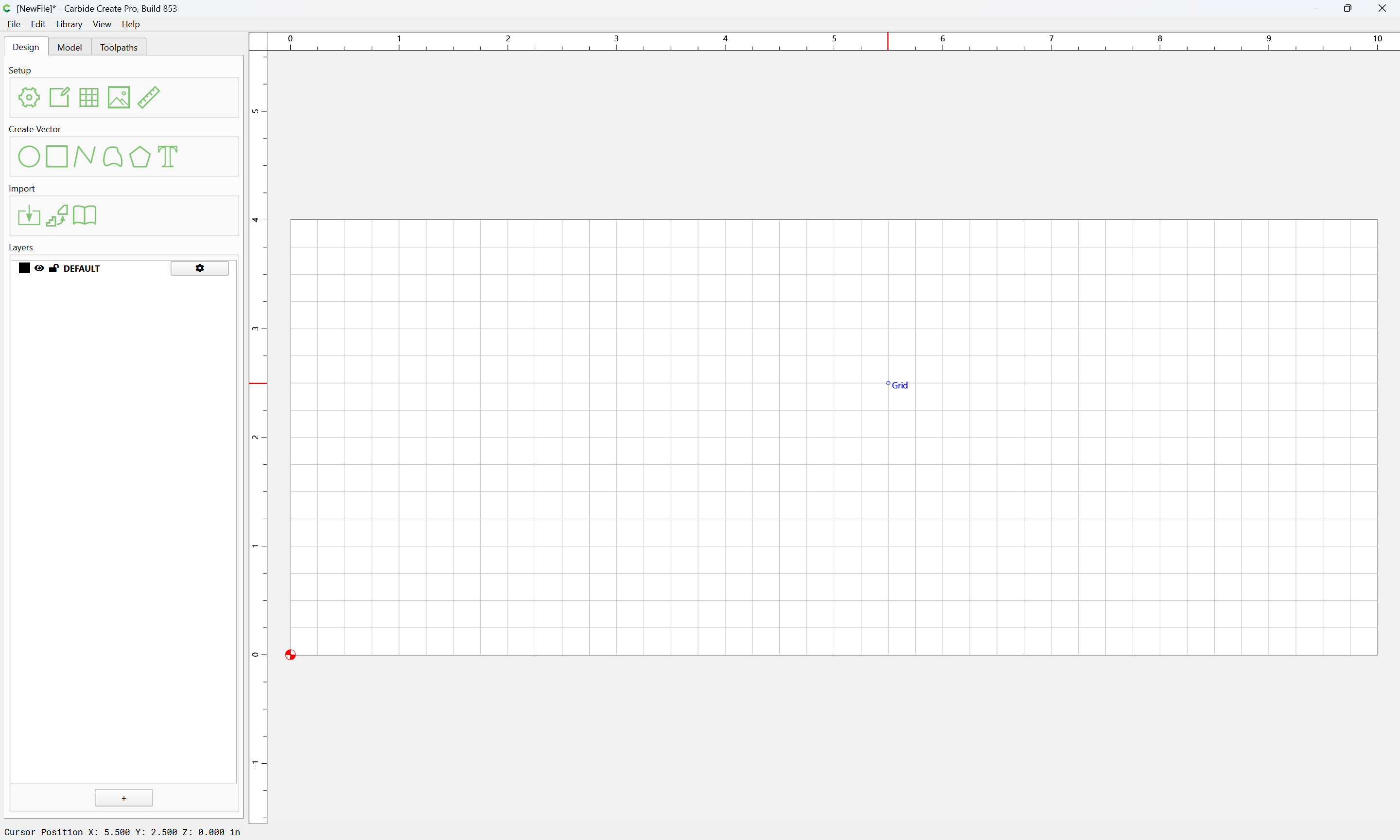

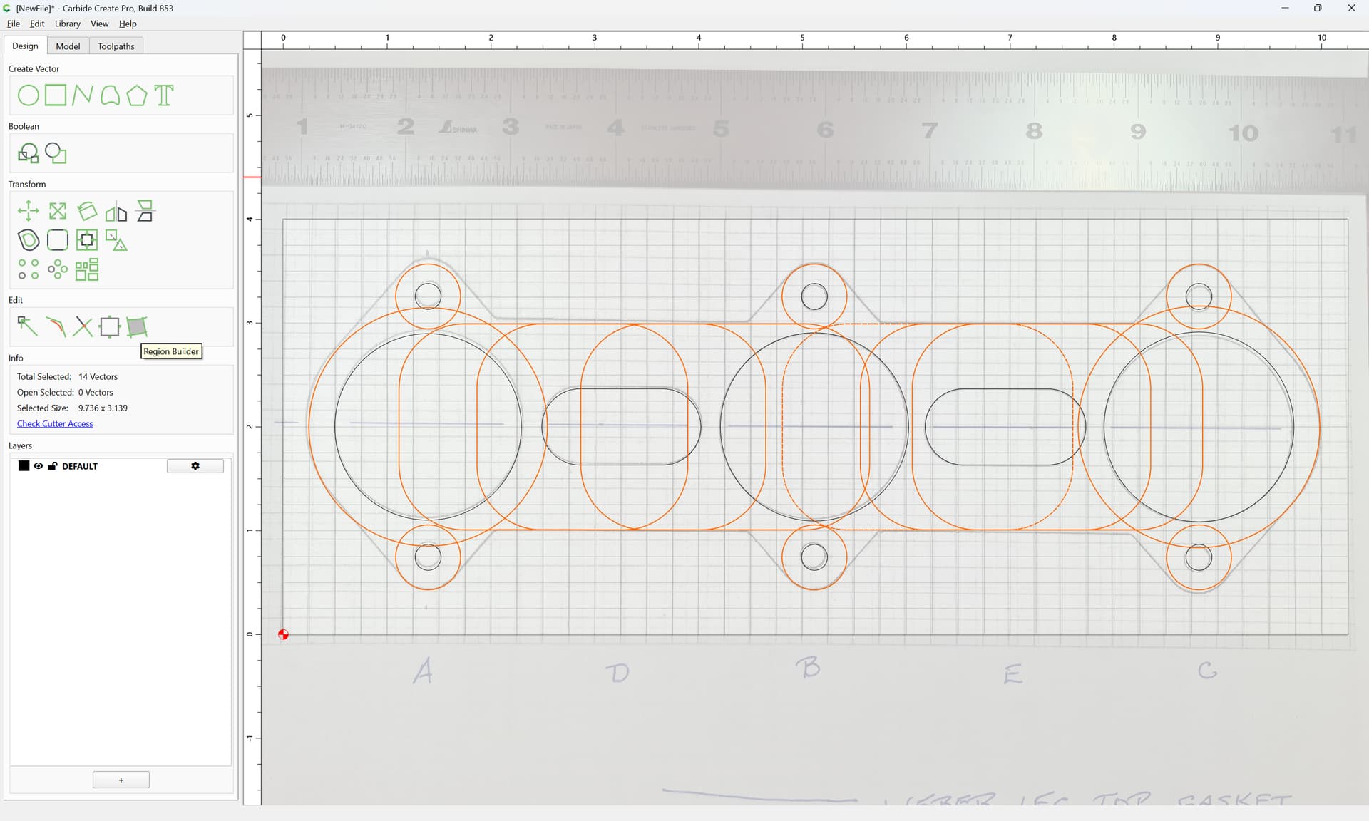

First, we make a new file with Stock of a suitable size:

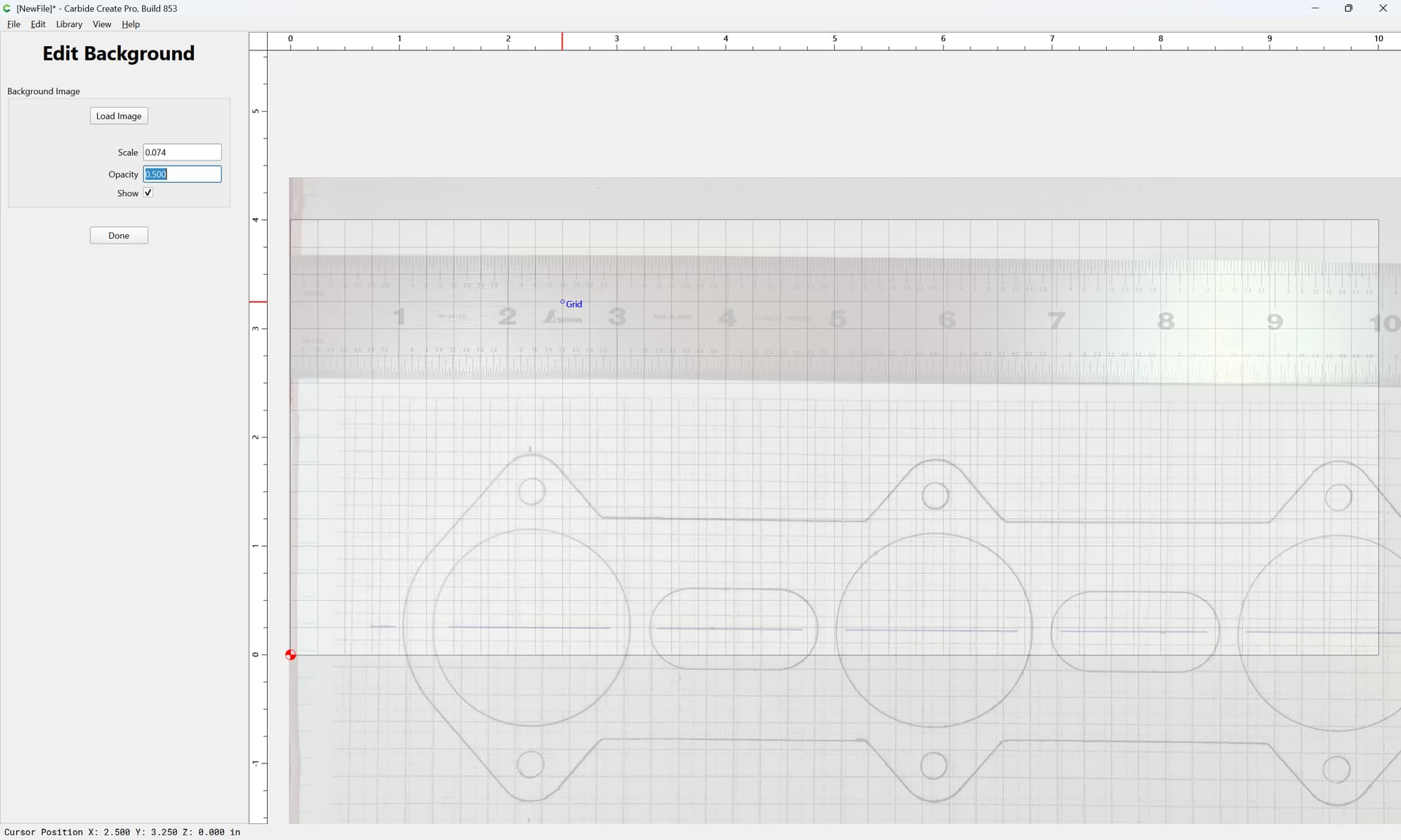

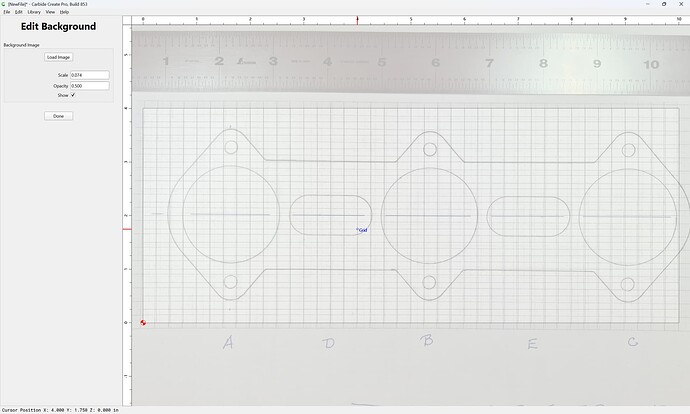

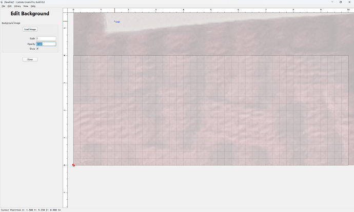

Then, import the pixel image:

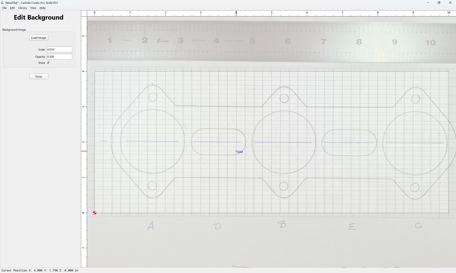

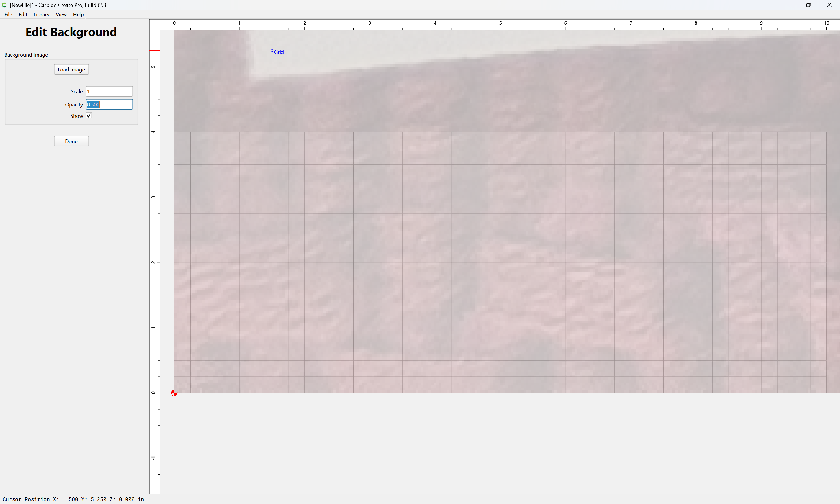

and adjust as necessary, making sure the scaling is approximately correct:
and then positioning so that it is reasonable:
(a scanned image, rather than a photo would make this sort of thing a bit more accurate, especially if positioned squarely)
Done

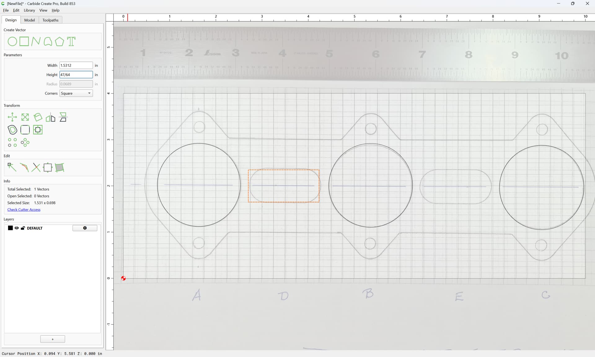

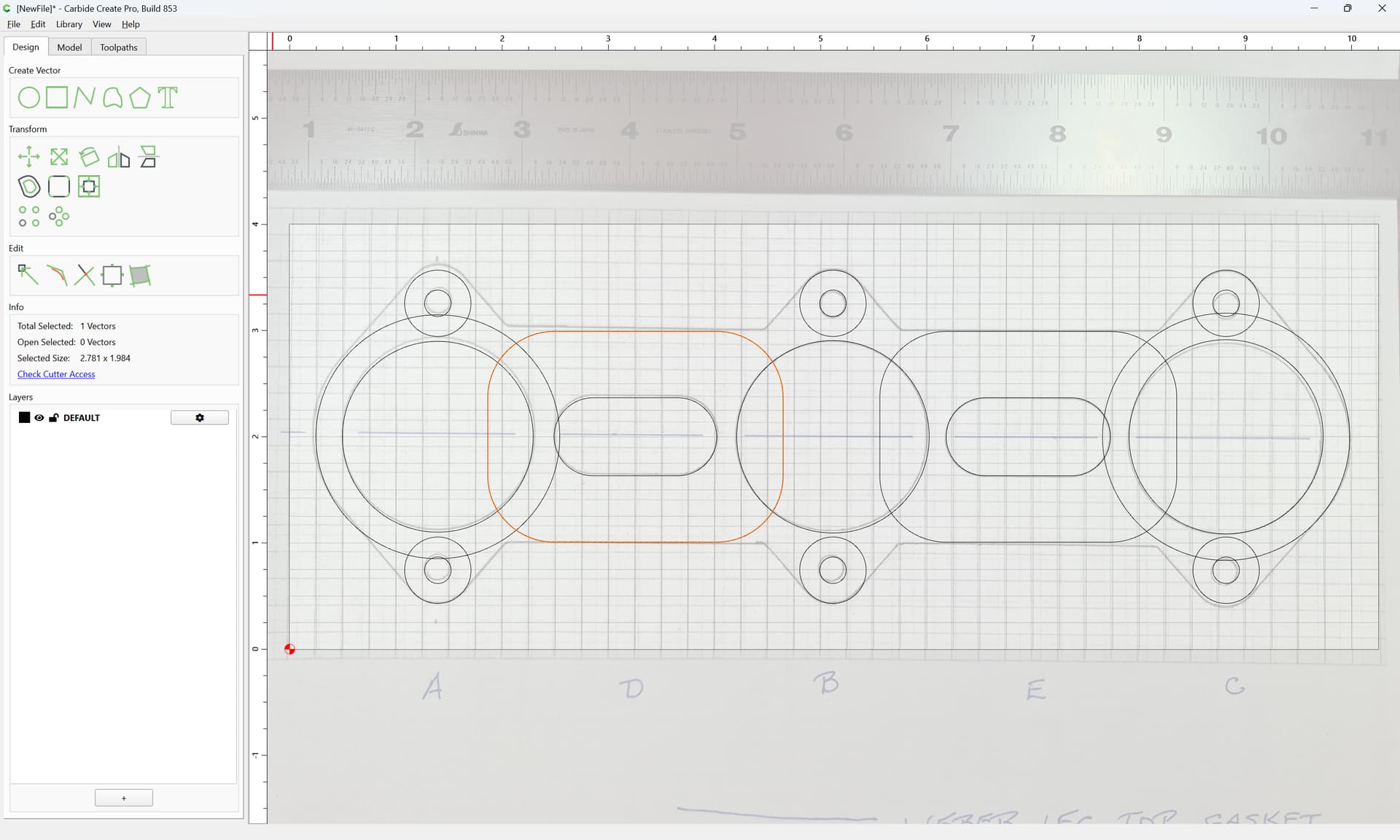

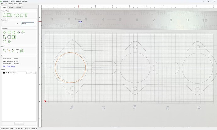

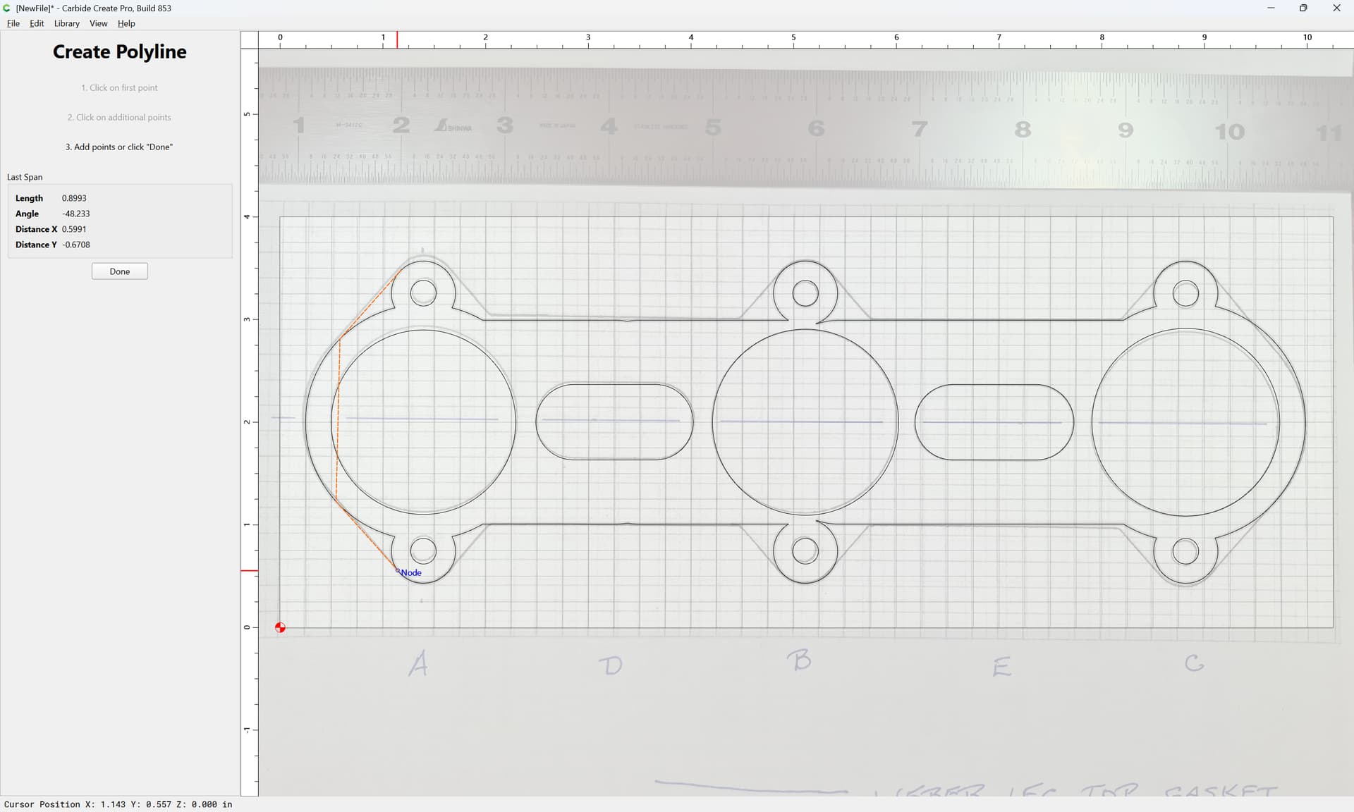

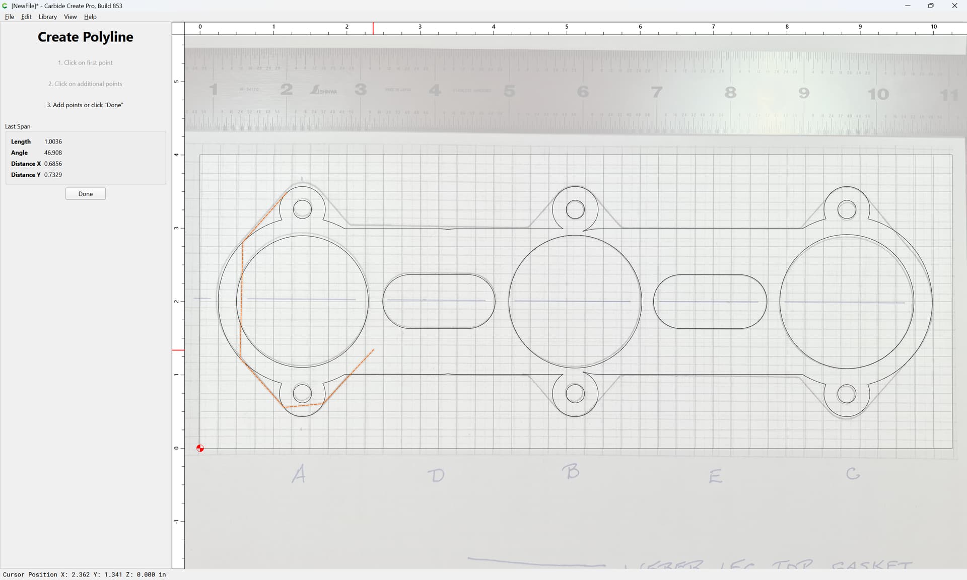

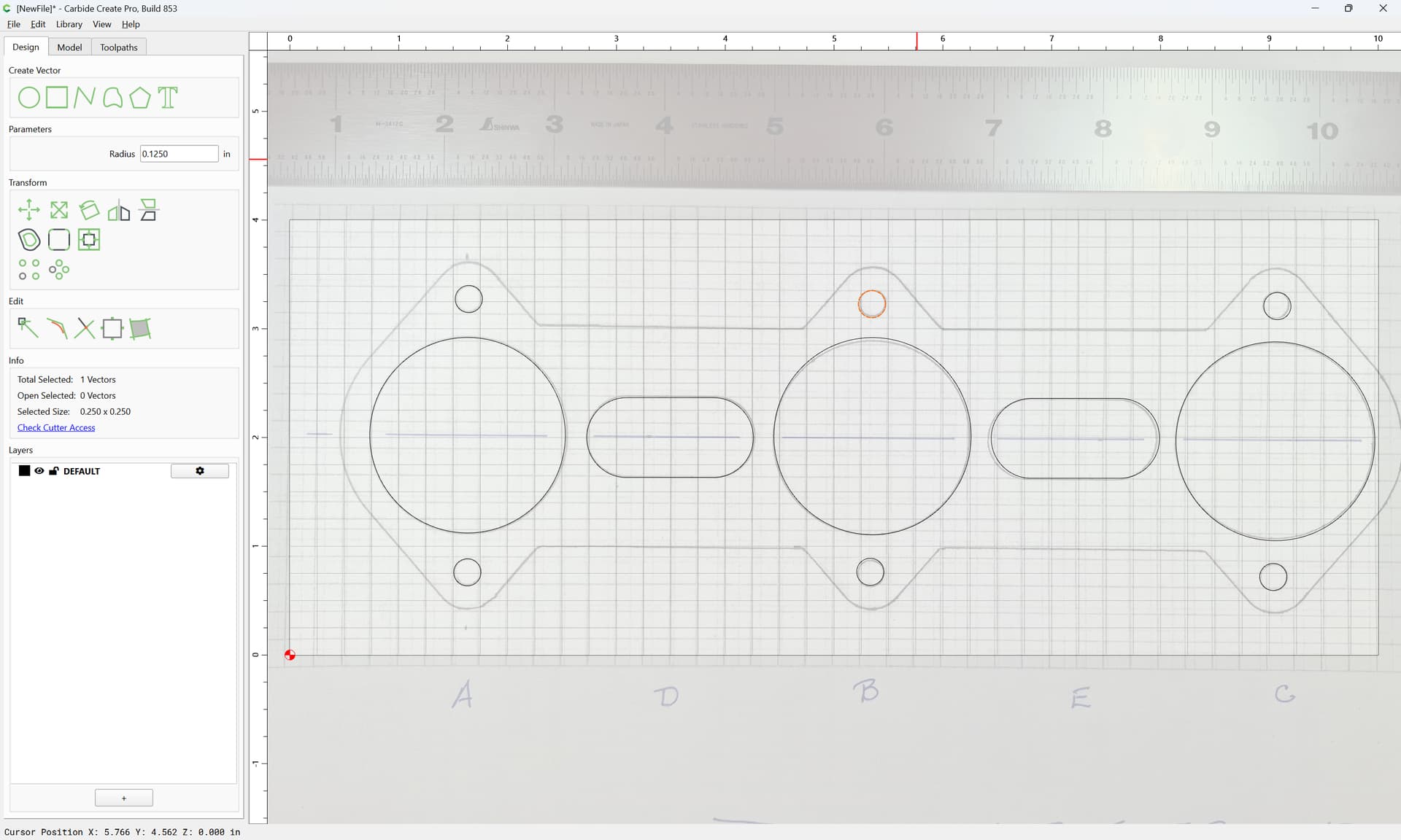

Then, draw and check/adjust dimensions as desired.

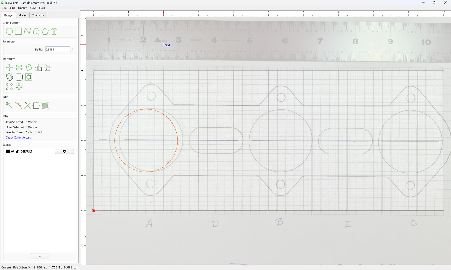

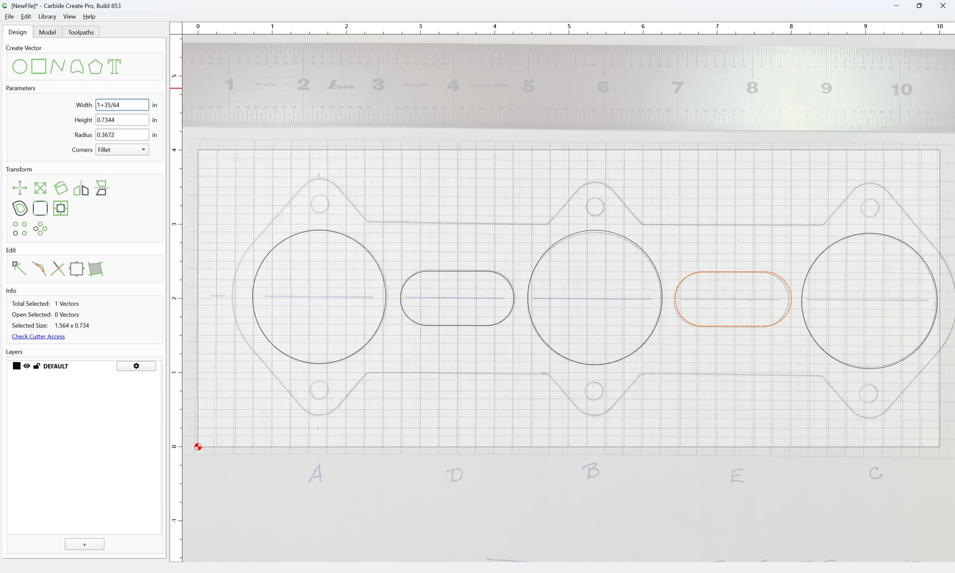

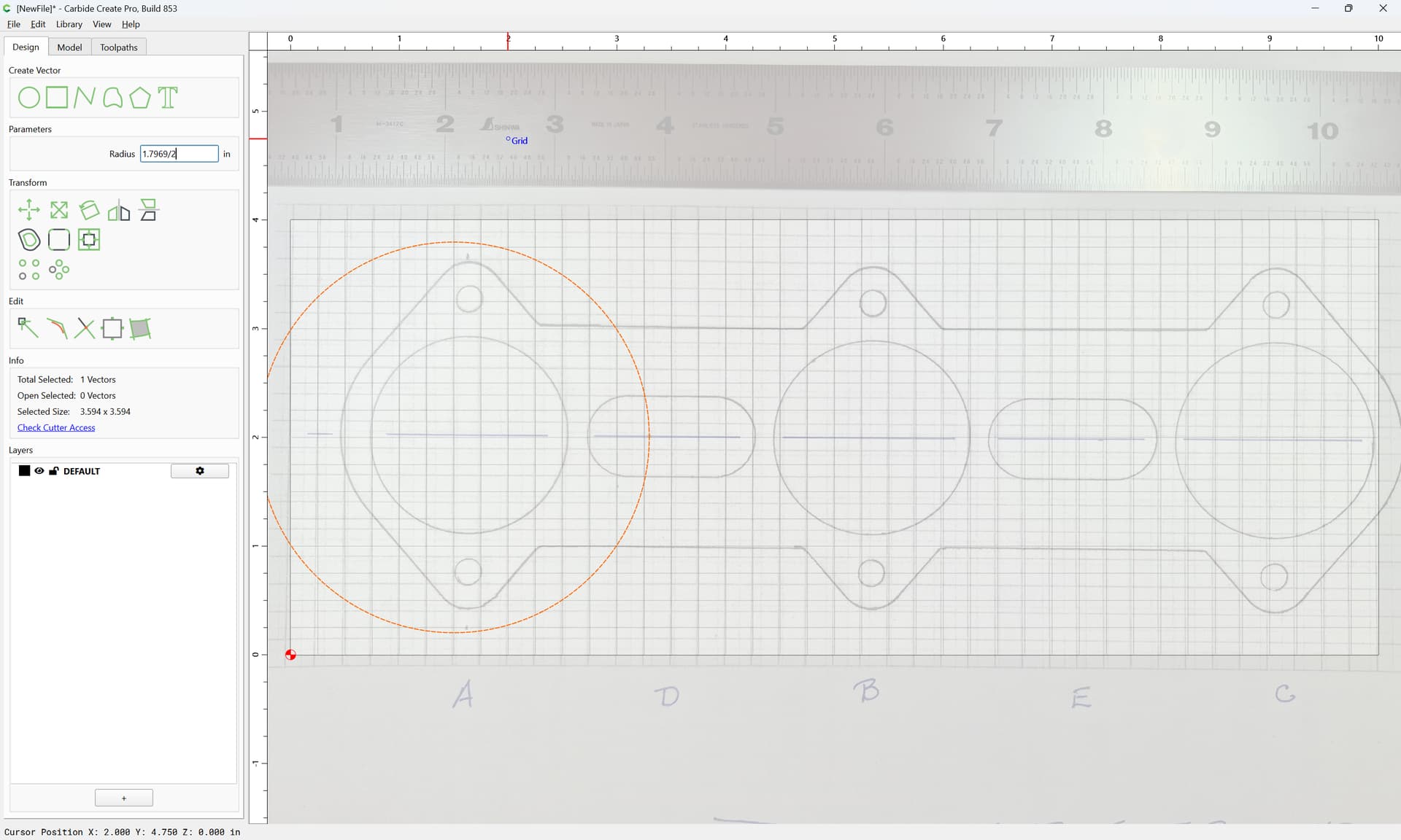

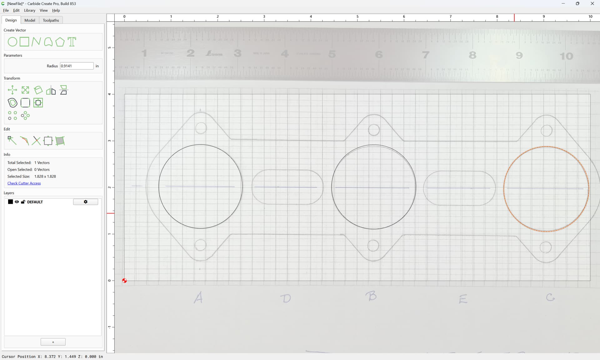

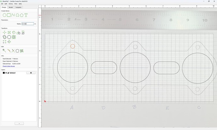

For the circles, it’s easier to type the diameter:
then divide by 2 to get the radius:

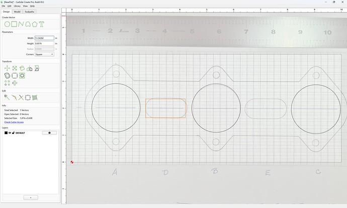

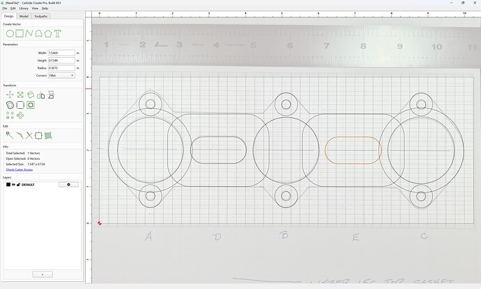

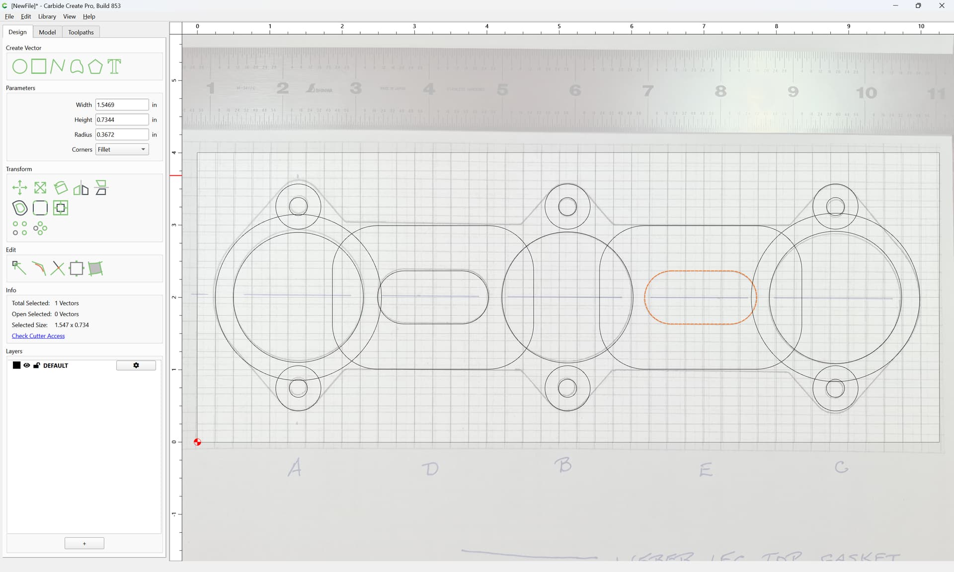

The ovals may be specified directly as rectangles with Fillets:

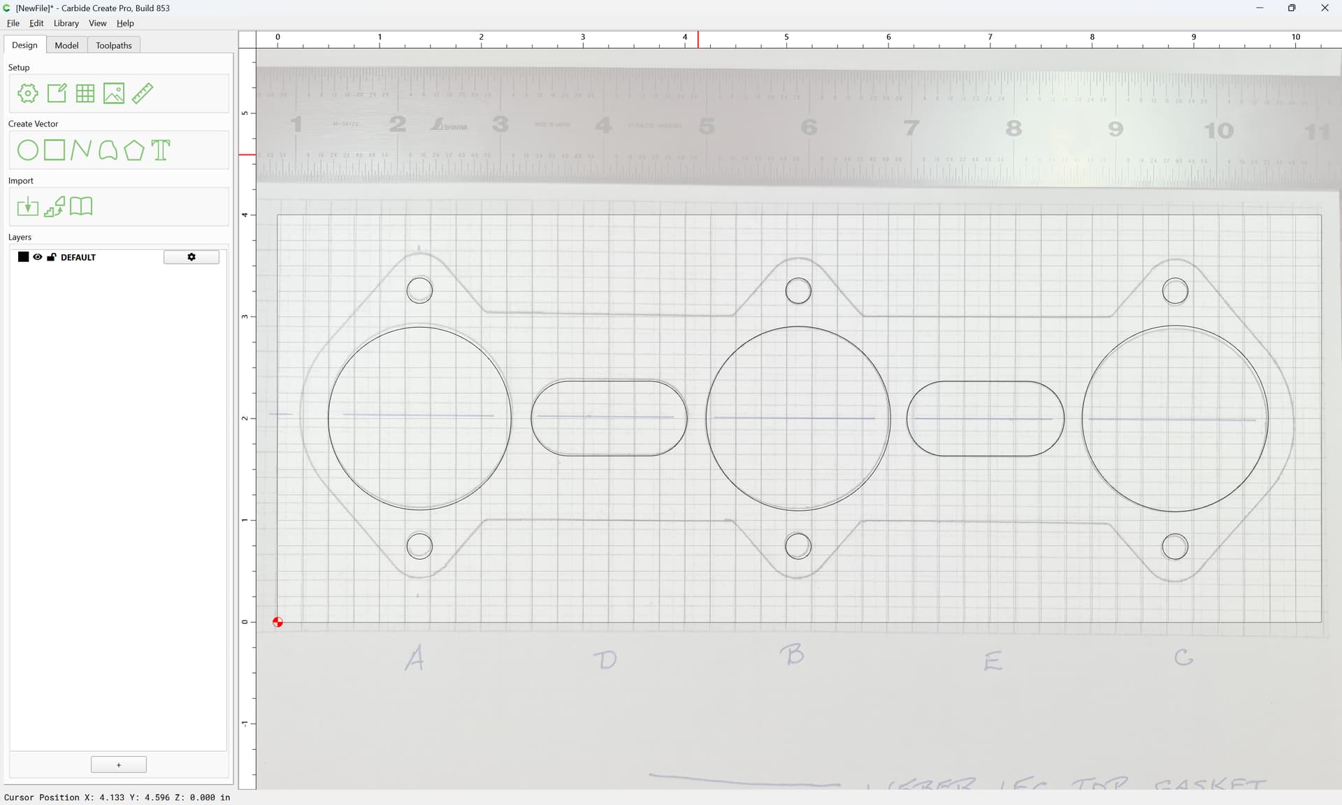

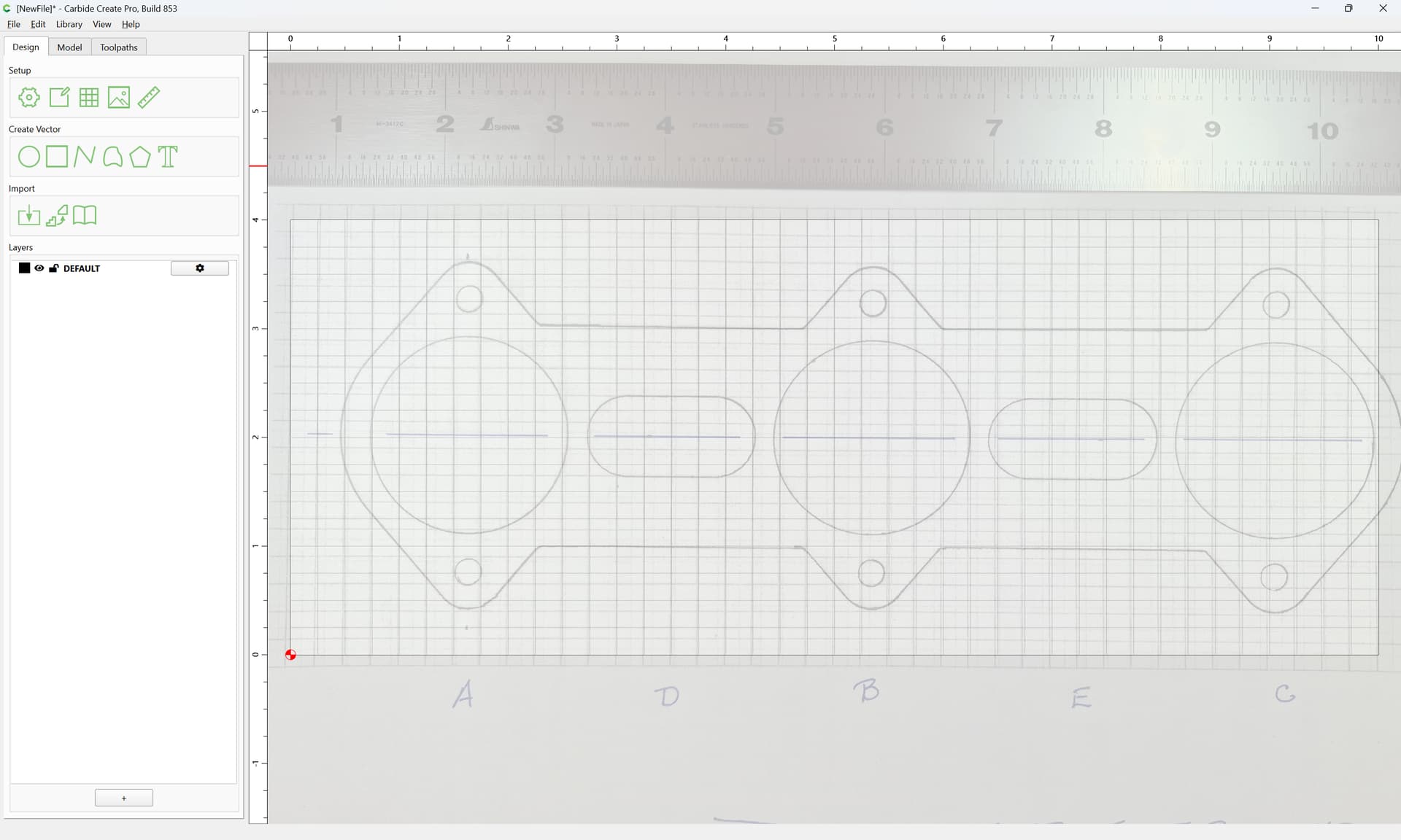

Drawing in the balance of the elements:

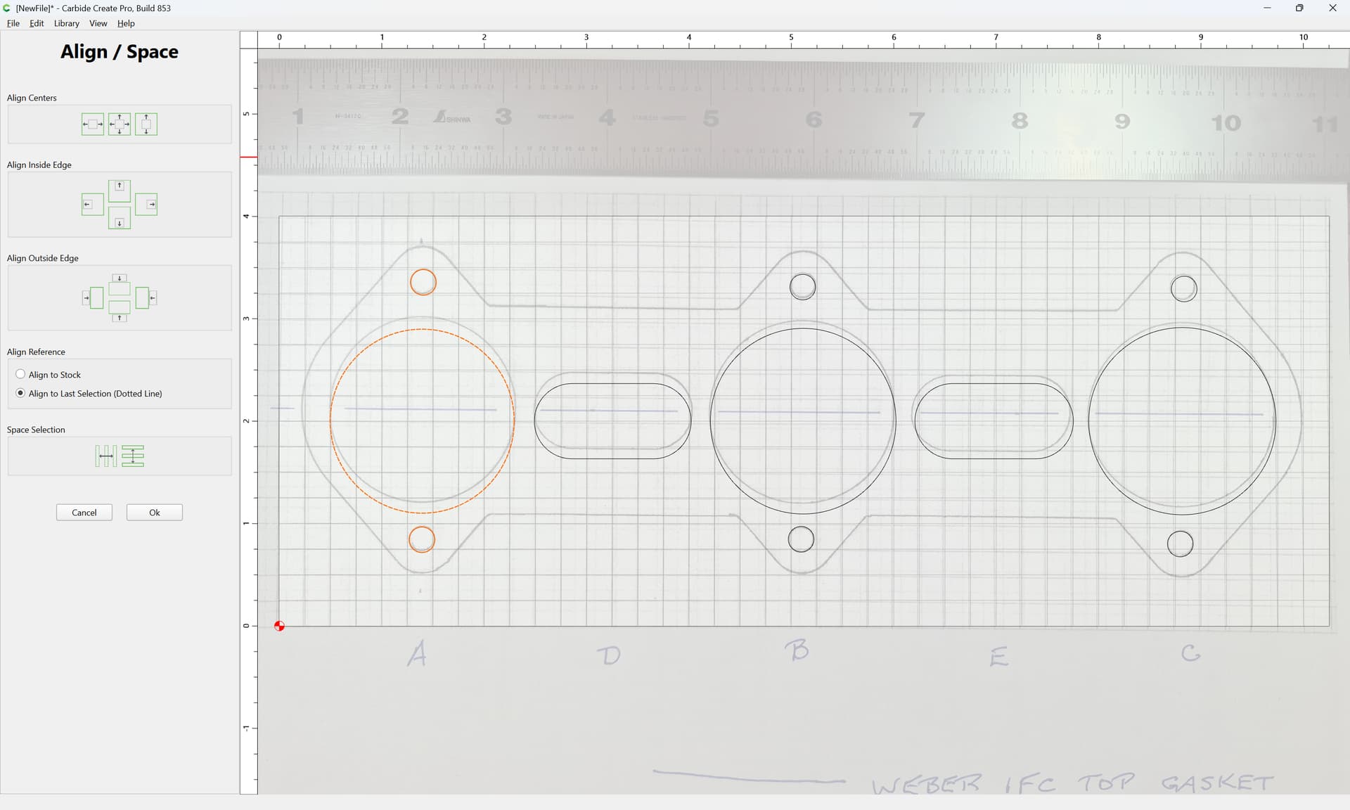

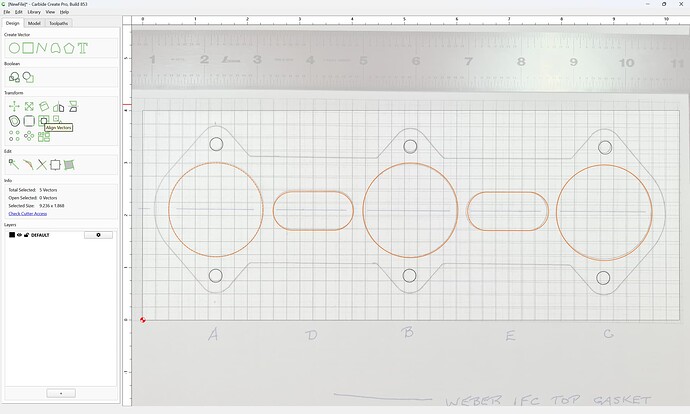

and it is then simply a matter of aligning things, then determining the distance between holes (unspecified) and the necessary offset around elements.

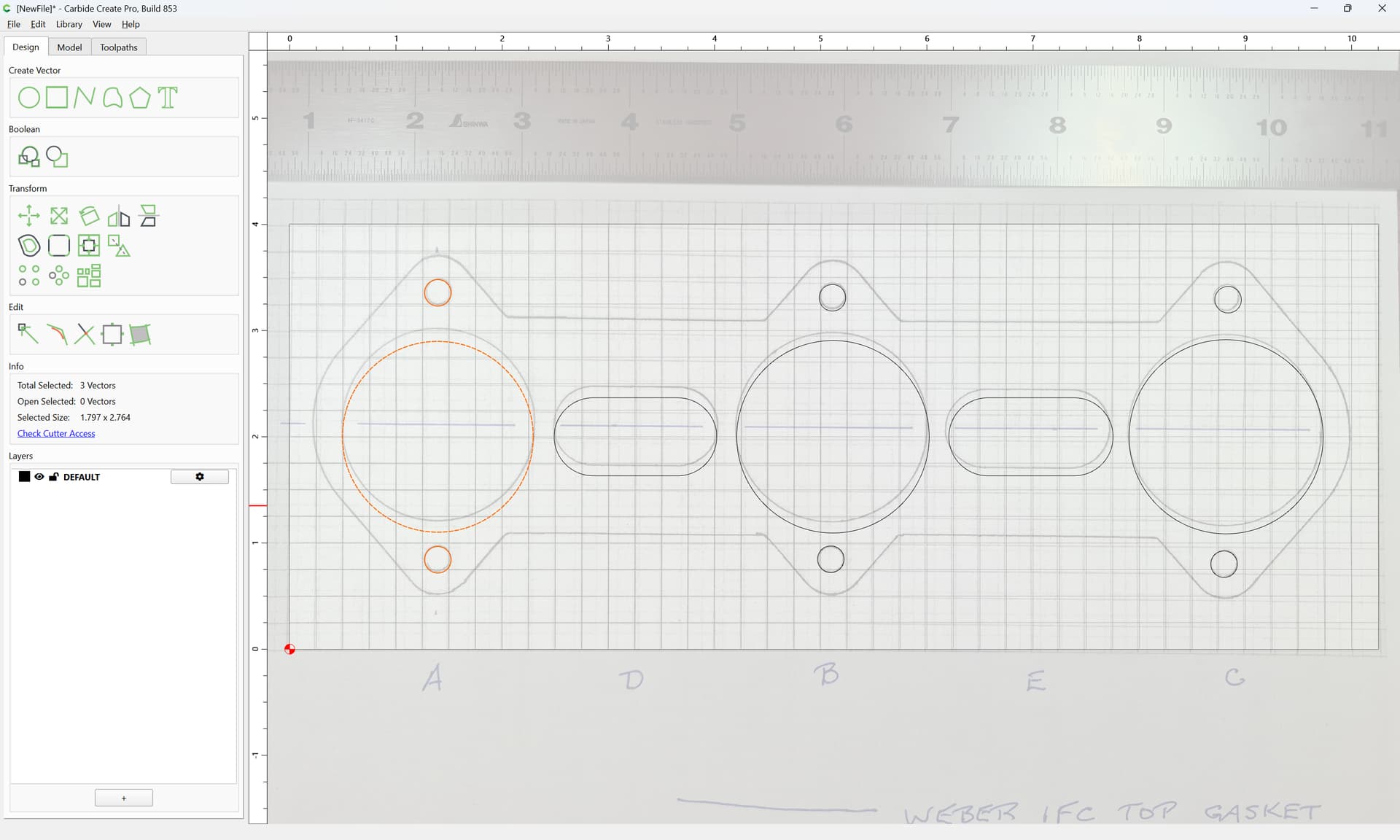

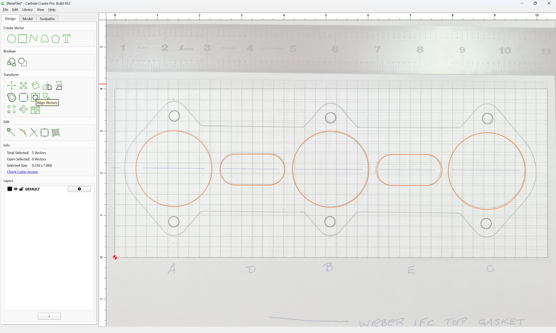

Horizontal alignment:

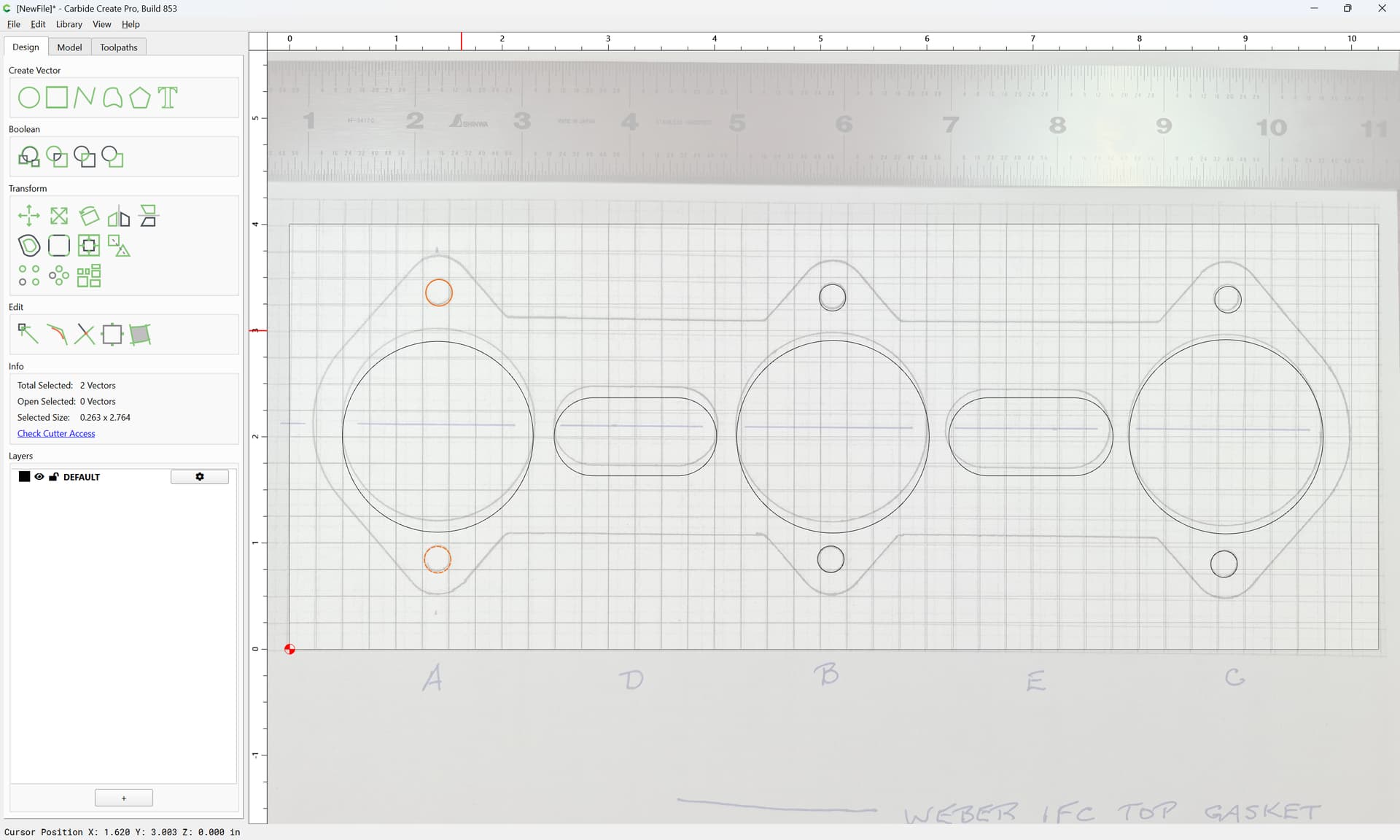

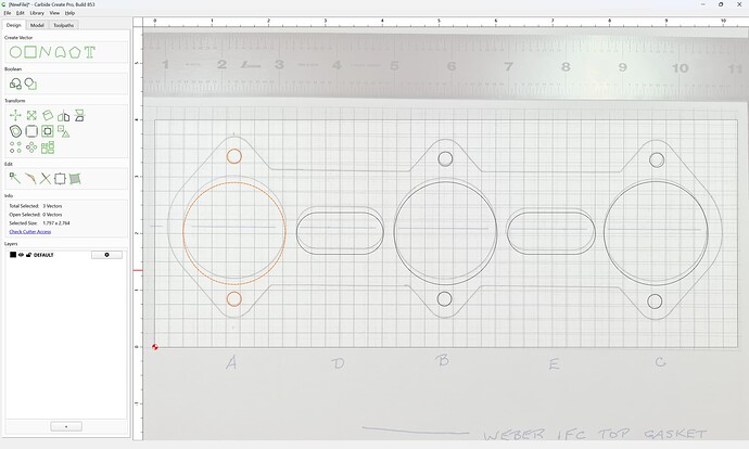

For the smaller elements which are relative to larger, select a pair of stud holes:
then shift-click on the matching larger hole making it the key element:
and align to it:
Ok

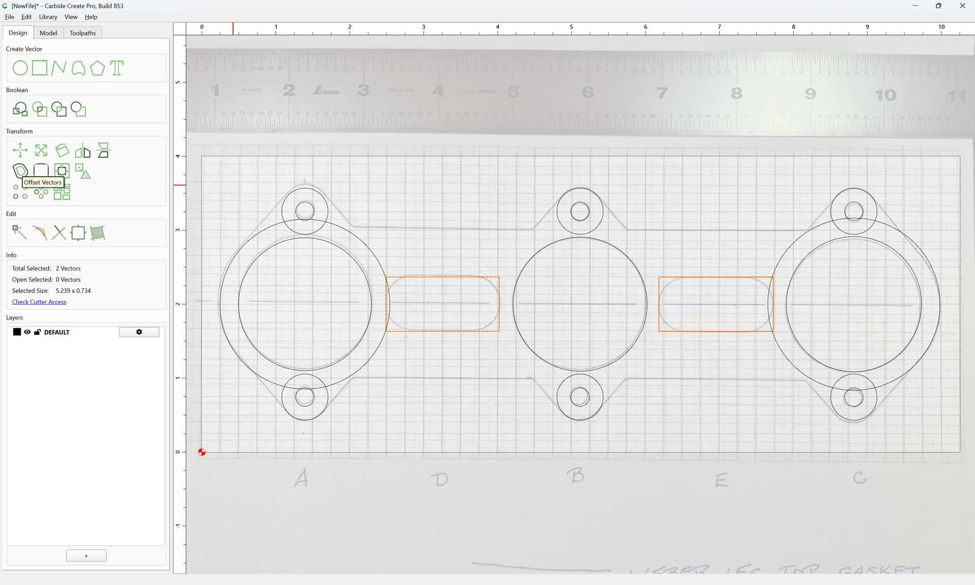

Repeat for all other elements:

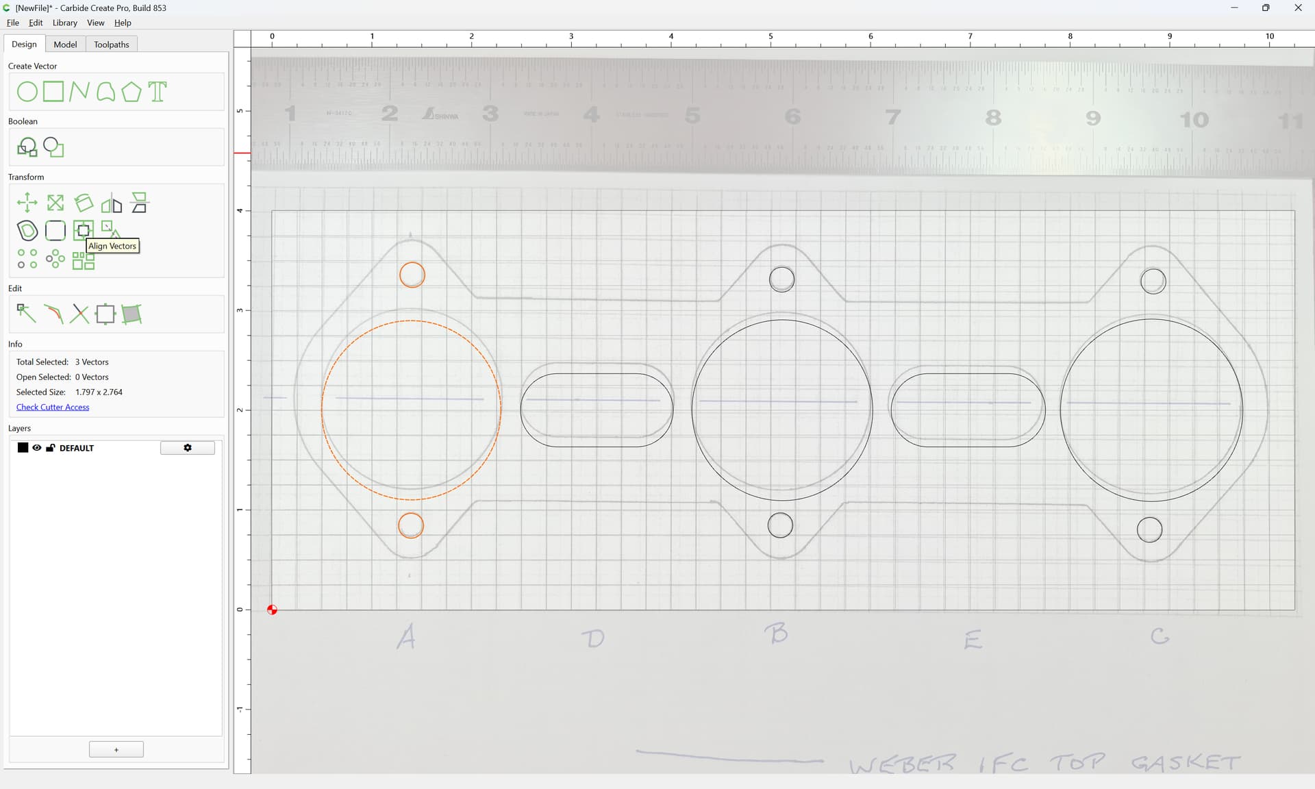

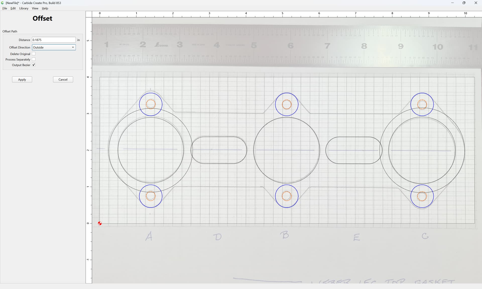

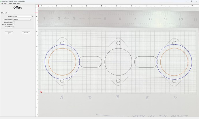

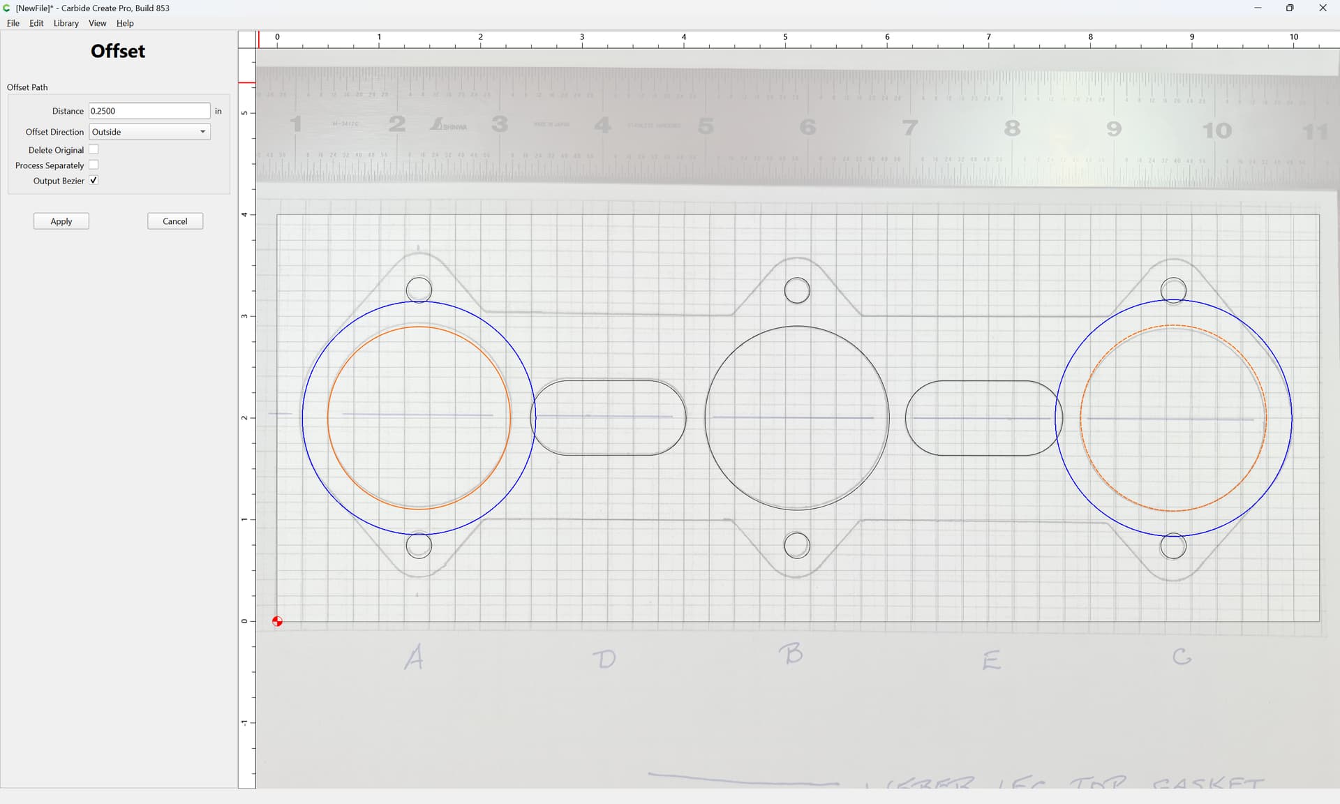

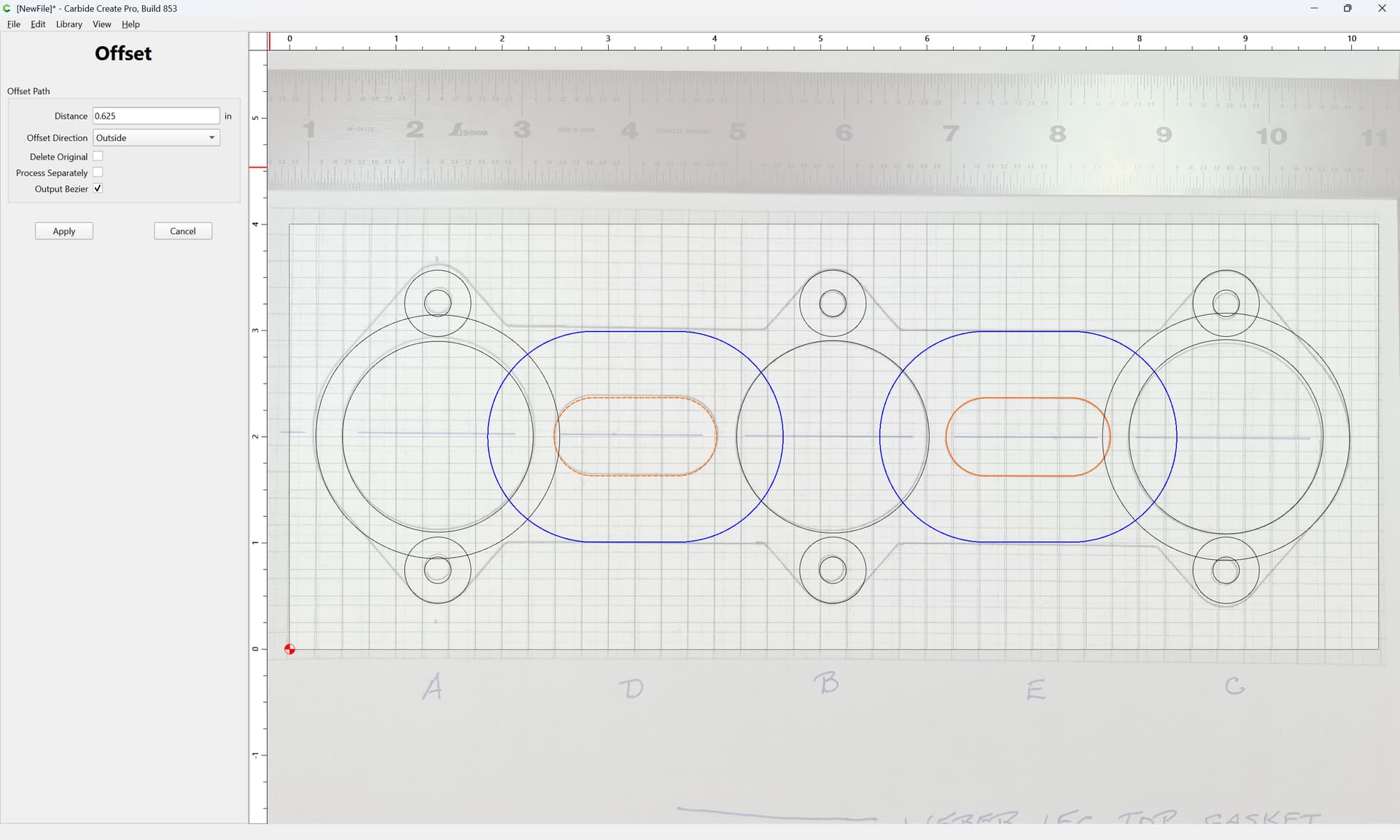

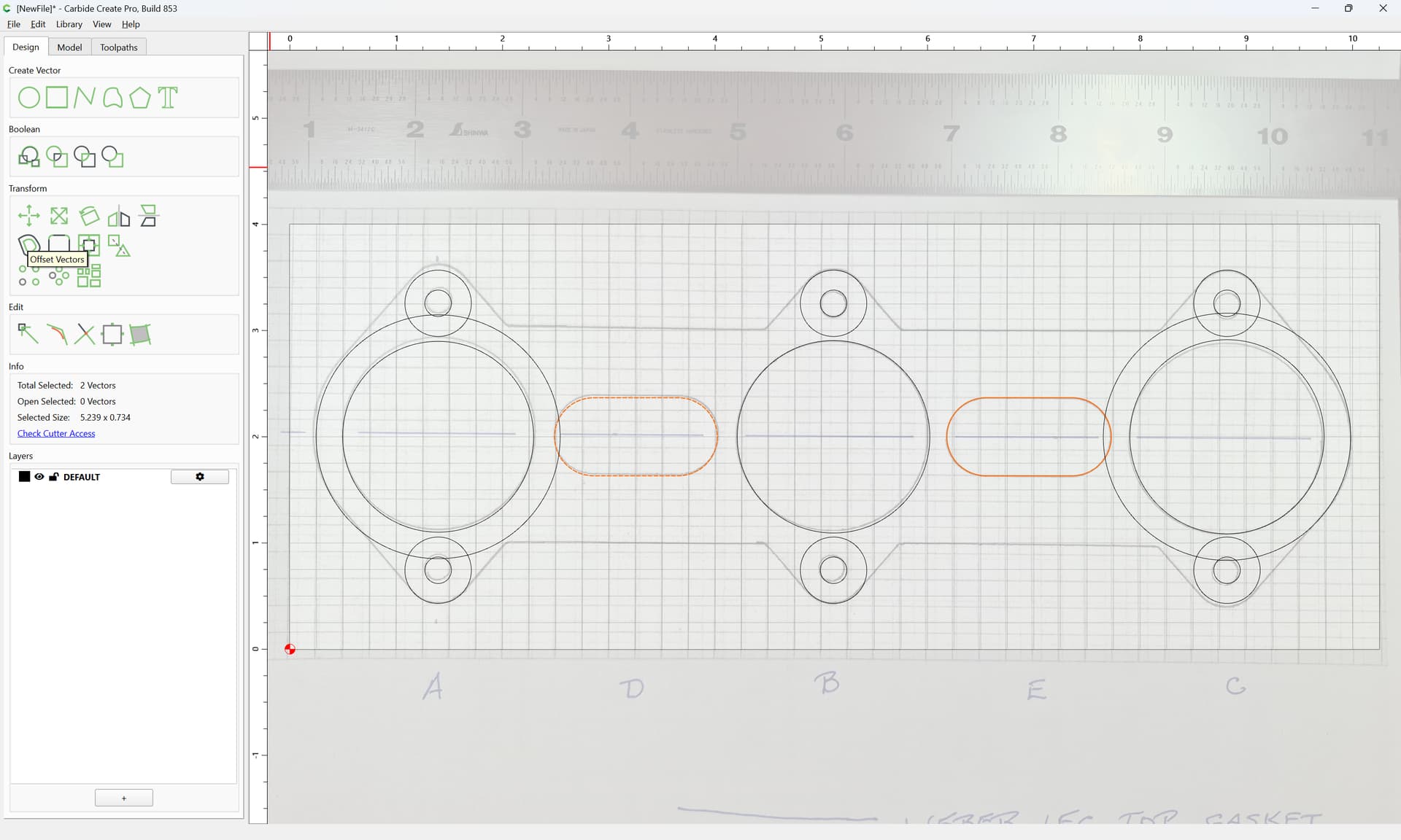

Looks as if 0.25" offset should work for the larger circle regions:
while for the smaller 0.1875" should work:

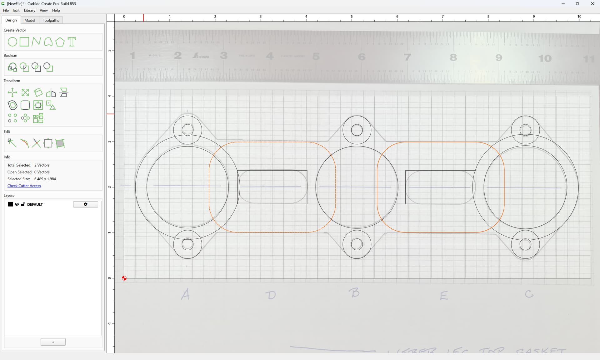

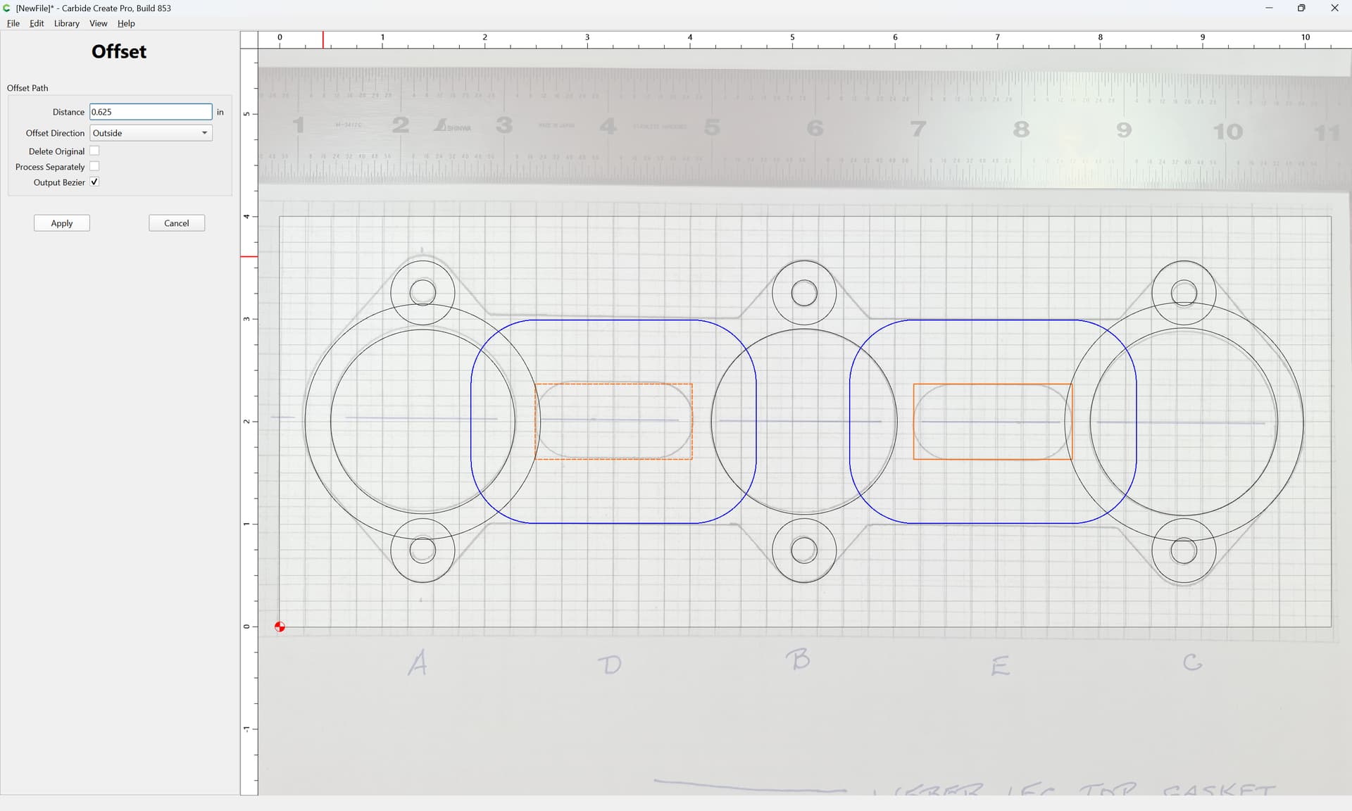

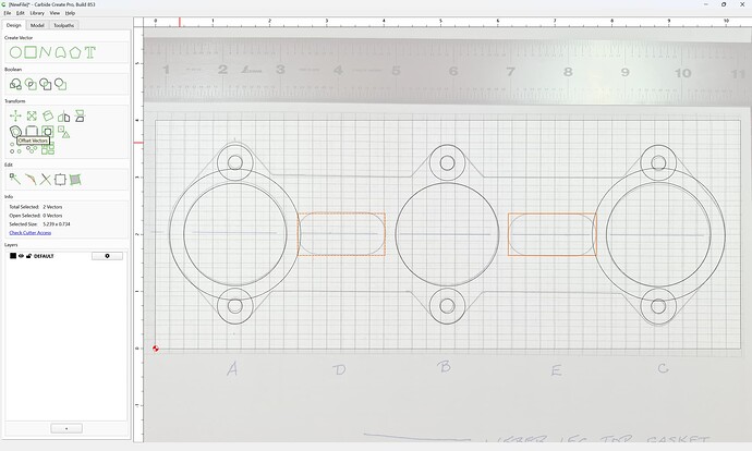

The slots look to need 0.625"
but temporarily turning off the Fillets should yield a better result:
Restore the Fillets

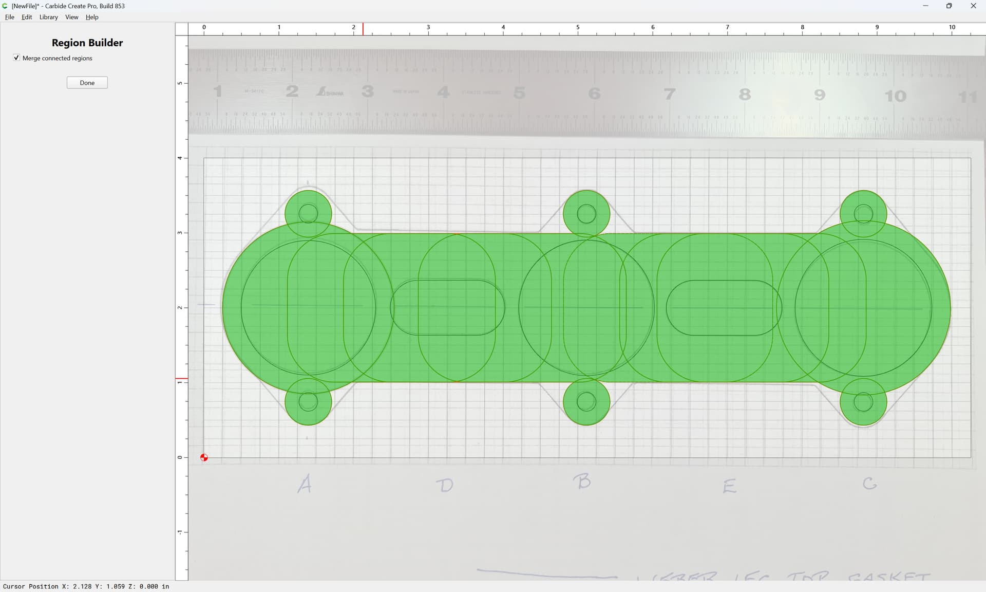

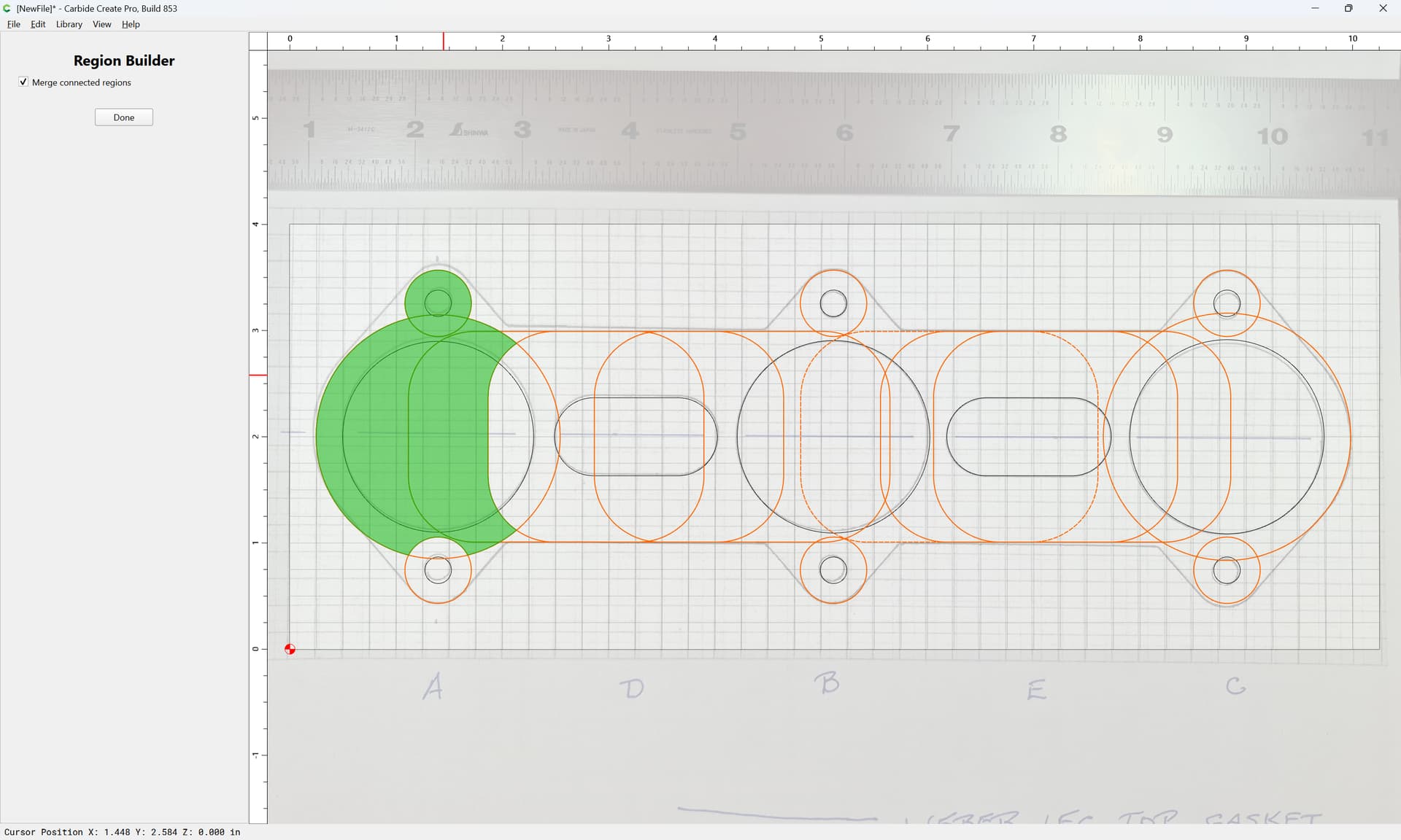

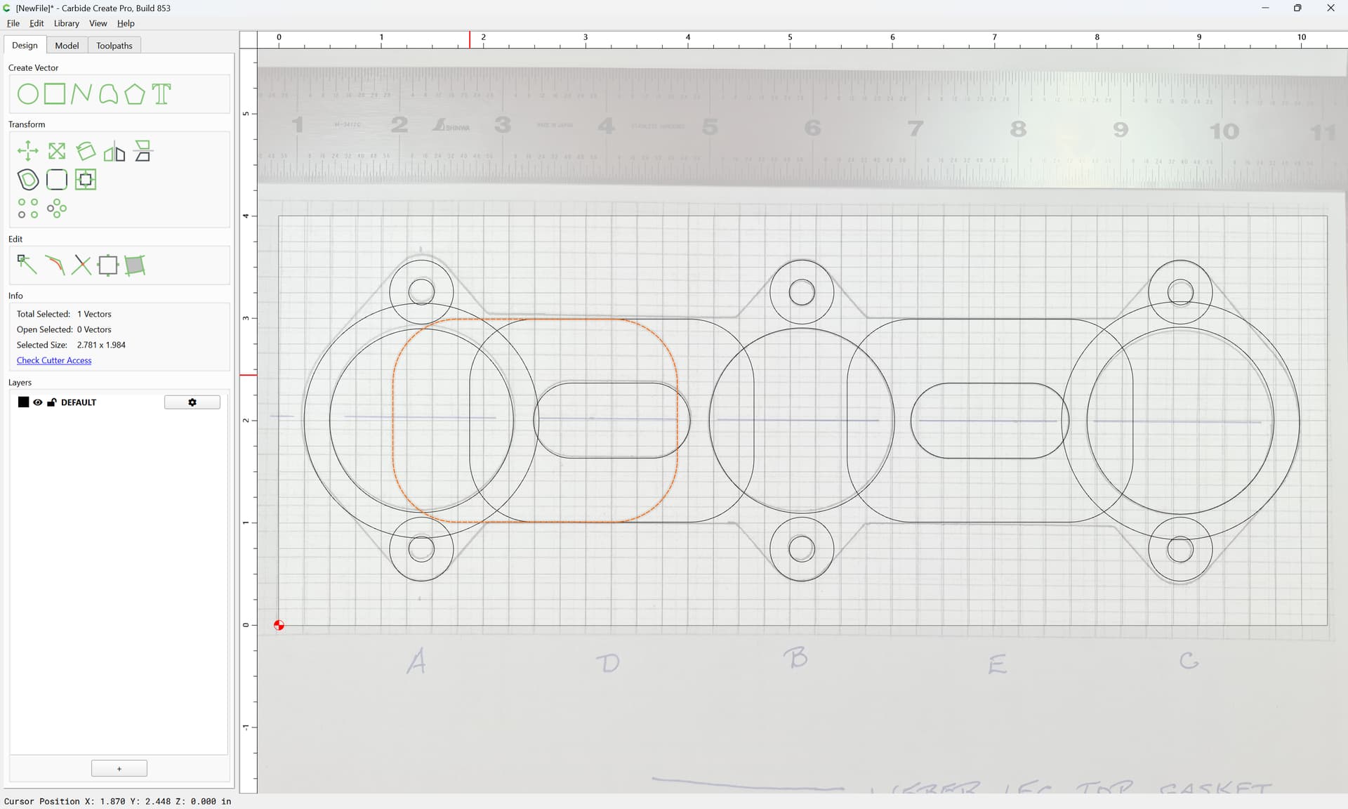

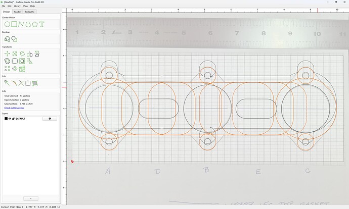

Duplicate the offset rounded rectangles in place:
and nudge the duplicates to extend the lines using the arrow keys:

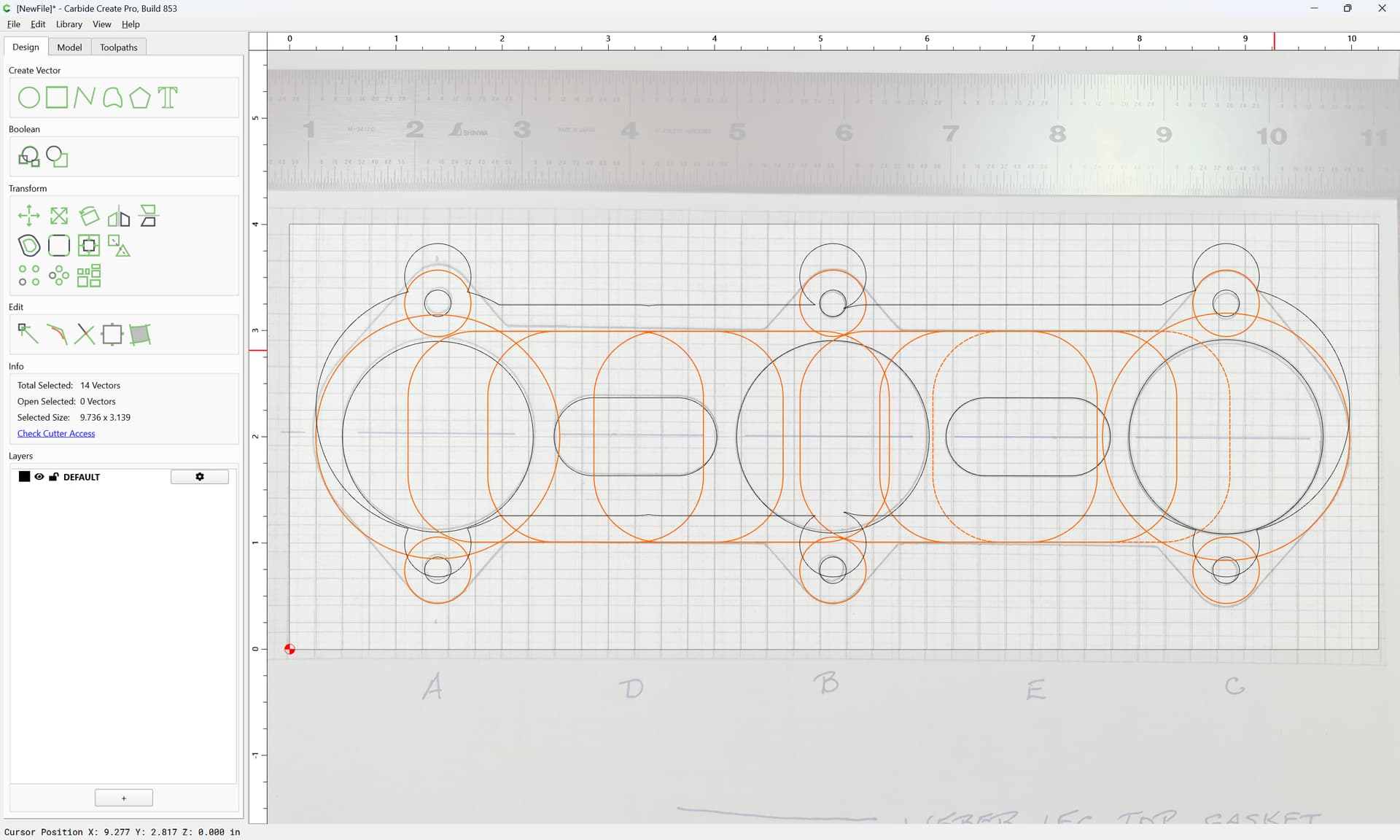

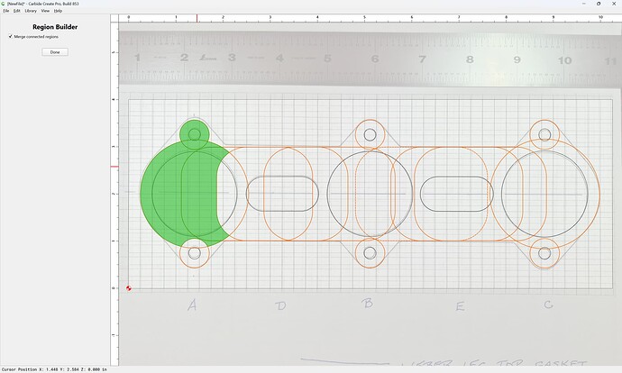

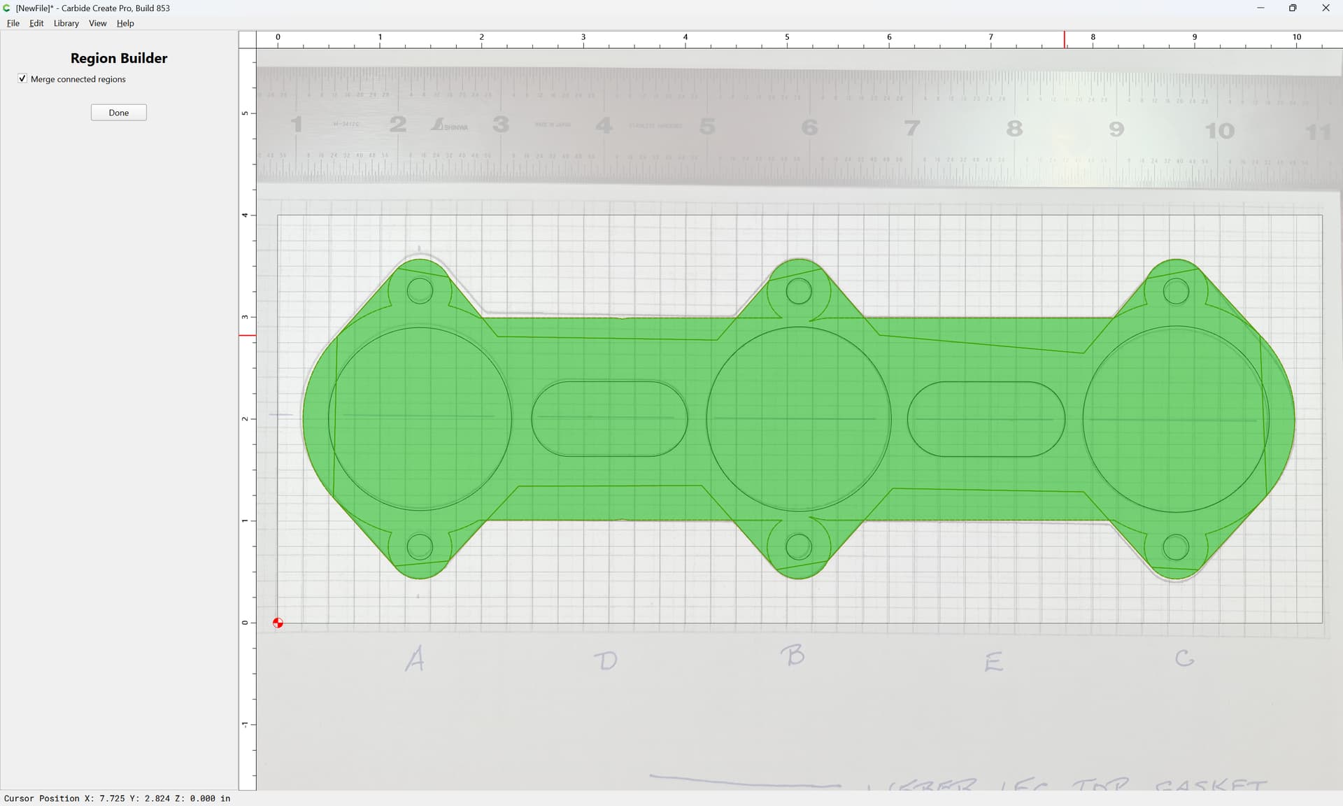

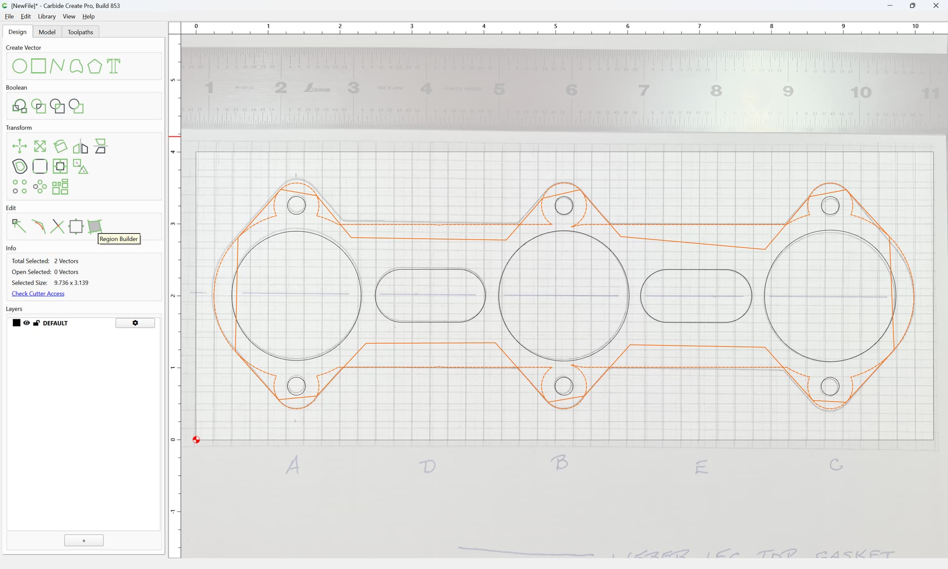

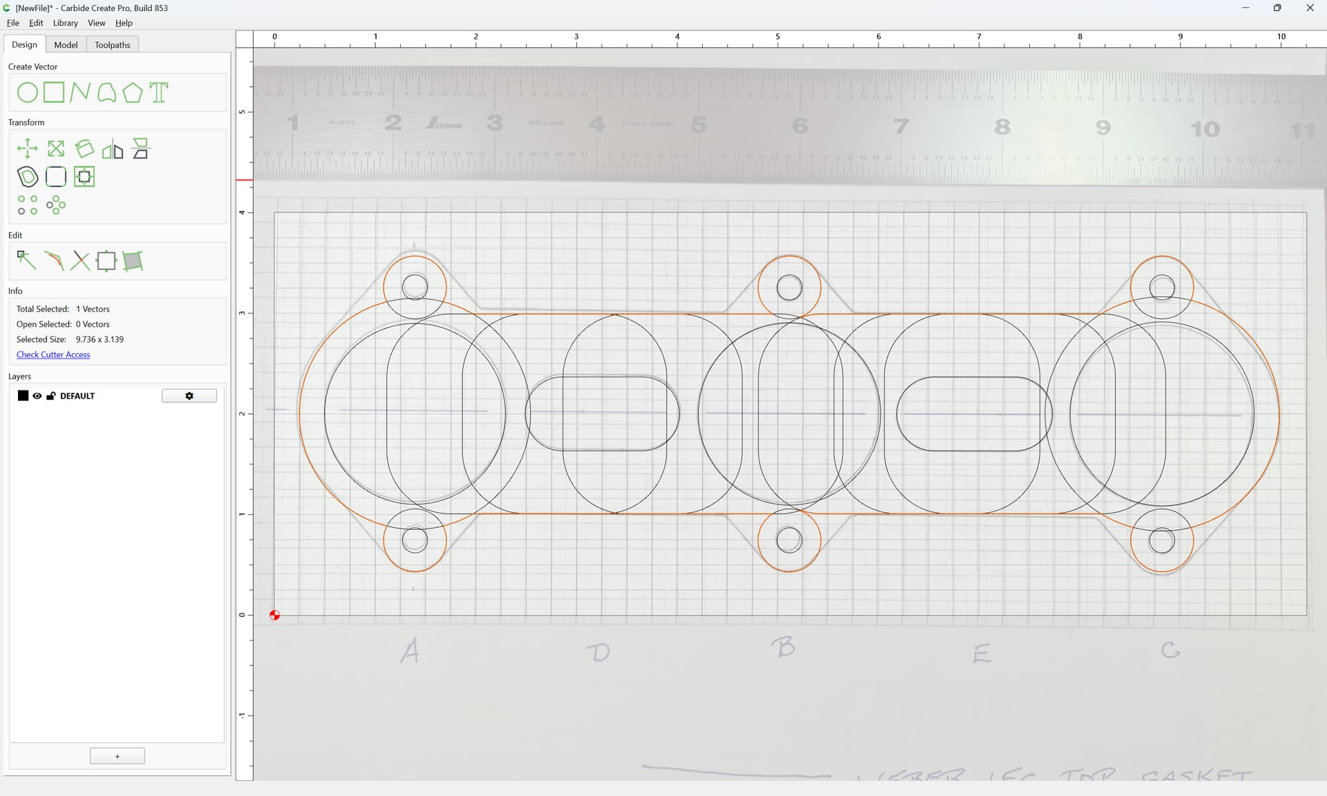

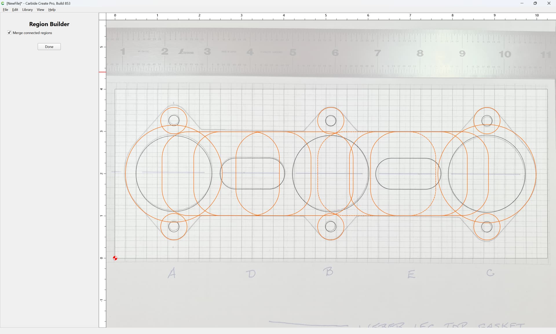

Select all the Offset geometry:

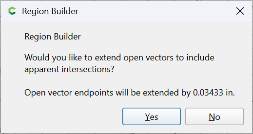

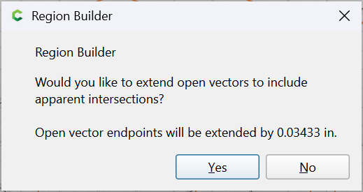

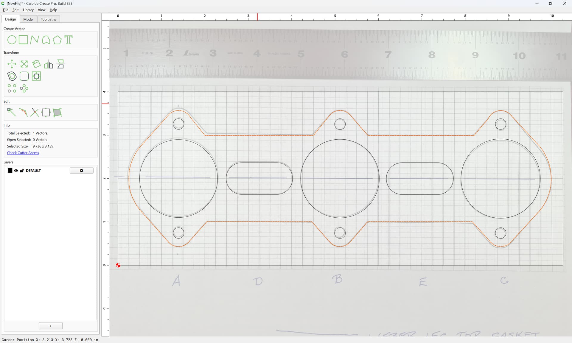

and use Region Builder to define the desired outline:
Yes
Done

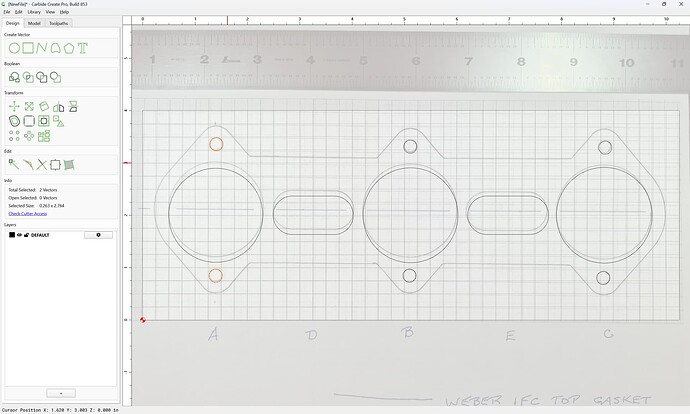

Delete the offset geometry:

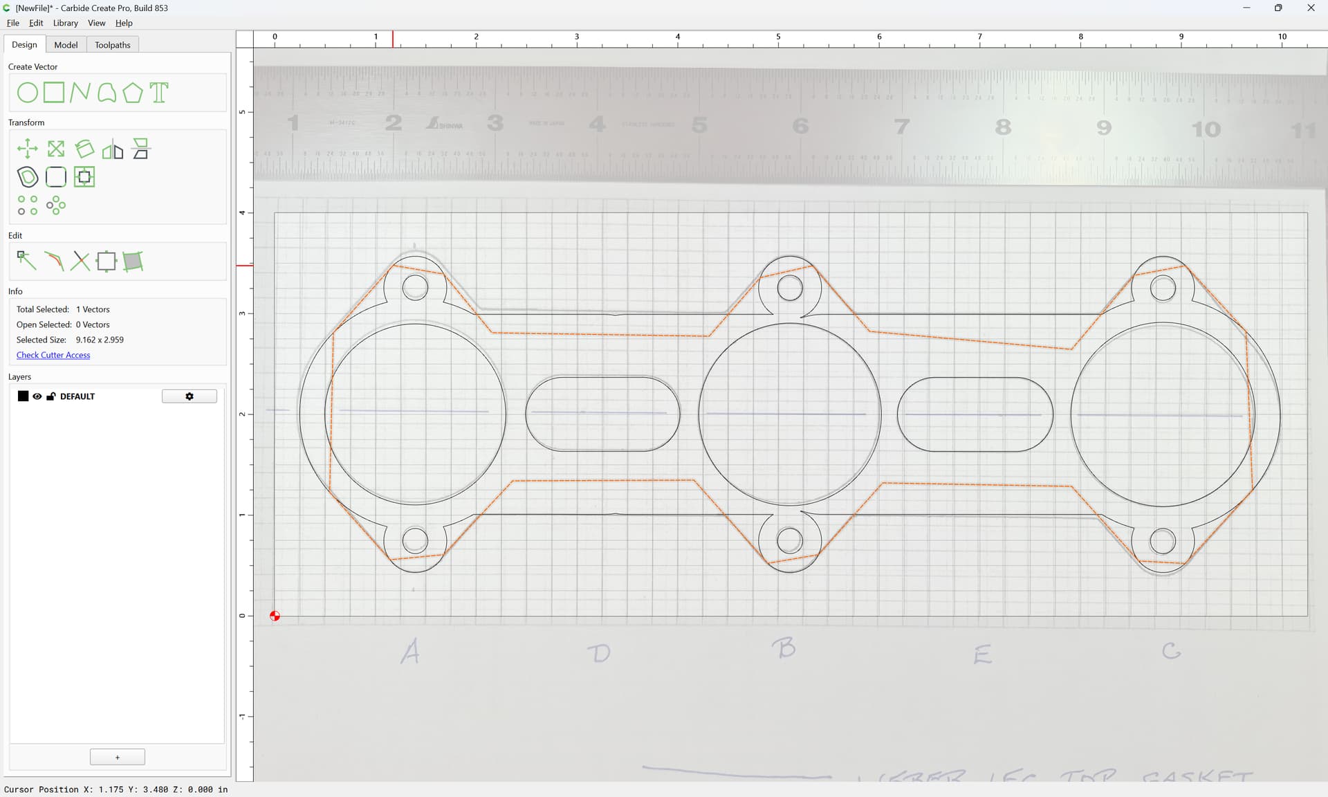

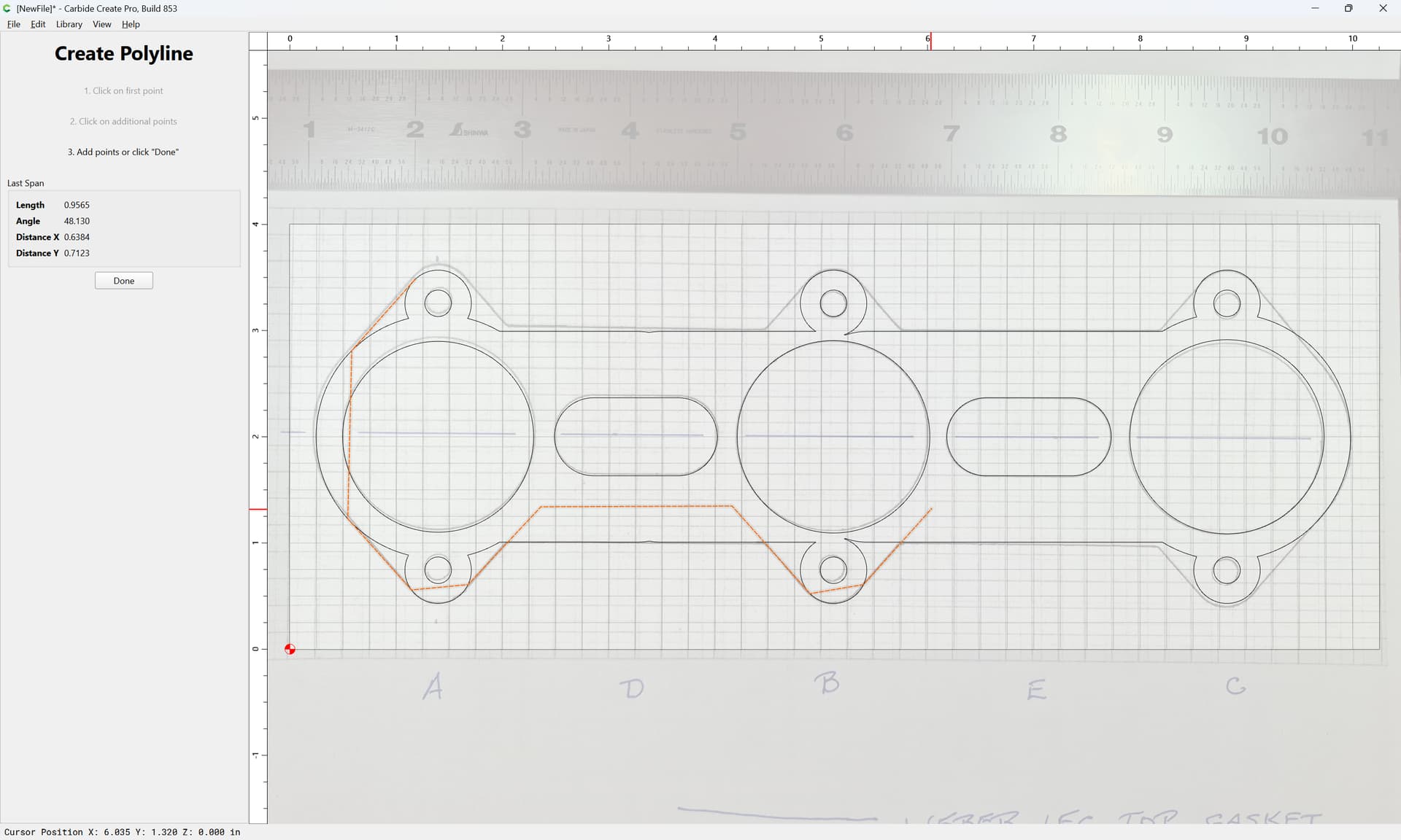

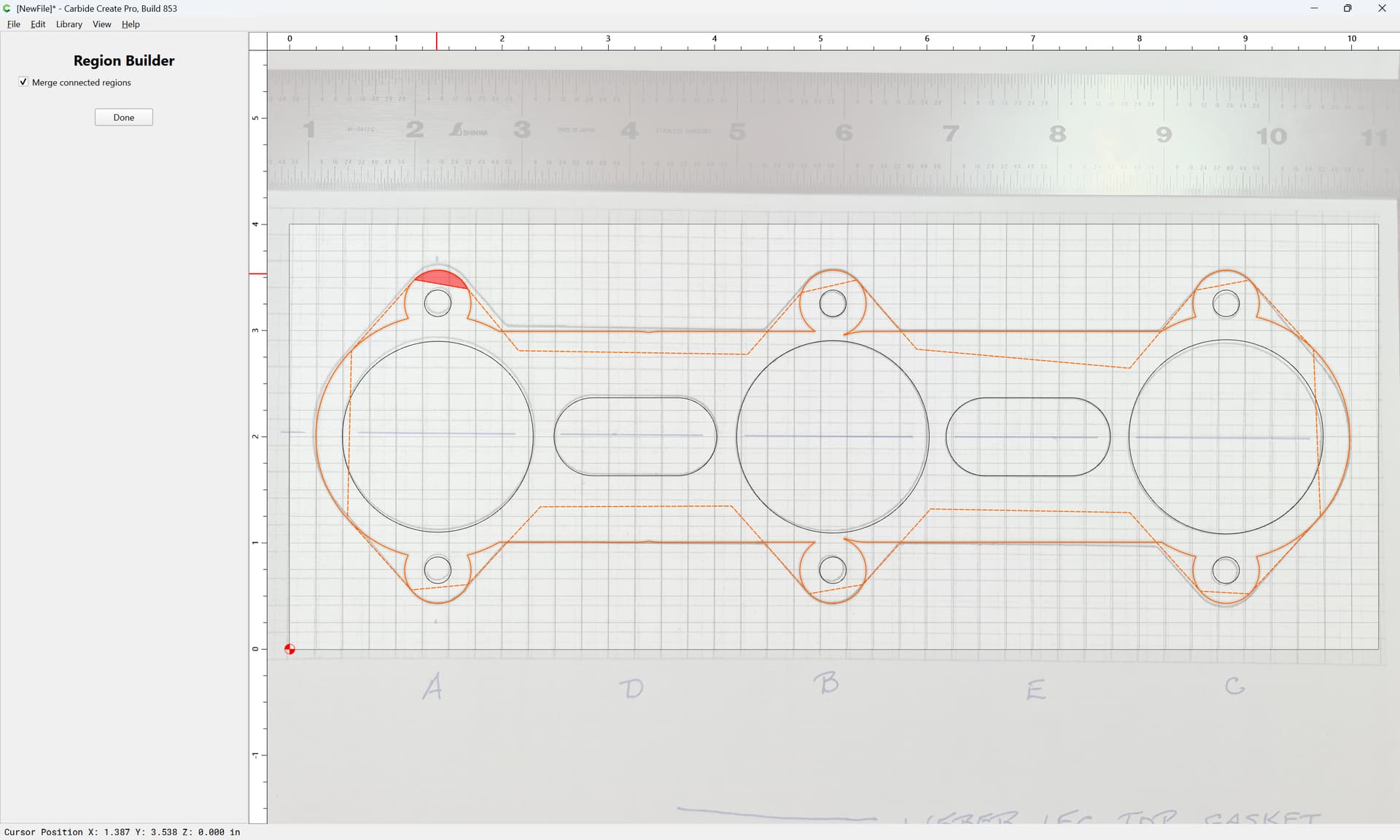

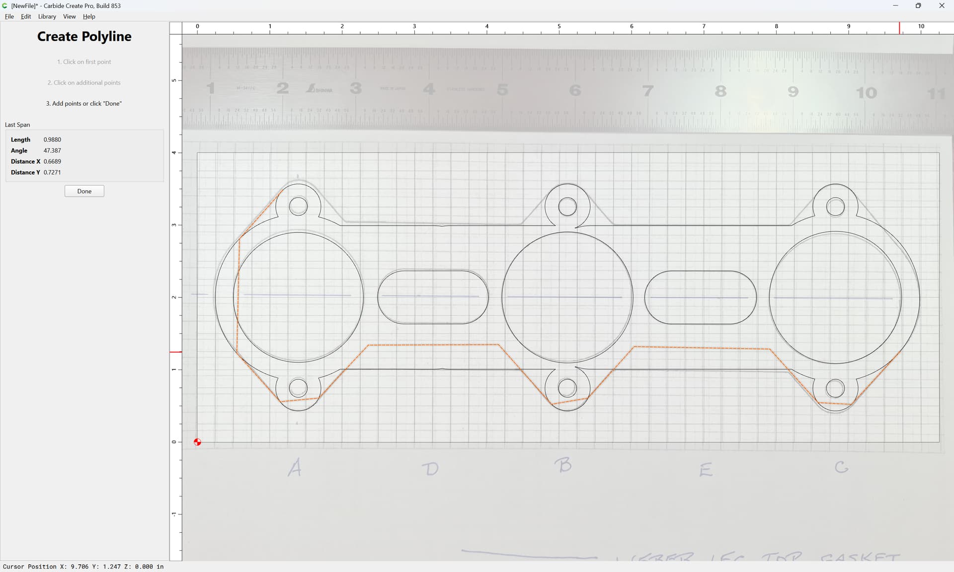

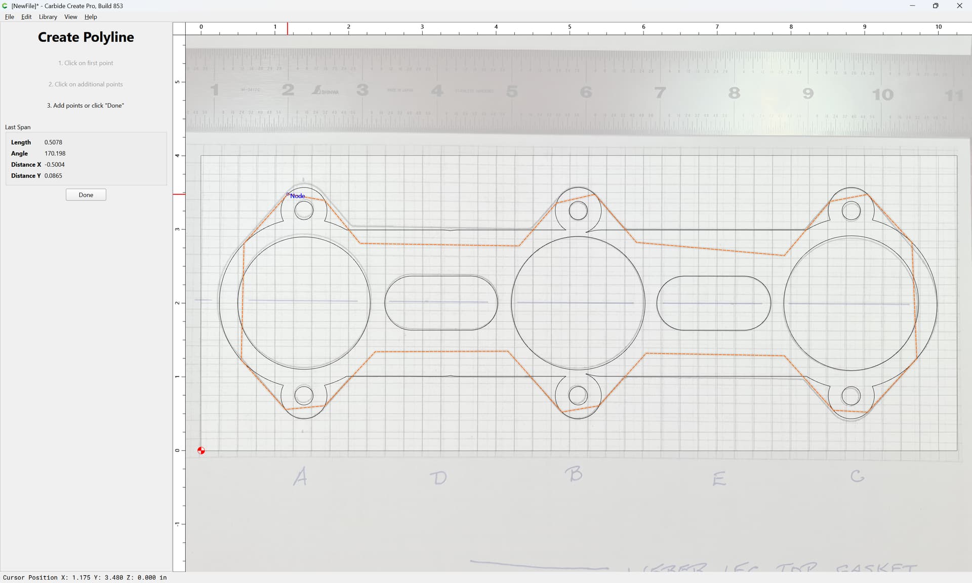

Then draw in the desired diagonals:

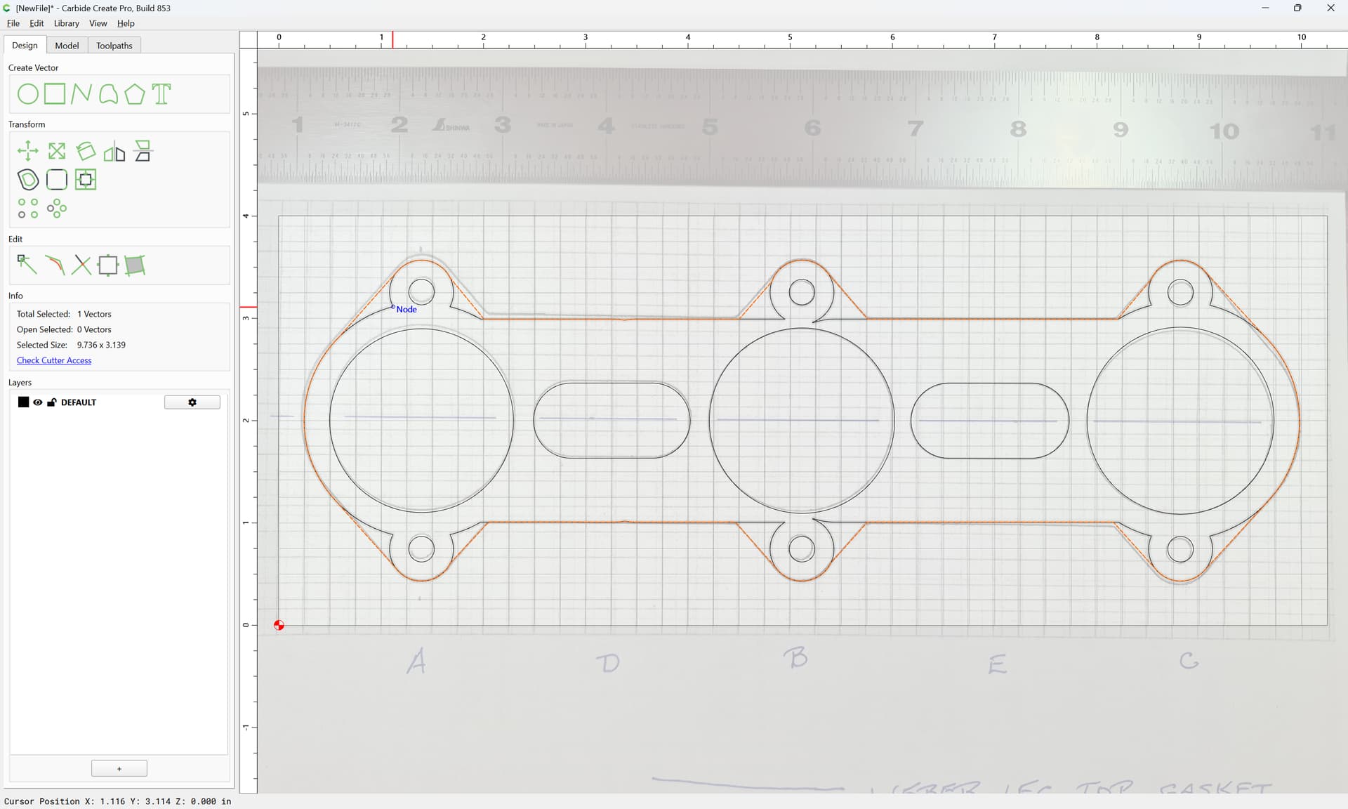

Then use Region Builder to combine the two outlines:
Yes
select the desired geometry:
