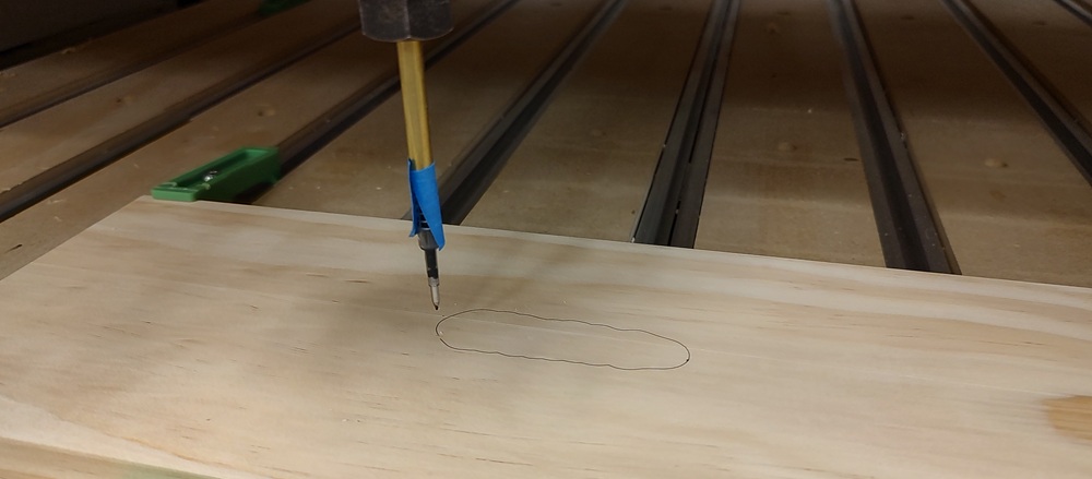

Every once in a while I need to glue another piece of wood onto my workpiece to build it up for carving, and need to “draw” onto the wood to get the location right. I’ve normally done this by profiling a super-shallow line with a v-bit, but the line can sometimes damage the wood, plus it’s hard to see when gluing.
I looked for a pen/pencil/marker holder for CNC machines but didn’t find anything with the needed precision (there was one for a marker). My solution today was the pictured 1/4" brass tube (with another 7/32" brass tube inside) with a pen insert and spring taken from a handy Amazon bag-o-springs. The blue tape just keeps it from falling out.
Has anyone come up with a better solution? I should clarify that I’d really like the router collet to hold the pen/pencil/marker straight down, so that I don’t have to calculate offsets. This worked great today to position the badge I need, but I would hope there’s something more “finished”, lol.

These are all great ideas, thank you! when Carbide Motion wants to measure the bit depth, how do you do that with these fixtures? With my brass tube approach, I had to cut a wooden dowel to the same length and manually place it next to the pen tube while the bit is coming down towards the BitSetter, so that the dowel length is measured. The pen length can’t be measured because it’s spring-loaded. I’m probably missing something obvious.
I use a customized post processor for when I am using the pen holder that omits the spindle start and tool change, and the end of program is “move to the front and raise up 1 inch” . For the initialization, I just use my finger to fake the bitsetter.
Then I manually zero the pen to the surface. Since my specific pen holder doesn’t use a spring, I just set the “cut depth” to -0.10" and let it run.

When using a pen (or an M.C. Etcher), I disable the BitSetter.
I will design and 3D print my own. I will design an outer cap that is the hard stop. You might be able to use a plastic tube or similar.
Depending on how you designed it, you might be able to use a binder clip as a temporary stop.
