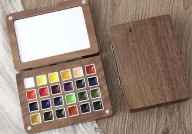

Drawing up a water colour paint palette
this came up at:
https://old.reddit.com/r/hobbycnc/comments/1q0woec/looking_for_opinion/

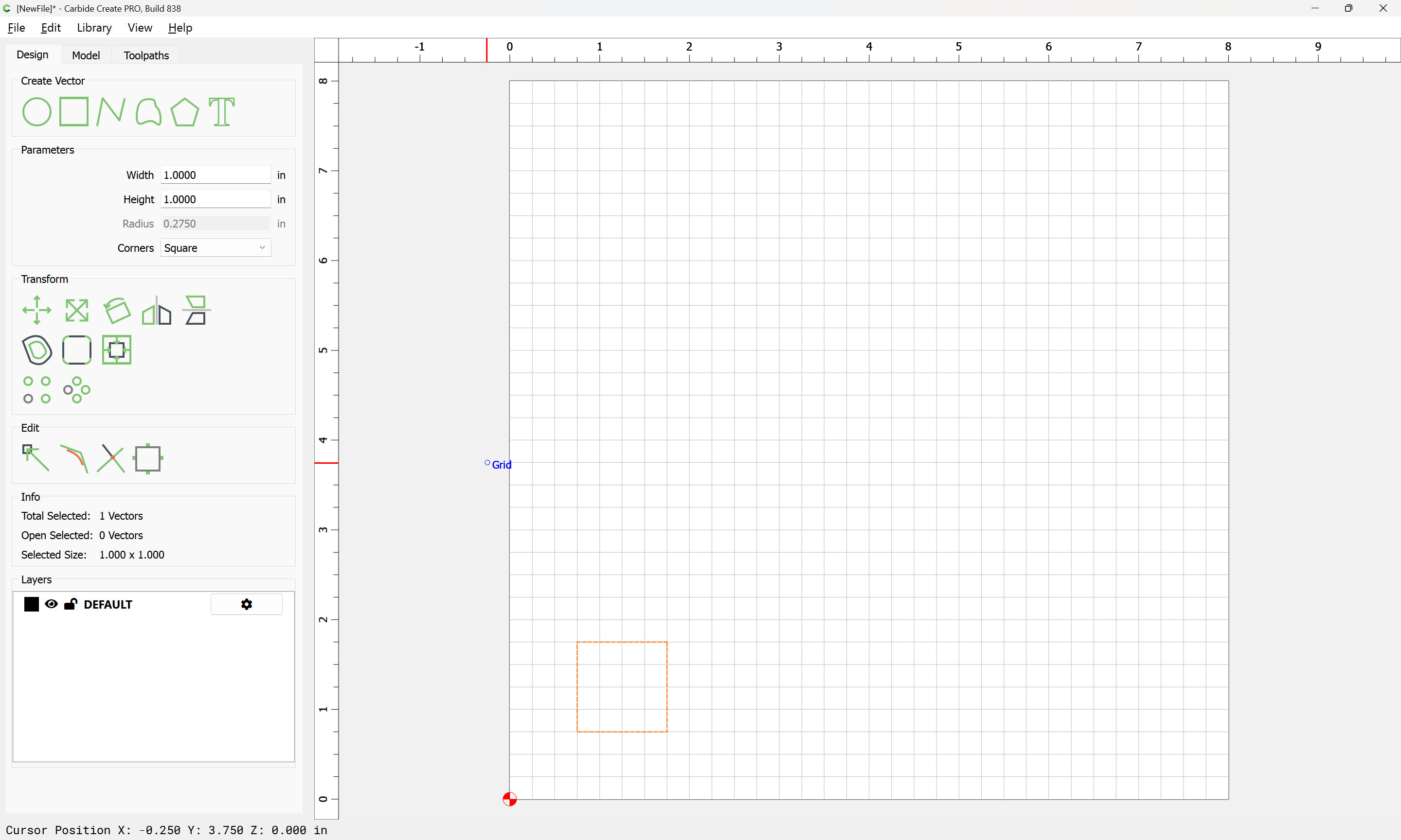

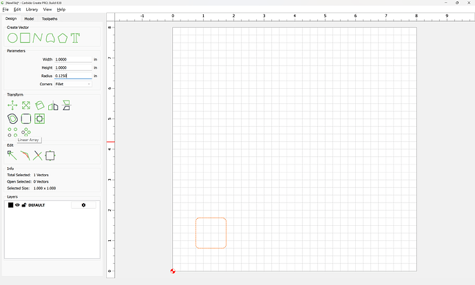

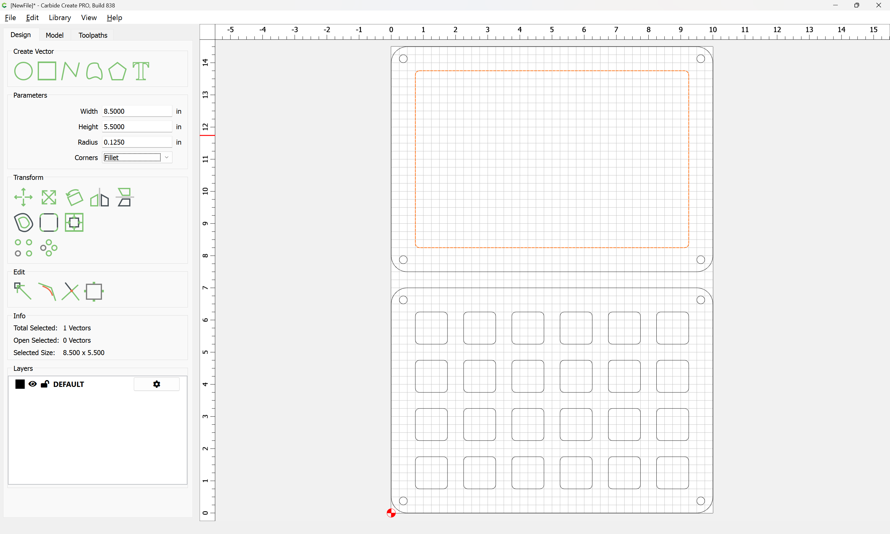

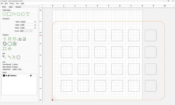

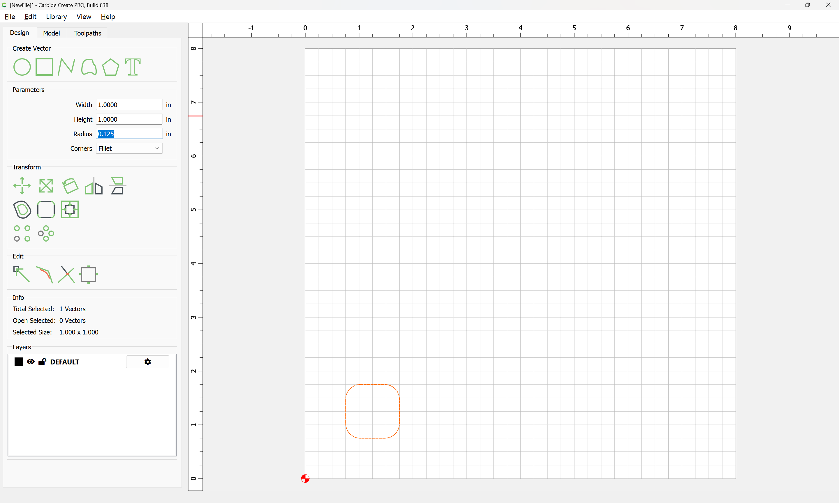

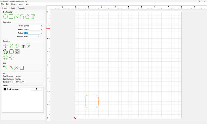

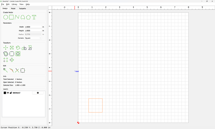

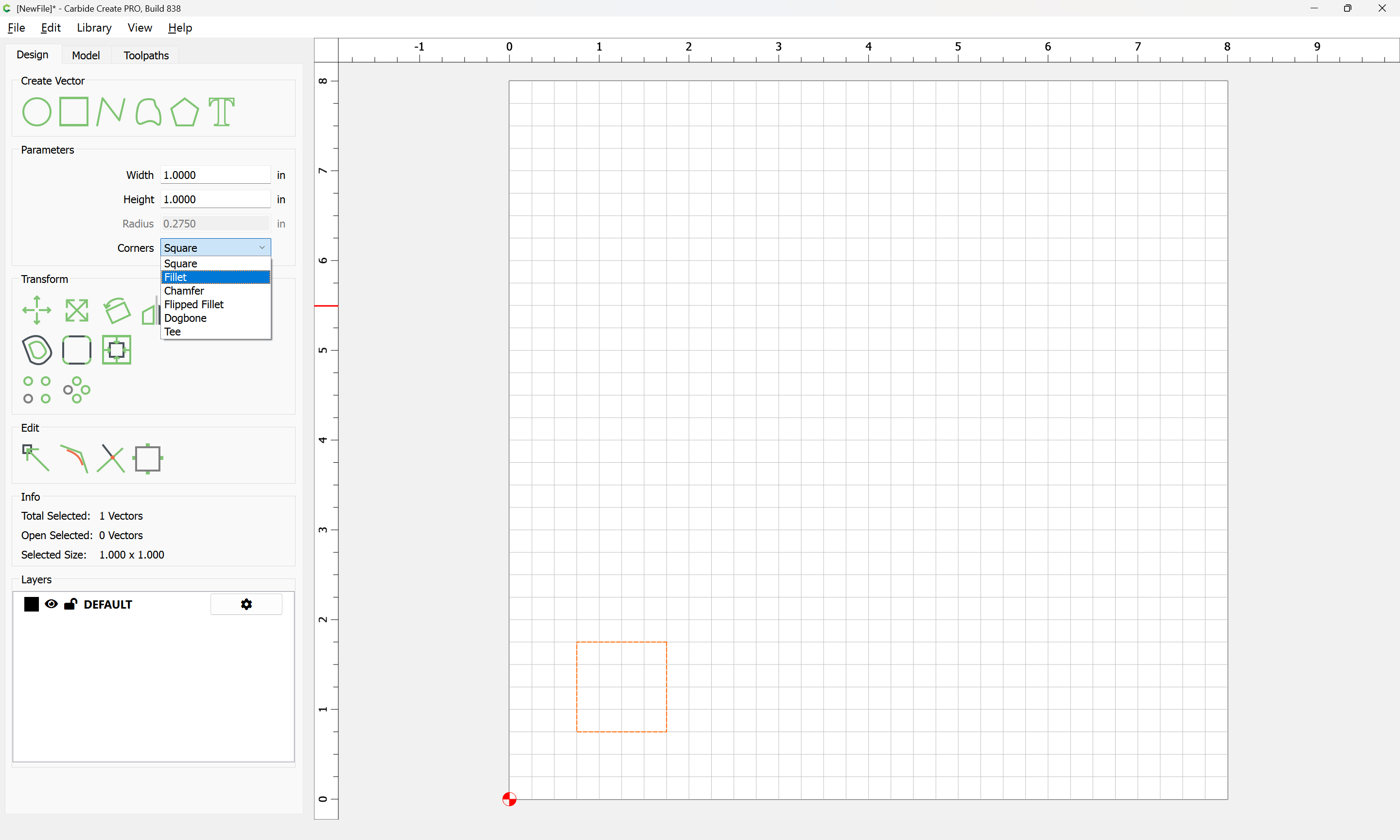

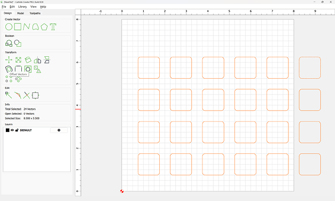

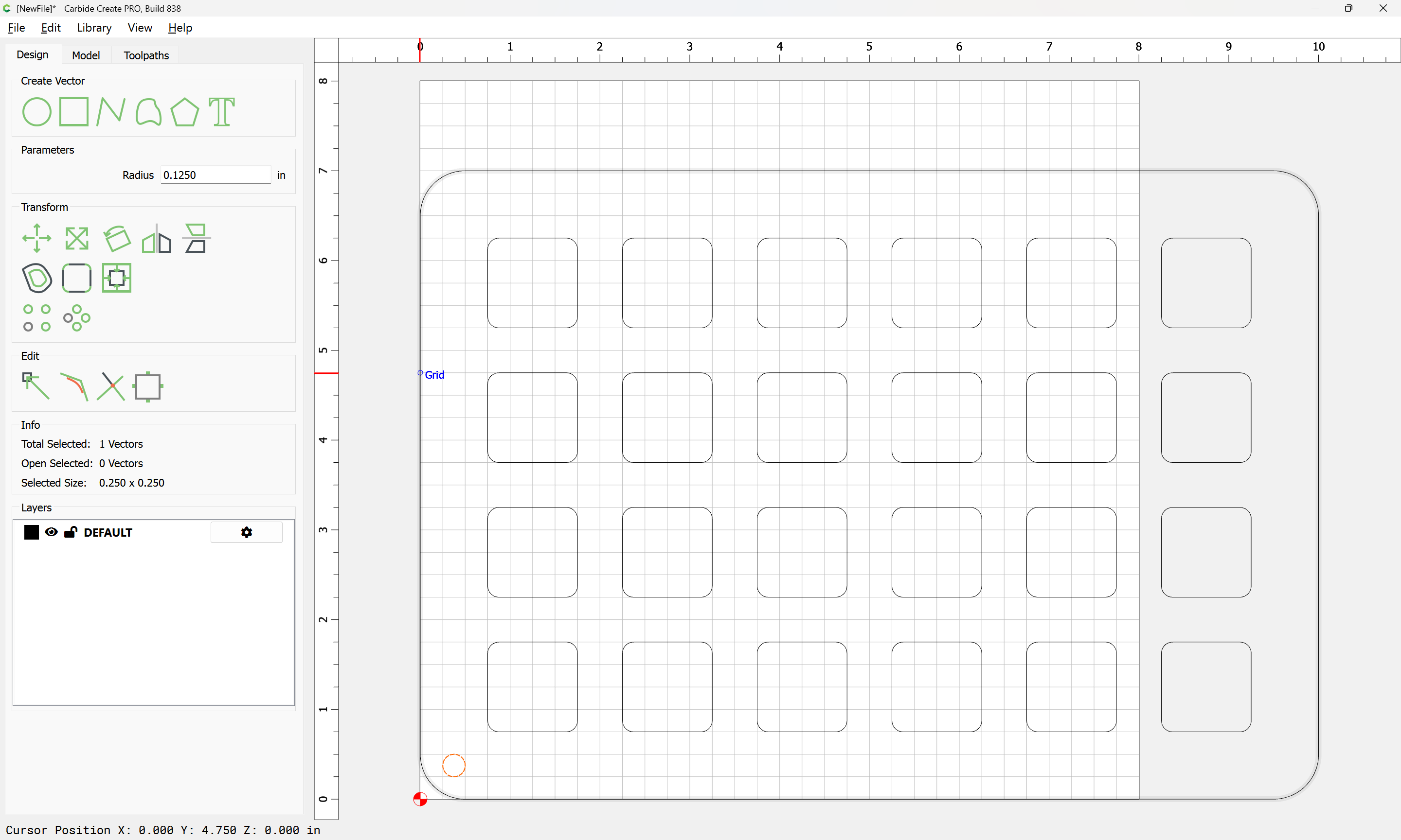

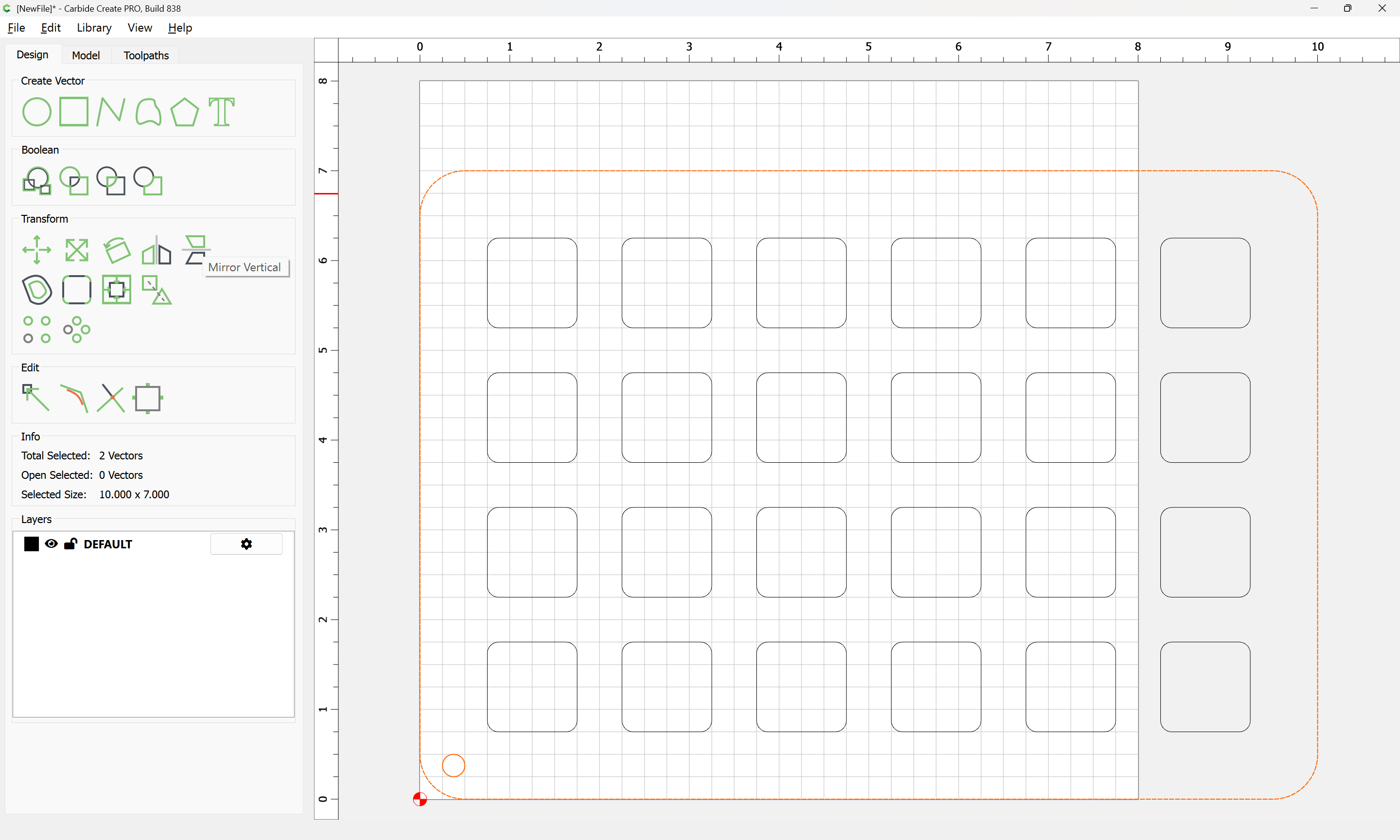

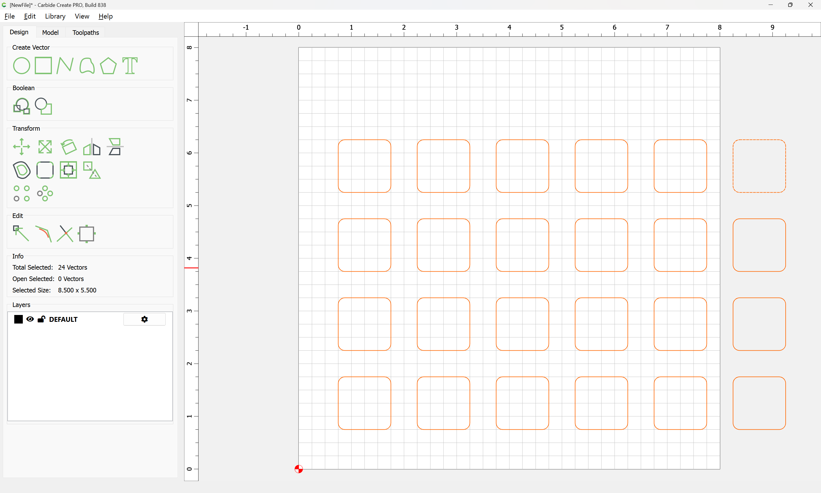

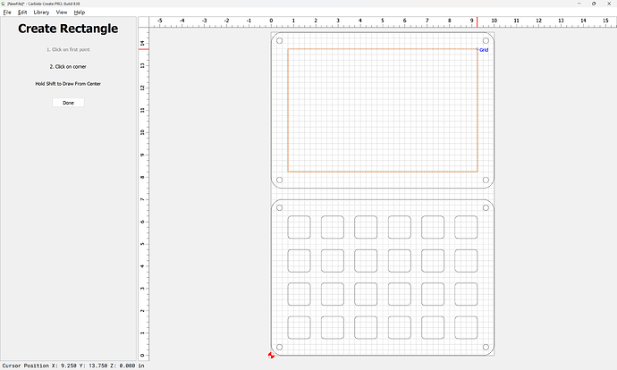

First, draw up one indentation for paint β€” guessing at dimensions, so 1" x 1" w/ a 1/8" radius:

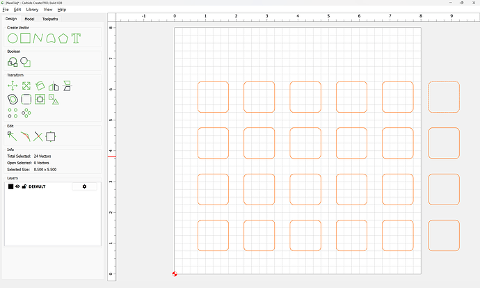

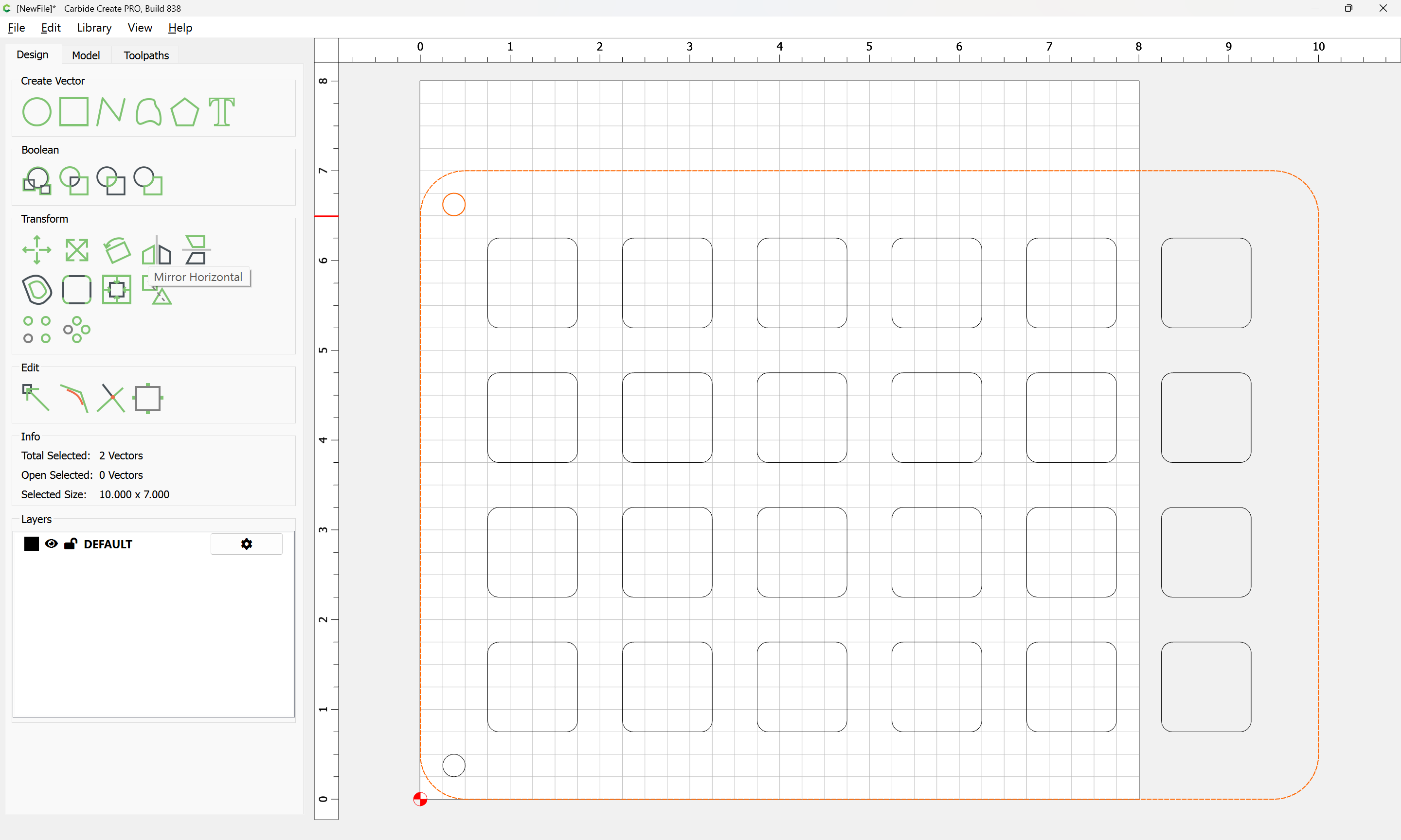

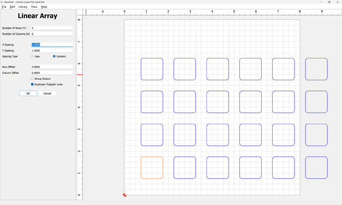

Then use Linear Array:

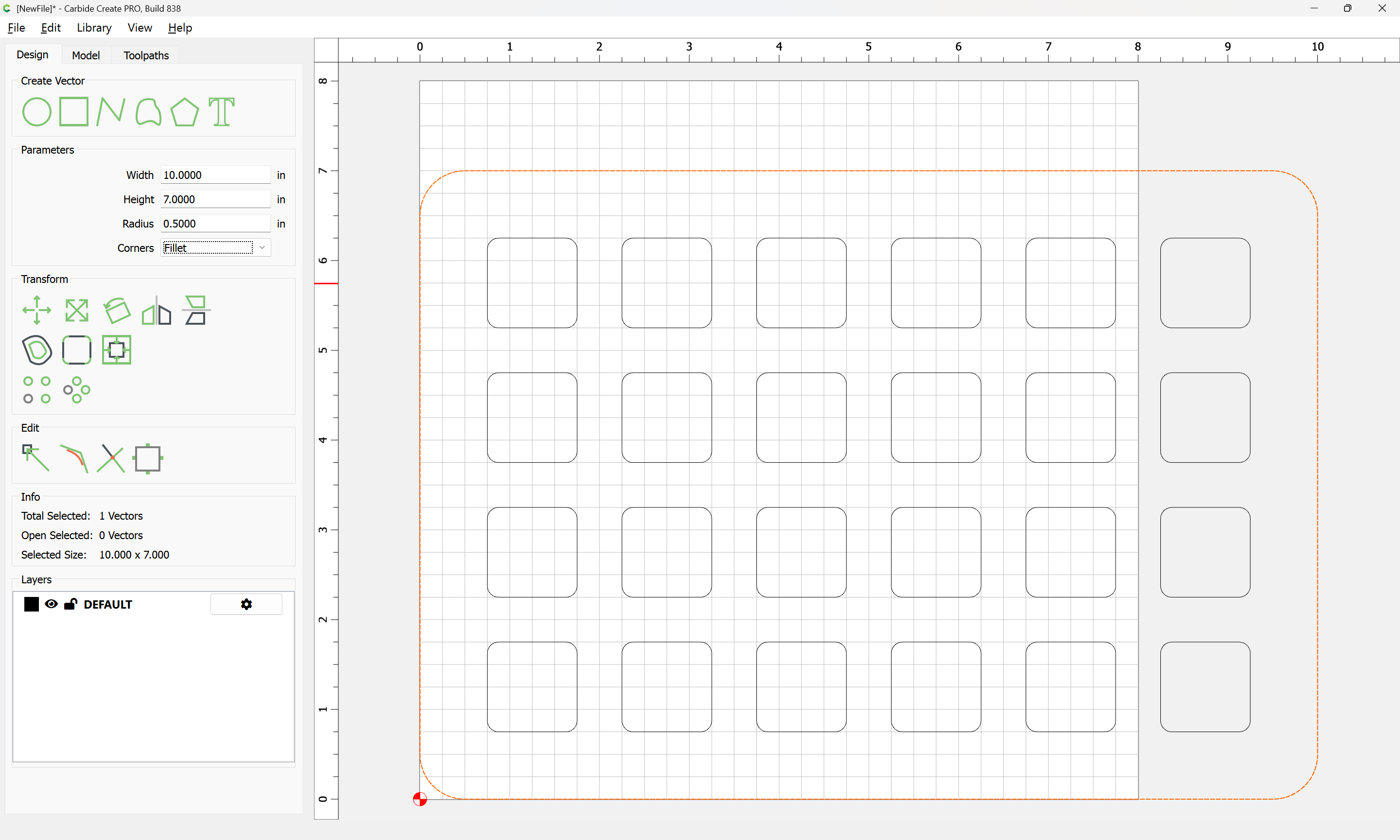

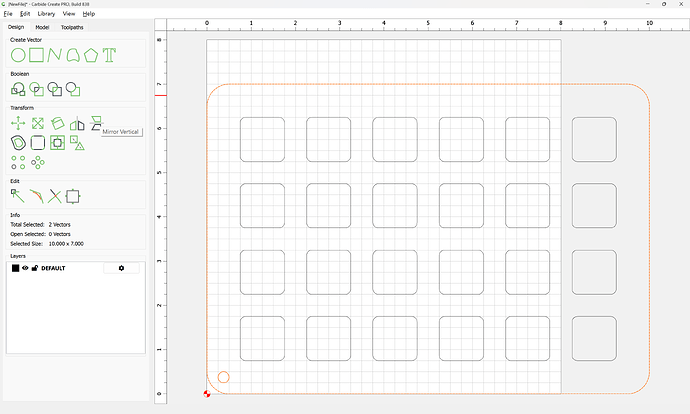

to make as many copies as are desired:
adjusting spacing as desired
OK

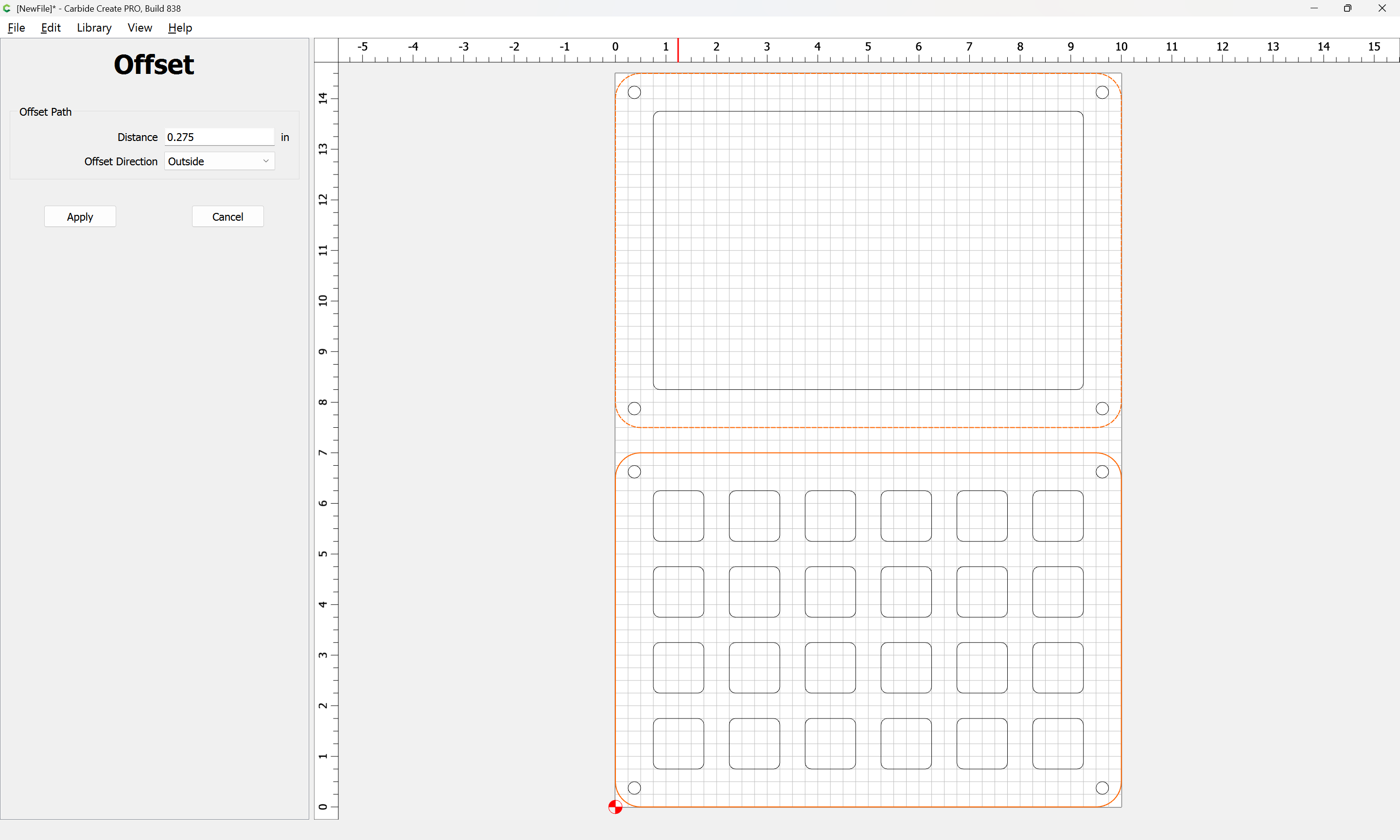

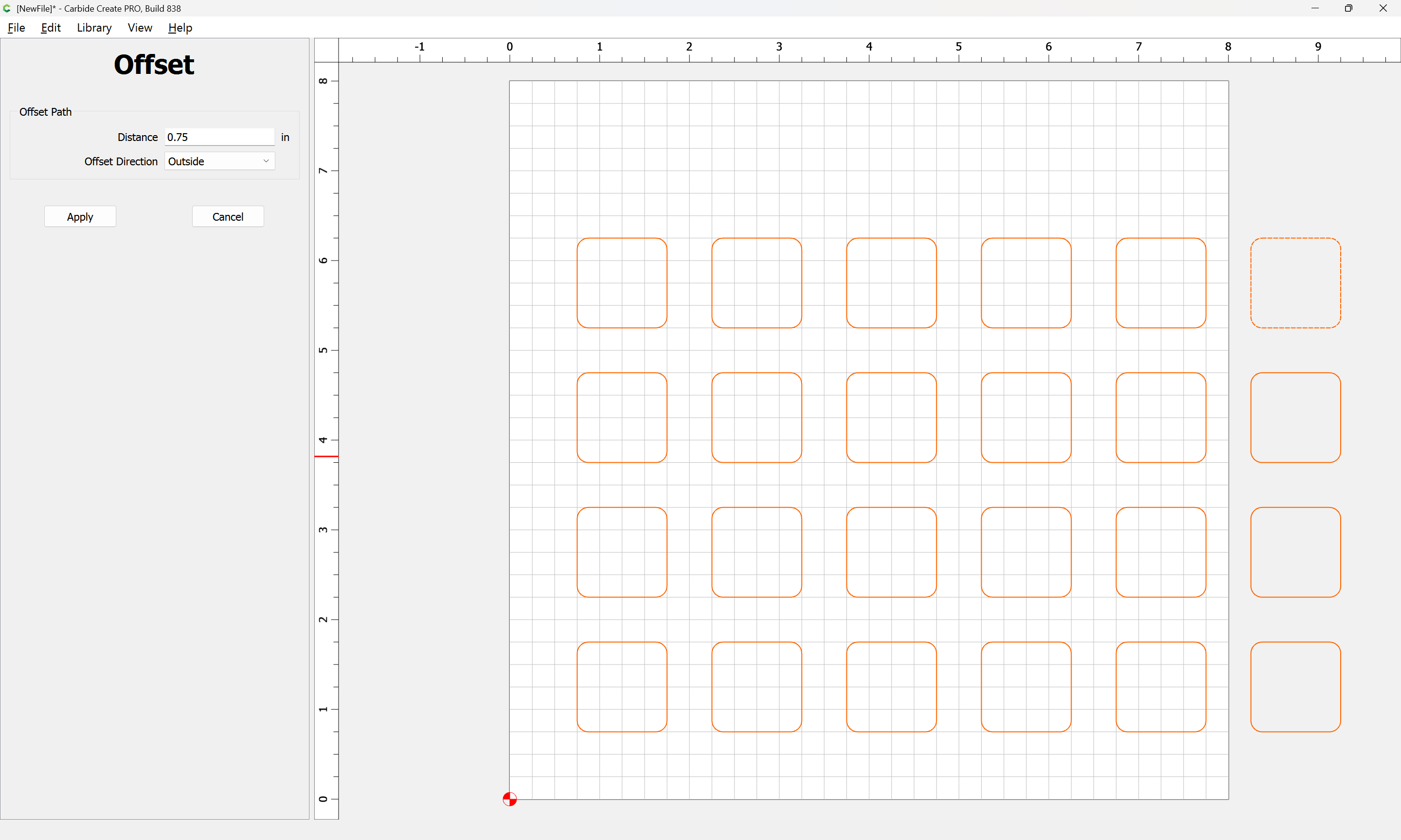

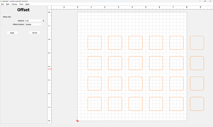

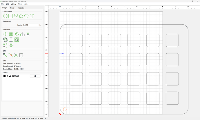

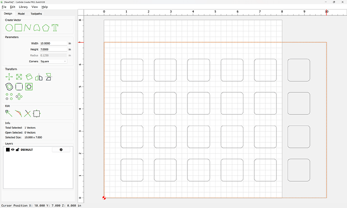

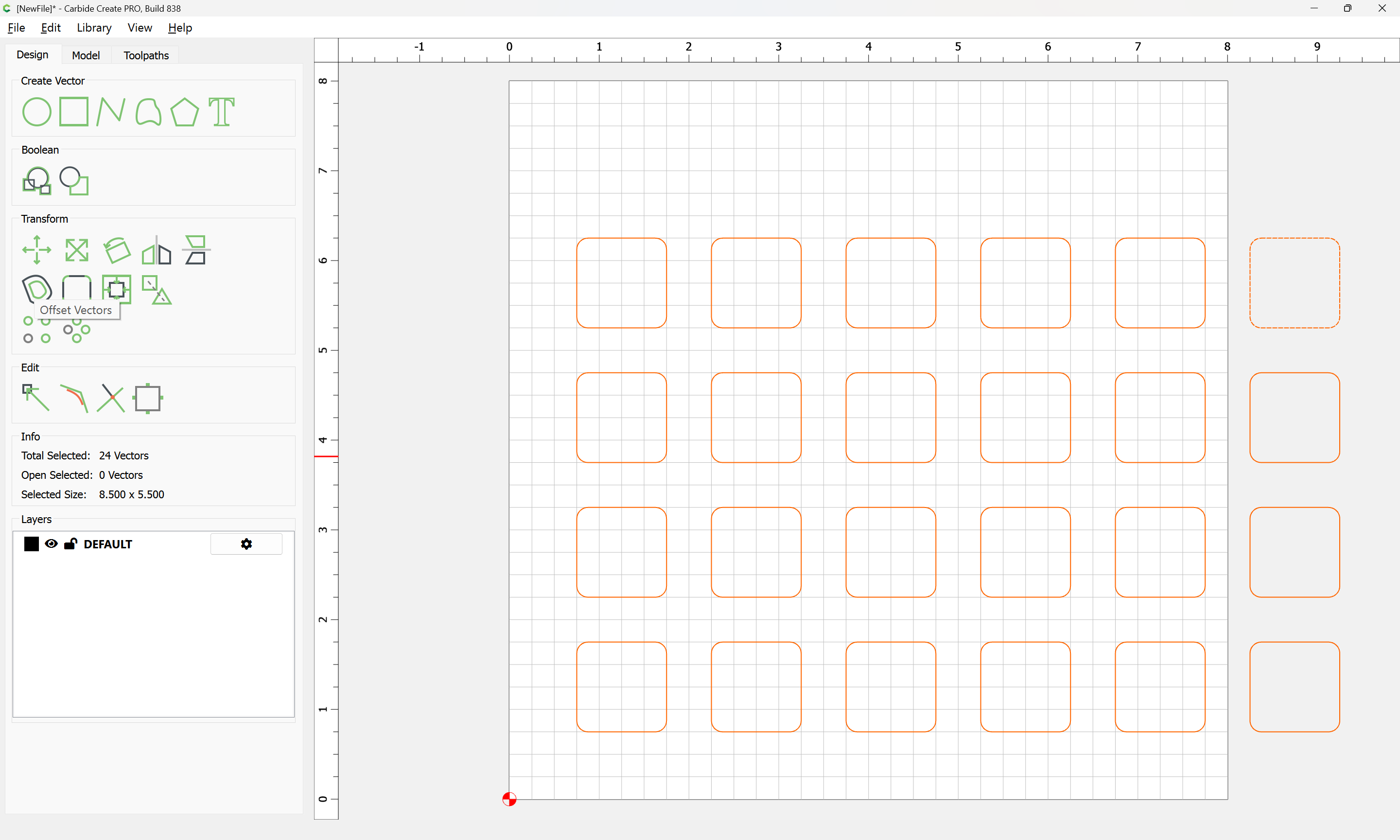

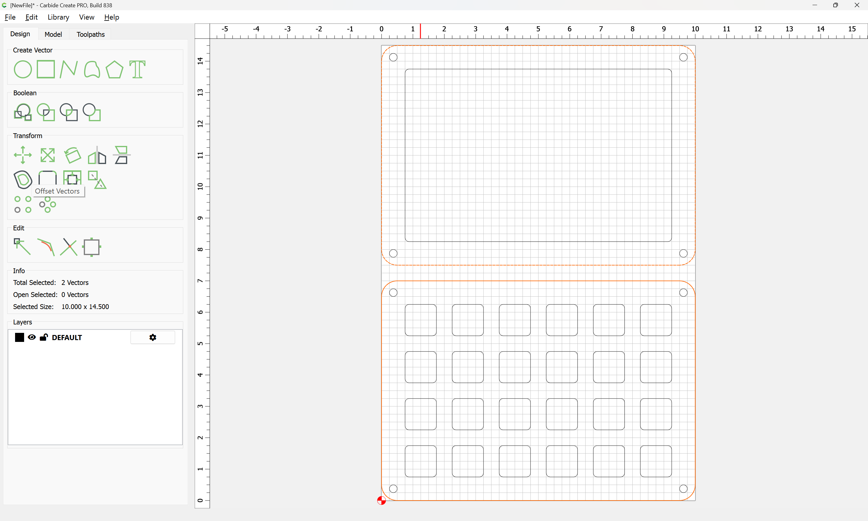

Select everything and offset by the desired area around the palette area:
Apply

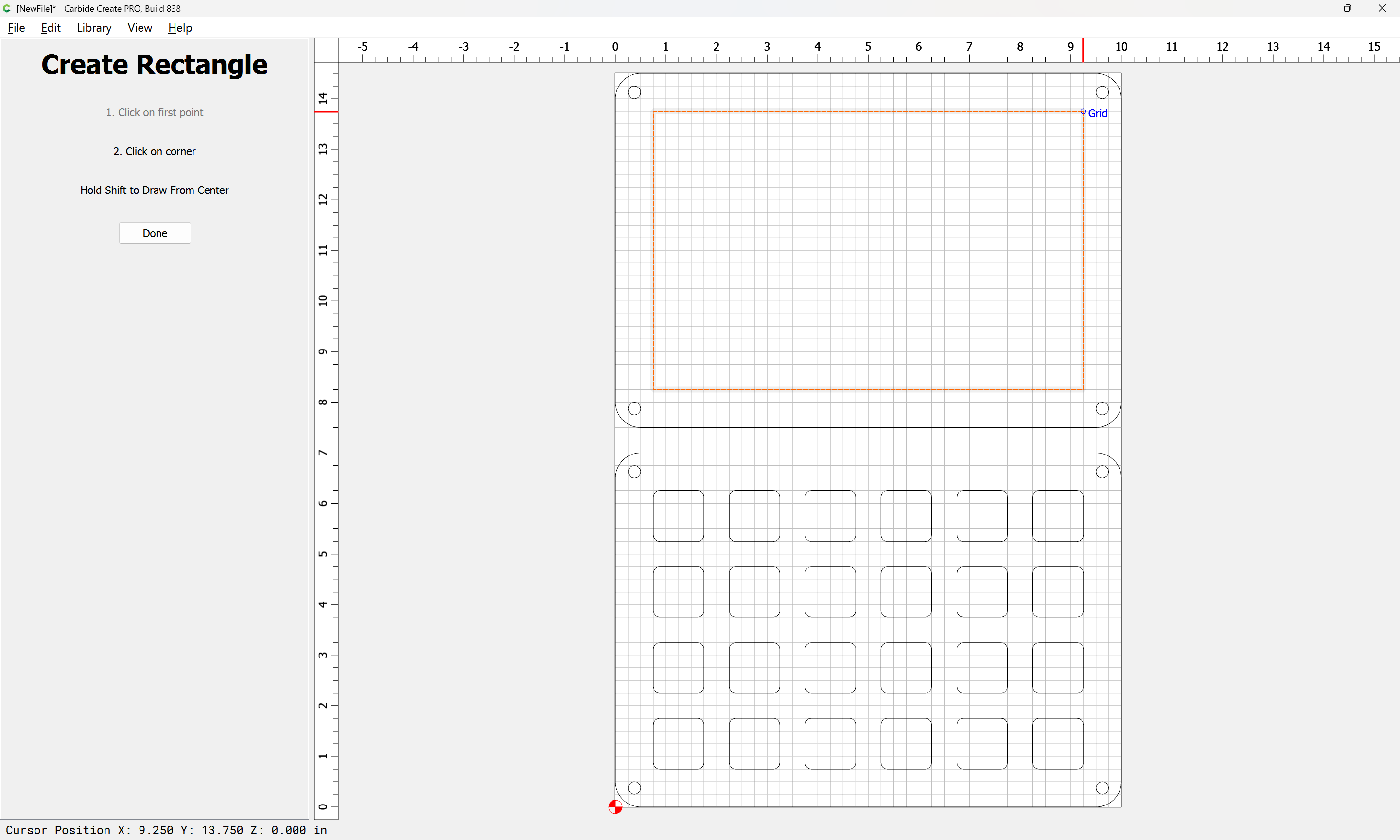

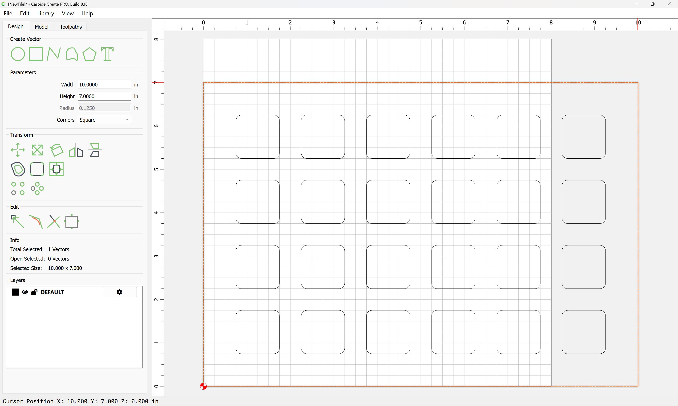

Delete that and use the dimensions of the offset to create a rectangle:
and round it off as desired:

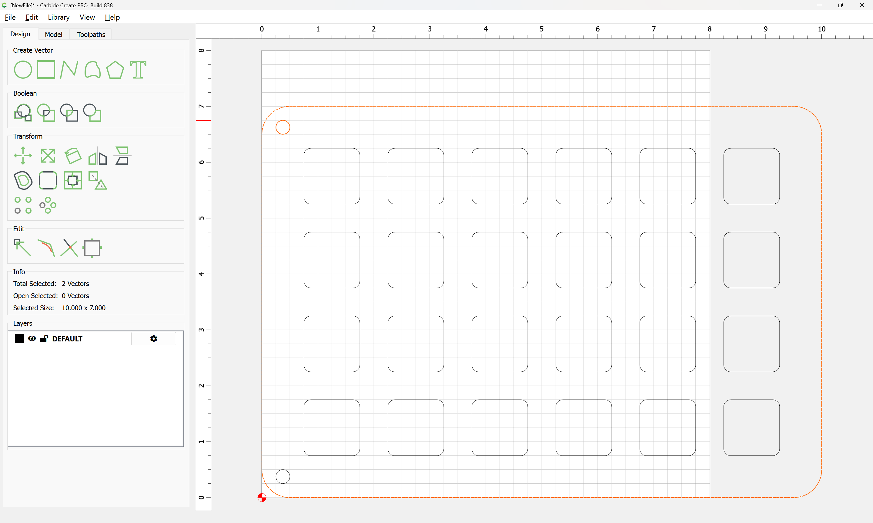

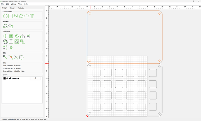

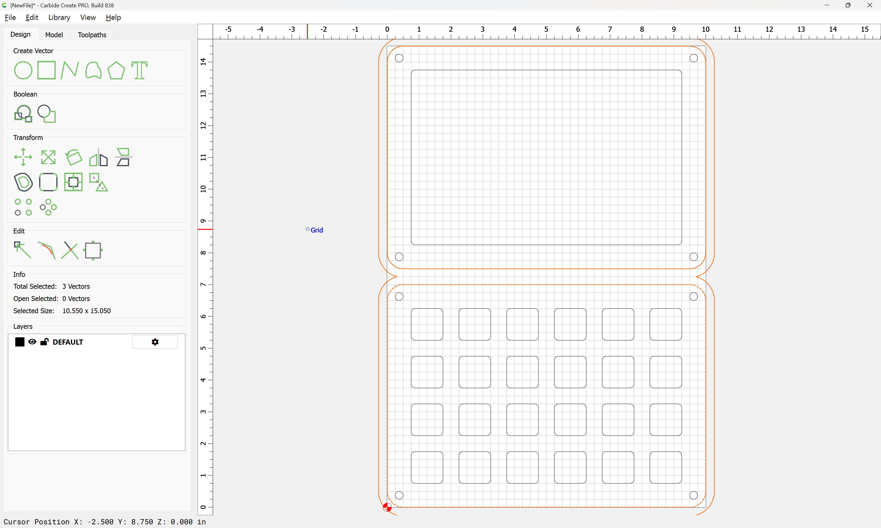

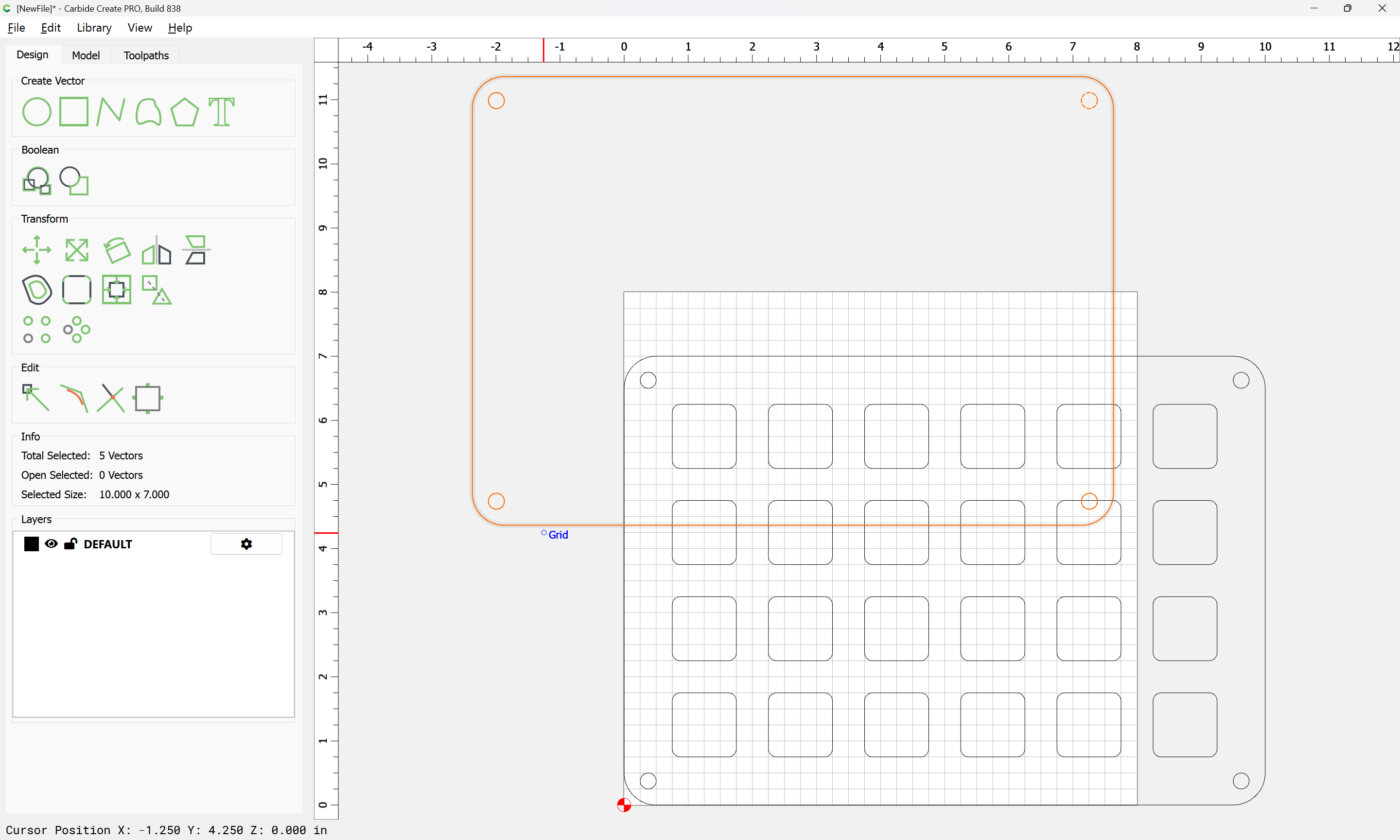

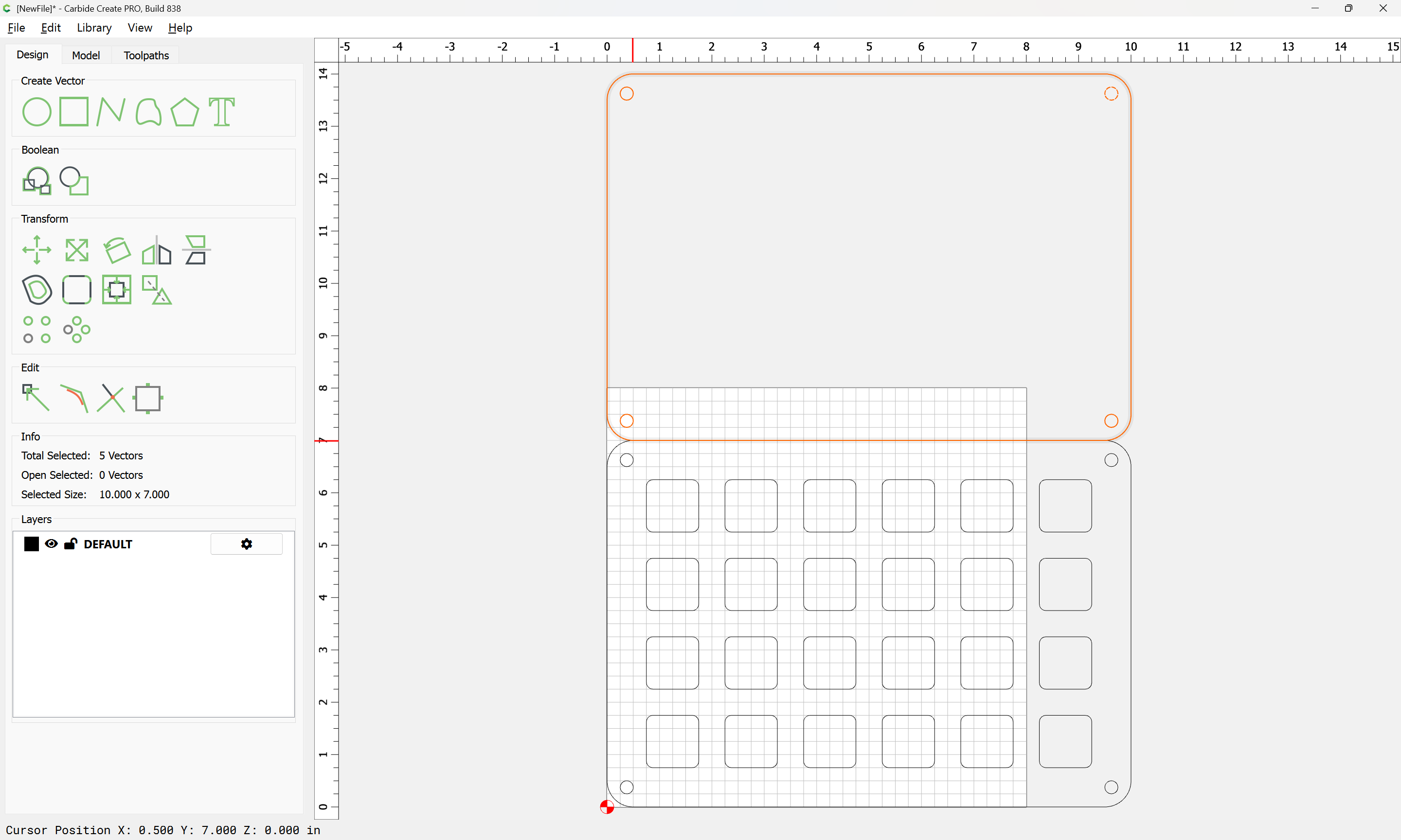

Add holes for the magnets at the corners:
and duplicate them:
and mirror into position at other corners:

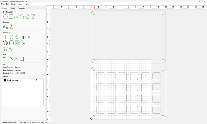

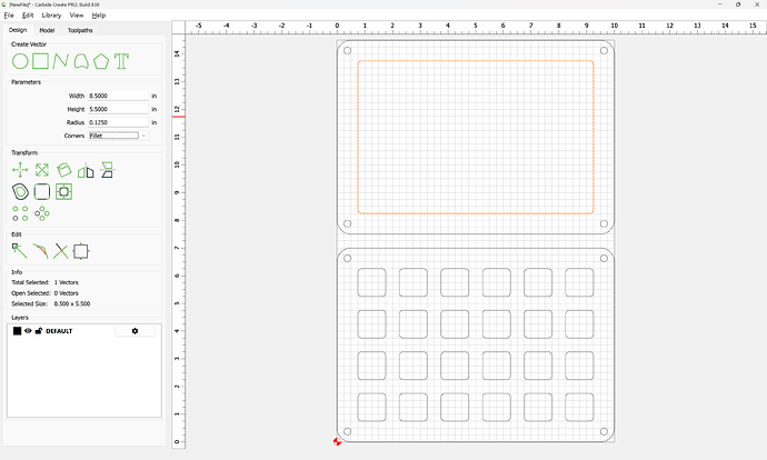

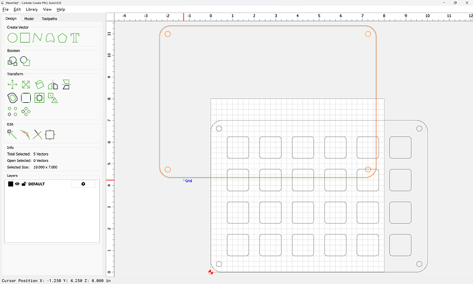

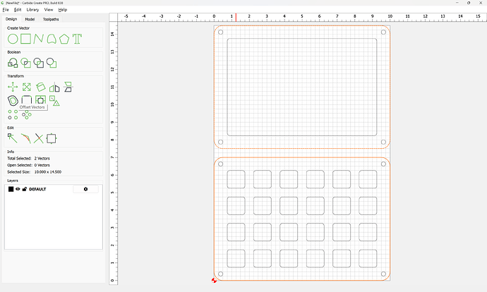

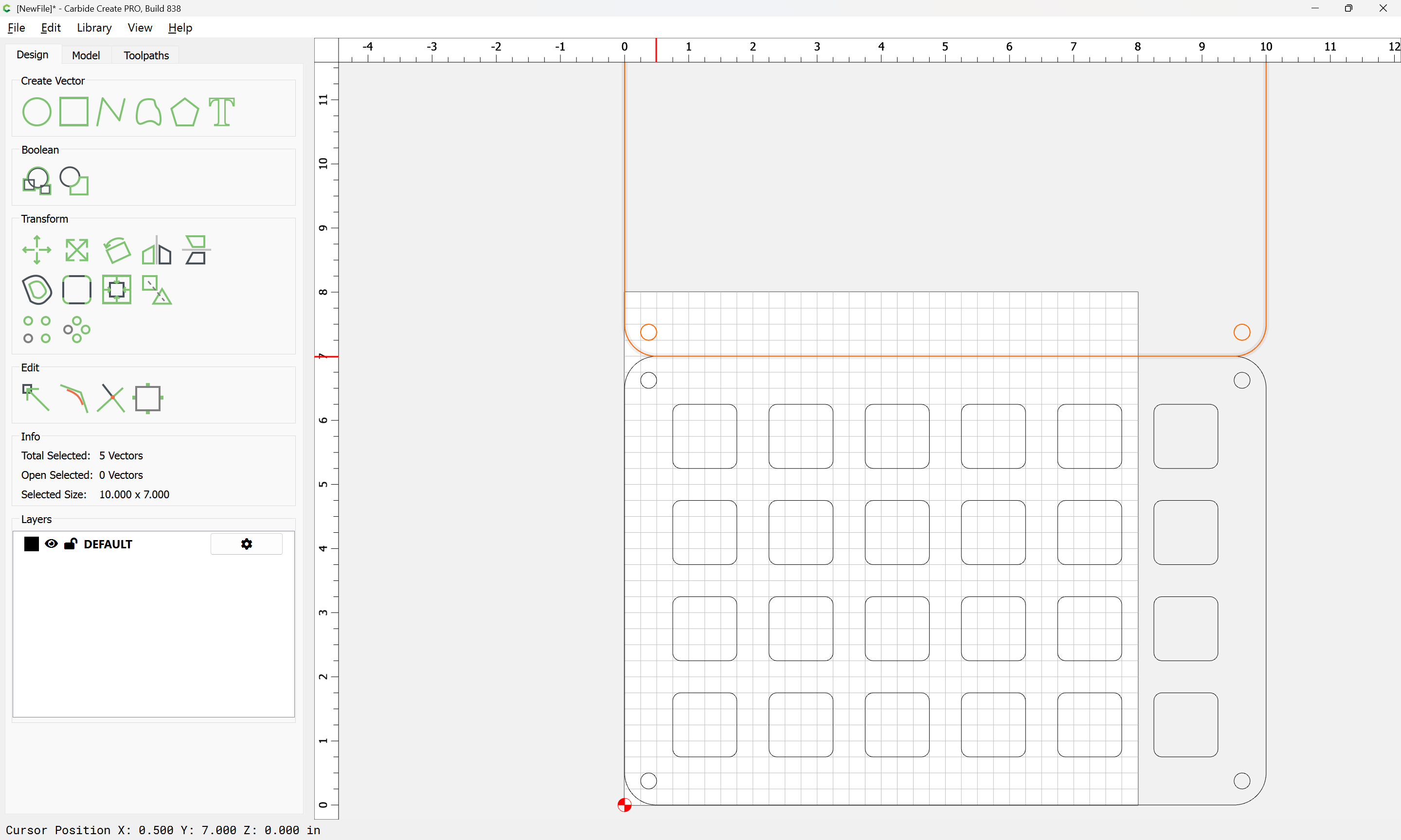

Duplicate the magnets and the perimeter:
Drag into alignment:

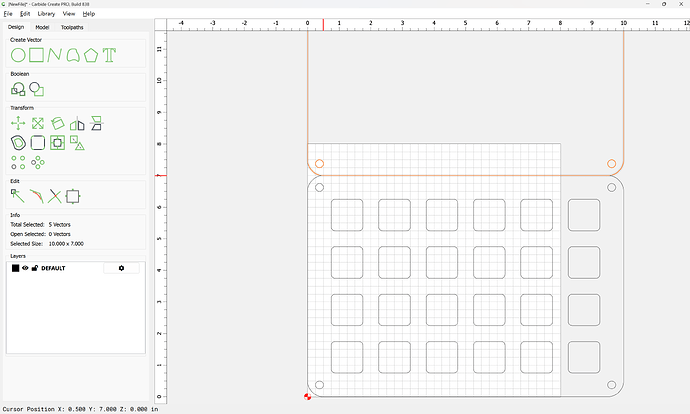

and nudge up enough to allow the two parts to be cut out of a board:

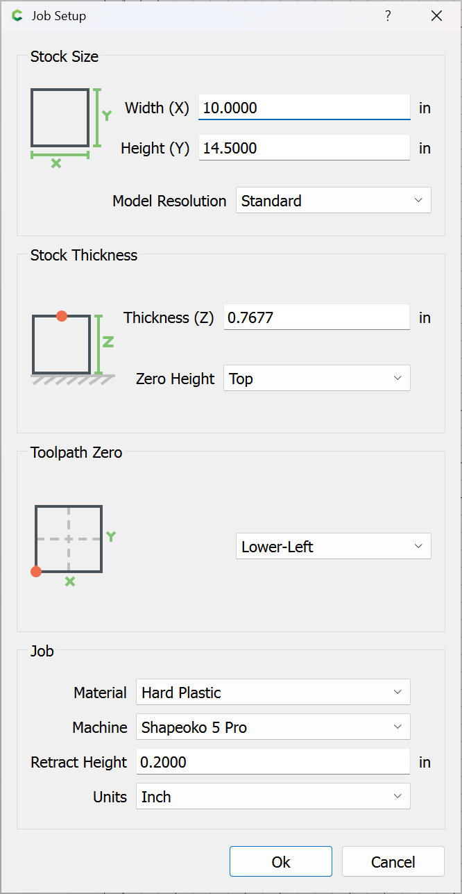

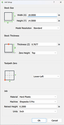

Adjust Job Setup:
and draw in the area for the paper:

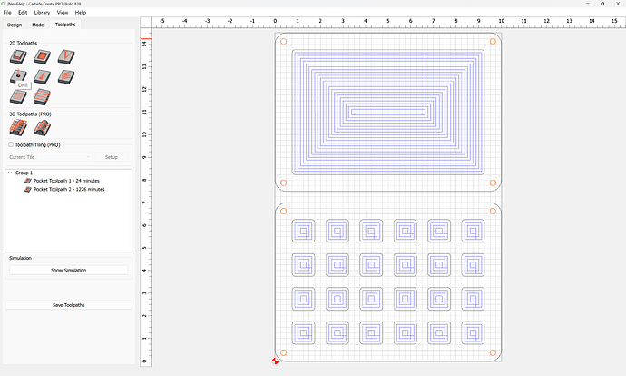

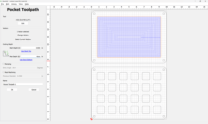

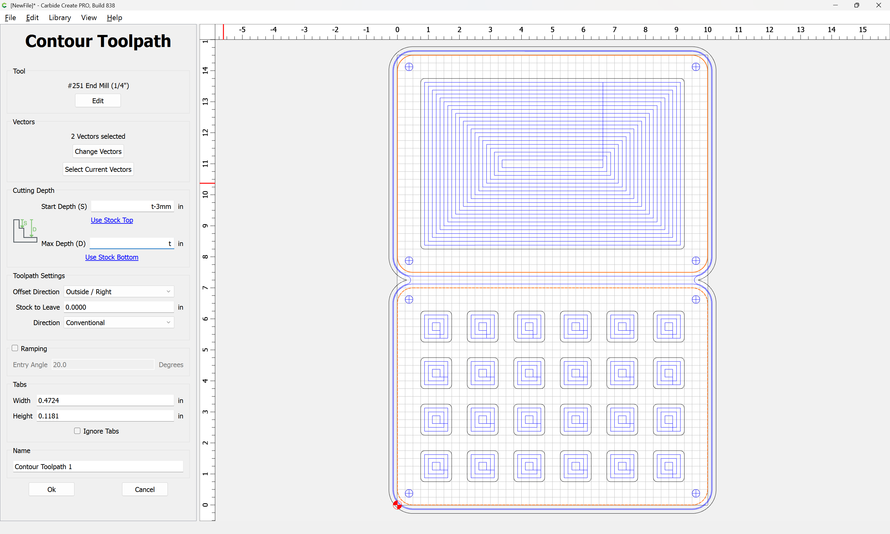

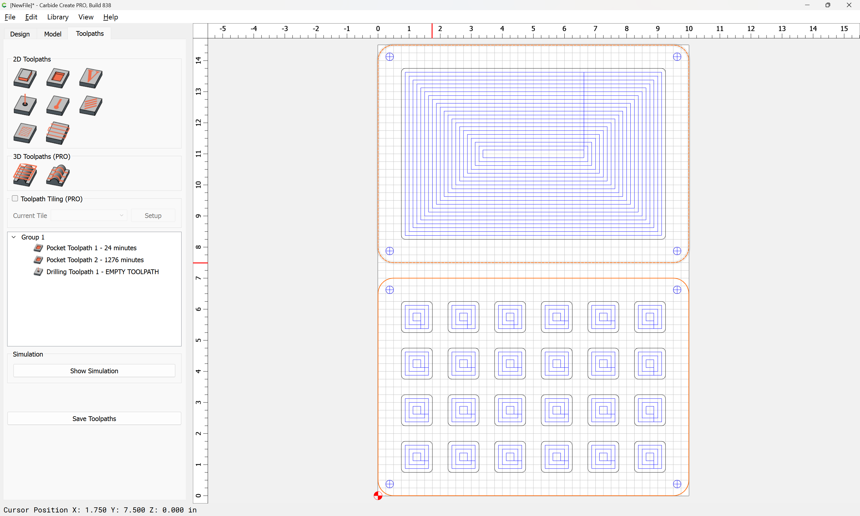

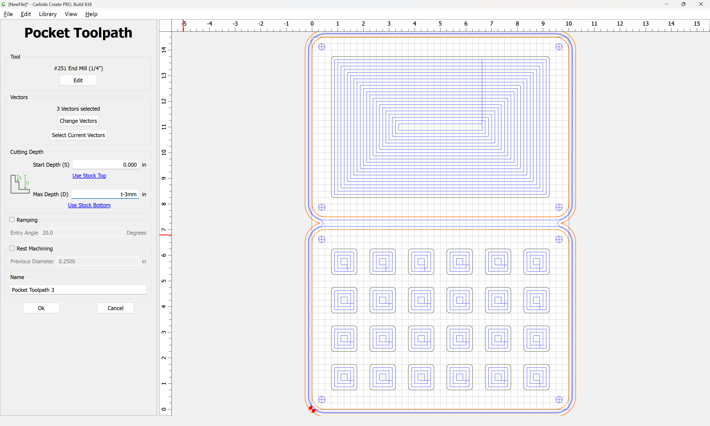

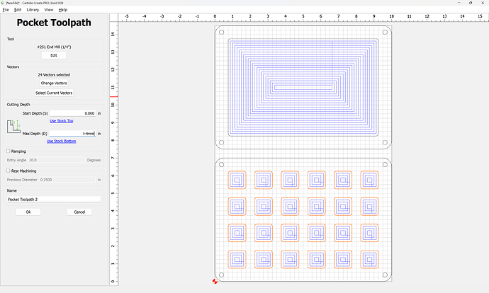

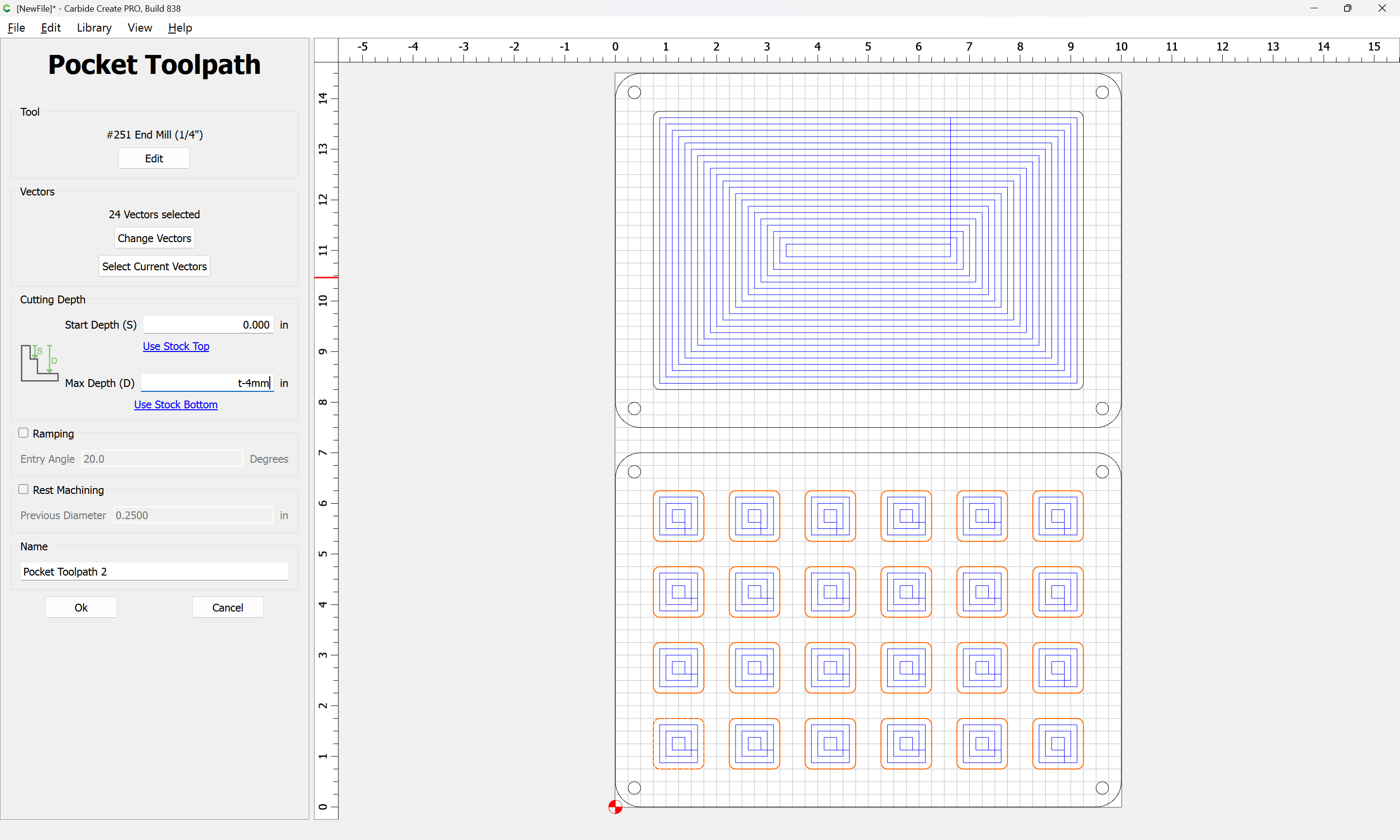

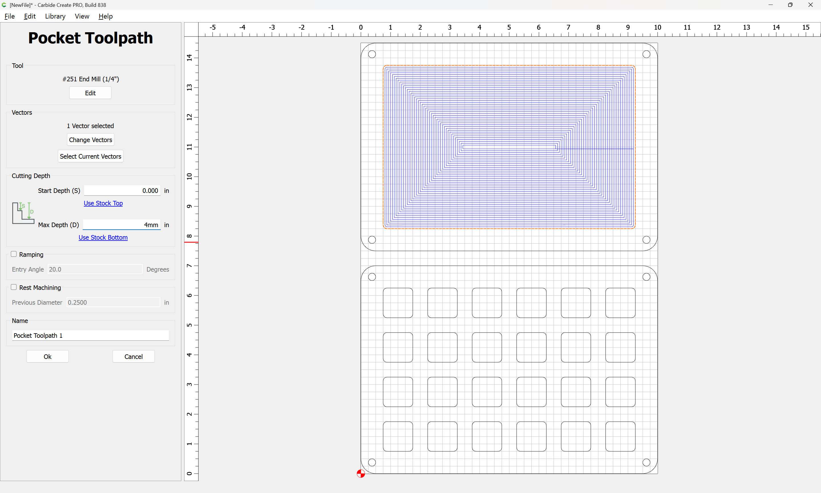

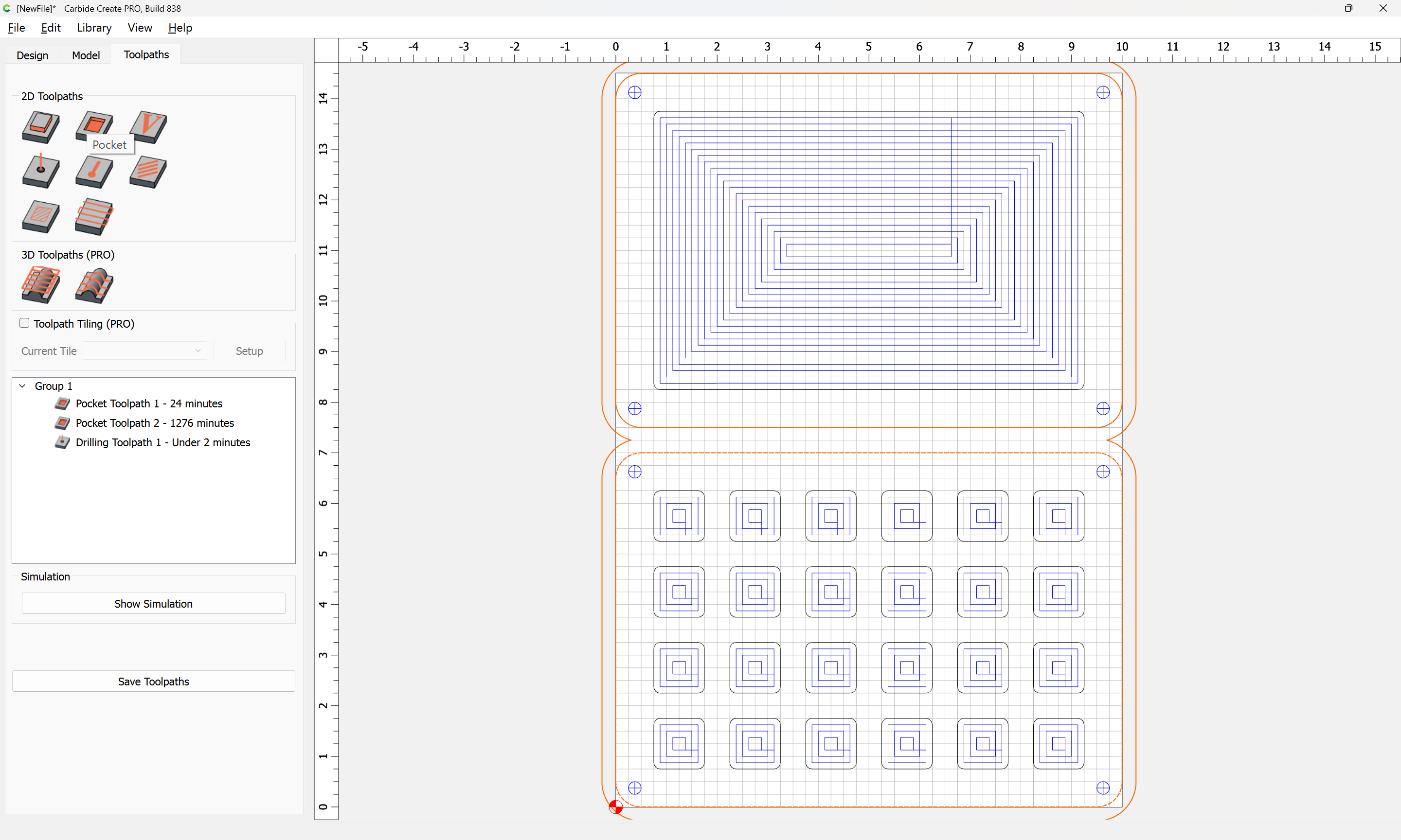

Then set up toolpaths:

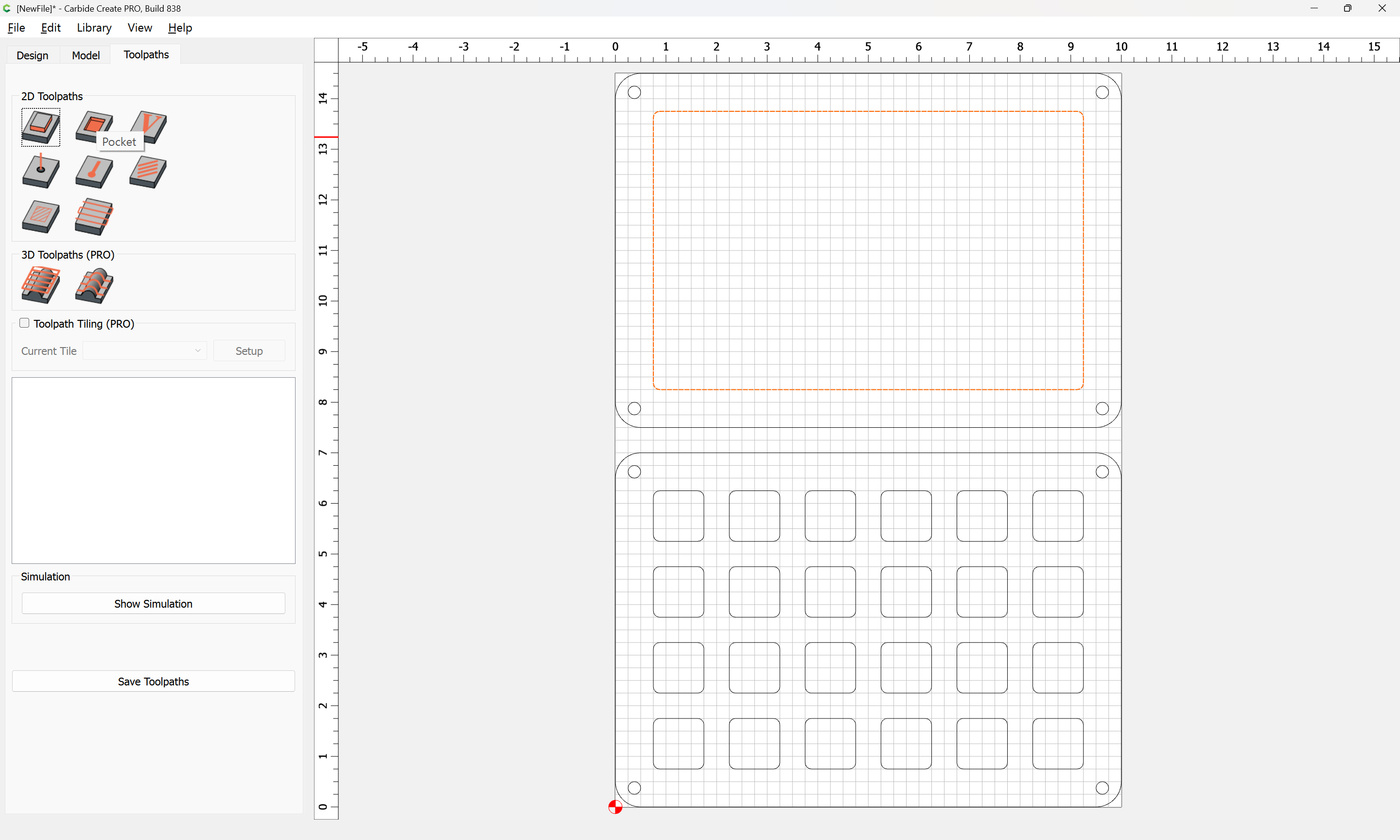

Start with a pocket for the paper area:

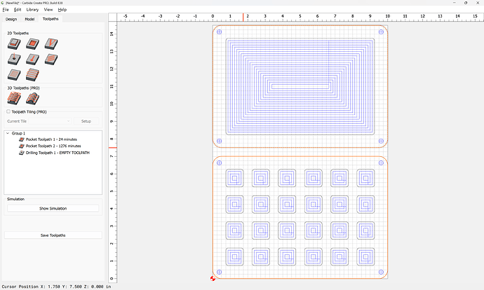

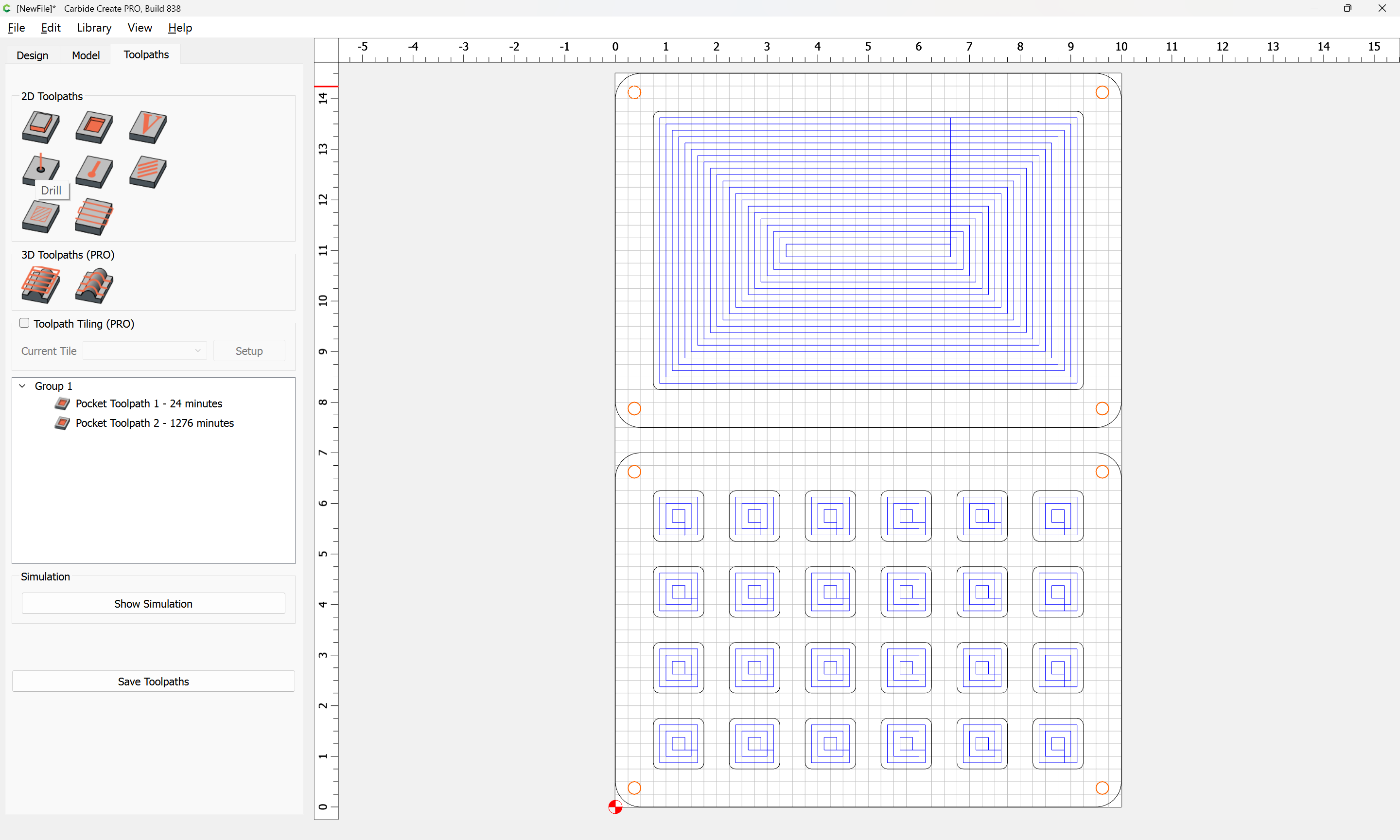

Then do pockets for the paint areas:

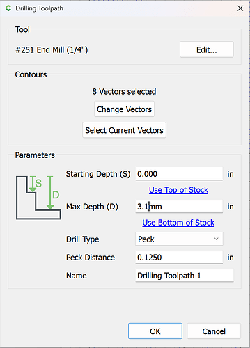

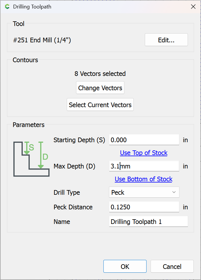

and drill holes for the magnets:
(assuming 1/4" diameter 3mm thick magnets)

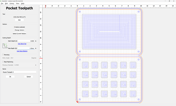

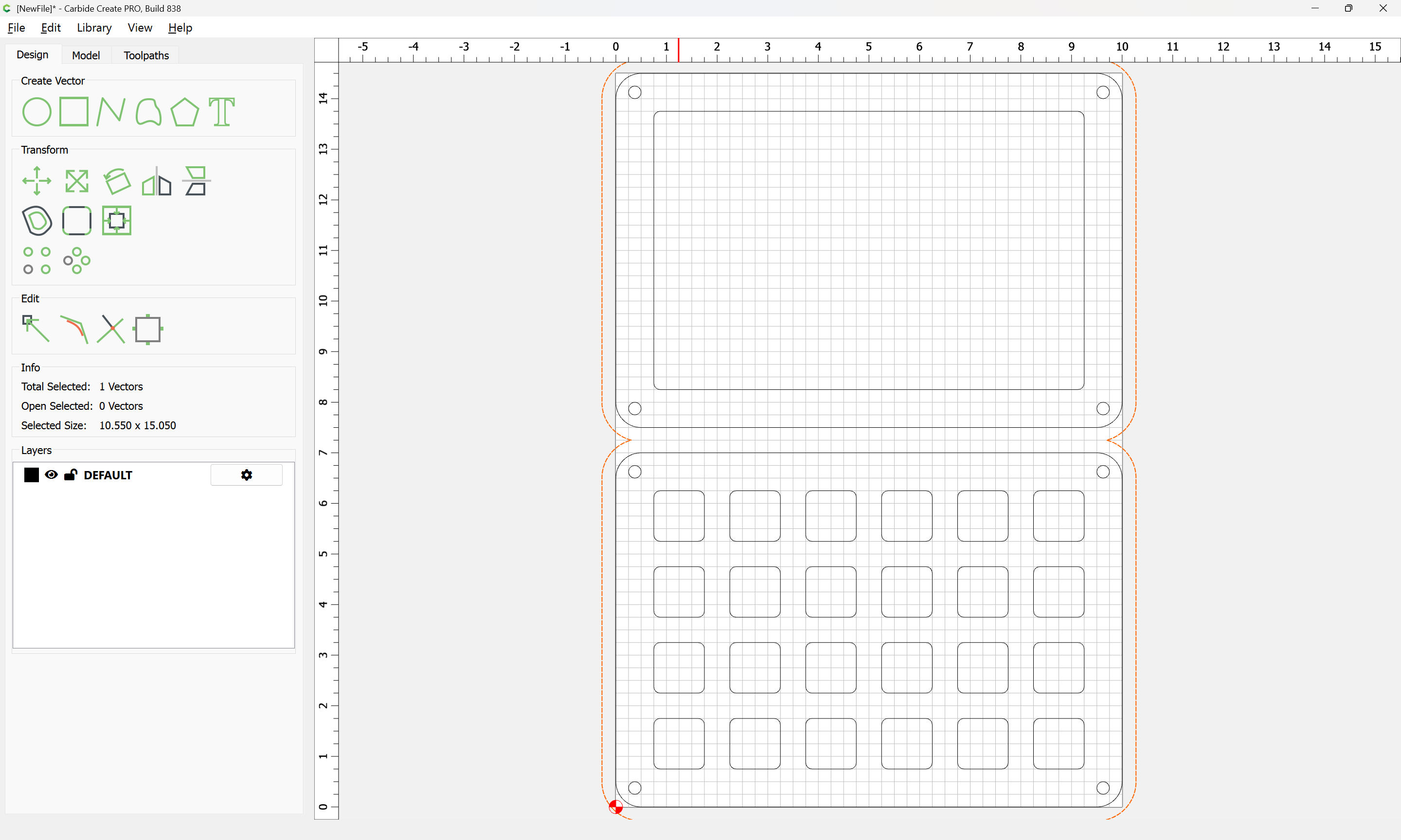

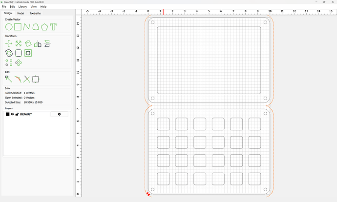

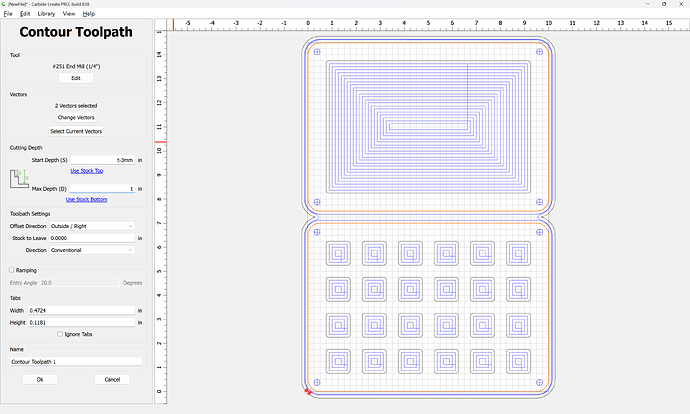

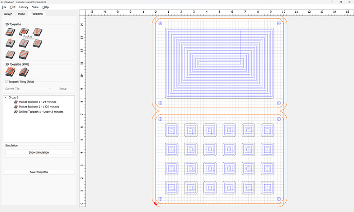

Select the two perimeters:

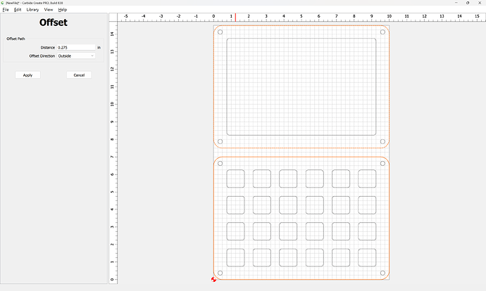

and offset by tool diameter plus 10%:
Apply
and select the offset and the perimeters:
and cut as a pocket down to tab height:

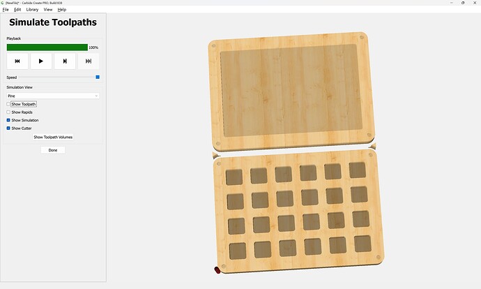

Lastly, select only the perimeters and cut out:
There is actually a common size for watercolor half pans…5/8x3/4 and 3/8 deep.
