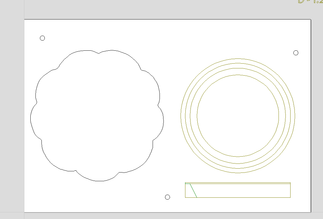

I have done a few flip jobs. Depending on the size of the piece, there are numerous options available.

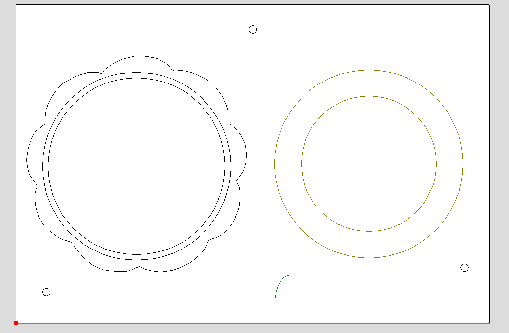

Dowels work great. If you look at the images, you can see the holes for the alignment pins.
Here is a pic of my last double-sided job.
Side One:
Side two:
You need to verify if the flip is bottom to top or left to right.
