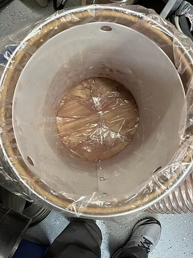

My Oneida Industrial vac has a liner for inside the pail. It’s just a thick (but bendable) plastic sheet that’s rolled just smaller than the diameter of the pail. You put the bag in the pail, followed by the liner. When it’s full, you pull the liner first and then remove the bag with everything in it. It works very well. The only thing to be careful of is taht you need to make sure there are no gaps in the seal on the drum, or the liner will collapse.
Oneida made the insert.
Good idea. I can make something with a thin sheet of plastic instead of wire mesh.
I’ll attach a pic of my liner after I get back into the shop
Actually…even better Here is the Oneida page
They come as a flat sheet and have a line of predrilled holes on the edges…you bolt them together to make the cylinder. Those finger holes on the top are godsends…they make it easy to pull out when the pail is filled with chips.
Found an image of the sleeve in place:
Unlike the way this person pulls the bag over the lip of the pail, I tuck the excess plastic bag in between the liner and the drum wall…so that it stays completely within the pail. That eliminates the chance that I create an air gap on the rim that will crush the insert (don’t ask me how I know that can happen…and how I know this tucking technique stops the problem).

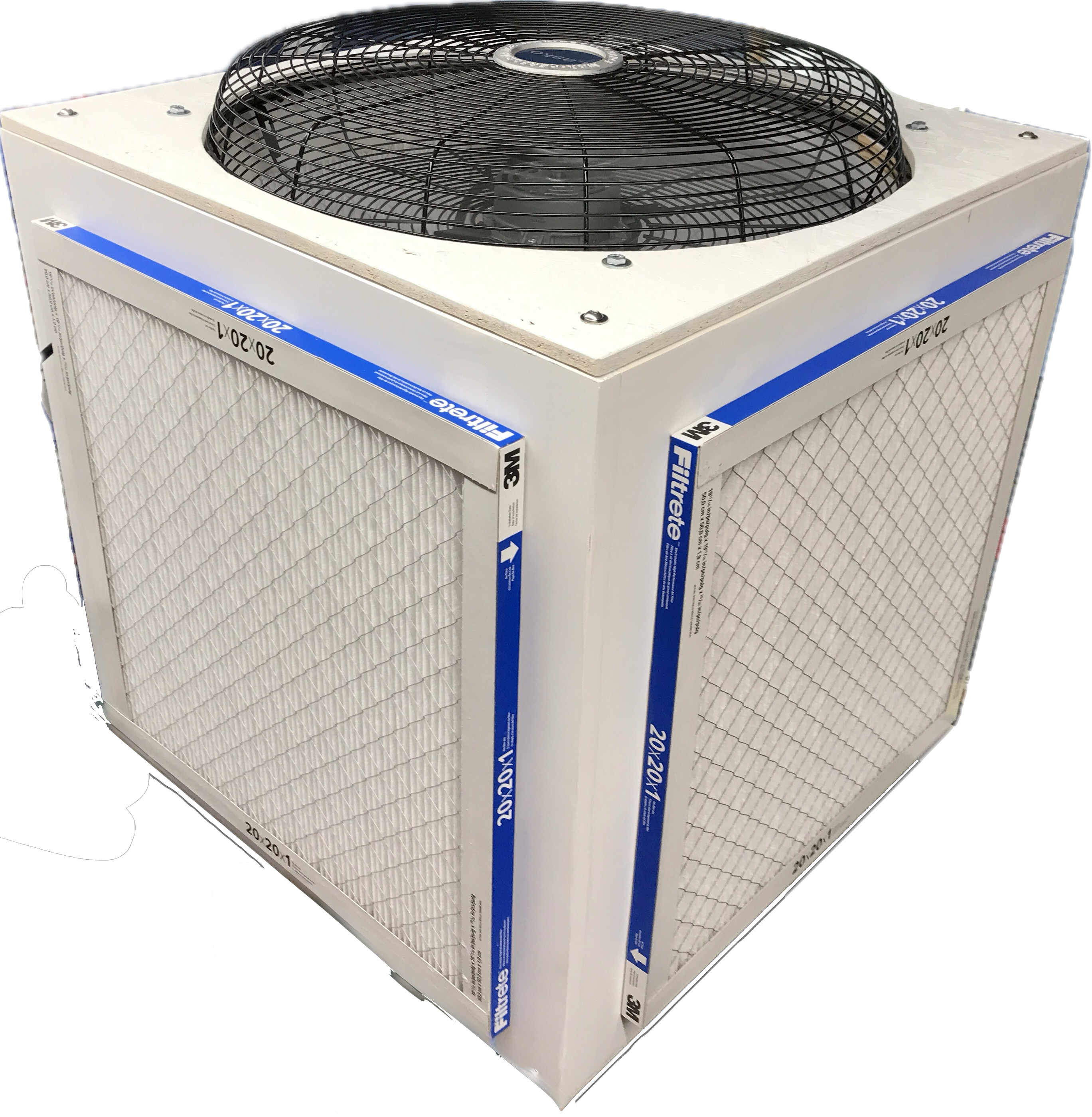

I built this filter to get the floating dust in my workshop. I’ve used my meter to see that it will reduce it to better than outside; very low in 30 minutes. I’ve also added some cheap filters on top of the HEPA filters to use as a pre-filter. I added large casters to the bottom.

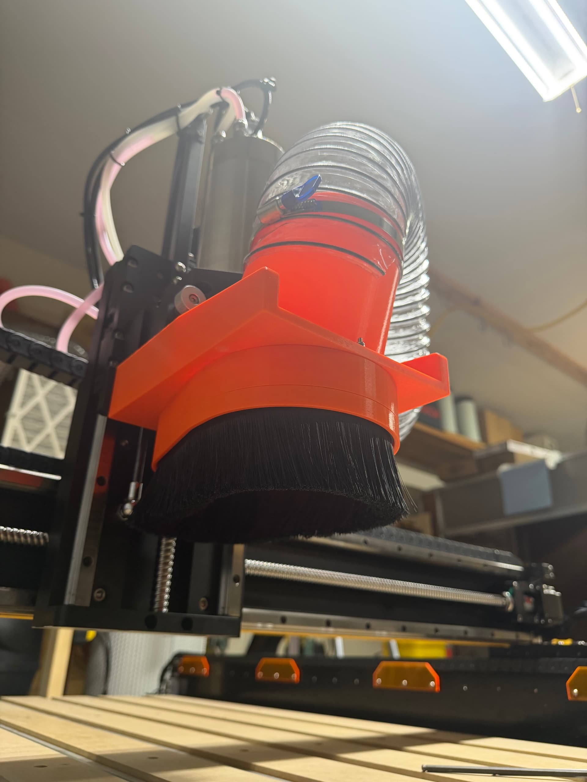

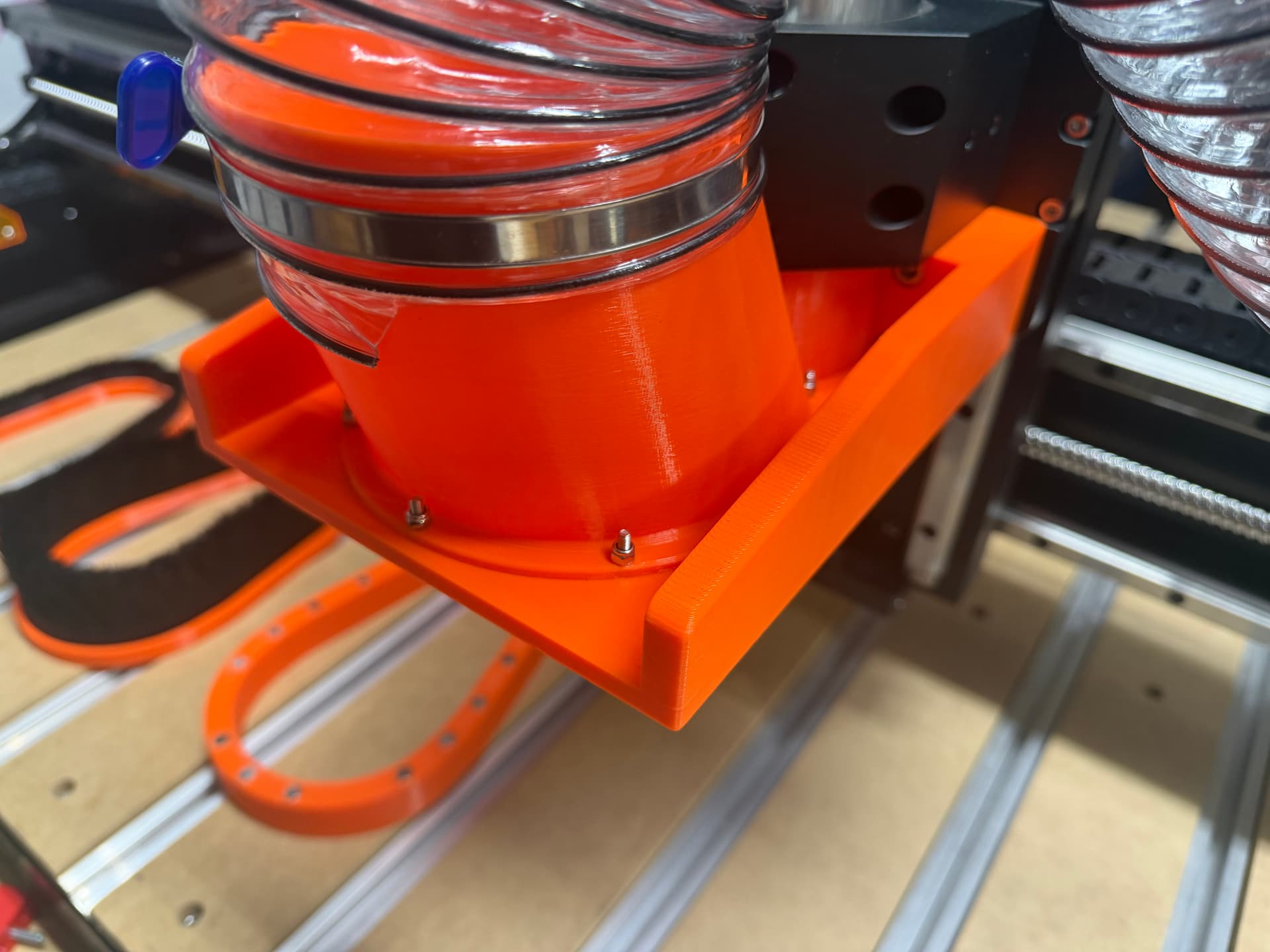

The problem isn’t the dust collector, the issue is the 2.5" hose size. It absolutely kills the suction on a dust collector. I’m in the late stage of a prototype dust shoe that bolts into the holes that the smaller spindle and routers use. I upgraded to the 80mm spindle. I have a project that will turn into production, and I needed more suction for cutting foam. I will make it look better in the future, but it works. I have a few different spacer options. I don’t have time to do a full write up. If someone wants to do the leg work, I will provide them the STL files, BOM, and details.
I also made an reducer that went from a 4" hose to the sweepy, and it does make a huge difference.

I get that. The vacuum doesn’t create enough airflow for my purpose. I also need to run it for hours a day, every day. Even though a vacuum, and a dust collector perform the same function, the systems need to be engineered differently. Vacuums tolerate smaller hoses well, dust collectors don’t. For those that have used both it is understood. I had never worked with a dust collector, but I know I needed a high volume flow.
I originally had a 4" to 2.5" reducer at the cyclone, with 20’ of 2.5" hose going into the Sweepy. I made a custom 4" to 2.5" reducer, and ran the 30’ of 4" hose to the sweepy and reduced it at the sweepy. I got a 30% increase in suction. With the 4" dust shoe I doubled the performance over the Sweepy. At some point, I will add a 5’ section of smooth pipe in the overhead swing arm I made, and that will get me some additional flow. With a vacuum, none of that seemed to matter.
For most folks it won’t matter. I am machining foam, and it makes a big difference for me.
