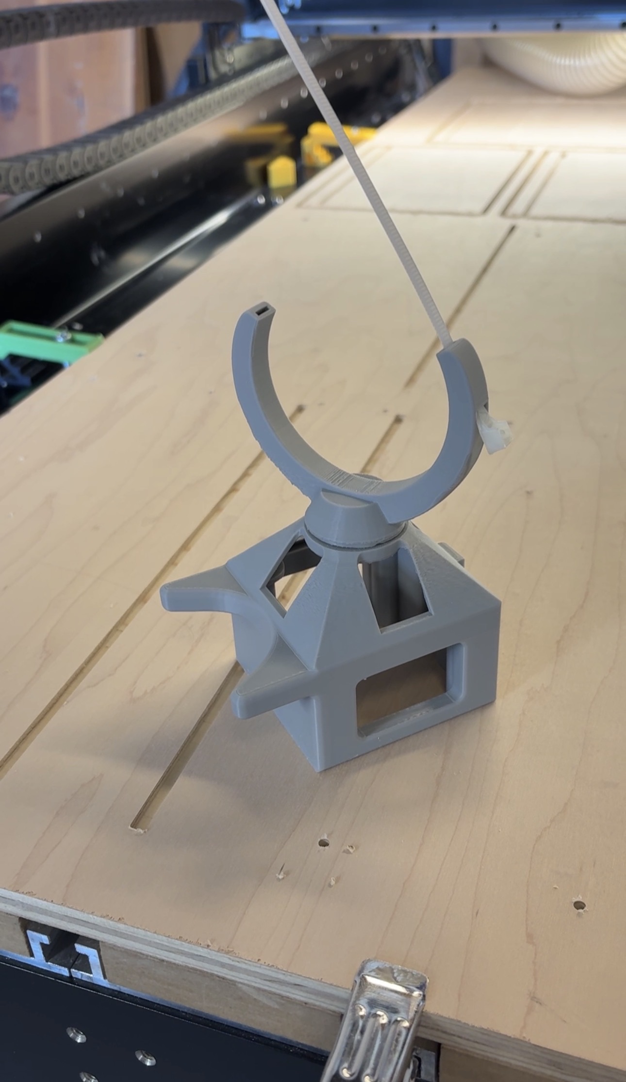

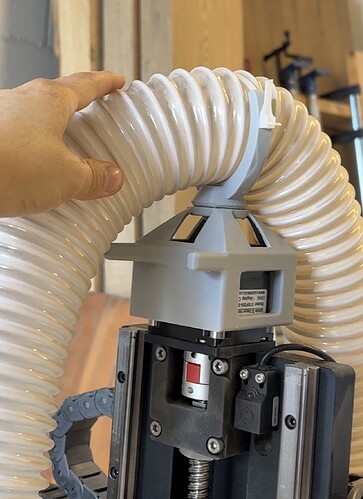

I was really inspired by the folks that 3D printed their own models for hose mounts for dust collection, especially a user called FarOutRide’s design with the rotating mount.

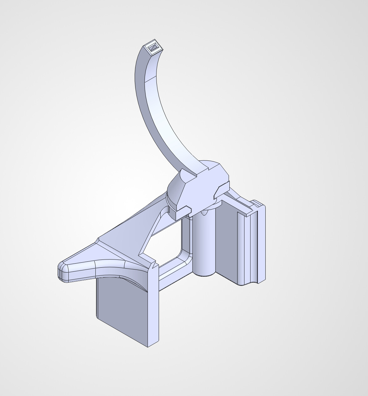

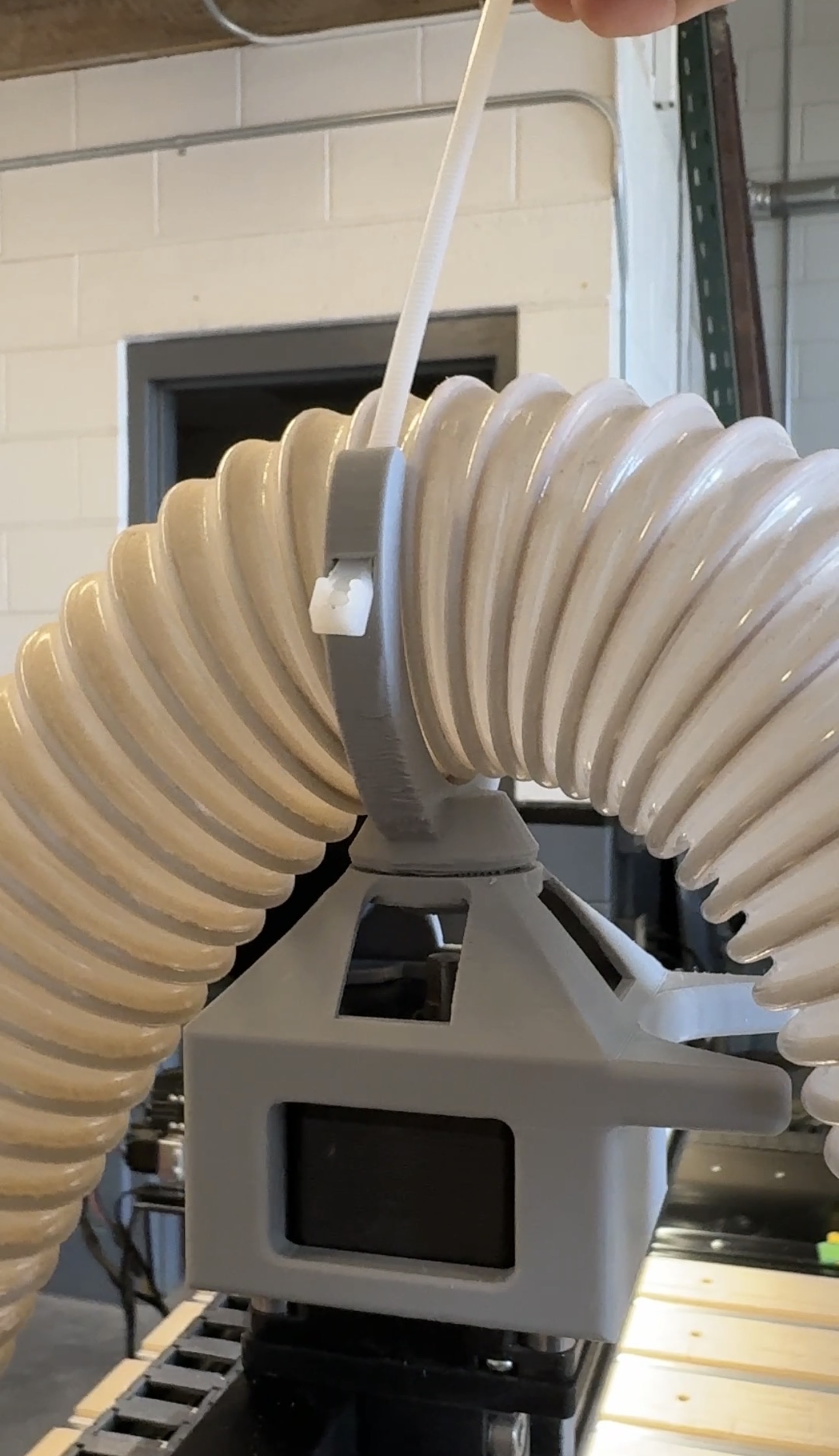

Just wanted to share what I came up with thanks to all your tips and tricks. I’m really excited because I was able to print-in-place, so no additional fasteners for the rotation.
I haven’t had it on for long so we’ll see how it holds up over time, but I’m hopeful as I used Bambu Labs Tough Filament. Fingers crossed!

Looks good, Andy! Print-in-place is something I haven’t tried yet. I’d just keep an eye out for PLA softening at the typical almost-too-hot-to-touch stepper motor temperatures. I know on the dashboard of my car I’ve had PLA parts warp…
Hey Randy, totally understand that concern. I actually ran a very similar model for the last few months about 12-16 hours a week with no issue thankfully so I feel confident in it!
Cool, I appreciate your experience and will keep it in mind (given that I have a lot more PLA than PETG) though I am currently playing with PETG-GF for outdoor (bicycle) parts.
