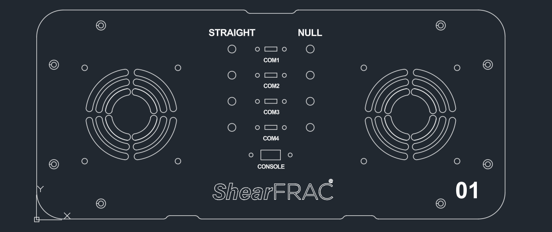

I was sent this dwg. I’ve opened it in Autocad, exported as a 2013 dxf but when I try to import it into carbide create i am missing elements and some of the features are different.

Autocad view
Carbide Create 813 View
Do I need to modify elements in the dxf? Hoping @WillAdams can teach me what I’m doing wrong here :slight_smile:
The DXF is getting saved as an assembly. The components don’t import.
Also, the lettering that’s missing is Note objects in the DXF. I’m guessing CC doesn’t like these either.

yes how did you make that one? I typically use inkscape but the dxf is giving me issues in that as well.
oh interesting, i had no idea about the assembly thing. I will need to look into how to flatten it or something.
