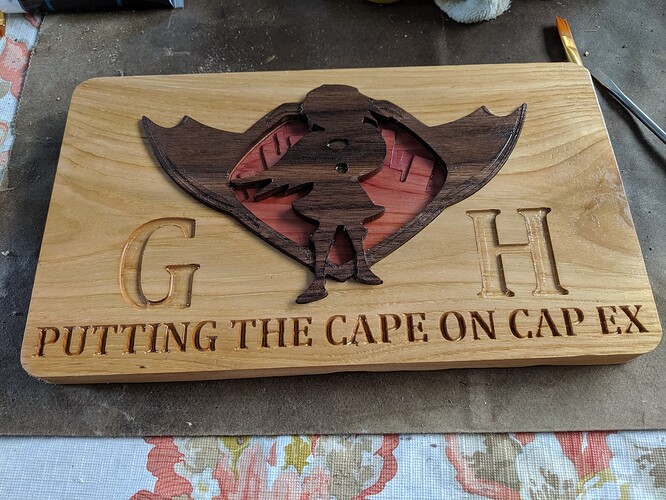

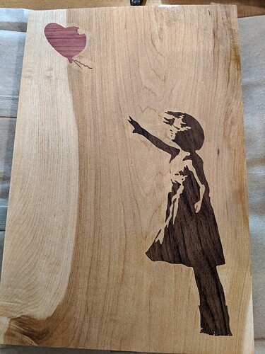

but there’s sort of 3 worlds of CNC cutting… and I’ll add some example cuts I did to show the differences
  1. “cutting things out” aka 2D – basically you cut shapes out of sheets and assemble into things
    (I’ll admit to not doing much of this)
  2. 2 1/2D multiple 2D layers in a design, V carves etc. I do this a lot and this things like signs, name plates, putting artistic things into other woodworking etc. Carbide Create outright shines here and frankly, this isn’t where I see Fusion 360 be at its strongest.
  3. Full 3D designs – this is where Fusion 360 is at home – not saying Carbide Create Pro can’t do anything here… but CCPro is more at home in a “2 1/2 D with bits of 3D stuff” world. You can do the toolpaths straight in Fusion 360 but from 3D printing, you need to change your brain to thinking “subtractive” instead of “additive”…
    (cut on a Shapeoko HDM which is a beast)
