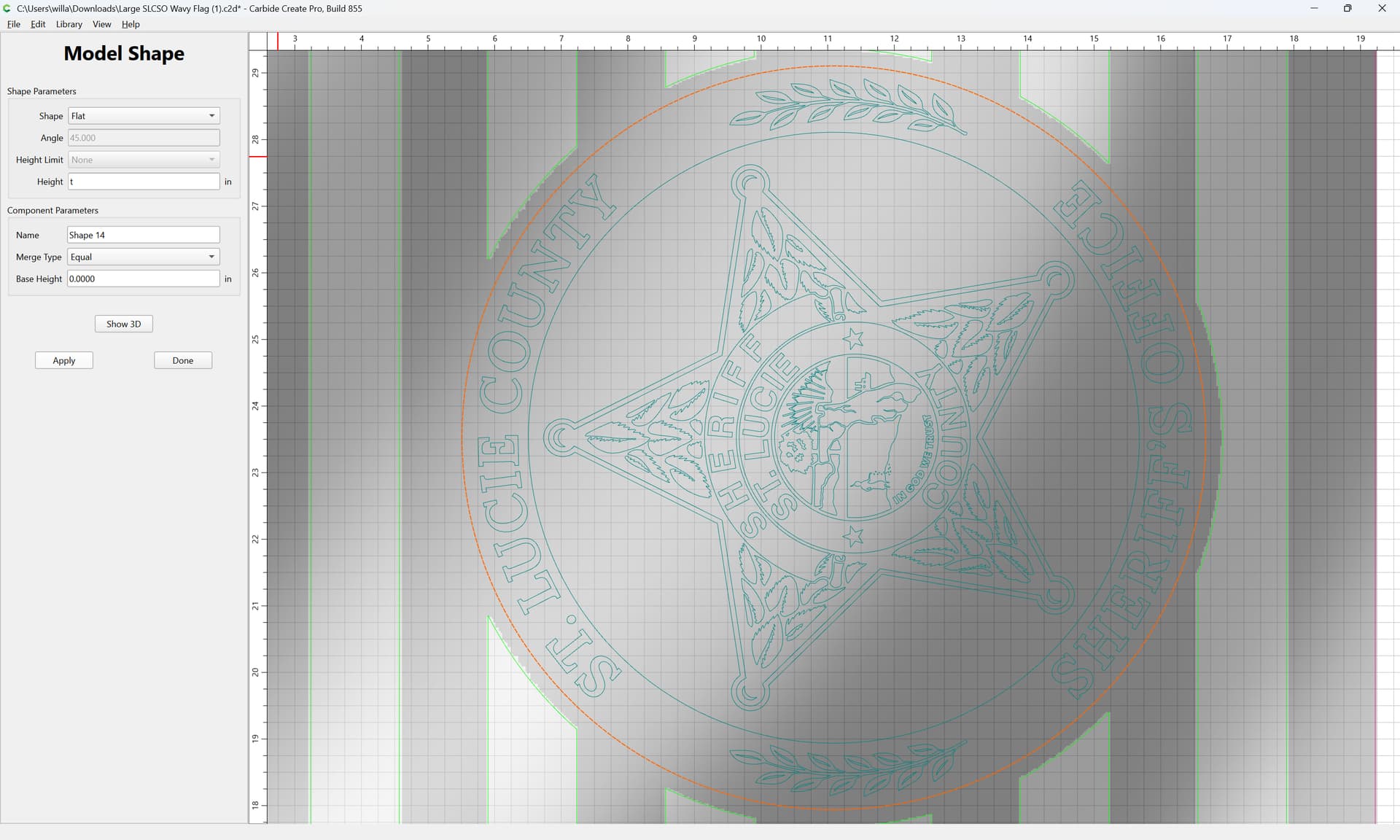

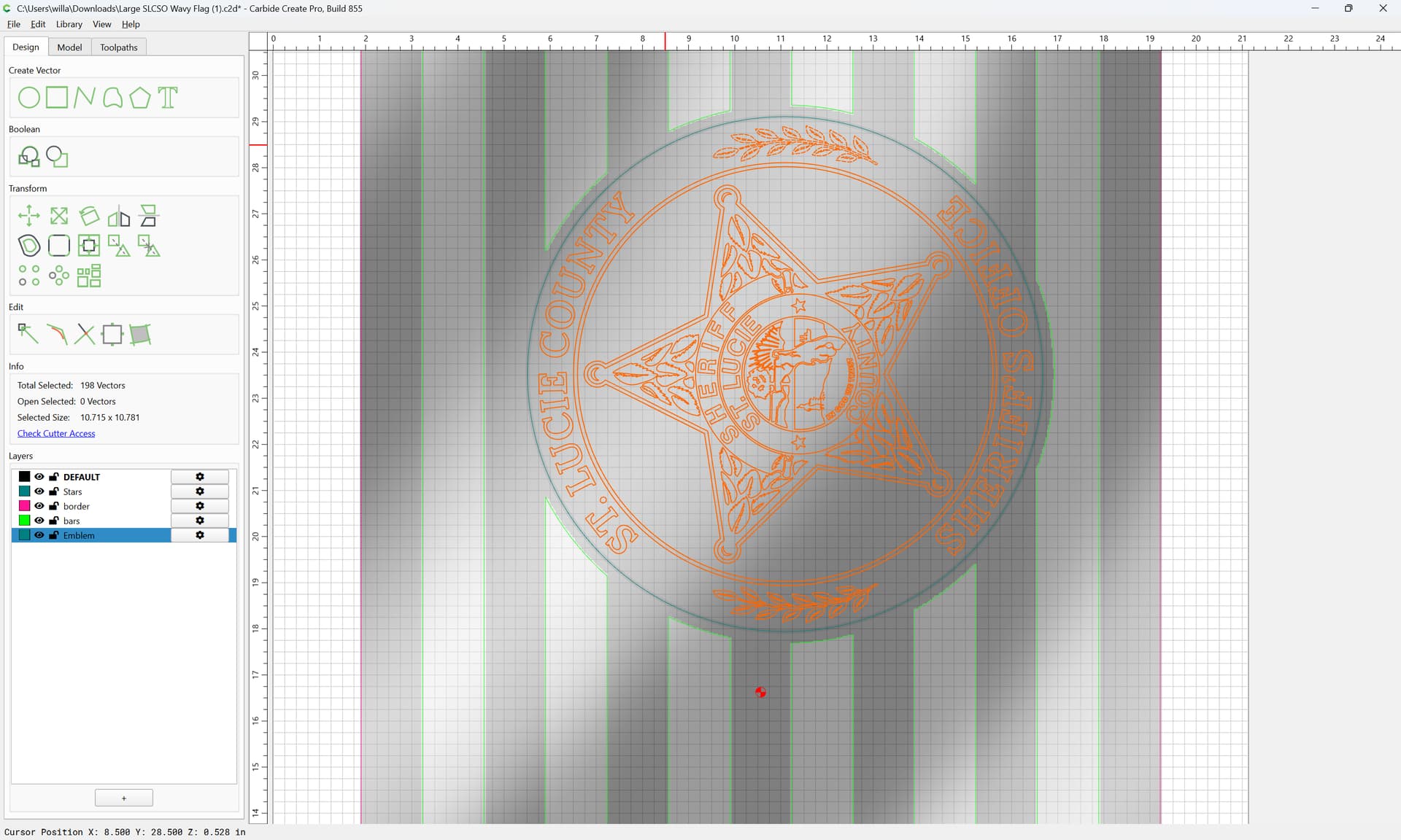

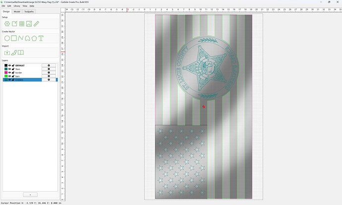

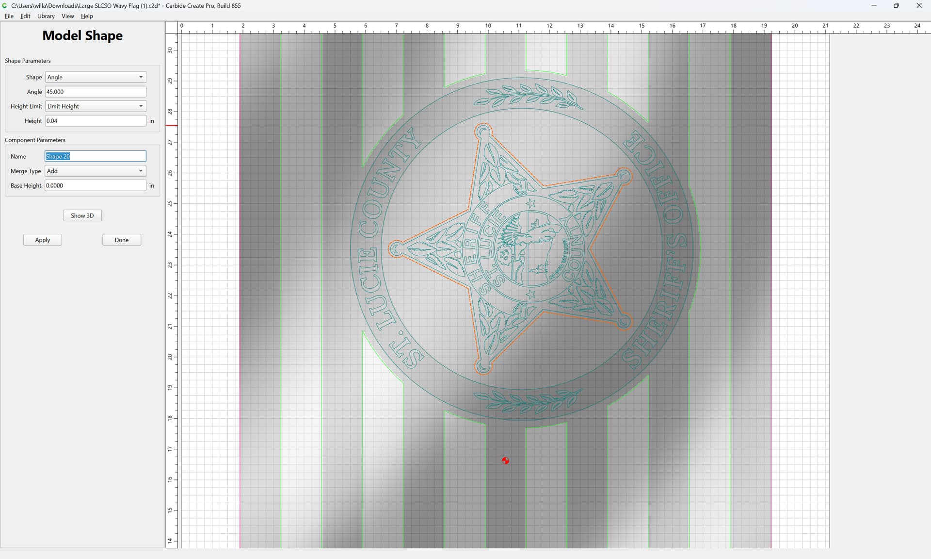

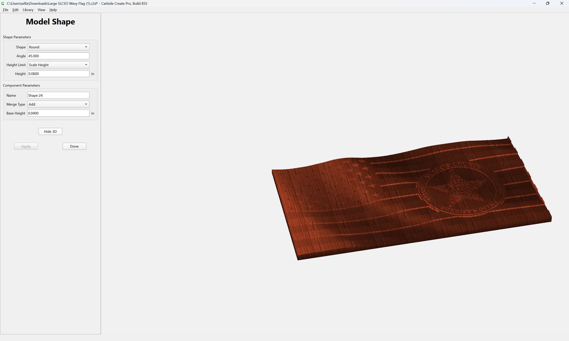

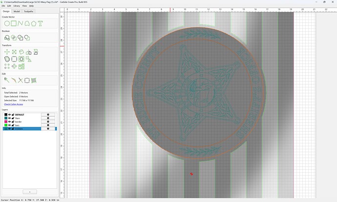

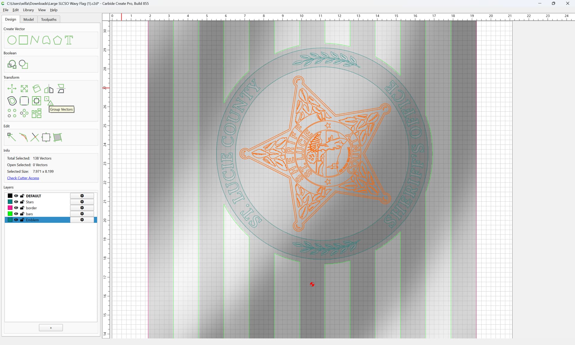

as requested on support…

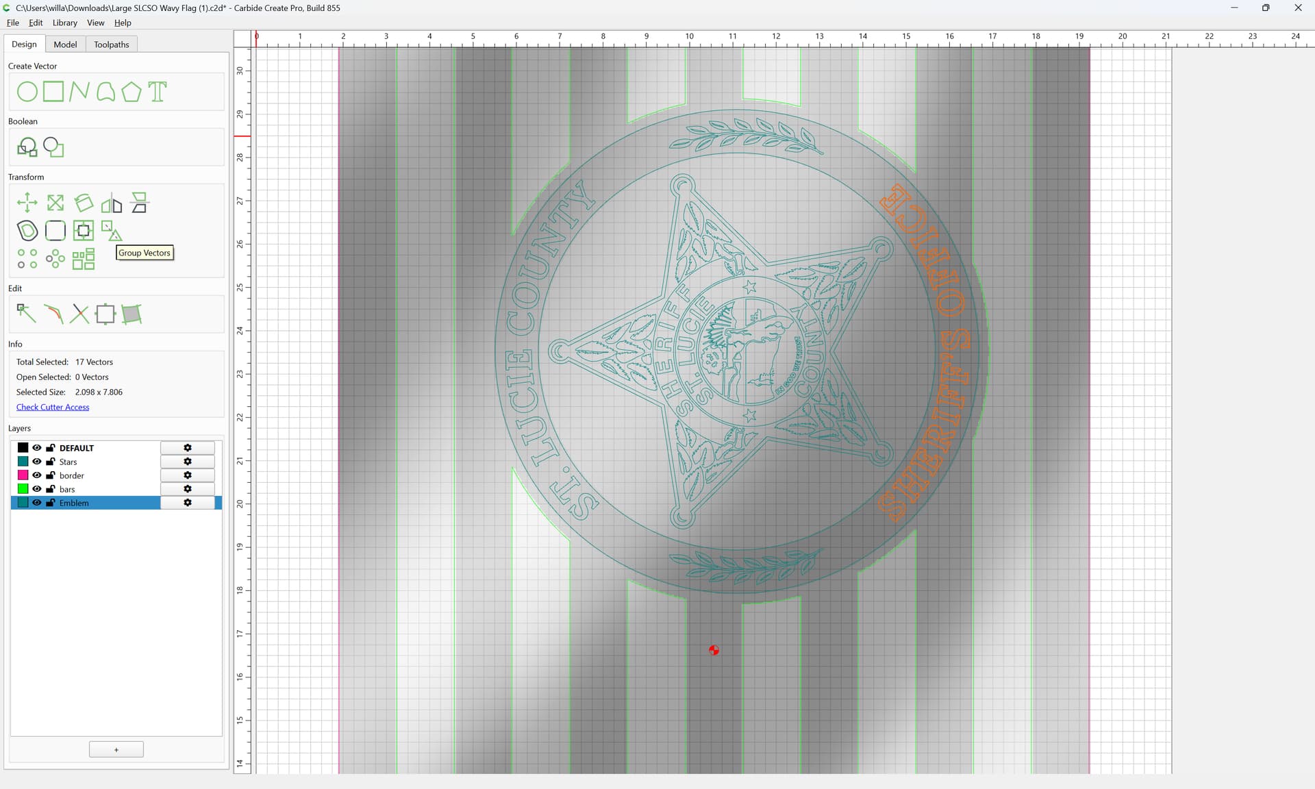

need a bit of help getting the emblem correct.
where the current state is:

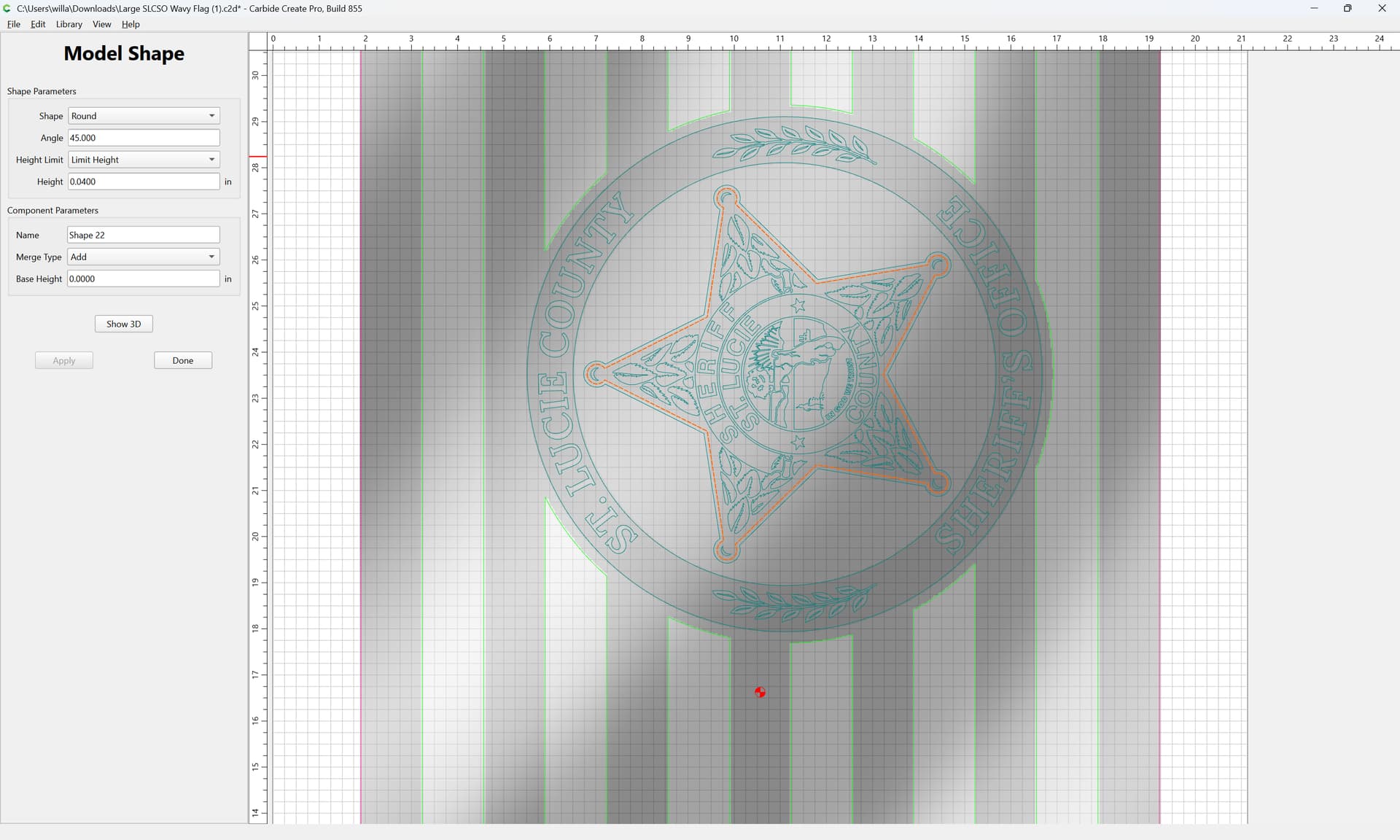

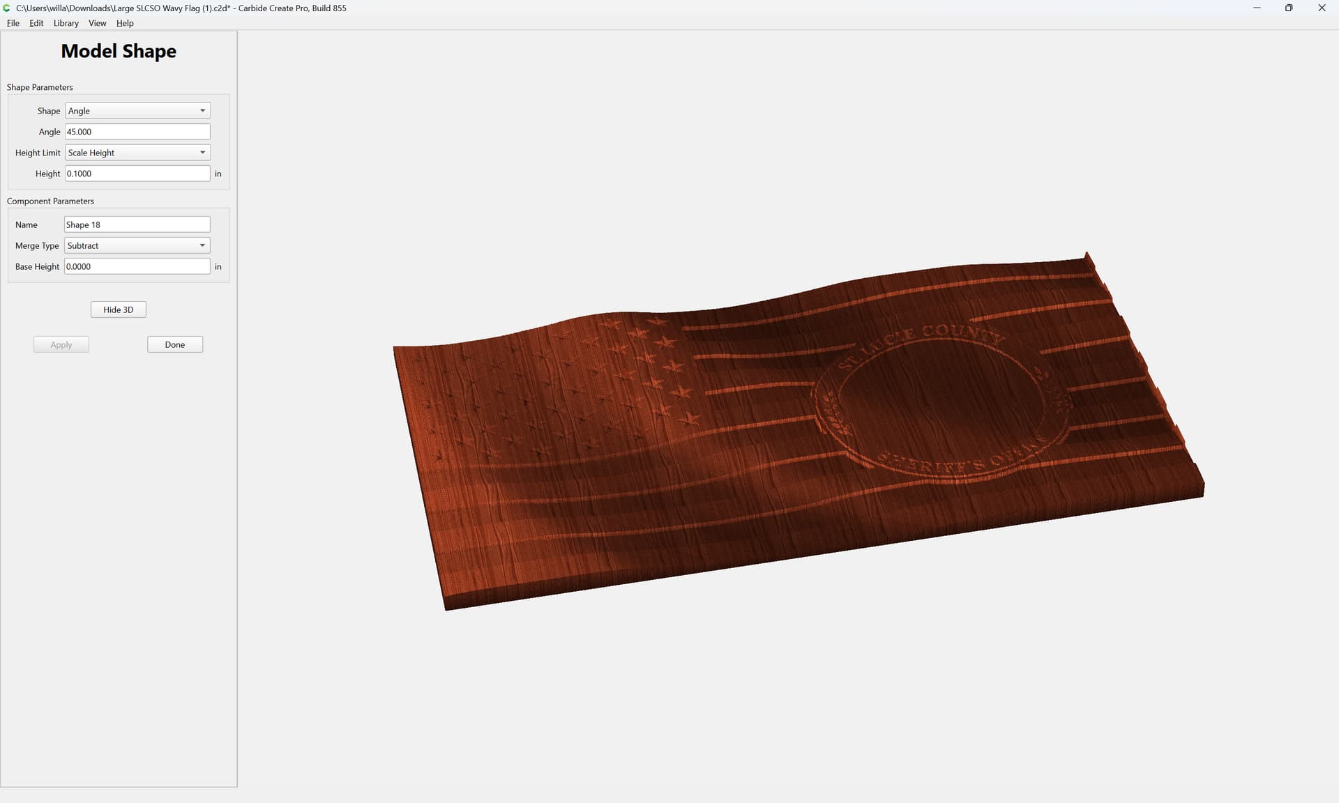

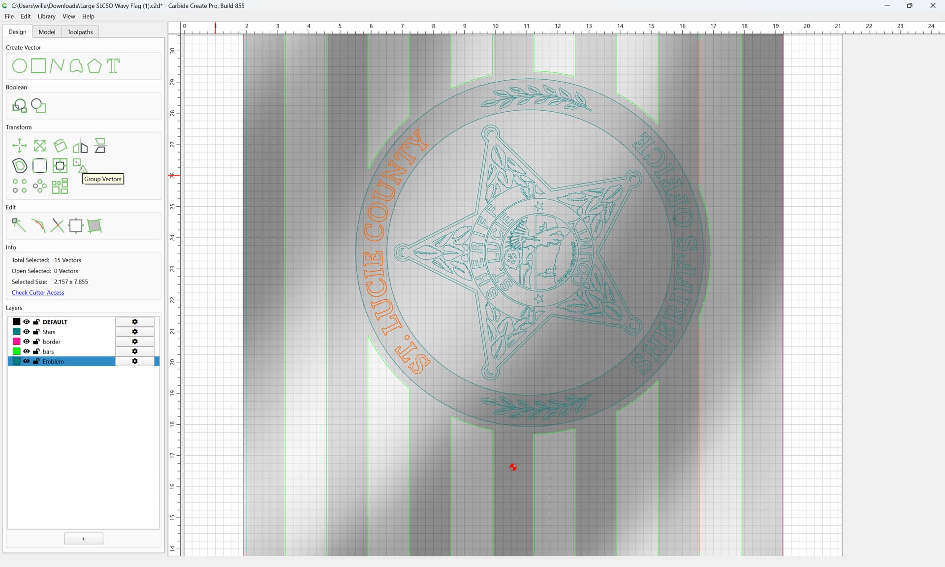

The drawn geometry runs into the classic arts problem, “figure-ground reversal” and there are three notable approaches which will be examined here:
drawing in geometry so as to adjust the nature of the design so that it may be subtracted en masse
Sub-dividing the emblem and selecting portions of it and applying different treatments to the various design aspects
causing the 3D design where the emblem is to appear to be flat and level and just doing a traditional V-carving
WillAdams
(William Adams (Carbide 3D))
August 23, 2026, 4:30pm
2

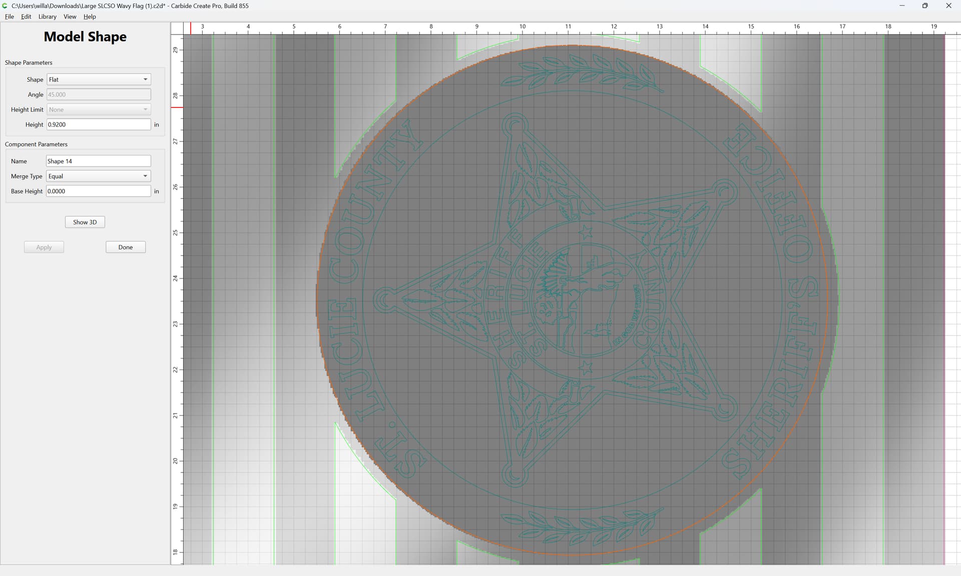

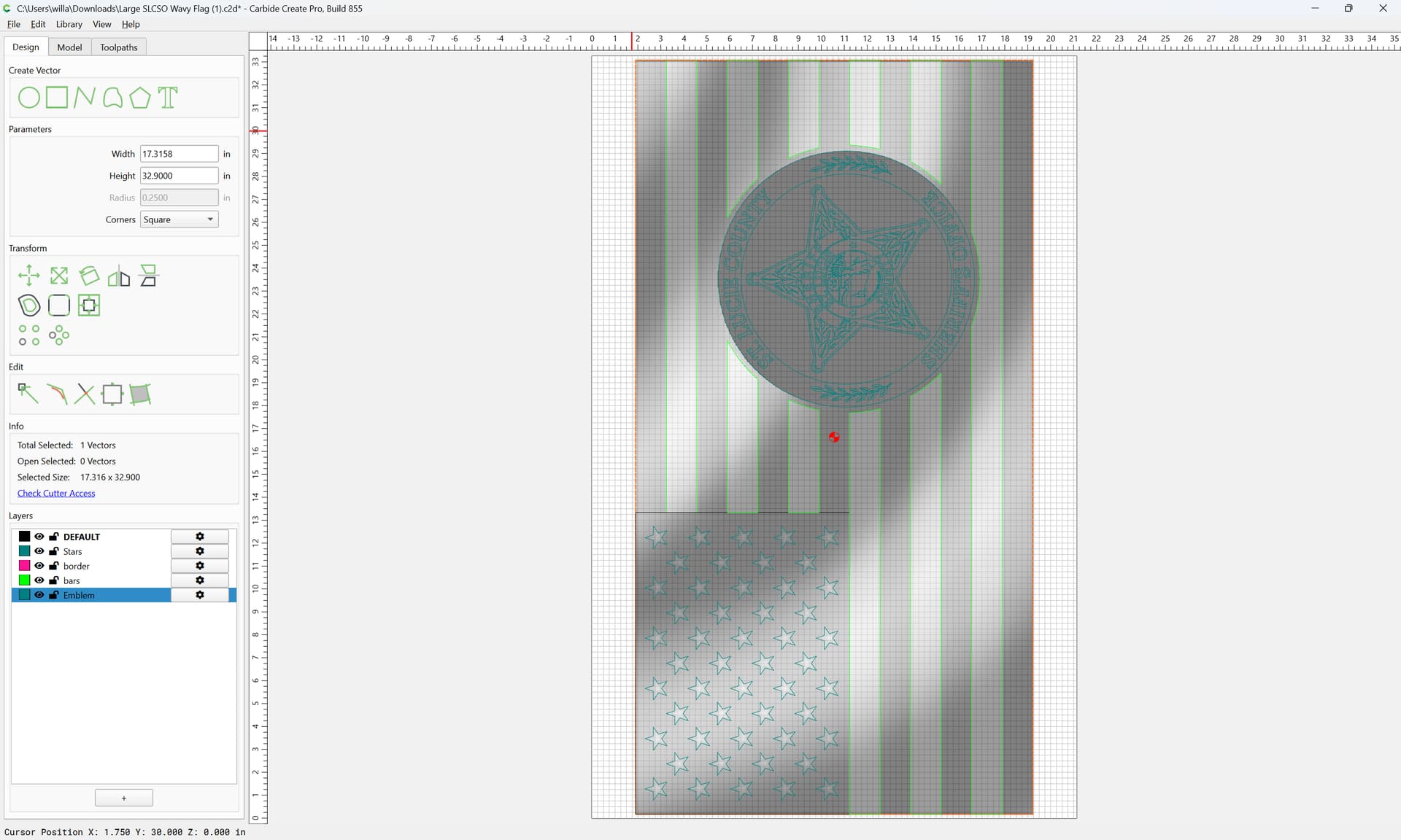

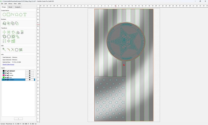

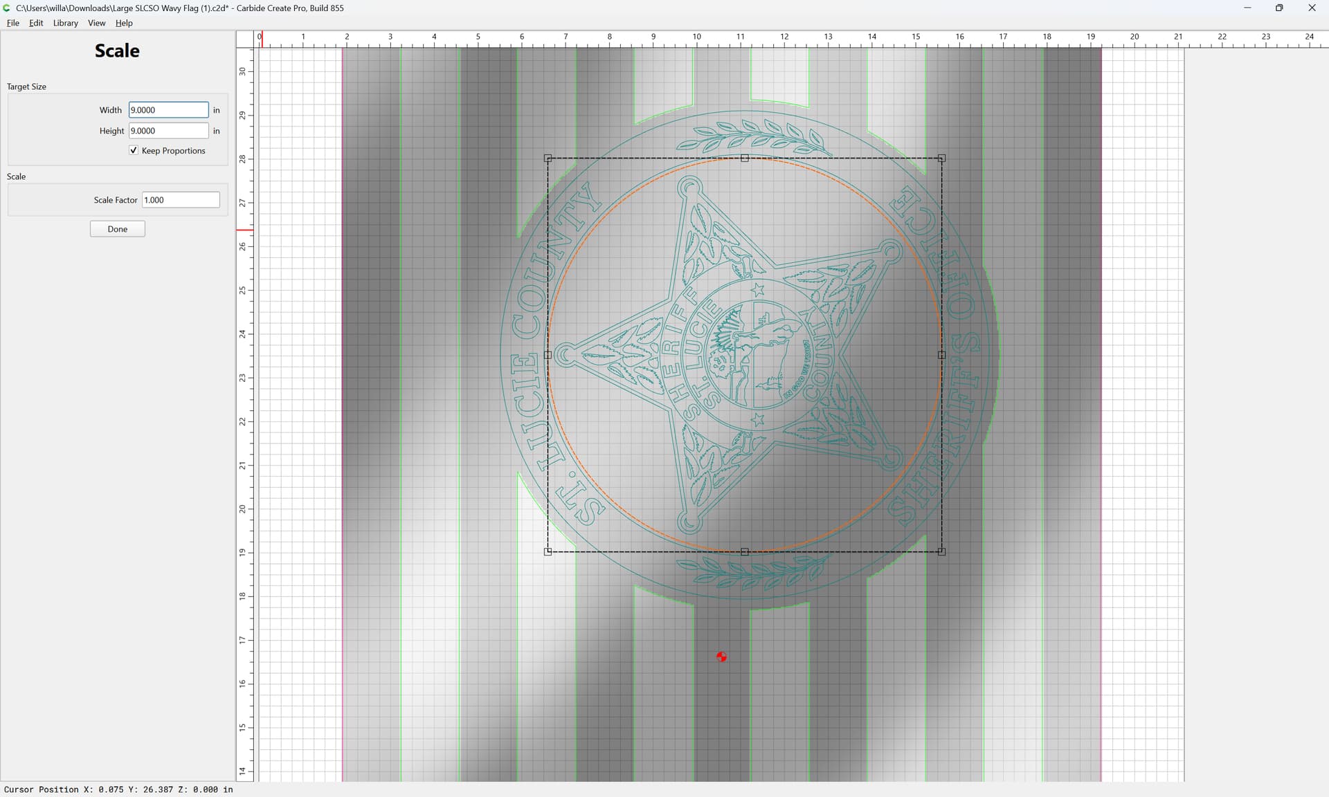

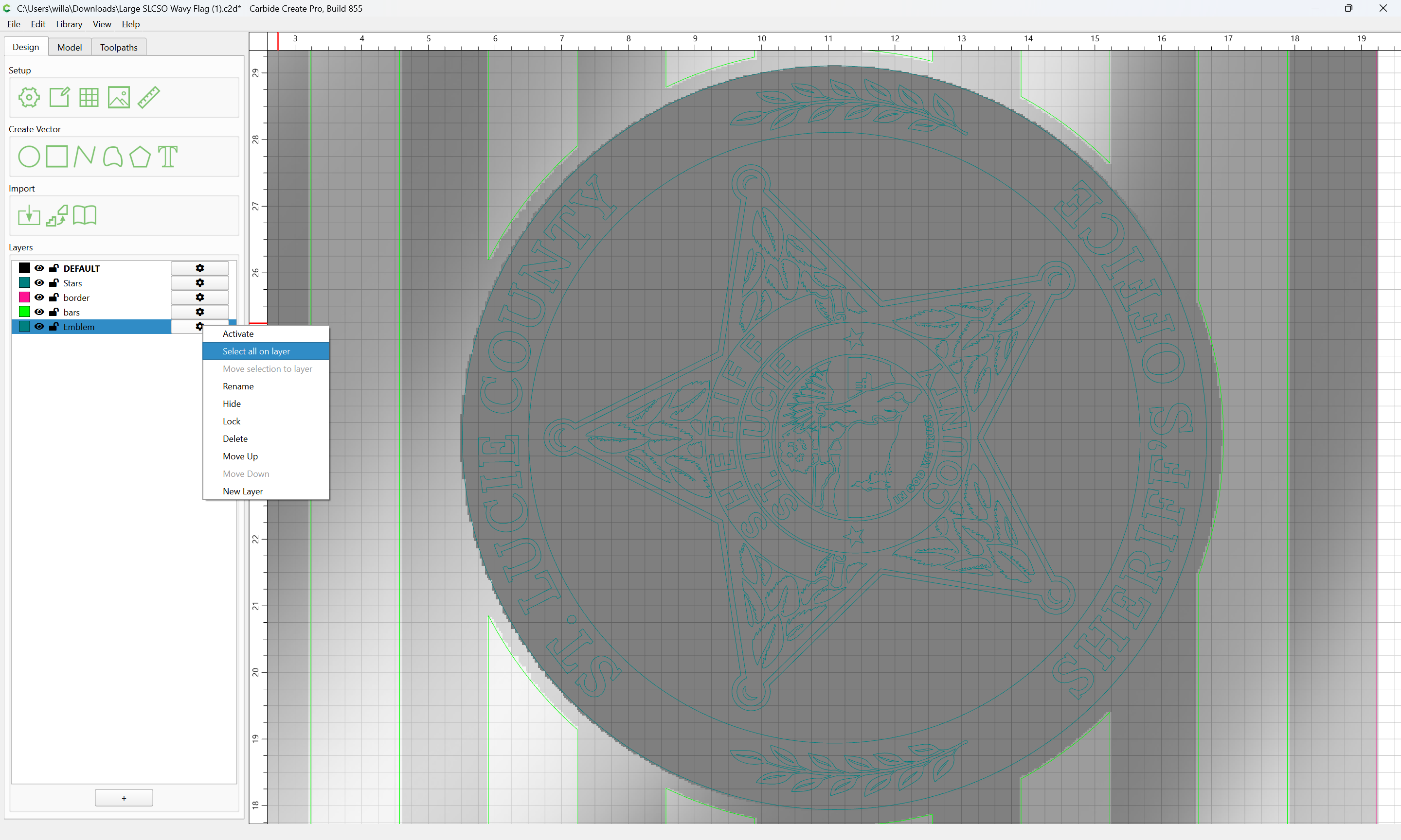

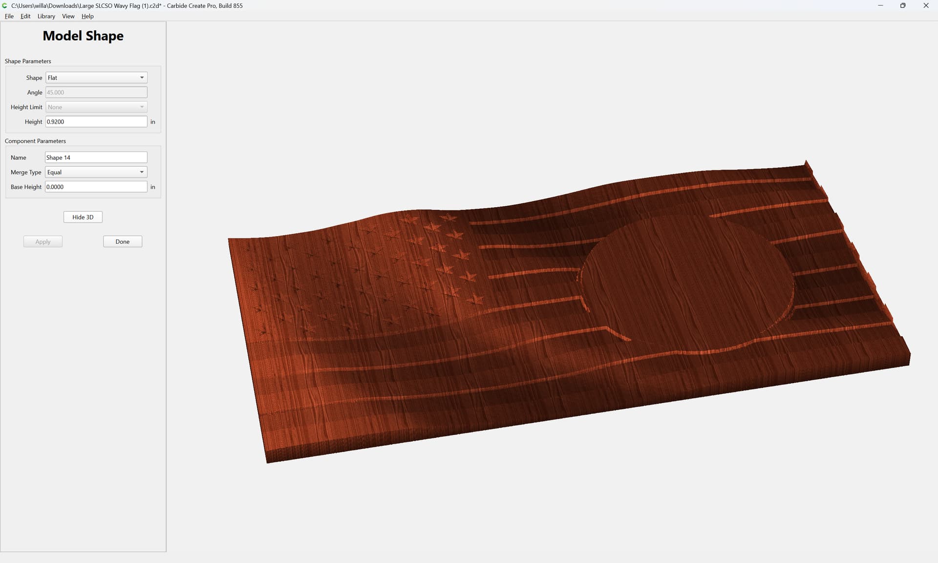

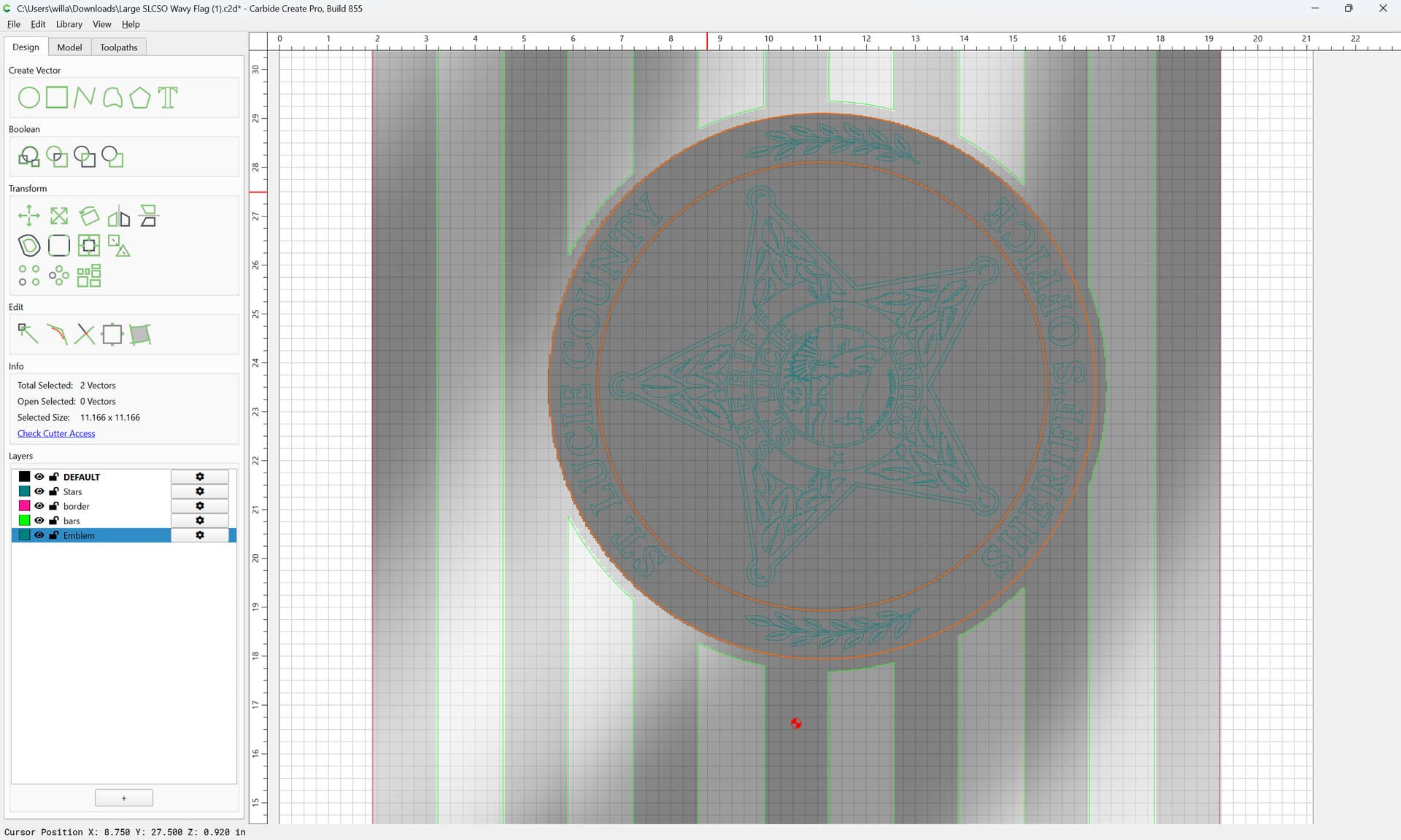

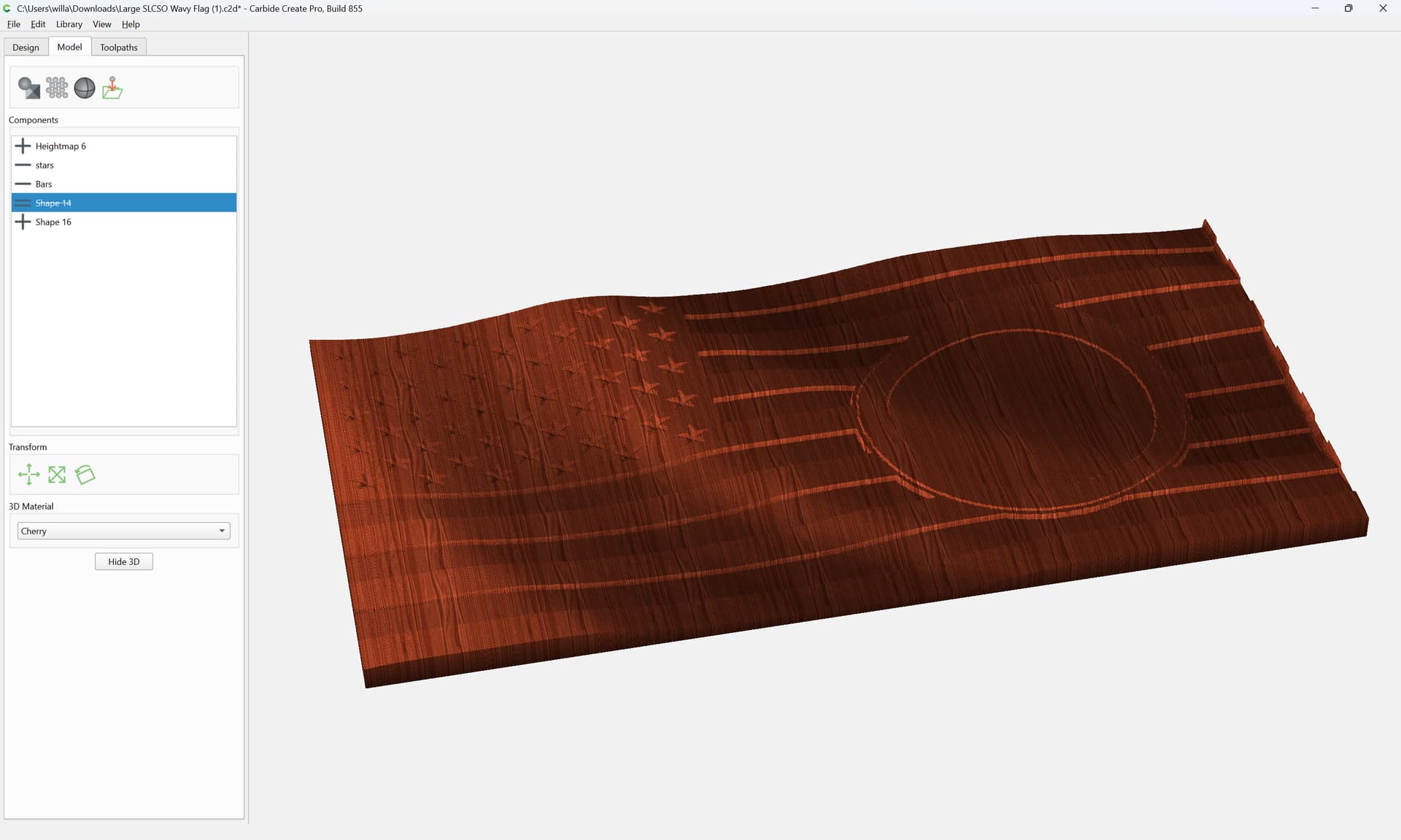

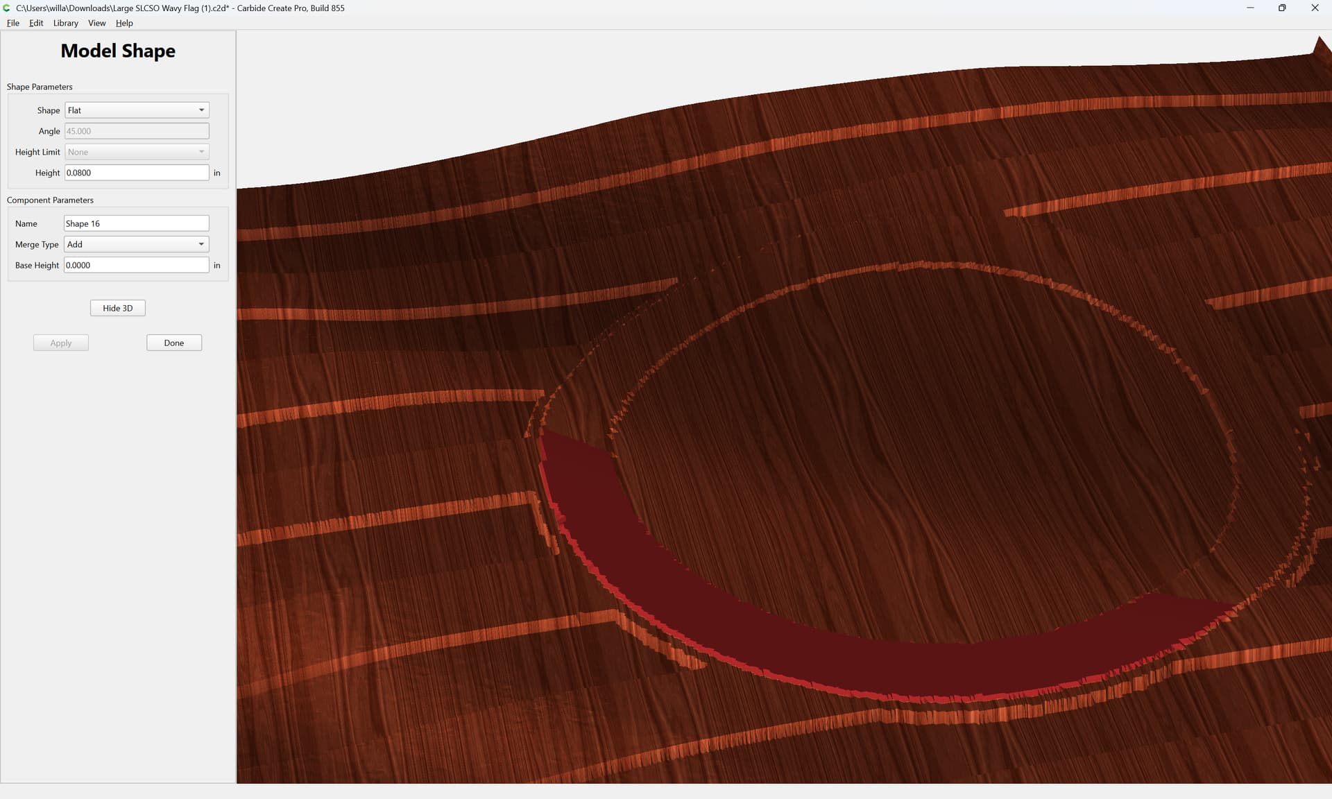

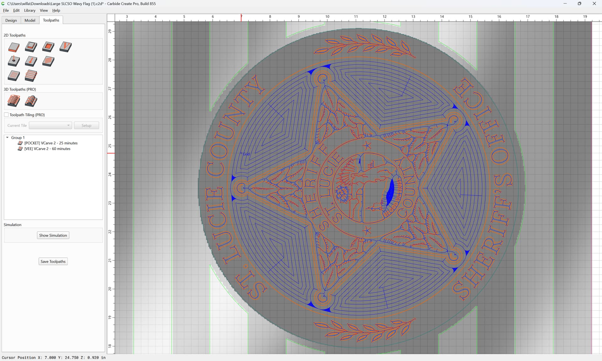

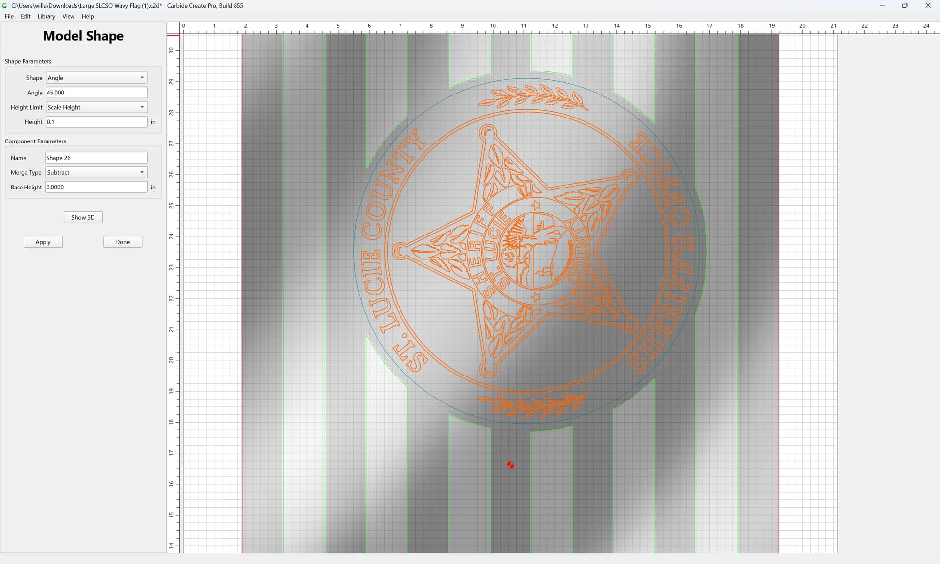

The easiest approach is to simply force the central round area to be flat:
Apply
and then apply a V-carving to everything on the emblem layer:
except for the perimeter which we shift-click to remove from the selection:

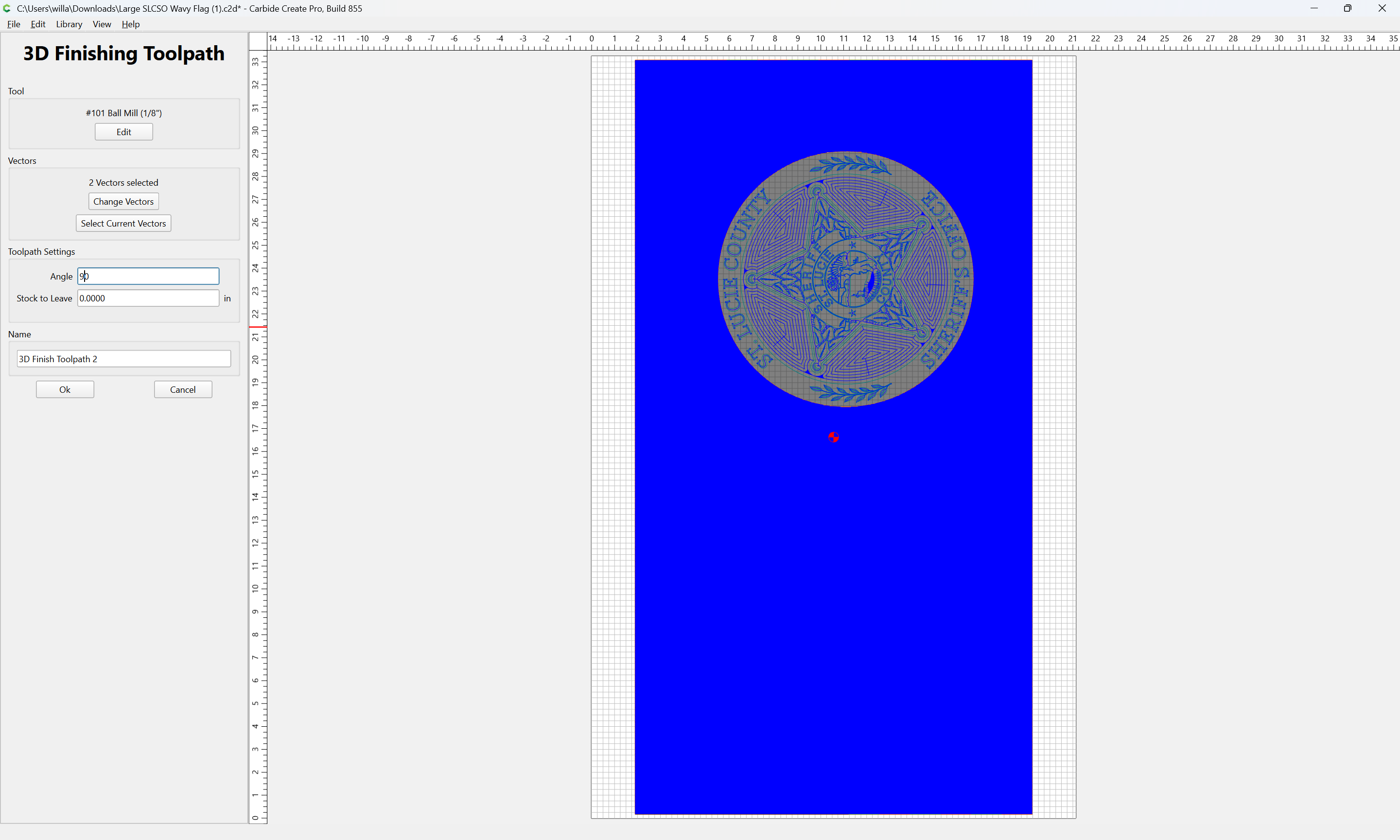

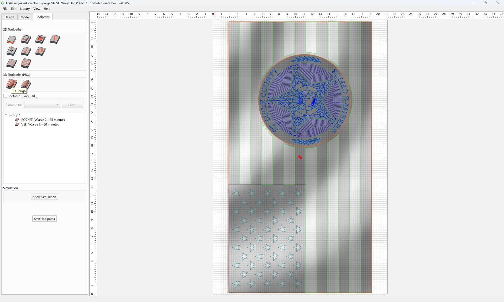

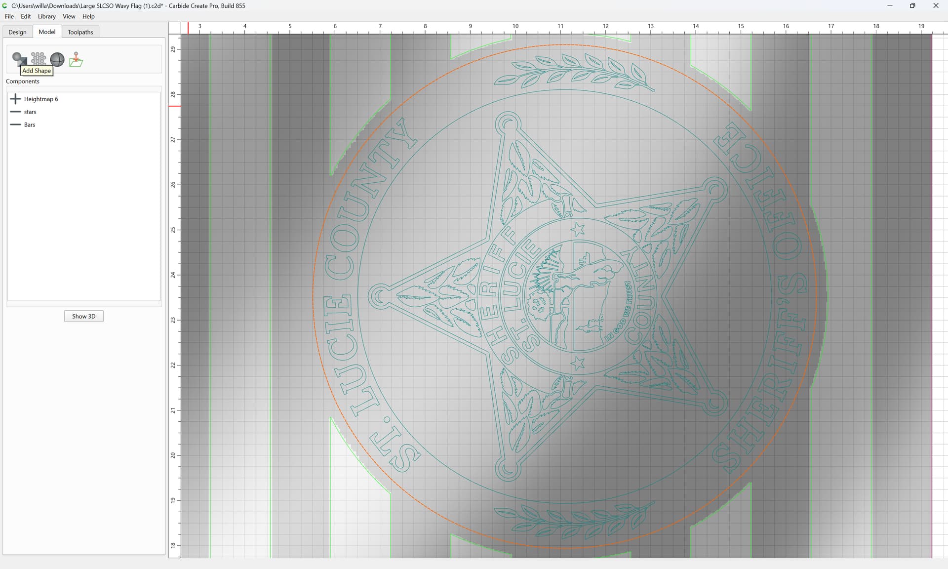

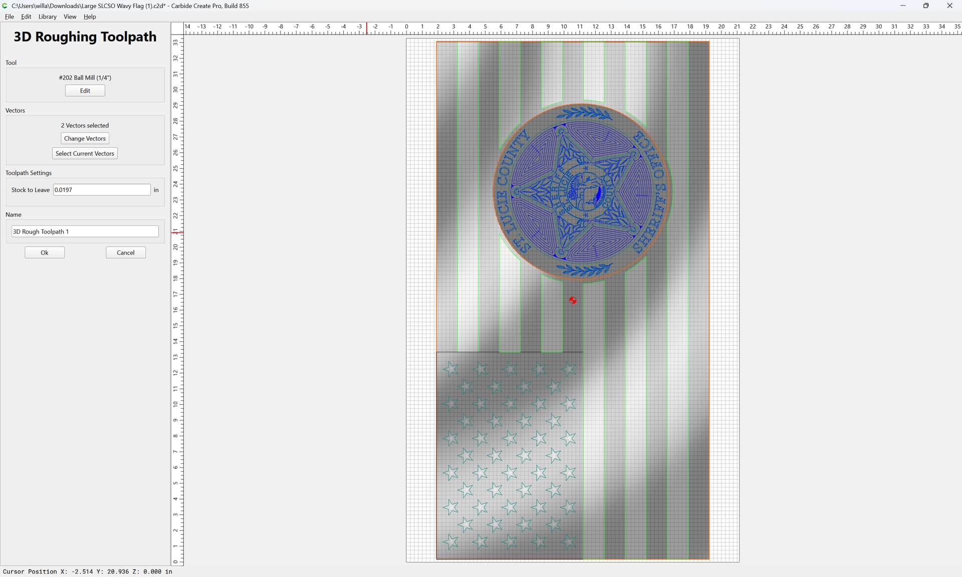

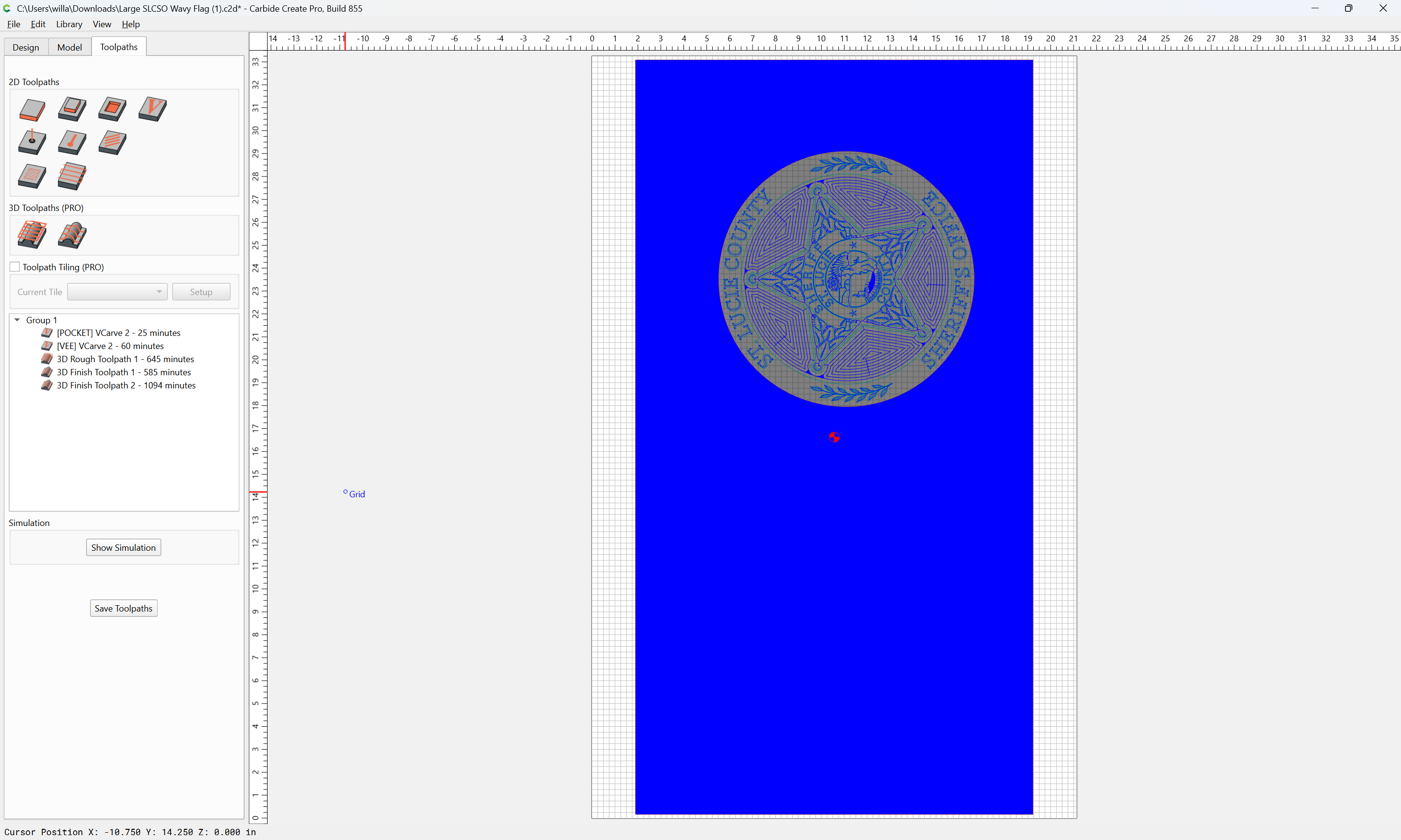

The balance of the design is of course 3D toolpaths:

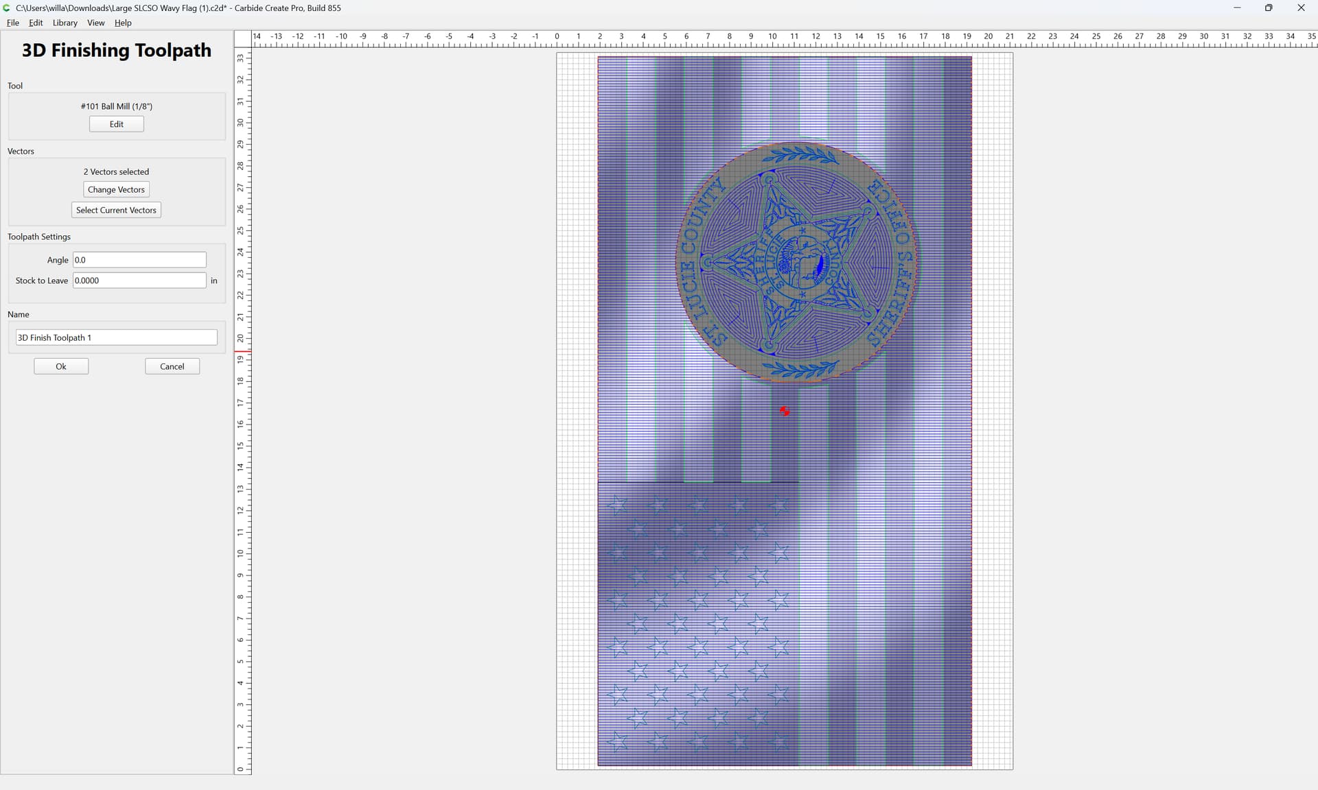

So select the perimeter circle and some piece of geometry which defines the surrounding design:
(note that the outer perimeter may need to be offset to the outside)
and if desired, a second 3D Finishing toolpath along the grain:
WillAdams
August 23, 2026, 5:39pm
3

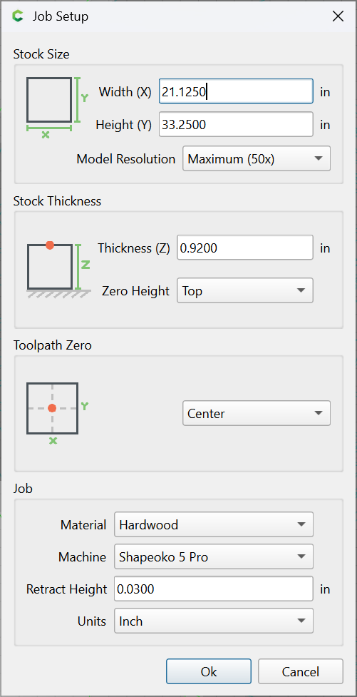

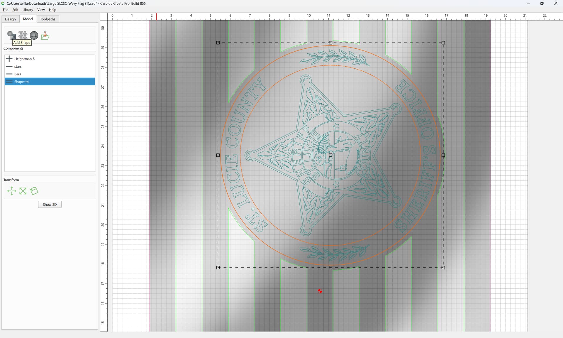

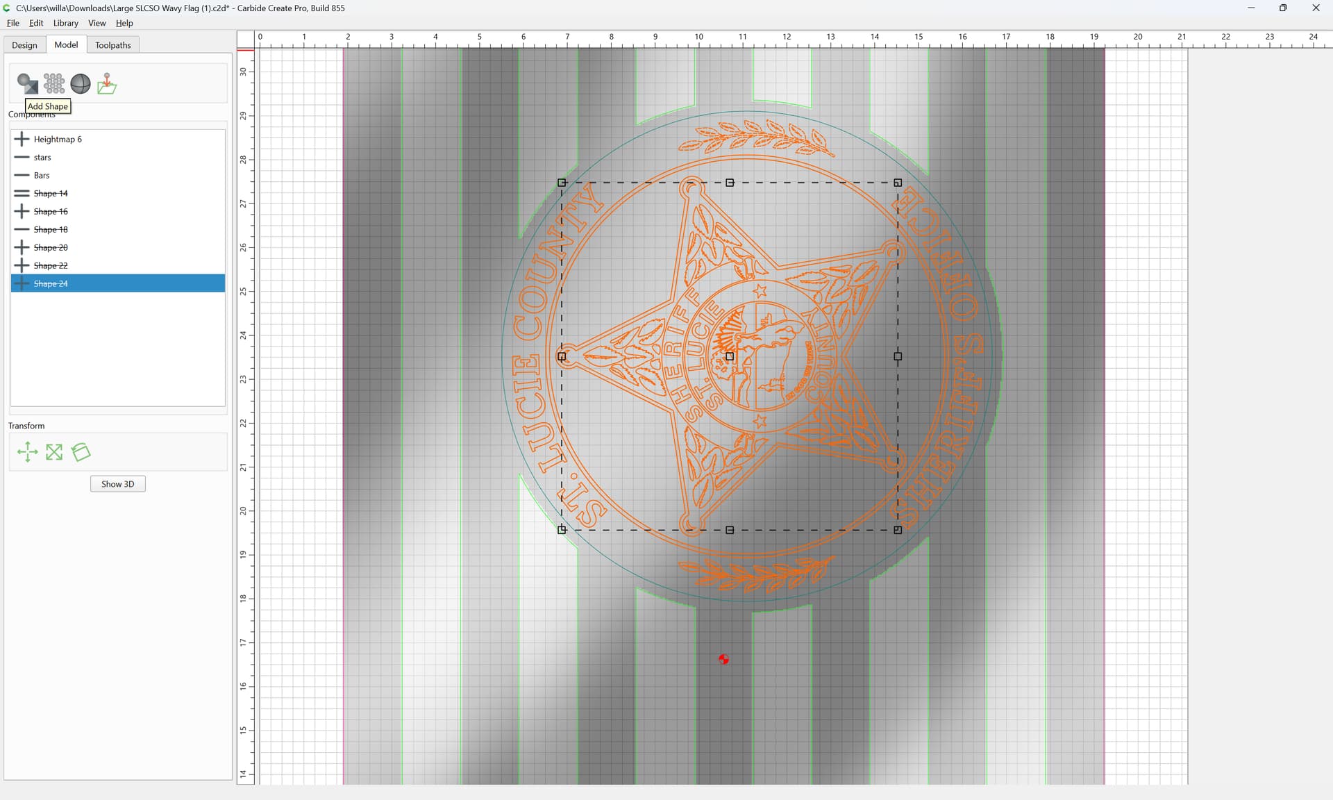

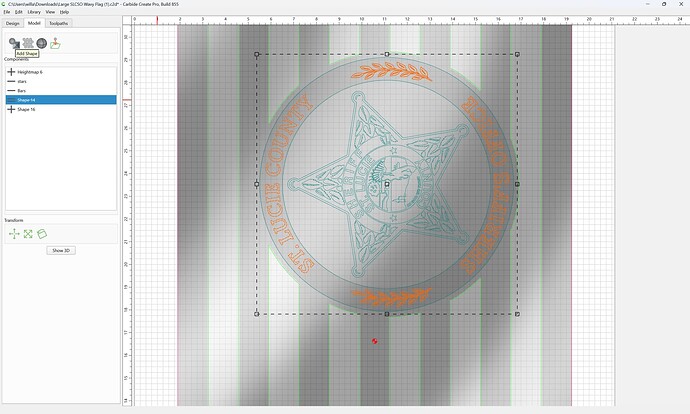

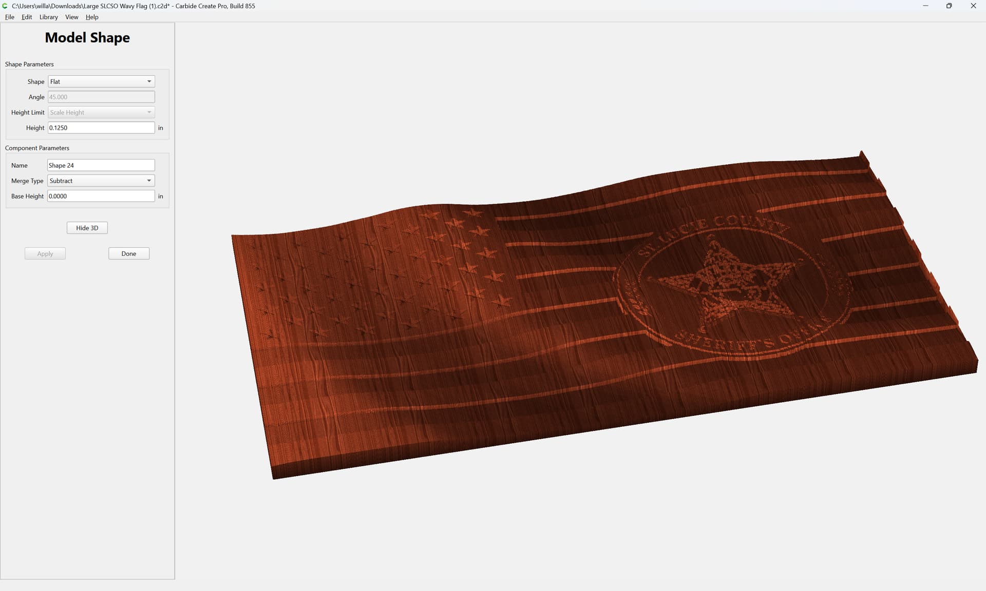

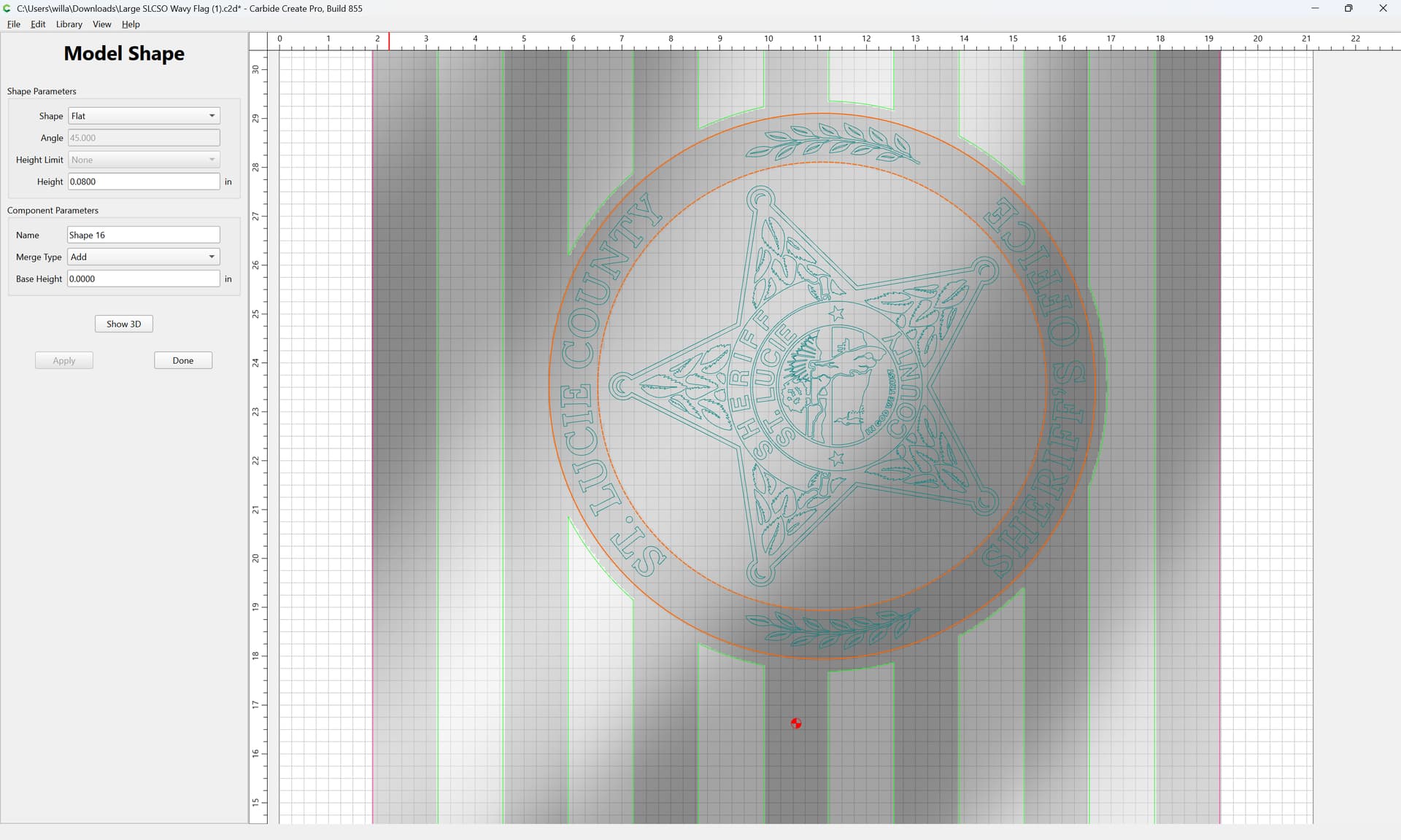

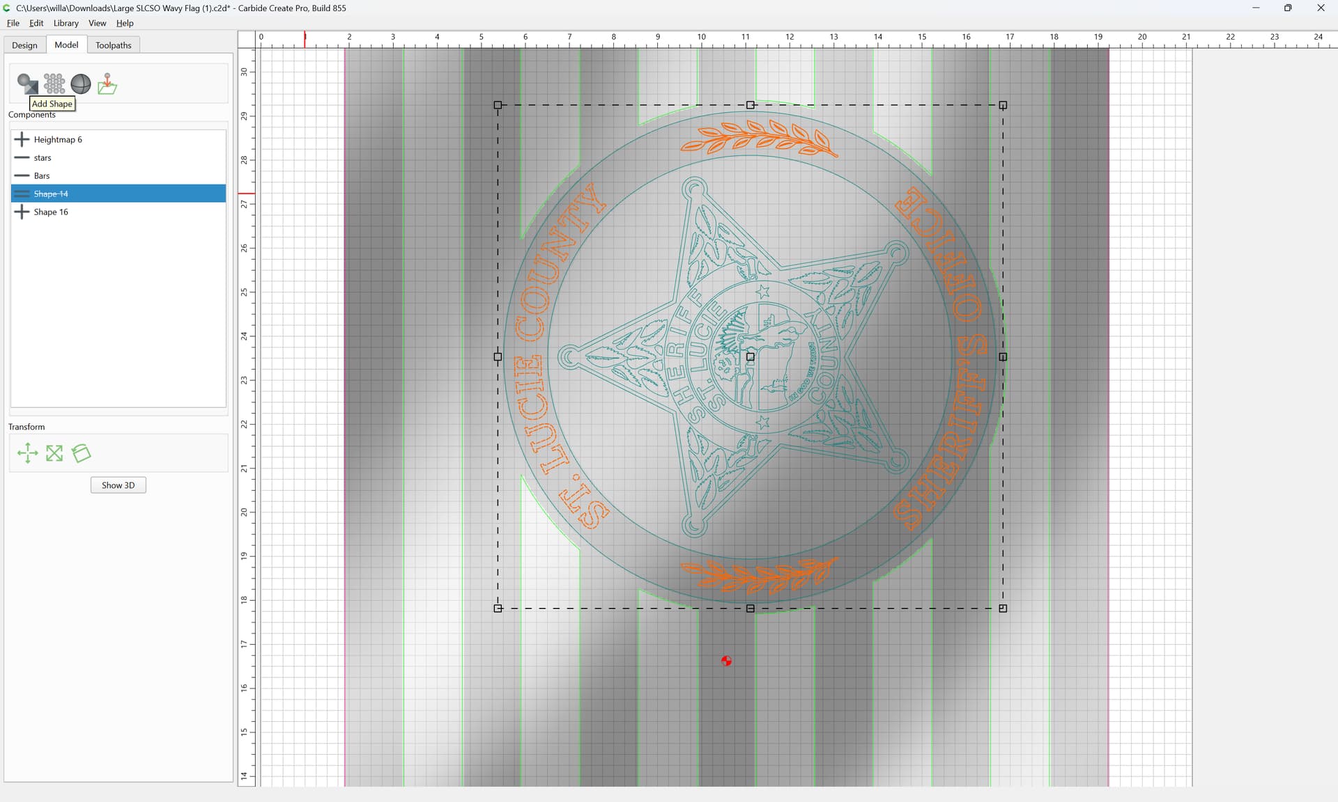

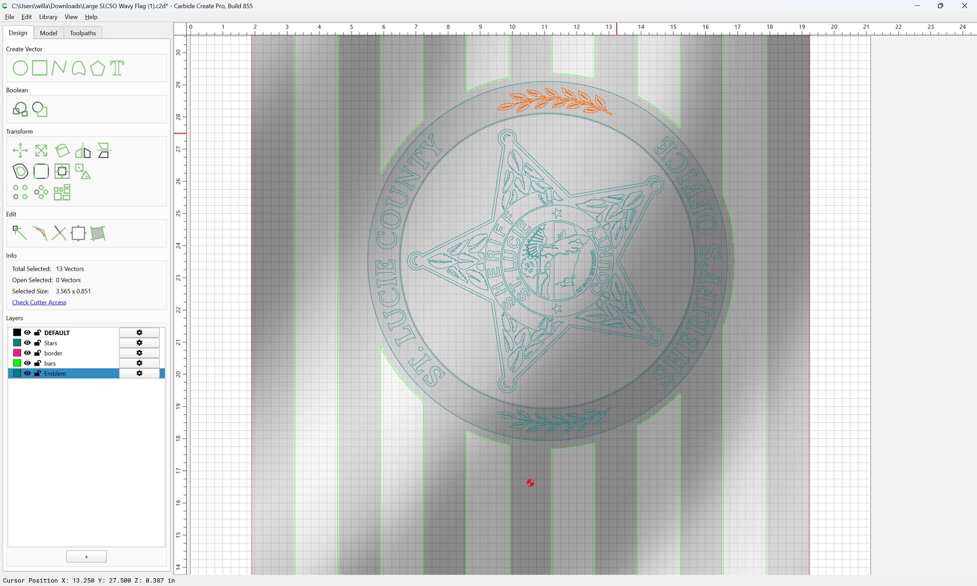

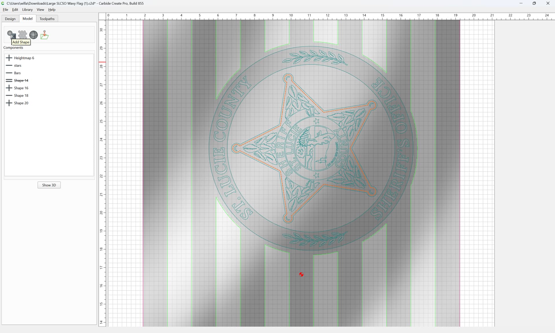

A second approach would be to select specific elements:

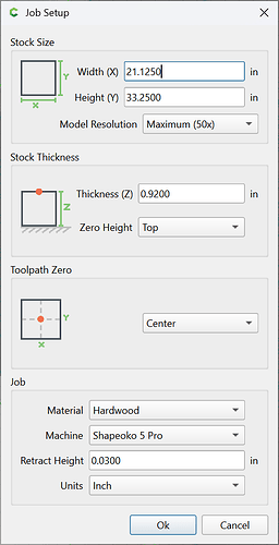

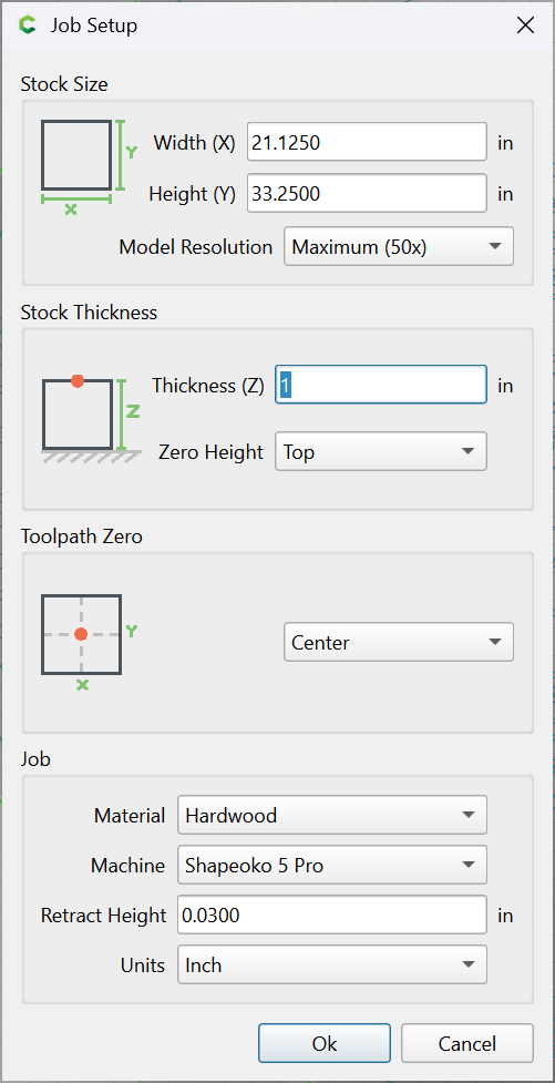

and model them separately and in sequence, but doing so requires an awareness of the Stock Thickness:
and what seems to be the thickest portion of the design:
and the lowest

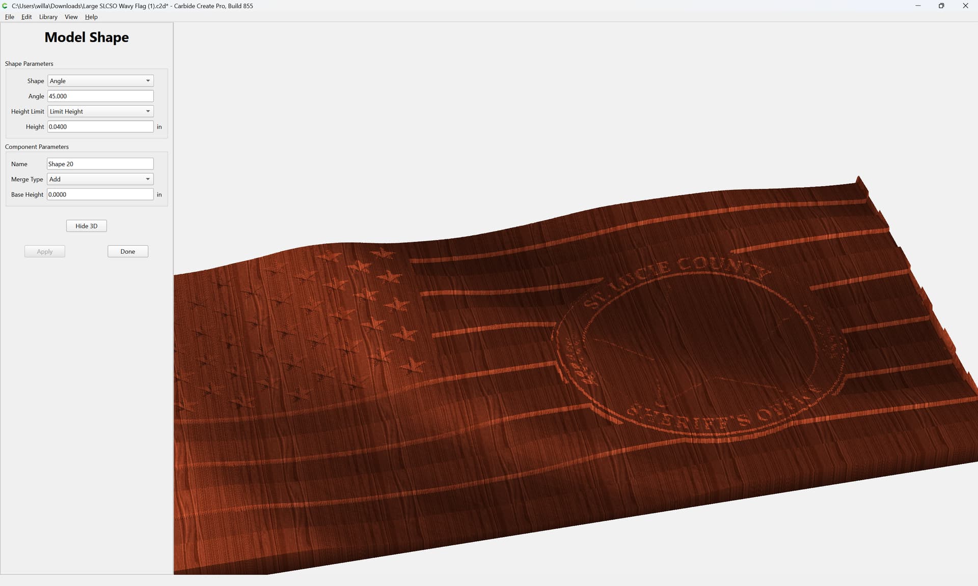

We will assume that the stock is 1" thick and that an additional 0.08" of thickness may be added:
Show 3D
(which seems to mean that we need to adjust Stock Thickness)

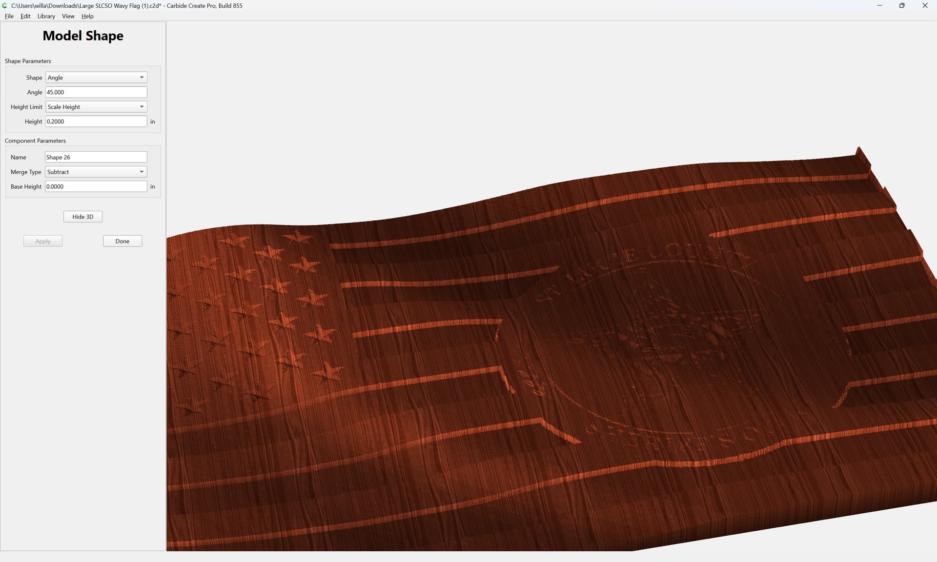

Then it is a matter of selecting the balance of the emblem design:
and then subtracting from the raised region:
and where appropriate, selecting:
or sub-selecting:
Then subtracting the balance of the design:
adjusting until one arrives at the desired effect:

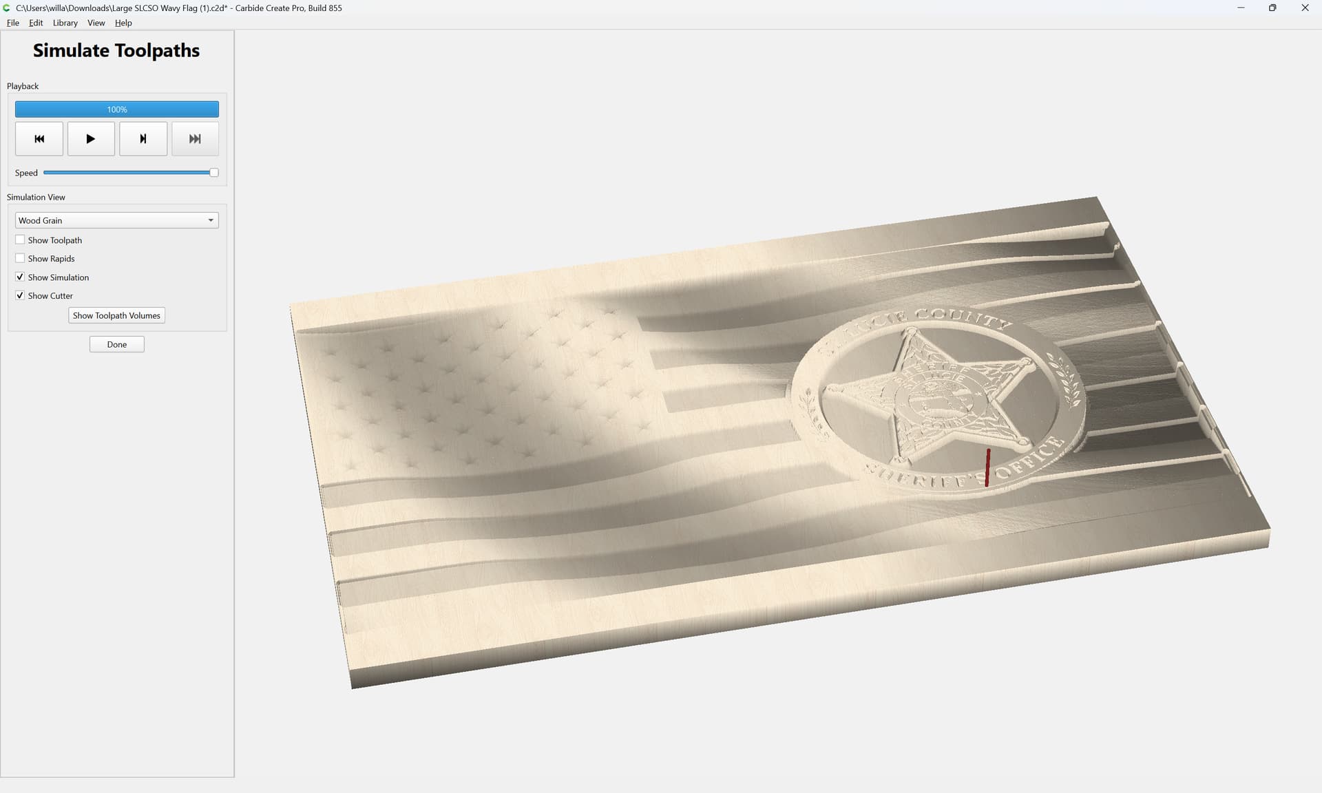

Since the design is fully 3D, then 3D toolpaths may be made as described at:
WillAdams
August 23, 2026, 5:53pm
4

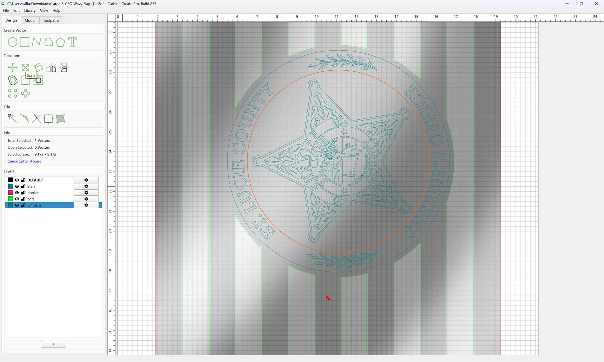

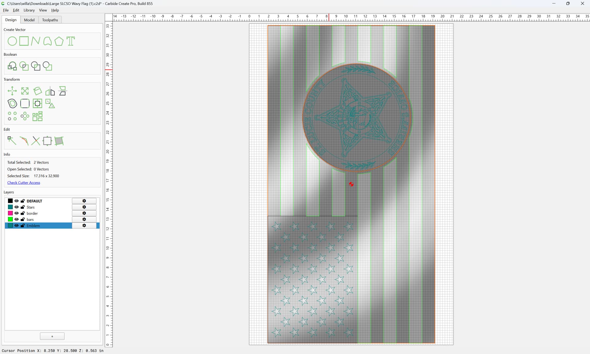

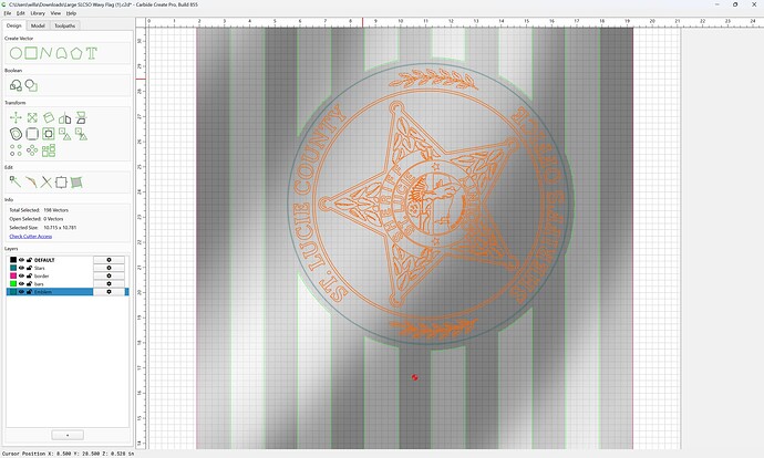

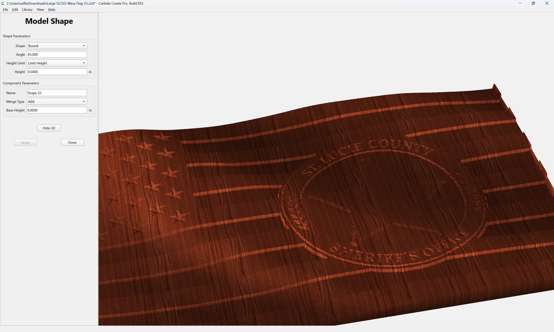

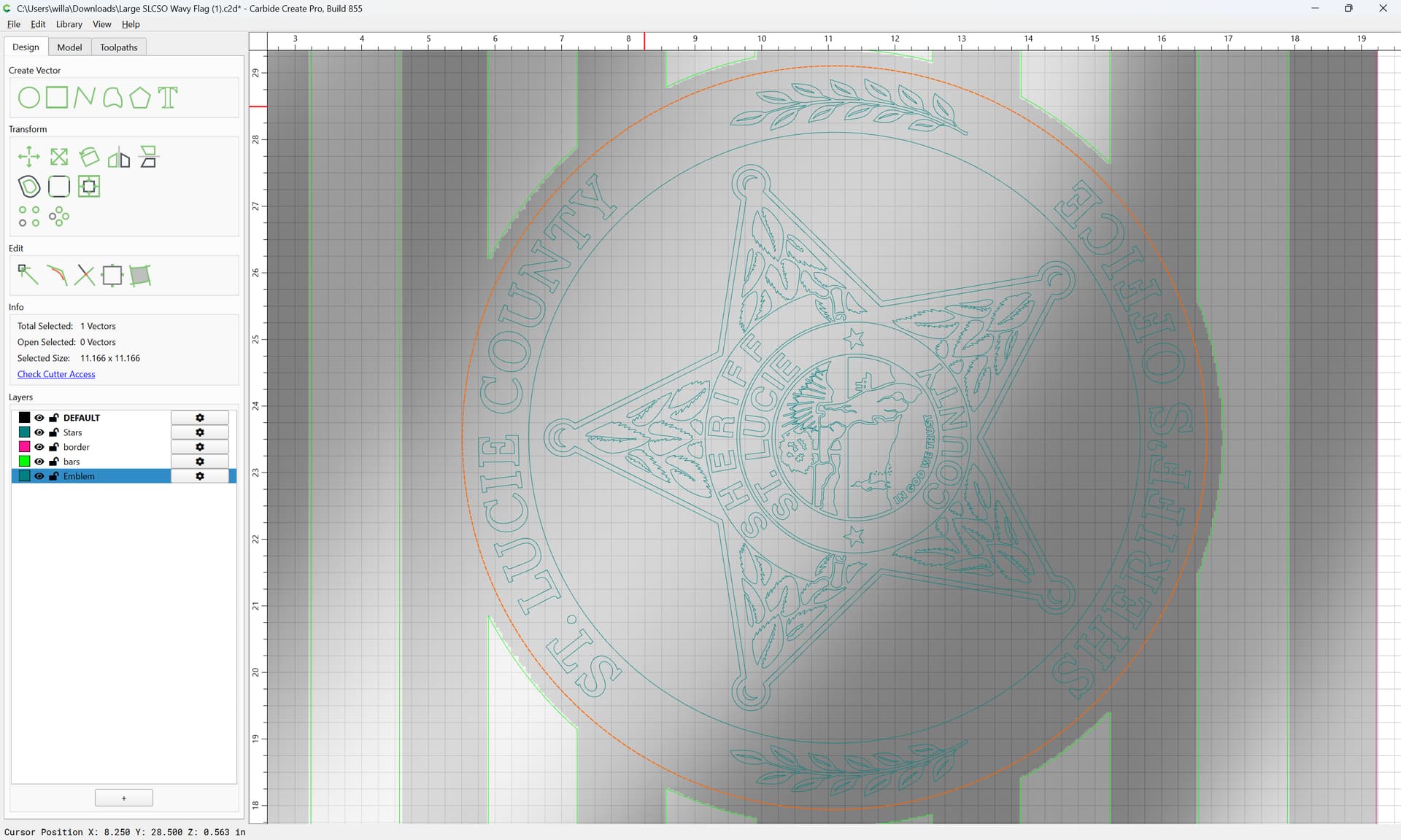

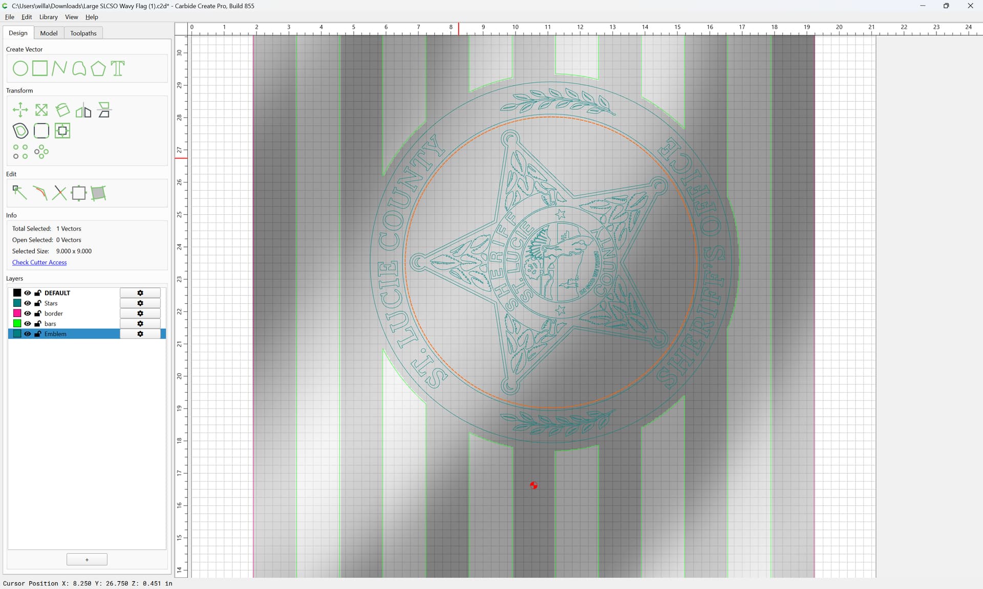

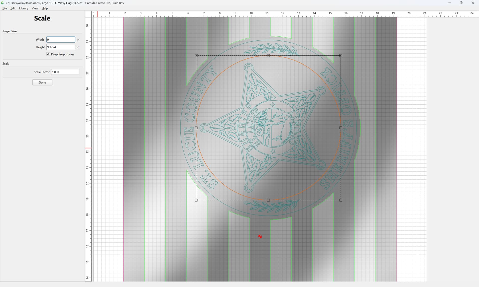

For the third and final option, we add an additional circle to keep the interior one distinct:
Done
and do not include the outer circle in the selection:
as before, adjusting until one arrives at the desired result.

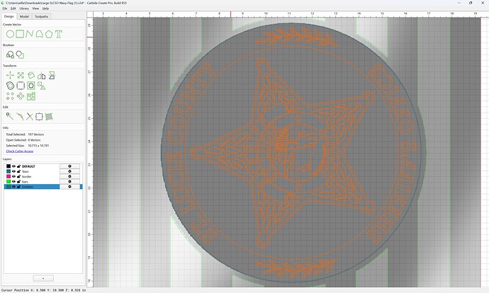

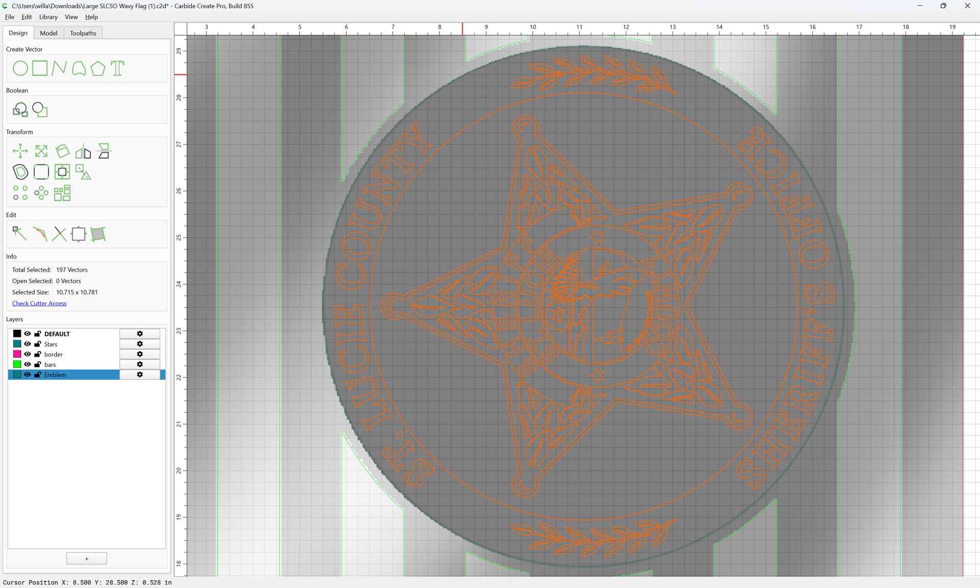

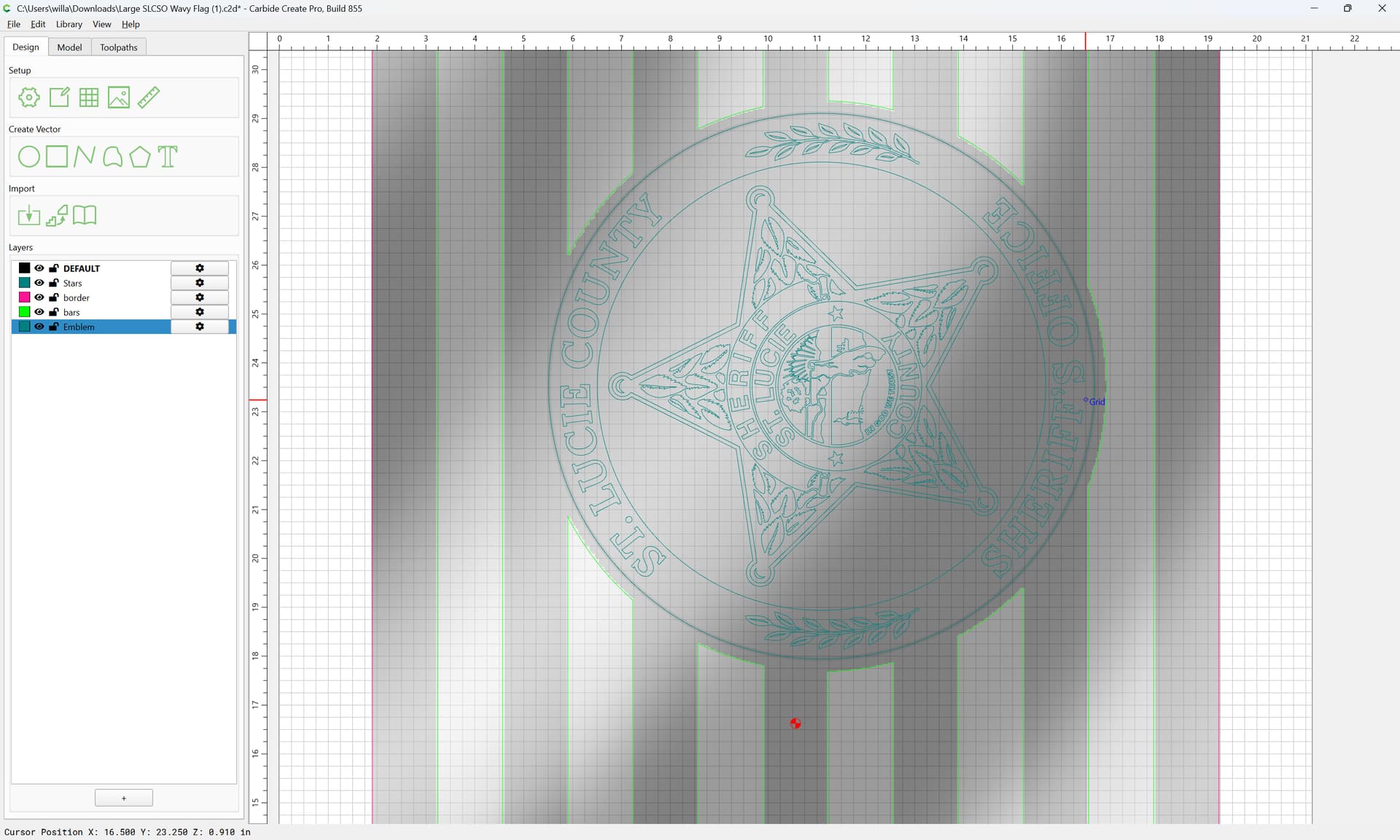

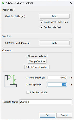

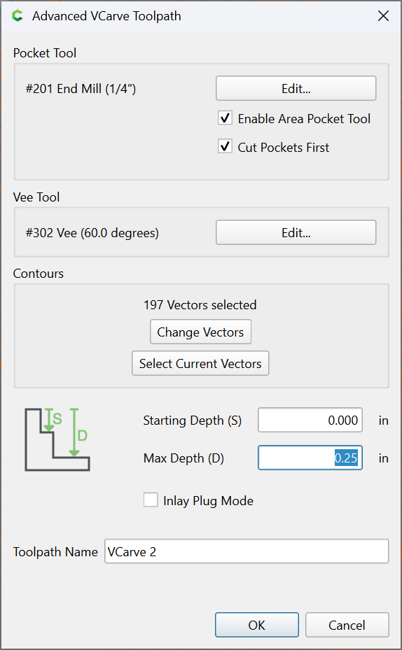

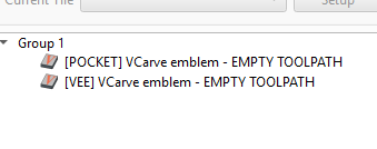

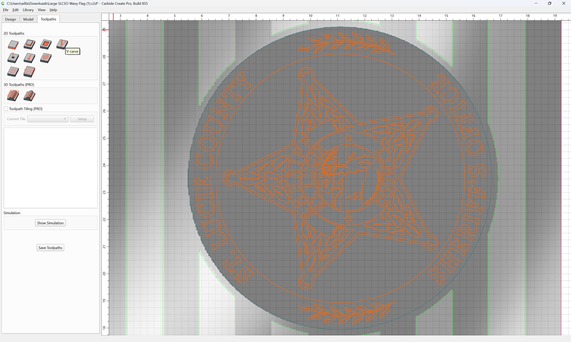

Thank you for the detailed walk through. I know this is probably remedial, but on the first example, I cant get a v-carve toolpath:
WillAdams
August 26, 2026, 12:35am
6
What do you have selected for the V-carve?
I selected the entire emblem, 197 selctions.
WillAdams
August 26, 2026, 11:52am
8

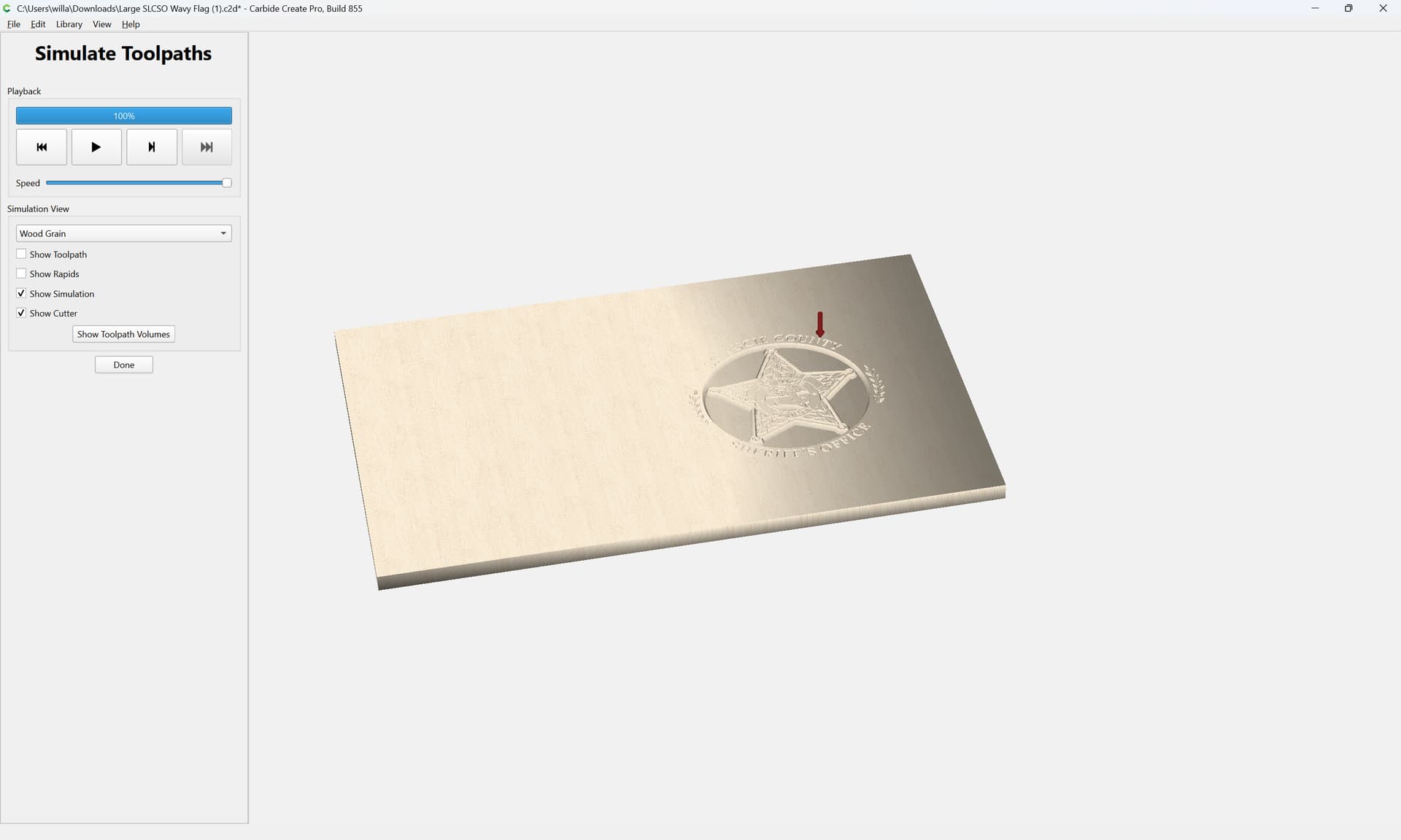

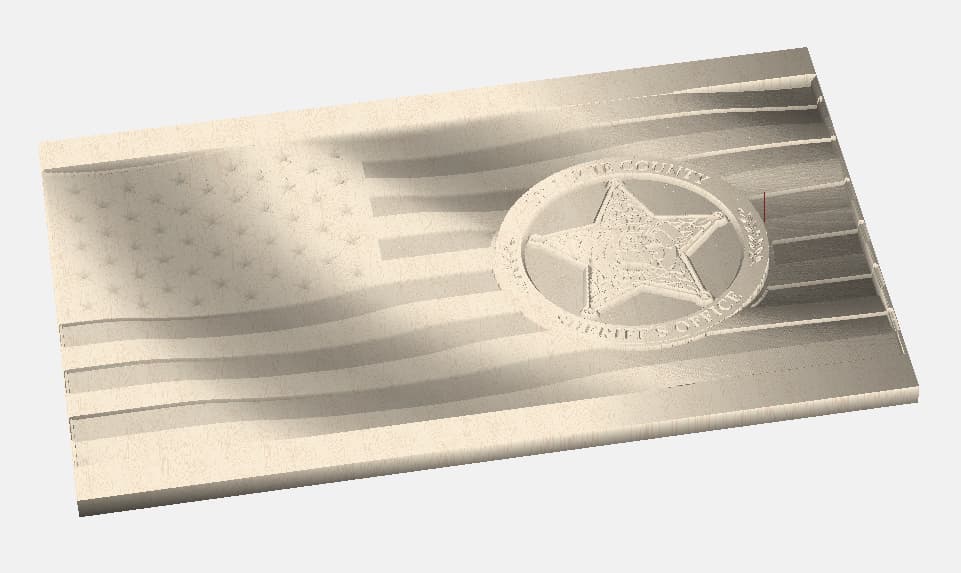

Will, I was able to successfully toolpath the job. I use the first method you showed and I got it set up. Tomorrow I will start the carve. I will keep you posted. Thank you. I actually learned a lot from this one! Thank you.
