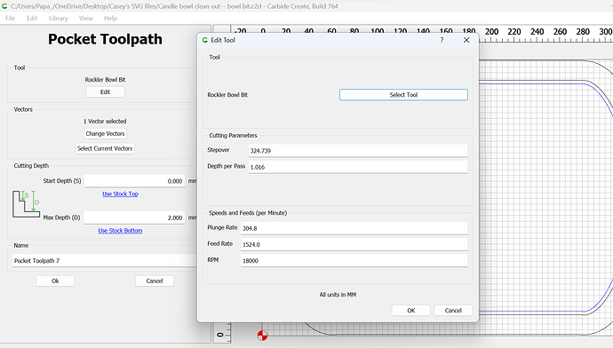

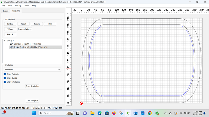

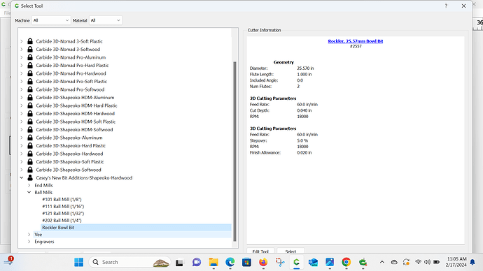

I just added a new bit which is a Rockler quarter inch shank bowl bit. I put in all the measurements but when I go to create a tool path, it continually comes back as empty tool path.
Does the tool fit in the geometry in question?
Post a screen grab of your custom toolpath description and a copy of your .c2d file?
Lots of people have added bowl bits. The geometry you are trying to carve out has to be a closed vector. Did you check that the object is a closed vector? If the vector is open any tool would have a problem. You could try changing the tool to a 1/4" or 1/8" and see if you can create the tool path successfully. That would put on the right track if it is the vector or the tool.
