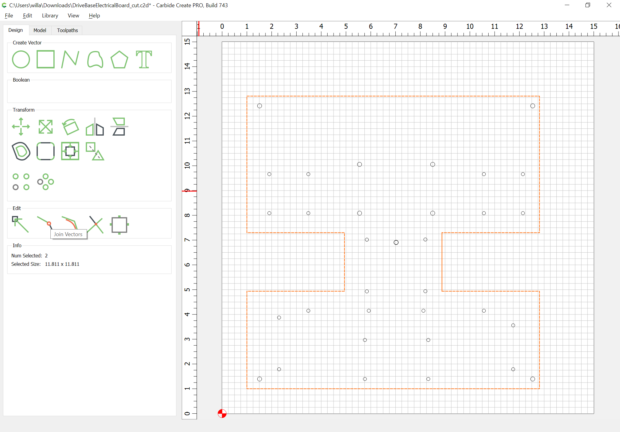

I have seen this issue multiple times in the forum but none of the steps suggested helped out.
After I drill the holes in a board I am trying to cut out the the inner piece. The files in question are attached
Bruce

The problem is the outline isn’t continuous:
It’s made of 12 separate parts which are too narrow to admit a tool if cutting inside/left — oddly, outside/right doesn’t work either (I suspect the paths cross), but No Offset does work:
Better though to edit the geometry and join it properly:
(repeat for the 11 other parts)
If need be, delete and draw in any problematic parts, then select everything and join:
