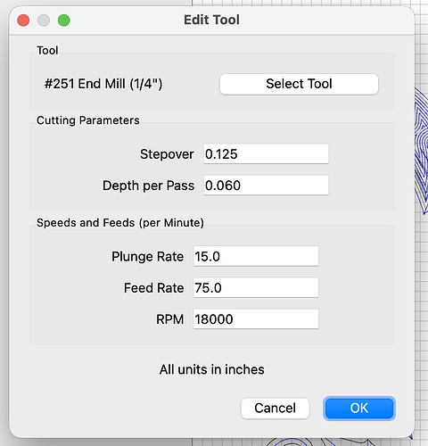

I’m running some simple pocketing cuts and the end mill and the retaining nut are both hot to the touch.
I’m assuming this is friction and not chips - faster speed? Slower feed? Something too tight somewhere?

Most recently it was plywood (test cutting). Everything between 1/8” to 120 deg v bit all were hot.
It’s cutting sharply so while I think it was a good question, I’m not sure that’s the problem.
The chips look reasonable - it’s not a fine dust nor are they big chunks with the router bogging down.
I am using a Makita router and using proper RPMs based upon cutting tool manufacturer specs.
I was wondering more if this is some kind of indication that the router is too snug or something?
I’ve always wanted to get a square spindle and bolt it on vs clamping on a router :-/
For instance, this is straight from Carbide Create’s tool library:
