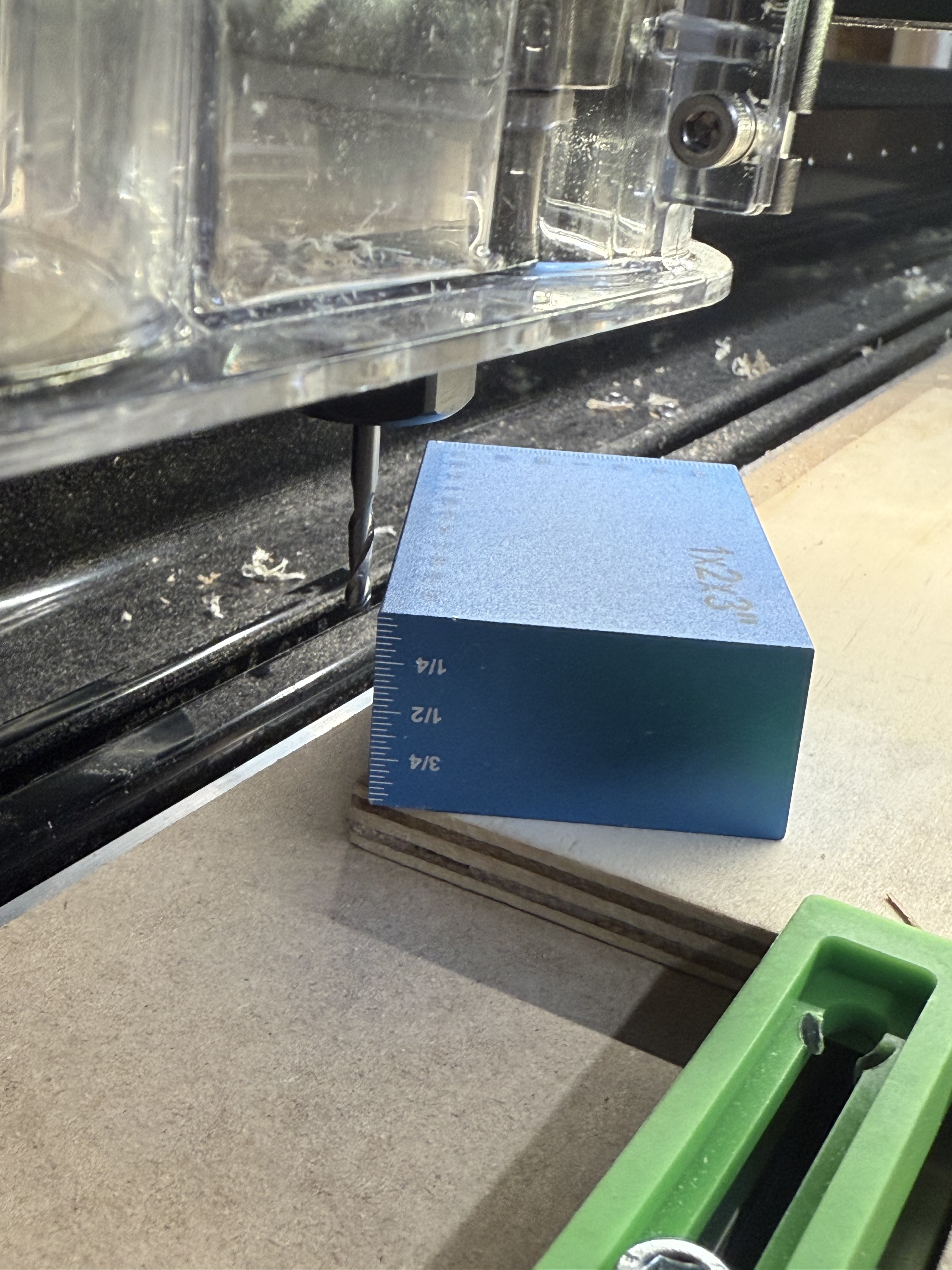

  1. Loaded the xyz zeros (I have the bit zero v2) - I’ve checked 4 times now that the zero is perfectly aligned to the bottom left of the stock (jogged it to Z+1 inch, jogged it to the Z+6mm, measured the spacing, it’s all perfect)
  2. Start job, soft checks bit height against bit setter - everything is fine - and then:
For some reason I can’t seem to understand - it goes to the correct place to start cutting and starts making the cutting passes around .125 inches ABOVE the stock.
I have no clue why - I’ve checked everything from scratch 4 times now - and the same issue every time. I have the pass depth at .03 inch so after 3-4 passes it eventually starts cutting the stock - but that also means it doesn’t cut it all the way through.
I’m about to start barking - I feel like I’m going crazy :crazy_face: If the zero is perfectly aligned to the top of the stock - what makes the machine start doing cutting passes 1/8th of an inch ABOVE the stock?

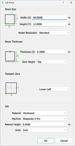

Your file is set to:

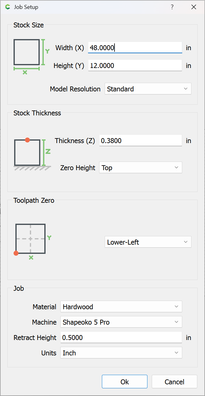

I use calipers to check the width of the material. It’s about .36 of an inch - so I set the material width to .38 to be safe AND set the contour cuts to .38.
I then use the bitzero to probe for XY and then for Z. I check that the zero is set properly with a quick action of plunge to 1 inch above the zero. Attached screenshot to show you it matches.
