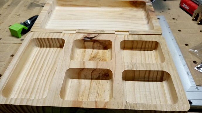

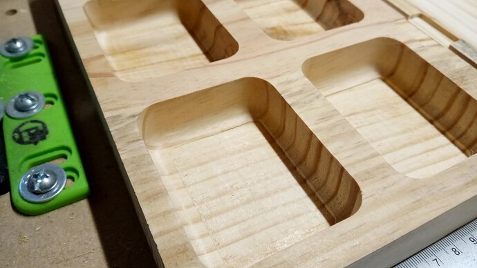

Should i run my endmill before the bowl bit? In this i ran the bowl bit for the complete pocket, then when i seen the rings left behind from it, i went back and tried to clean it up with my 1/8th endmill. Helped alot but seemed to leave a perimeter, either way I’m more so wanting to find out is there a specific order or if it even matters which order to use an Endmill and Bowl bit…I’m using cheap azz pine for this prototype until I get something I like, so I know that plays a factor, not to mention my v wheels more than likely need replaced. So, again, the focus is the order of the bits, not my quality on this particular piece.

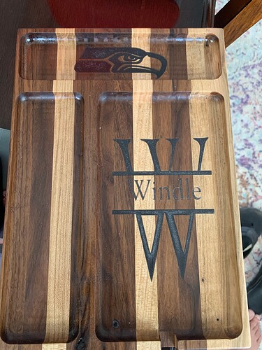

I did a similar project with Walnut, Maple, and Cherry.

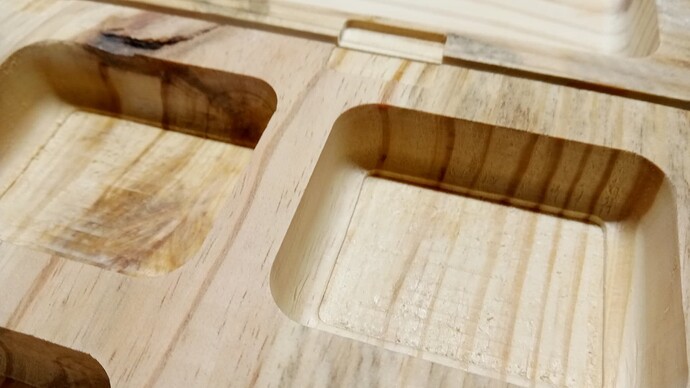

I found that I got the best results by using the Bowling bit in a Raster ToolPath, then one final Pass using a profile pass.
When I just used the Raster toolpath I had very small ridges where the bit turned around. The profile pass cleaned that up.

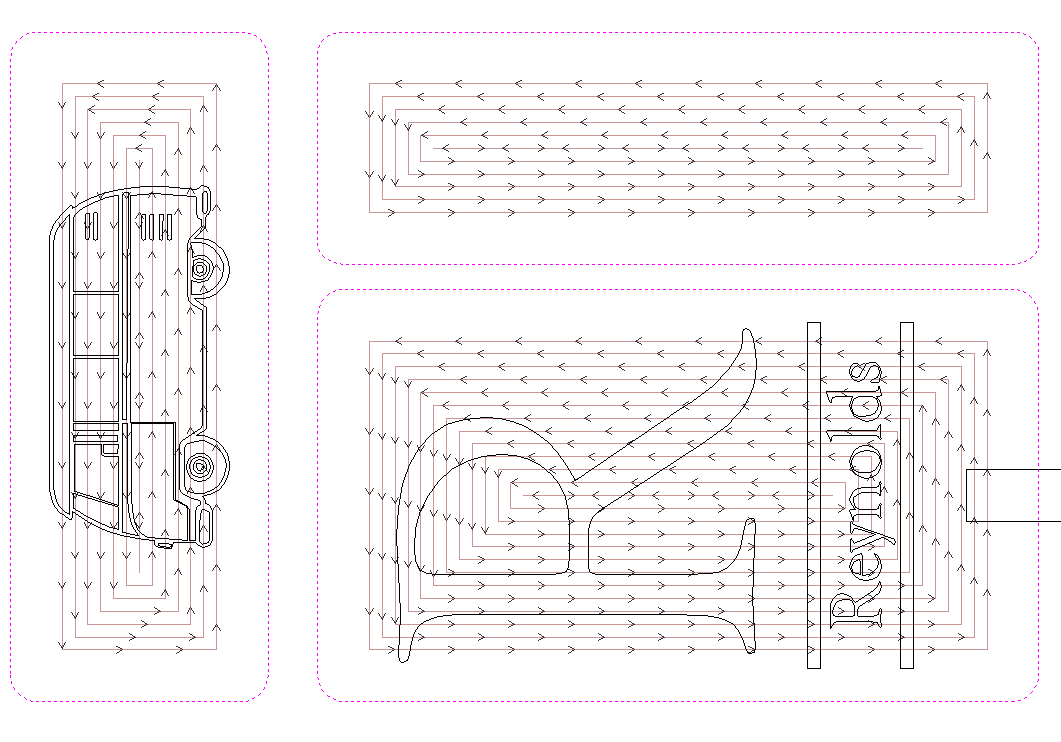

Here is a Raster tool path.
Here is an Offset toolpath.
Using a Raster tool path makes for a cleaner cut when used with the grain of the wood. Making the finished product a lot cleaner. It is very time-consuming to sand away tool marks inside of a pocket cut.
