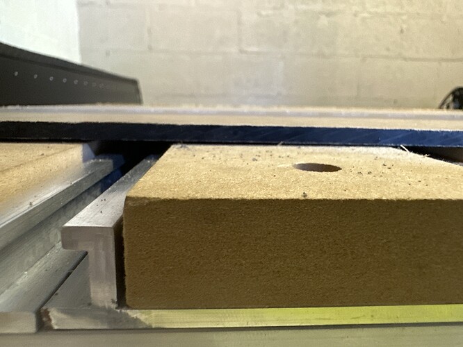

Is there something that’s going on that I’m doing wrong? I’ve been using the BitZerov2 And I always have a problem with engraving. You can see in the photo where the engraver is not touching the stock. how can I fix this?

I think the reason is is because the stock/acrylic one side is up from the table just a tiny bit where you can’t see it then when the engraver touches the stock the acrylic goes down, but then engravers just not cutting. I tried again today But setting the Z zero with paper and now one side is perfectly fine, but then the other letters are very deep
In that picture above your material has a bit of fuzz on the left side. Perhaps that threw off the BitZero measurement?
I wish I can send a video but it’s like the stock is a wobbly table that’s just not flat as soon as the engraver touches it, the acrylic goes down a bit cause it not to engrave the words correctly. Is there a better way to flatten everything out ? I know a vacuum table is perfect but don’t know how to make one

But, why is it wobbly? Have you trammed your spoil board? If you put the material on a good flat surface like a counter or tablesaw does it wobble?
In the picture, you can see that the stock is not touching the spoilboard. so when the engraver touches it, the acrylic lays flat, but the engraver is not touching it. It’s barely grazing it. sorry if I meant wobbly, it’s just I meant the stock is wobbly like in the picture
Thinner materials require full support to prevent flex. This is a good case for a supplemental spoil board. A piece of MDF larger than the parts you are making that you can secure to the machine. Surface it in place to provide complete support for your acrylic. Then painters tape and super glue will provide full contact.
Agreed. Even a cutting mat would be better, but a scrap of MDF or anything like that would be good.
I tried doing it. It still doesn’t work. The engraver still misses the stock. I’ve done it a couple times try adjusting, and it still doesn’t touch. One side, it will be touching, and the other side is not touching at all
Have you trammed your MDF and ensured that your stock is of consistent thickness and secured so that the top surface will be in plane with the machine motion?
Yes I have with the white side surfacing bit
